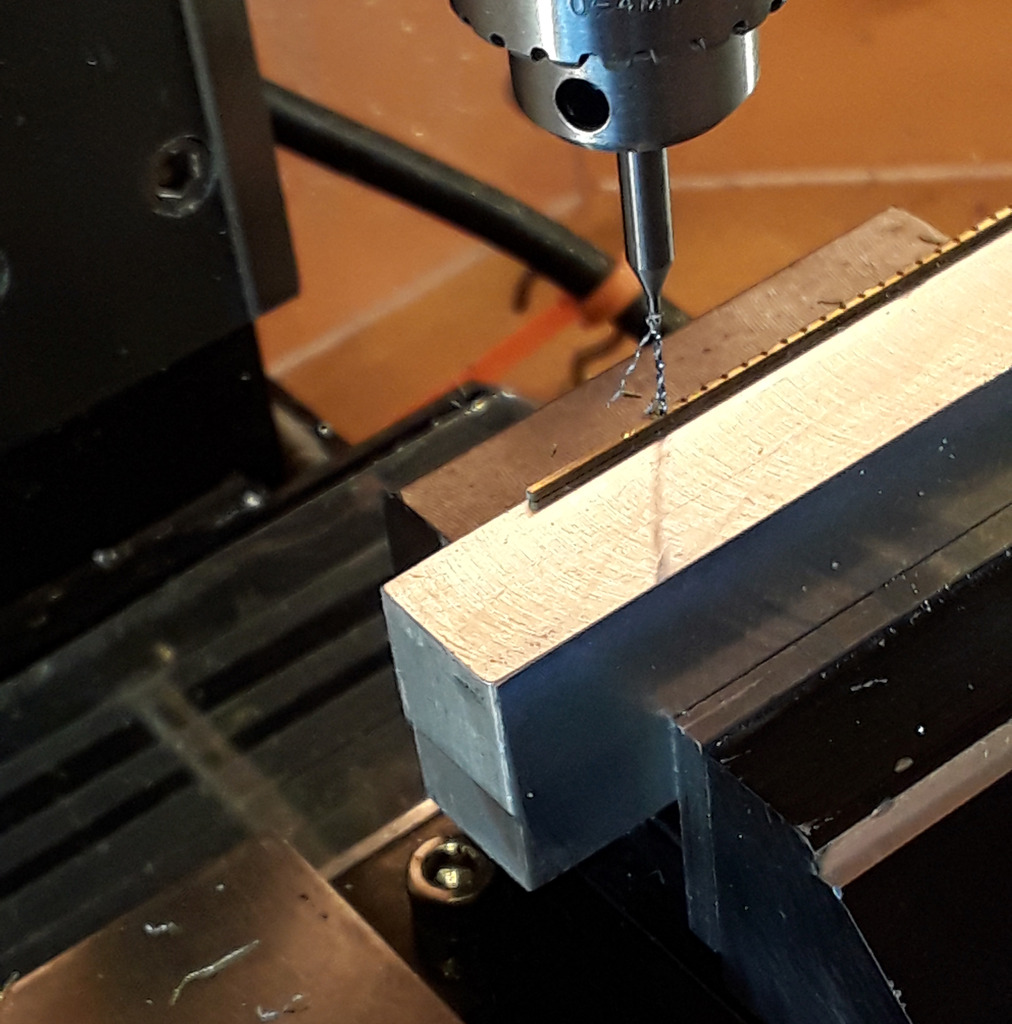

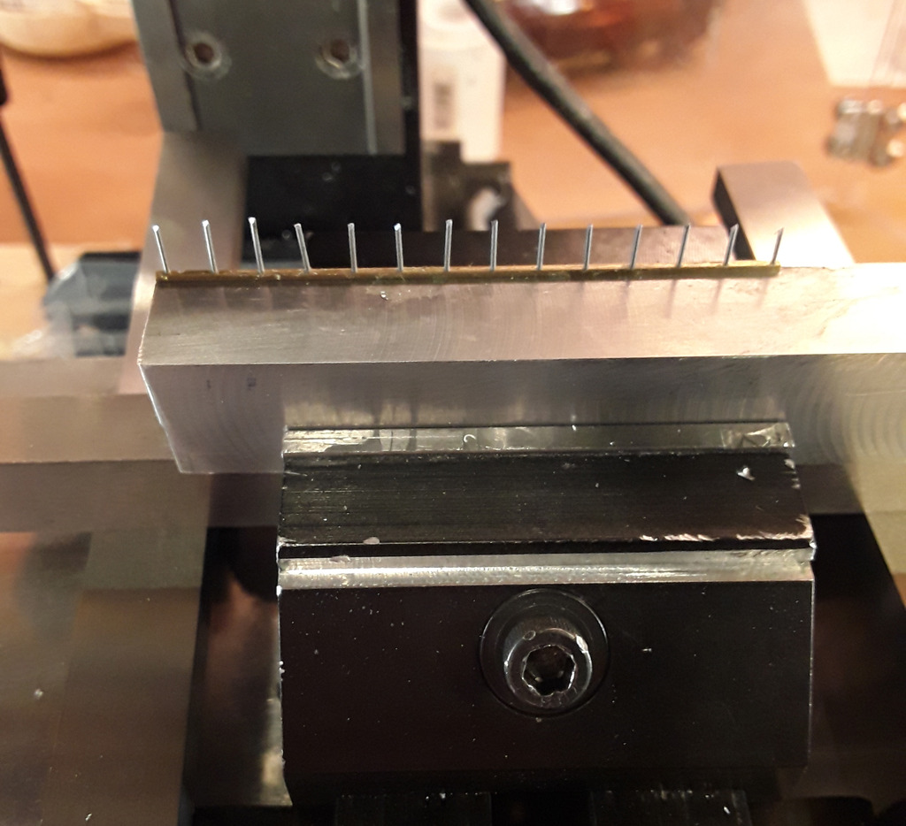

As has already been mentioned, it really comes down to what you are doing, as to the tool you choose.  Just trying to get a hole through plastic, heat s needle over an alcohol burner would work fine,  or cheap bits from a discount house.  About the same.  The pictures below show the need for a perfectly sharpened bit.  That bit is .028 and the brass is .040.  Anything less than perfect and the bit will wander and you will either break a bit or drill through the side.  Ya, get wachya pay for.

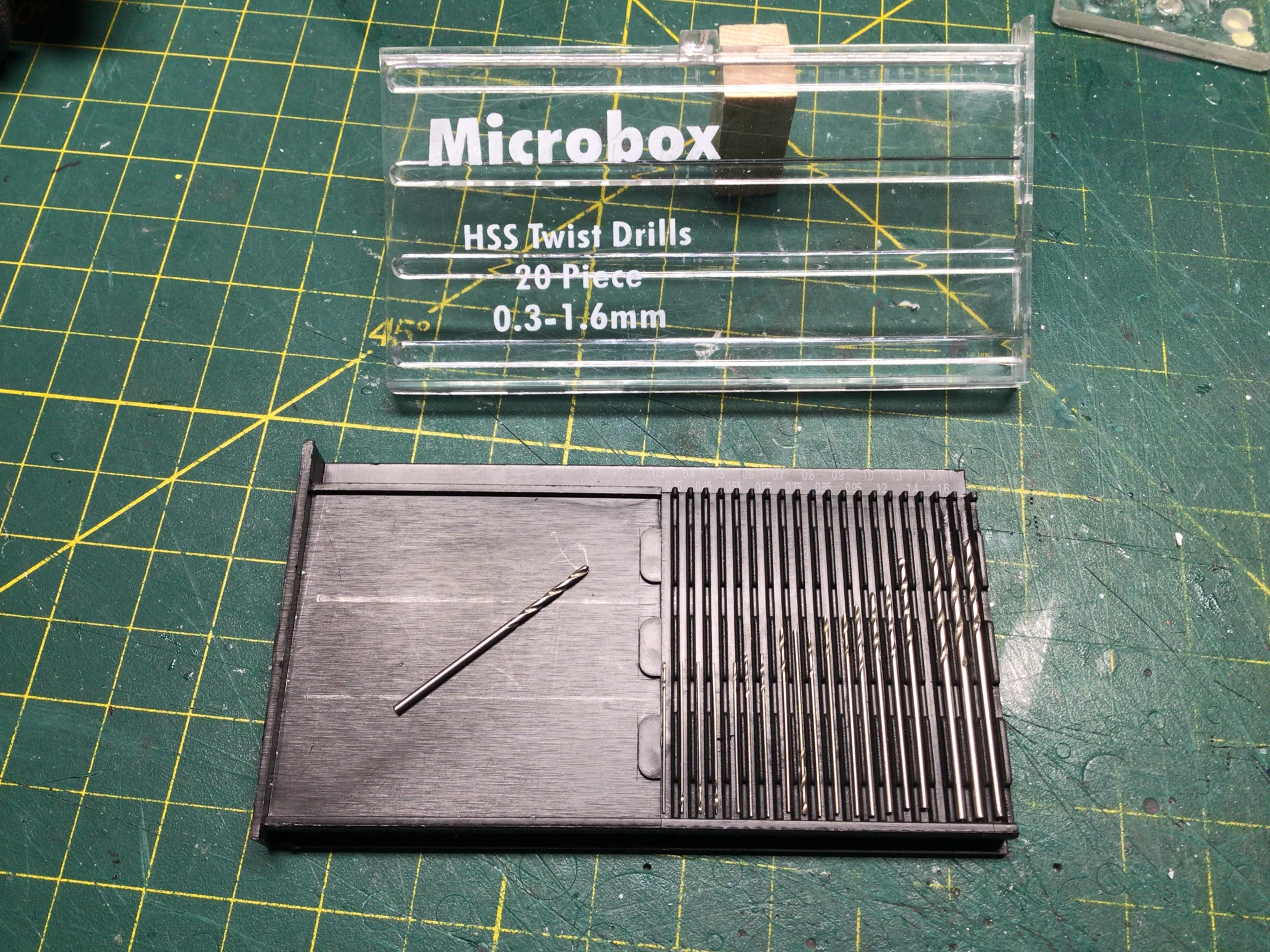

On 12/12/2018 at 12:26 PM, Justin Porter said:
We carry the Trumpeter line of hobby bits at my shop after a few of our ship guys requested them and I've been pretty impressed.
trumpeter-09954-twist-drilling-auger-bit
How do these Trumpeter drill bits hold up over time?
So far so good. My personal set have seen a reasonable amount of use (generally either opening option holes for underwing stores or reaming overly shallow mounting pin holes) and haven't shown any signs of dulling yet.

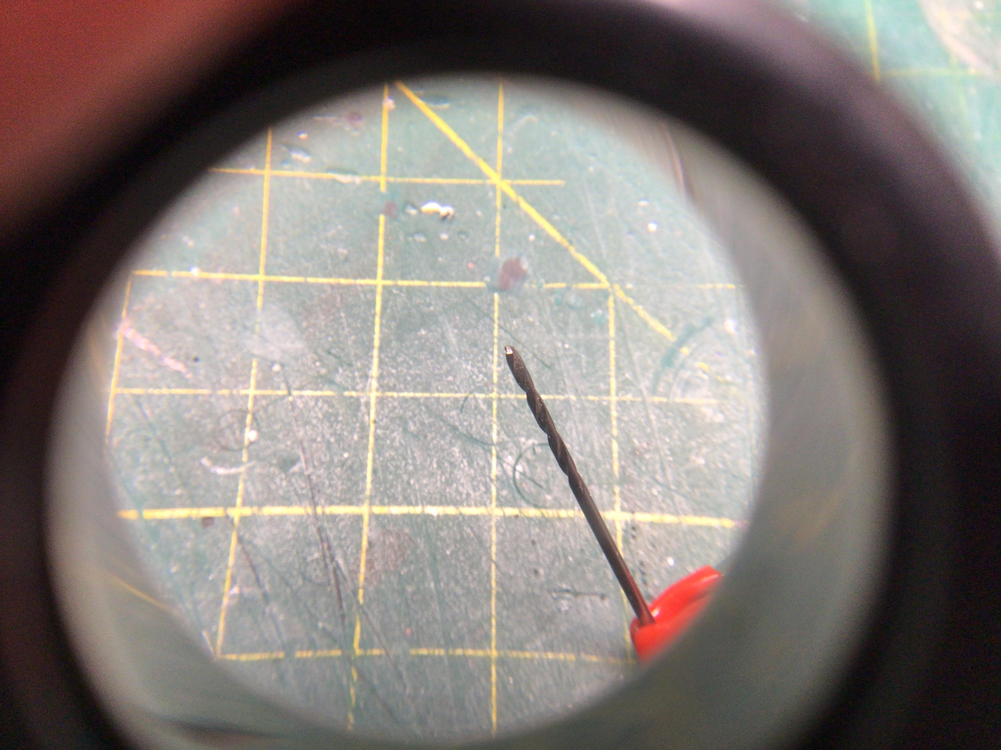

Yes, with inexpensive miniature drill bits the quality is all over the place. The point i was making is that a steel drill will not get dull by drilling lots of hoes in plastic.  If they are dull, it is right from the start.
Edited by peteski
Here is a brand new cheap one. The cutting edge will not even touch the material being drilled, since it is ground at a reverse angle.?
