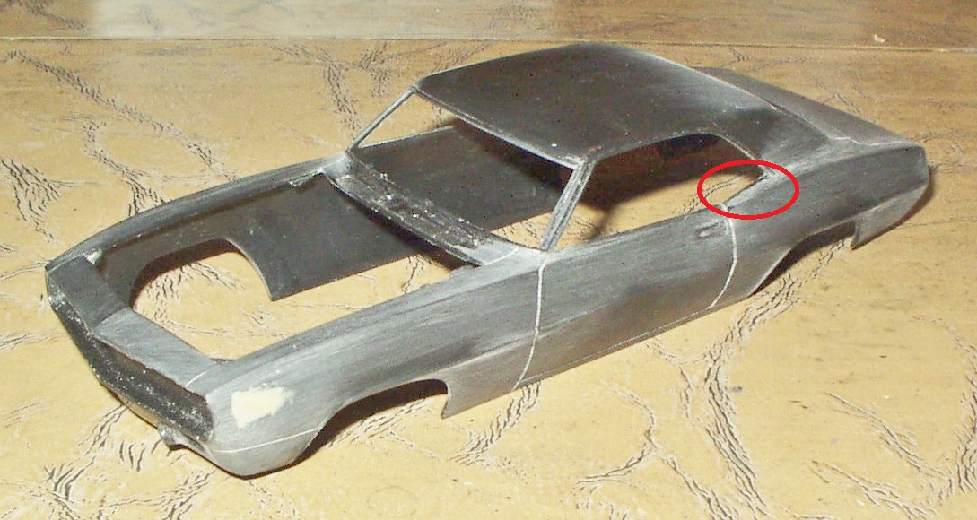

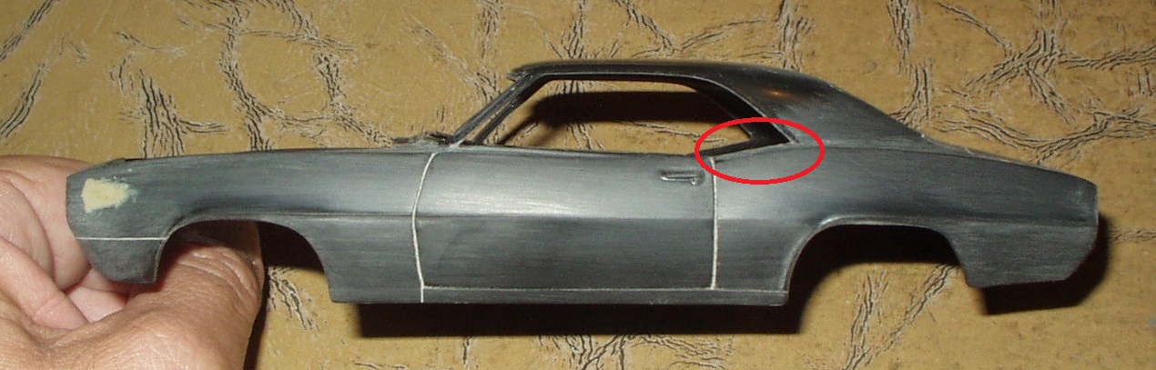

Snake45 Posted December 14, 2018 Posted December 14, 2018 25 minutes ago, Mark said: One change you can make that really improves the look of the body, is to trim the windshield opening higher at the top. You'd file the actual opening higher by the thickness of the trim around the windshield at the top, then scribe new trim above that. There are other issues (headlights are too small, for one) but the windshield opening makes a big difference. Another thing that really helps this body (and the MPC '69 Camaro as well) is to knock down the top edge of the rear fenders a little, so you can get the correct contour between the bottom of the rear quarter windows and the top of the fenders. The circles in these pics show how I've done this on an MPC '69 Camaro body. It's a bit hard to describe, but look at the MPC Firebird or Camaro body and compare it with either pics of real ones, or even the Revell '69 or '67 Camaro or '68 Firebird bodies (or even the AMT '68 Camaro) to see what I mean.

Snake45 Posted December 18, 2018 Posted December 18, 2018 49 minutes ago, Oldcarfan27 said: The problem with the MPC Camaro body is the wheelwell openings and flairs are too small and too low. I've read the problem here is that the 69 Camaro annual kit came directly from the 68 annual and that the side crease is actually too low for a 69. You'd have to channel out a slice from above the crease and move the side up. Then you'd have to add material to the bottom of the door/rocker panel area to make up for the loss. Not sure if the 69 Firebird has these same issues or not, it doesn't look as bad to my eye. You read that from me, and the Firebird body has the same problem. The only cure to do a GOOD one is to start with a Revell '69 Camaro body and convert it to a Firebird.
