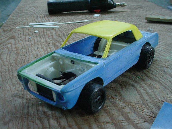

The Valiant progressed. I cut out the hood and glued in the engine room from the Duster kit. There are small changes that occurred from 1963 to 1971 but nothing that would bother me with this model. And I was so pleased with my progress that I sacrificed a fairly clean 1964 Valiant body for a new roof. The other Valiant is in progress to be a convertible so it won't be wasted.
