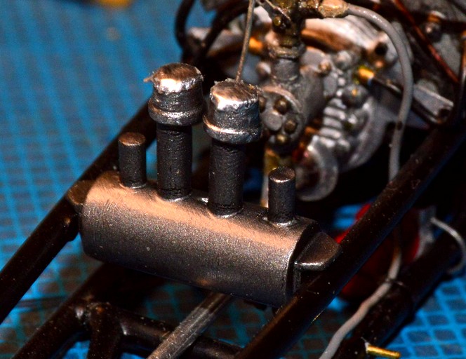

Straightliner59 Posted March 30, 2019 Author Posted March 30, 2019 I have recused myself from round two of "Gitter Done!". I just have too much left to do. I am already in, for round three, should it happen. I didn't have aluminum wire in the proper size, for the main fuel line. I ordered two lengths, one in '040" diameter and the other in .052". I opted to use the .052". I soldered the three-way return/shutoff valve from four pieces of brass, and added a lever/linkage from an unknown photo-etched set. The shutoff "cable" has been stripped, and is ready to attach to the valve, once I have permanently mounted it. I need to make the fittings for the main fuel line, then, it can be attached. I am going to make a small manifold for the return lines, so that I can use a single, rigid return line back into the tank. I also started playing around with the headers. I'll be fabricating a flange to mount them to. Over the weekend, I will have this part of the fuel system done, and will, once again, remove the body, so that I can finish up, in the cockpit, and get the body mounted permanently. I also plan to write and shoot a proper tutorial on making scale zip ties. Questions and comments always welcome! Thanks for looking!

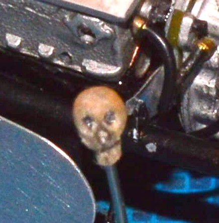

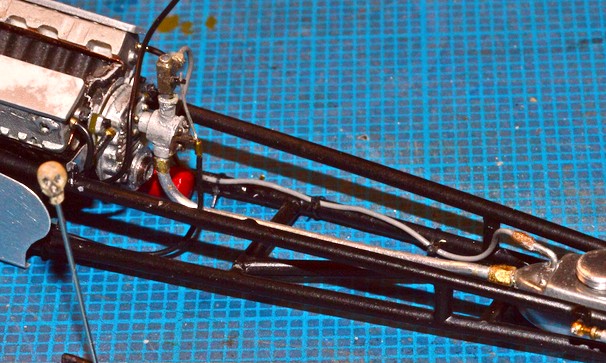

Straightliner59 Posted April 8, 2019 Author Posted April 8, 2019 (edited) I have most of the fuel system, from the front of the engine, forward buttoned up. I changed the return line from the one in the "zip-ties" tutorial, because it was stupidly complex, when two simple return lines will do--one down each side, rather than a tee fitting that looked more like a manifold! The return line is 36ga. grey wire I bought from a model railroad specialty place, online. I applied a Purolator decal to the oil filter. That came from an Etzel's sheet. Also note the skull. I got some inspiration from a photo I have of the restored "Chizler" dragster's brake handle, and, since I need to shorten the brake handle, anyway...I though I was on my way, with a 1/72nd scale tank commander's head. Alas, it was too big. So, I used a birch (I think) cuticle tool from a bag I bought at the beauty supply, and began carving a skull. It still needs a bit of work, but I think I can use it, to replace the round head of the pin that's there, now. Thanks for looking! Comments/questions always welcome. Edited April 8, 2019 by Straightliner59

Straightliner59 Posted April 13, 2019 Author Posted April 13, 2019 5 hours ago, afx said: The driver's head looks great! Thanks, JC, but, that is the brake handle knob from the re-creation of Karamesines' Chizler. It is very cool! I was going to try to somewhat replicate it, for mine, I have a 1/72nd scale tank commander's head I was going to use, but it is just too big. That's why I started carving the skull. I should have this thing finished in about a month, give or take.

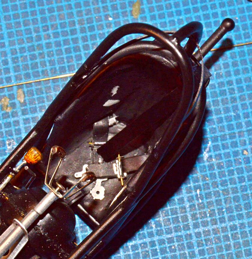

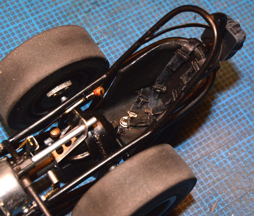

Straightliner59 Posted April 22, 2019 Author Posted April 22, 2019 Okay, here's where I am, now. The harness is installed. 'Chute is mostly painted, and is hanging on its mount, in these photos. I got the puke tank painted, and its draincock installed. Next up, I'll be installing the eye for the 'chute release cable and 'd'-ring, and wrapping the roll cage with thin strips of electrical tape. I dry-brushed some steel on the diff, since the driver's legs will be riding over it. Getting closer to working on mounting the body...

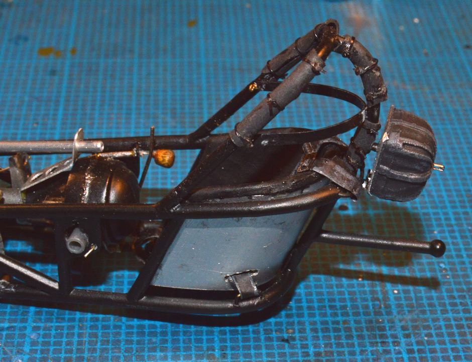

Straightliner59 Posted May 3, 2019 Author Posted May 3, 2019 A little update: This project likes to back me up a step, for every bit of progress, I make. Case in point; Initially, I had hoped to wrap the rollcage with narrow strips of electrical tape. In fact, I did. It was not uniform, no matter the effort I took to make it so. That had to come back off! So, I decided on short lengths of heat-shrink tubing, fastened with zip ties. No problem, there, until I decided I wanted "padding" to better conform to the cage. I waved a lighter past the heat-shrink, and the "padding" softened slightly, and conformed. Okay! That's all good! Except, in the process of that, the heat melted the ends of the zip ties, as you can see in these pics. I am in the process of replacing them all, now. I am using finer line, this time, as well. The harnesses are all installed. I will be working more on their finish, retouching some of the black, where the highlights got a little out of control, and reapplying some India ink wash. I also got paint on the puke tank, and a draincock, installed there, as well. I really want the cockpit done, so I can move on to getting the body mounted!
Straightliner59 Posted May 17, 2019 Author Posted May 17, 2019 I have fixed the padding on the roll cage, and replaced the zip ties. Also mounted the 'chute. Installed the spark plugs--not that they'll be too visible--but, they create visual interest. I hd forgotten the pinion support, and have now made that. With the body on, and all the other "business" going on in the cockpit, it will be barely noticeable, but, it needs to be there! As always, questions and comments/critiques welcome

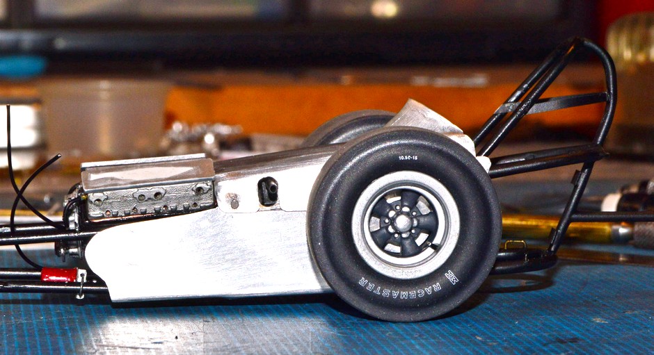

Straightliner59 Posted May 27, 2019 Author Posted May 27, 2019 The body panels are mounted! The car's right slick is also mounted. This is a big step!

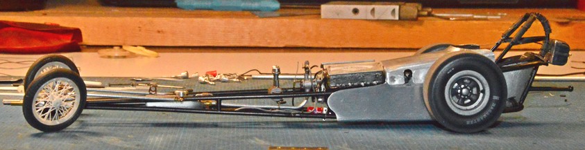

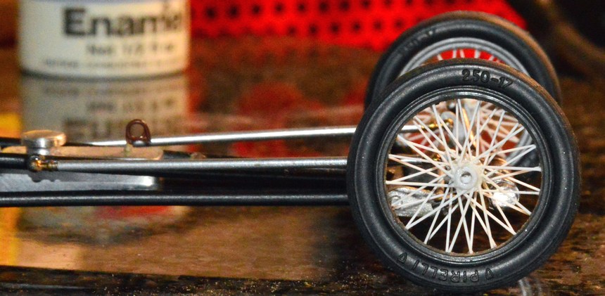

Straightliner59 Posted May 31, 2019 Author Posted May 31, 2019 Halfway home on front wheel number two! I just hope it matches the first one! Maybe I can get her on the wheels, before the weekend's over.
gasser59 Posted May 31, 2019 Posted May 31, 2019 (edited) Nicely done Dan. I'm sure they'll match judging by the way you're building process. Edited May 31, 2019 by gasser59
Straightliner59 Posted June 1, 2019 Author Posted June 1, 2019 (edited) 11 hours ago, gasser59 said: Nicely done Dan. I'm sure they'll match judging by the way you're building process. Thank you, kind sir. I'm halfway done with the other rim, now. Should finish that, tomorrow, then, I can fire up my recently-ducted spray booth and airbrush, and shoot some paint on these babies. I'll likely go with Alclad, but, will look around and see what other possibilities I might have. Edited June 1, 2019 by Straightliner59

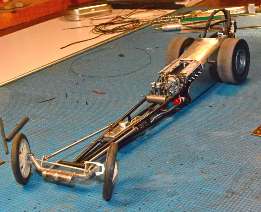

Straightliner59 Posted June 2, 2019 Author Posted June 2, 2019 The wheels are built, except for joining the wheel halves, and finishing them. I was thinking about using Alclad, but, I may go with metalizer, instead, to avoid extra coats (the undercoat for Alclad). I think they'll work!
