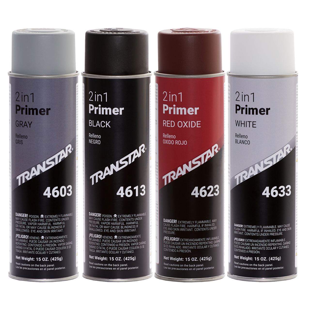

RSchnell Posted December 15, 2022 Posted December 15, 2022 I'm not a fan of Krylon or Rust-Oleum for models, stuff is too thick IMO. I used to use Dupli-color primer 80%, Tamiya for the other 20%. My local auto paint jobber gave me a can of this to try. So far I like it better than Dupli-color. Sands better than Tamiya and covers better than Dupli-color. I'll likely go back and pick up a can of black & white.
