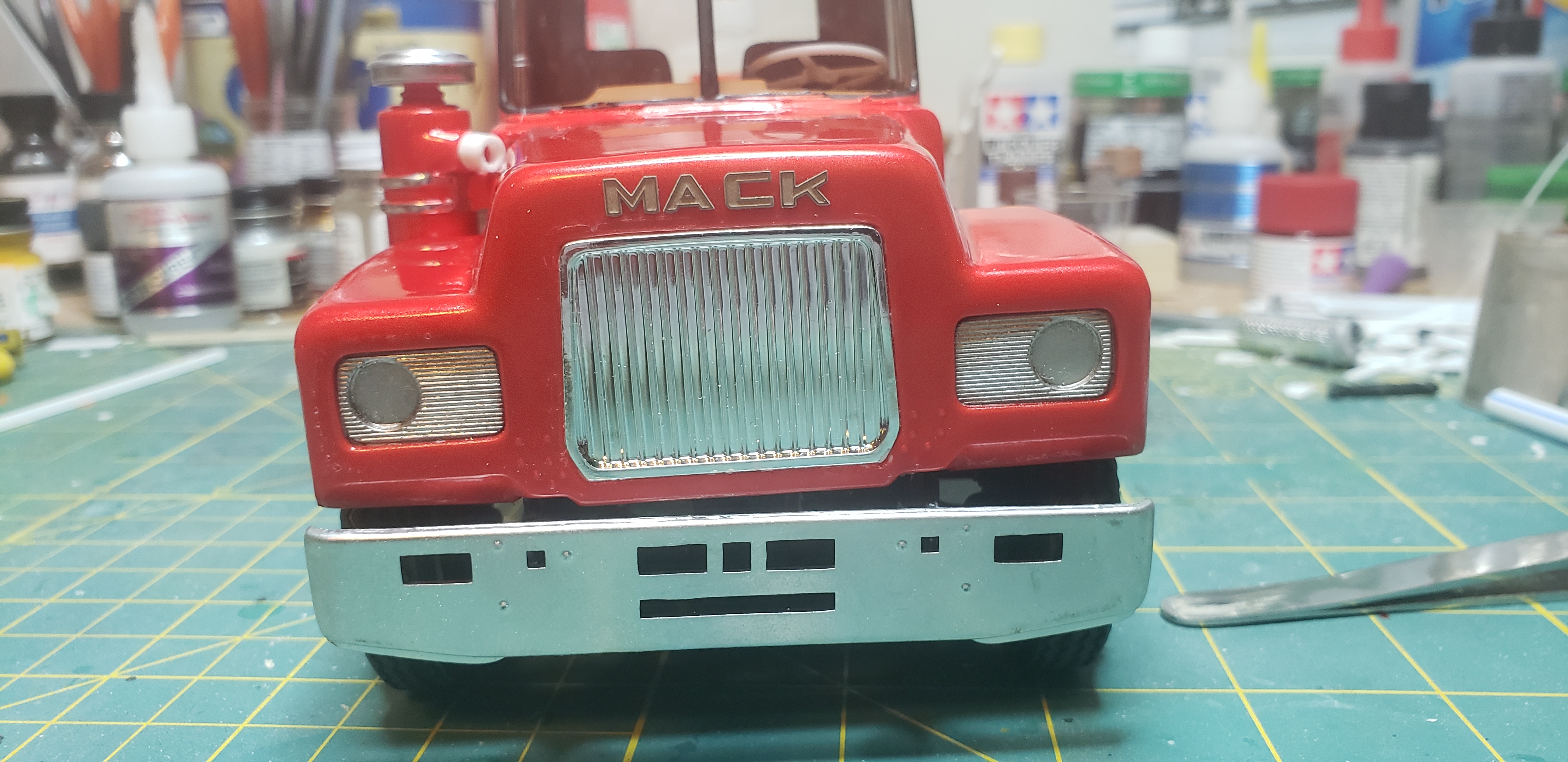

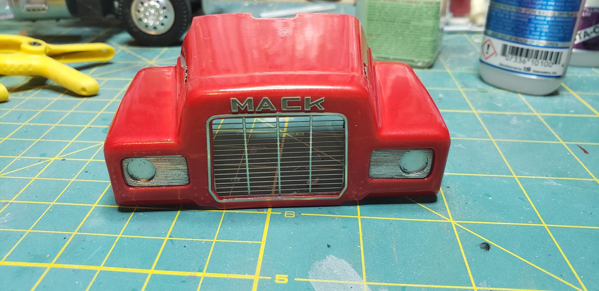

Thanks everyone!  How about a hood pic..I used the detail master pe grill set to replace the kit blob they sell as a grill

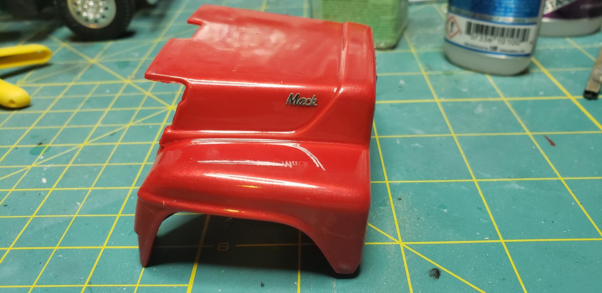

all the emblems are glued w future

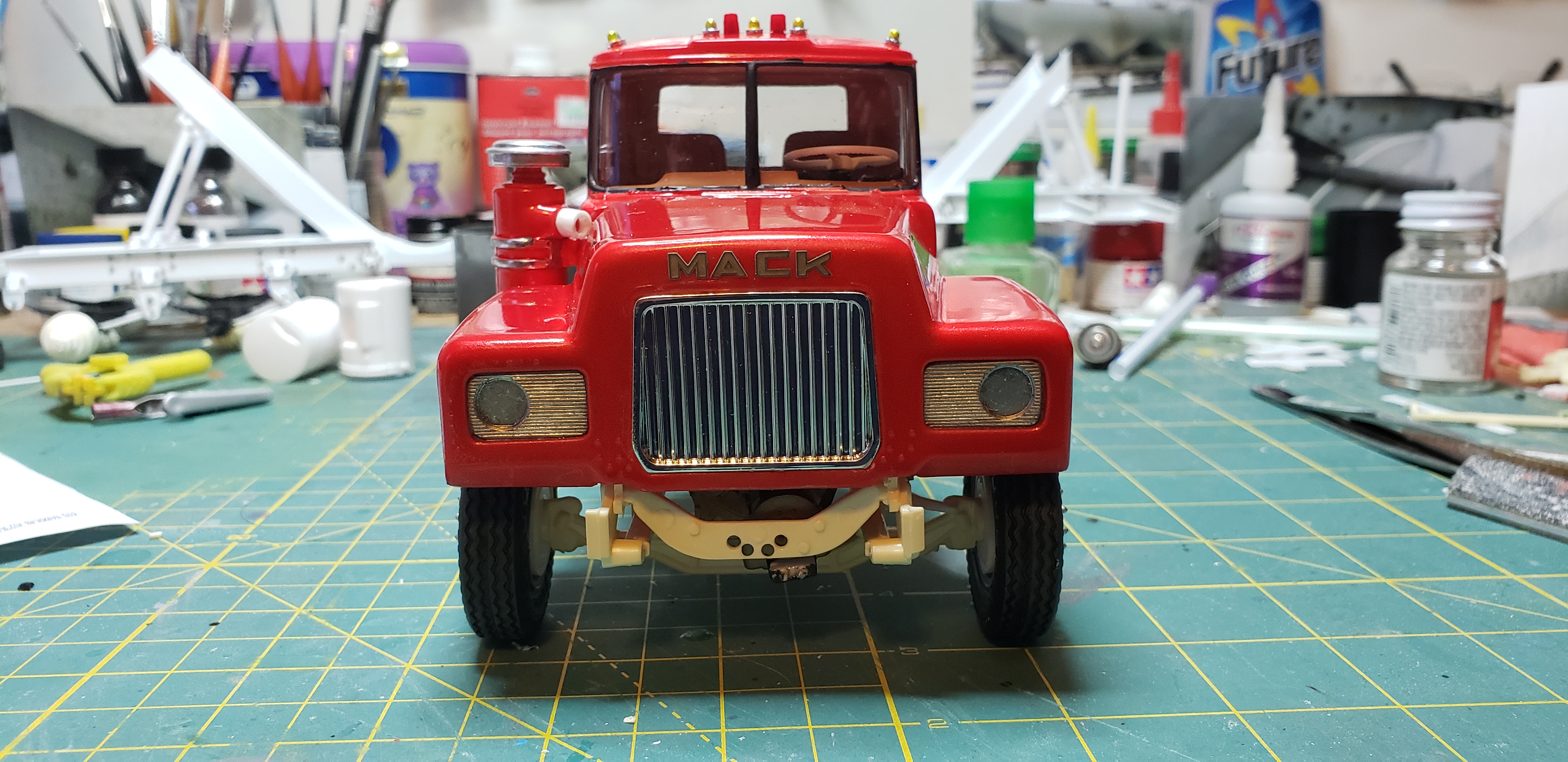

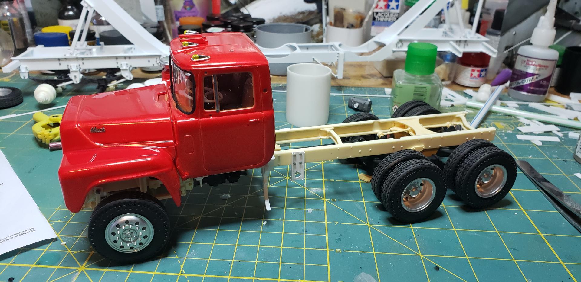

Well I hit a major issue...after mounting everything up , my cab and hood are seriously crooked. I noticed an issue after installing the hood w the etch grill..thinking it was my hinges I swapped the grill for the kit one..it didnt help
I popped the cab off the mounts , installed hood then remounted cab..now its sitting like this.20190305_184416.thumb.jpg.1f92c42b2daa5d2792985163144b31ee.jpg
the hoods in the holes , no idea why it's so wacky ..but decided I better revisit this project after cooling down.
I really considered myself a dog person..but lately I'm not sure..glad our Lab is loyal lol
Any suggestions to fix it are welcome , I think it's the new frame rails made from the same tree  lowes lumber comes from lol I might try using an older frame and drop the cab on it
It looked fine in your mock up the other week and all the wheels appear to be touching the "ground"?   The hood's obviously off to the bumper, so something's out of whack.   Have a break and come back to it with fresh eyes.
Well..its resolved.  I ended up mocking up a spare chassis and everything dropped in perfect.  Guess I tweaked the first chassis assembling it . Now a few more parts to install and the new frame will be ready for paint  !
My buddy tbill hooked me up with a few pics of a properly assembled truck, and I spotted my firewall wasnt tight against the cowl, a quick tweak had that sorted out ! Thanks tbill
And its sitting level on all the mounts now too bad I ruined the etch grill screwing with the other frame

Looks great!! Ashame u cant reuse the etch grille
Yeah that etch grill really looked sharp. Hardest part using the etch grill was attaching the hinges in correct spot since the holes were molded into plastic  grille.  It would take serious surgery to remove this one now. I made a spacer for the other ones before I found my alignment issues

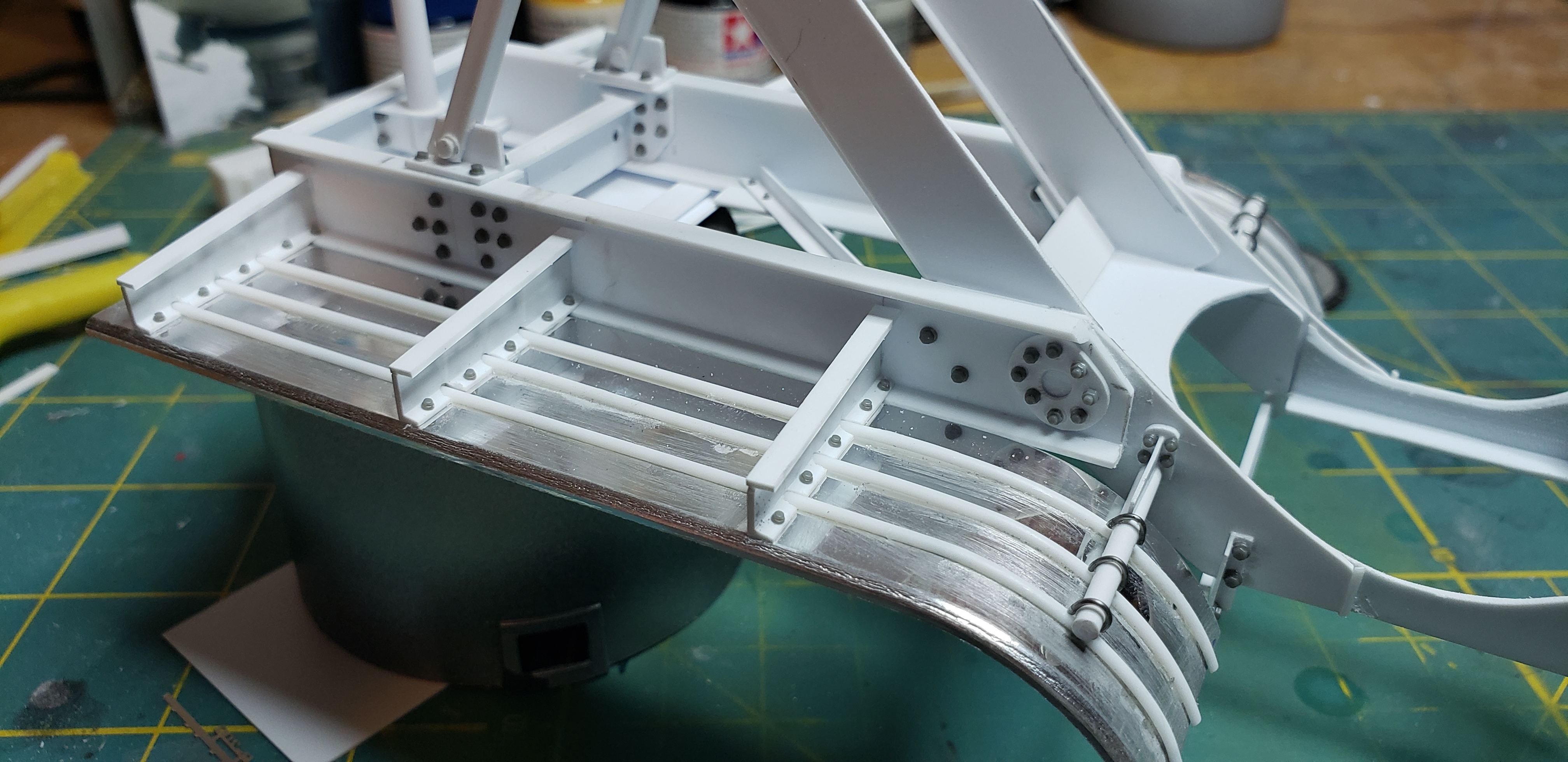

I puttered w the tanker while paint dried on my new chassis , detailed out the front fenders. Ribs from half round,  and small loops of solder replicate the u bolts seen on my reference.
The fenders came from Jamie at moluminum

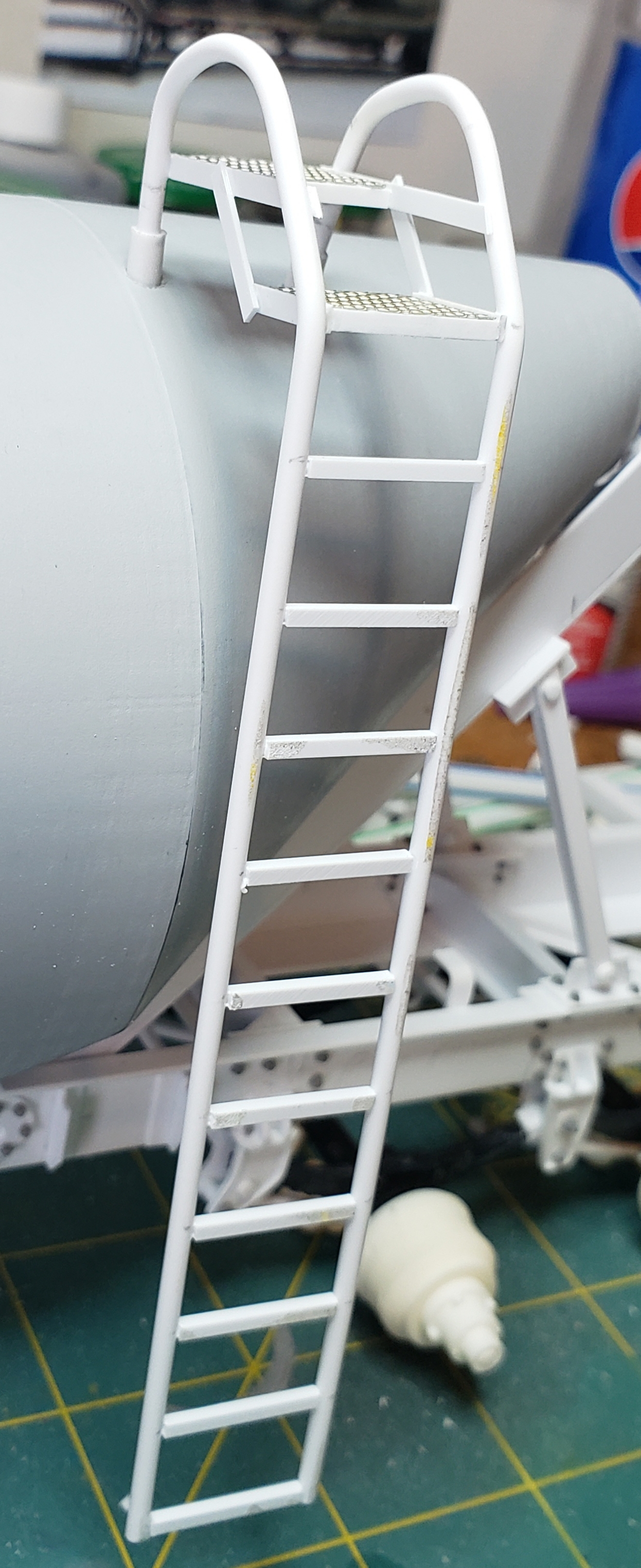

The ladder was extremely fun.  .080 rod w 060 steps . The top treads are perforated sheet ( gorgeous pattern) I bought from KFS .
20190314_170342.thumb.jpg.e87240948d695925f25f1c244a5ed4d4.jpg20190317_103218.thumb.jpg.5762dcac294b496811a95a5b09042afa.jpg

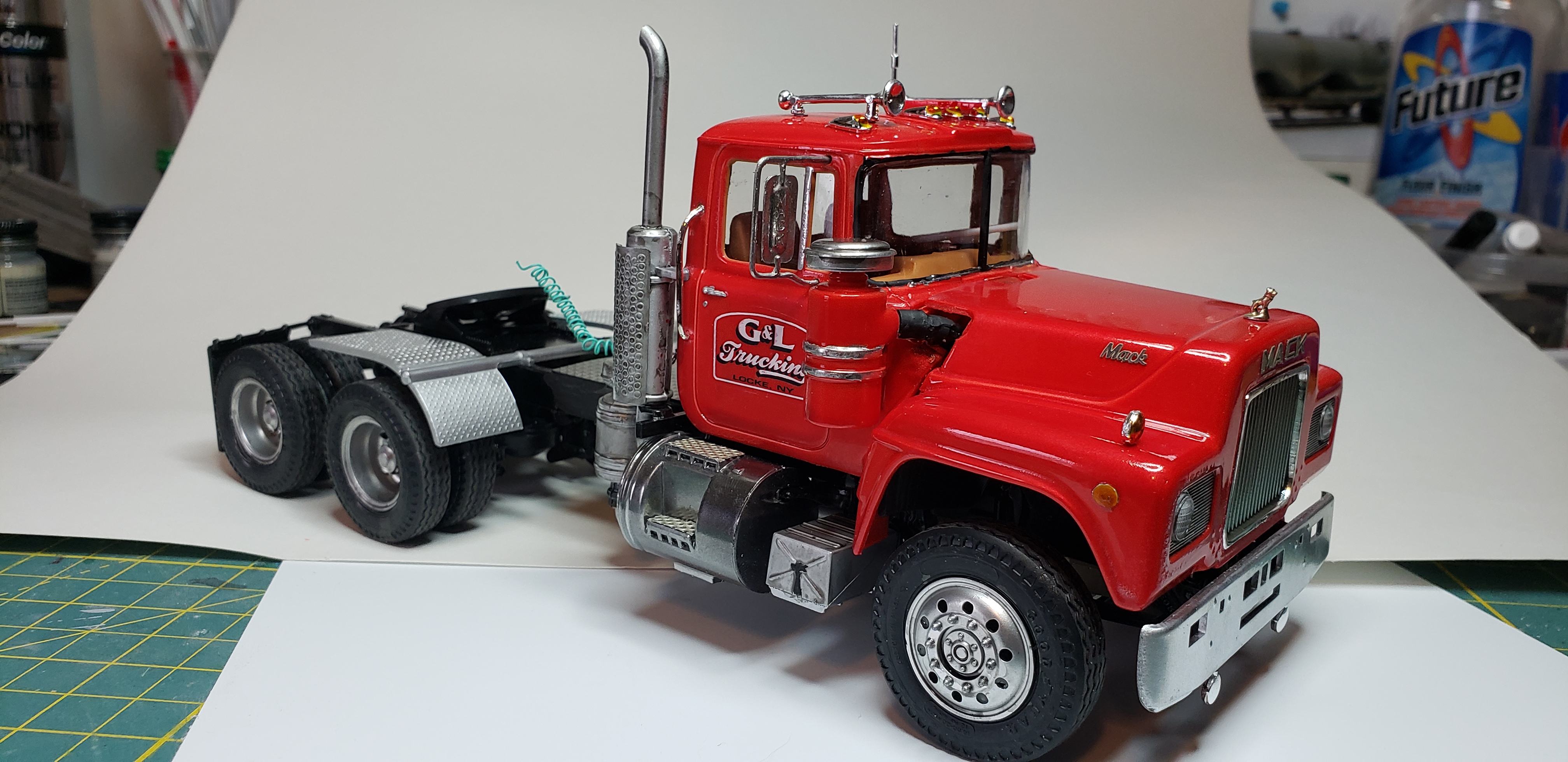

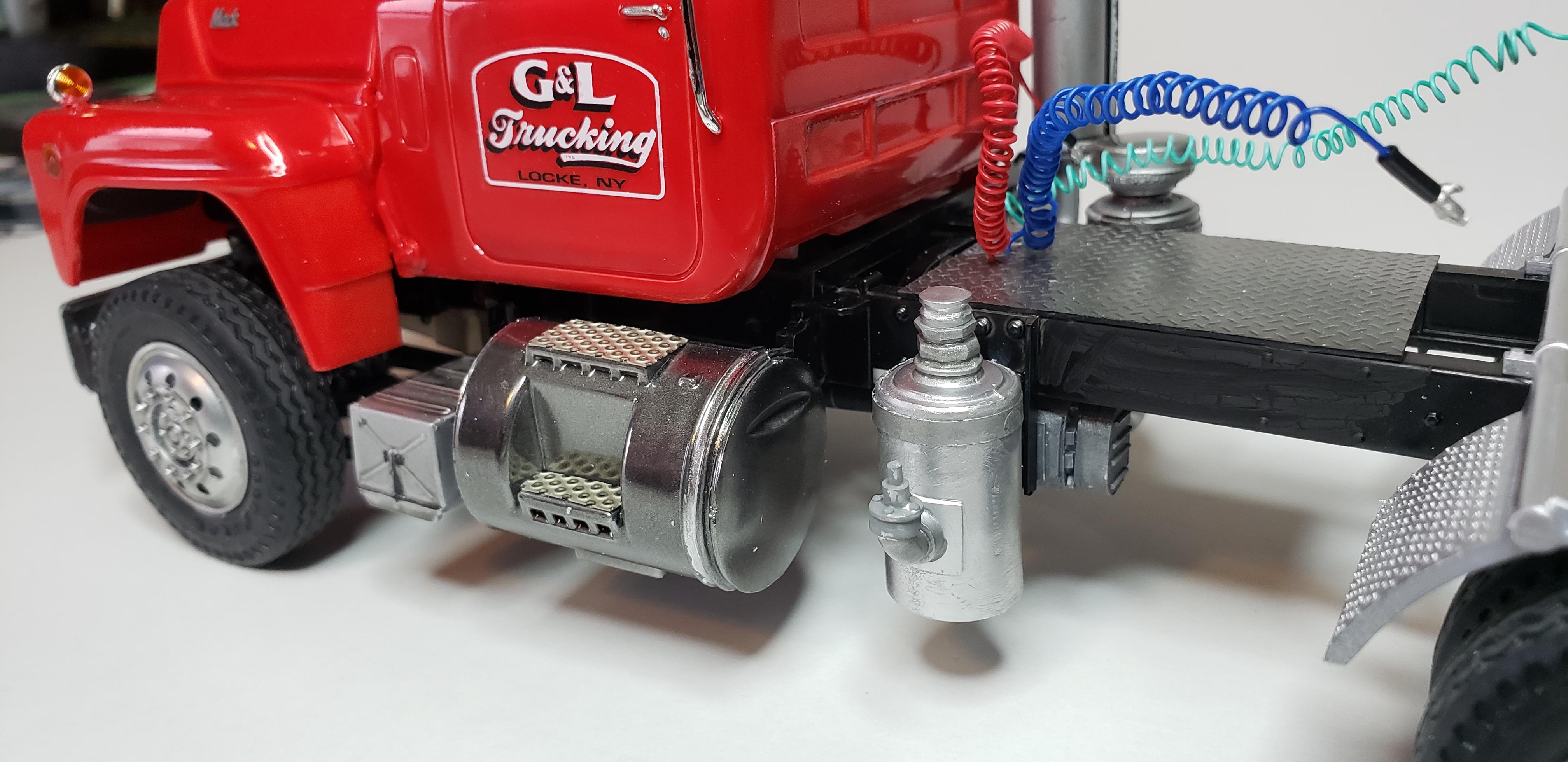

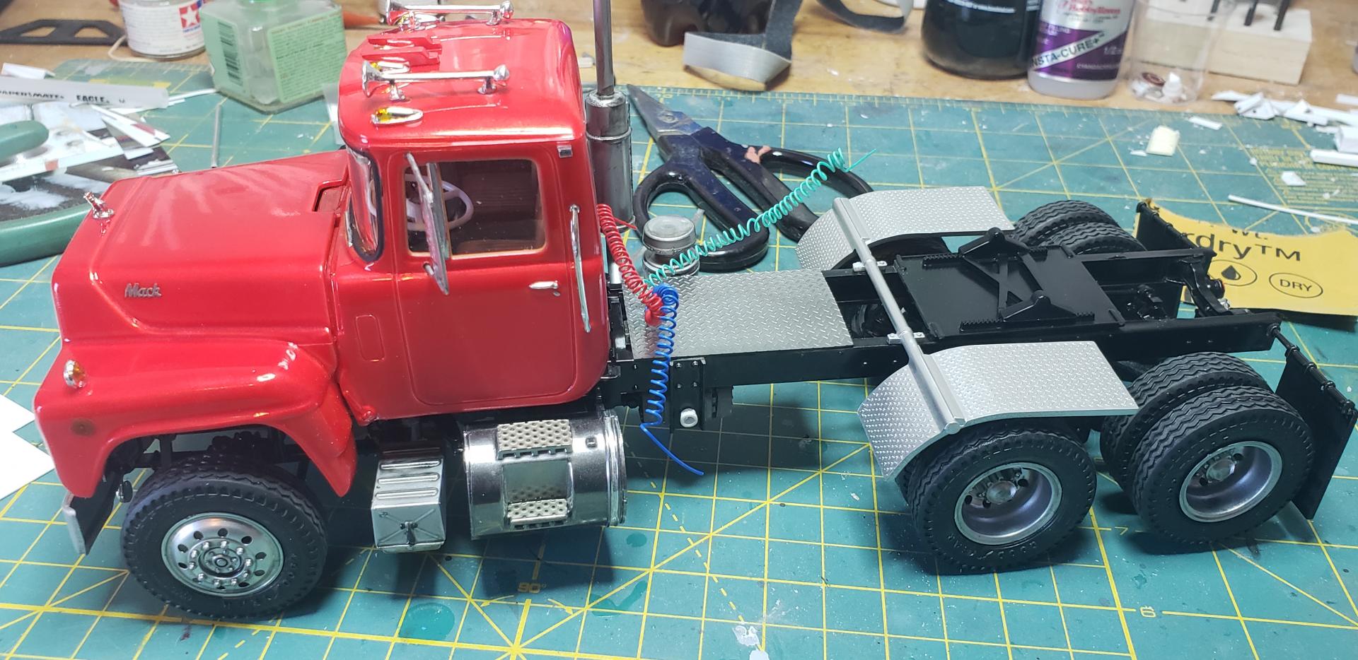

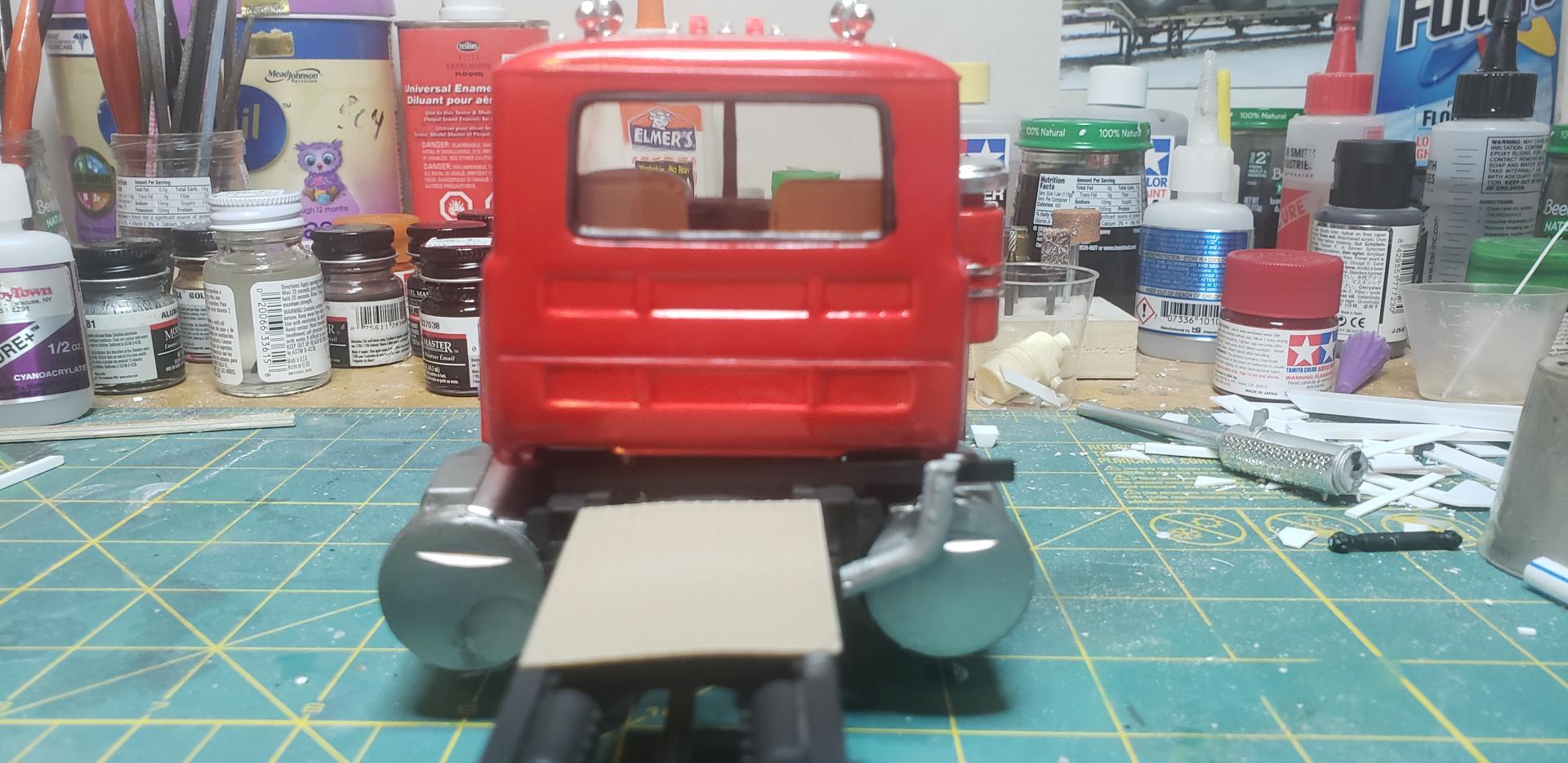

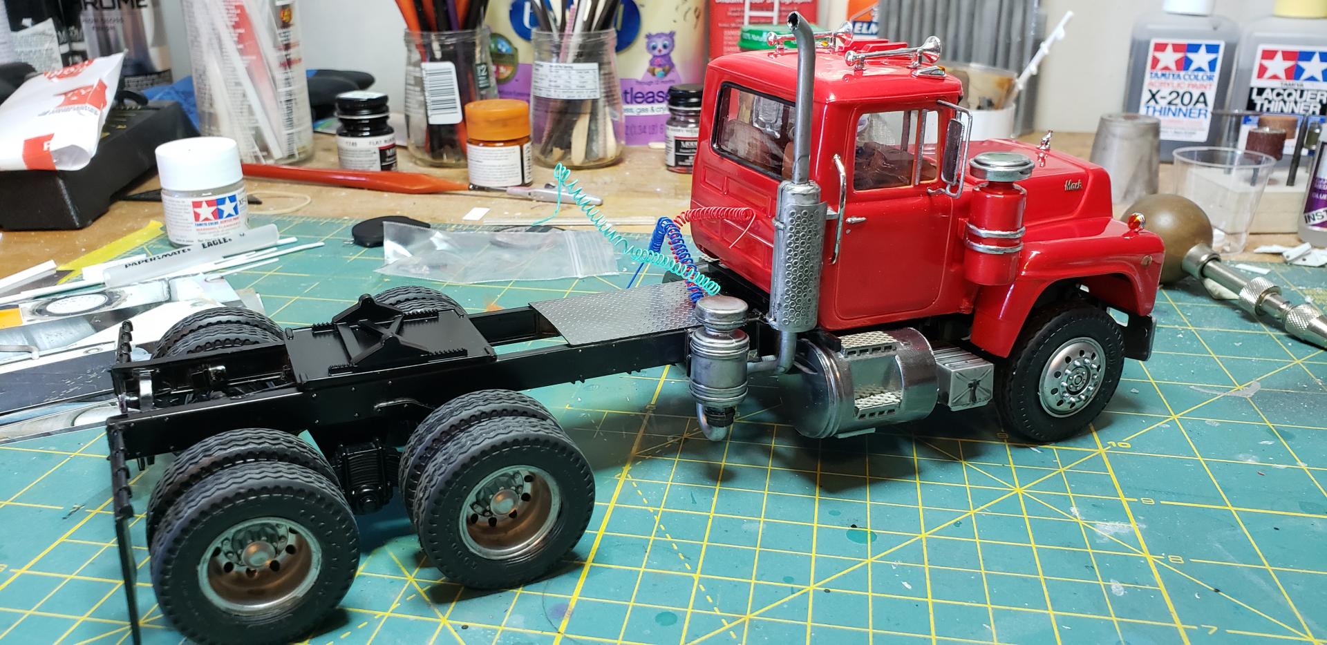

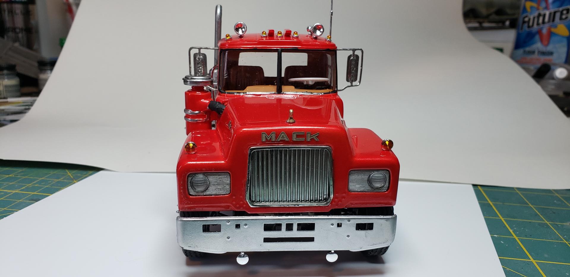

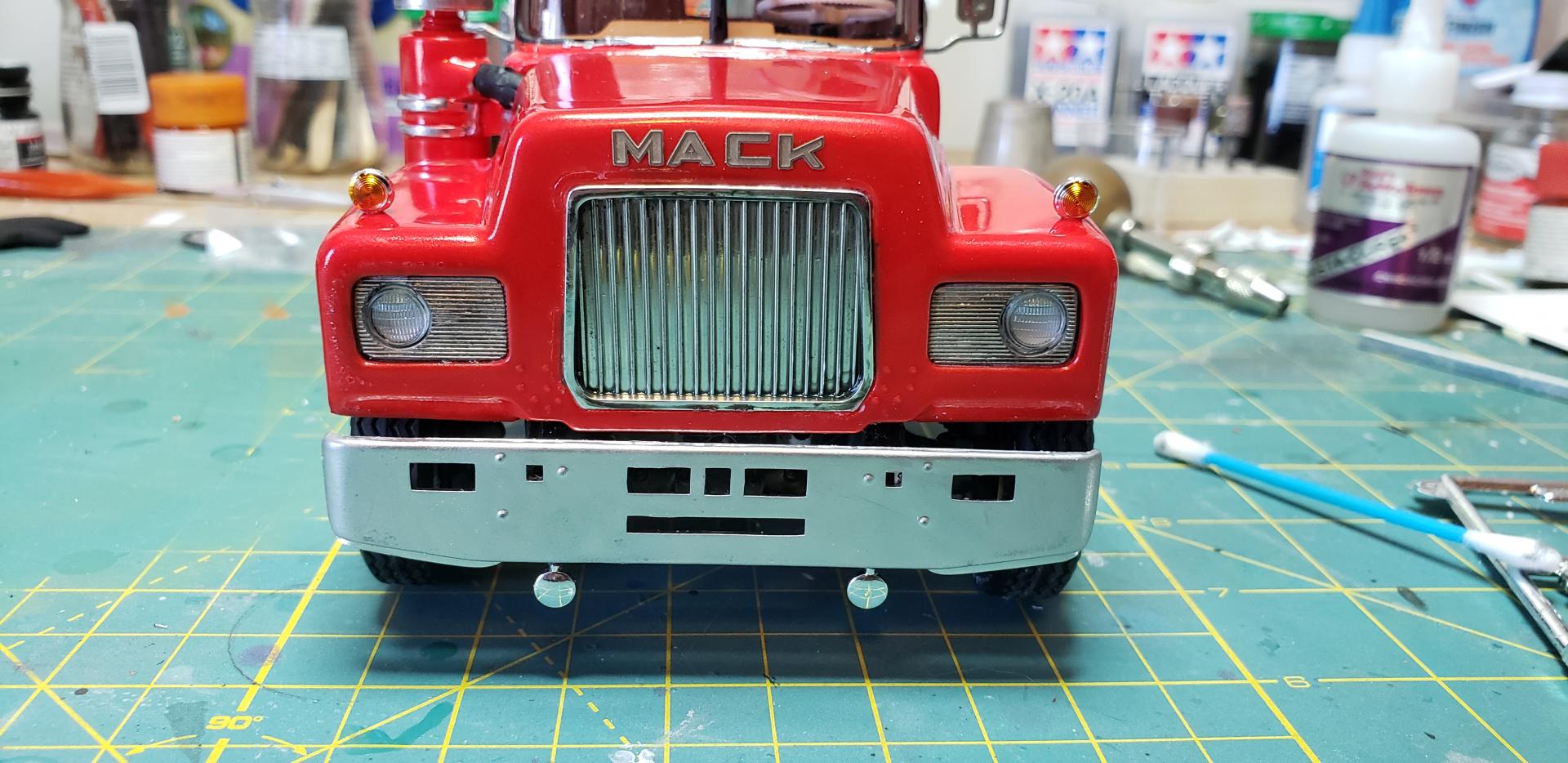

I finally got back into working on the Mack, and now its falling together.  I wanted to add a few personal touches , so I added a couple fog lights below bumper. Also what road tractor wouldn't have a CB antenna? I bummed one from the 4300 kit. The mount is just a scrap piece of angle mounted just above the drivers window .The fuel tank steps needed something , so scraps of perforated photoetch was attached . Lastly the exhaust stack was replaced w a curved top.

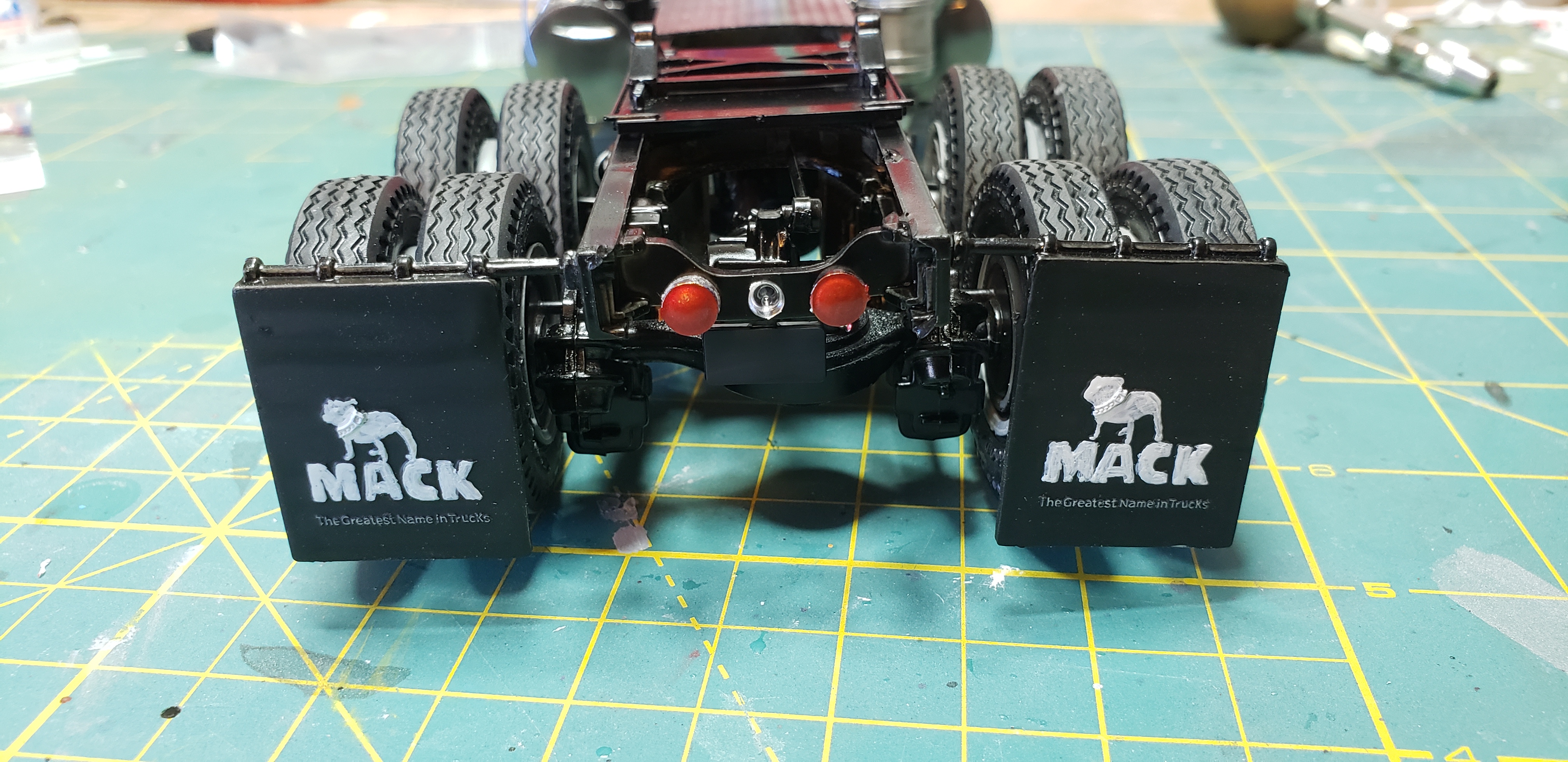

My fellow builders pointed out a large empty space behind the cab before the rear tandems,  a set of half fenders from the snap KW fit the bill..and will compliment the trailer fenders !
Enough gab enjoy the pics !

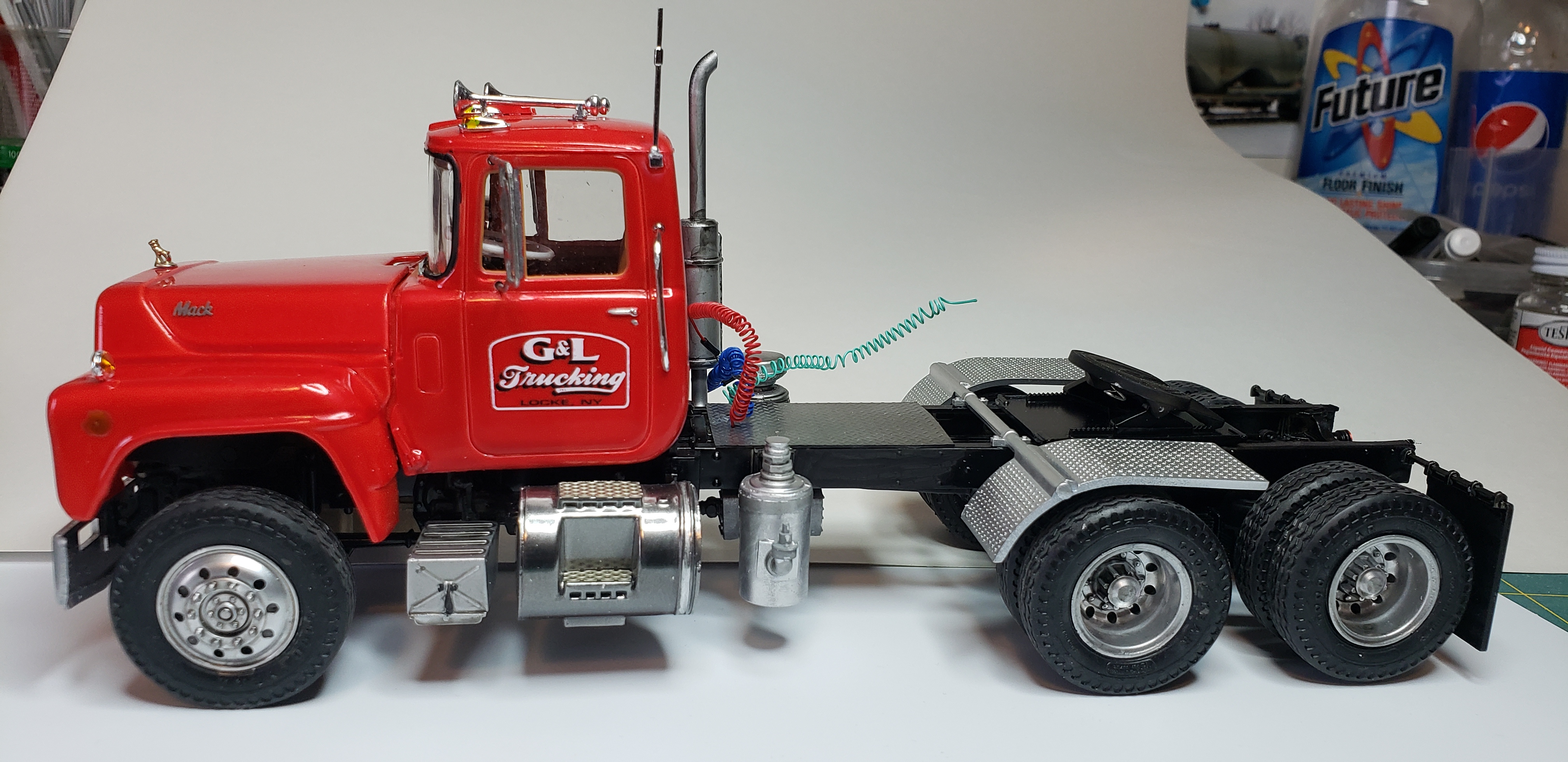

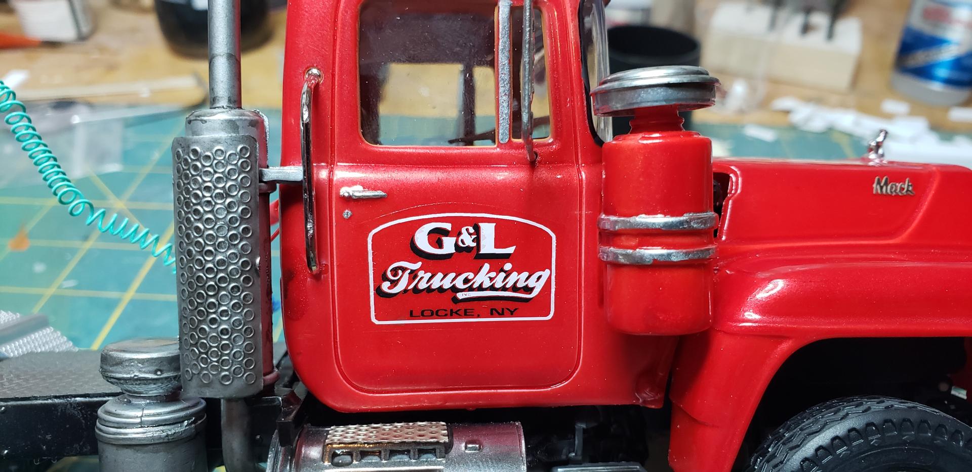

Back to the Mack, last night I added the door graphics custom made by Joe Shultz of diecast and decals , absolutely awesome work !! The decals are in perfect register and no bleed thru over the mica red..

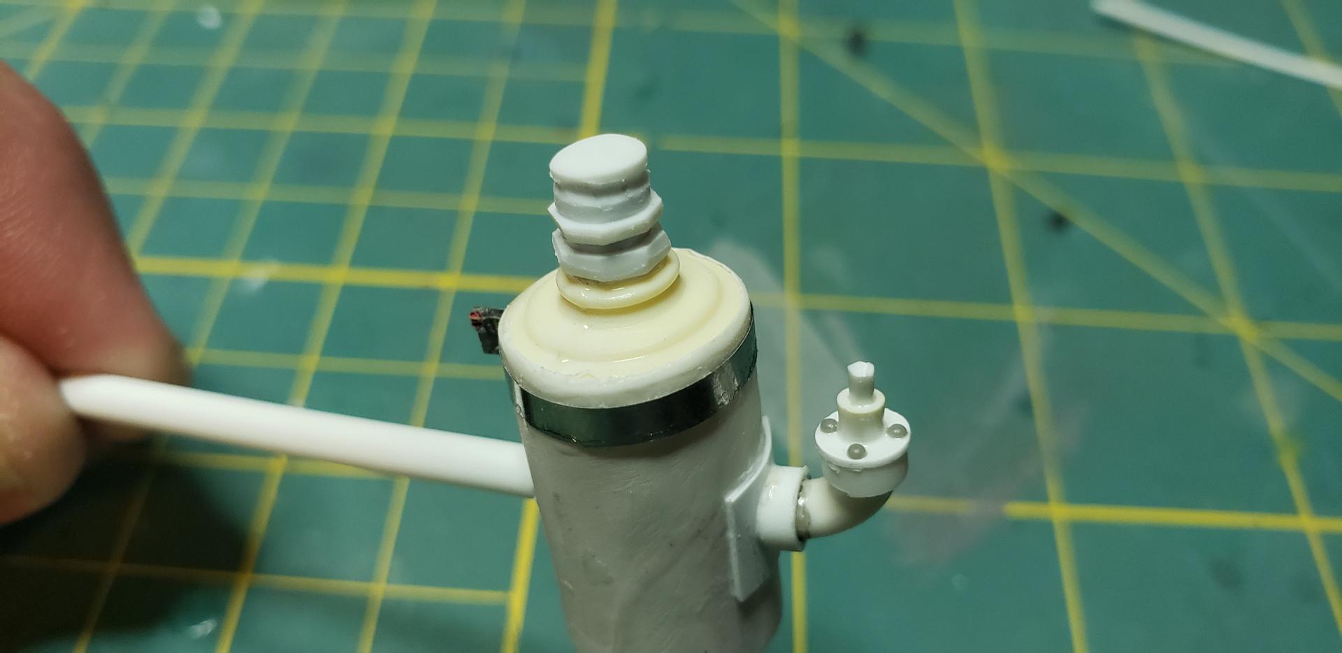

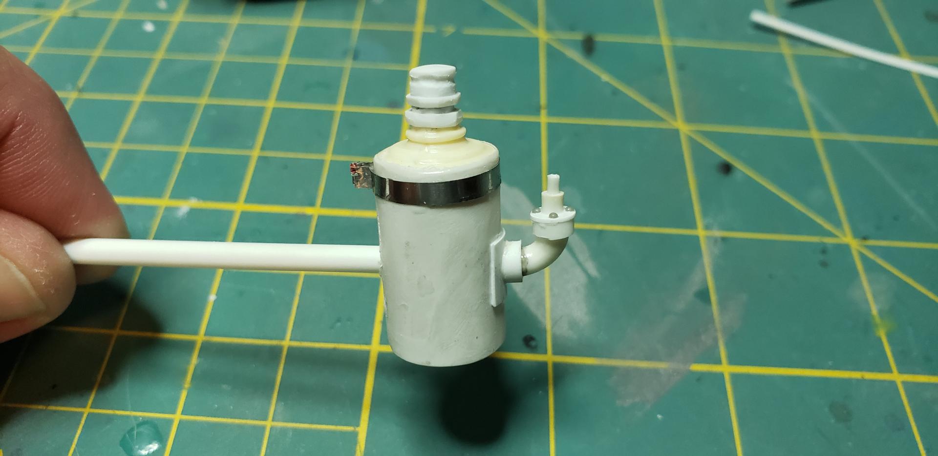

Last item on the list , ya cant have operate a pneumatic trailer without a blower  !
I used the large aux air tank chopped in half wrapped w 010 thou for tank body. The rest is odd bits added . The top hex pipe fittings were added , mounting strap, and it's off to paint

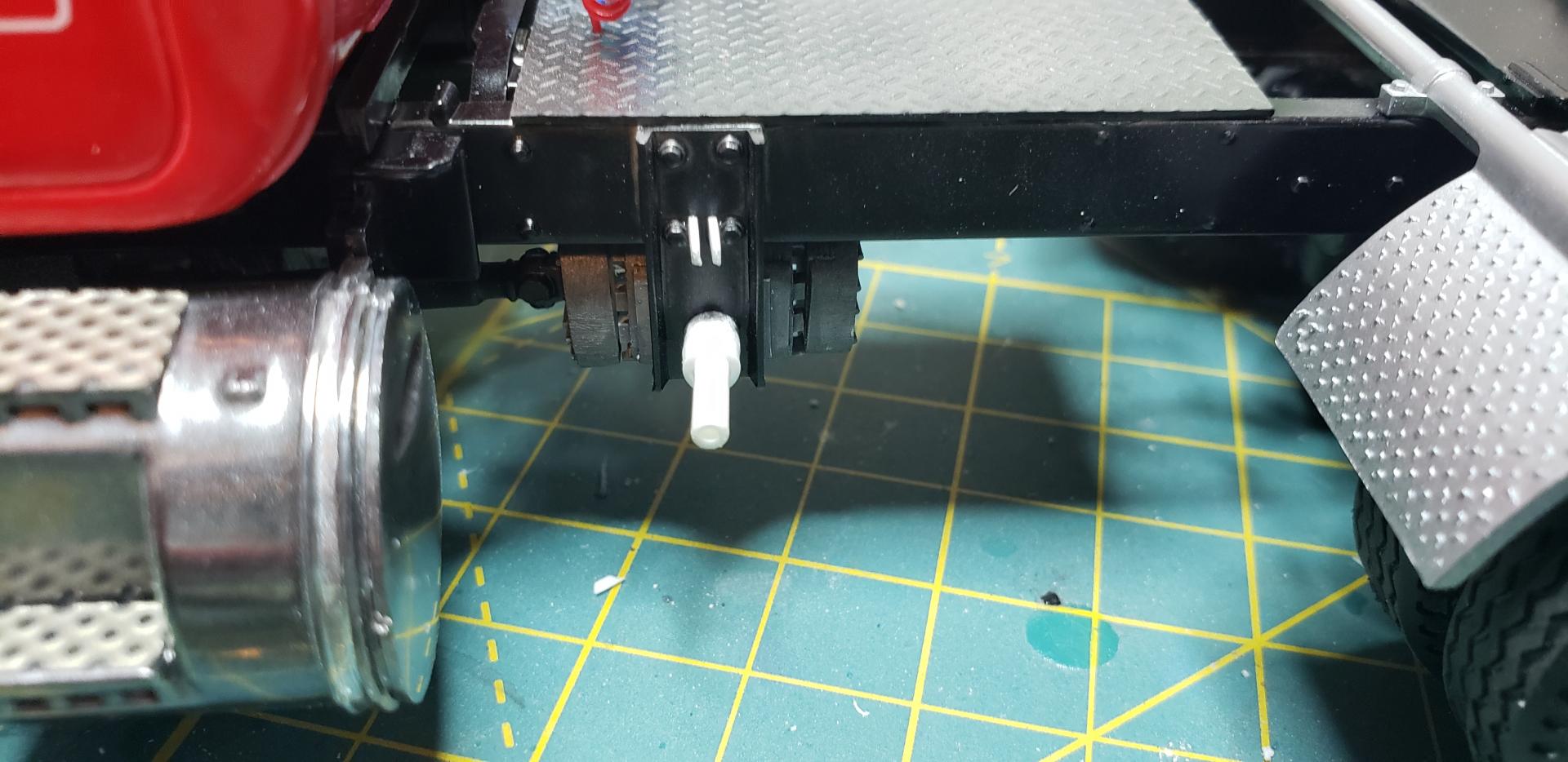

Heres its home, PTO drive w mount tabs ..

Well I'm calling this build finished ! I'll post better pics in glass once weather gets better

Changing the exhaust stack really looks better to me, probably not authentic but I prefer them.
