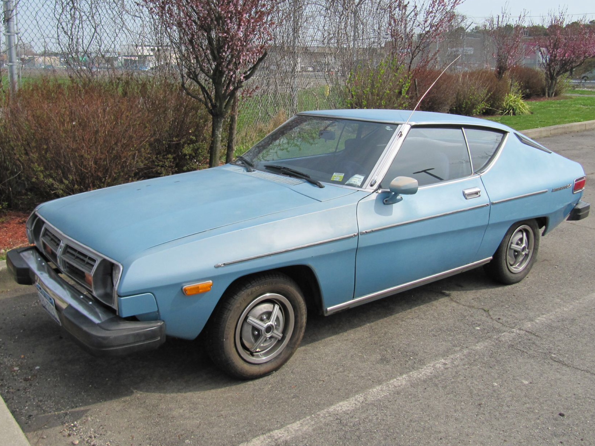

My dad bought this car brand new in 1977, I was nine years old. I remember going to the dealership with them.
I remember questioning why he wouldn’t buy the 280Z.  This car had a backseat, though it wasn’t much. As I grew, it became more difficult to climb back there. I was taller than anyone in my family. Eventually, he bought a 1990 Chevy Cavalier. I inherited the Datsun.  I drove it for about two years. Rust had taken over the car. It started to become unsafe to drive. It was a fast little car, it had the Nissan truck motor in it. It also had a five speed manual. I learned to drive a stick on that car.
 The dealer installed the stripes after purchase. They also gave him a set of upgraded hubcaps.

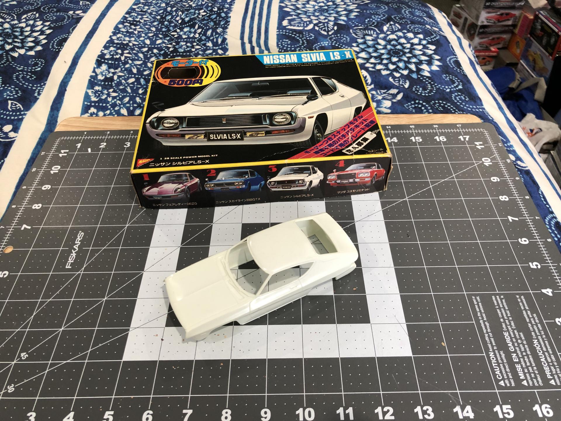

 The only plastic kits I ever found this car came from overseas. They are models of the Sylvia. That is the name of the same car in European configuration. To sell the car over here they had to add 5 mile an hour bumpers.  The front and rear bumpers are exactly the same.

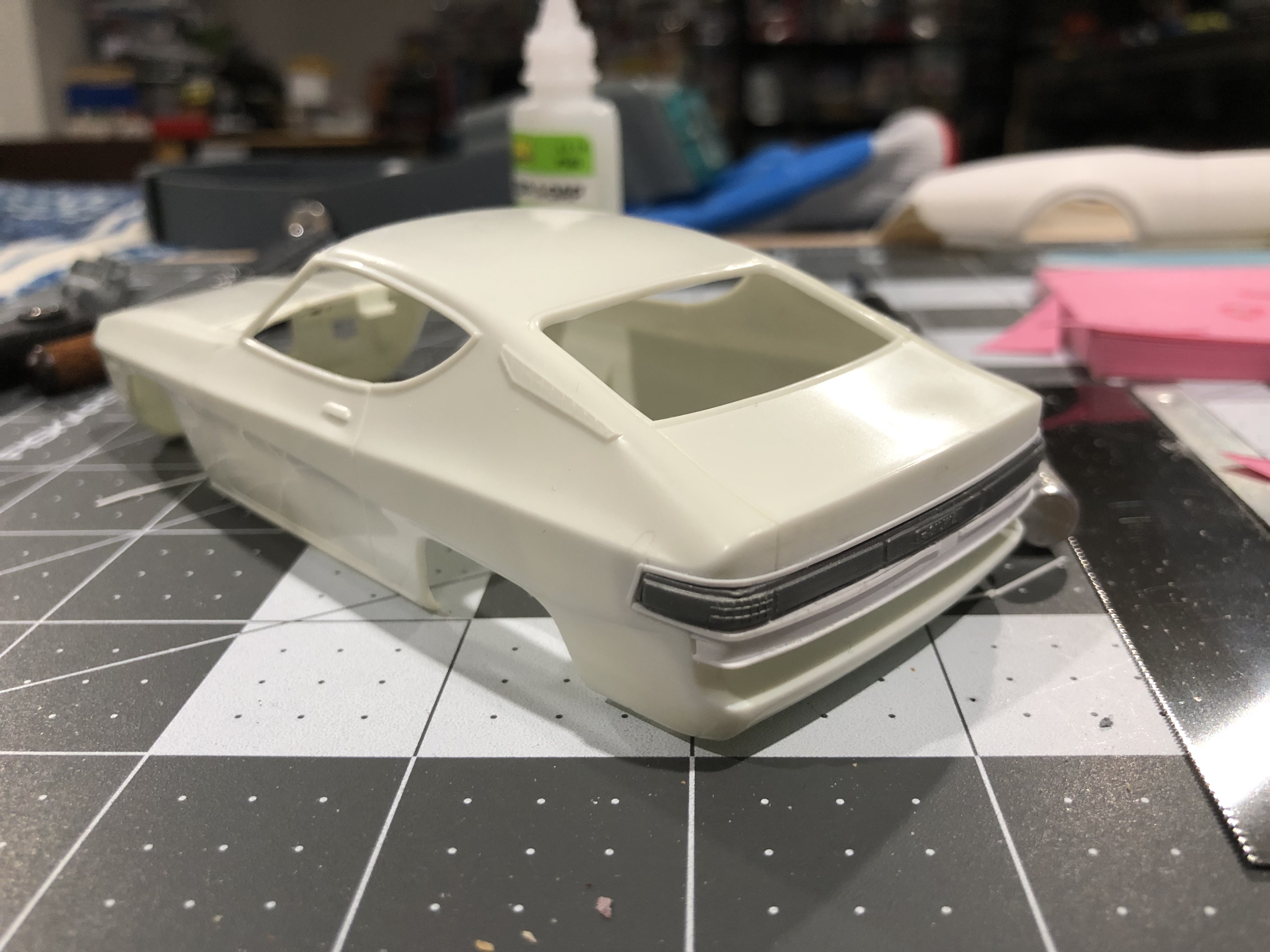

 I separated the taillight panel from the rear bumper and fabricated panel that goes in between the taillights and rear US bumper.
The hardest part will be trying to create the new grill below.

If you're still on this project, or are bogged down by scratch building a '77 front end, it shouldn't be too difficult if you use photo etch railing from railroad or ship for the grill. Shop carefully or seek advice from railroaders about what size you need. I was able to shop a perfectly scaled grill PE from a well stocked hobby shop where I could visualize the size/shape I needed for a project.
