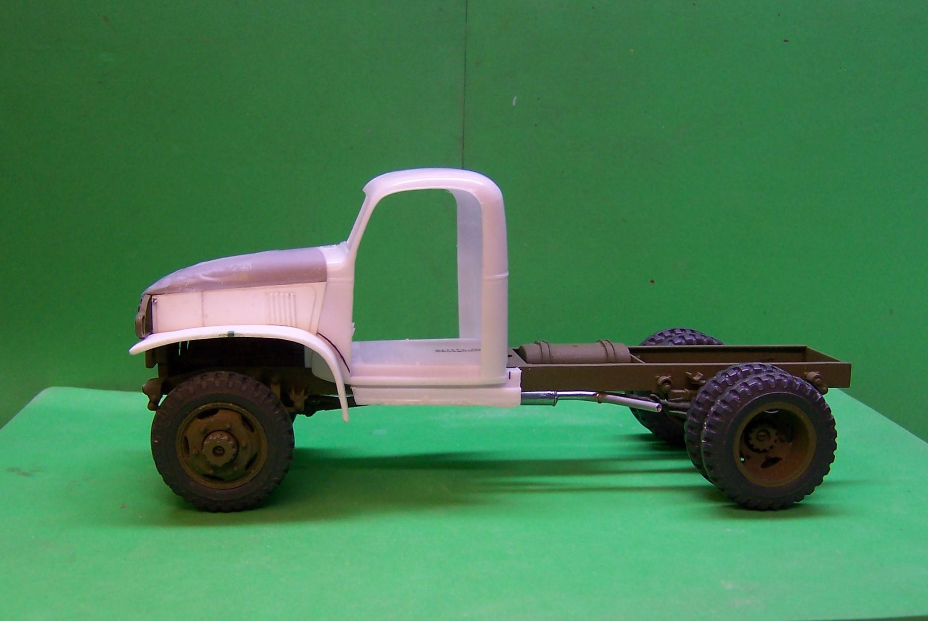

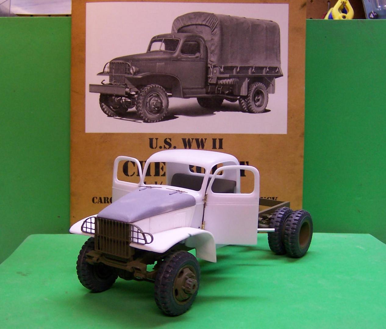

Chariots of Fire Posted September 2, 2019 Posted September 2, 2019 16 hours ago, Bucky said: This is how I do it, too. But, go slowly, as the Exacto blade might have a tendency to jump out of the panel line and leave a scratch where you don't want it. (I learned that the hard way.) Yes, slowly is the secret. A new sharp blade is best and many, many passes over the same area until you are through is best. I had good results cutting open the doors on a '41 Chevy pickup but it was tedious work, that is for sure.
