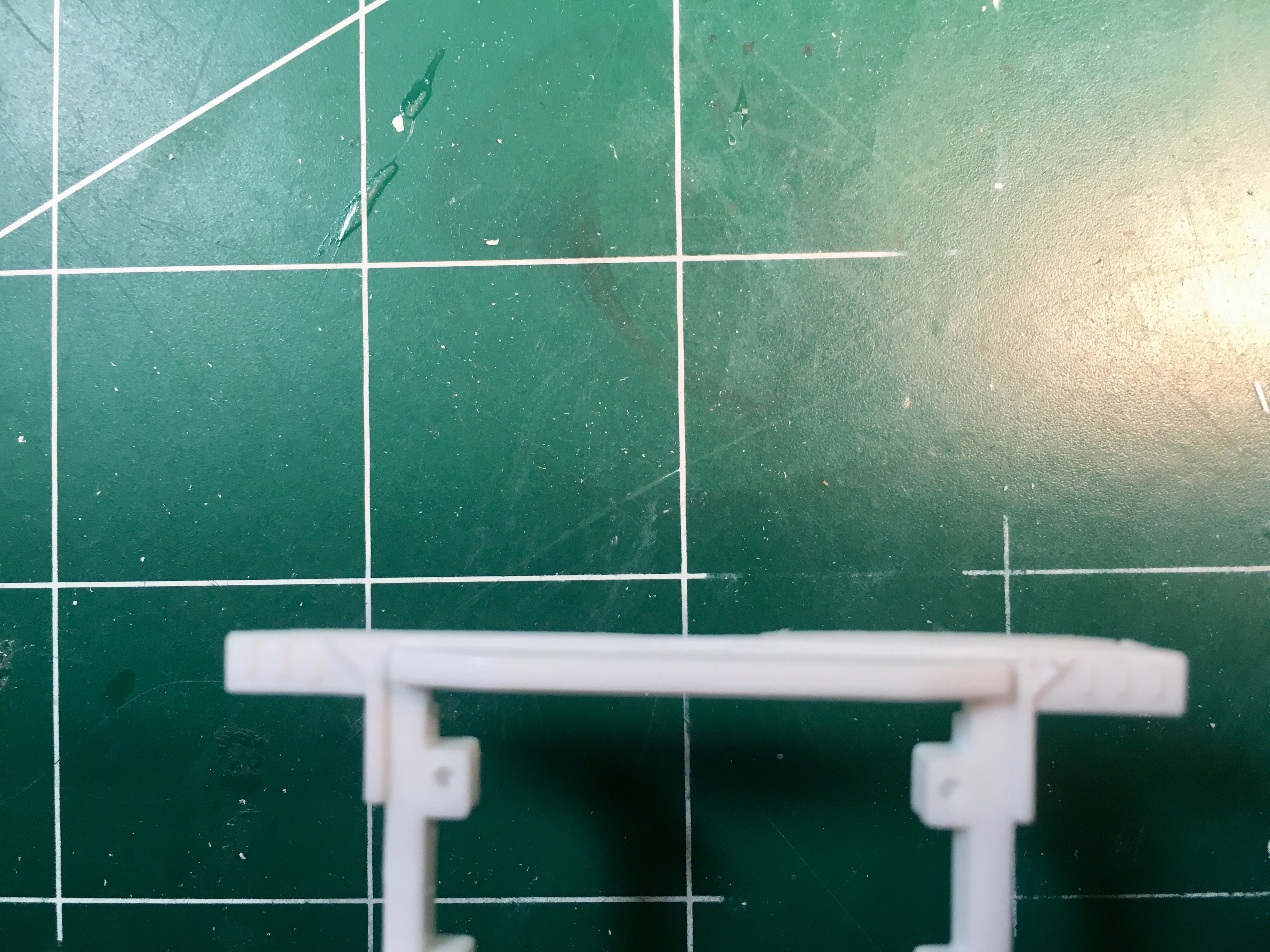

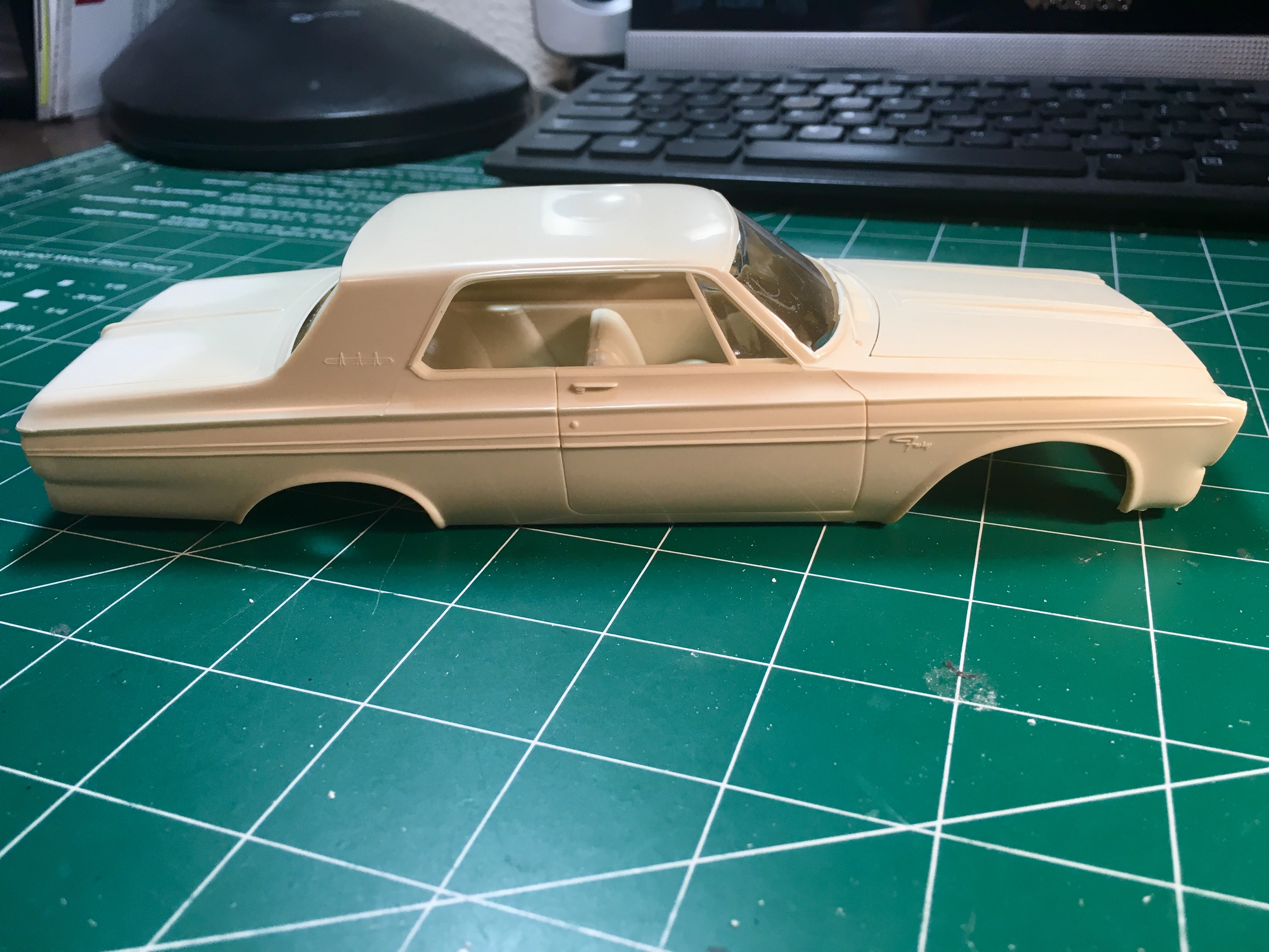

Brutalform Posted April 25, 2019 Posted April 25, 2019 I’ve built a few later 60 cars, but I really would like to add a few of the early Max Wedge 413 and 426 cars. My back problems have kept me from the bench lately, but I’ve been messing around the last two days. Ive started on this JoHan 63 Fury, but I also have a JoHan 62 Dart 440, and I am also waiting on two resin cars to be delivered from MCW. I ordered a 1962 Plymouth Savoy sedan, and a 1963 Dodge 330 sedan from MCW. These two will have the fender well headers also. They should be arriving any day now. I plan on using the Lindberg 64 Color Me Gone kit for the chassis, suspension, and engines. All cars will also have Fireball Modelworks rims/ wheels. Here are a few pics of the Fury, that I started last night.

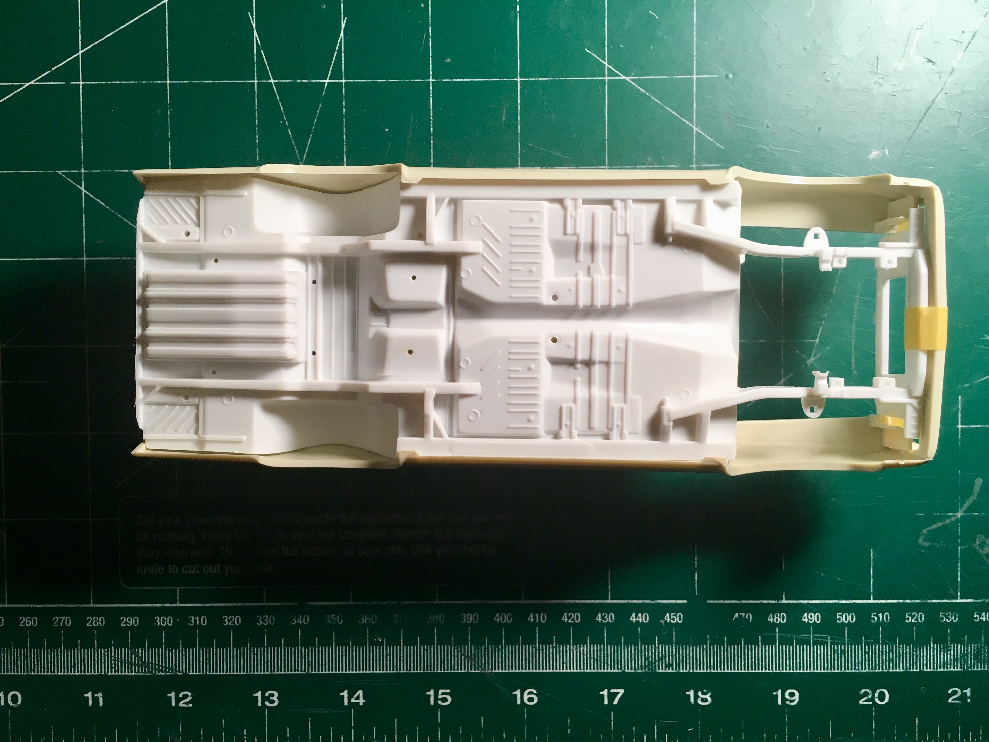

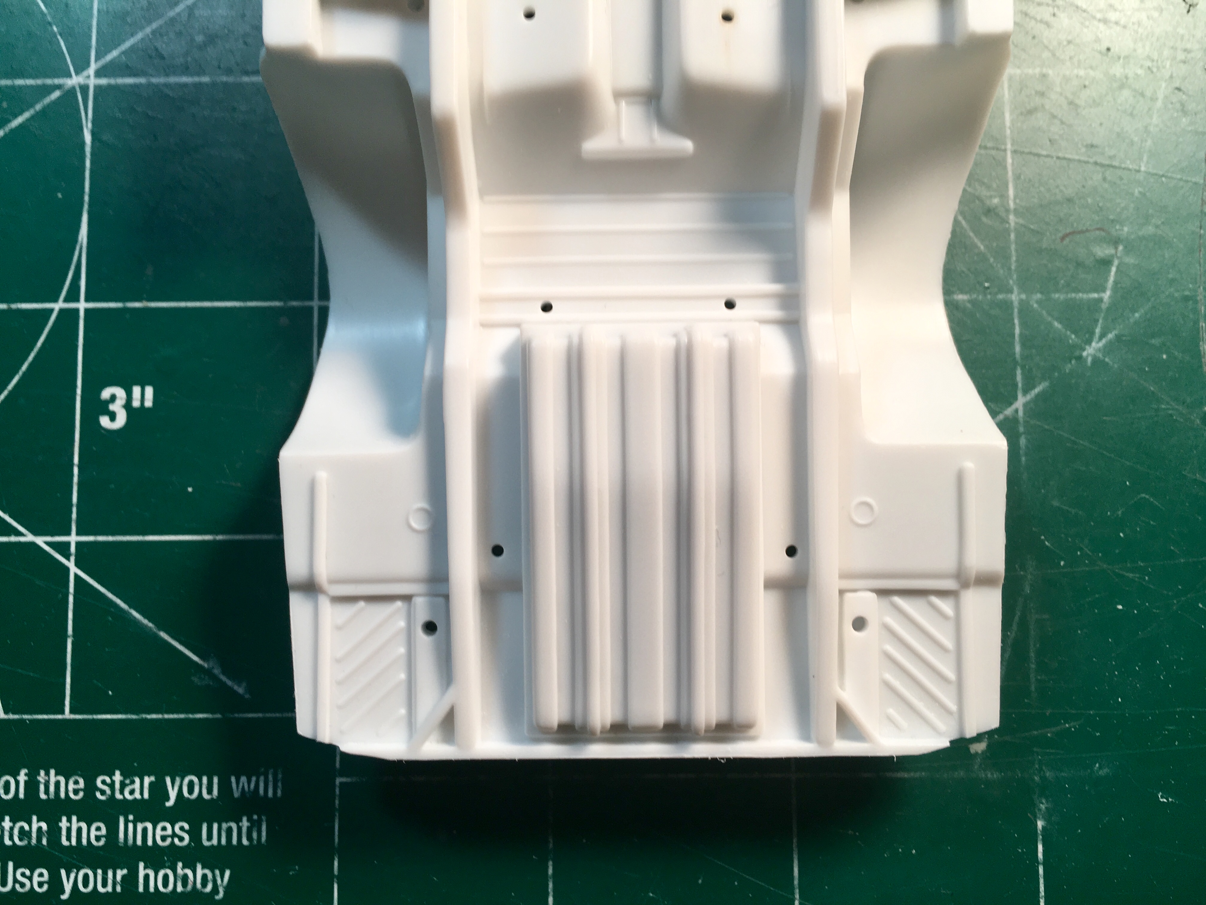

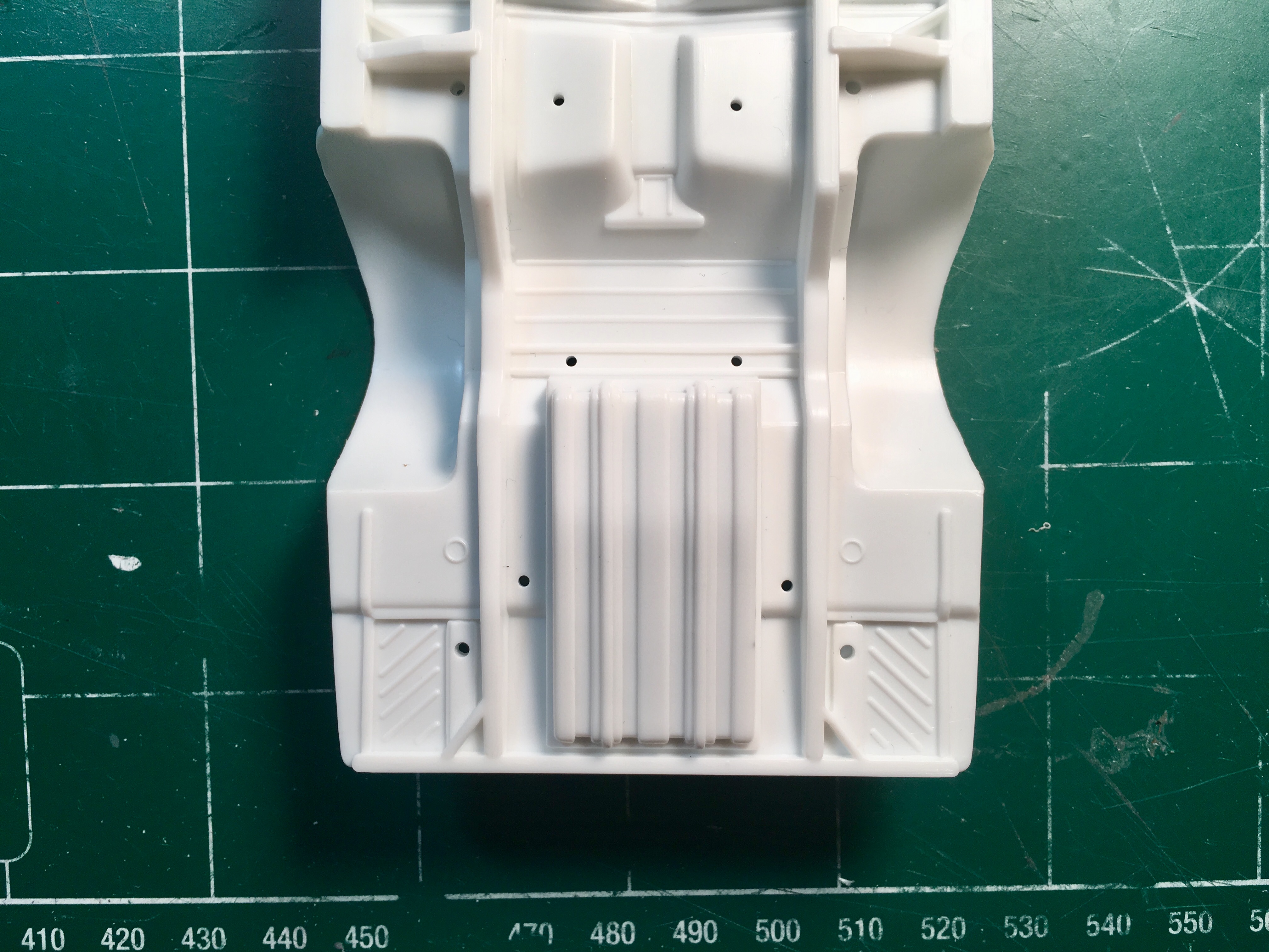

Brutalform Posted April 25, 2019 Author Posted April 25, 2019 (edited) First was getting the floor pan to fit into the JoHan body. Just a little trimming at each end was all that was needed. The cut off ends will be sanded smooth before painting. Edited April 26, 2019 by Brutalform
Brutalform Posted April 25, 2019 Author Posted April 25, 2019 Will still have to assemble the front and rear suspension to make sure the wheels are in the right spots and centered within the wheel wells. Looks good so far.

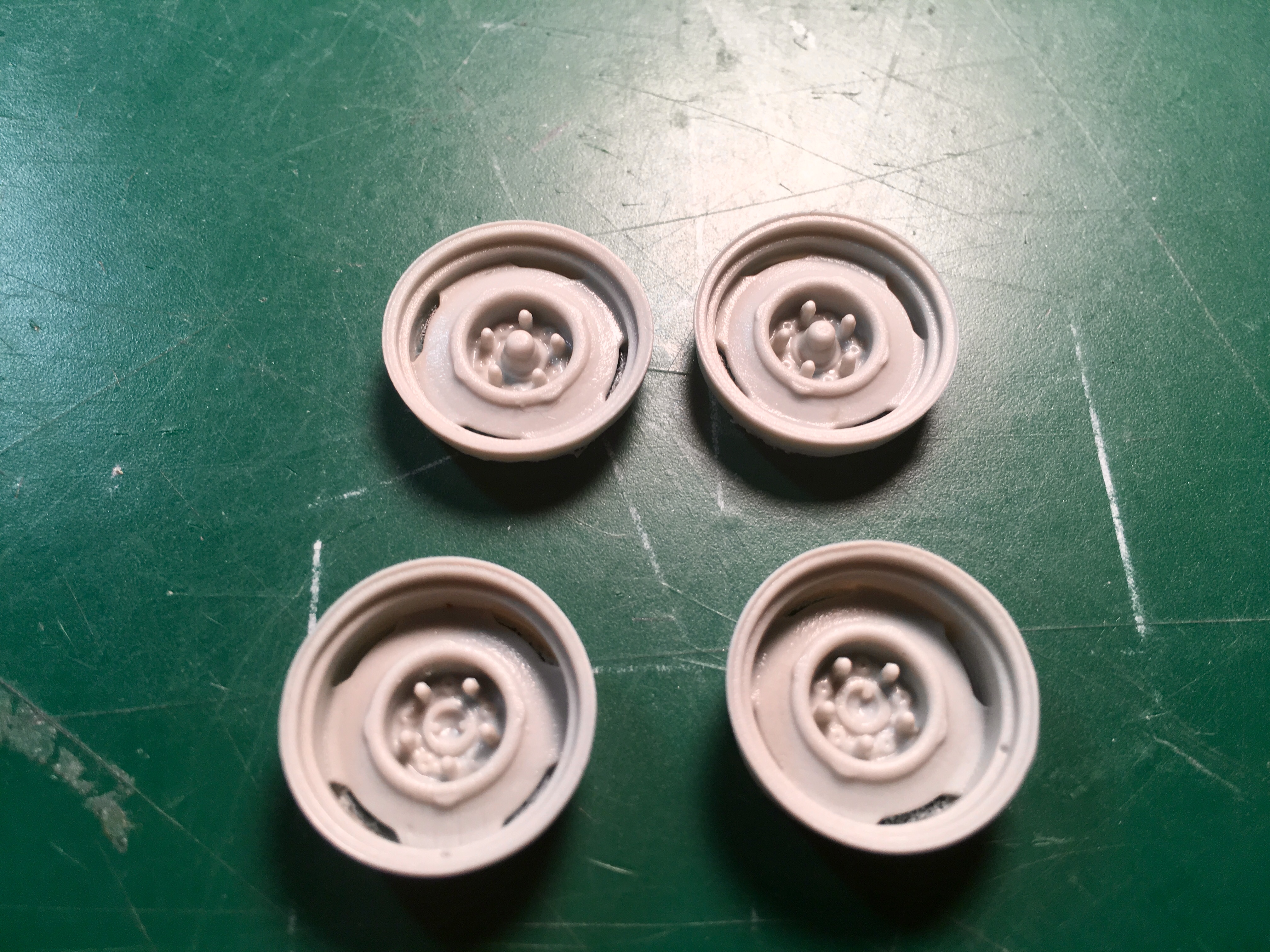

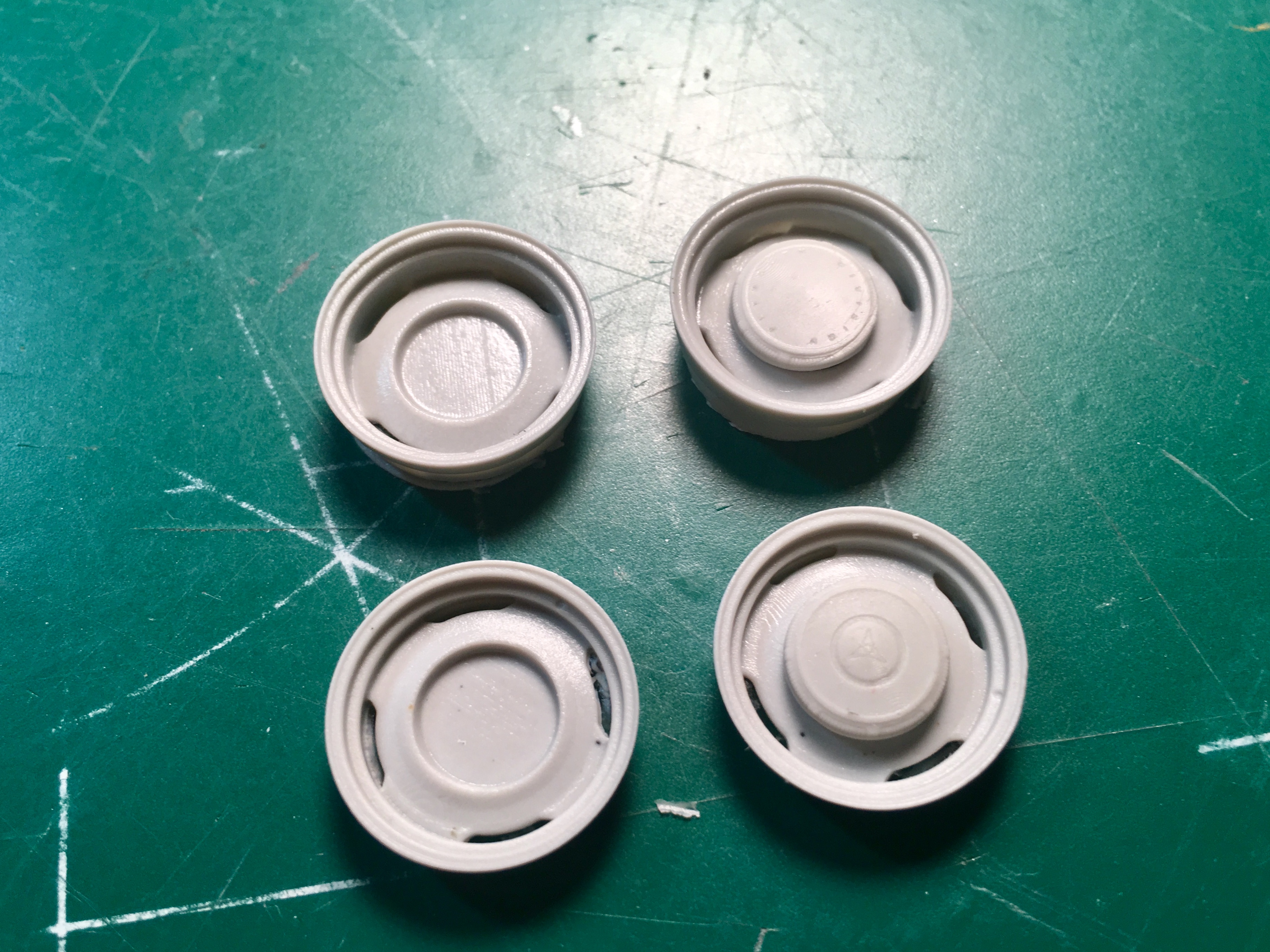

Brutalform Posted April 25, 2019 Author Posted April 25, 2019 Not totally sure if this car will have the dog dish wheels, or the plain steel rims?

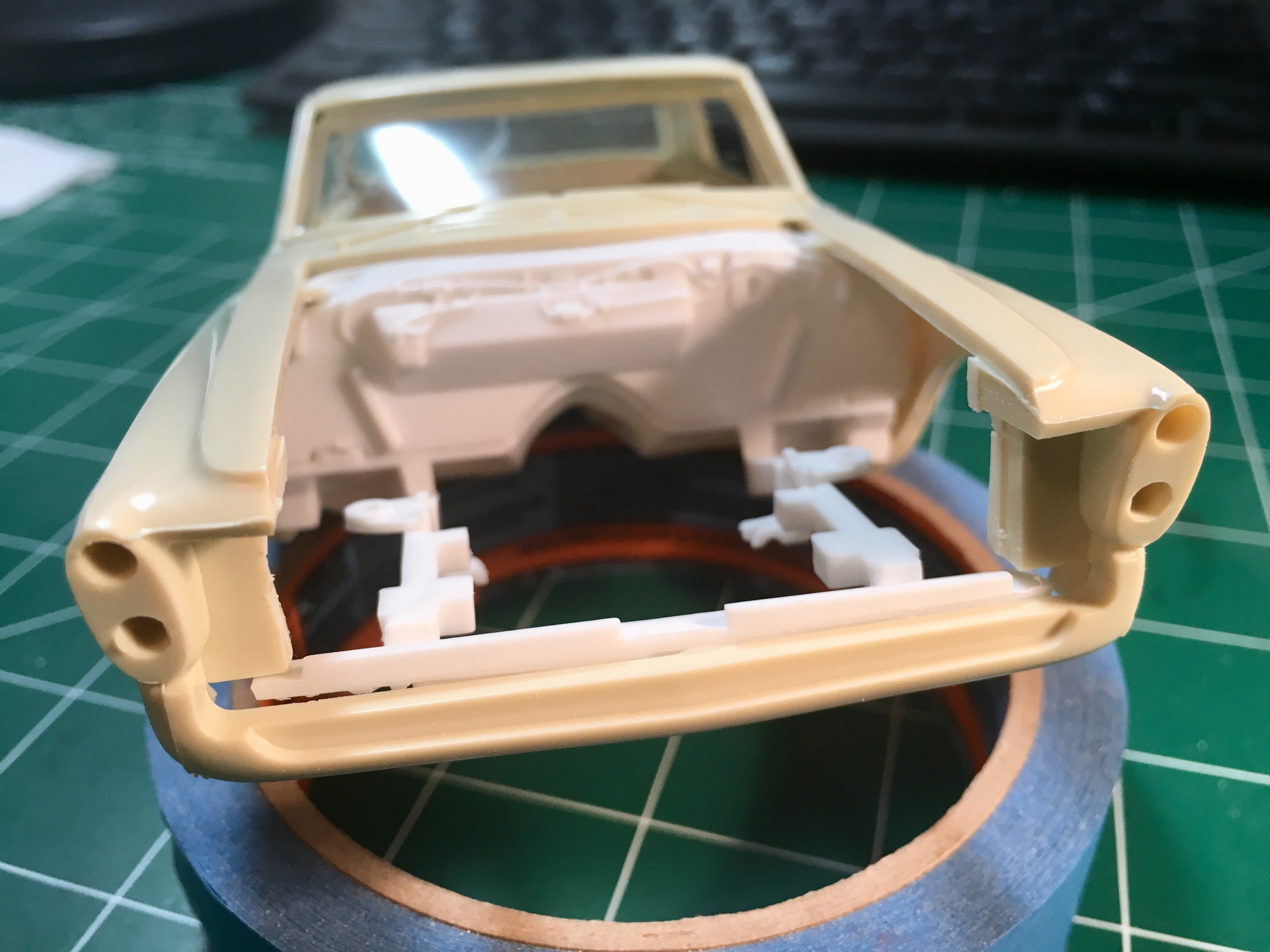

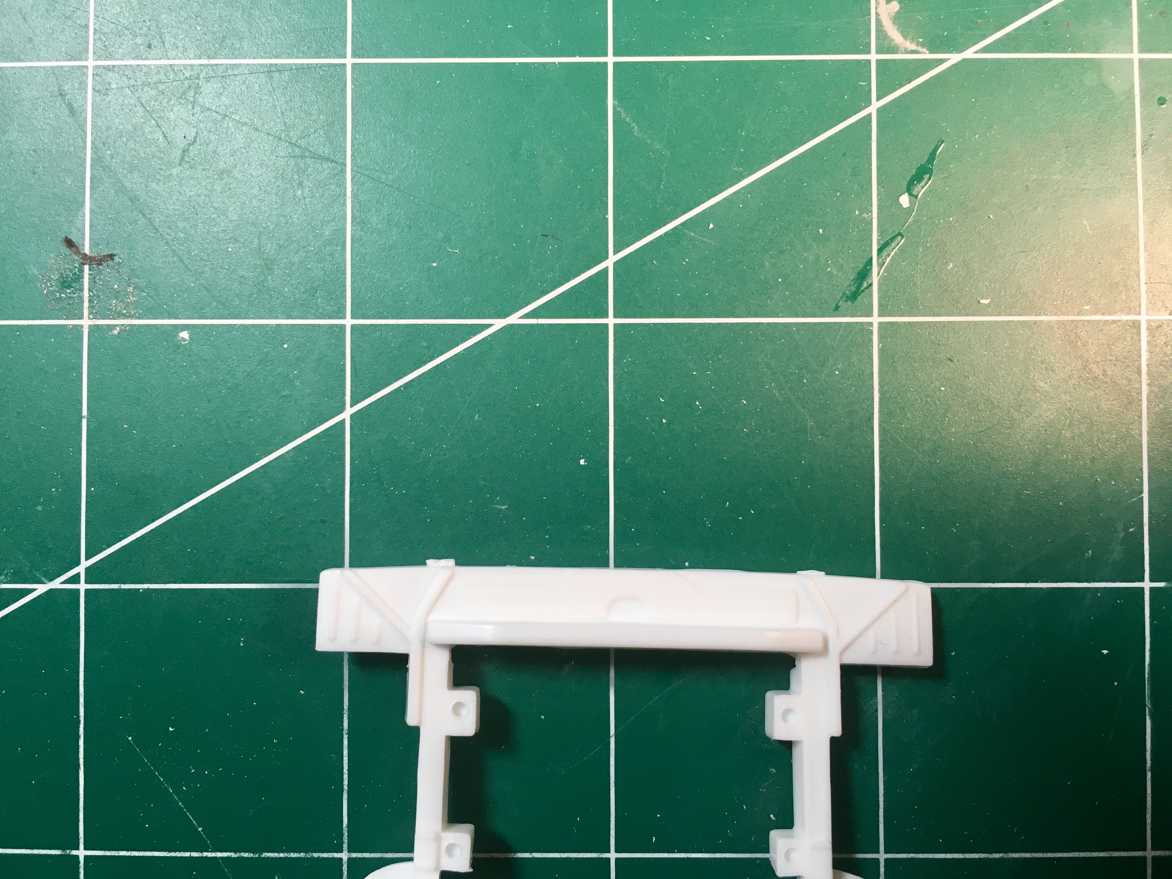

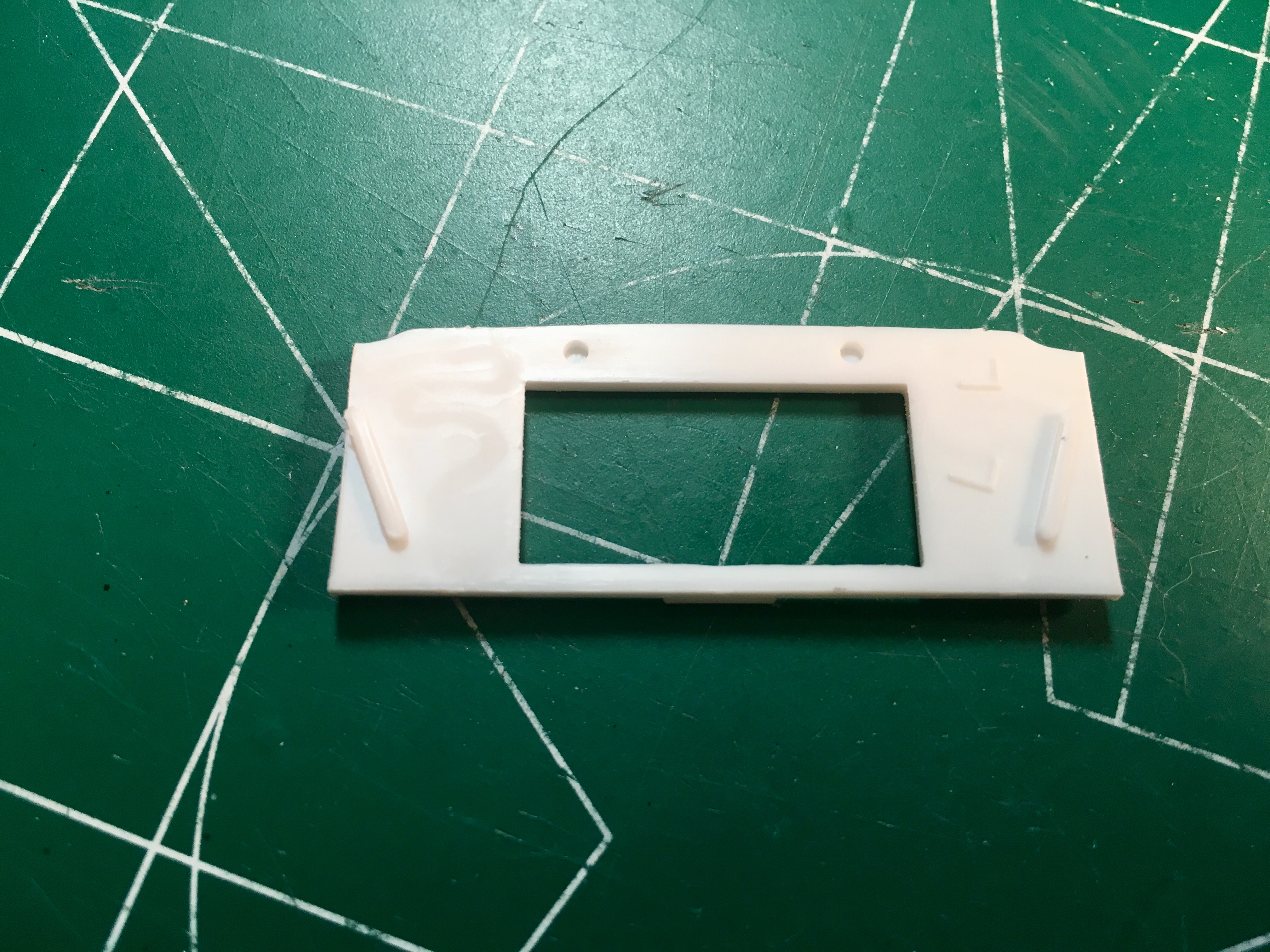

Brutalform Posted April 25, 2019 Author Posted April 25, 2019 (edited) Had to carefully remove the molded radiator support from the body, so the 64 Dodge support can be modified and added. Edited April 25, 2019 by Brutalform

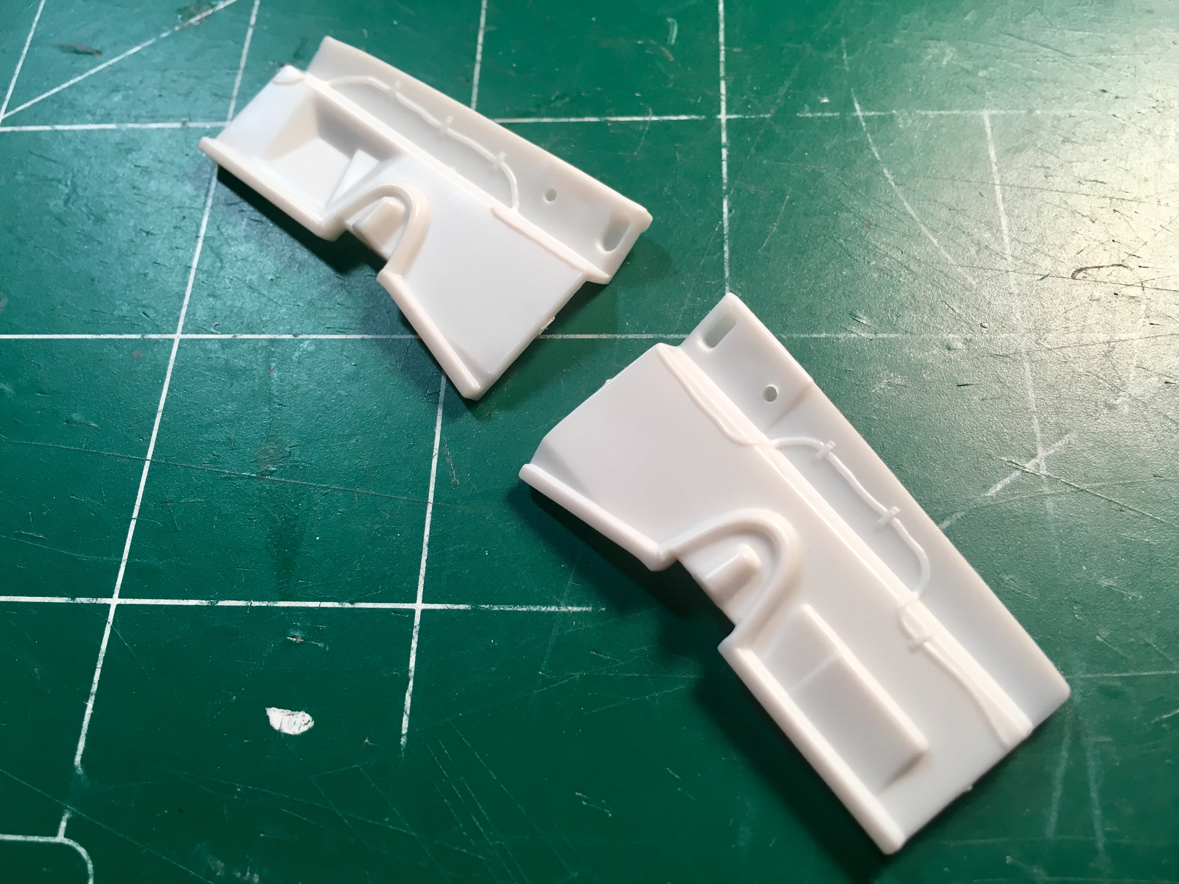

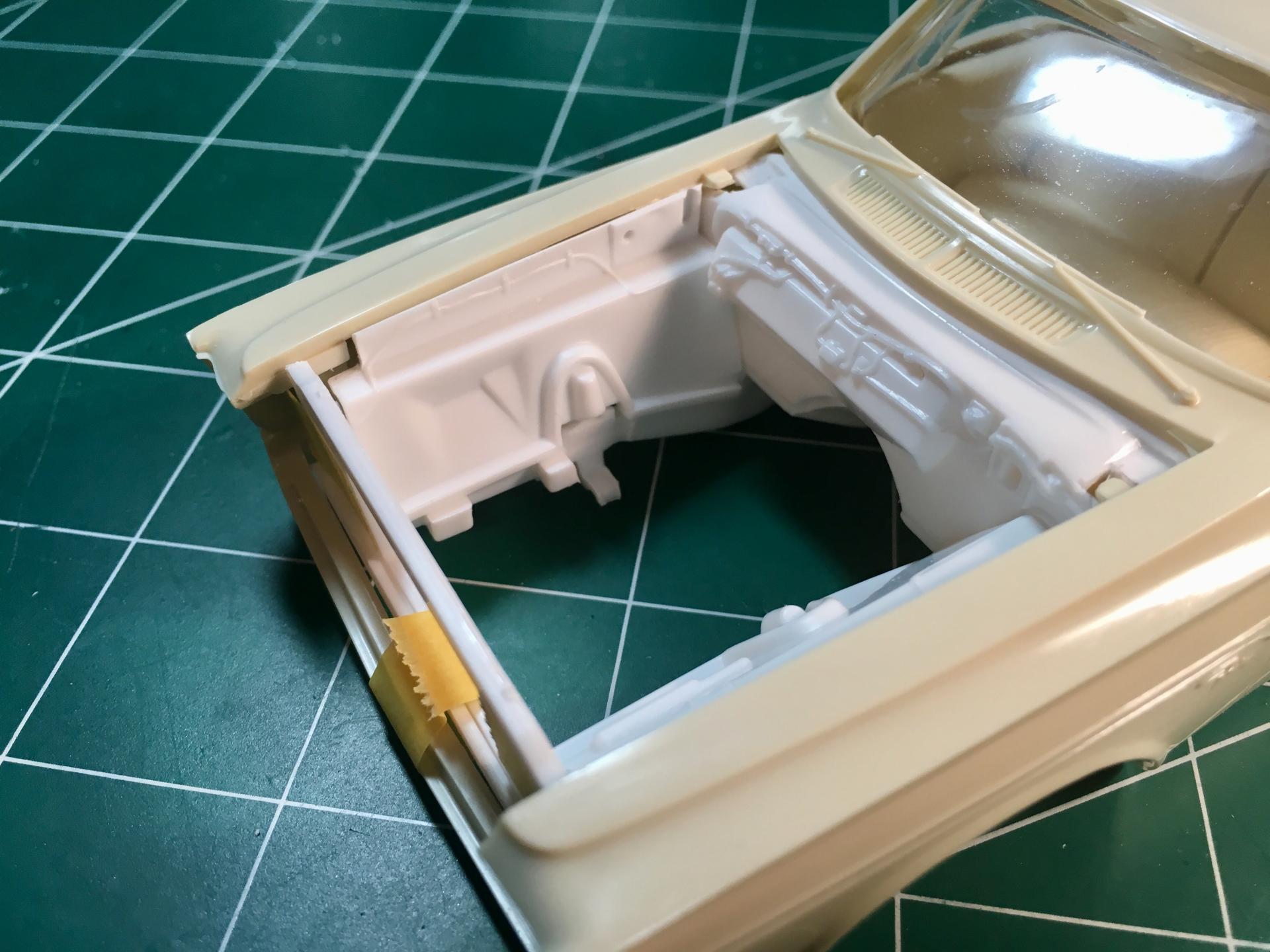

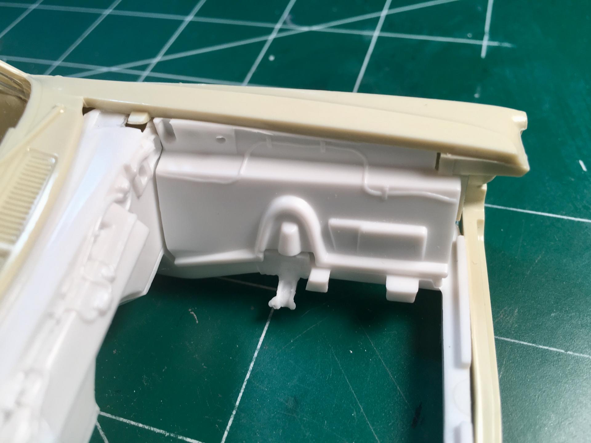

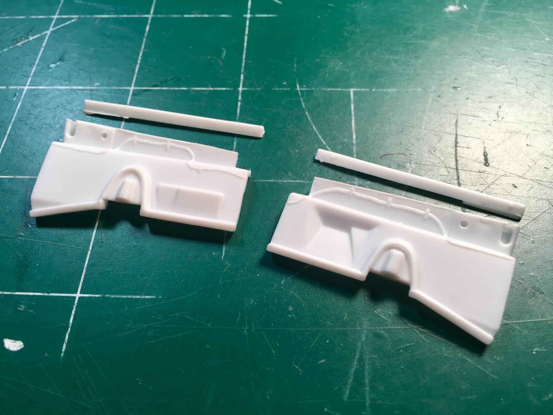

Brutalform Posted April 25, 2019 Author Posted April 25, 2019 The inner fender wells are a bit too tall as they are. So after a test fit, the top lip of the parts had to be removed.
Ace-Garageguy Posted April 25, 2019 Posted April 25, 2019 (edited) Nice work. The old Johan bodies are beautifully engraved and proportioned, and the substitution of the excellent Lindberg chassis and related parts is exactly what's needed. Edited April 25, 2019 by Ace-Garageguy

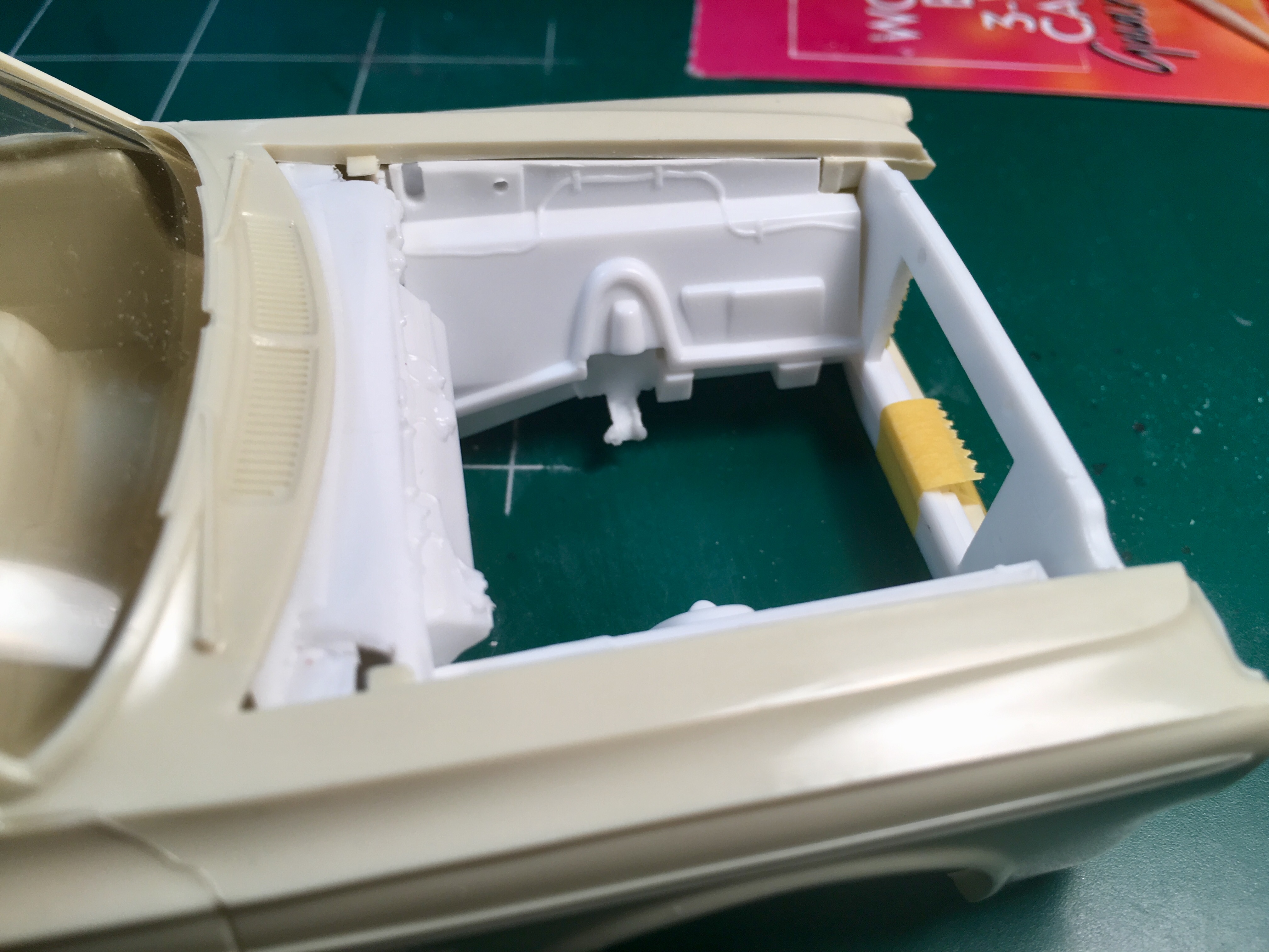

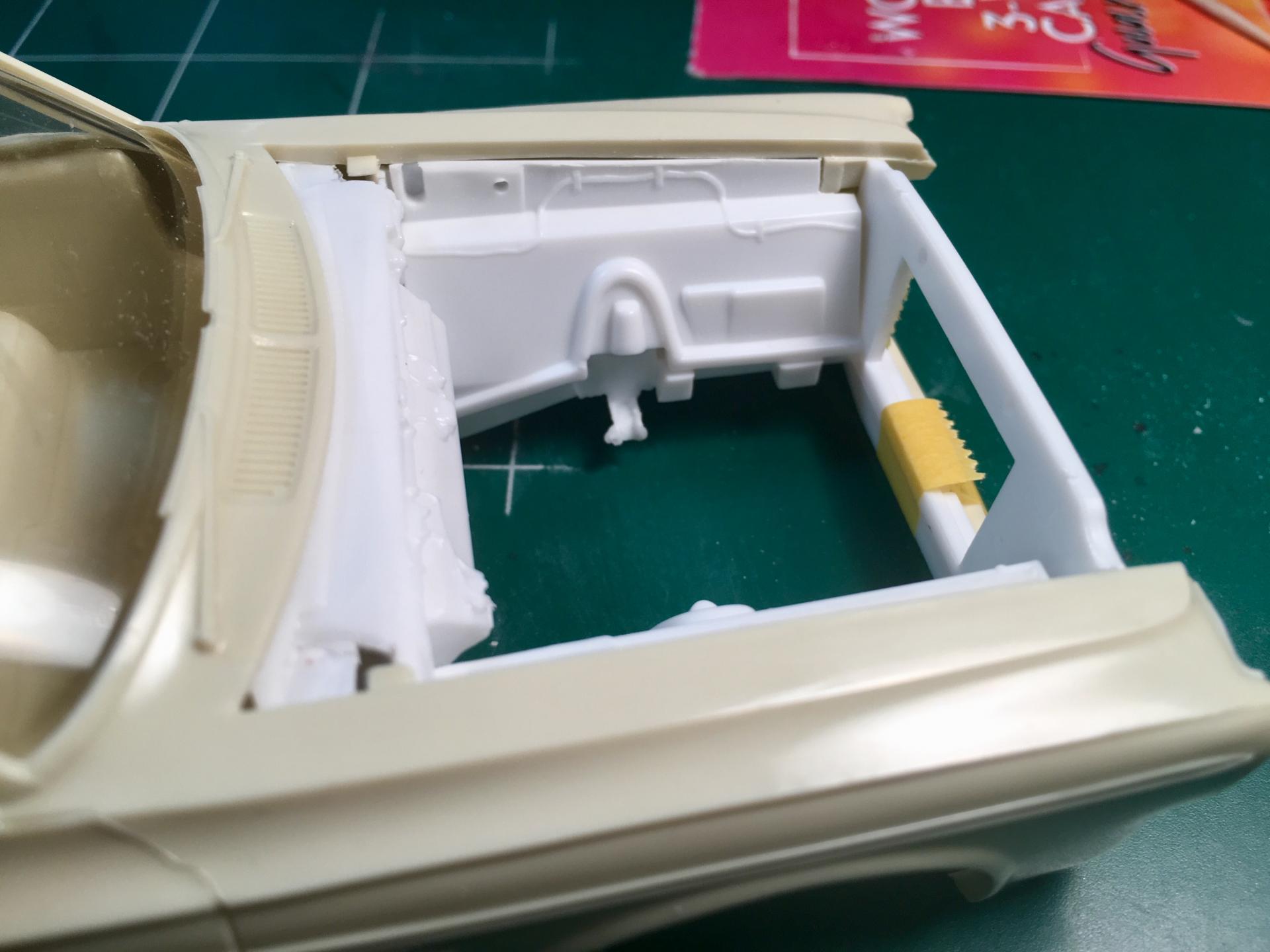

Brutalform Posted April 25, 2019 Author Posted April 25, 2019 After some trial fitting, and trimming, and adding a notch to each inner fender, everything seems to be fitting pretty nice. This is where it’s at now. More to come.

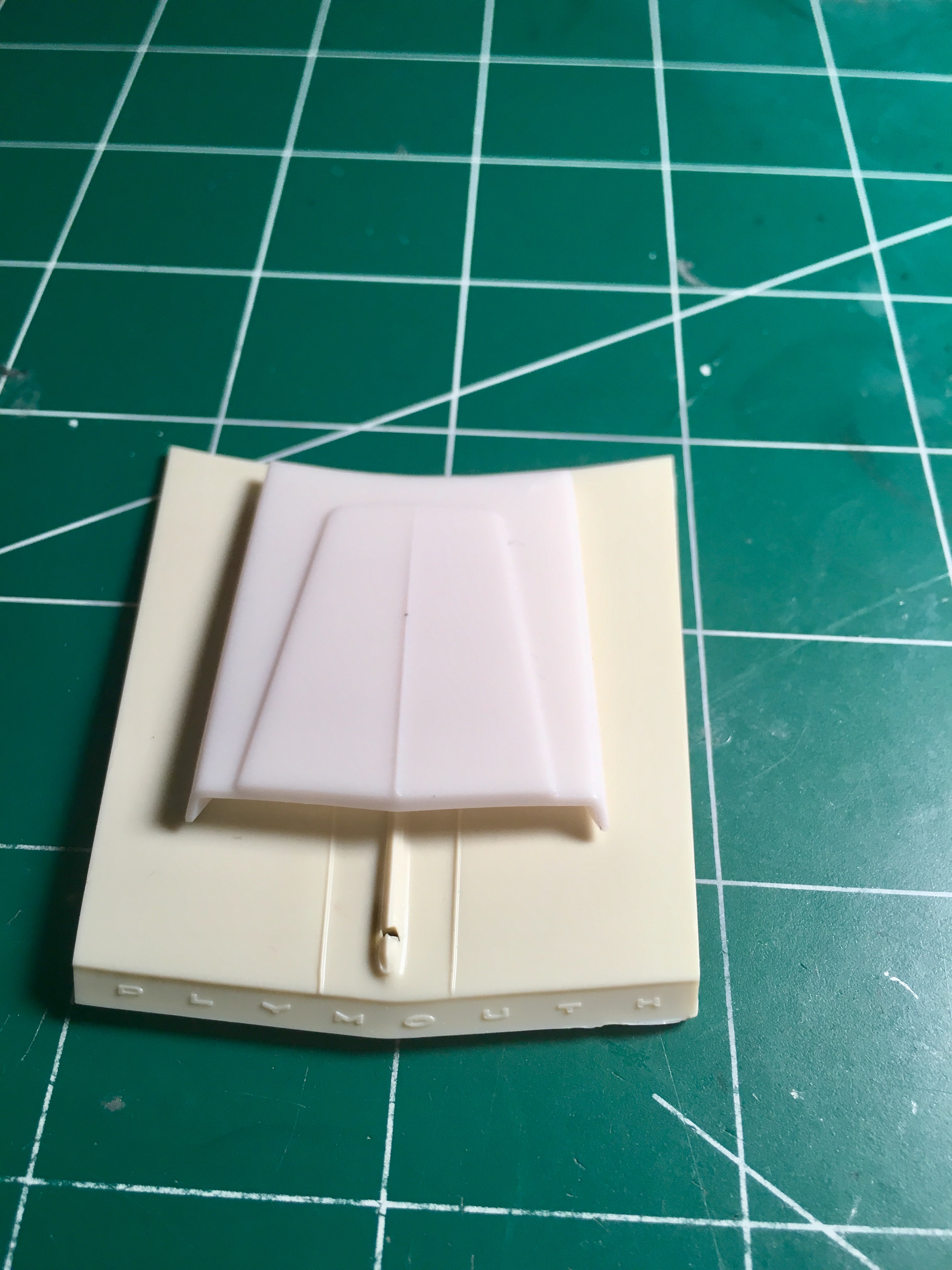

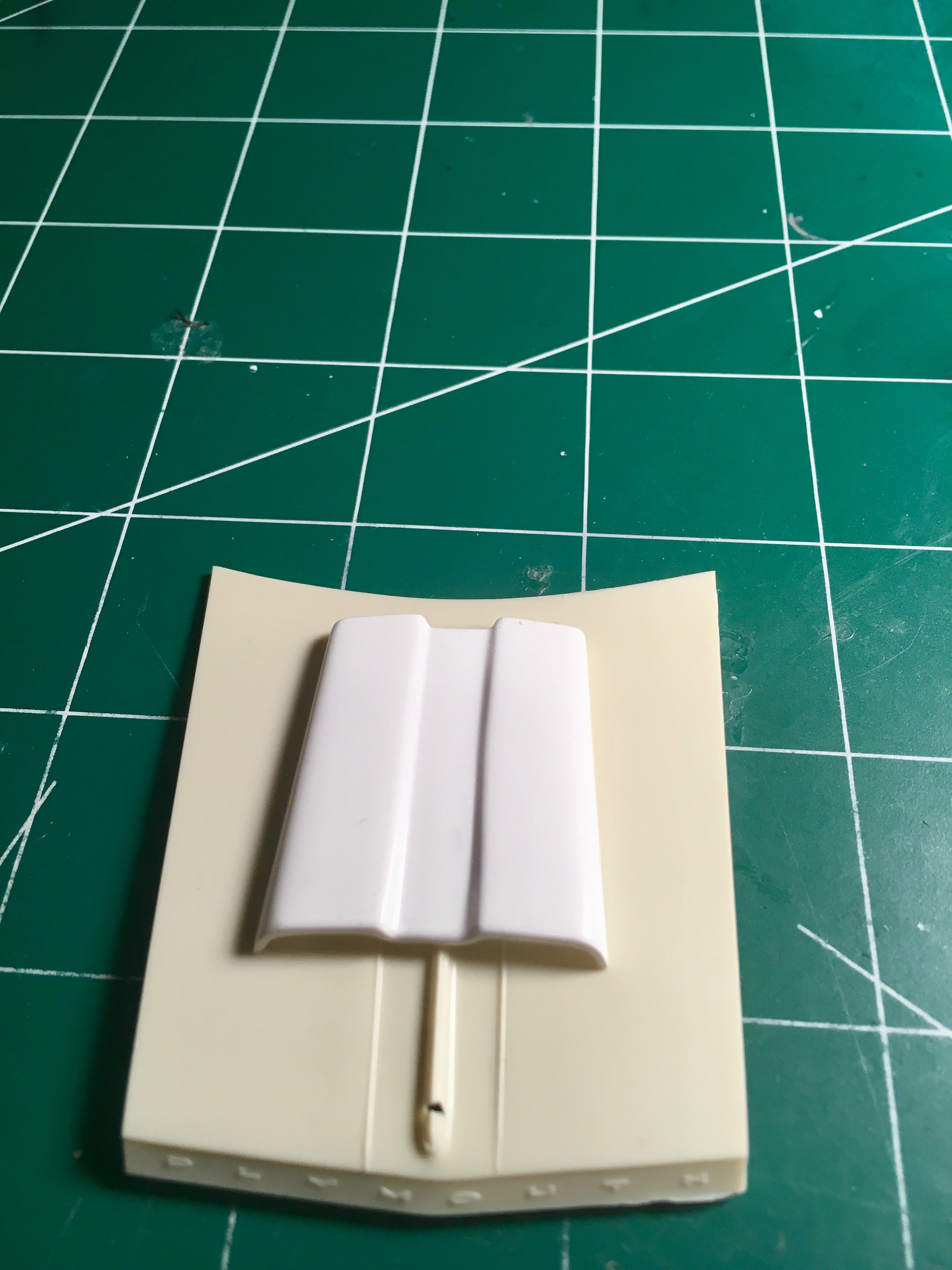

Brutalform Posted April 25, 2019 Author Posted April 25, 2019 I have a choice of these three hood scoops. Looking online at some max wedge cars, it seems scoops are personal preference. I think the third one looks the best for this particular car.
StevenGuthmiller Posted April 25, 2019 Posted April 25, 2019 9 minutes ago, Brutalform said: I have a choice of these three hood scoops. Looking online at some max wedge cars, it seems scoops are personal preference. I think the third one looks the best for this particular car. This is the one that appears to be the most correct for this car. Personally, I don't care for either of the others. Actually, I prefer no hood scoop at all. That is how I will finish mine. In my opinion, the scoop looks too busy. Without it, you get a much smoother, "sleeper" look. This is similar to how I will be doing mine. No scoop, and no wheel covers......minus the white walls. Steve
Brutalform Posted April 25, 2019 Author Posted April 25, 2019 10 minutes ago, StevenGuthmiller said: This is the one that appears to be the most correct for this car. Personally, I don't care for either of the others. Actually, I prefer no hood scoop at all. That is how I will finish mine. In my opinion, the scoop looks too busy. Without it, you get a much smoother, "sleeper" look. This is similar to how I will be doing mine. No scoop, and no wheel covers......minus the white walls. Steve Should look really fine. The max wedge engines fit pretty nice under a flat hood. I was planning on building the 62 Dart 440 with a more stock appearing look similar to your plan, right down to the steel wheels.
StevenGuthmiller Posted April 25, 2019 Posted April 25, 2019 I was thinking, at one time, of using a similar hood scoop on my '65 Fury. I just couldn't bring myself to glue a scoop to such a rare kit! Steve
Brutalform Posted April 25, 2019 Author Posted April 25, 2019 1 hour ago, StevenGuthmiller said: I was thinking, at one time, of using a similar hood scoop on my '65 Fury. I just couldn't bring myself to glue a scoop to such a rare kit! Steve I know what you are saying. Since I’m going to use the Lindberg scoop, I can use the kits hood with its mounting holes, as well as the air cleaner inlet holes, as a template. Still will be extra careful.
StevenGuthmiller Posted April 25, 2019 Posted April 25, 2019 31 minutes ago, Brutalform said: I know what you are saying. Since I’m going to use the Lindberg scoop, I can use the kits hood with its mounting holes, as well as the air cleaner inlet holes, as a template. Still will be extra careful. The '63 Plymouth is a little less scary. It is much easier to find. Steve
