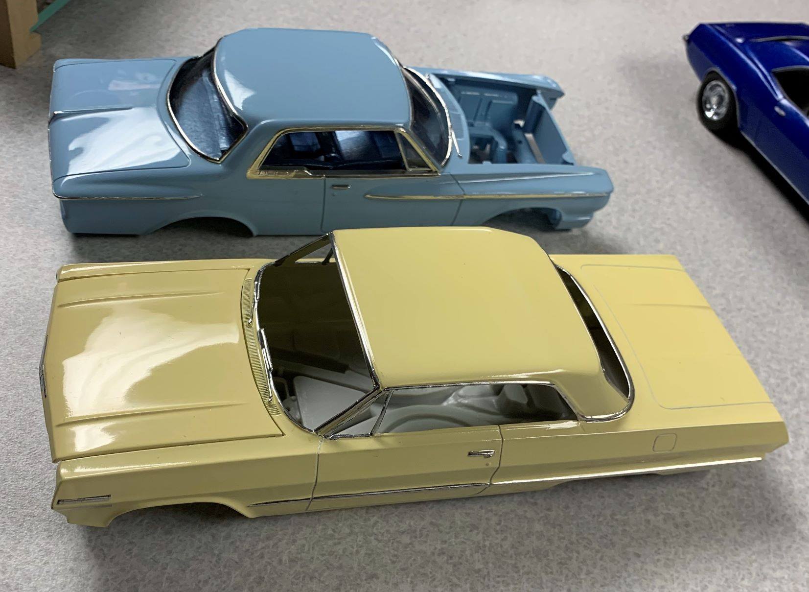

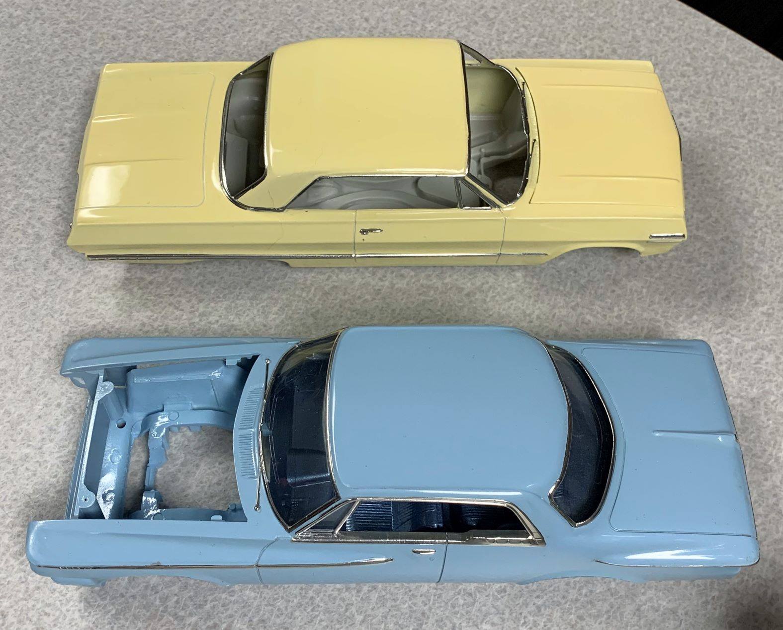

moparfarmer Posted May 1, 2019 Posted May 1, 2019 I shot for the first time ever Krylon Fusion over Duplicolor sandable grey primer..Went on smooth the shot with Duplicolor Acrylic Enamel(tall black label can) I was worried but came out good..Dry quick and smells like lacquer but smooth like enamel..Week and half later wet sand 2000 then 4000 then polish with Meguiar's Scratch X2.0 then finish with Meguiar's Gold class paste..Its the yellow car in the picture...Both cars were cleared with the Duplicolor Acrylic Enamel..and polished the same..
Bucky Posted May 1, 2019 Author Posted May 1, 2019 (edited) Those look great, Wayne! I think I have some of the Dupicolor clear hanging around. If not, I know I can get some close by. I'm wondering why the Krylon clear did that over the Krylon tan? I would have thought the same brand would be a good match. Edited May 1, 2019 by Bucky
moparfarmer Posted May 1, 2019 Posted May 1, 2019 Bucky I think its just a BLAH_BLAH_BLAH_BLAH shoot with Krylon..That why I was a little doubtful of using it..I liked the yellow so I tried it and it came out okay..Will be worried again when I try it another color but why not..
