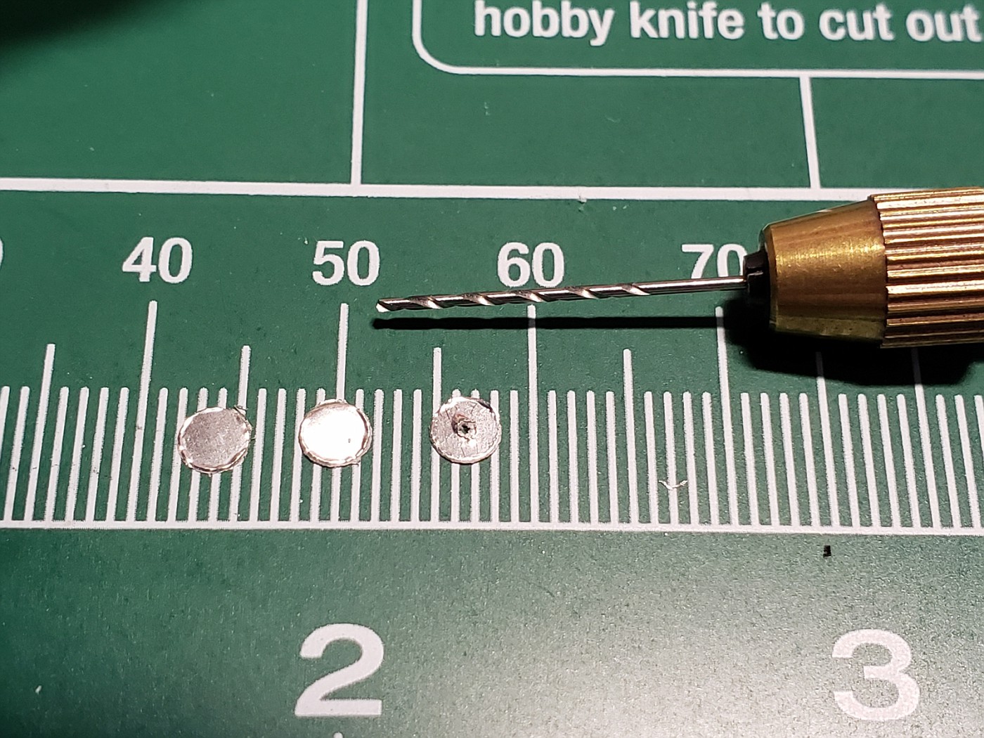

Nacho Z Posted May 5, 2019 Author Posted May 5, 2019 Last WIP post. I worked on other details but did not take a lot of photos. I painted up the hood emblem. Monogram's box art is incorrect. A quick Google search had plenty of nice detail shots. For some reason I had trouble getting a good picture of my emblem. Here is a shot of what I call a poor man's wheel alignment jig. There is some distortion in this picture but I assure you it is pretty dang square. The hood pins are just molded in blobs with a little pin that sticks up. If you try to BMF foil this the way it is, the BMF will not lay down flat. I punched discs of BMF and then drilled little holes in the middle. I applied the BMF and then touched up the pin with Molotow. I also installed the glass.
