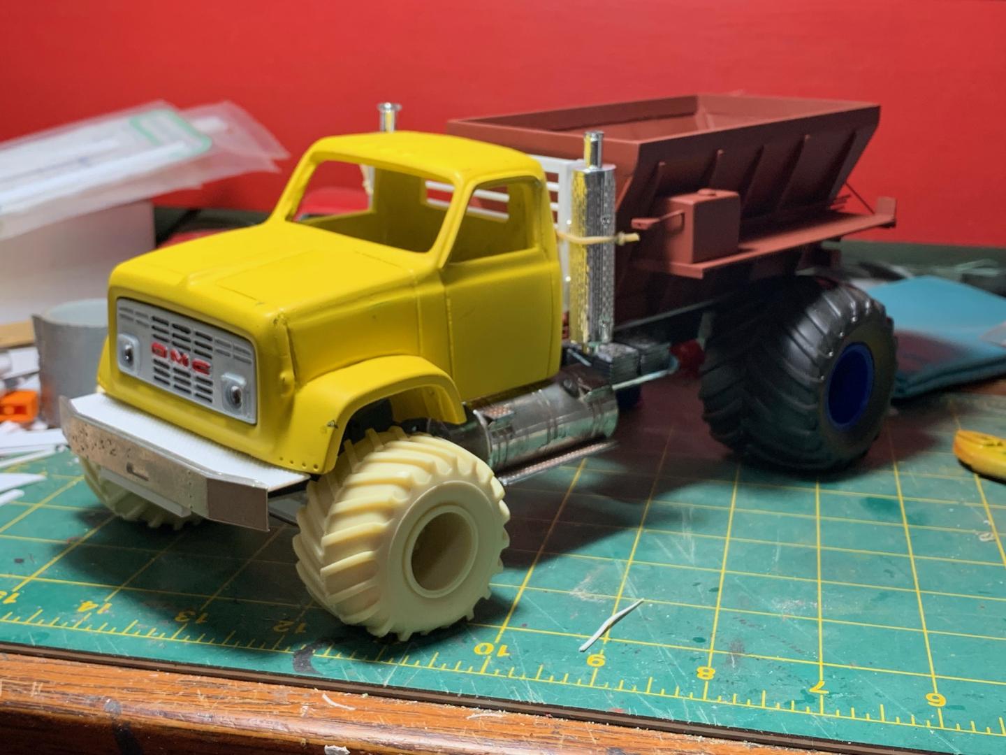

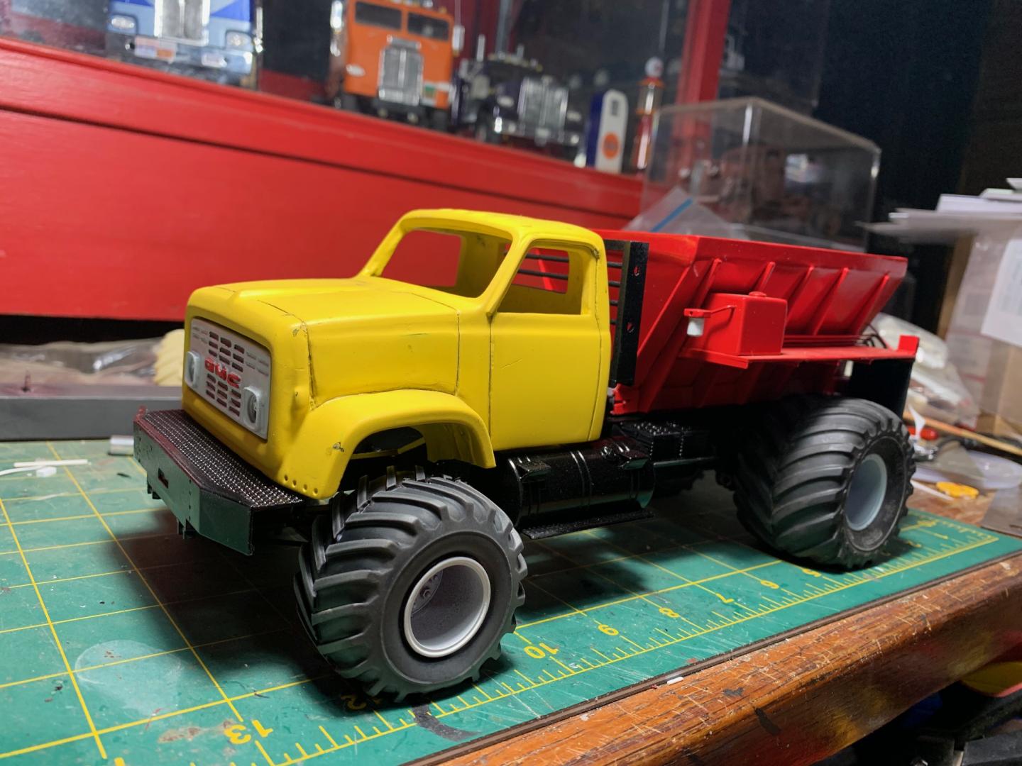

Well I'm pretty much at the end of my rope with these cabs. I don't think that I'm going to be happy with neither. The red one was dry, but the swirl marks began to "ghost" in the problem area which was mostly the driver's door. After it began to ghost it got soft again. I scraped to the paint off of the door to find the resin soft and flaking off. I think that the putty in the other cab will continue to crack because it is pretty thick as you can see in the crater pictures. These cabs are currently unavailable from Dave right now until he can make new molds.
So here you can see the swirly green resin after the paint came off. Notice the lower part of the door is fine with the primer still bonded.

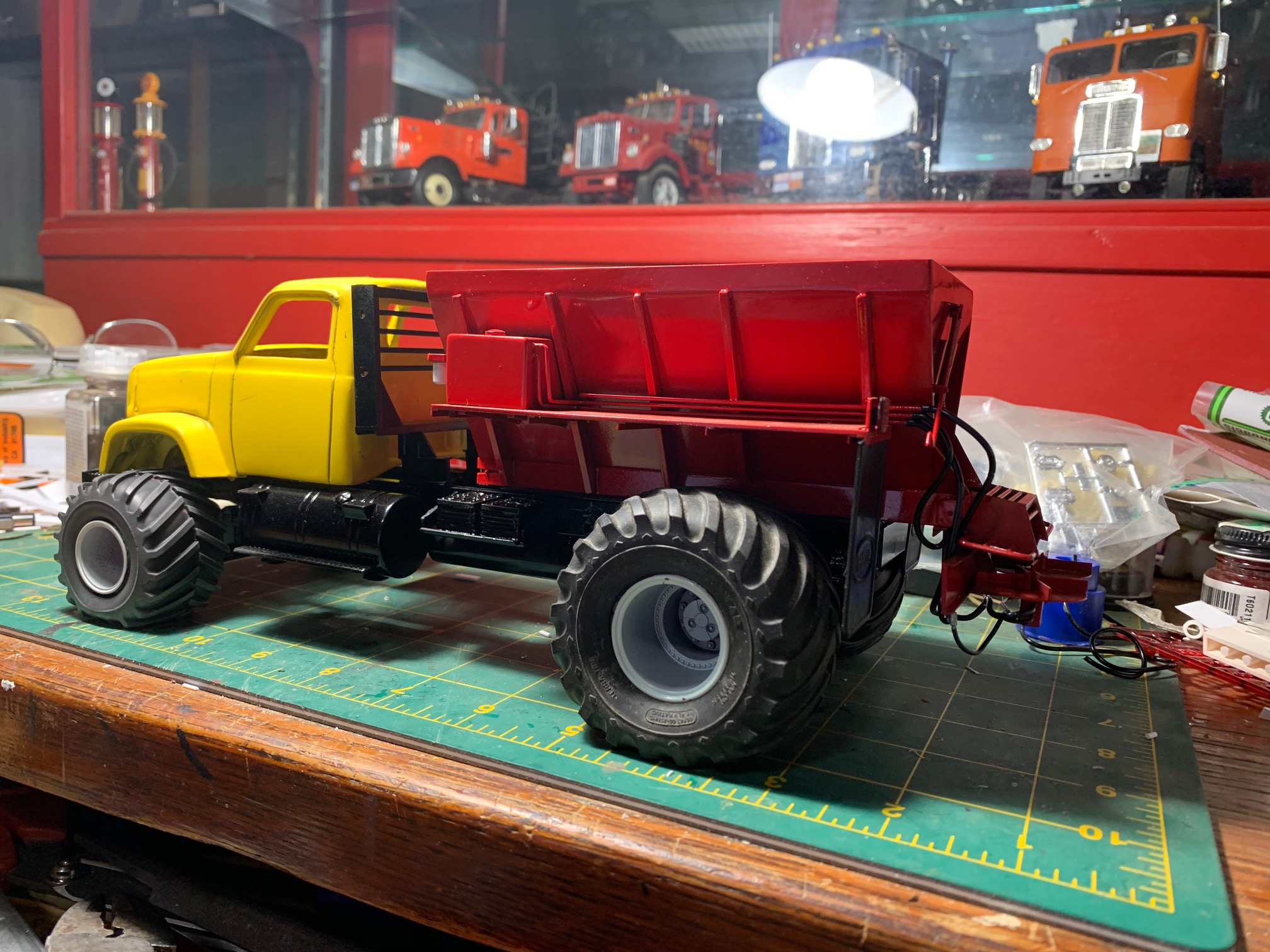

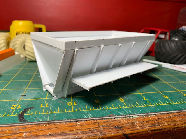

In other news the spreader bed is coming together. So whatever kind of cab that I have to use, I'm planning to make a spreader.
If anyone has a spare GMC 9500 cab or even a C70 cab that they're willing to part with, let me know.
Thanks,
Brian

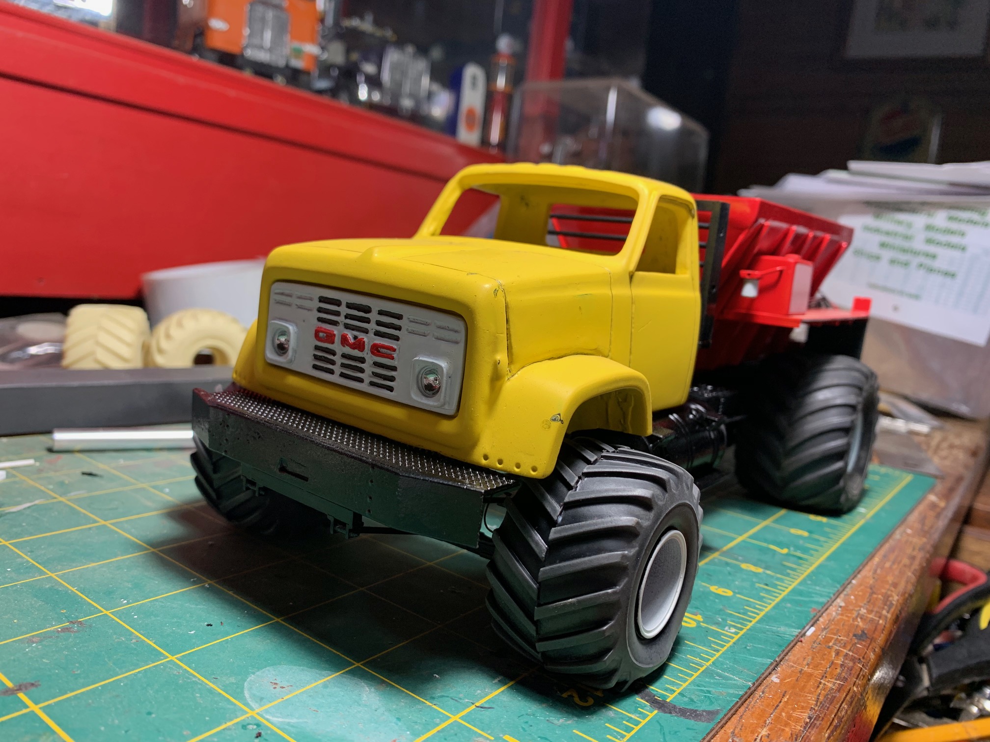

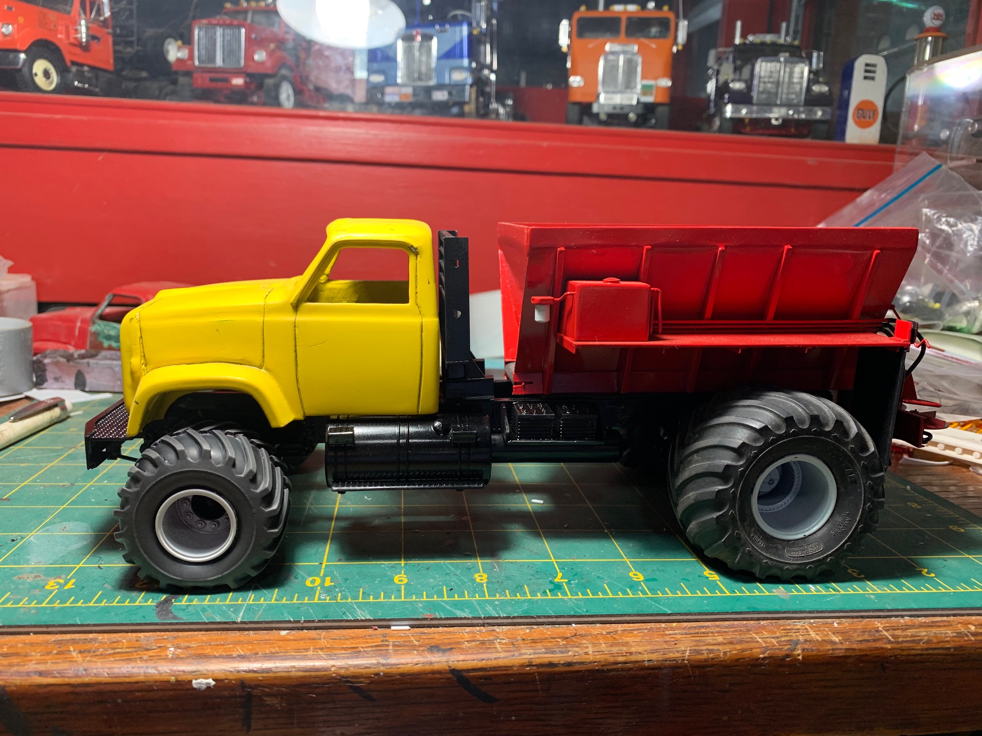

Unfortunately, the red cab is junk. All of the areas that were troublesome before began to soften back up. On the other hand the "crater cab" (green one pictured before) is in usable condition now. So this project is back to moving forward. My original plan was a farm truck that was a little banged up, so I think this cab will work now. At least it's dry and not soft. :D
The bed is mostly done. I need to paint it before I install the belt, and I have to install the belt before I can install the spreader assembly. Then I can finish with the hoses.

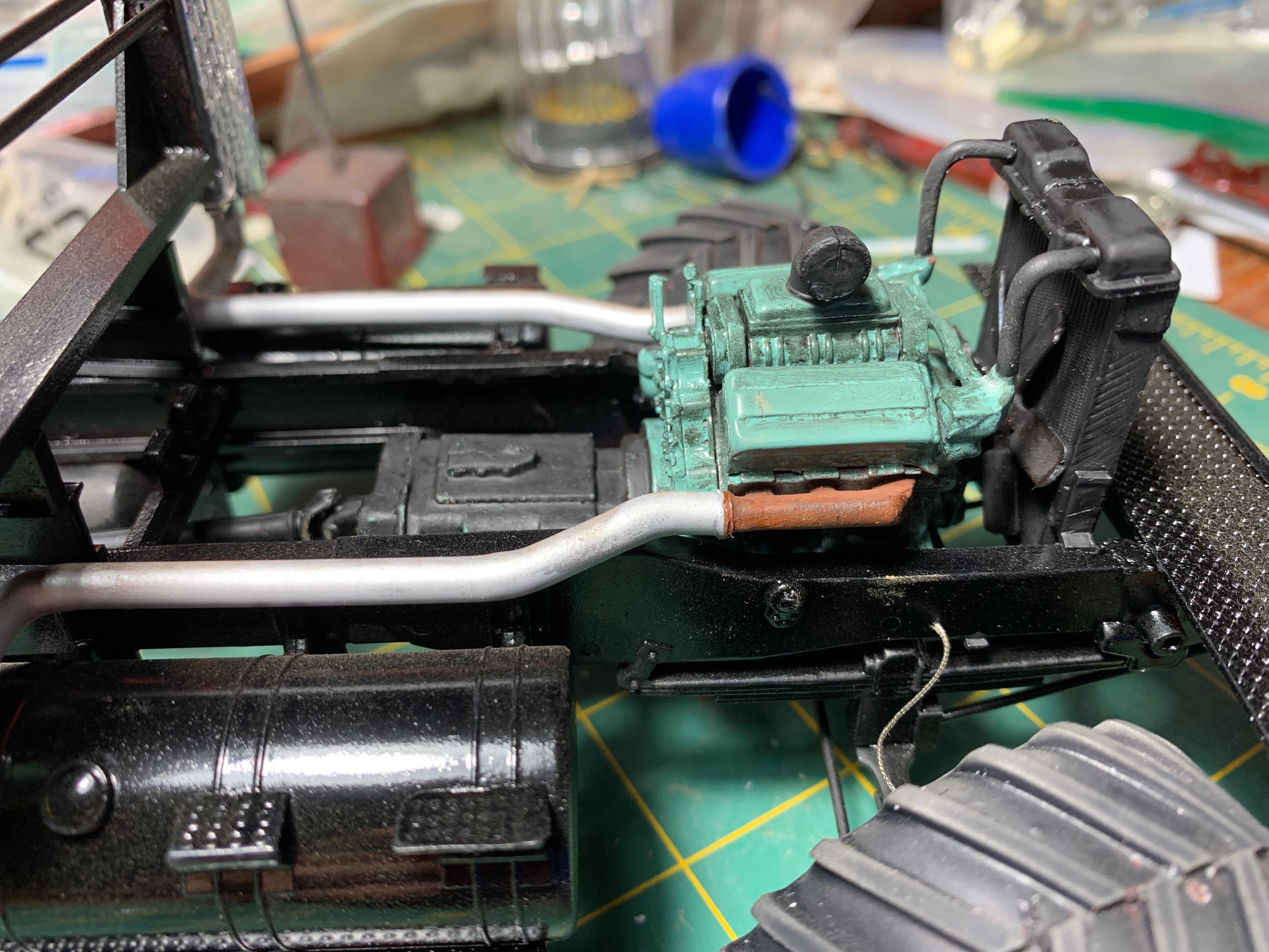

A little progress. This truck will be a curbside, but I wanted to put an engine in it anyway. The engine I wanted is a 6v-53. The main difference between the 53 series and the 71 series that will be noticed right away is the valve covers are different. Of course the heads are different, the engine is slightly smaller and some other details. I want to make a better representation than this of a 6v-53 one day, but for this curbside truck, this one will work. I cut down an 8v-71 to make this one.
Fabricated a dash. It began with 4 pieces of Evergreene Styrene stock glued together in a block. It's not perfect, but it will do in this farm truck. I scuffed it up a bit and used a little chalk on it to show some wear.
