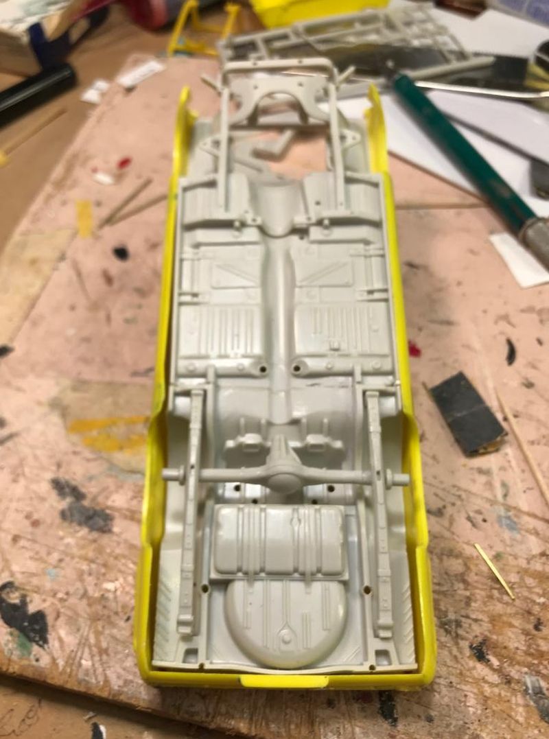

As we sit right now.. I pulled out one of my donor '71 Duster kits and started carving. Same conversion I did on the '63 Valiant stock car. That's the Duster's engine bay carved from the body and transplanted into the Valiant.
And we shortened the Duster chassis about 6 scale inches. And it's a fit!
I've already carved the back seat out of the Valiant interior bucket to narrow it for the top iron side pockets. Next step is to pull a slant six from the hoard!

Pretty much correct.  The same basic stamping from 1963 onward, not sure of that first gen 1960-62.  The V8 was introduced in 1964.  The base was modified in 1967 to allow for big blocks. There are small differences under the hood, enough that you would probably want to fix 'em, but I've decided just to go with it and nobody would notice.
Here's how shortening the chassis worked for me... note these pix were of my original experiment with a junker chassis.
MVC-008aF
MVC-009F
If you cut straight and true, there is very little clean up.
MVC-007F
and on the top side there is a trough which is the indent from the rear unibody.  I used brass rod to join those together with press fit.
