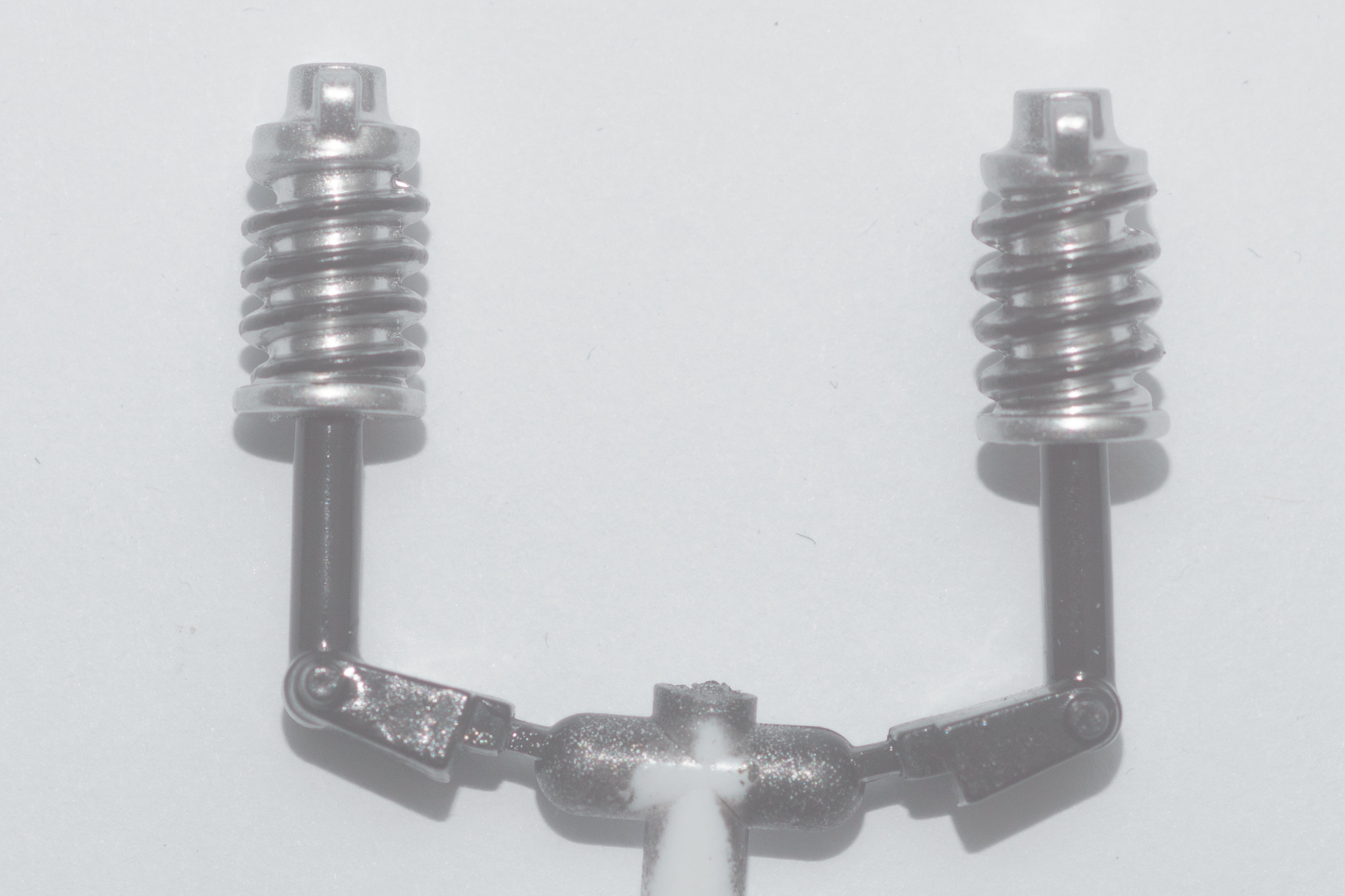

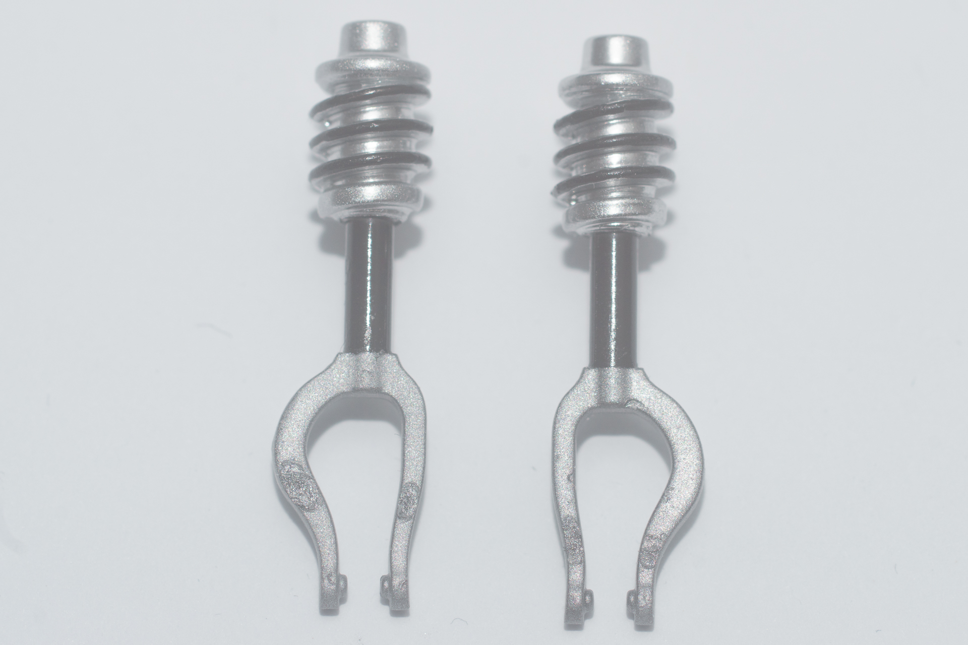

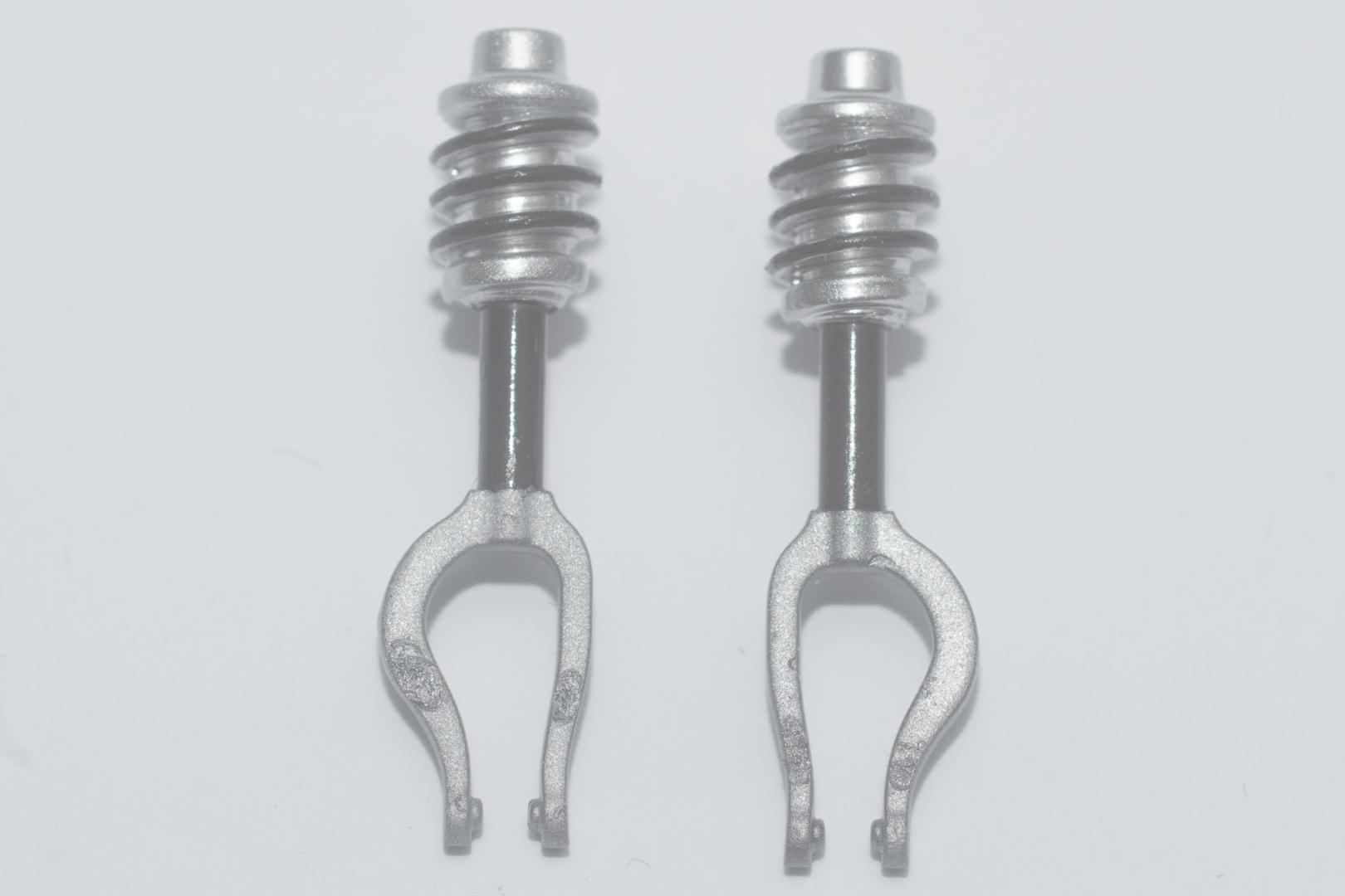

First I started with the shock struts. The front ones I will have to redo in the aluminium colored part as there was a mishap when holding them to get the chrome paint on.

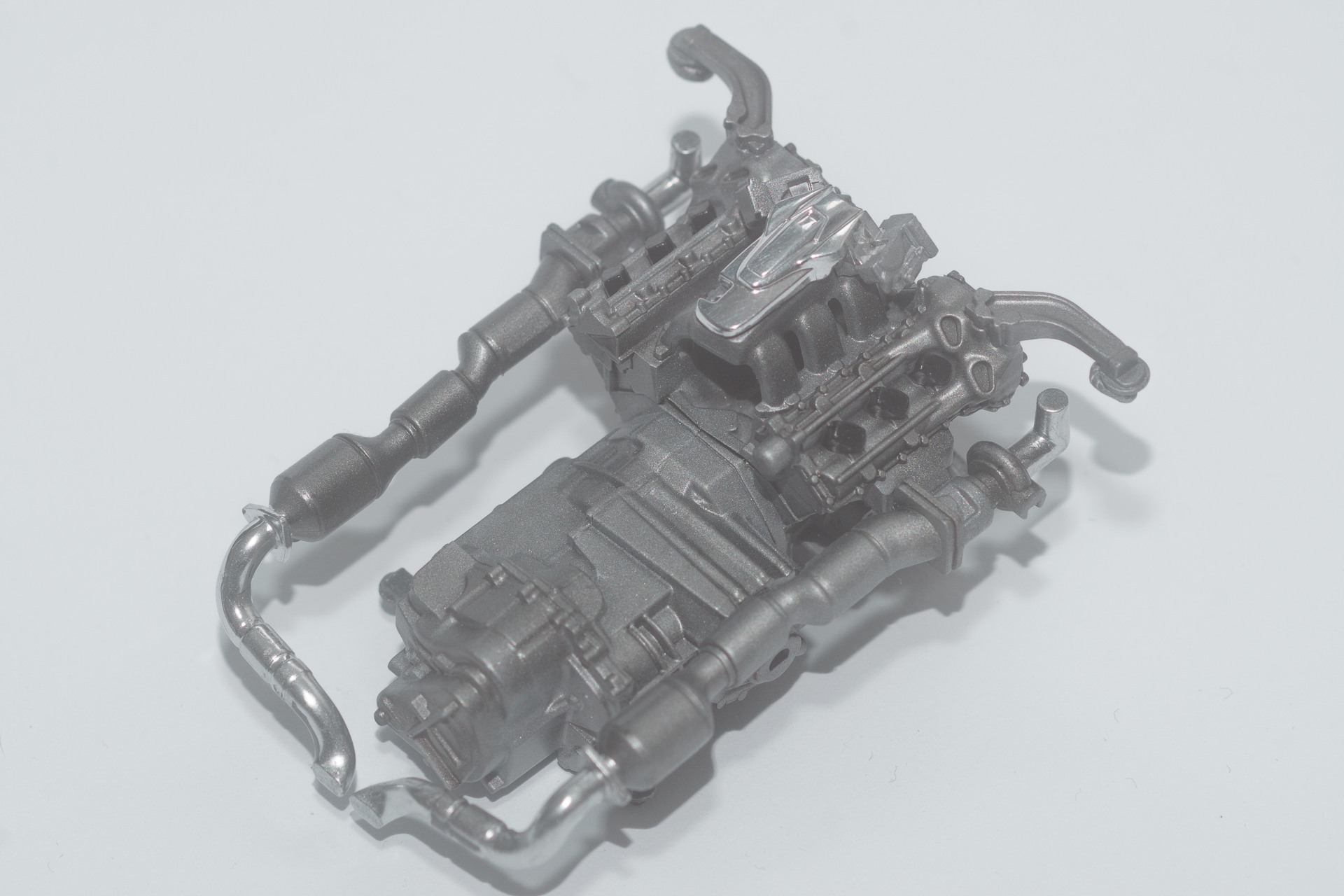

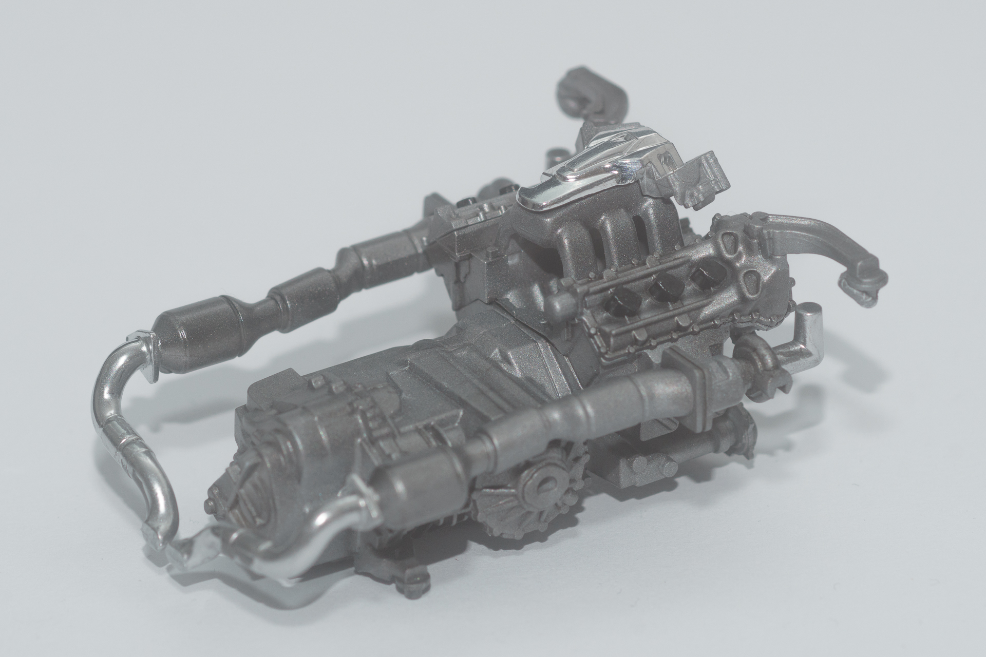

The engine has been assembled and painted in dull aluminium. The valve covers and the chromy thing on top are not glued on yet.

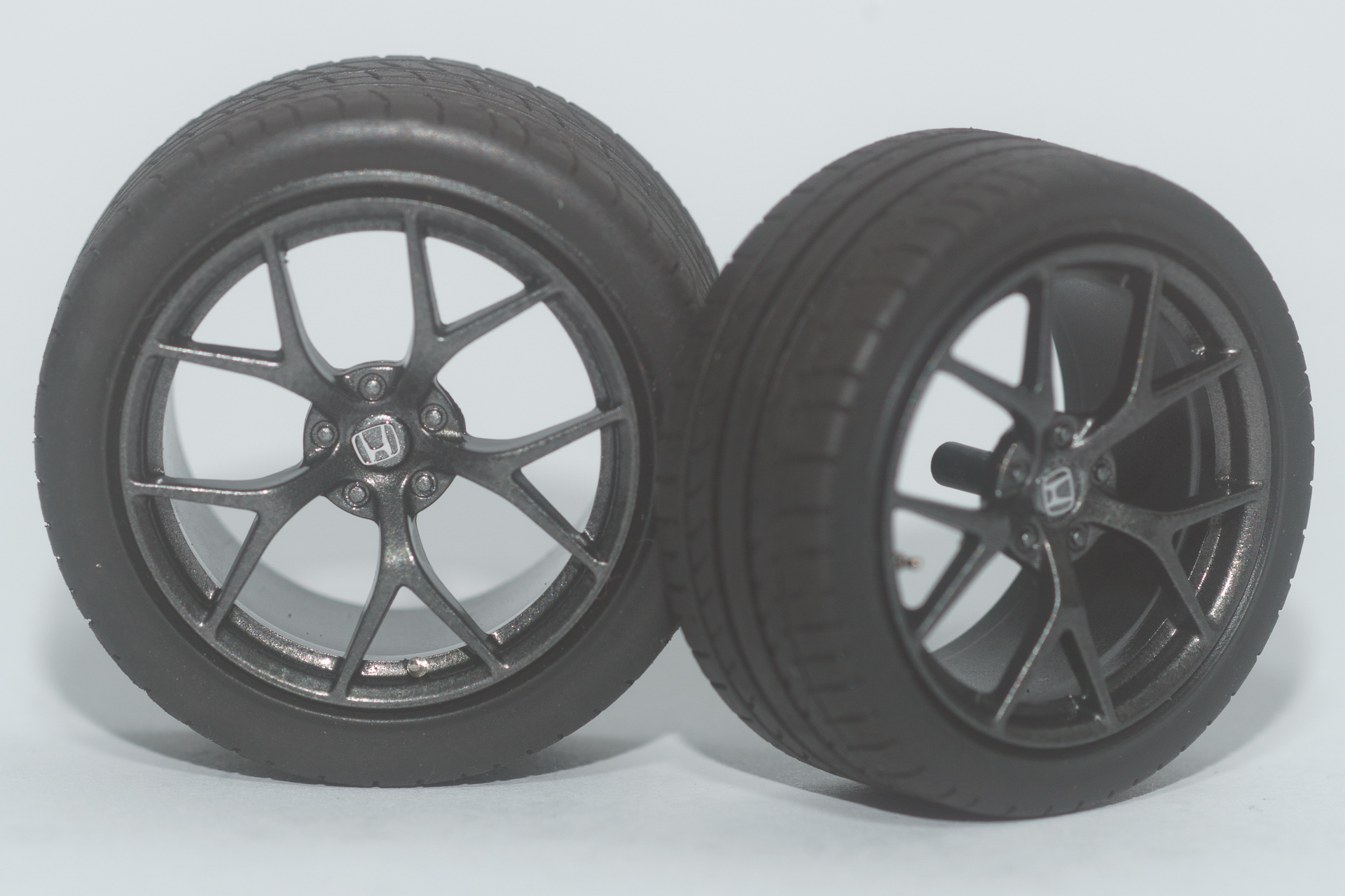

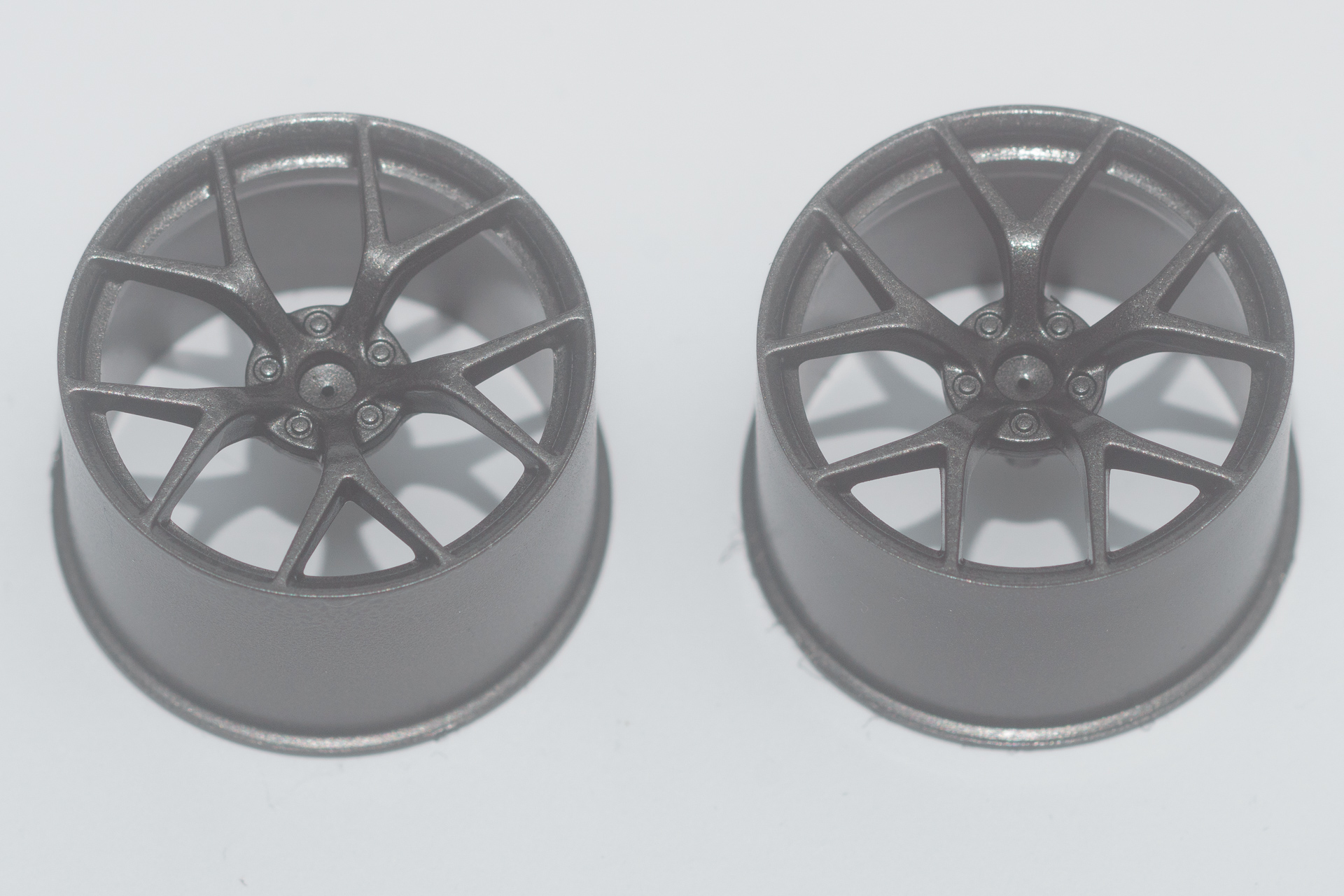

The rims have been painted in gunmetal gray. I'm not absoluteley sure, whether they will stay like this. This will depend on the final color of the body. I won't tell you yet the exact color, but I think not all of you will like it ;)

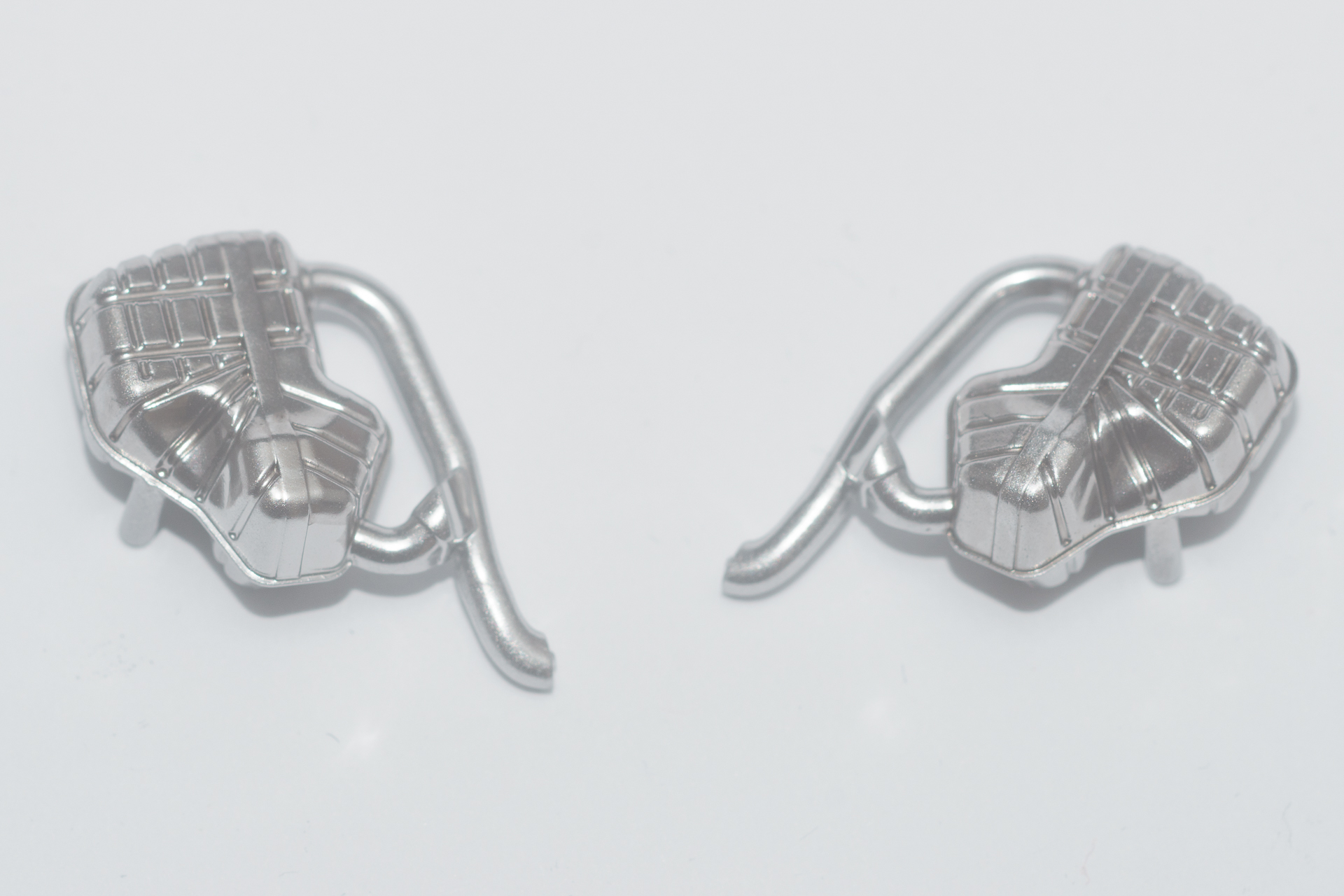

Some parts of the exhaust system have been airbrushed with Molotow's Liquid Chrome and sealed with Alclad's Aqua Gloss before getting a light wash.

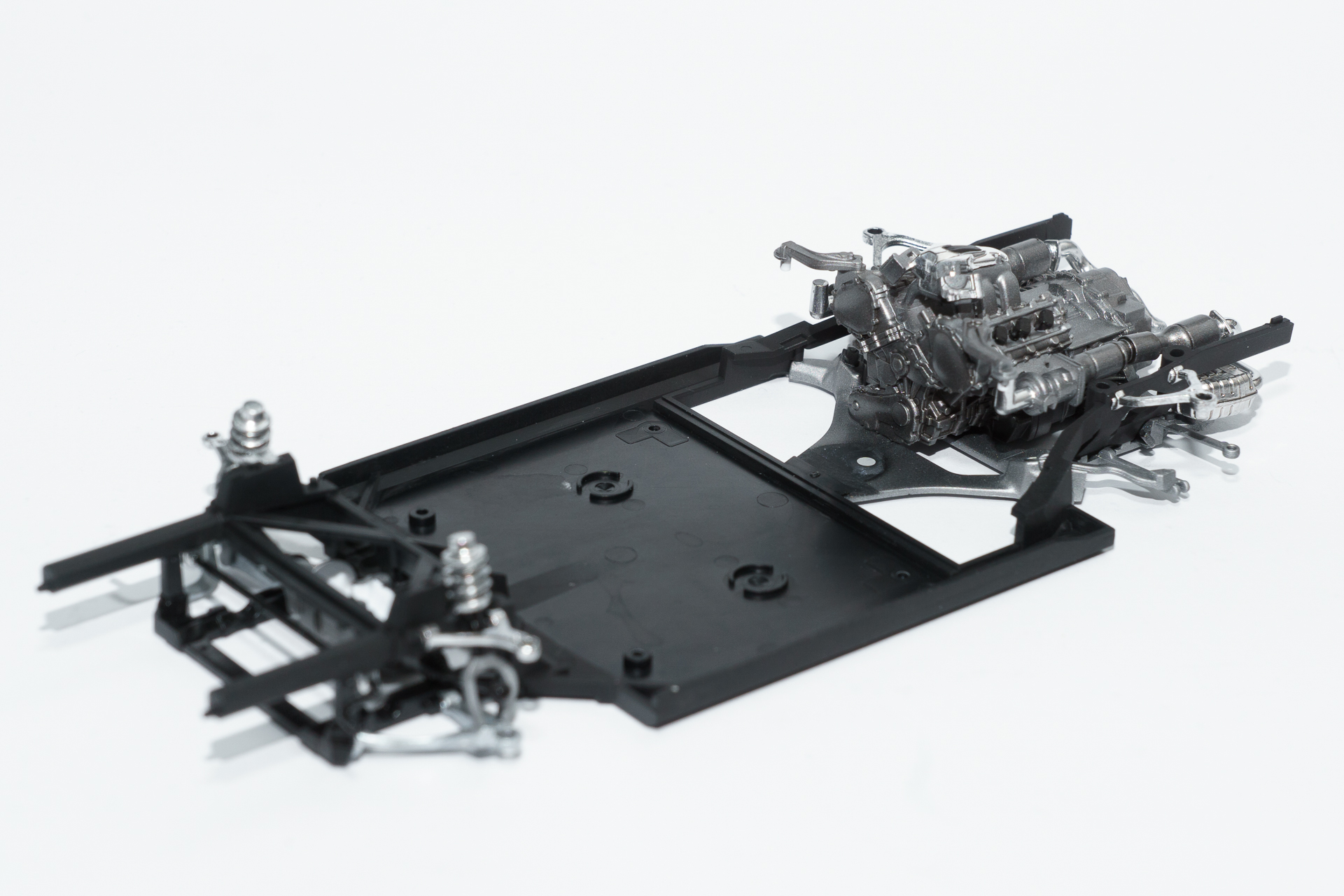

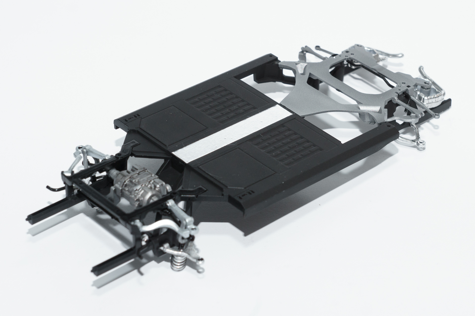

Thank you for your feedback :) Meanwhile I got some more progress to show. First, I finished the engine as far as I could before mounting it to the frame. Then I finished the underbody(?). The engine has not glued on yet, as it has to be mounted to the interior tub, which I didn't even started with. The stripe on the underside has been made by usual aluminium foil.

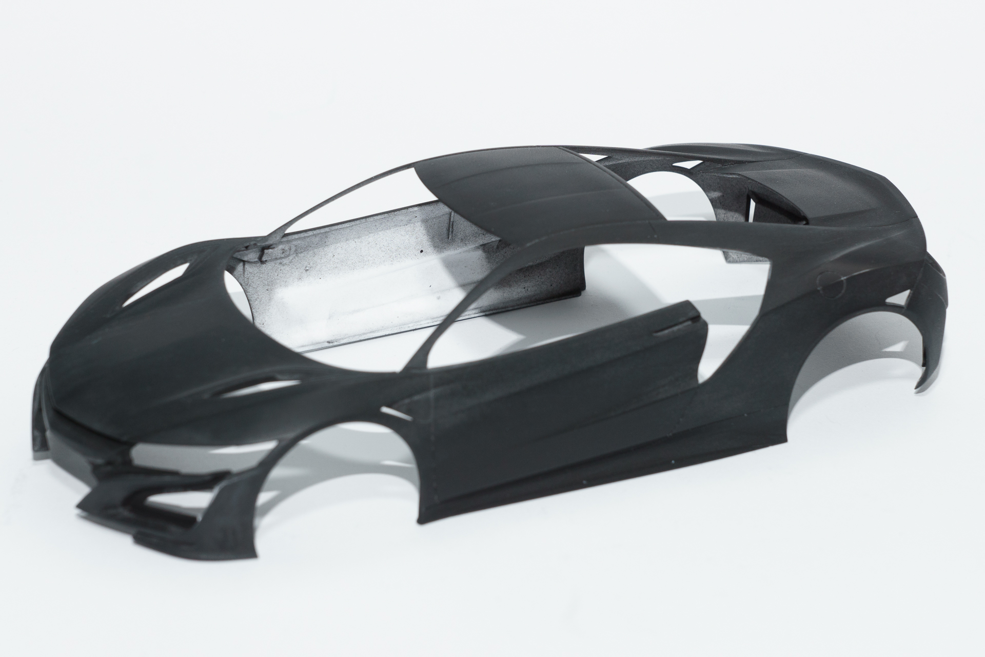

Than the body parts got their first coats of primer. Here you see the result after three coats of primer and some wetsanding with a 3000 grit sanding sponge. Today I applied another coat of primer on these spots where I managed to sand through. This evening I will start painting it.

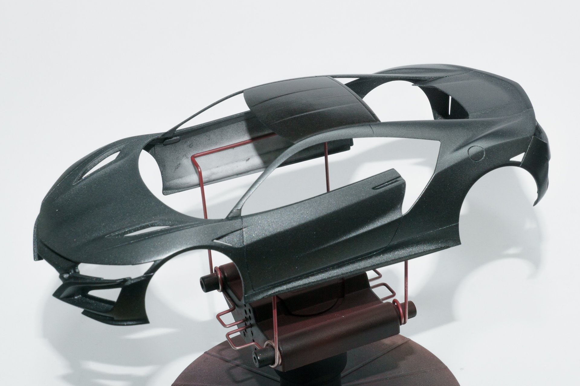

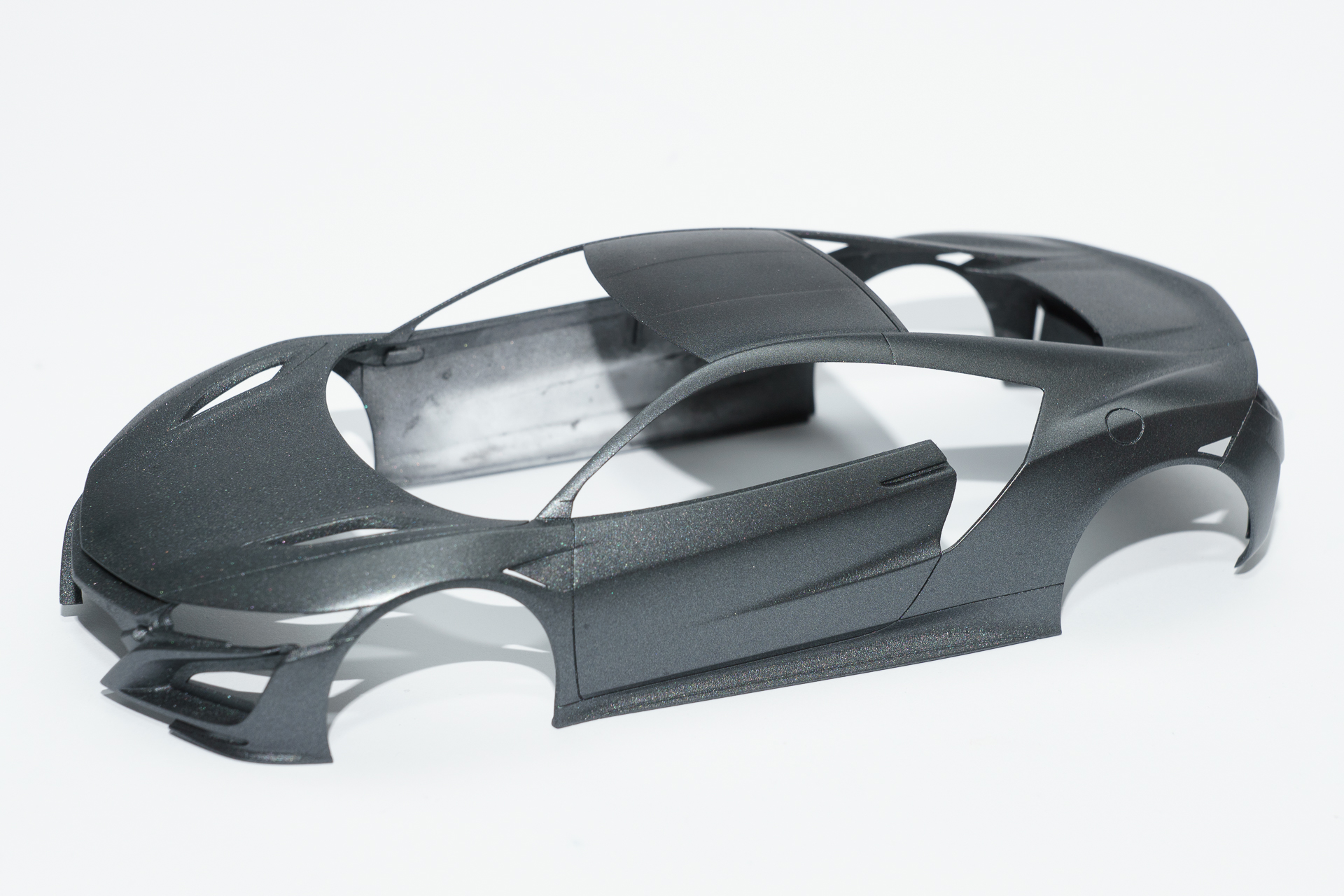

Some progress has been made. Although first there were several steps back. After the first few coats of paint I noticed on several spots that I missed sanding the surface to a flat apperance. After sanding there were so many white spots where I came through to the bare plastic, that I decided to remove all paint and start over. The paint is Nord Gray Metallic by Zero Paints. First I was quite disappointed, because on the 1:1 car the paint looks quite green depending on the angle of incidence of the light. Here I only got a dark gray metallic color. But after about 10 thin layers the greenish tint started to show. Currently there are 14 thin coats applied an sometimes you can already see the desired effect. Unfortunately I didn't manage to capture it in my picture. You will just have to believe me;)

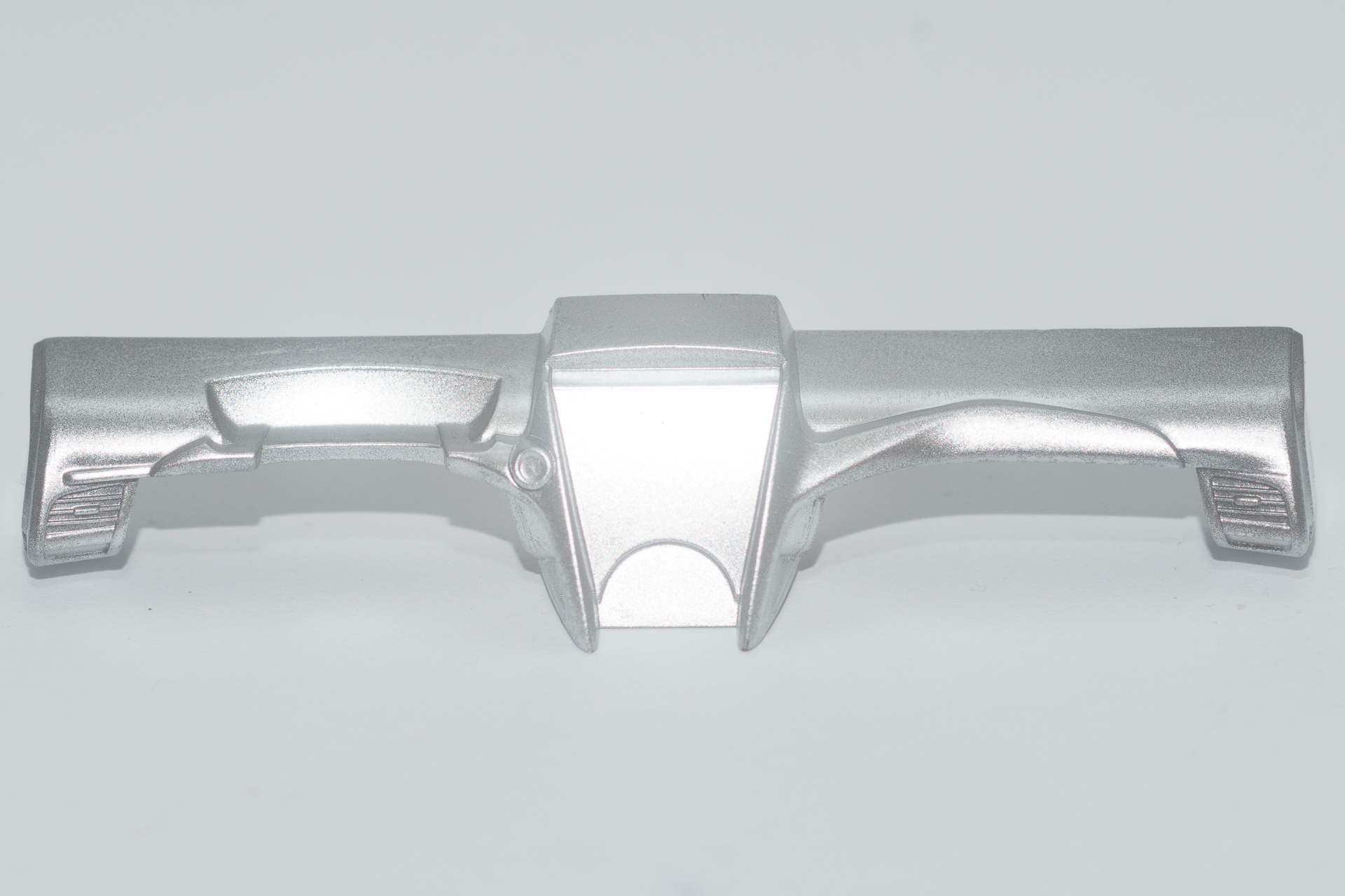

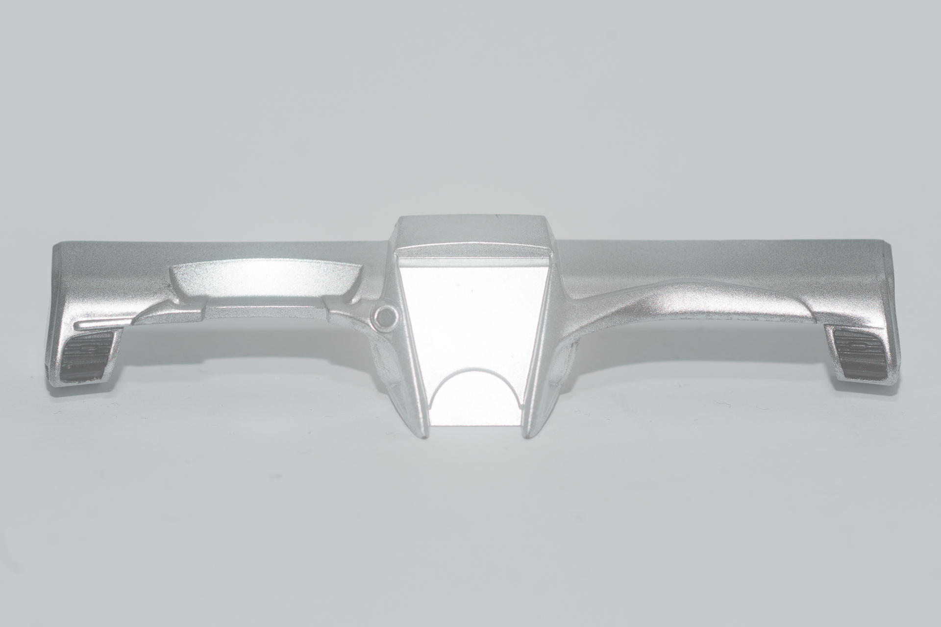

Than I repainted the lower part of the dashboard. Some detail painting will still be required though.

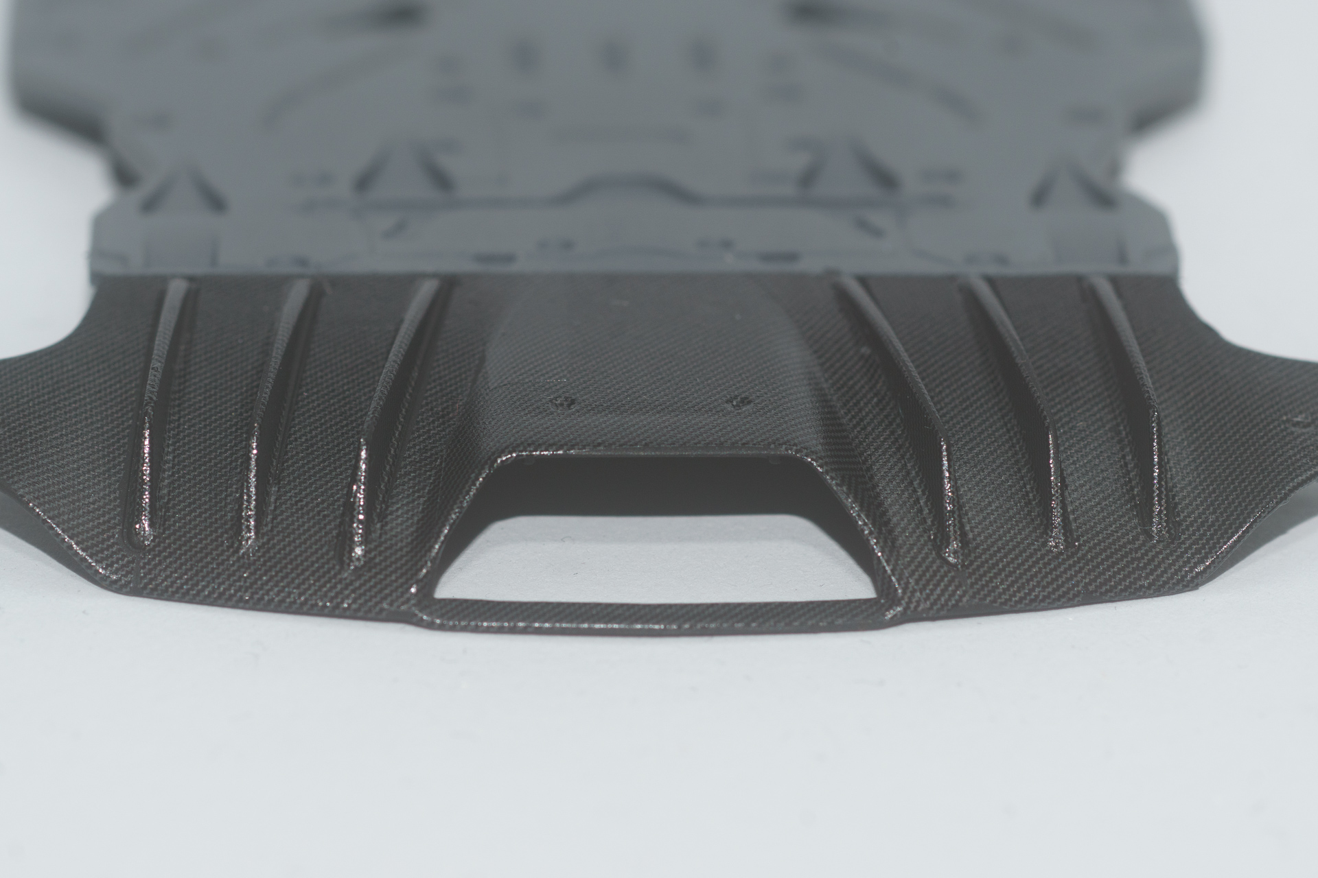

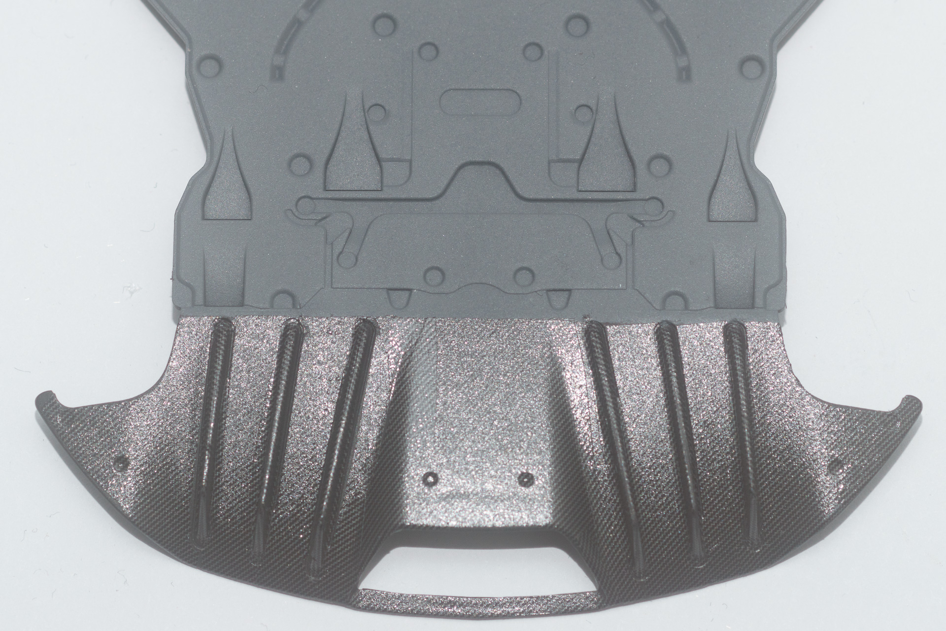

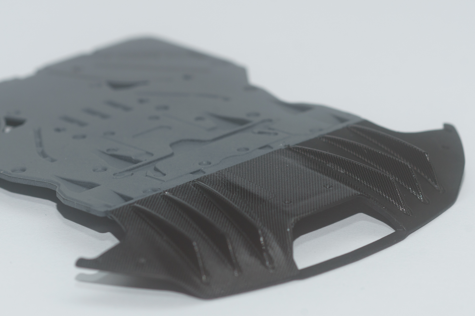

The diffusor got some carbon decals applied. As you can see it is not yet finished. In the back I will have to make new stencils to cut them out, as the way I planned on doing it didn't work that well in the front part.

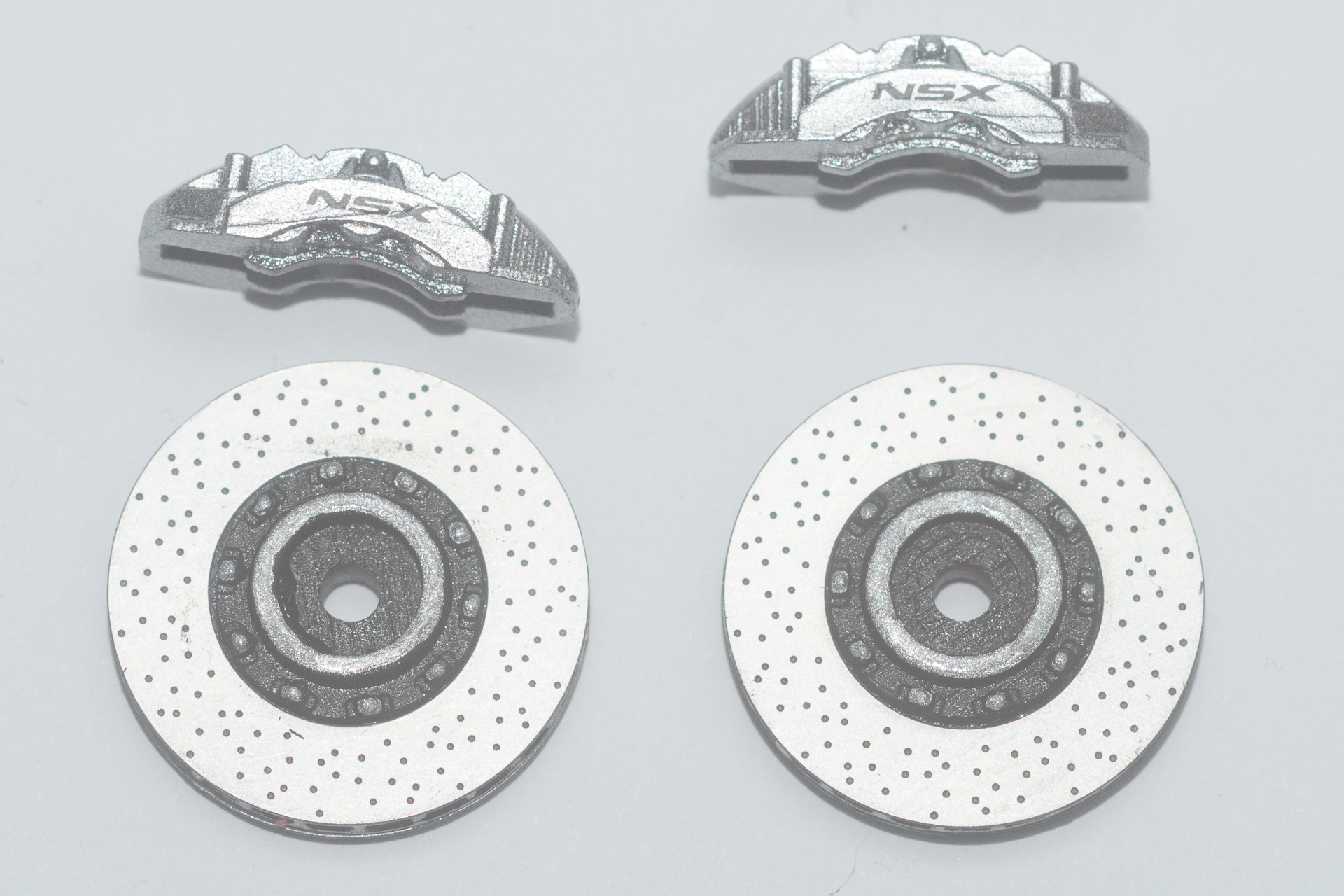

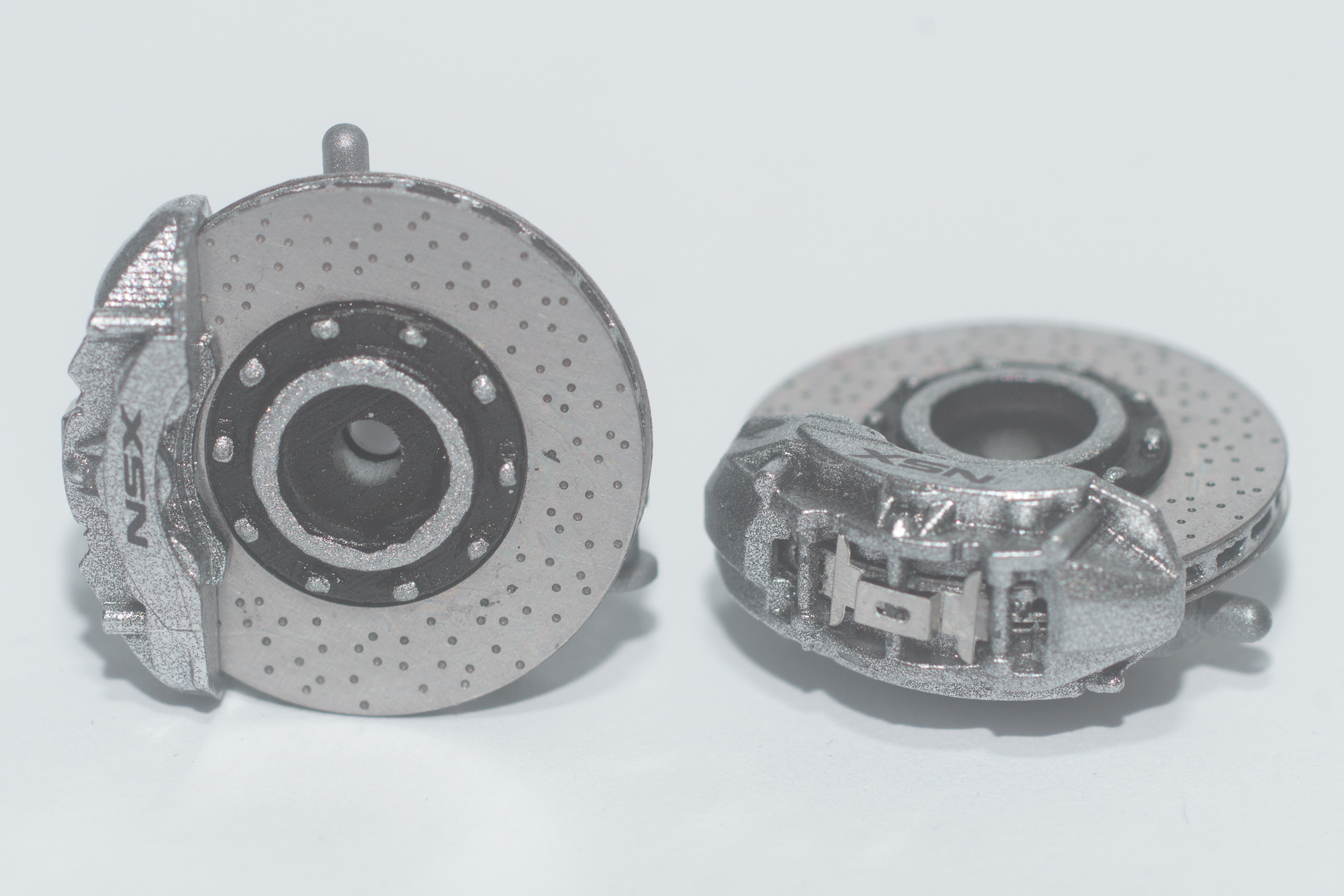

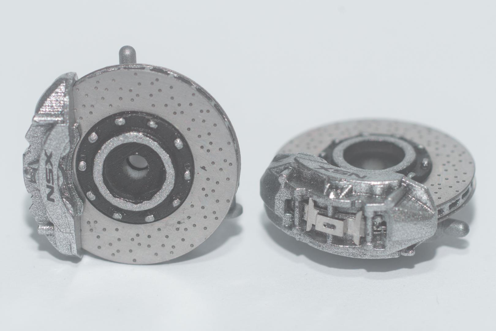

Finally I took the brakes out of the detail set and put them together.

Don't lose heart on the paint... with Zero Paints the transformation when you finally apply the clearcoat over the matt basecoat(s) can be dramatic. I used the Liquid Blue Pearl on my LFA, and it looked pretty uninspiring with the base colour and blue translucent topcoat on, but when I hit it with the 2K clear all the richness, depth and subtlety of the colour appeared, as if by magic!

Oh, I won't :) I'm quite sure, the paint will change after clearcoating. And I like the way it looks, even in case the greenish tint won't show, so I will be happy anyway.

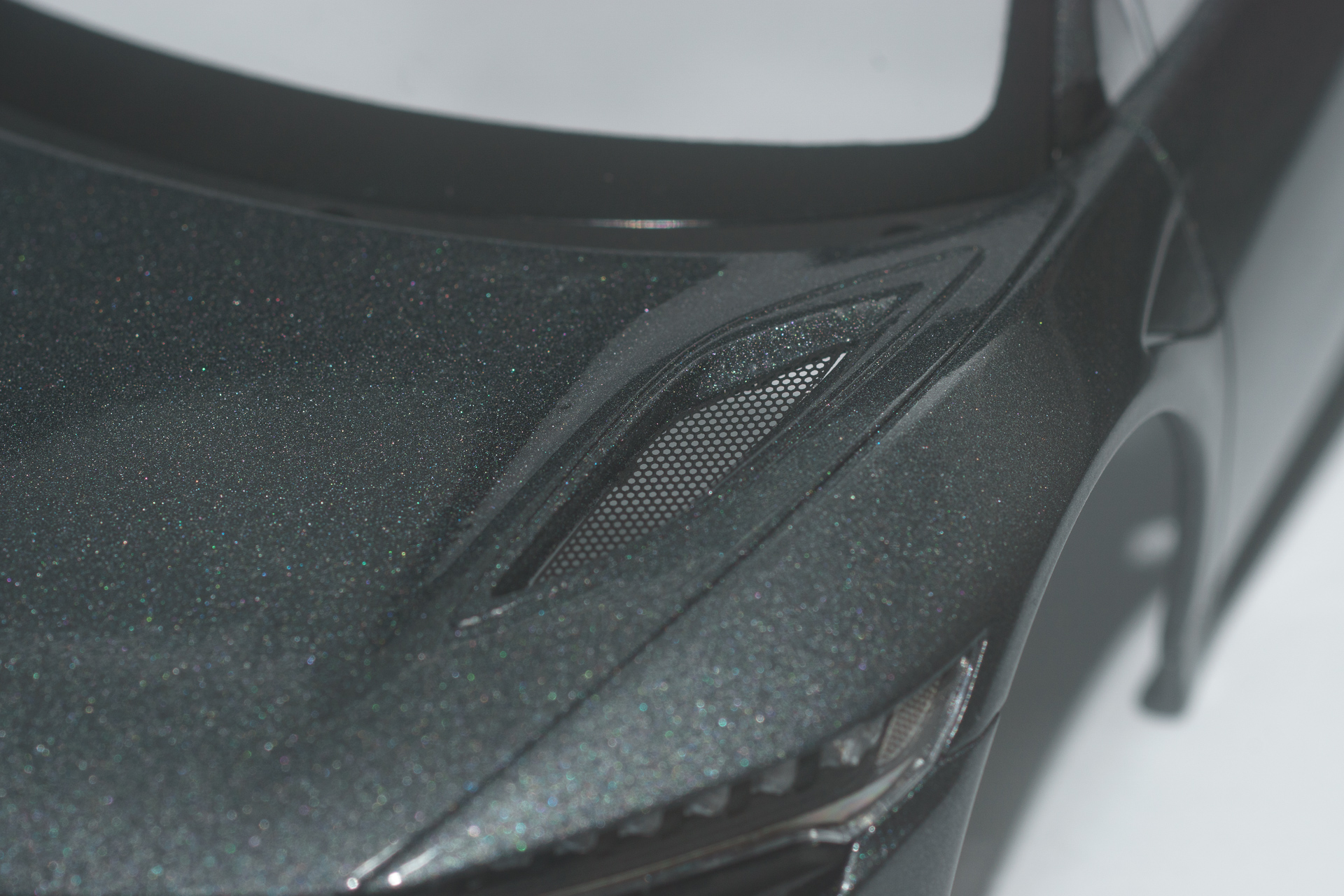

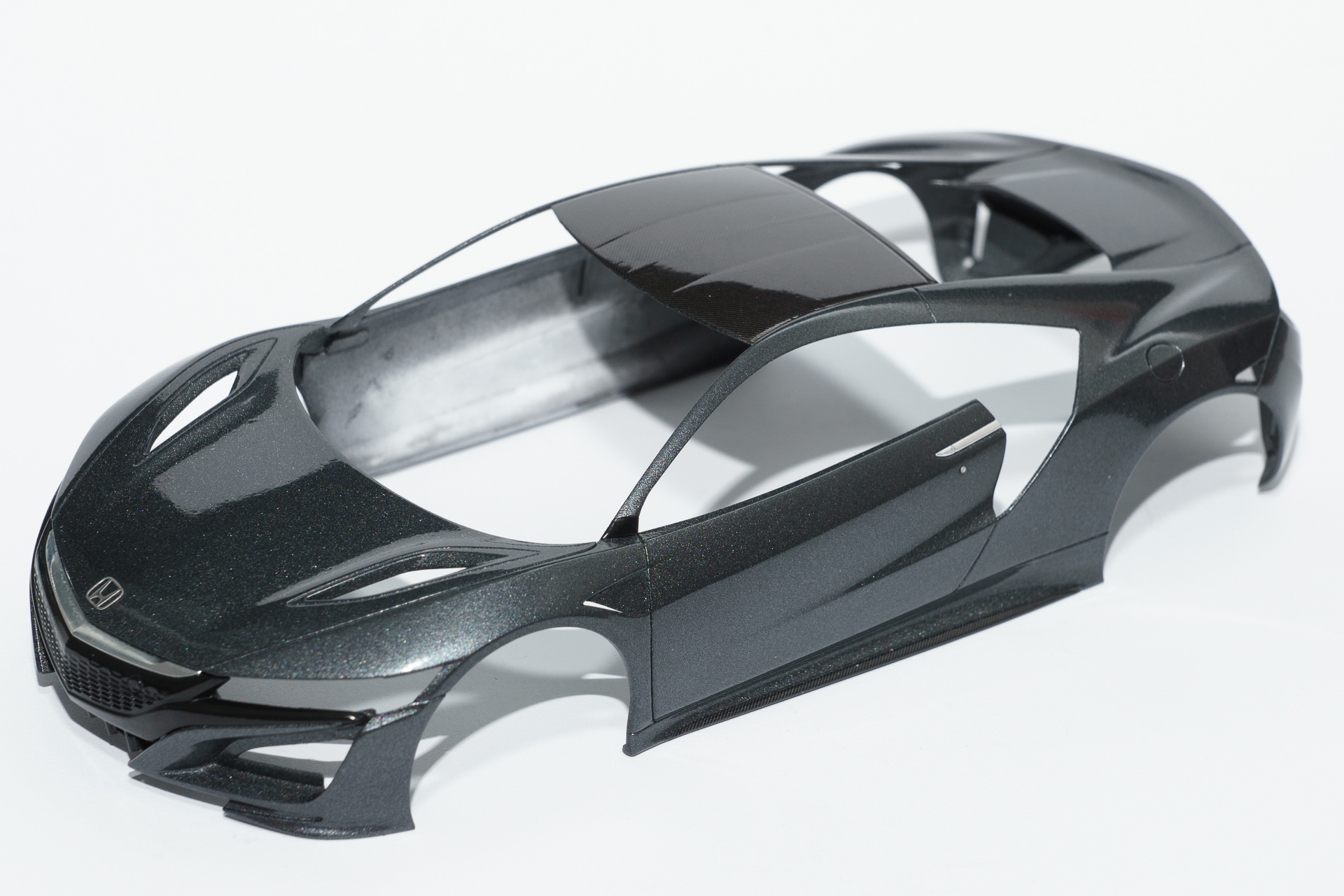

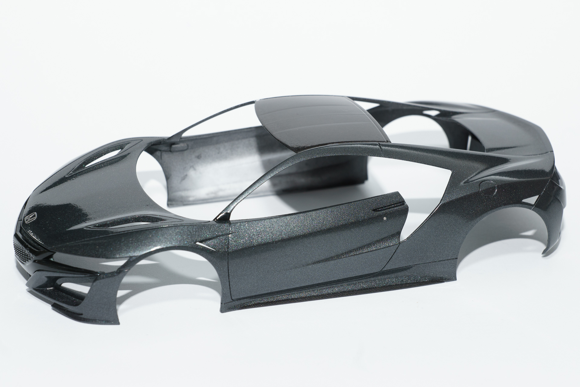

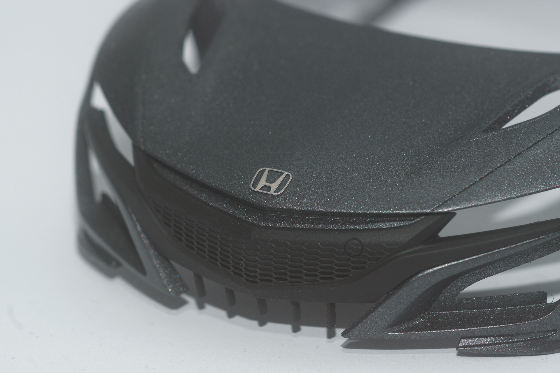

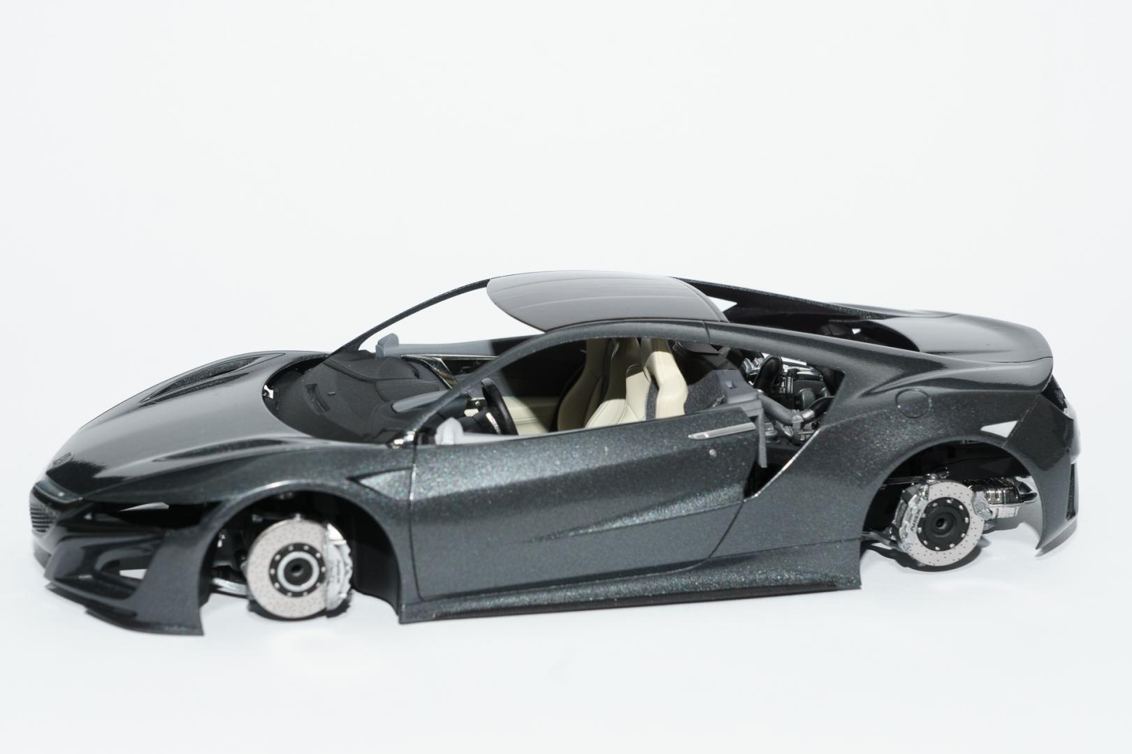

Finally I received the paints for the interior. But before switching to the progress made on the inside, let me first show you the body. After 16 thin coats of color, I decided to call it done. So I added the carbon decals on the roof and on the sides. Next friday I will apply the clear coat. Now you can sometimes already notice the greenish tint, as you can see in the following picture. Somehow I just got the right angle of light to make it show (the white spots visible here and there ist most likely just dust I didn't remove before taking the picture):

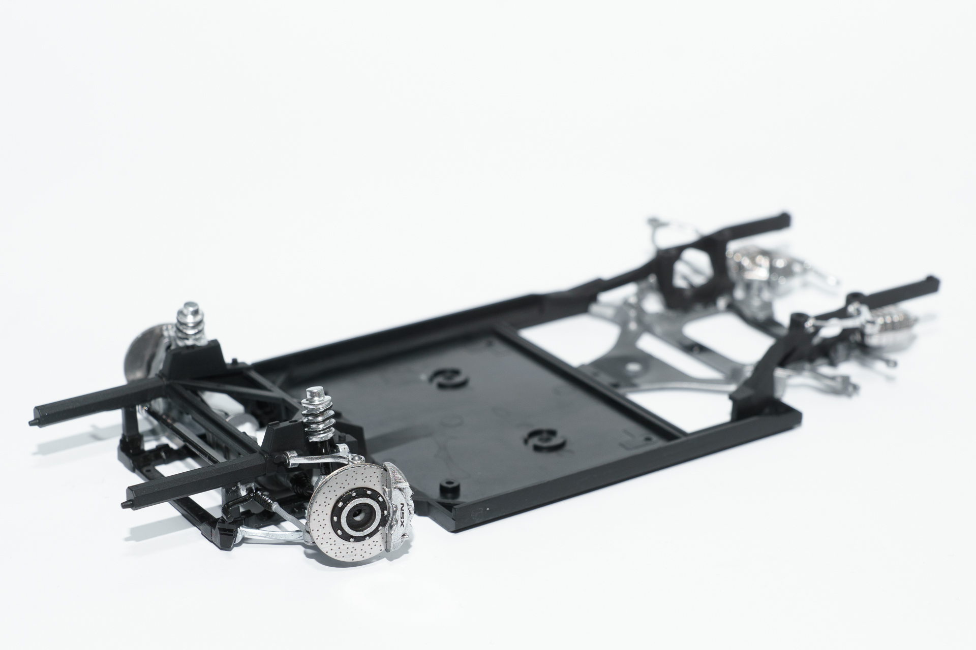

Also something already mentioned in my previous post are the front brakes which have been finished and put into place.

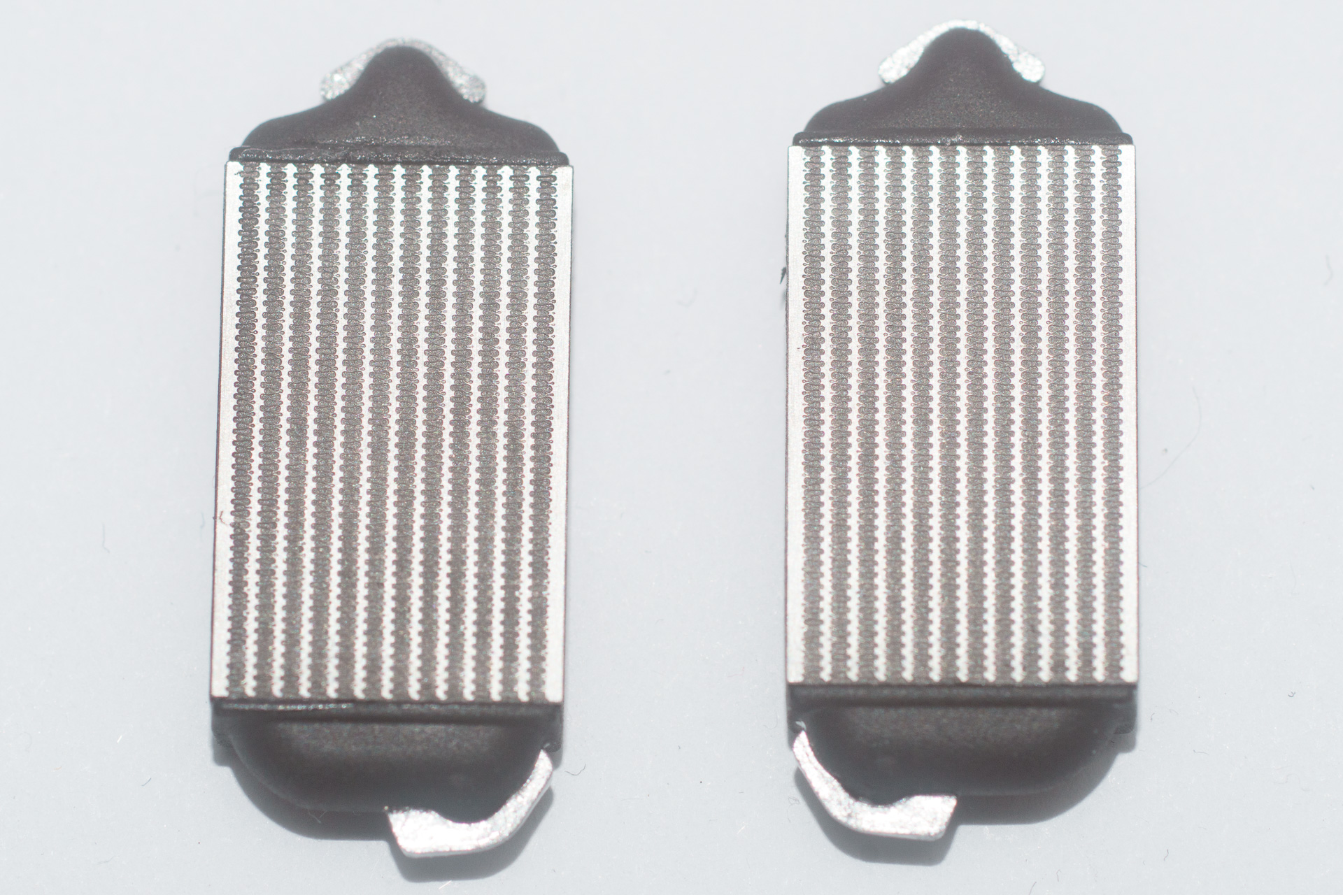

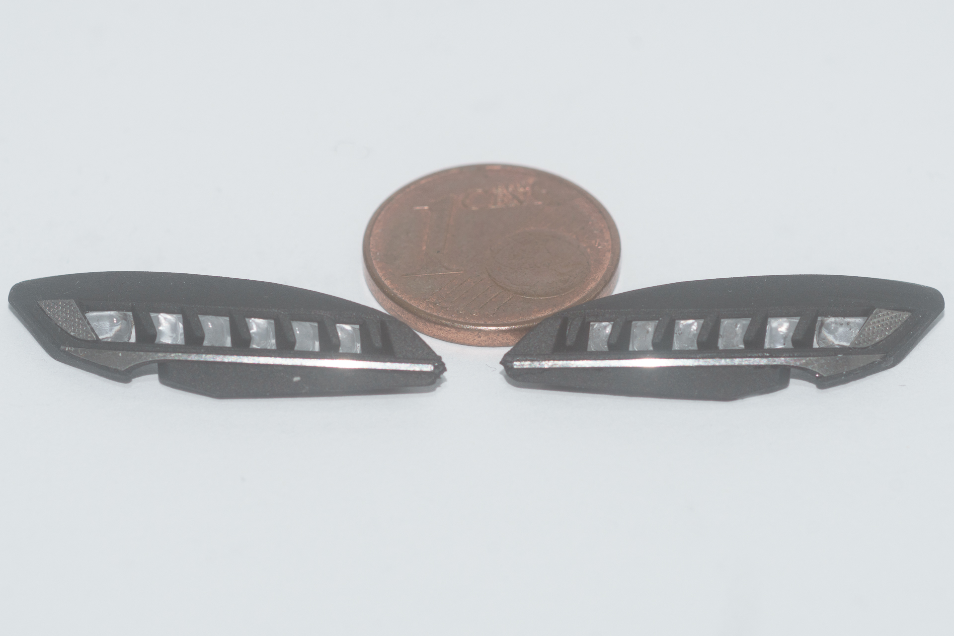

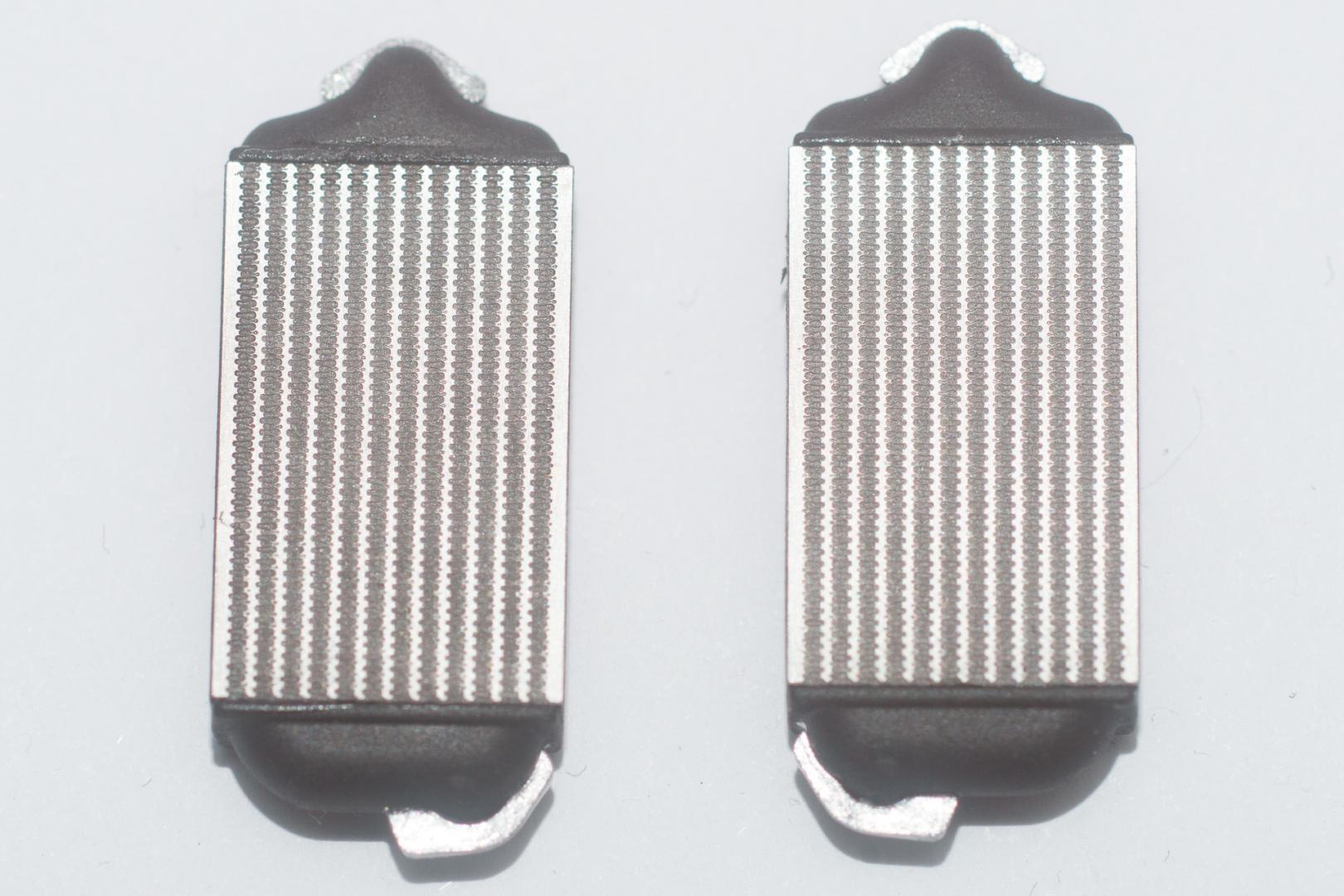

The intercoolers got their pe parts followed by a light washing.
The last carbon decals have been applied to the diffusor. That was definitely not my best carbon job, but as it is on the underside of the car, nobody will ever see it again, so I don't care that much.

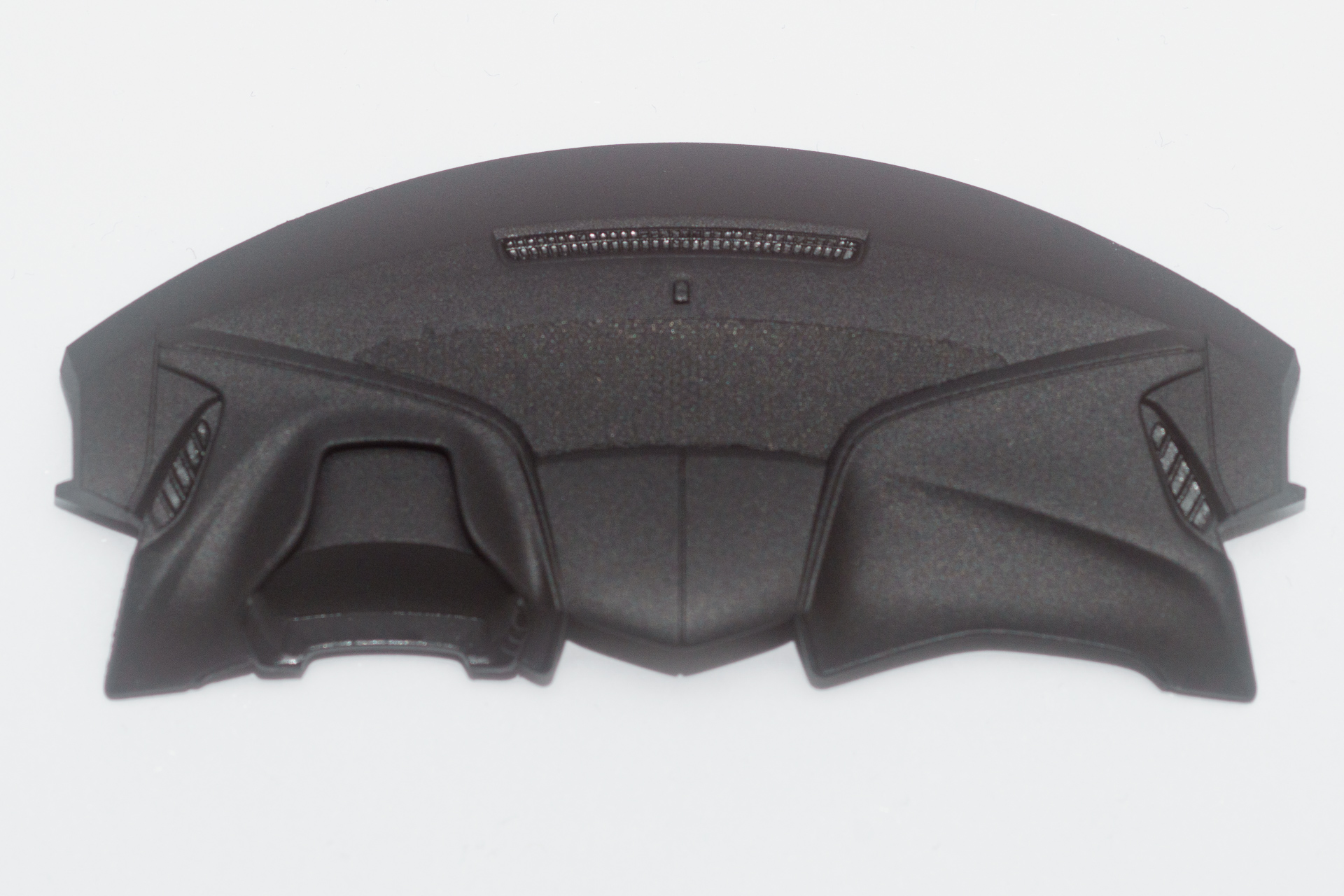

Some detailing on the dashboard.

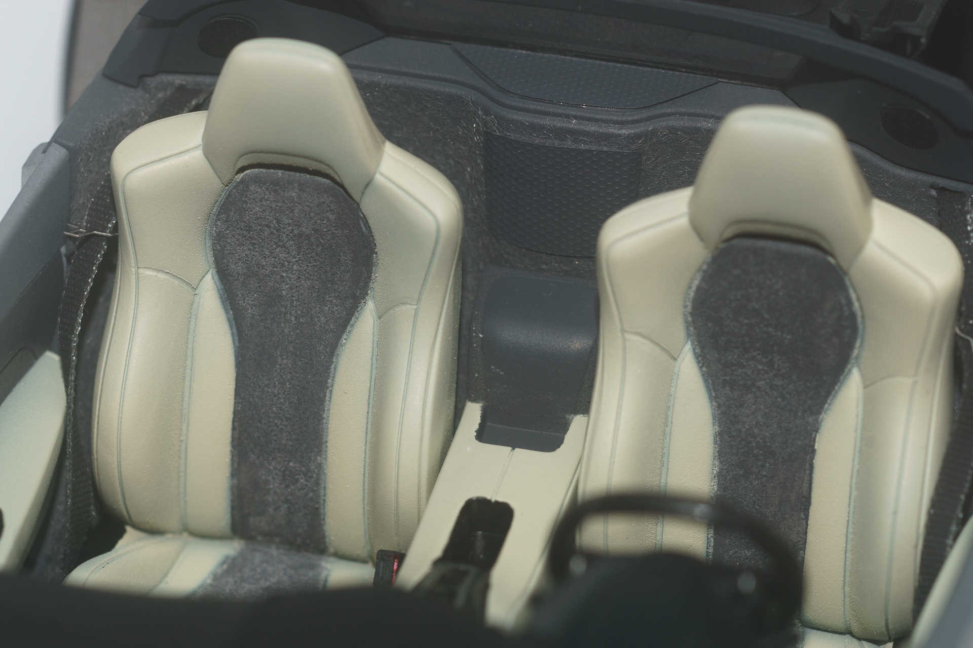

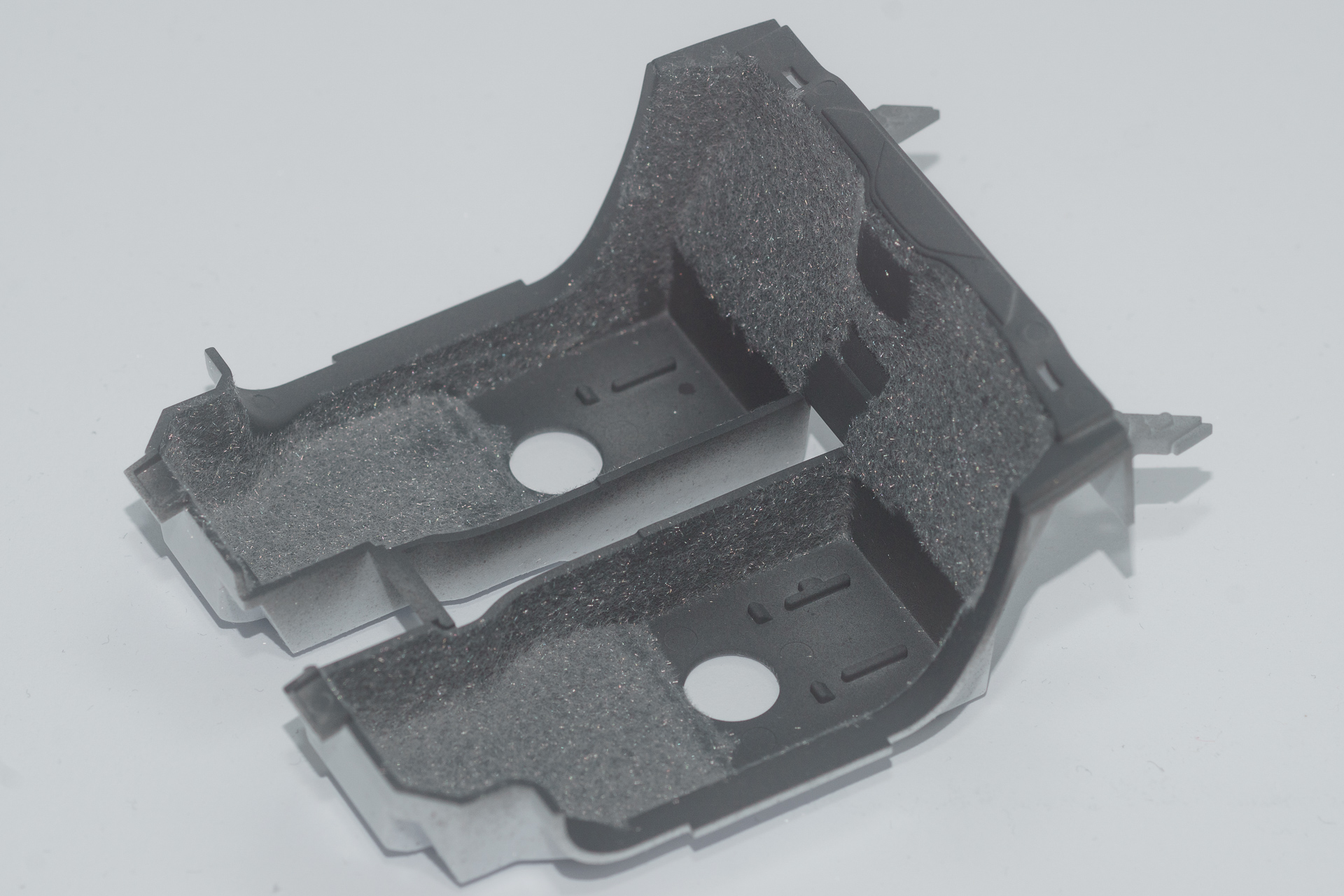

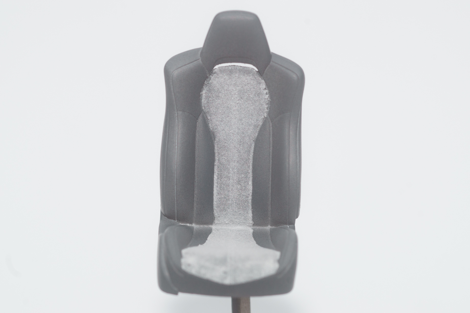

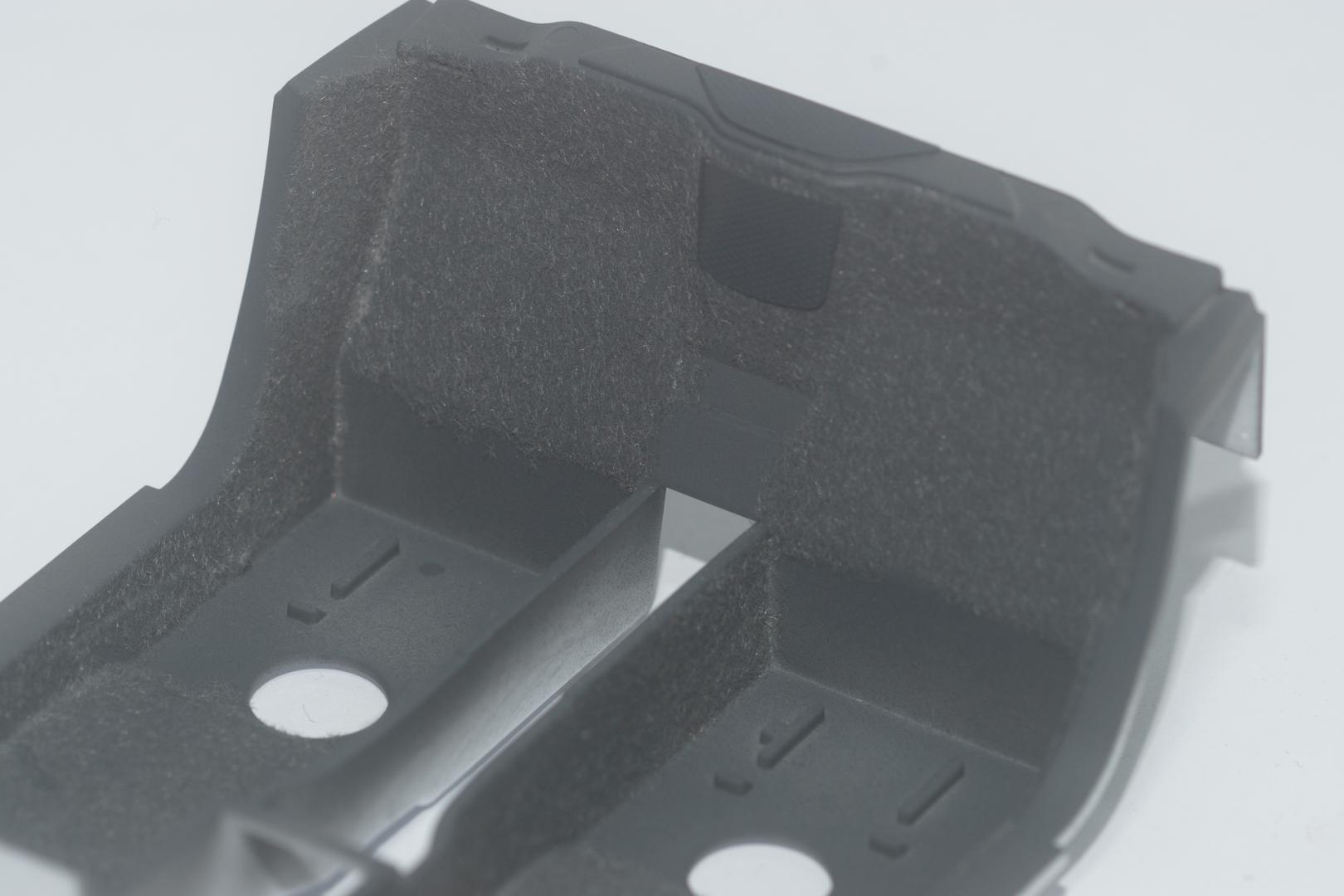

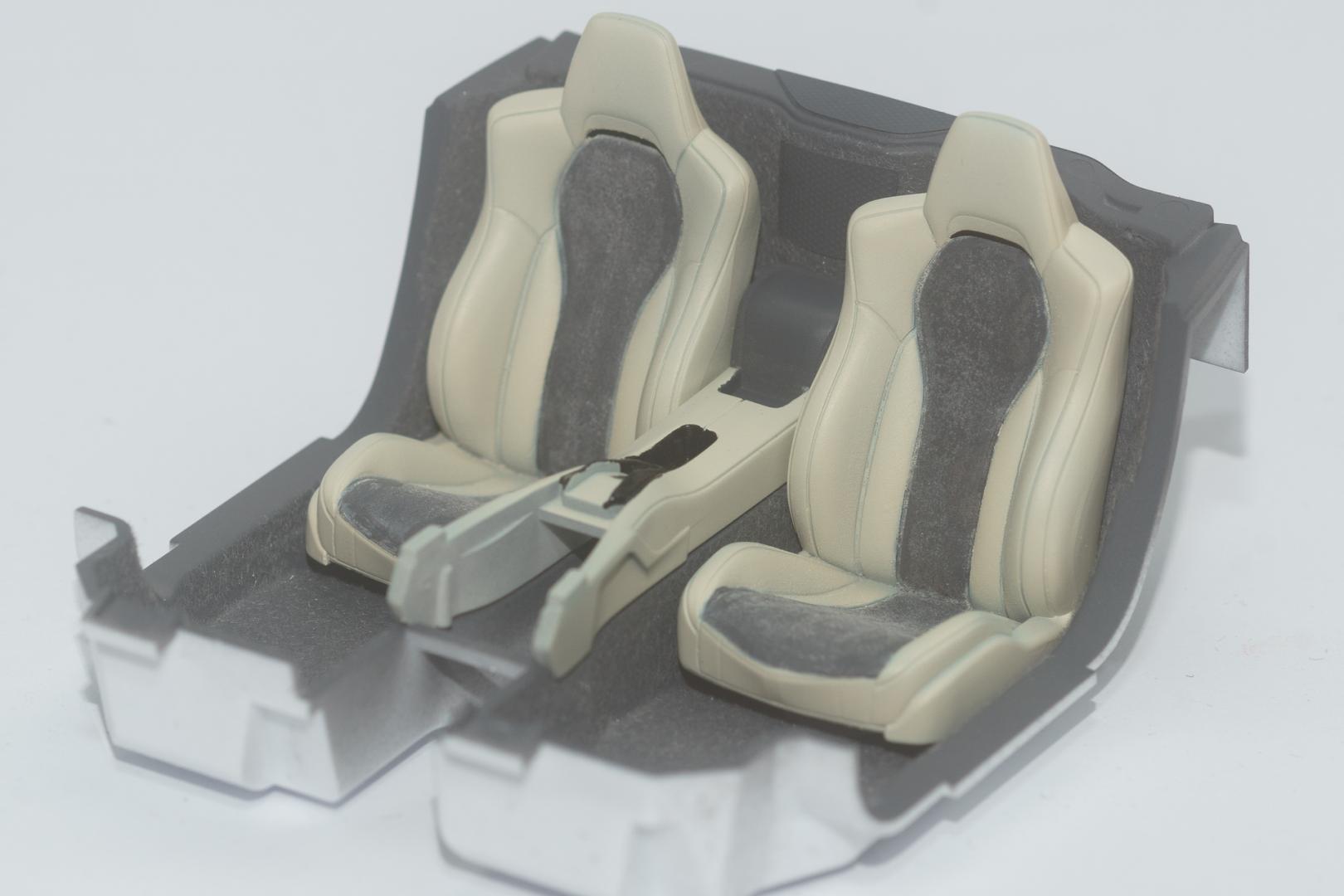

Today the interior tub has been primed and laquered. Afterwards I tried some flocking. Usually I have several nervous breakdowns when it comes to this point, because I never seem to get it right. But today, for the first time in my modellers life, I am really happy with the outcome :) When the glue has thorougly dried, I will mist another coat of the interior color.
Because the flocking went so well, I thought I could spin the wheel of fortune and try applying some micro ballons on the seats. Somehow this must have been my lucky day :D

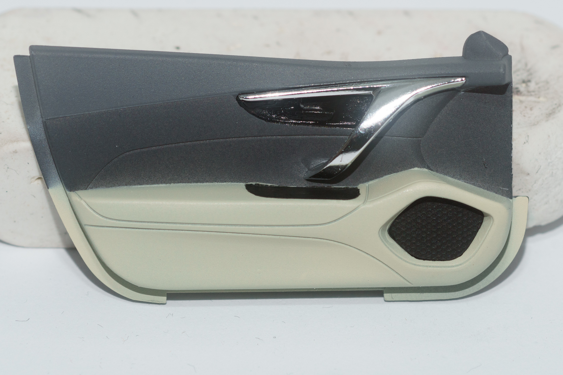

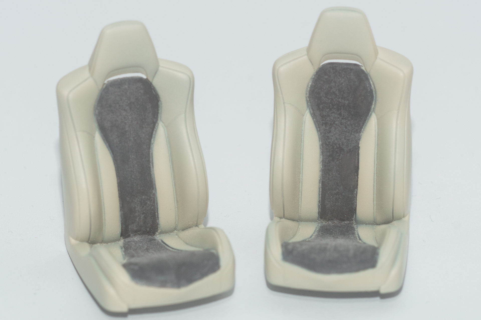

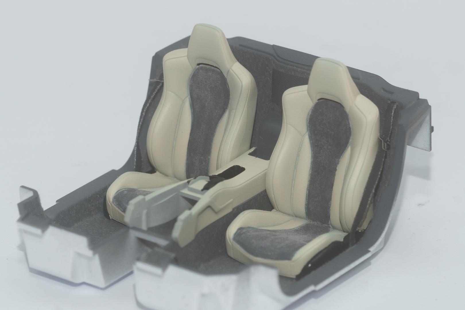

Over the past weekend I found time to continue with the interior. The Cream interior color by Zero Paints turned out to be much more yellow than expected, but in my opinion it fits quite well with the body color, so I will leave it as it is :)
First I (almost) finished the seats. When masking off the middle part I was afraid, the microballons would come loose when removing the tape. But to my surprise they stick really good to the seats. I only had to touch up a few spots I already had some problems with the adhesion before masking. In these cases I just put on some new microballons and applied Zero Paint's interior color by brush. By dabbing it on it worked out quite well :)

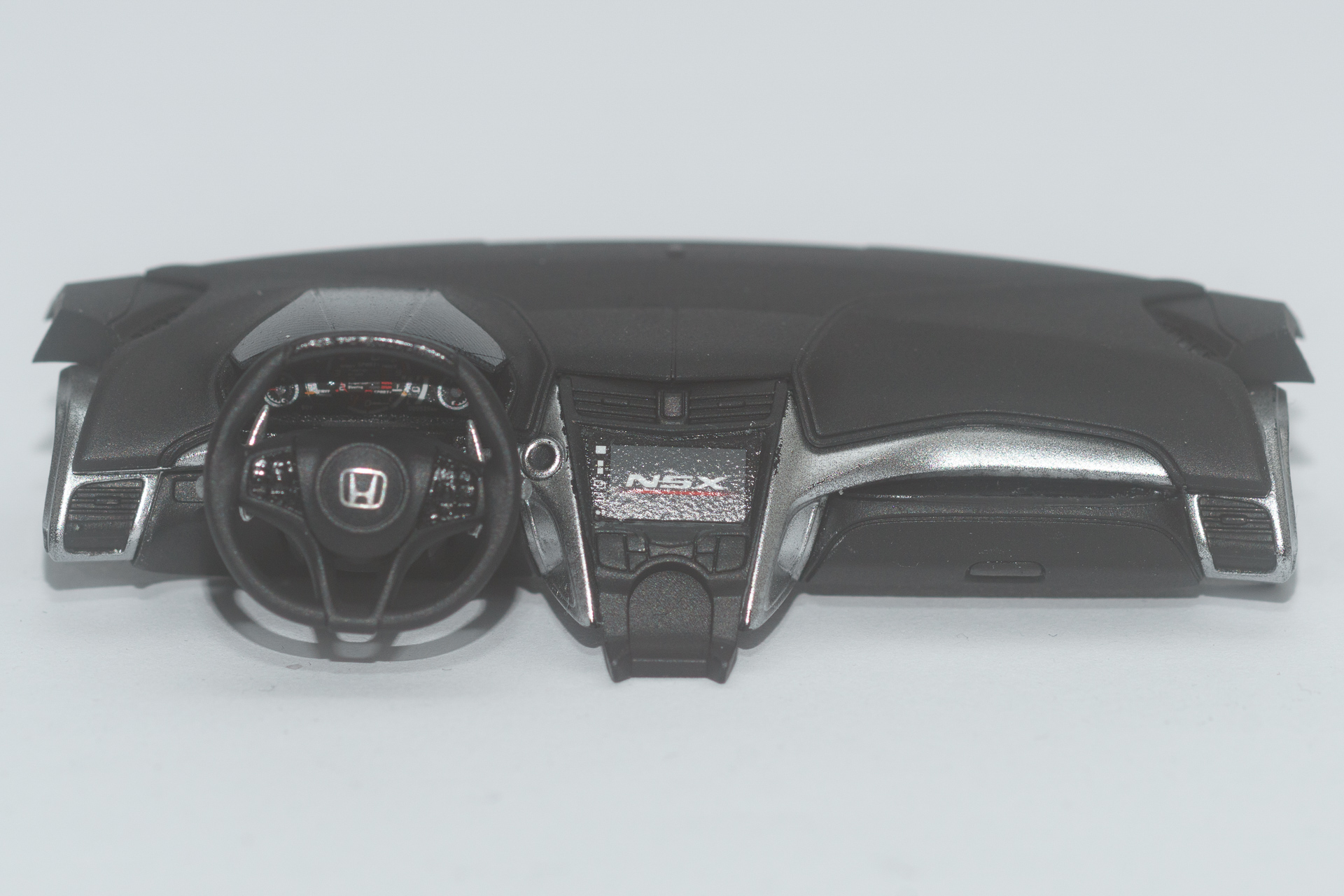

The dashboard has been completetd as well, as far as I could put it together already.

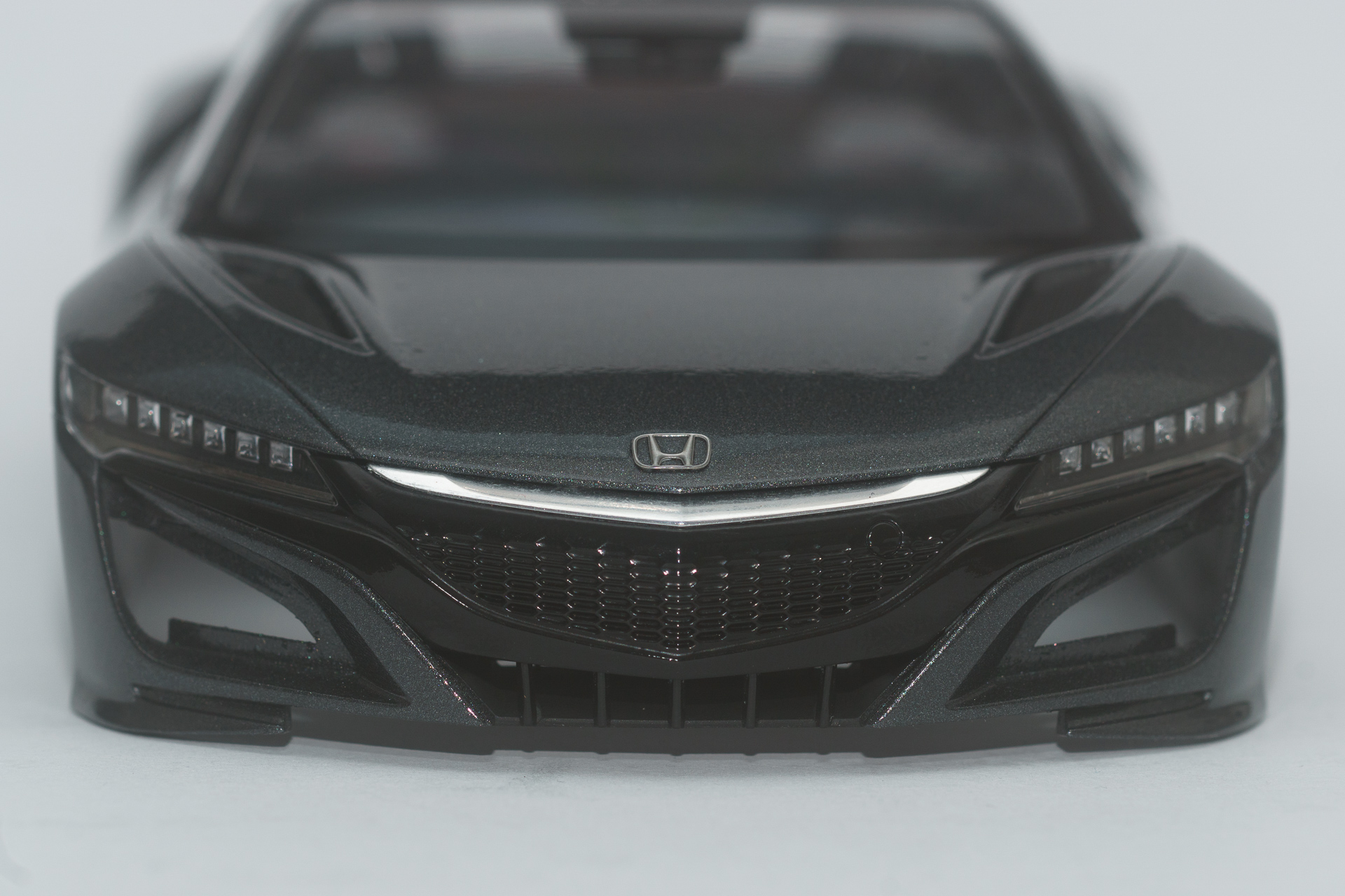

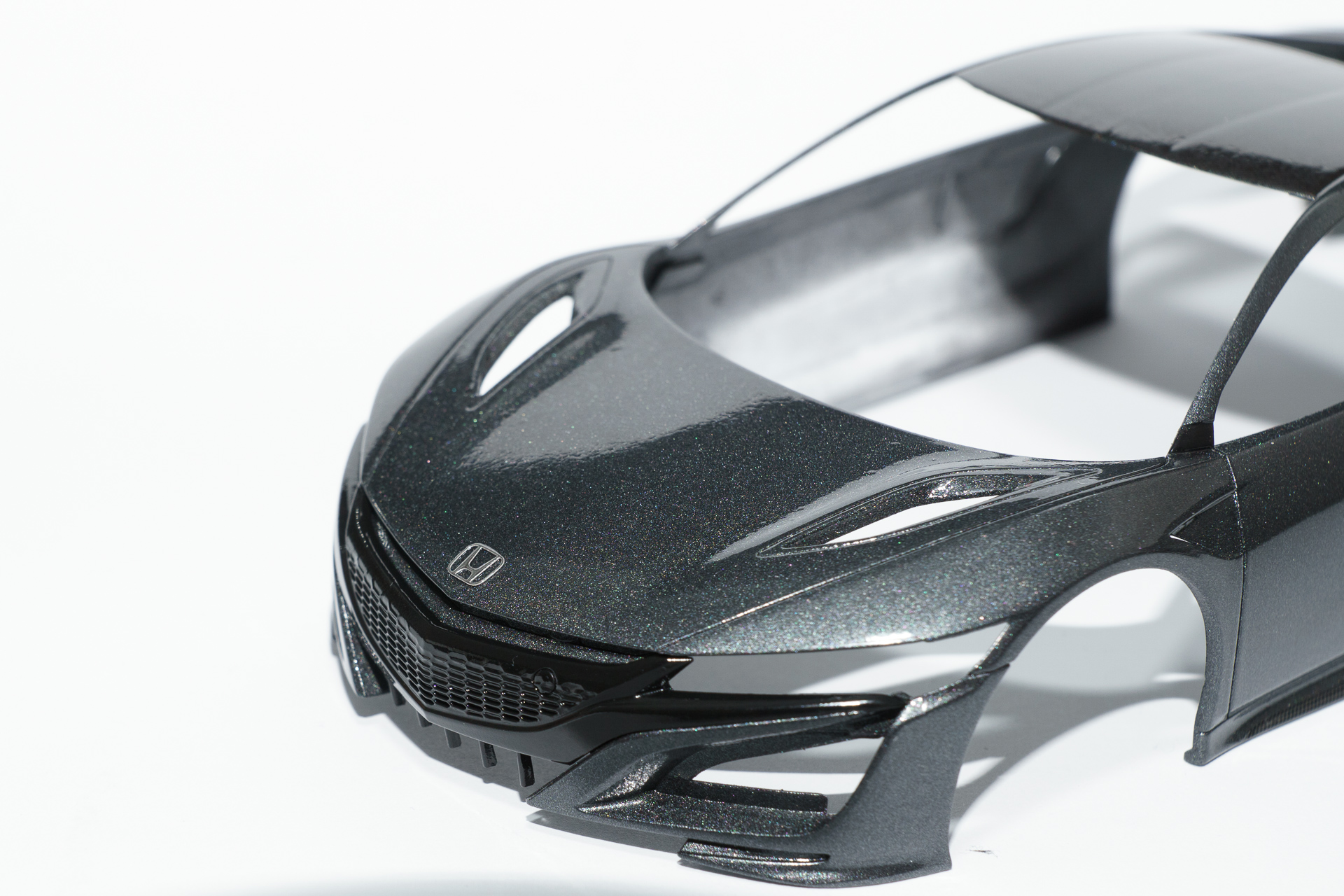

And finally the front of the body was completed, so I can put on the clear on friday.

Amazing looking build! It is really turning out well. I like the microballoons idea on the seats. I'll have to use that idea on a build. Can't wait to see it with the clear coat on.

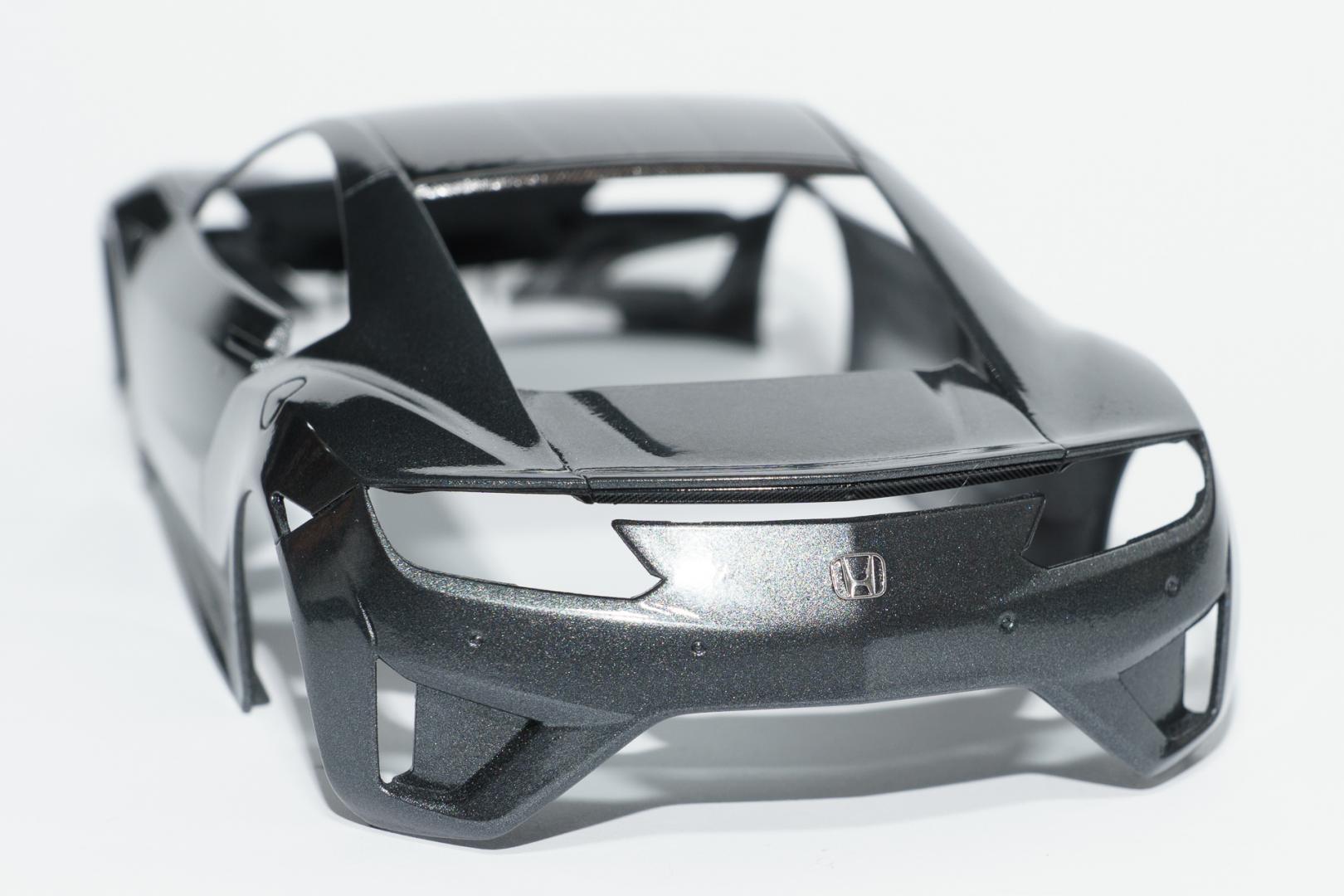

That made at least two of us then. As announced in my last post, friday was clearcoat-day. Unfortunately the clear did not come out as smooth as I wanted it to be. So today I spent the whole evening sanding and polishing the body. All the time I was unsure whether there was still some orange peel left or whether it was just an optical illusion because of the metal flakes in the paint. After having made the pictures for my WIP, I know there is still quite heavy orange peel. I did not decide yet, whether I will go on with that or whether I should start over sanding and polishing.

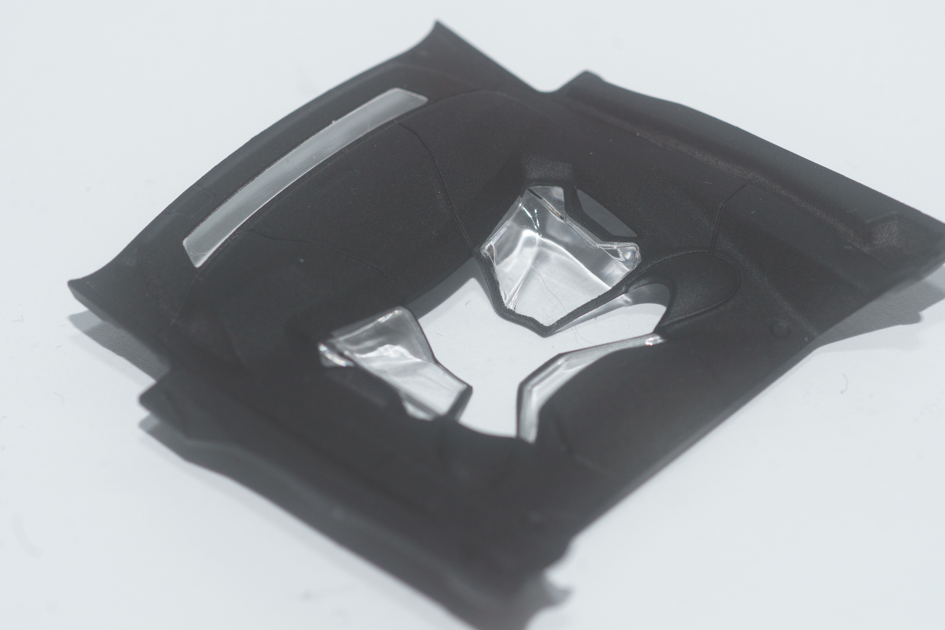

At least the interior comes together the way it is supposed to :)

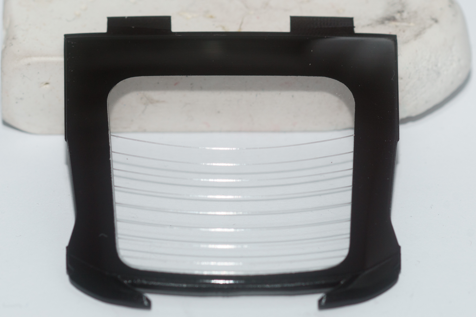

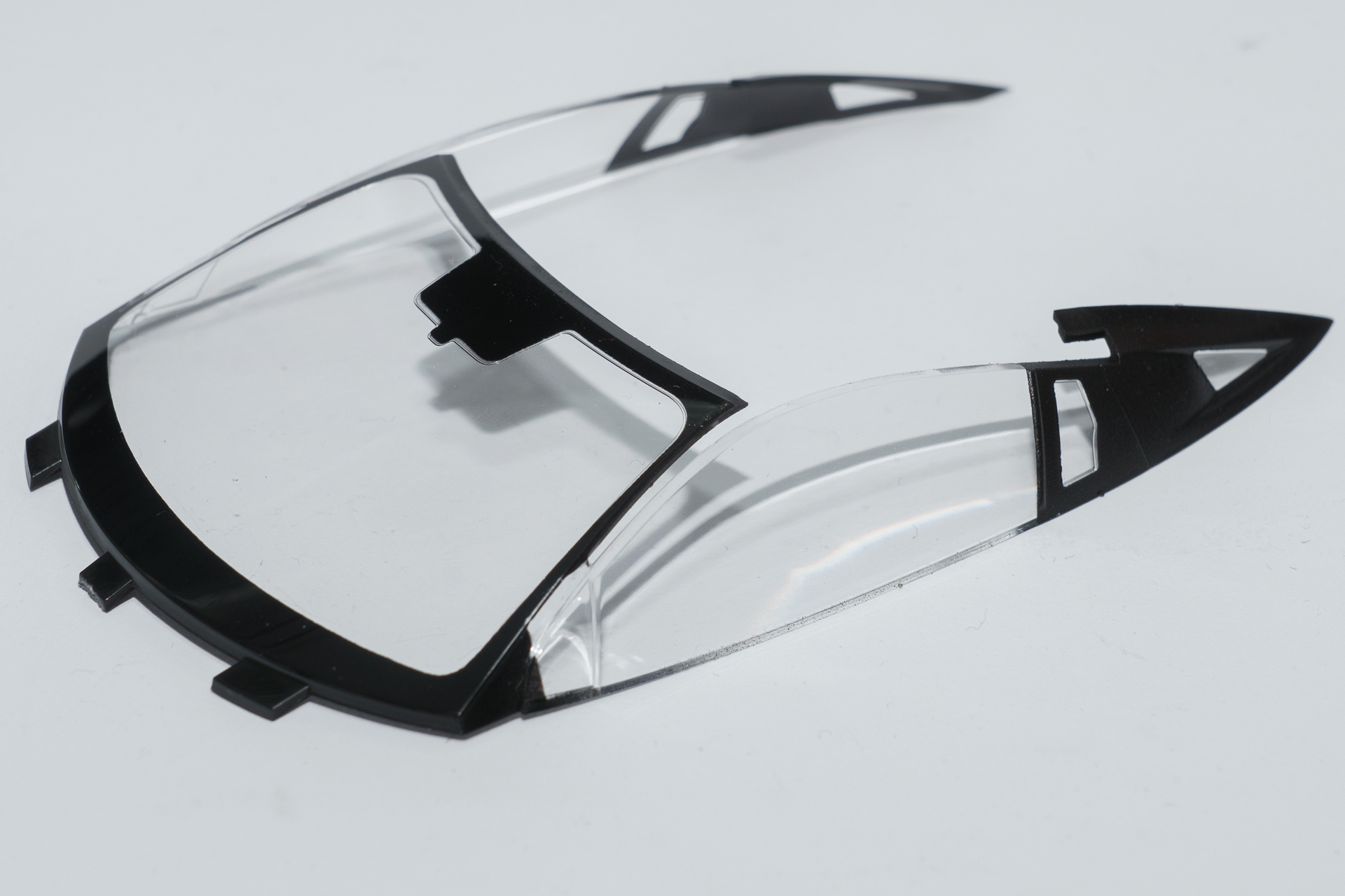

And finally the clear parts got their black paint

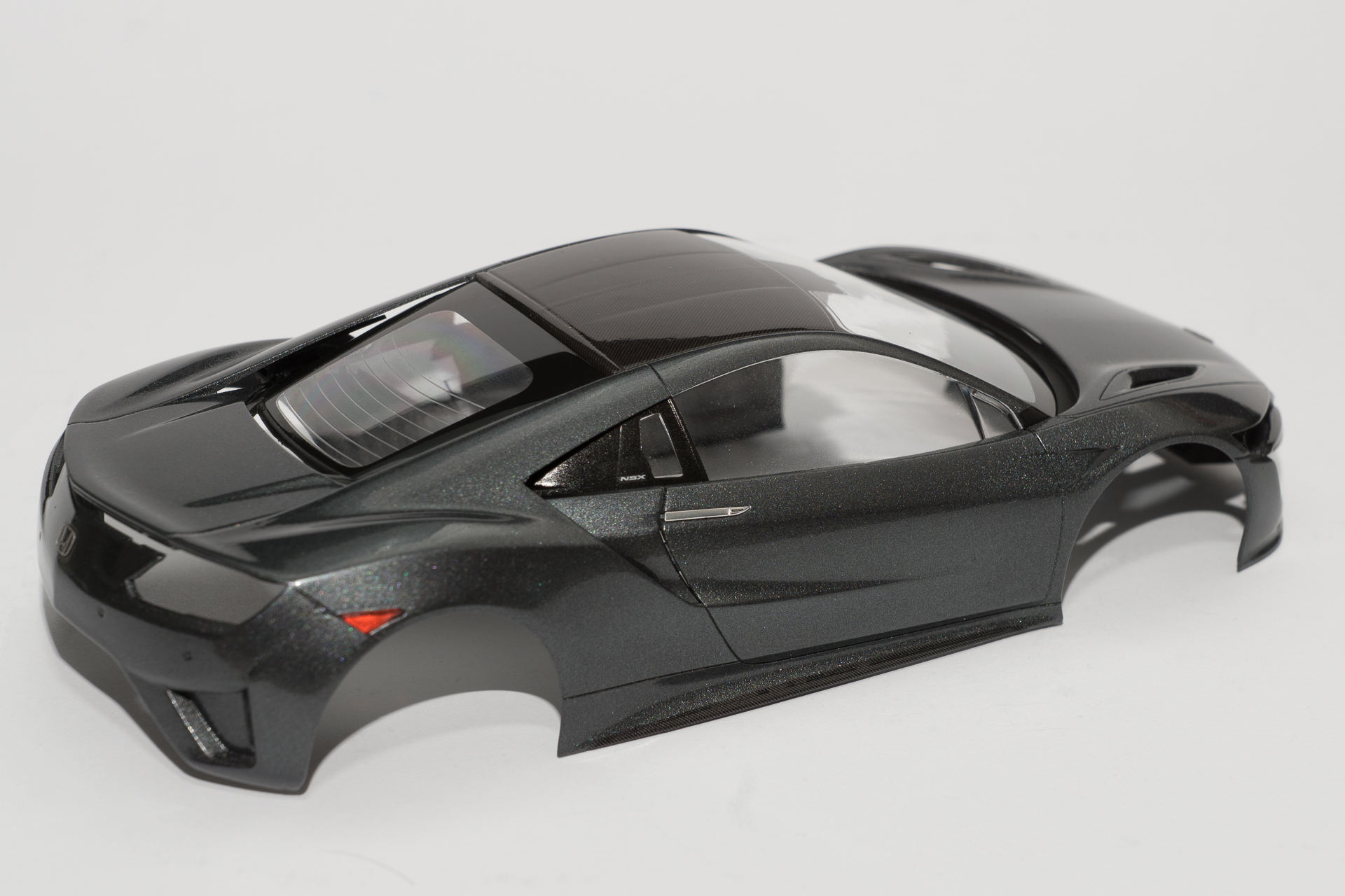

The passenger side and the front hood have been sanded (from 2000 up to 12000 grit) and polished a second time but with no big difference to the rest so I decided to leave the body as it is now. After adding the chrome parts, the body has been waxed with Tamiya's Modelling wax. Apart from the PE parts, the windows and the mirrors the body is almost complete now. Only one part on each side is missing (directly behind the doors). These parts have been prepared today, now I'll let the glue dry and tomorrow they will be added.

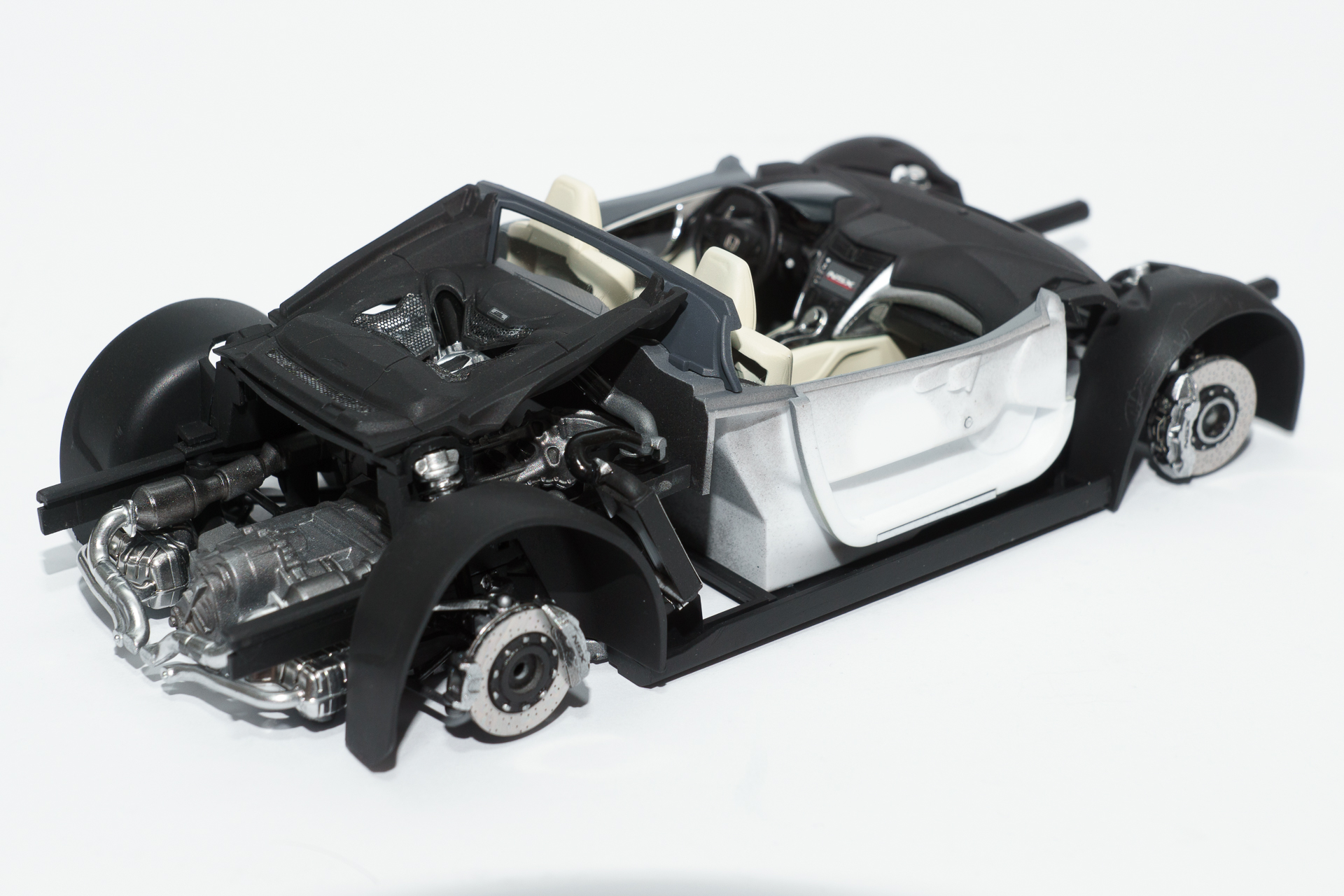

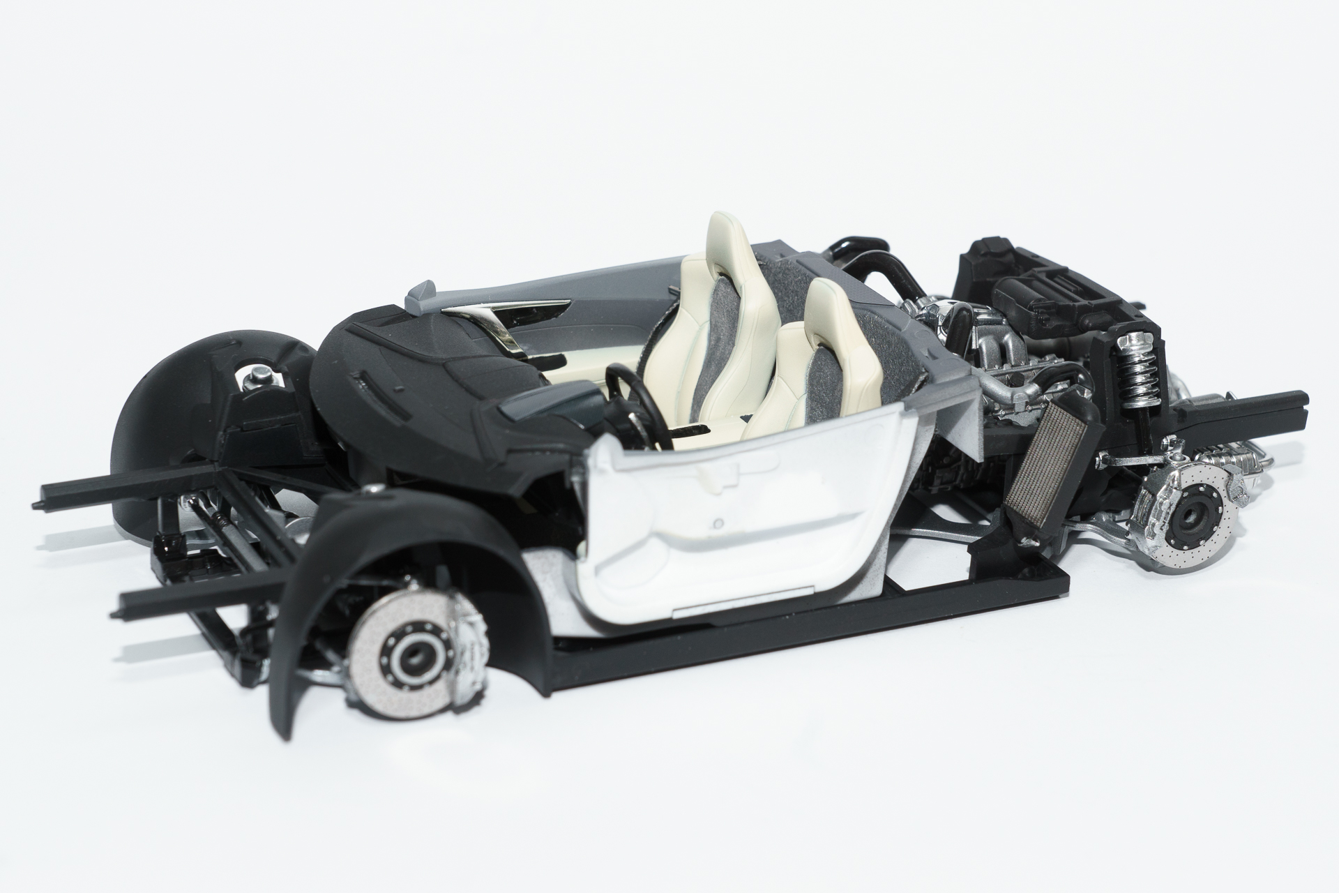

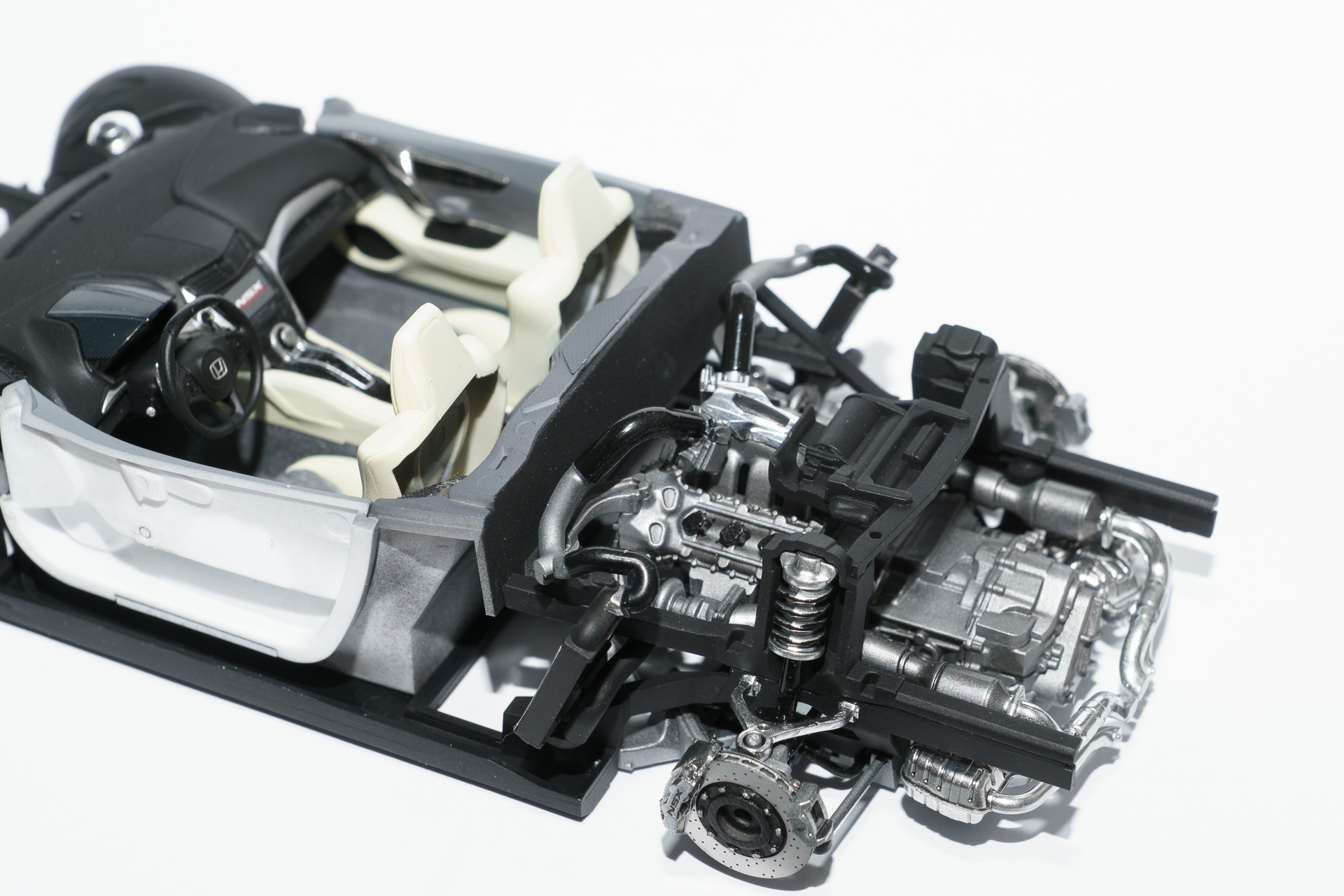

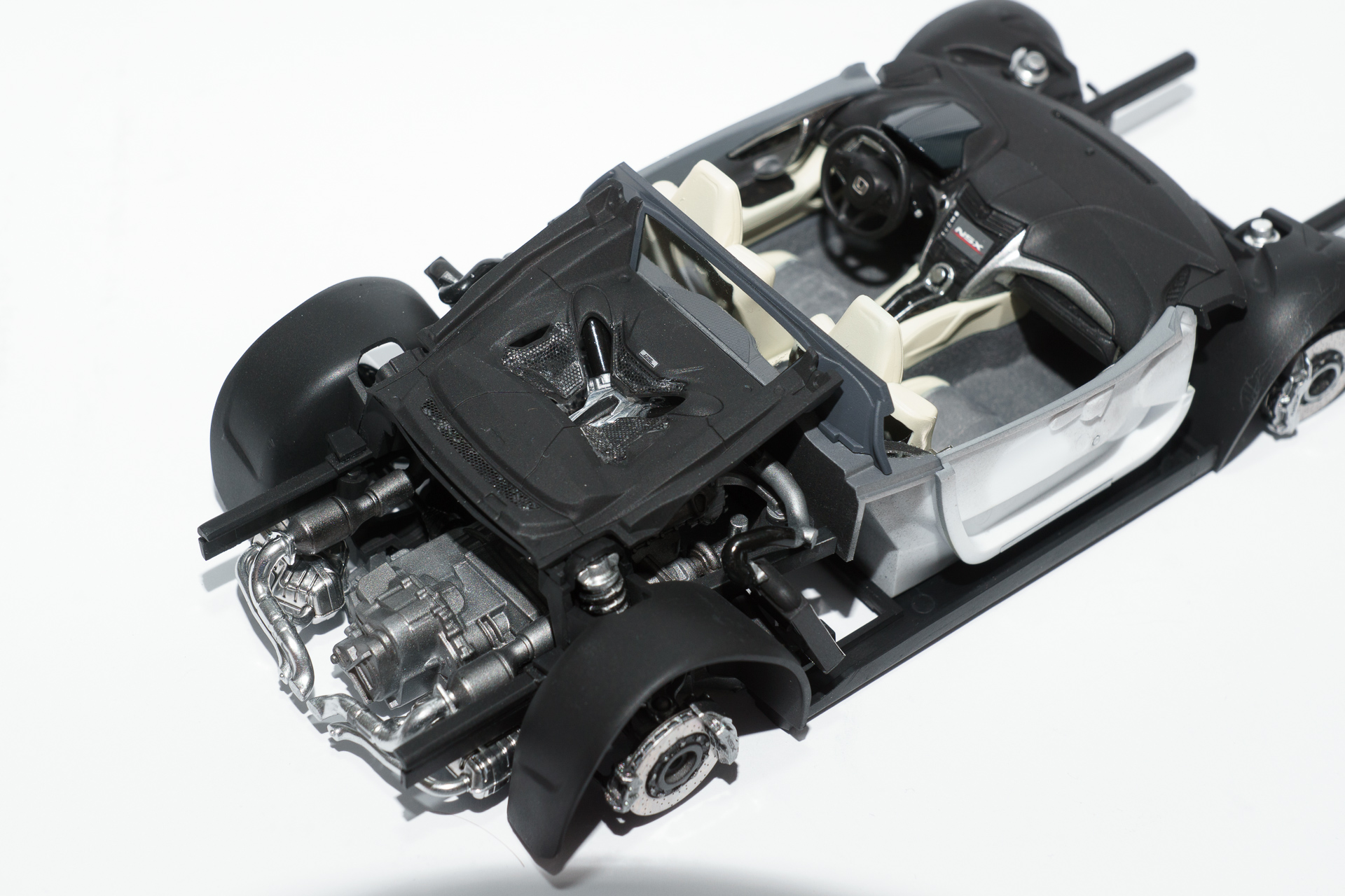

The engine and the rear suspension were put into place. Once again the high quality of this kit showed when all the parts just slipped into position without any problems.
_DSC2928_20190709_mbk.thumb.jpg.3d36b32b140f5680bbf3c13f3be70854.jpg _DSC2929_20190709_mbk.thumb.jpg.01441f3c53aae45c8eaebdc54470121d.jpg

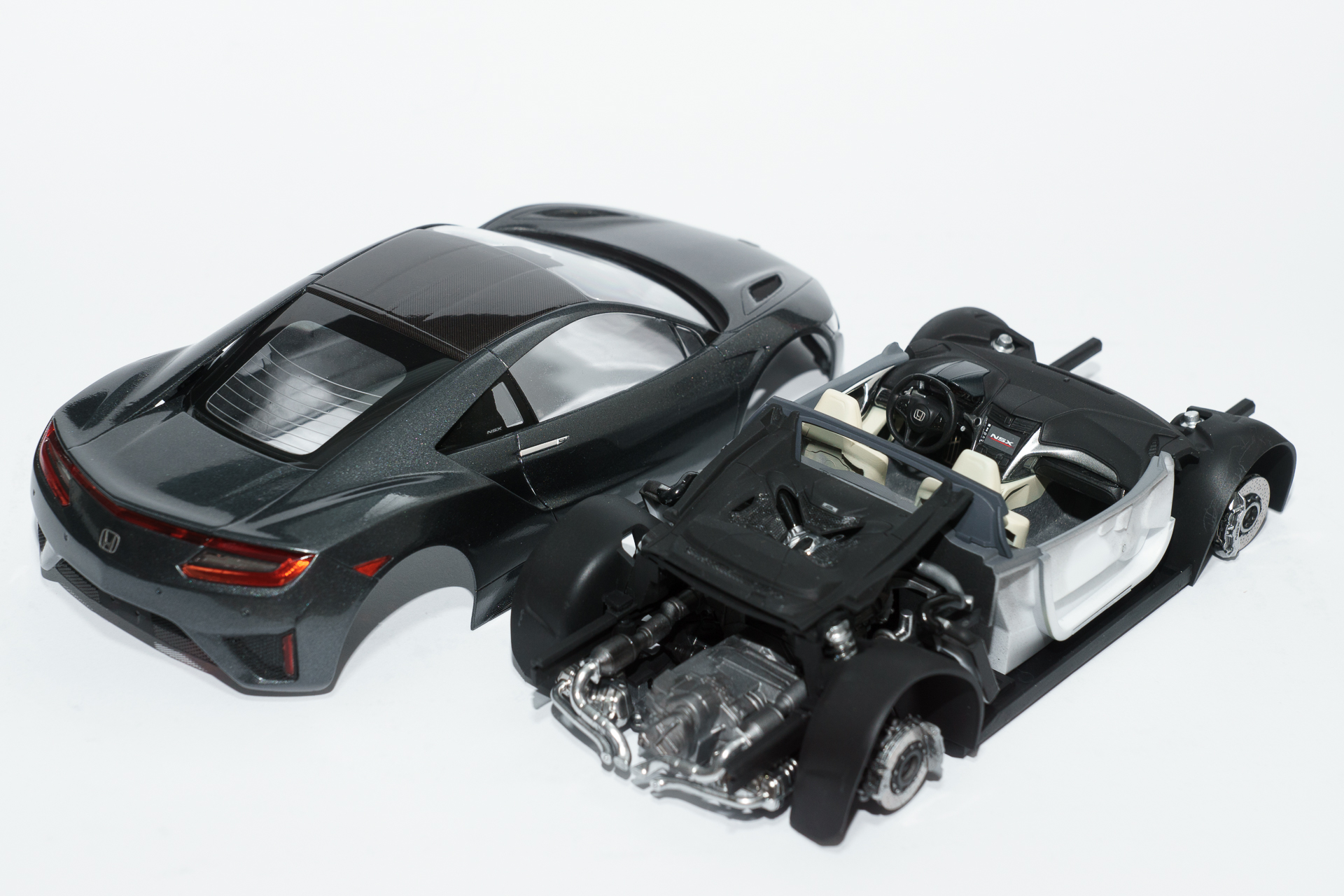

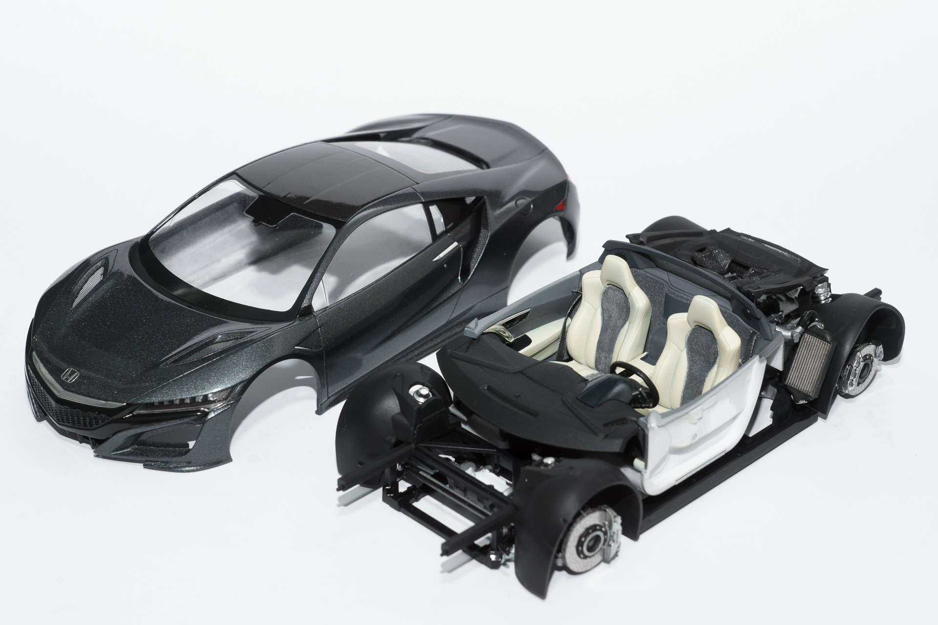

Another test fit of body and chassis to see where the journey is about to end. Again everything comes together nice and smooth. I think for the final assembly absolutely no glue will be required.

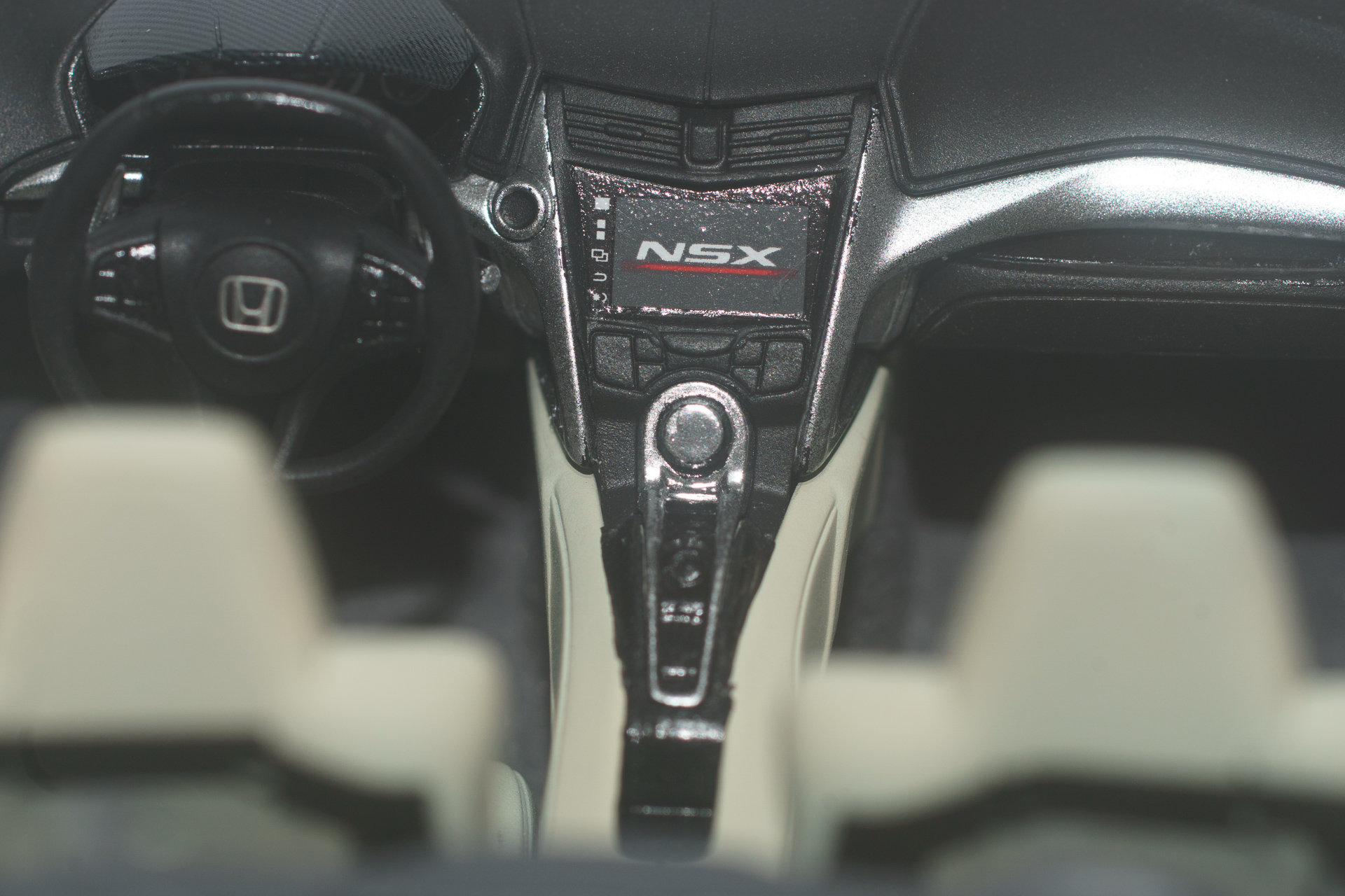

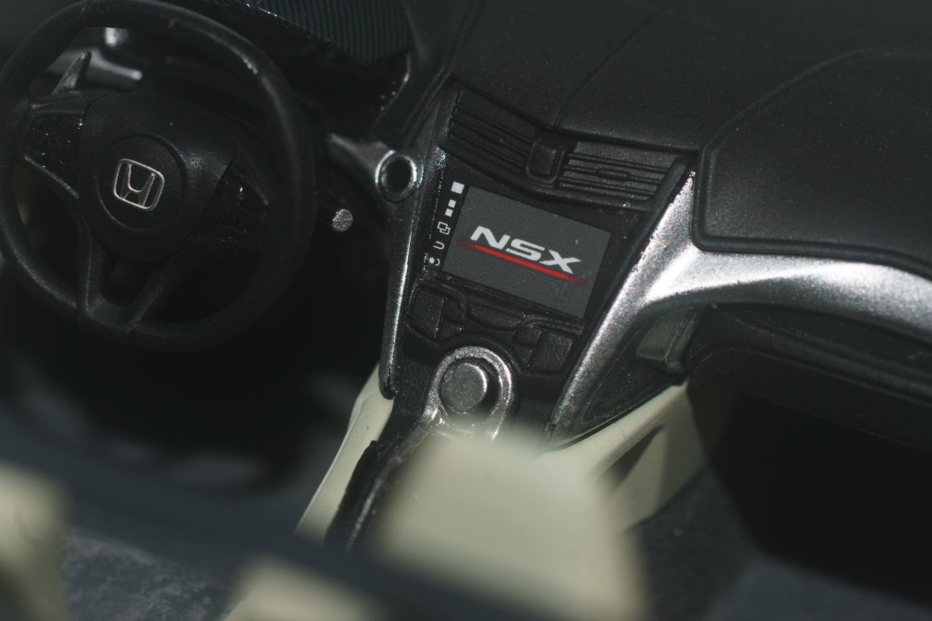

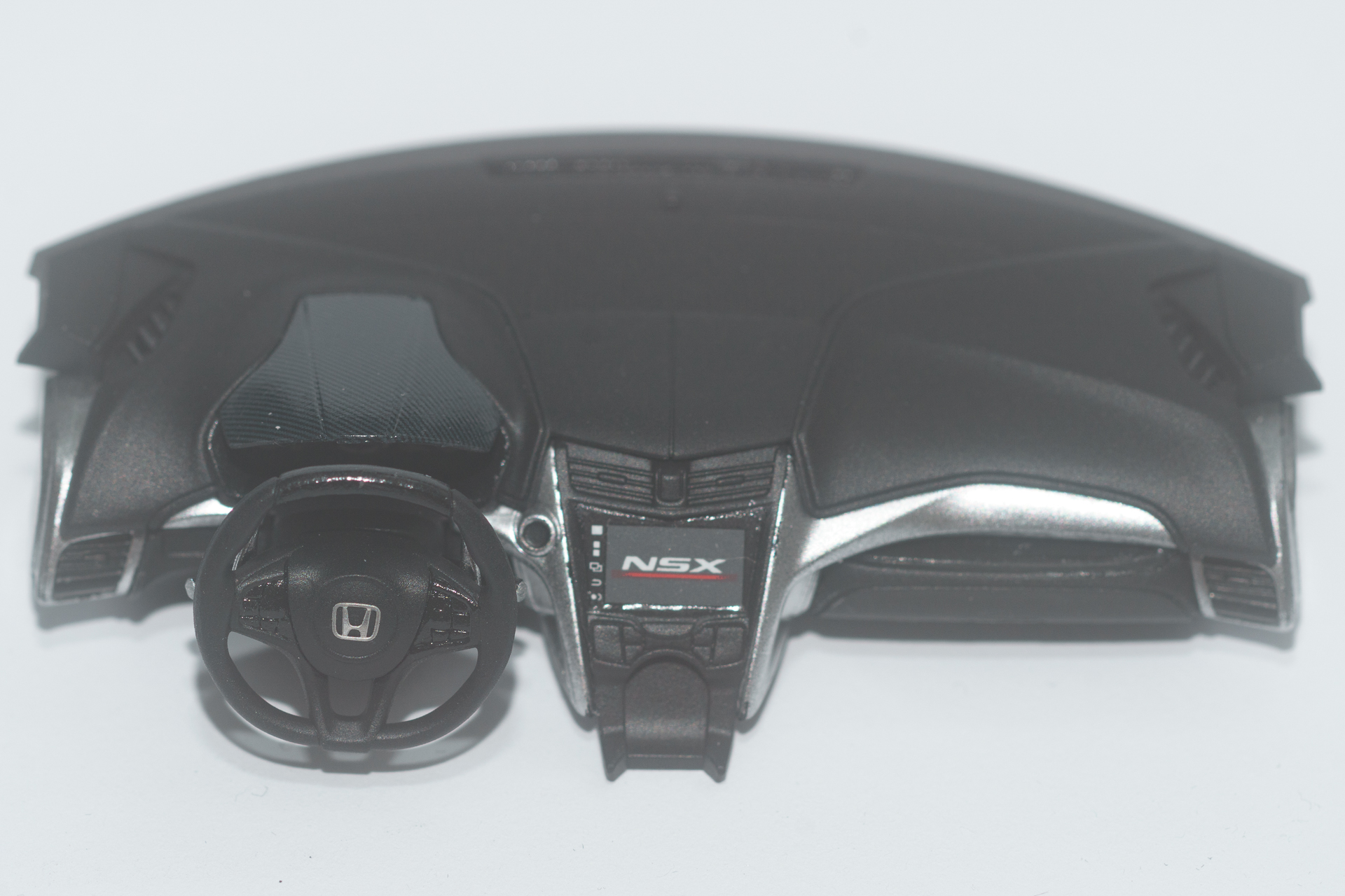

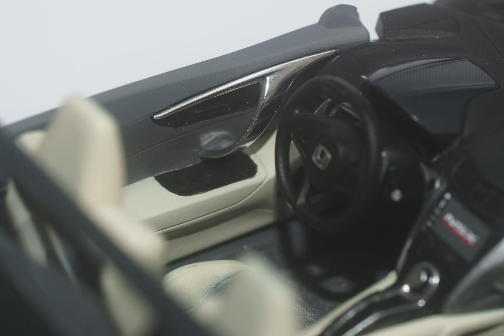

Before the interior gets inside and won't ever be seen, here a detail picture of the dashboard and the center console.

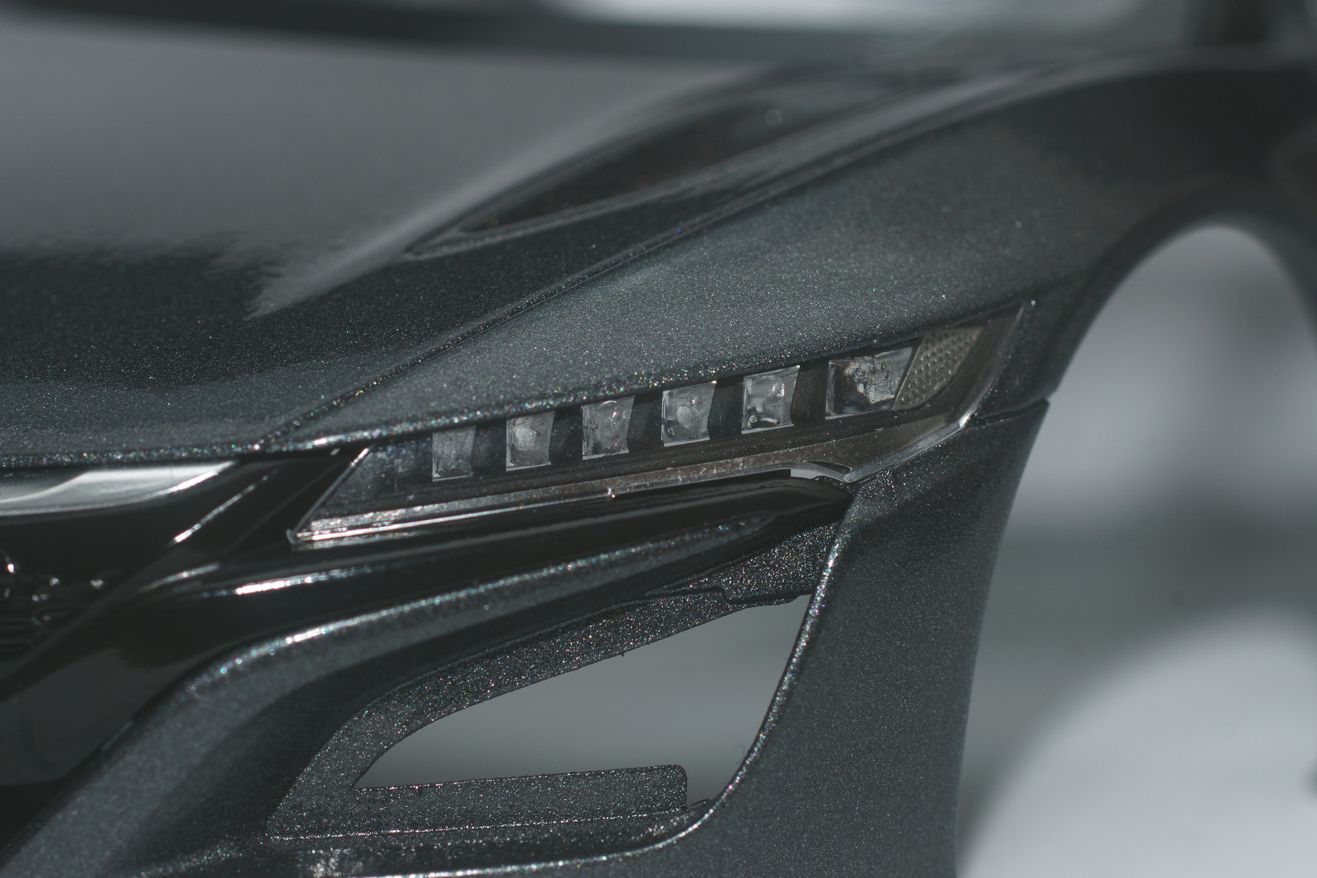

Today I finally worked on the headlights which got their PE parts.

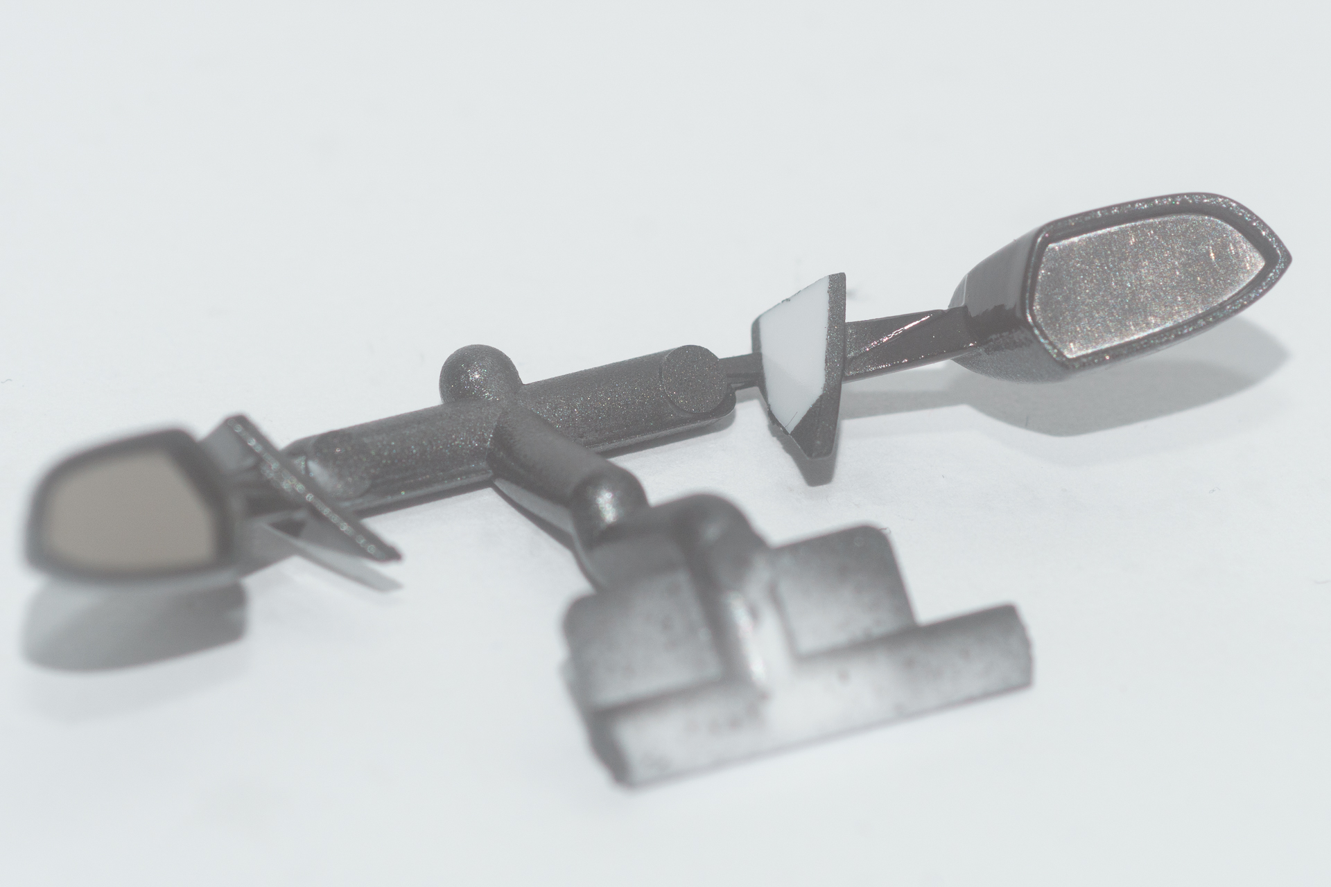

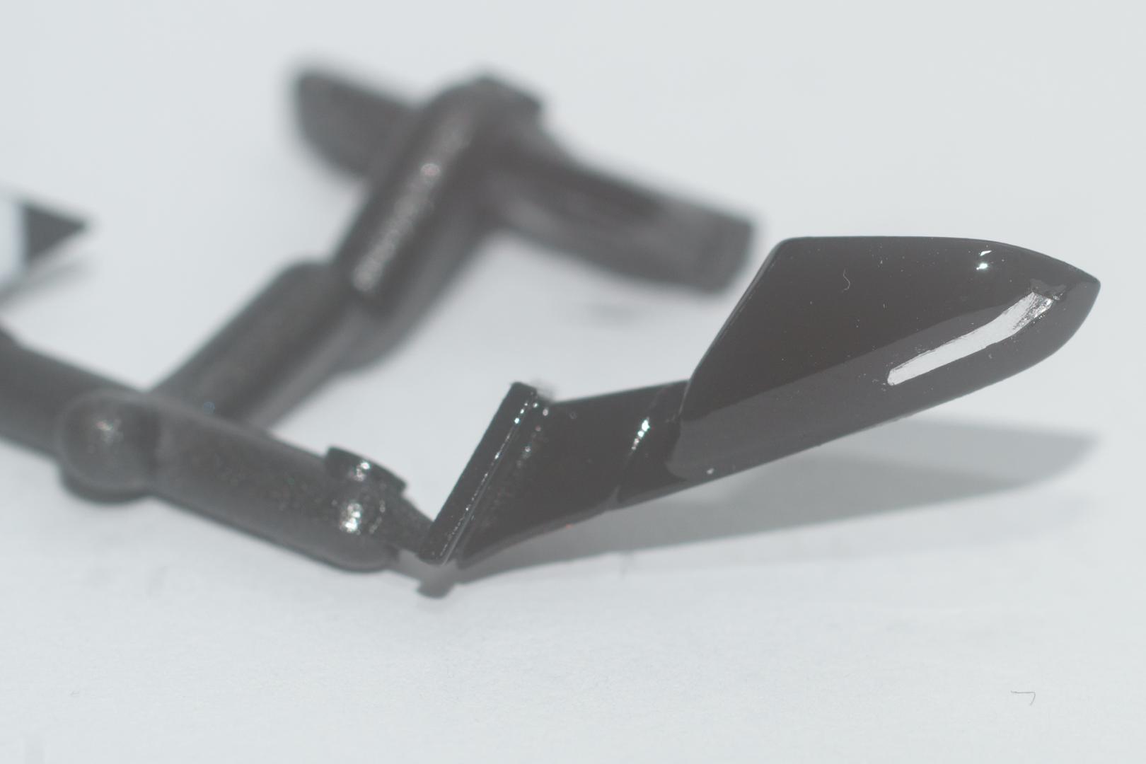

The mirrors got their PE parts as well. According to Tamiya you were supposed to paint a small stripe on the lower part of each mirror white. On the images I found online, I got the impression that on this particular spot there was something reflective behind a glass. So I decided to apply a small piece of BMF before clear coating.

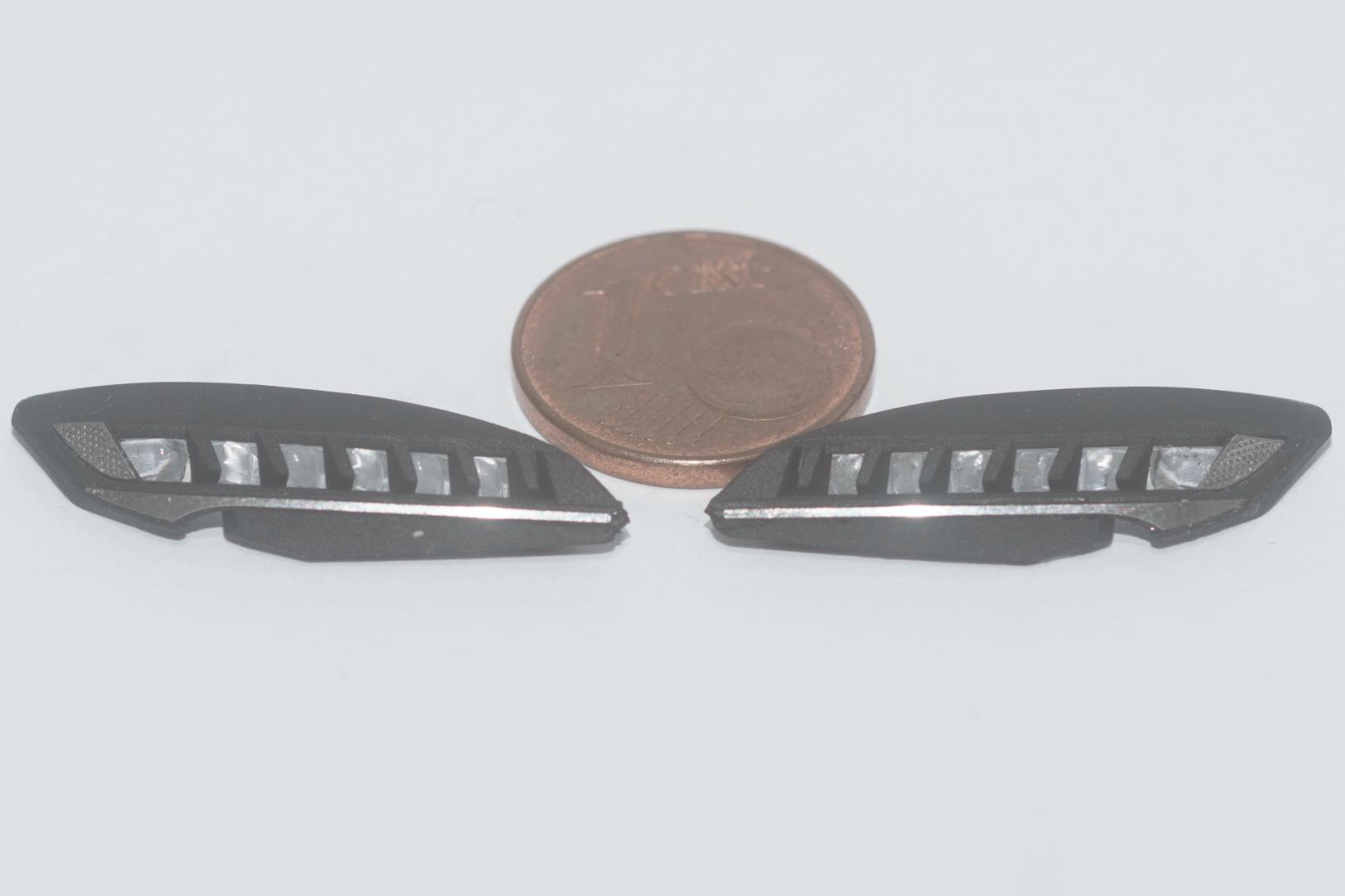

The body got its missing parts behind the doors as well as the transparent parts and the two "taillights" on the side of the rear body.

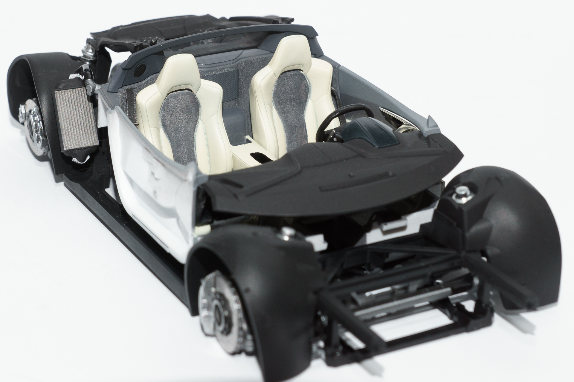

First body and chassis were prepared for their wedding

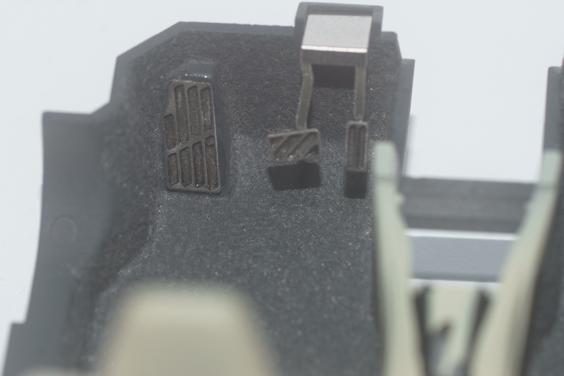

Before the interior gets inside and won't ever be seen, I've made some detail shots

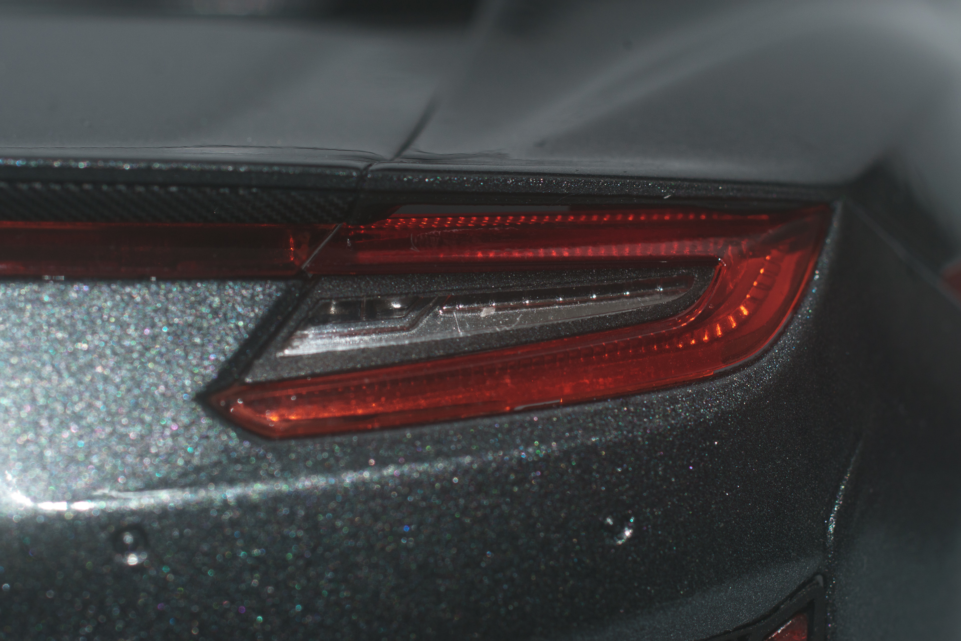

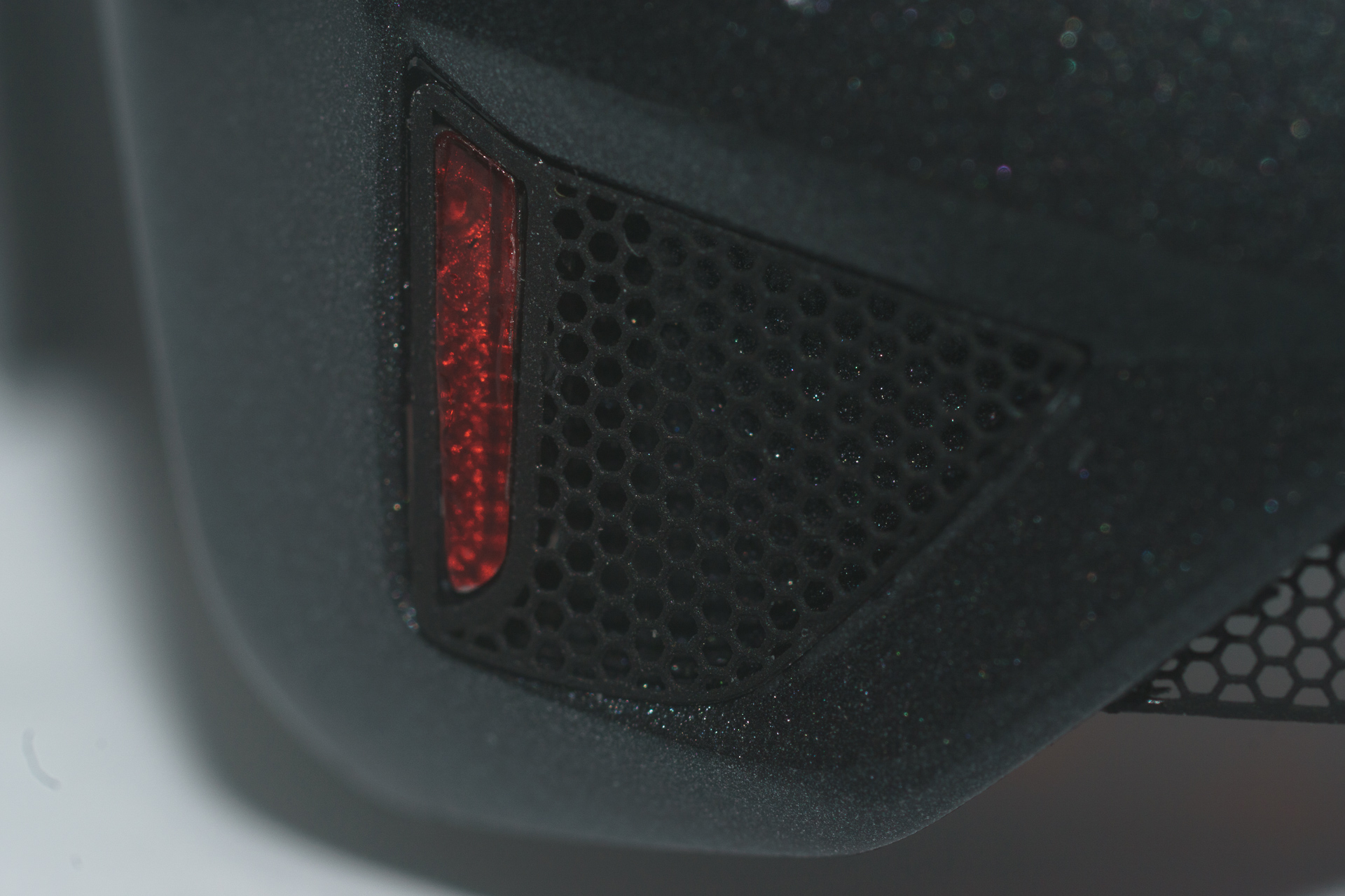

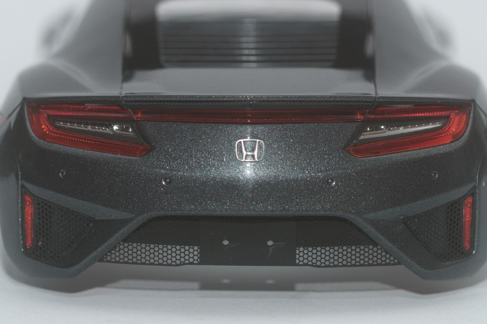

The rear end got finished with its rear lights and some grids from the PE parts
Also the front got mostley completed. Some PE parts are still missing and will be added next time I'll return to the working bench

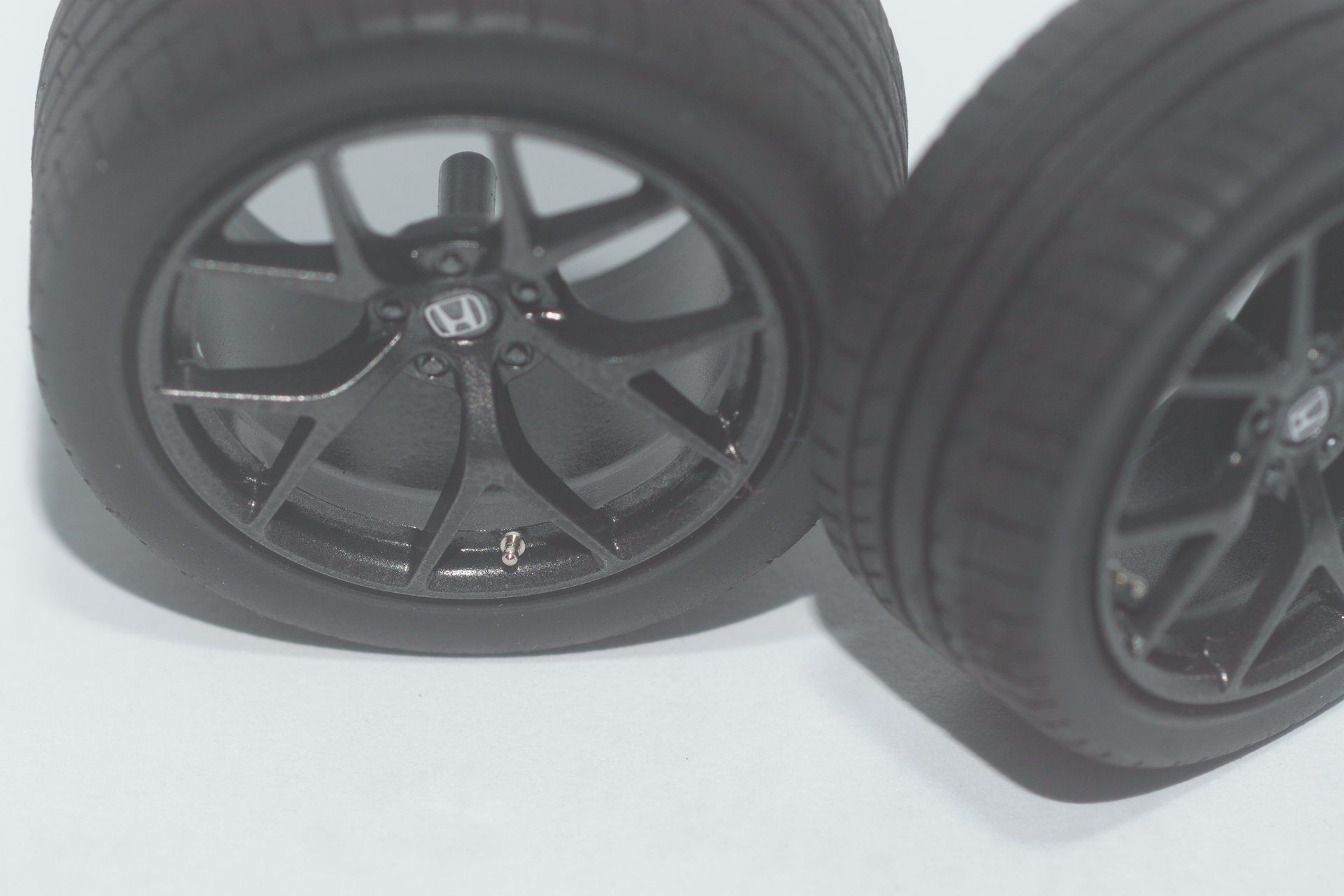

And finally the wheels are ready and even got some air valves
