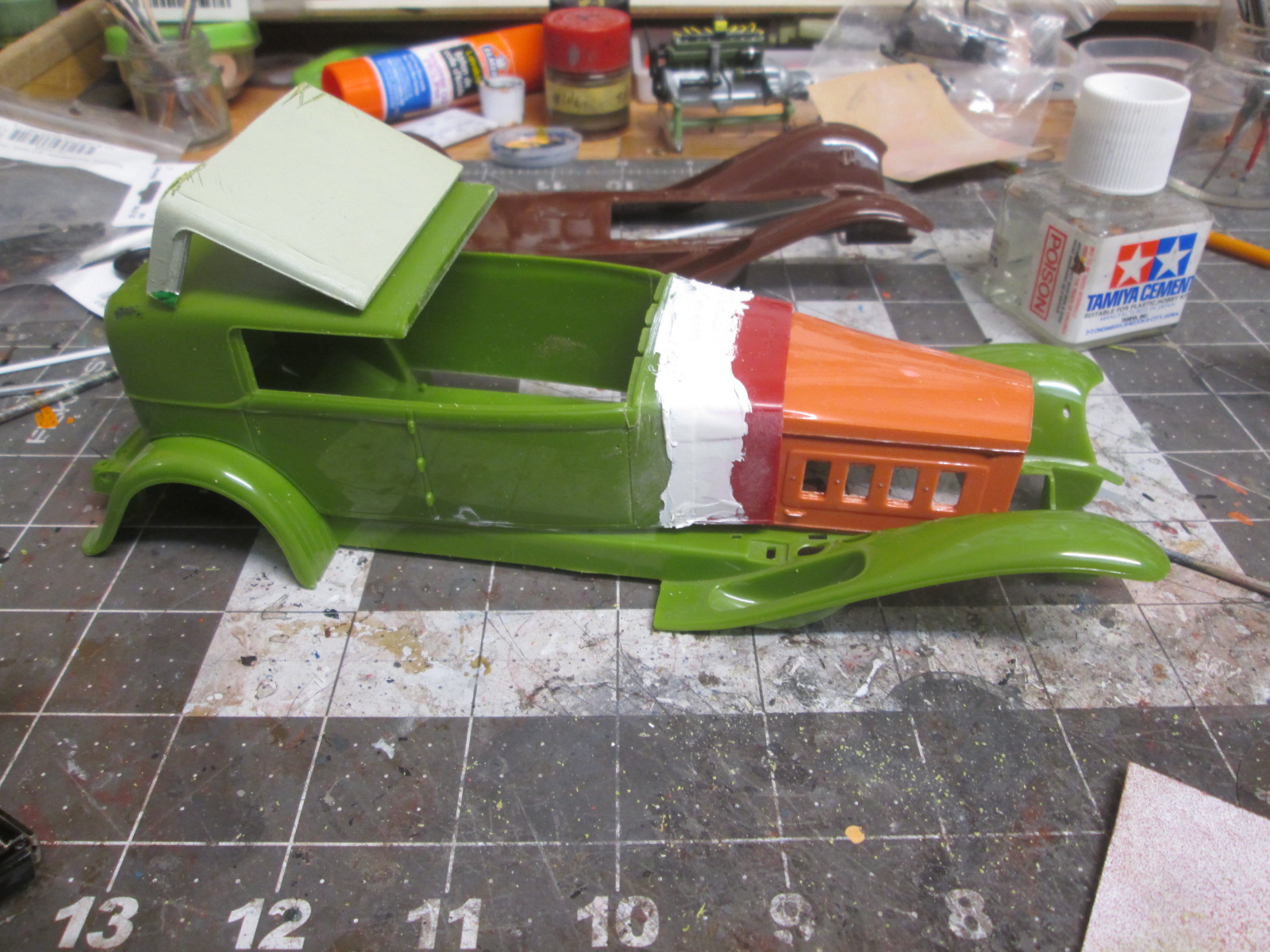

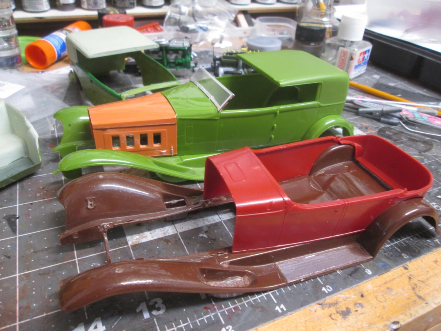

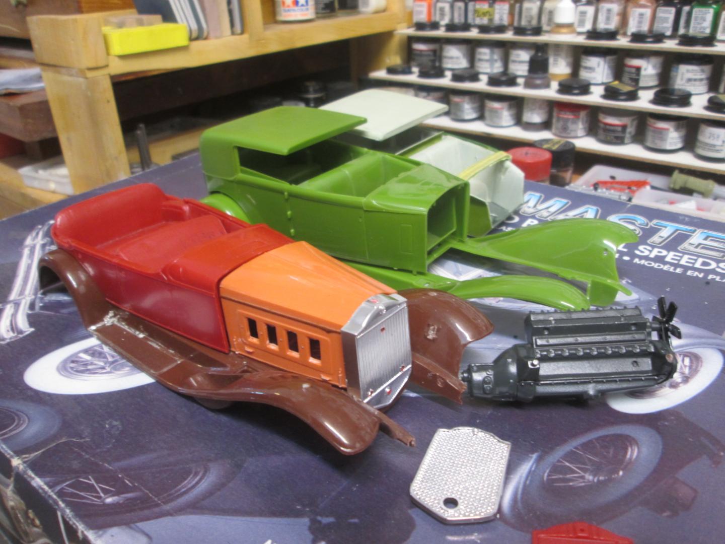

I always liked the Club Sedan body style with the blind ear quarter. So I rummaged and I think I have what I need to make one.
First car I ever noticed with seven wheel lug nuts. This one deserves a slow meticulous build IMHO.

It won't have the disc wheels Ray, whatever I have in the pile. I get the slow and meticulous.

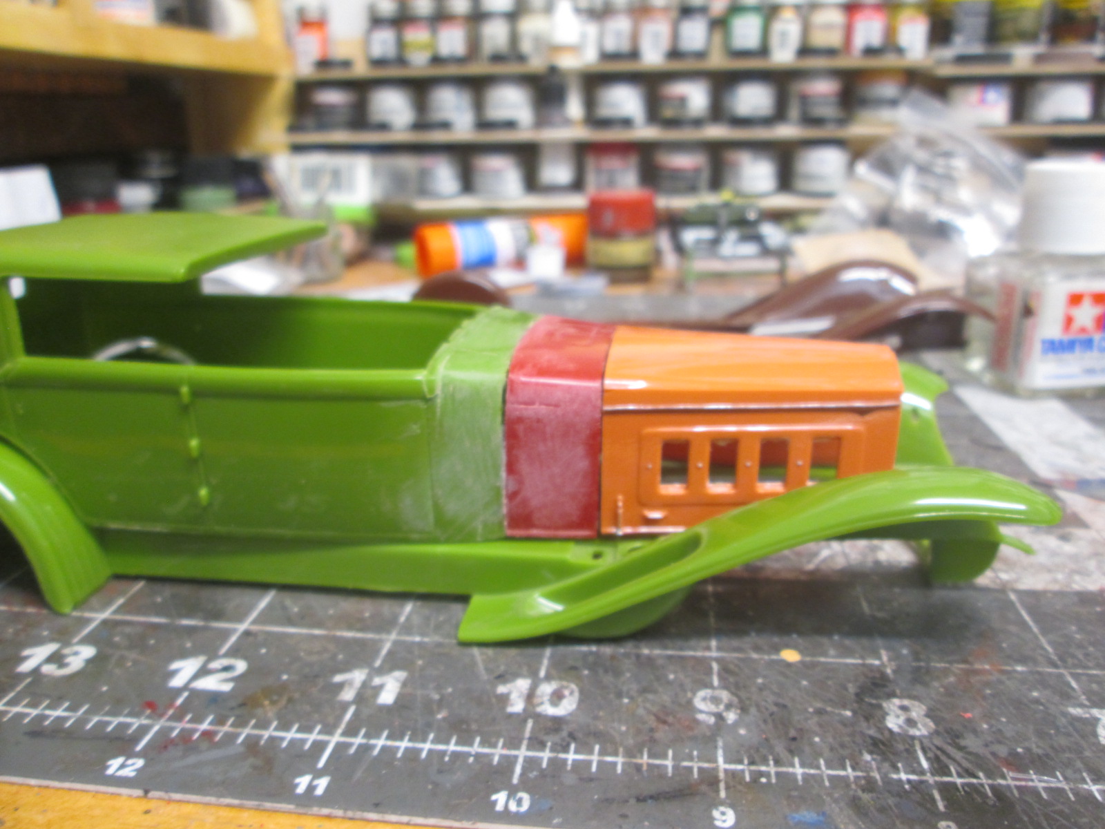

The Packard hood is a close match to the Duesenberg cowl. Now remains to decide where to cut to put the front pf the Packard cowl on to the Duesenberg body.

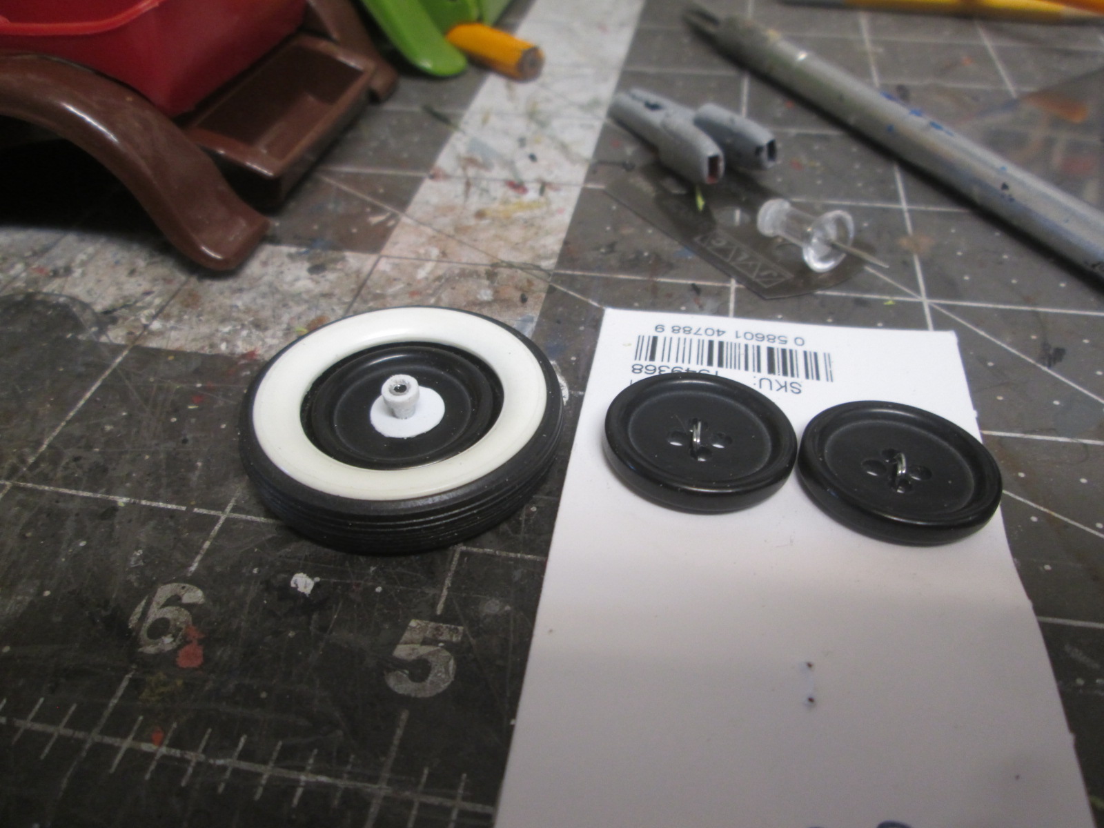

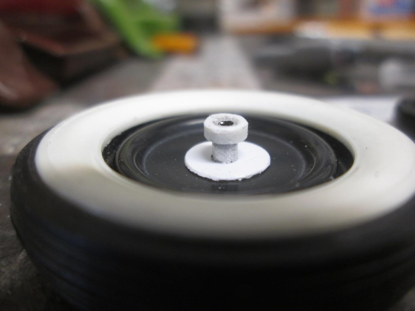

Dabbled a bit at making a disc wheel with a button, some aluminum tubing and bits of styrene. I think a very small socket head screw might make a nice hub as well, especially since it has Packard's trademark hexagon right in it.

The purple front fenders are closer to the Packard shape.
They are Packard fenders.

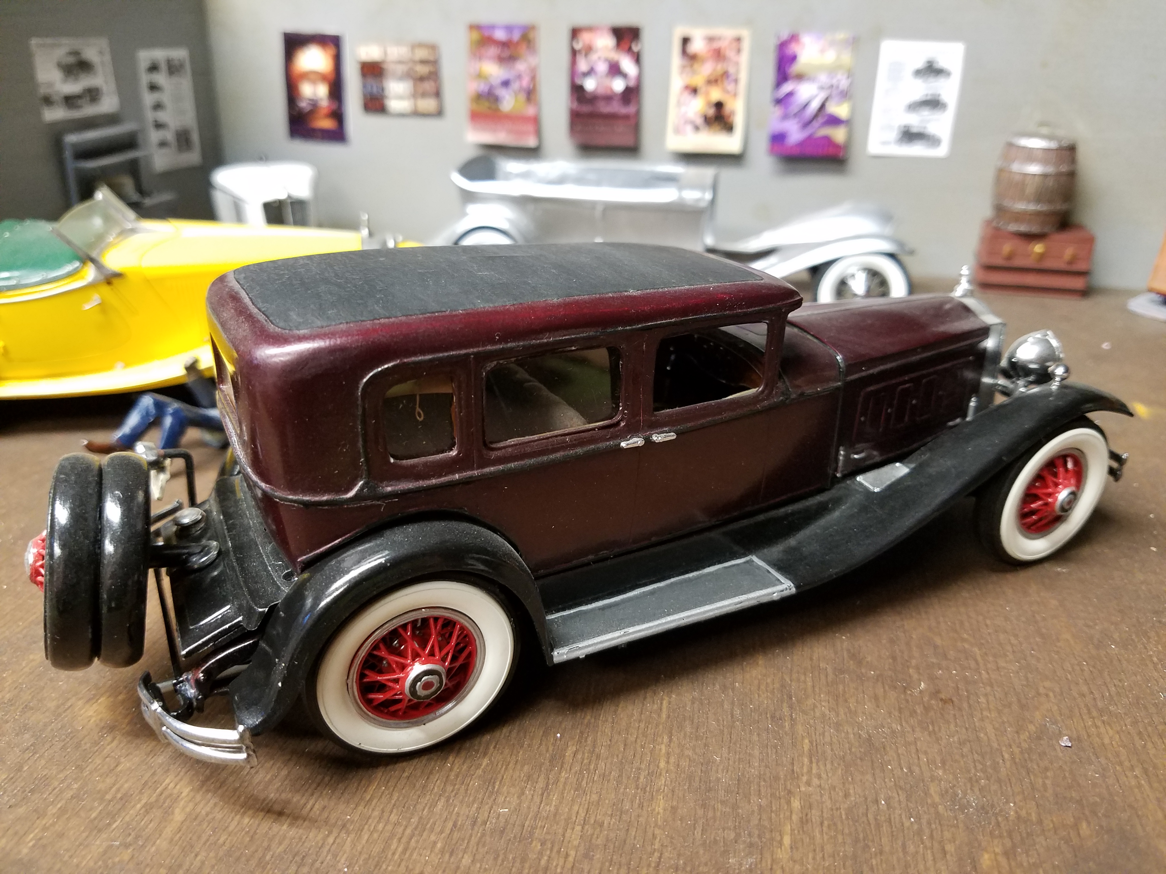

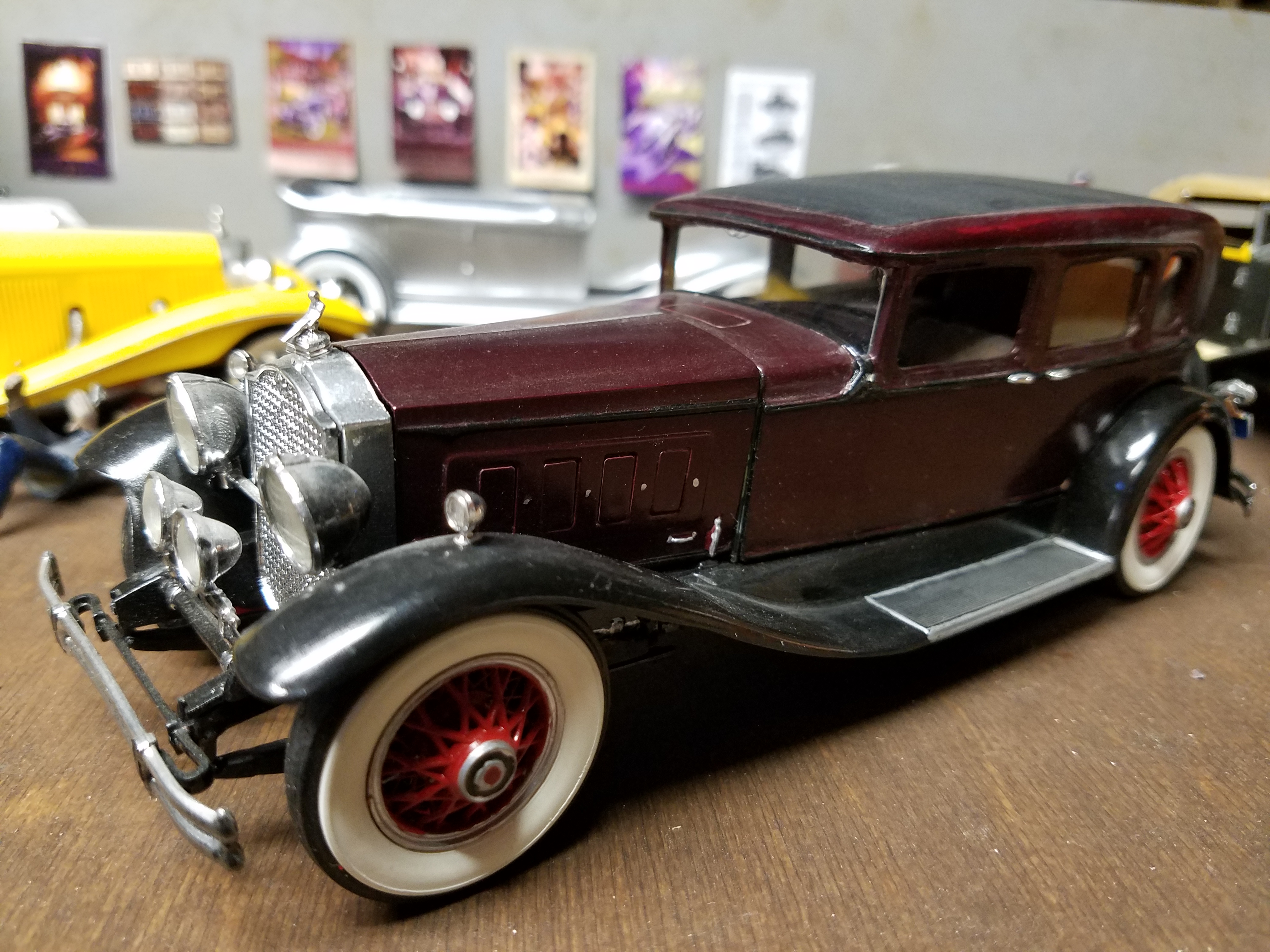

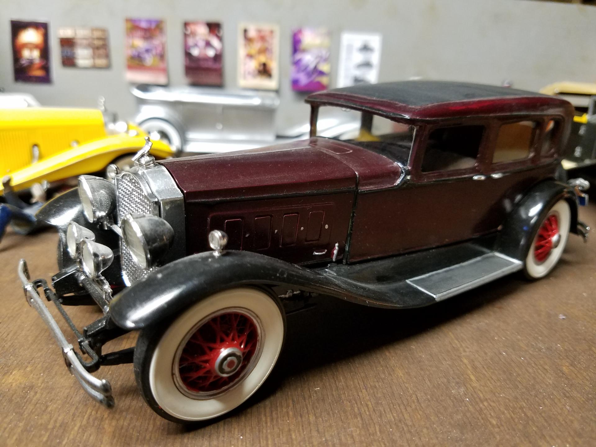

I built a 1930 Packard 734 sedan perhaps 15 years ago. This is not for the feint of heart but you'll have a great model when you are done.
Any pictures Eric?
27 minutes ago, Eric Macleod said:

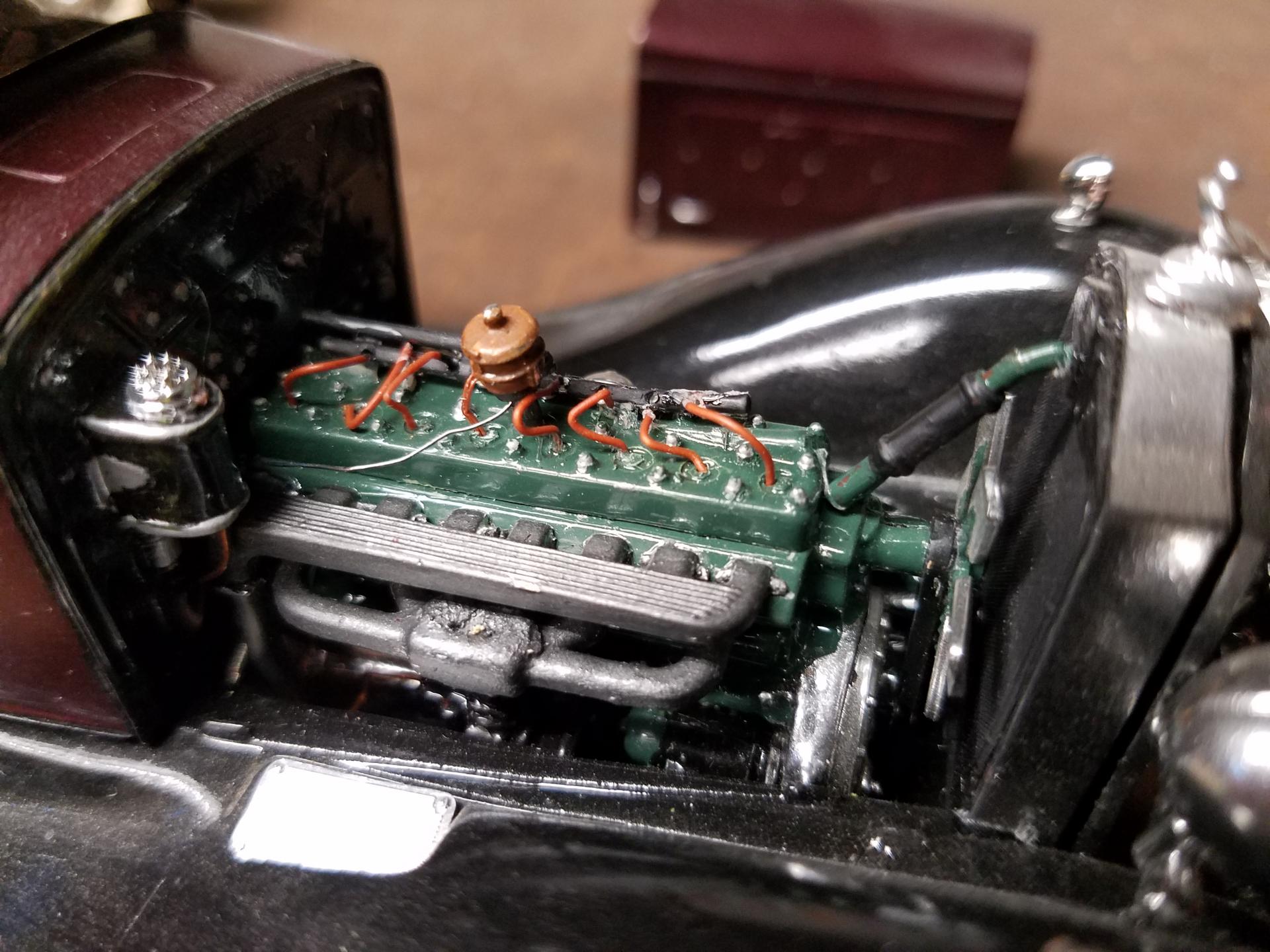

I didn't want to hijack your thread but here is what I built at the time.
Eric, was the whole body scratchbuilt or is it based on something else?
I used the Monogram Packard Phaeton body on the bottom and grafted a pair of Monogram Ford Model A Coupe roof sides ( for window frames) along with a full roof section from a AMT 31 Ford Tudor. Tons of sanding and filling gave me the result you see.
When I built my Duesenberg Judkins Victoria I used a method very similar to yours with the multiple Town Car bodies and the wedges cut in them.
You definitely have the right idea as far as I am concerned Pat.  I am interested in watching your progress.

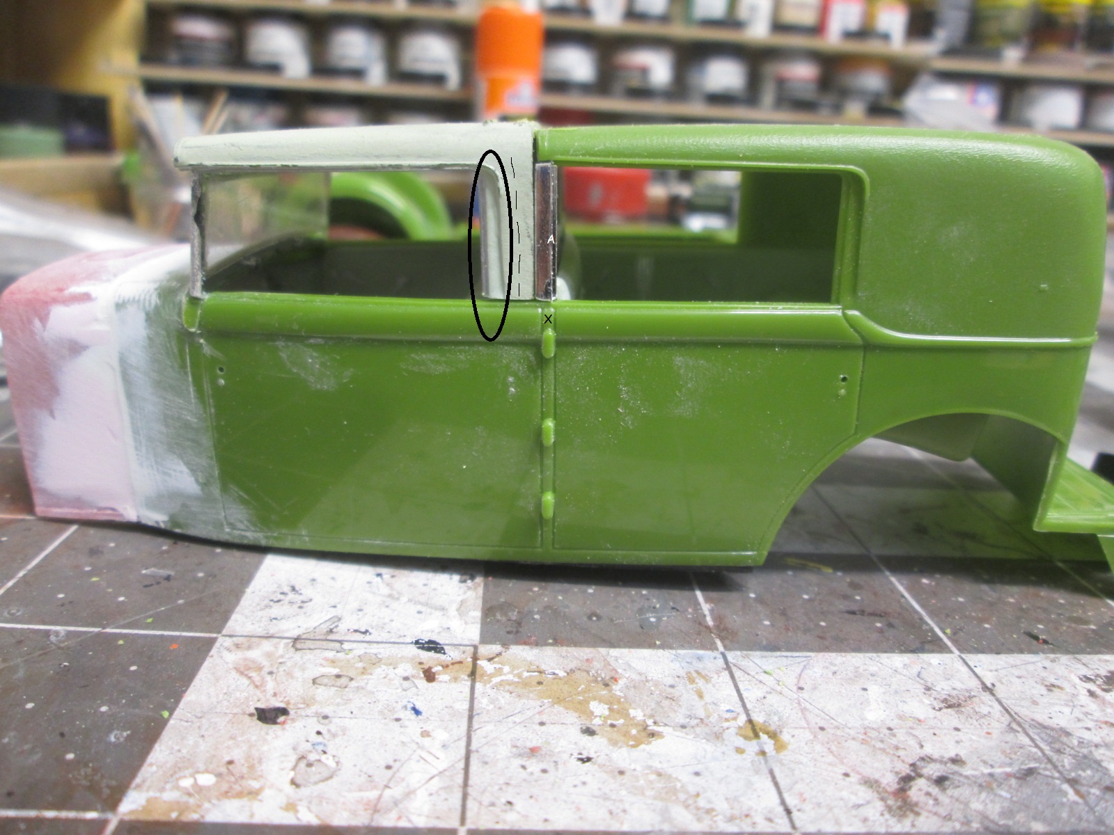

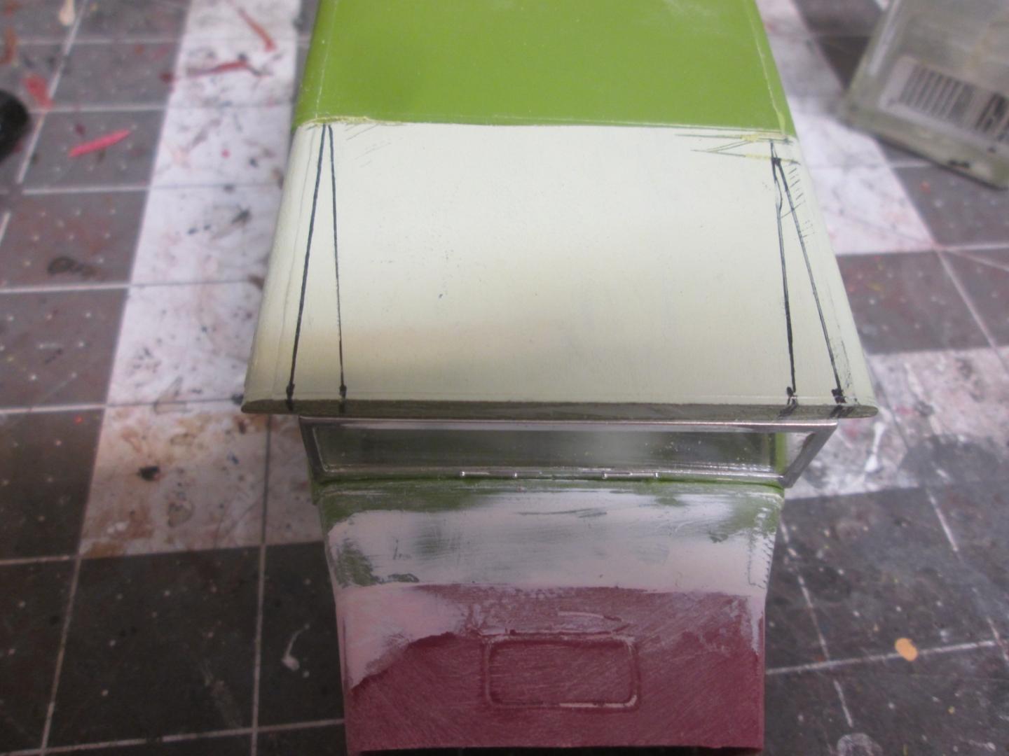

Here's what i plan to do where the two roofs  (or it it rooves?) join. I have to trim to bring the dotted line over the X, then copy what is in the oval at location A. Wish me luck.
