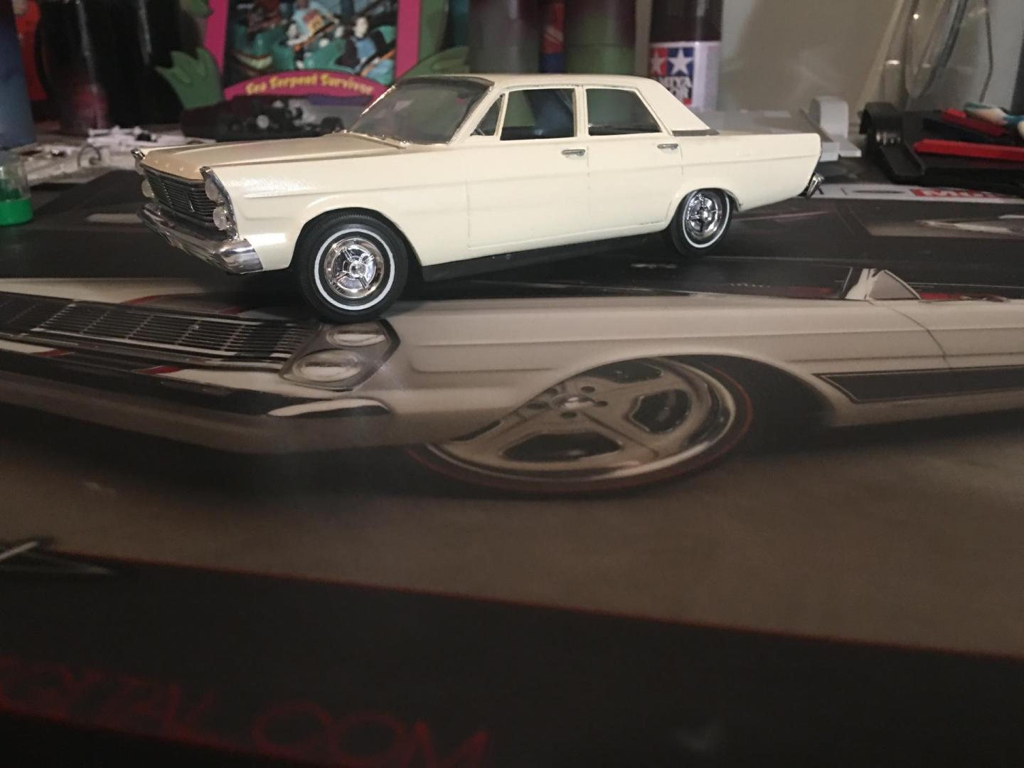

Monty Posted July 8, 2019 Posted July 8, 2019 (edited) Here's a pic of a 1:1 '65 Galaxie Focus on how the headlights fit in the bezels, as the AMT kit's bezels have a raised ring, approximately a scale 1/2 inch high, which the headlights sit on, resulting in a much different appearance (no offense to the builder). I'm thinking there's got to be an easy way to do a circular grind that eliminates the rings and leaves a recess that I can Molotow and drop the headlights into (no need to drill all the way through). Suggestions? Edited July 8, 2019 by Monty

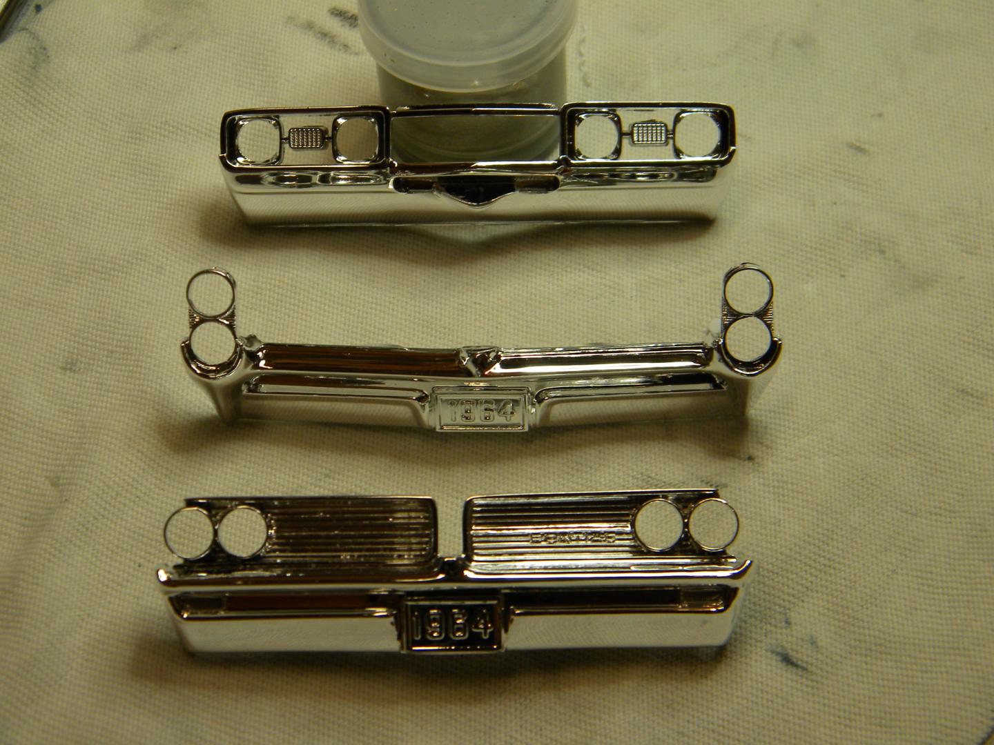

StevenGuthmiller Posted July 9, 2019 Posted July 9, 2019 I drill mine out with a various reamer bits in my Dremel tool all of the time. You will want a variable speed Dremel set on a lower speed. (I use 10) I start by drilling out the center of the head light with a pin vice and then a small slender cone shaped reamer to gradually make the hole larger. Yes, you do have to be careful, and a lighted magnifier is a must! When I get down to where I'm very close to the trim ring, I finish with a round file and cylindrical sanding sticks. I have gotten to the point where I do this with every model with the headlight lenses molded in. Steve
