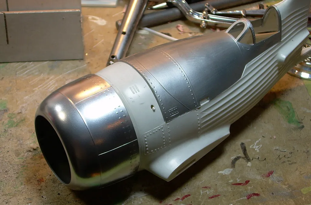

I recommend against this. The sealer usually turns the polished metal finish into silver paint. If the metalizers are allowed to dry very thoroughly, they become much less sensitive to handling.
I also recommend handling recently shot metalized parts with thin cotton gloves.
The engine cowling is buffed metalizer. The cockpit cowling has been shot with "sealer".
