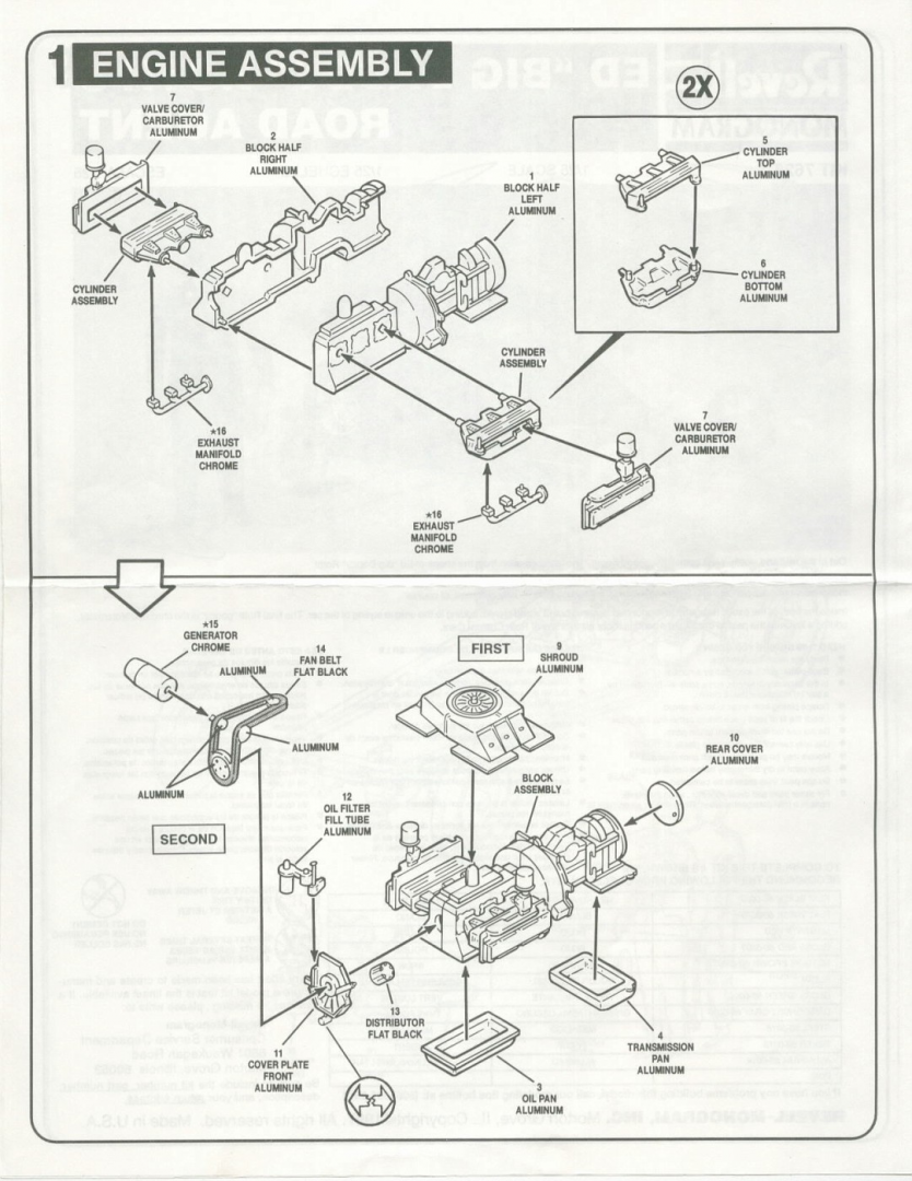

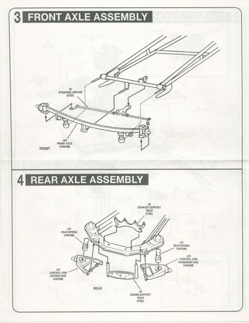

Ace-Garageguy Posted August 29, 2019 Posted August 29, 2019 (edited) AND...The Road Agent, at least as modeled by Revell, uses an auto-box and does NOT use the transaxle inverted. The automatic gearbox pan is shown in the conventional position, which it would absolutely positively HAVE TO BE. So...if the real Road Agent used an automatic gearbox, just about the only way the rig could work with the engine forward of the gearbox is with a reverse-rotation cam. Again, these were fairly common and are still available. Compare the rear suspension though, and you'll see the visual similarity to the Tempest assembly... Edited August 29, 2019 by Ace-Garageguy

Casey Posted August 29, 2019 Posted August 29, 2019 12 hours ago, Ace-Garageguy said: Note that the above is a Revell-Monogram era instruction sheet, and represents the restored/re-created Road Agent kit, which differs significantly from the original:
Ace-Garageguy Posted August 29, 2019 Posted August 29, 2019 (edited) 1 hour ago, MrObsessive said: ...I REALLY appreciate the pics of the bare rear suspension setup. Those will come in mighty handy! ? A couple more points... 1) The black-and-white photo on the left of the 4th post from the top shows a manual floor-shifted transaxle, THE transaxle that came out of the brand new '63 Tempest that was rebuilt as Mickey Thompson's famous A/FX car. 2) The color shot next to it shows an automatic transaxle from the same vehicle line. Note the completely exposed torque-converter on the left end. That was exposed, at the rear of the unit as-installed. Seeing one of these things running on a lift, and the famous "rope" driveshaft, gave me perhaps my first "WTF were they thinking??" moment in the car biz. Keep your hands away from the crazy thing. 3) The manual and auto boxes used different crossmembers, IIRC. Seems the wagons were different too. 4) Nobody in the hot-rod community ever understood why GM chose to build two very similar but almost totally different transaxles for two contemporary cars, as a little more homework could have made one unit that would have worked equally well in both. All I can offer is that GM divisions operated with more autonomy in those days. Engineering departments from different divisions definitely influenced each other, but apparently, wringing every last nickel out of every product by cross-platform component sharing wasn't as prevalent as it later became. 5) Image-search "Tempest transaxle". Lotsa pix of the things installed, assembled in their suspension carriers, and sitting on the shop floor nekkid. Edited August 29, 2019 by Ace-Garageguy
Ace-Garageguy Posted August 29, 2019 Posted August 29, 2019 19 minutes ago, Casey said: Note that the above is a Revell-Monogram era instruction sheet, and represents the restored/re-created Road Agent kit, which differs significantly from the original: Yes, but both kits depict the identical Corvair 2-speed automatic transaxle. BUT...because the Corvair runs its torque-converter within the bellhousing, where any sane engineering department would put it, the Road Agent kit is a better visual likeness for the manual Tempest transmission.
Casey Posted August 29, 2019 Posted August 29, 2019 58 minutes ago, Ace-Garageguy said: Yes, but both kits depict the identical Corvair 2-speed automatic transaxle. True, but one version does it with more detailed and considerably more parts. Which version is preferable is up to the end user to decide. but it's always good to know your options.
Ace-Garageguy Posted August 29, 2019 Posted August 29, 2019 17 minutes ago, Casey said: True, but one version does it with more detailed and considerably more parts. Which version is preferable is up to the end user to decide. but it's always good to know your options. Good point. The early version is the typical jewel-like (but criticized as being "fiddly') Revell assembly of the period. The later one is OK, but requires some knowledgeable hacking up to use as a Tempest stand-in. Actually, to be reasonably accurate, the early one requires mods too, but as more of the components are separate, it's possibly more straightforward. Speaking of old vs. new...do you or anyone else, maybe Mark or Tim Boyd, know what happened to the original tooling?
