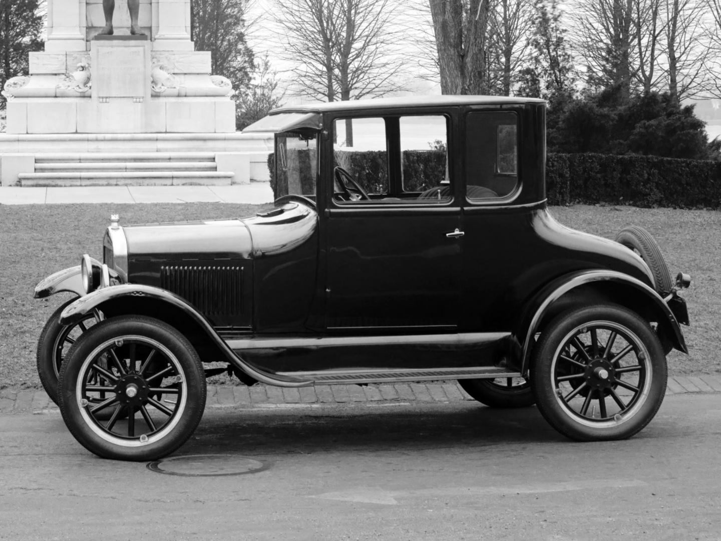

On 9/12/2019 at 11:26 AM, Eric Macleod said:
Eric
Eric, the bearing covers where stainless not chrome as I stated. Going to try to post a pic of a 26 I pulled off the net. The year may be wrong. I don't remember it having a rear glass behind the door like the one I found on google. And I don't remember the trunk being as rounded off as the one in the pic. And I know for a fact the truck lid was flat, no curves and pretty much square made of wood with metal over it and painted gray under it and in the trunk area. The one in my pic is close, but that aint the one I worked on, the trunk is all wrong. Maybe you might know what year it was.

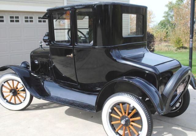

I am suspecting the car may be like this instead.  It fits a bit more of your description. Its pretty close to the car you described.  In this case its a 25 Model T Coupe.
That looks more like the one I worked on. Clarence's car did not have the lamps on the cowl or the rear spare tire on it. Options I'm sure. Very simple, neat little cars. Thanks for the info and jogging the ole memory.
And what if the gas tank was under the front seat instead of inside the trunk. The shut off valve would be a get out and get under thing.  Does that sound like his car?
