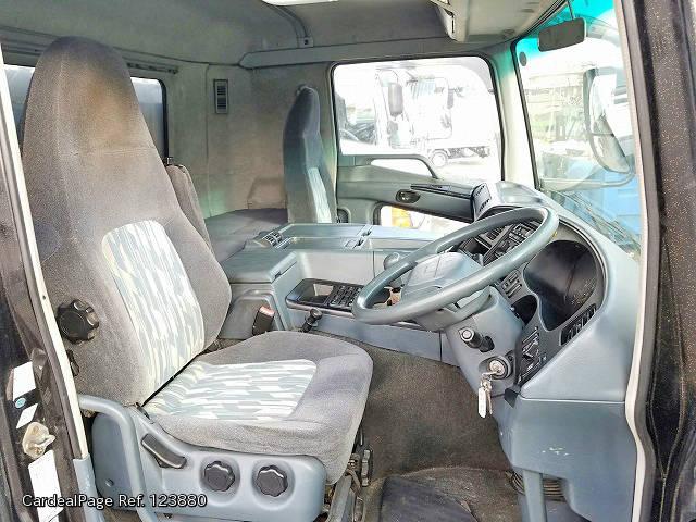

Hermann Kersten Posted February 8, 2020 Author Posted February 8, 2020 (edited) Thanks for the nice comments guys! Yes, here it also continues, today it's time to start the interior. I can tell you, that this interior is not the easiest one, lots of shapes and angles. First i show you the real interior..... Yep, as you all can see, not the easiest one. The first attempt was a failure, because the console was too high. So, i started all over again, as i always keep in mind..."it's just plastic", and with the second attempt it looks more in proportion. First i searched in my Actros spare-parts box and picked 2 seats out, modified these seats a bit, and made the boxes for the seats what is needed for this Fuso. The driver seat need some more work, but that is for later. Then it was time to make the tunnel and tunnel console and had to cut out a lot of styrene parts of different shapes and sizes. It is really unbelievable how many different shapes there are on such a console. I had to determine the scale, because i don't have dimensions of this tunnel console, but with some comparisons with the height of the seats and door windows, i figured out and estimate what the dimensions should or could be. Then with a cutter and a lots of patience, it was time to cut. With this tunnel console and storage compartments, i laminate the 0,5mm styrene plates, to get the final look of this console. And the slow progress so far. The upper plate is not glued yet, because i have to cut out some more hatches. When this console is in shape, then i will continue with the dashboard, what is also full of different shapes and angles. That's it for today, and till the next time! Hermann. Edited February 8, 2020 by Hermann Kersten

Oldcarfan27 Posted February 16, 2020 Posted February 16, 2020 On 2/8/2020 at 8:35 AM, Hermann Kersten said: FYI, did you know that those seats look a lot like the ones in the AMT Ford Ranger kit?
Vince66 Posted February 16, 2020 Posted February 16, 2020 (edited) 2 hours ago, Oldcarfan27 said: FYI, did you know that those seats look a lot like the ones in the AMT Ford Ranger kit? They actually do now that you brought that up. Never would've thought about that. Edited February 16, 2020 by Vince66
Hermann Kersten Posted February 22, 2020 Author Posted February 22, 2020 On 2/16/2020 at 7:37 AM, Oldcarfan27 said: FYI, did you know that those seats look a lot like the ones in the AMT Ford Ranger kit? Ah, good to know Patrick.......i only don't have that kit. It's not a problem anyway because i will modify the seats a bit, and i saw at various Fuso reference pictures also some differences in seats. On 2/21/2020 at 2:35 AM, DRIPTROIT 71 said: A joy to watch an artist at work! Thank you for the nice comment Brian. Hermann.
