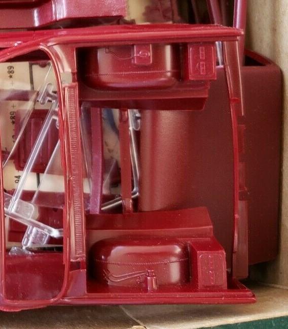

Uncut version:
Yup that looks like it.... So square it out it is, I don't need 2 batteries this thing is not a diesel.... Thanks guys...
FYI, that shape on the top of the Monogram passenger side fender is the jack and jack handles. Don't know regular Blazers well enough to know if the 2nd battery was an option in gas engines, but I do know that the '76 and '77 Blazer Chalets (gas, 350s or 400s) with the factory-installed camper units had a second battery on the driver's side to power the camper unit's lights and sink water faucet.

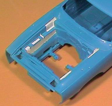

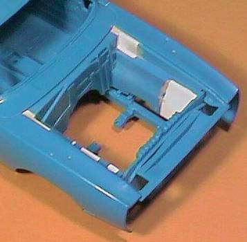

I've done similar repairs - it's not too difficult. Pre-bend the plastic card if necessary, and finish with a bit of filler. The photos below will give you an idea, even if they're 20+ years old.
Rob
Edited by robdebie
