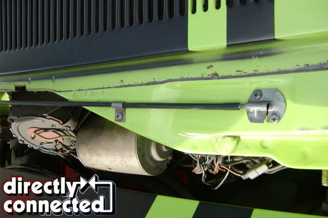

1972coronet Posted December 1, 2019 Posted December 1, 2019 The blackout / accent (et al.) paint is actually textured on the 'real' car ; its nomenclature is Organosol --- Here's a page which exhibits that finish : https://the70aarcuda.com/aar-`cuda I'm not sure if you're planning to replicate that textured finish (maybe a moot point in 25th scale) ; however , that gnarly stuff was applied before the rest of the car was painted .
SfanGoch Posted December 1, 2019 Posted December 1, 2019 (edited) 1 hour ago, 1972coronet said: that gnarly stuff was applied before the rest of the car was painted . According to this This is an up close shot of an original 1970 car showing where the stripe over spray went between the hood and the cowl. NO WAY was this area masked off and NO WAY was the stripe painted before the body color. ‘Nuff said! Organosol: Separating Truth From Fiction Edited December 1, 2019 by SfanGoch
gtx6970 Posted December 1, 2019 Posted December 1, 2019 1 hour ago, 1972coronet said: ; however , that gnarly stuff was applied before the rest of the car was painted . Sorry. But I'll respectively disagree with this. I've done some work on an original fc7 paint aar. And can assure you there is purple under the blackout.
1972coronet Posted December 1, 2019 Posted December 1, 2019 My mistake , mea culpa --- I was *thinking* of the painted tail stripes of the 1970 Challenger R/T . Not sure how I confused the two...
