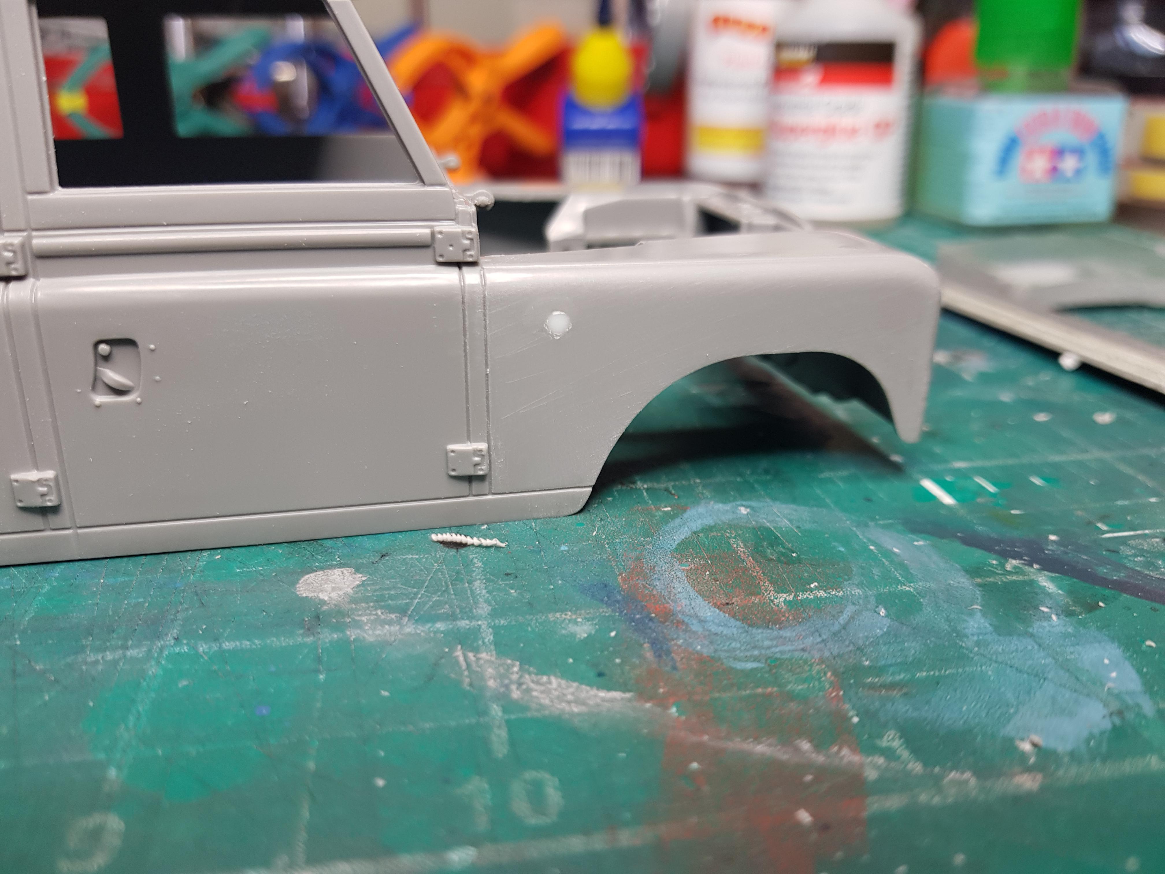

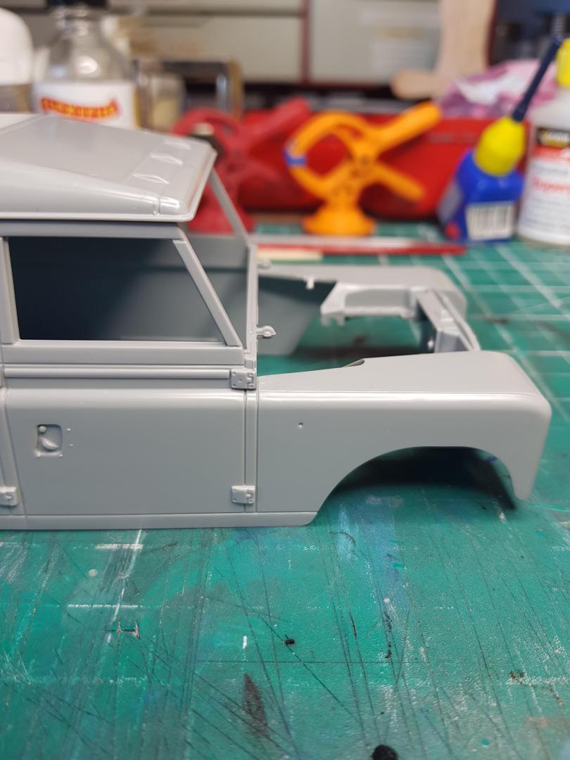

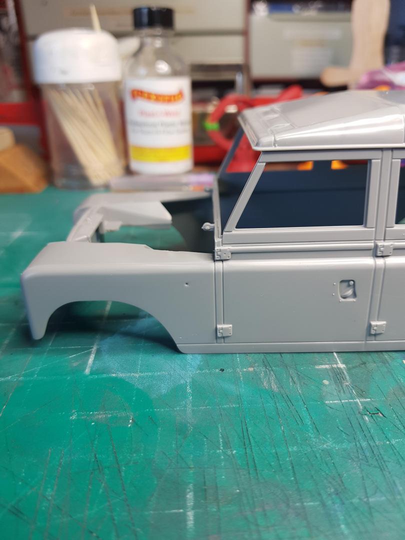

Looking over the Revell Land Rover this morning, already spotted a mistake, depending on whether it is left hand drive or Right hand drive, the air intake for the carburetor will be on one side only, Revell seems to put a small locating mark molded in the body on both sides, so a little bit of filler should sort out it, why Revell didn't mark them on the inside so they could be drilled out.

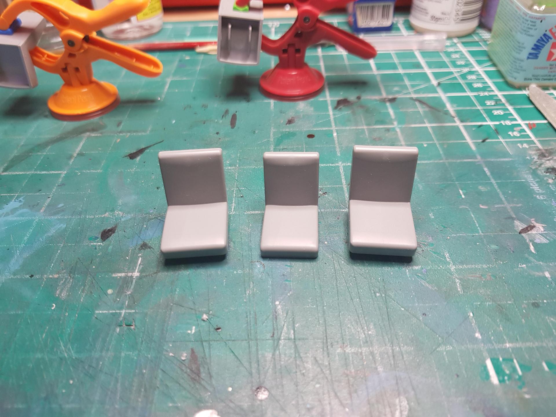

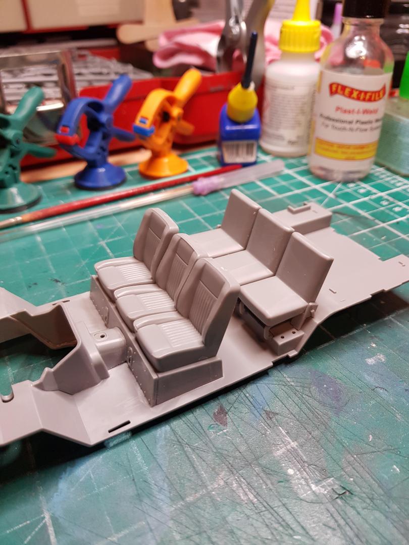

Sometimes it's worth reading the Instructions before putting any parts together, although not mentioned in the instructions, Revell have supplied seats to make a basic and Deluxe interior, Its a shame they didn't supply a Deluxe bonnet  hopefully someone's out there will do a resin aftermarket one, looks like the spares box will be gaining a few more parts.

Why Revell decided to put these drill out marks on the outside of the body is beyond me, the easiest way to deal with them is to drill them out with a 2mm drill and insert some 2mm styrene rod, cut flush then sand smooth.

I'm hoping that the fact that you have to drill out so many holes in the floorpan for the rear seats that Revell have other versions in the planning, if the 109 kit sells well, hopefully Revell will se fit to release a 88" version.

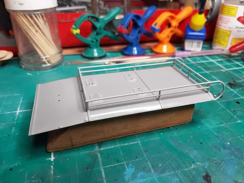

No time to spend time in the hobby room today, I did manage to get in there later this evening as soon as things had quieted down, used the safari roof panel to use so the roof rack could be fixed together, as soon as the joints are strong it can be removed from the roof panel and painted.

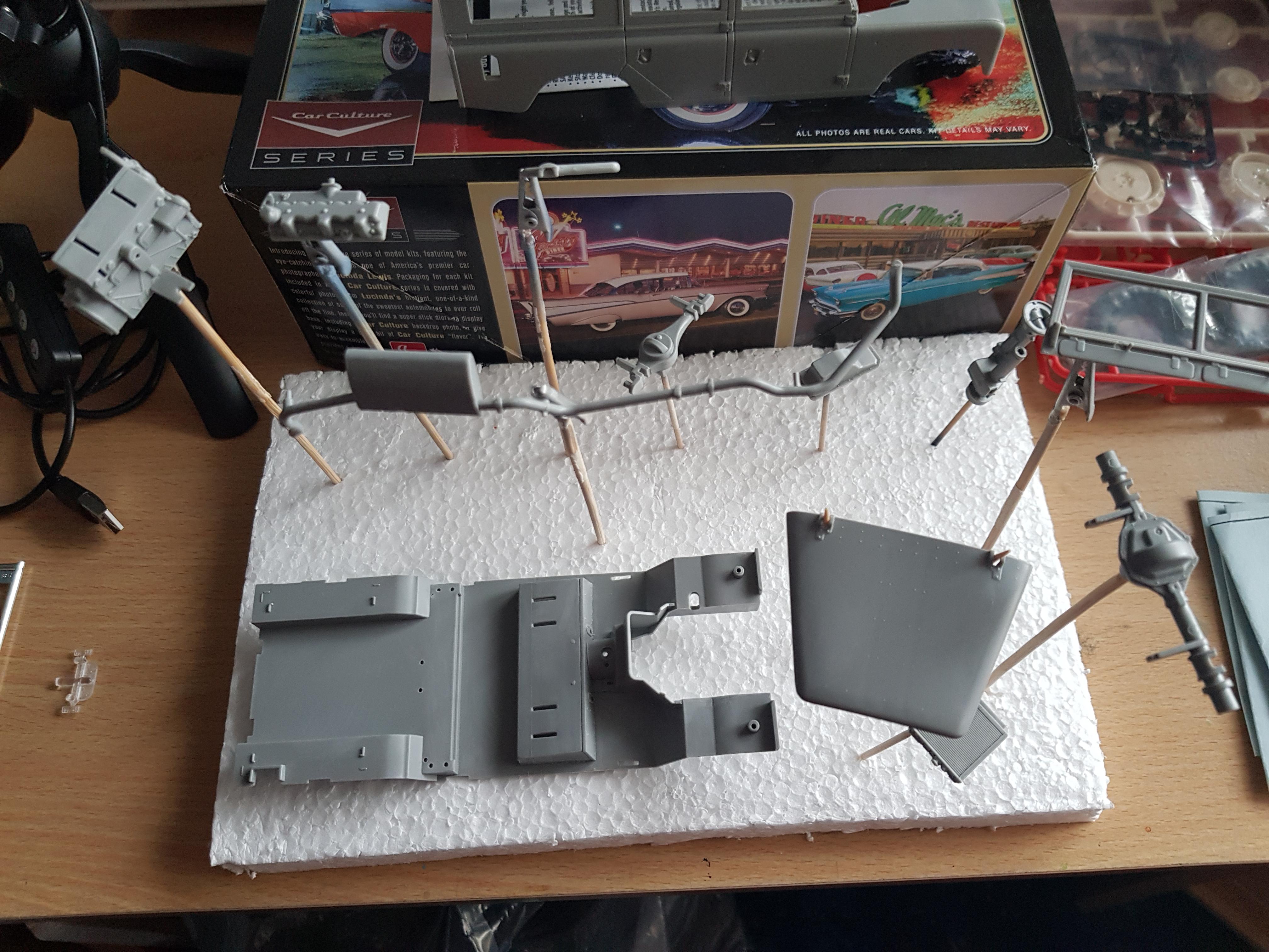

Decided to close the hobby room for Christmas, mainly because I needed time with friends and family and also had some last minute photography work to get sorted, managed to get a load of parts prepared and ready for primer.
