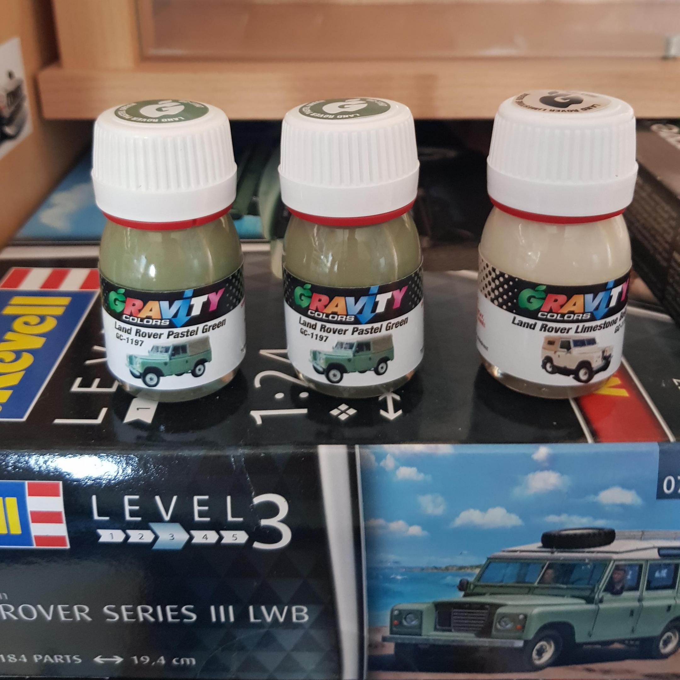

GeeBee Posted January 20, 2020 Author Share Posted January 20, 2020 Paint arrived from Gravity paints in Spain, it's about time I gave them a try, hopefully I'll find time to get back into the hobby room very soon. Quote Link to comment Share on other sites More sharing options...

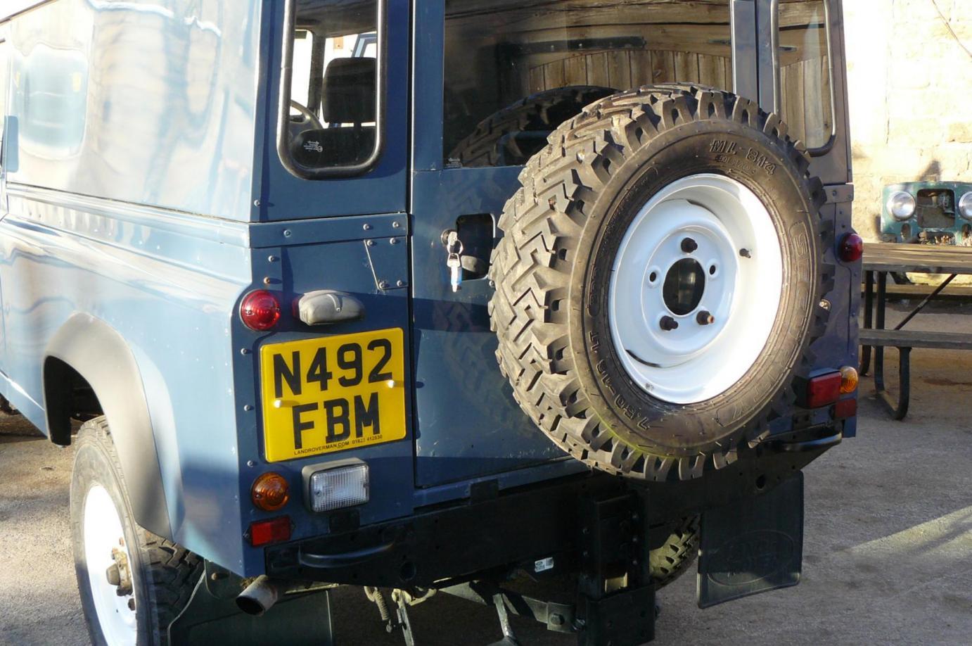

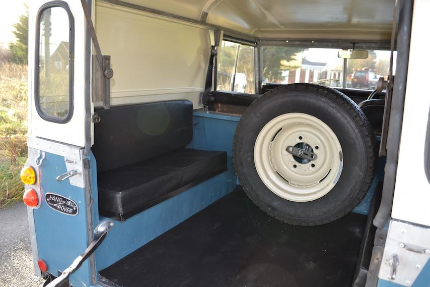

GeeBee Posted January 23, 2020 Author Share Posted January 23, 2020 (edited) 9 hours ago, Roadrunnertwice said: Does the deluxe have the spare wheel mounted on it? I'm enjoying the progress on your build and can't wait to start my own. Yes, the standard bonnet didn't have the indent in it, the standard bonnet is what is supplied in the kit, the spare wheel would have been put in the back, which was totally inconvenient, you either had to put up with it, leave it behind it you were going to use the rear seats or pay for the dealer to have it mounted on the back door, which was a pain if you were using your Land Rover for towing as the tyre got in the way when coupling up the trailer, the later Defenders have the wheel mounted much higher. The door mirrors supplied in the kit are totally incorrect for a Series land rover, the only way to fit them is to swap the top door hinge with the ones off a later Defender. Deluxe Bonnet Edited January 23, 2020 by GeeBee Quote Link to comment Share on other sites More sharing options...

GeeBee Posted January 24, 2020 Author Share Posted January 24, 2020 12 hours ago, Tom Geiger said: I have never owned a Land Rover but I would think that having the spare up on the hood would be inconvenient. How does it affect opening the hood for service? It looks like it would be very heavy Done it a few times, almost impossible with the tyre still in place, if you weren't going to use it for towing,the spare wheel could be mounted on the rear door, but if you were towing the bottom of the tyre got in the way of the coupling, vans and pick ups had the spare wheel mounted on the rear bulkhead inside, the later Defenders had the spare mounted much higher on the rear door. Quote Link to comment Share on other sites More sharing options...

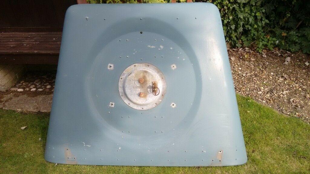

GeeBee Posted February 10, 2020 Author Share Posted February 10, 2020 21 hours ago, mrmike said: My spare tire will go on the hood (bonnet) even if the hood is not part of the deluxe package. I figure no one will really notice the lack of the deluxe hood unless they know about that package. The spare wheel mounting on the bonnet would have been a dealer fit option on a non deluxe Land Rover, pretty easy to scratch build the pie dish mount, hope these photos help you out.... Quote Link to comment Share on other sites More sharing options...
mrmike Posted February 10, 2020 Share Posted February 10, 2020 Thanks Geoff! It does help. I will look into maybe making a mount for the hood mounted spare tire. Quote Link to comment Share on other sites More sharing options...
