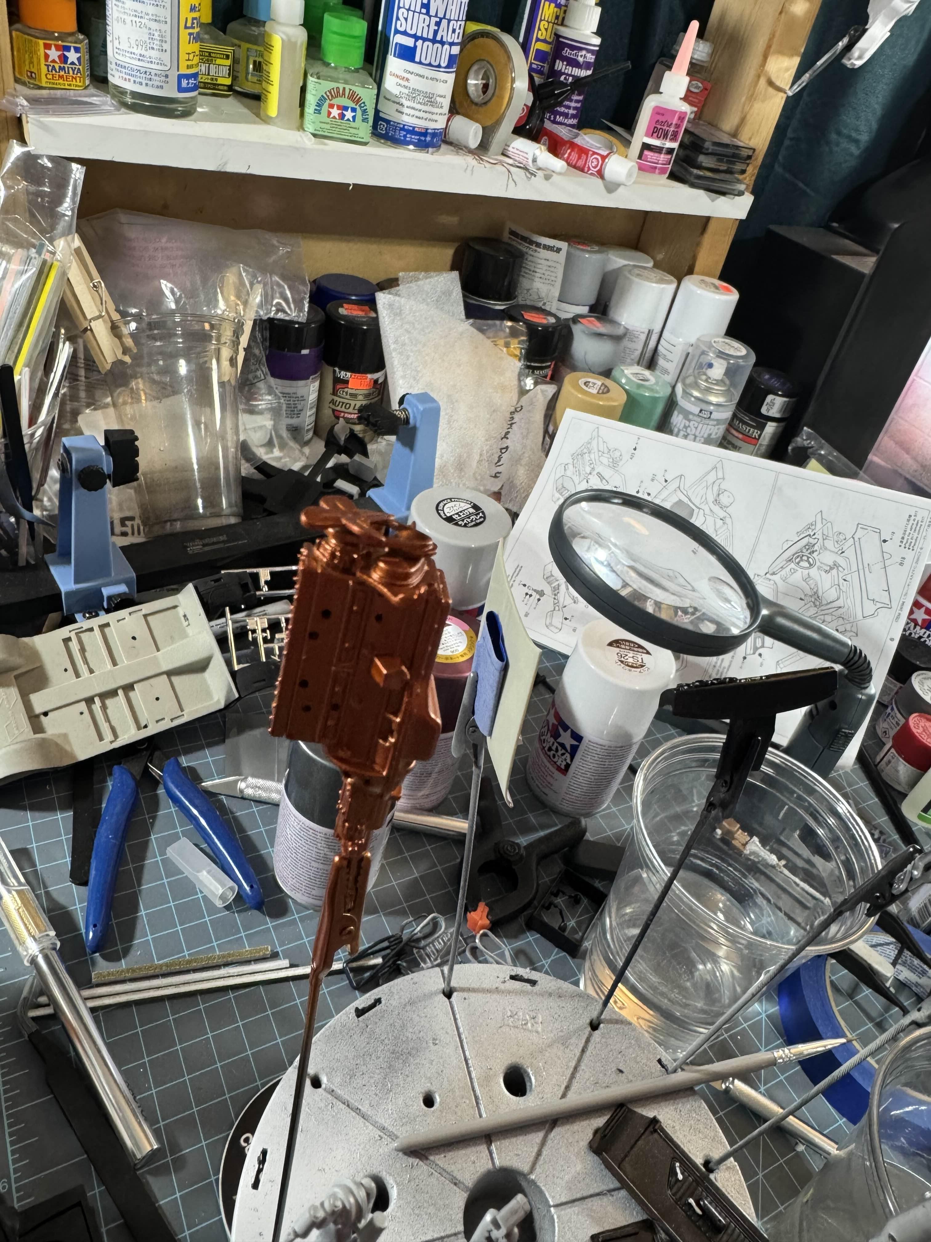

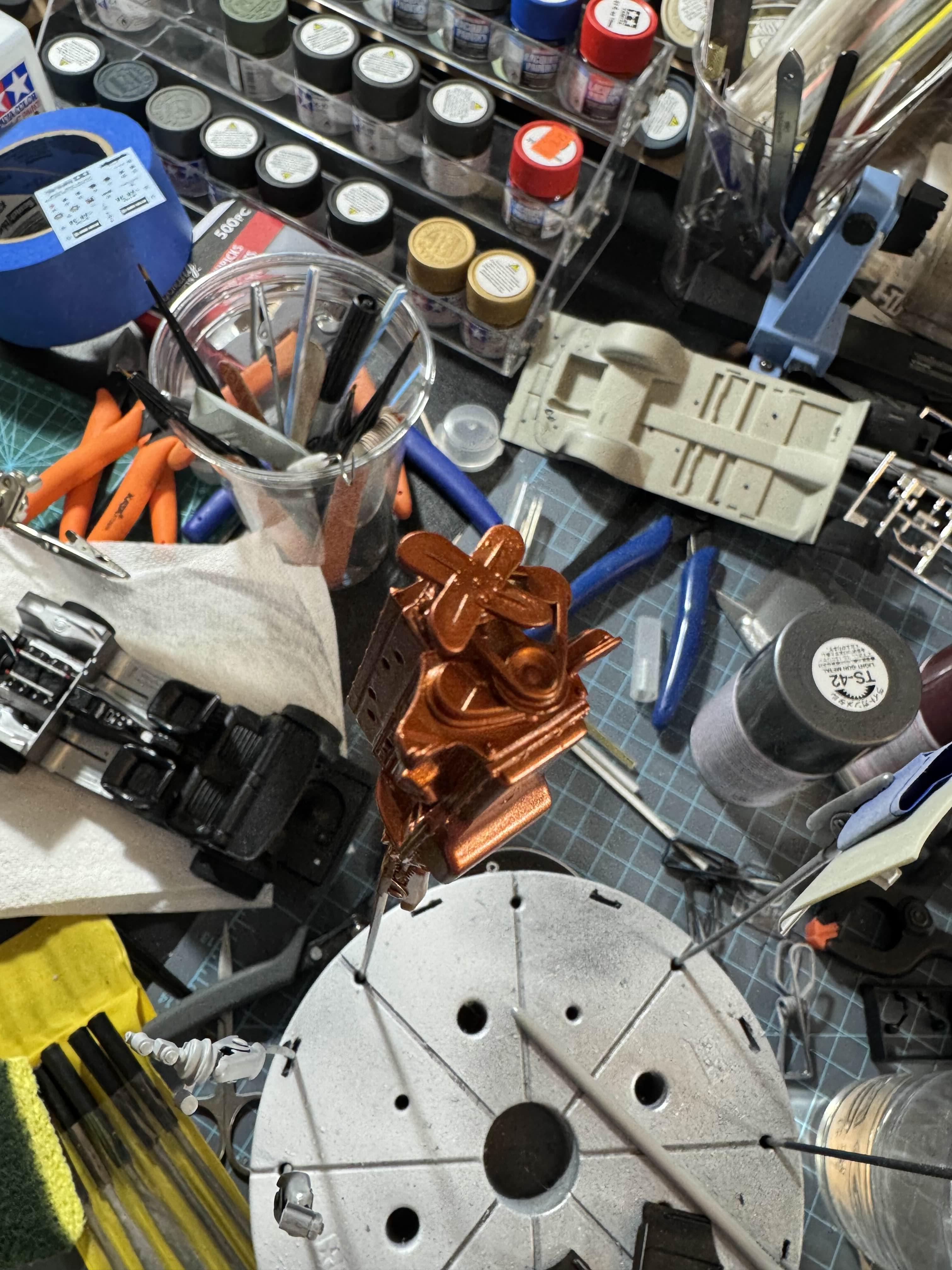

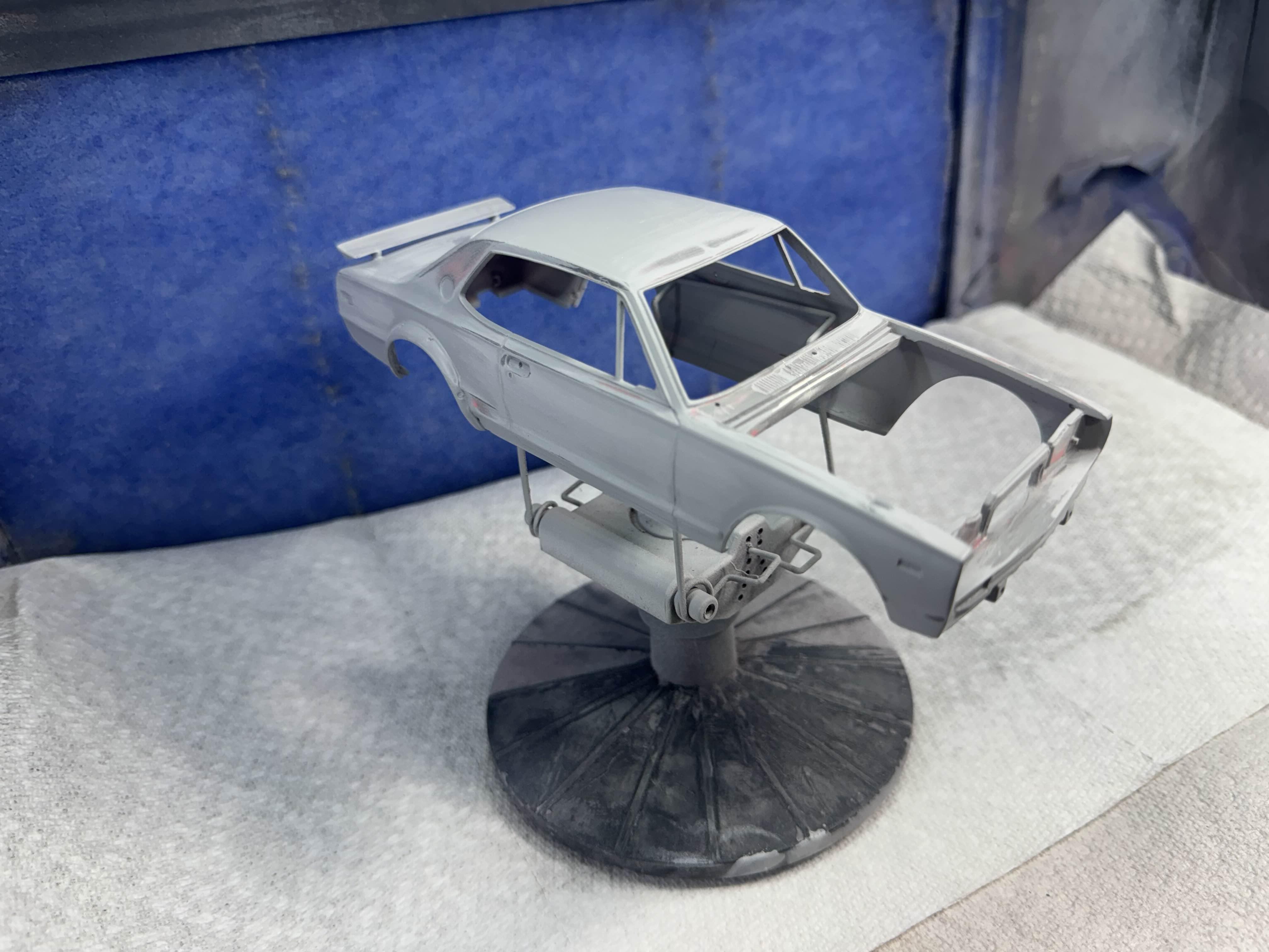

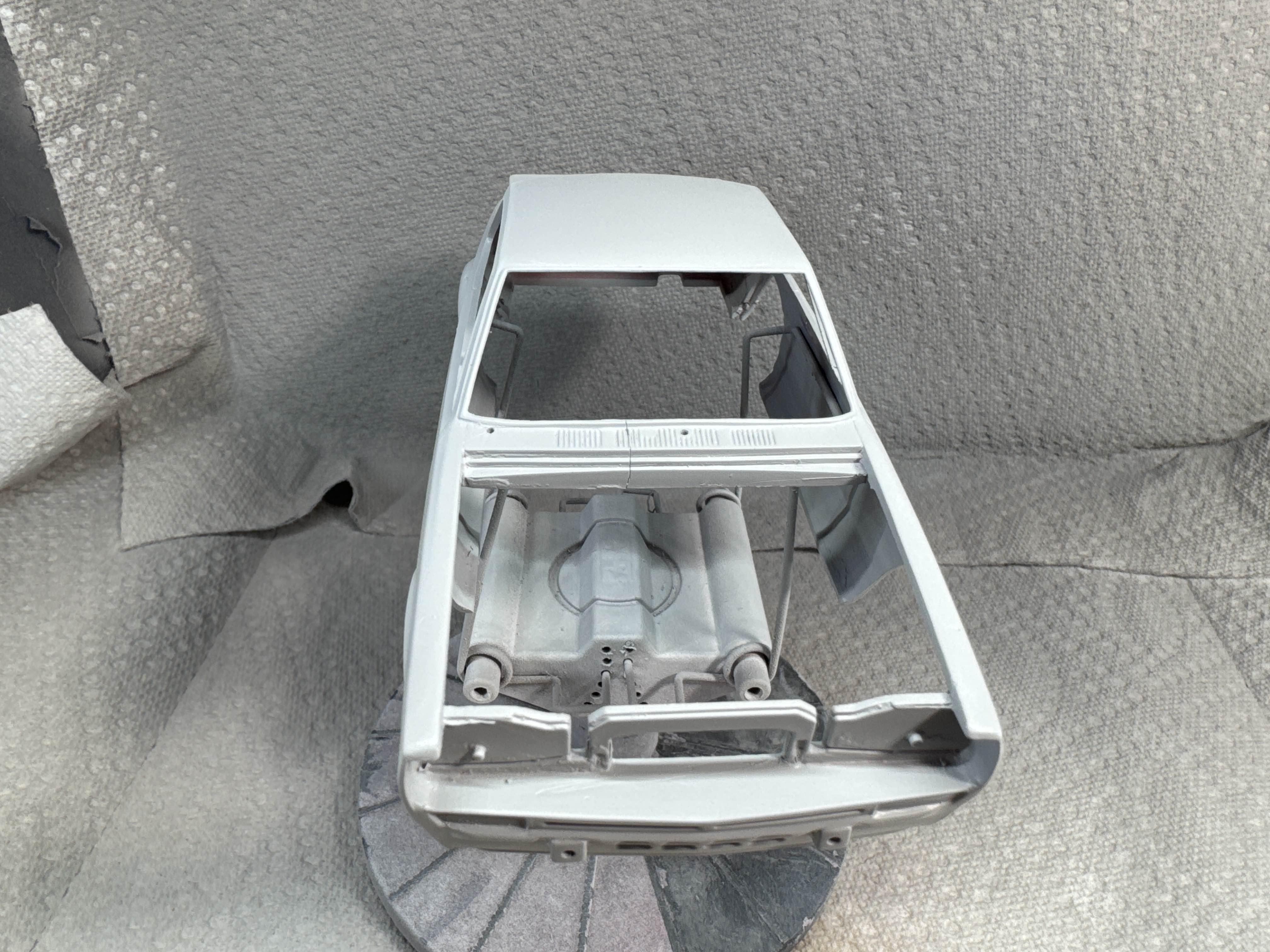

meechum68 Posted October 31 Posted October 31 Did some work on the Skyline... I had it ready and then stuff, so pond it went, and you can see where the body broke in the cowl area. I will goop it tomorrow morning and let it dry while I am working. I shot it grey primer so I can see what I have to do to get it ready for the pink primer. Primed some small engine bay parts for it, and primed the chassis parts for the Longbed Datsun I have going. Primed the bottom sides of the hoods for the Pontiac and the Hudson. Painted the Hudson engine Copper, turned out nice. Will detail it before adding more parts of the assembly to it, which I have to prime and paint and detail. 2

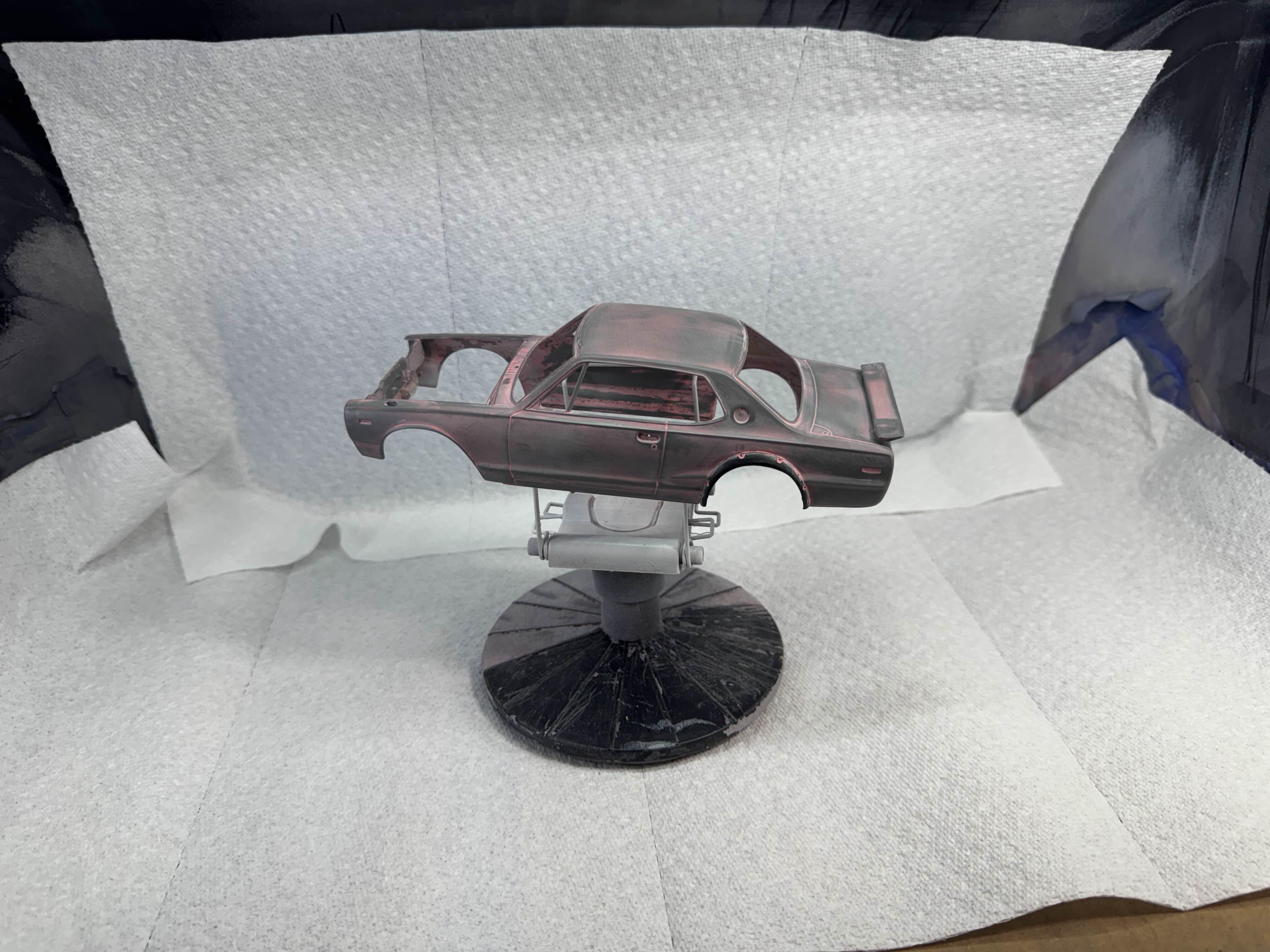

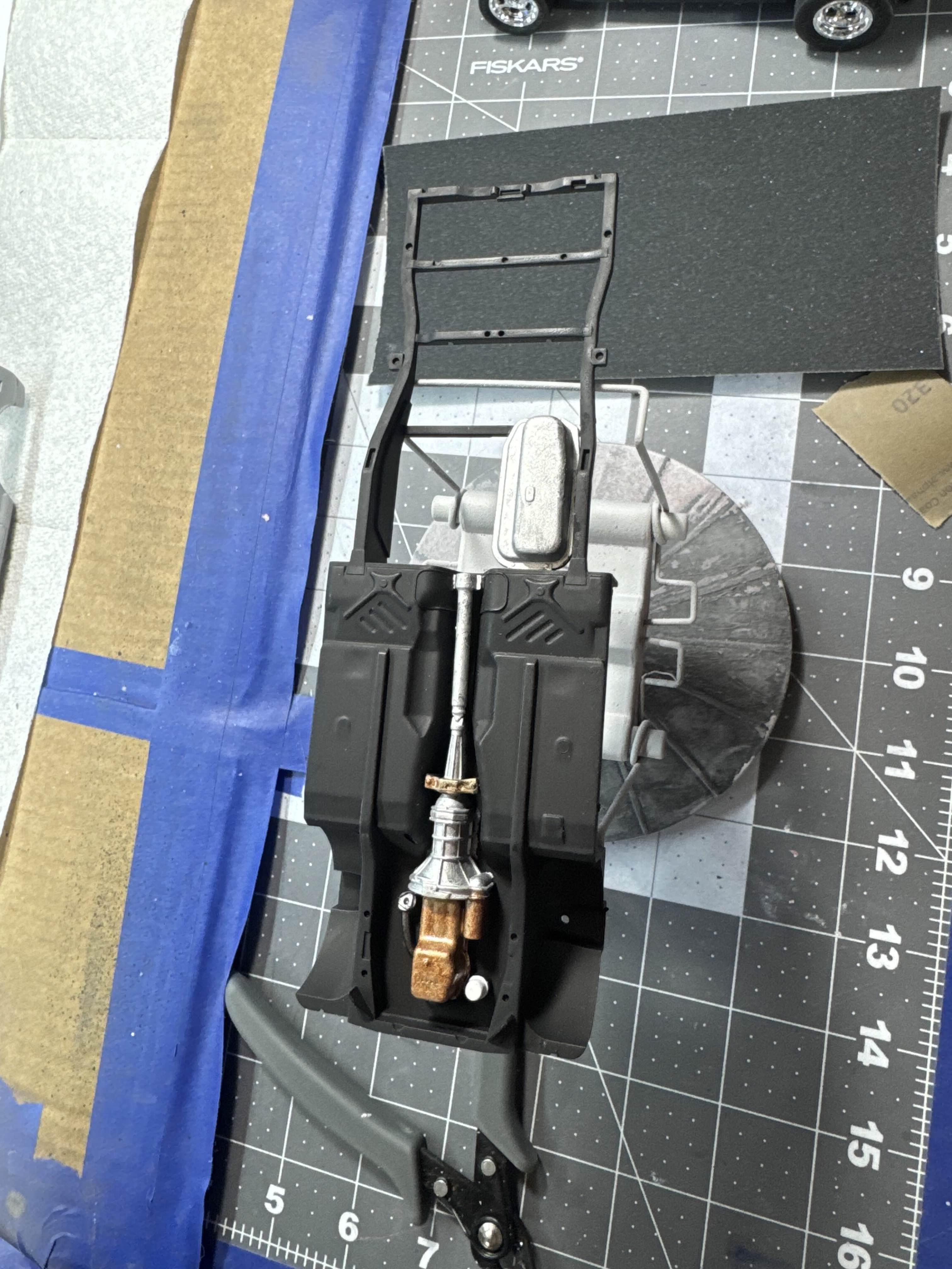

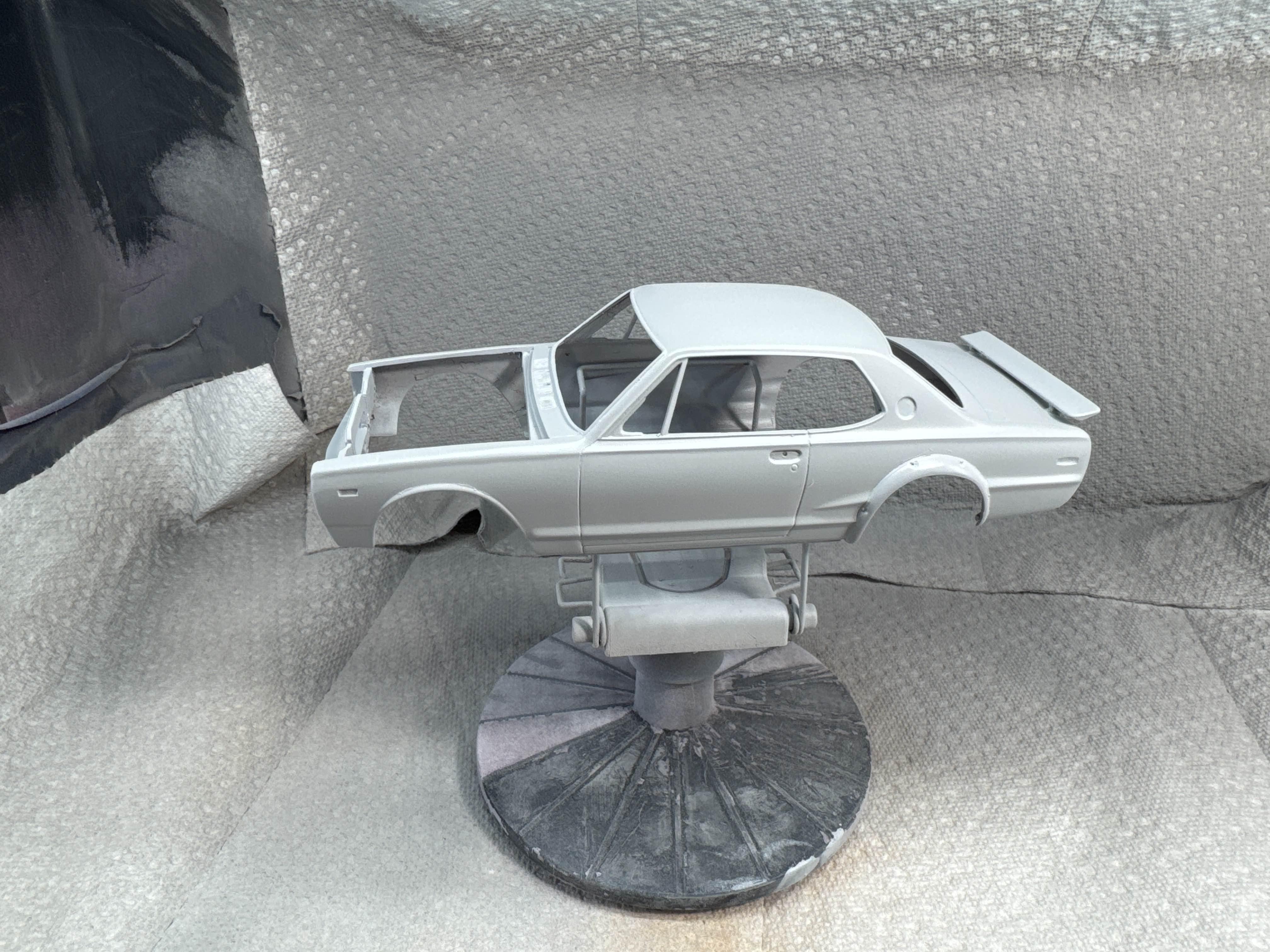

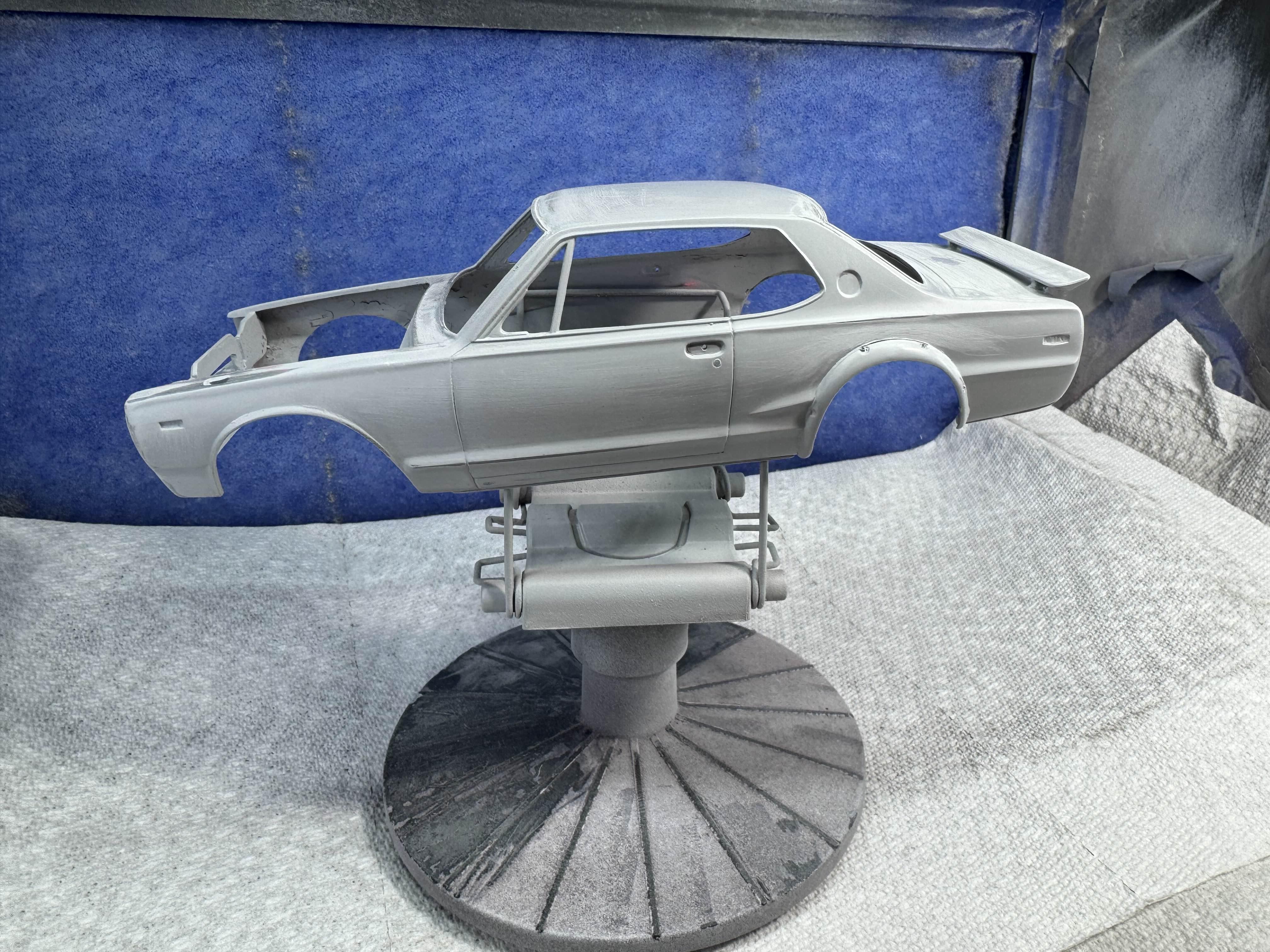

meechum68 Posted November 1 Posted November 1 Got some detail paint done on the Datsun and the rough spots on the Skyline sanded as well as the putty where I fixed the crack sanded as well. Will give it an alcohol wipe down to remove finger oil, and dust then lay the first coat of pink primer down. 4

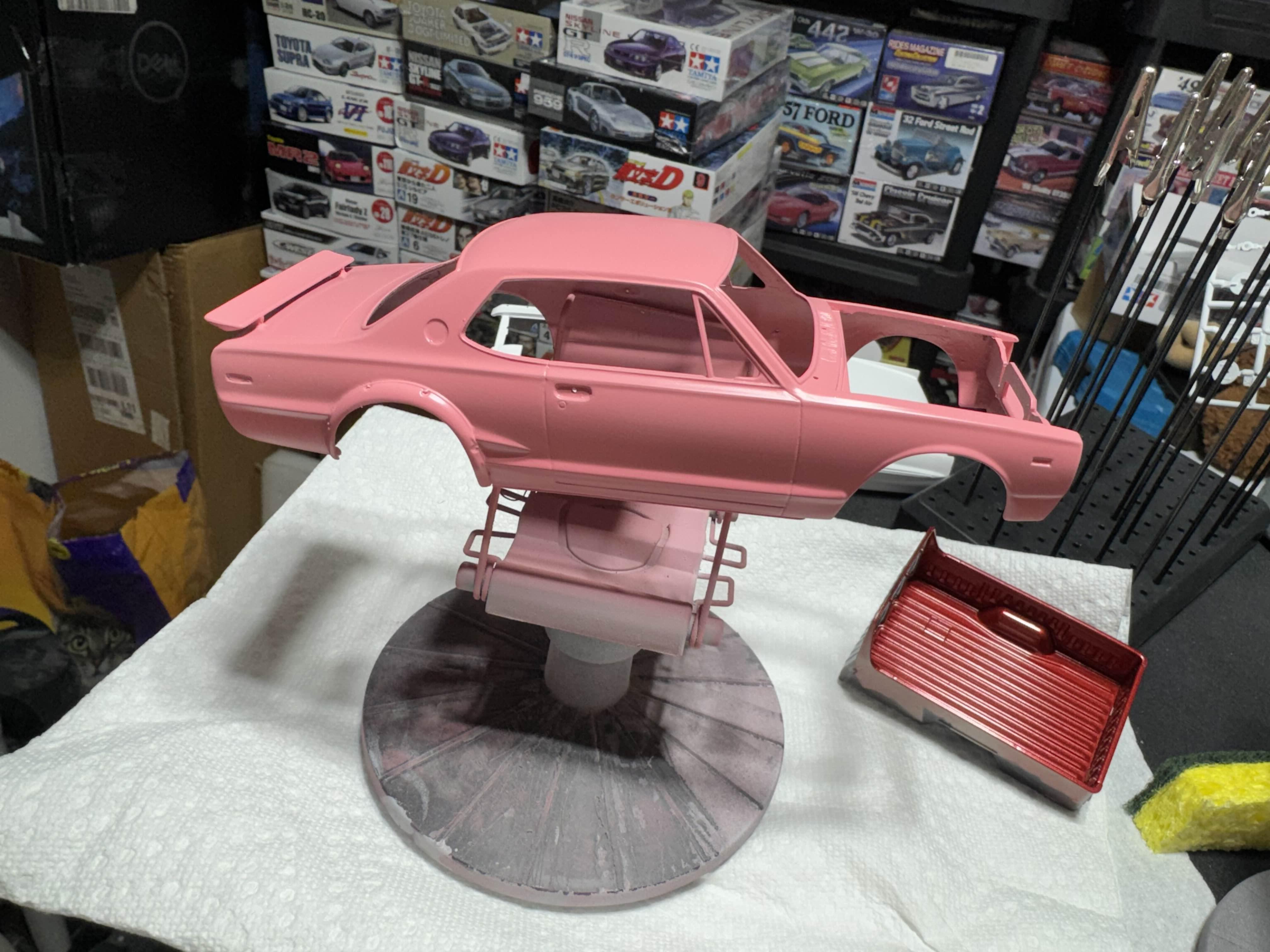

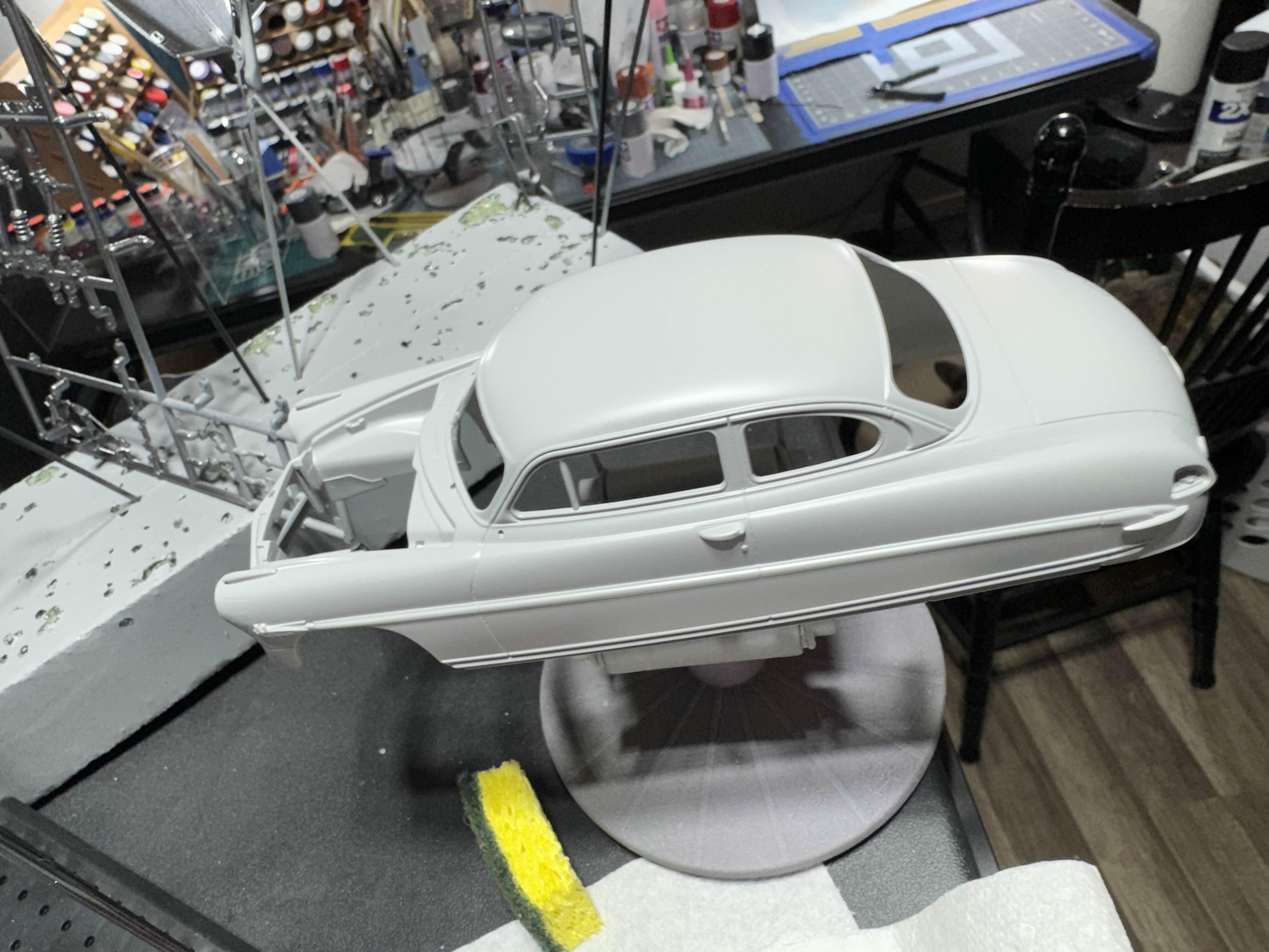

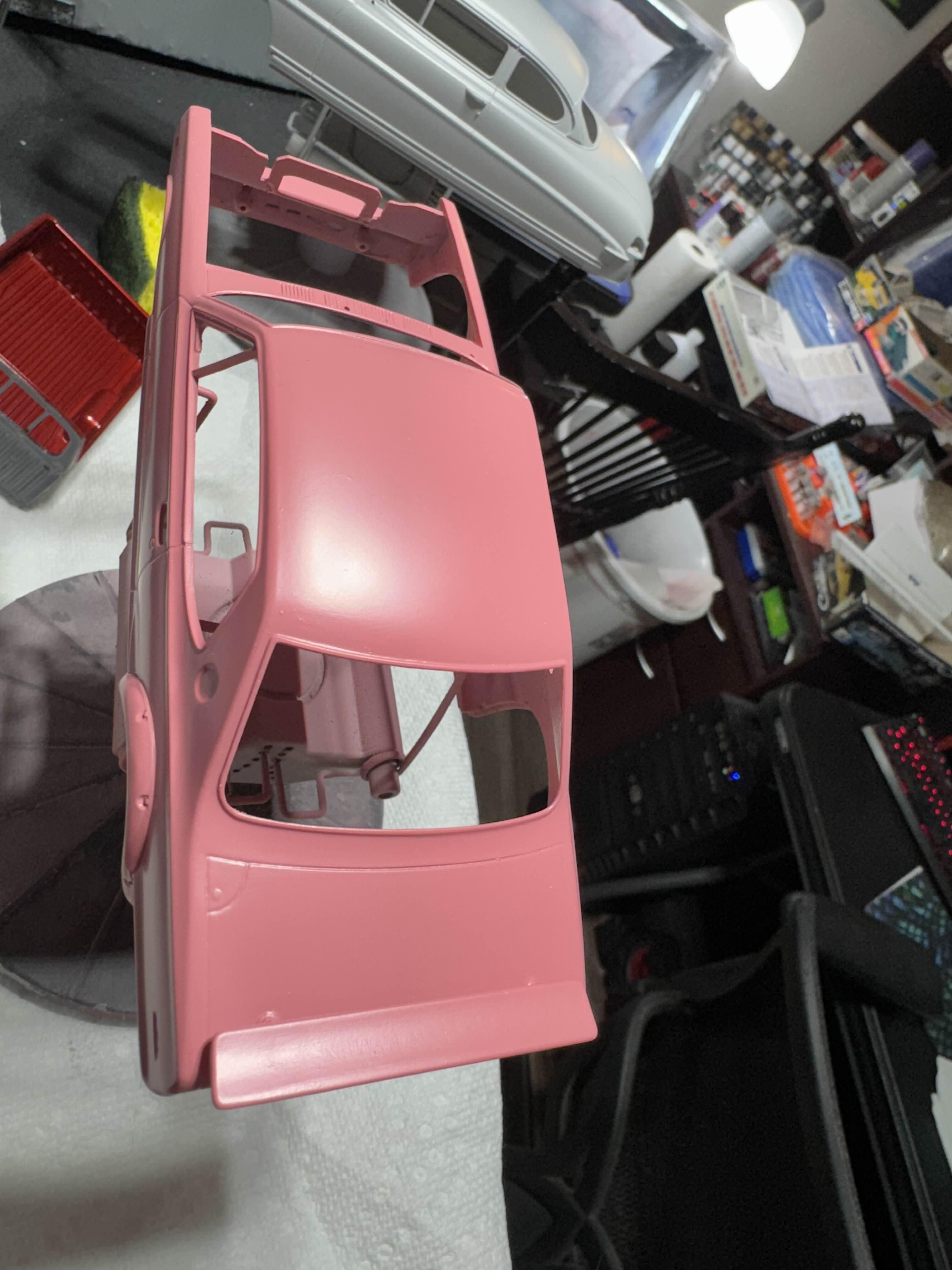

meechum68 Posted November 2 Posted November 2 (edited) Got the pink primer down on the Skyline, got the Hudson in grey primer and of course obligatory pic of the copper engine. I am going with. Got some other random parts painted too. Getting closer to doing some assembly on a couple other kits chassis wise. Edited November 2 by meechum68 4

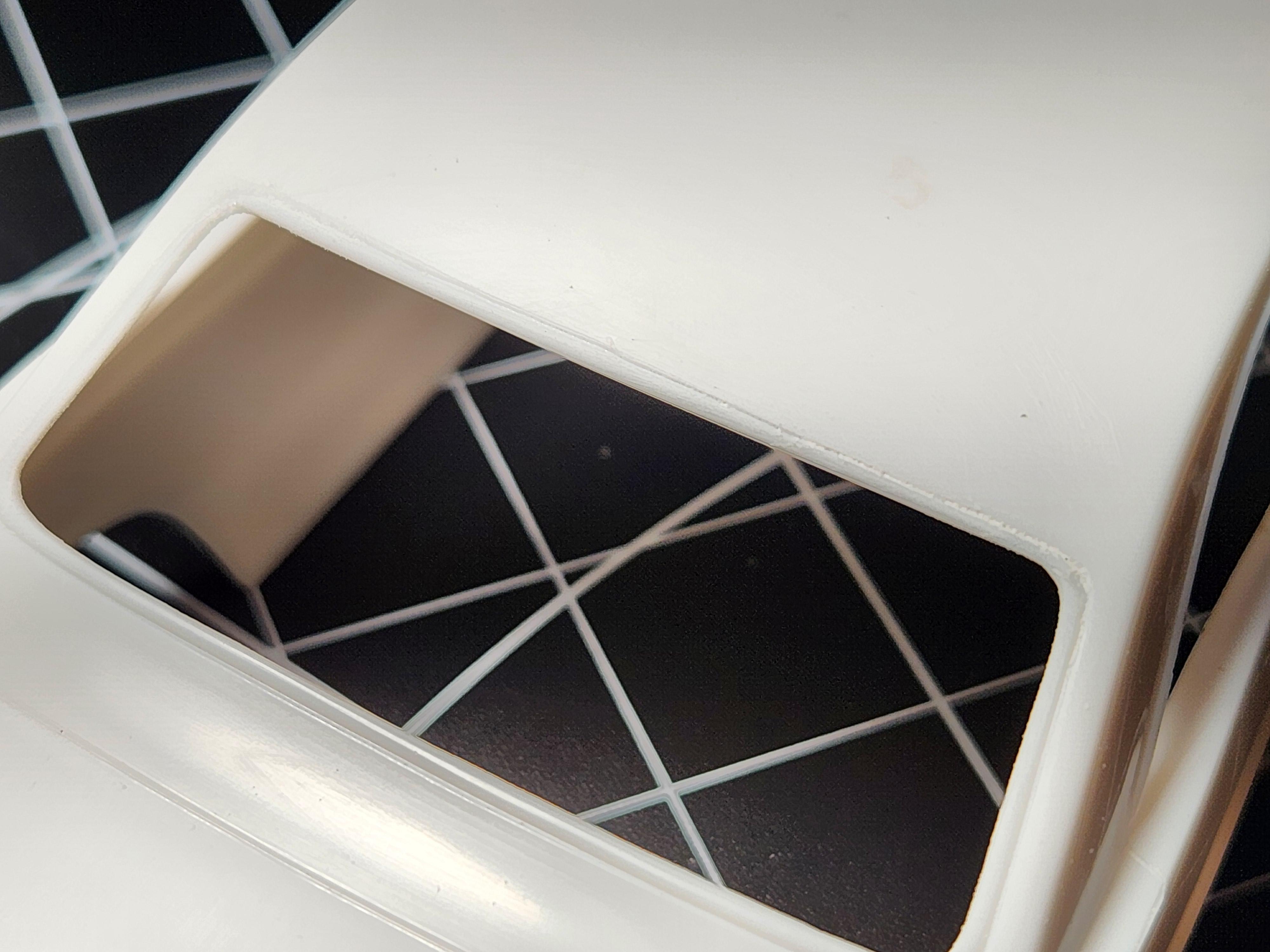

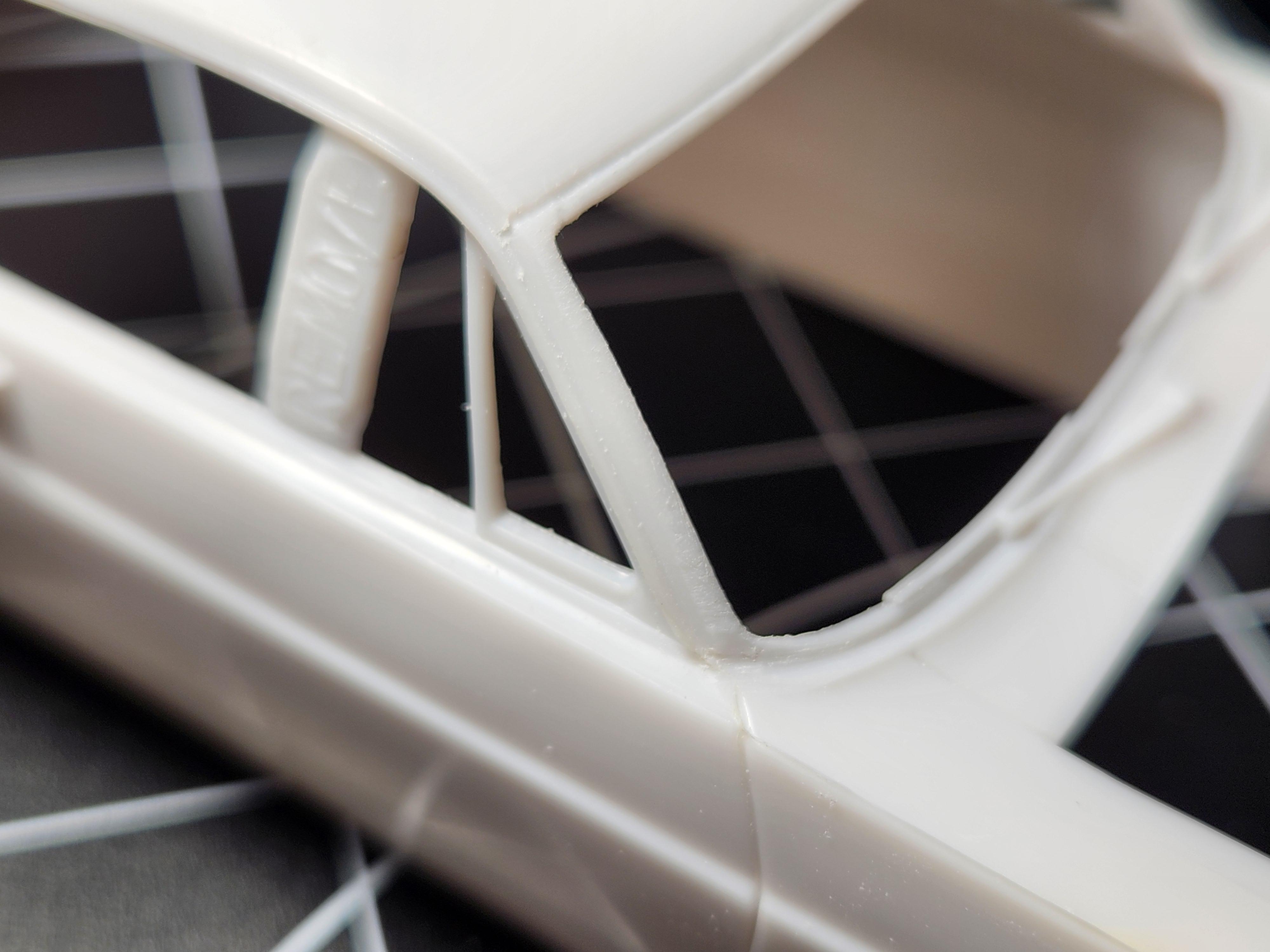

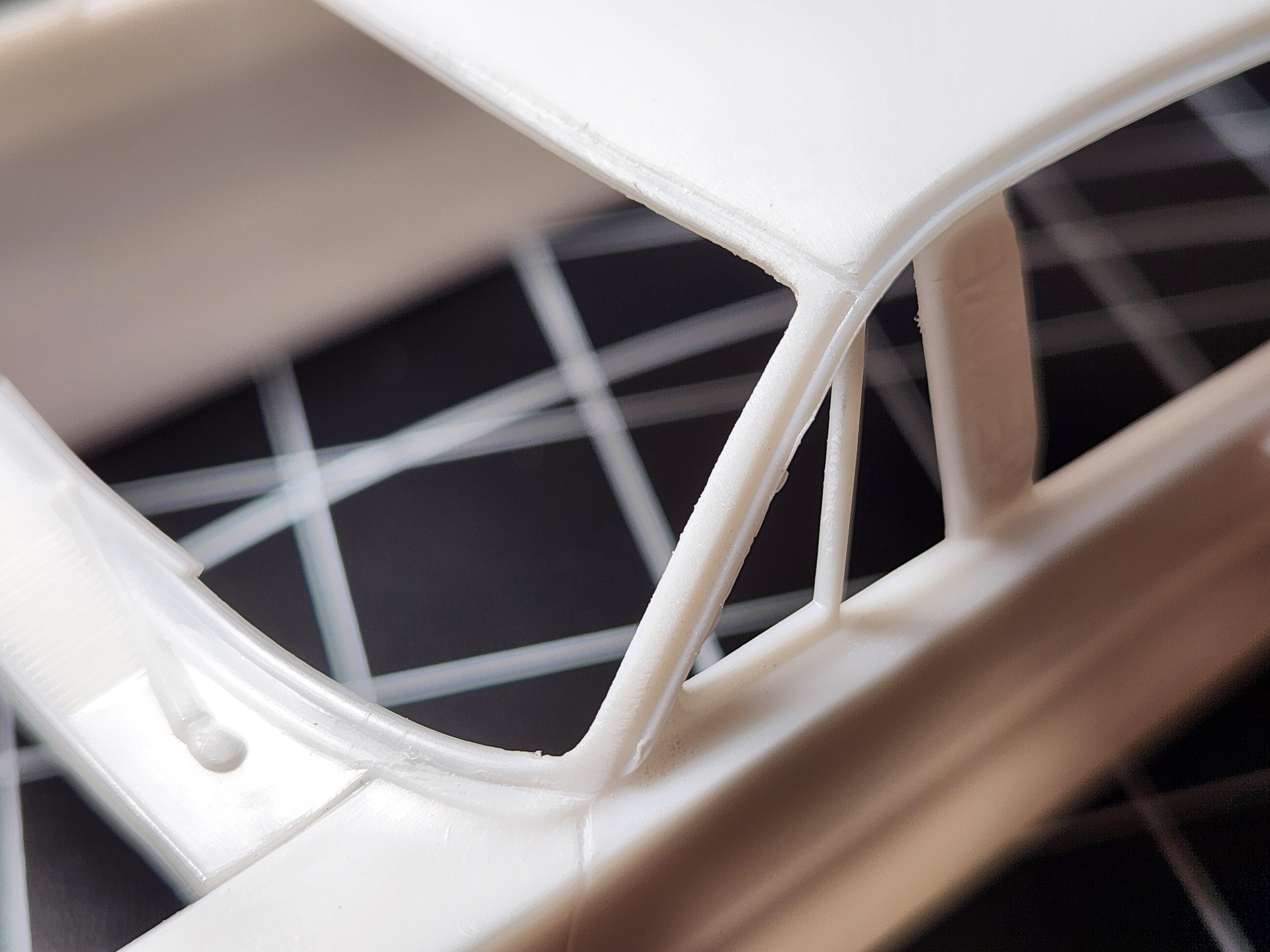

FoMoCo66 Posted November 2 Posted November 2 After finishing up 3 cars I was tapping my fingers on what to do. So I decided to correct the window openings on the amt 66 fairlane. Moved the rear and front window openings upward. The trim on the windshield is also not represented correctly, it is one solid piece of trim from the window to the door. This means the curved part had to go as well as meaning I could thin the a pillar. I actually used a 66 falcon annual as a guide because on the 1:1 they are the same in this area. 4

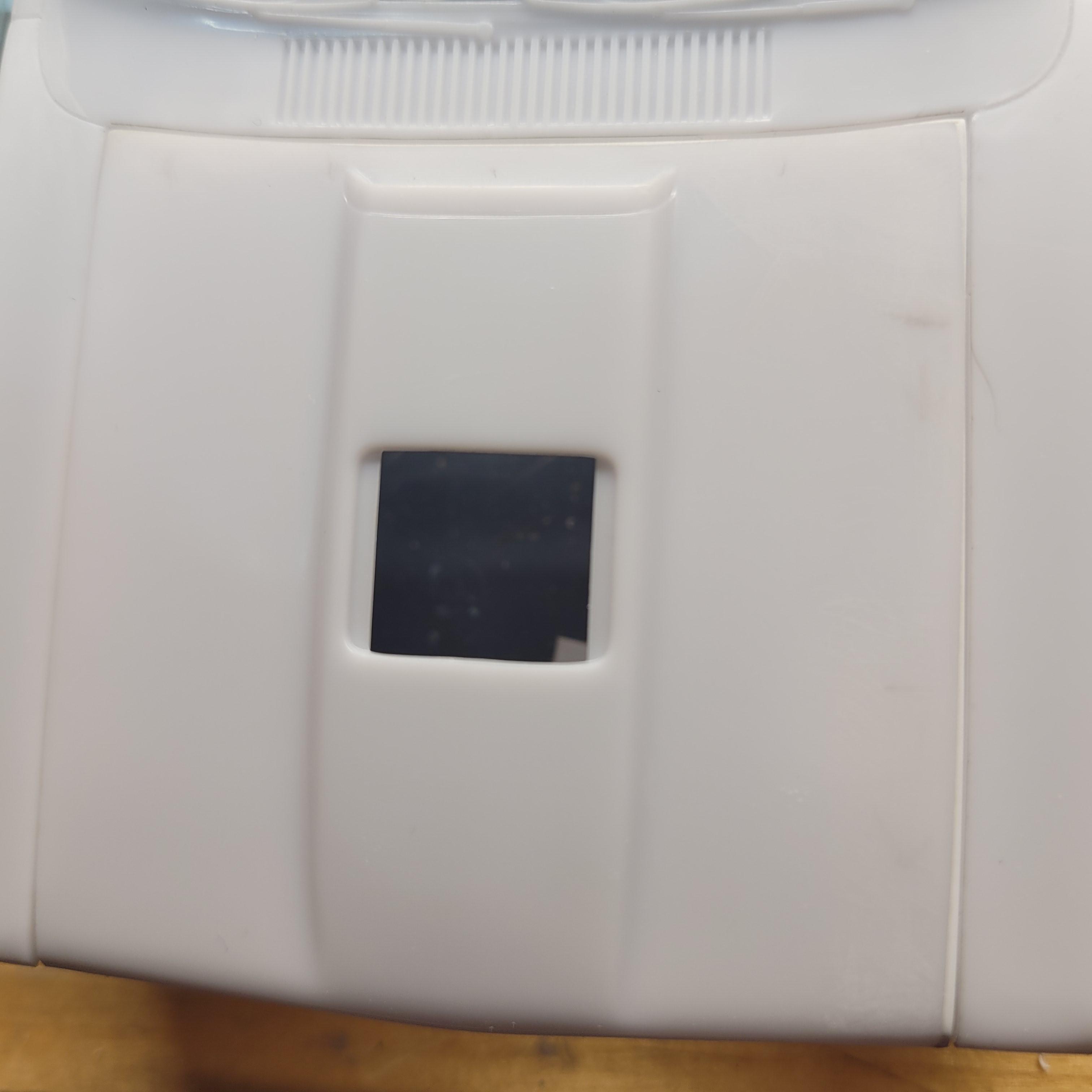

johnyrotten Posted November 2 Posted November 2 Fixed this hood, had to add styrene on the back edge and side, there was a mile missing. Gaps look better now an it fits properly. 4

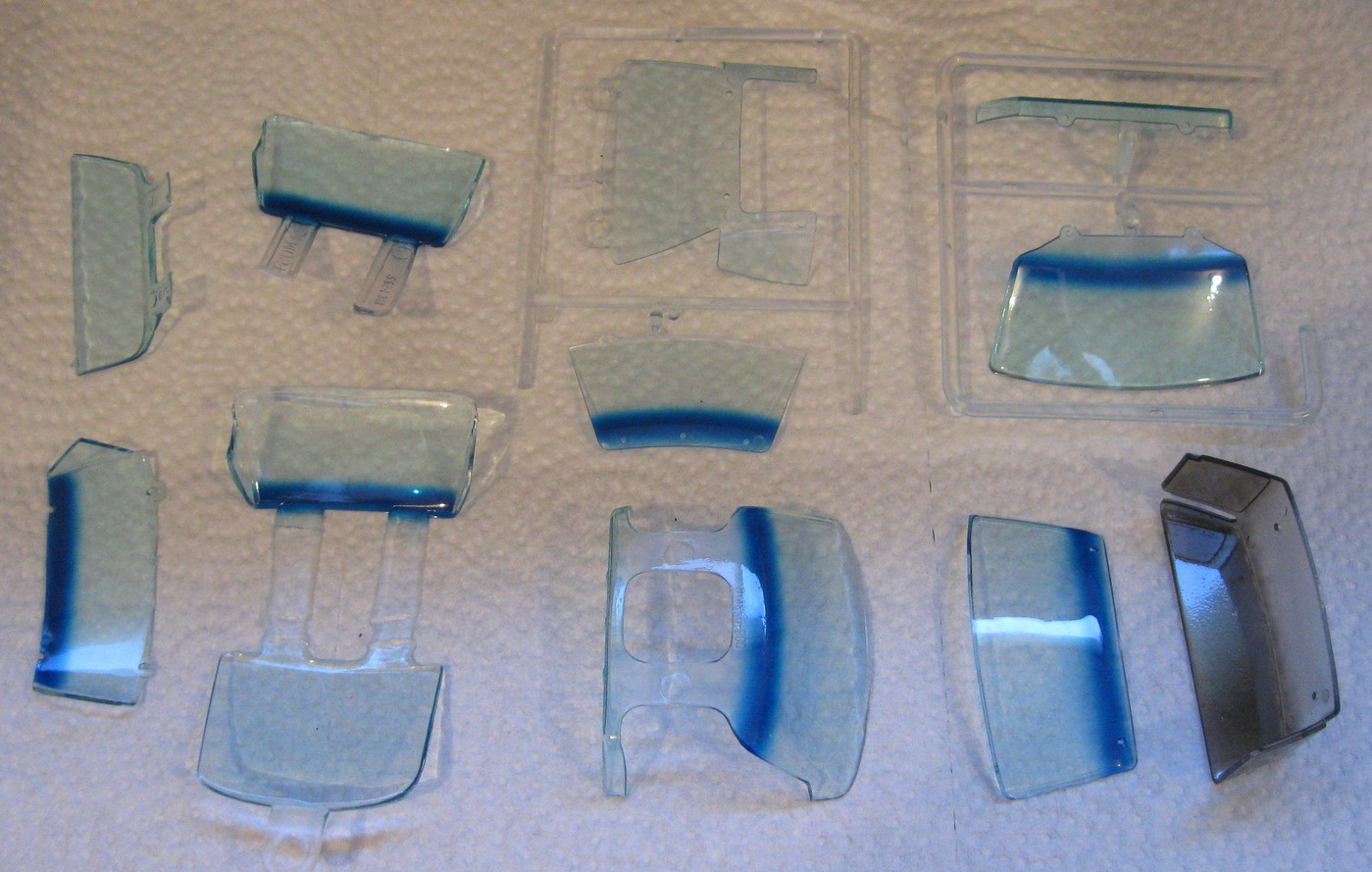

Can-Con Posted November 2 Posted November 2 Tinted up a bunch of windows. Had to do the ones for my '64 Elky project so I did a bunch for future projects at the same time. I usually do them in batches of about a 1/2 dozen kits at a time. Then the paint is fully dried for several months or more before I wet sand and polish them out. It's all Tamiya acrylics. Dark sea blue for the tint bands, a custom mix of clear blue and green and strait clear [X-22]with a couple more coats of X-22 so I don't polish into the tint by accident. 5

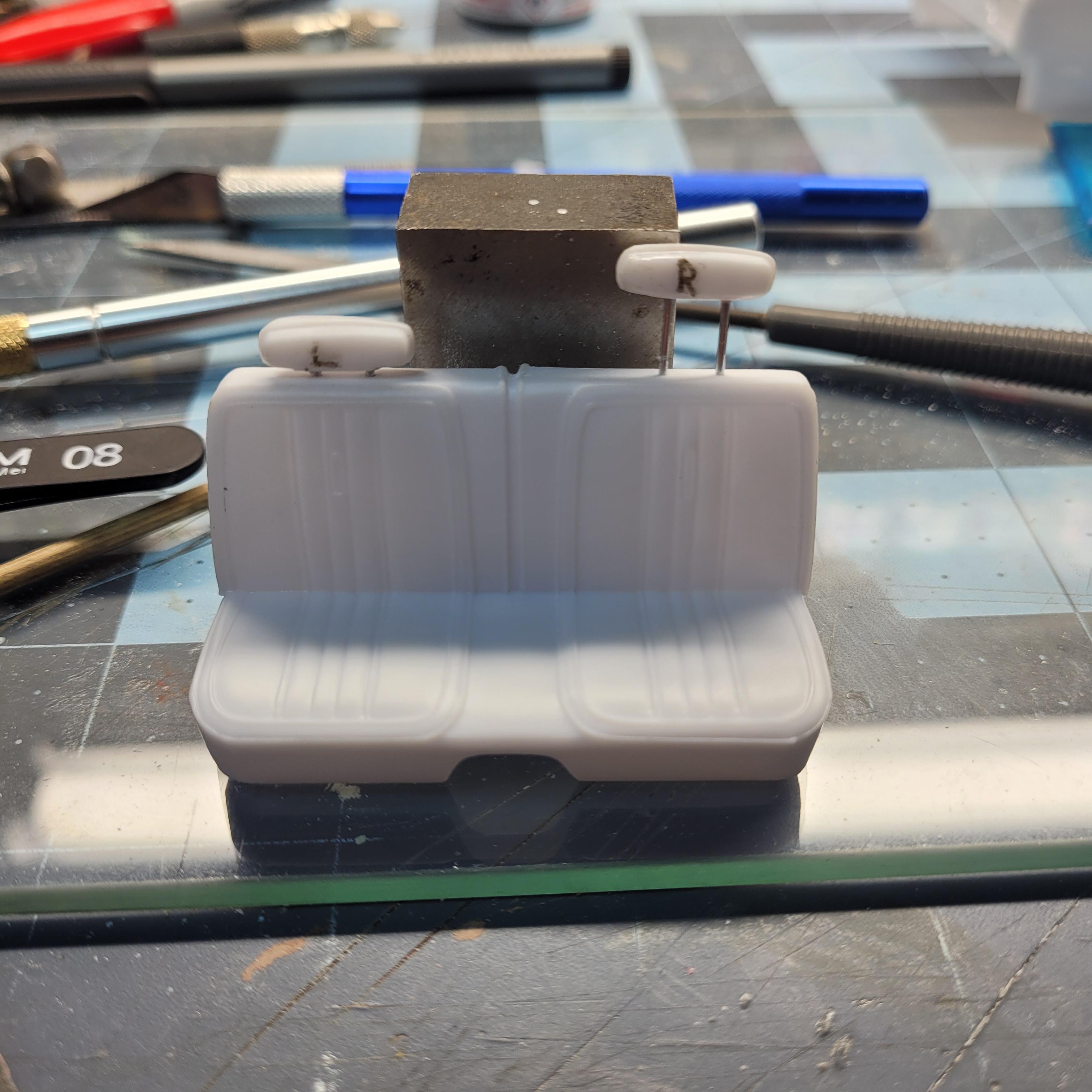

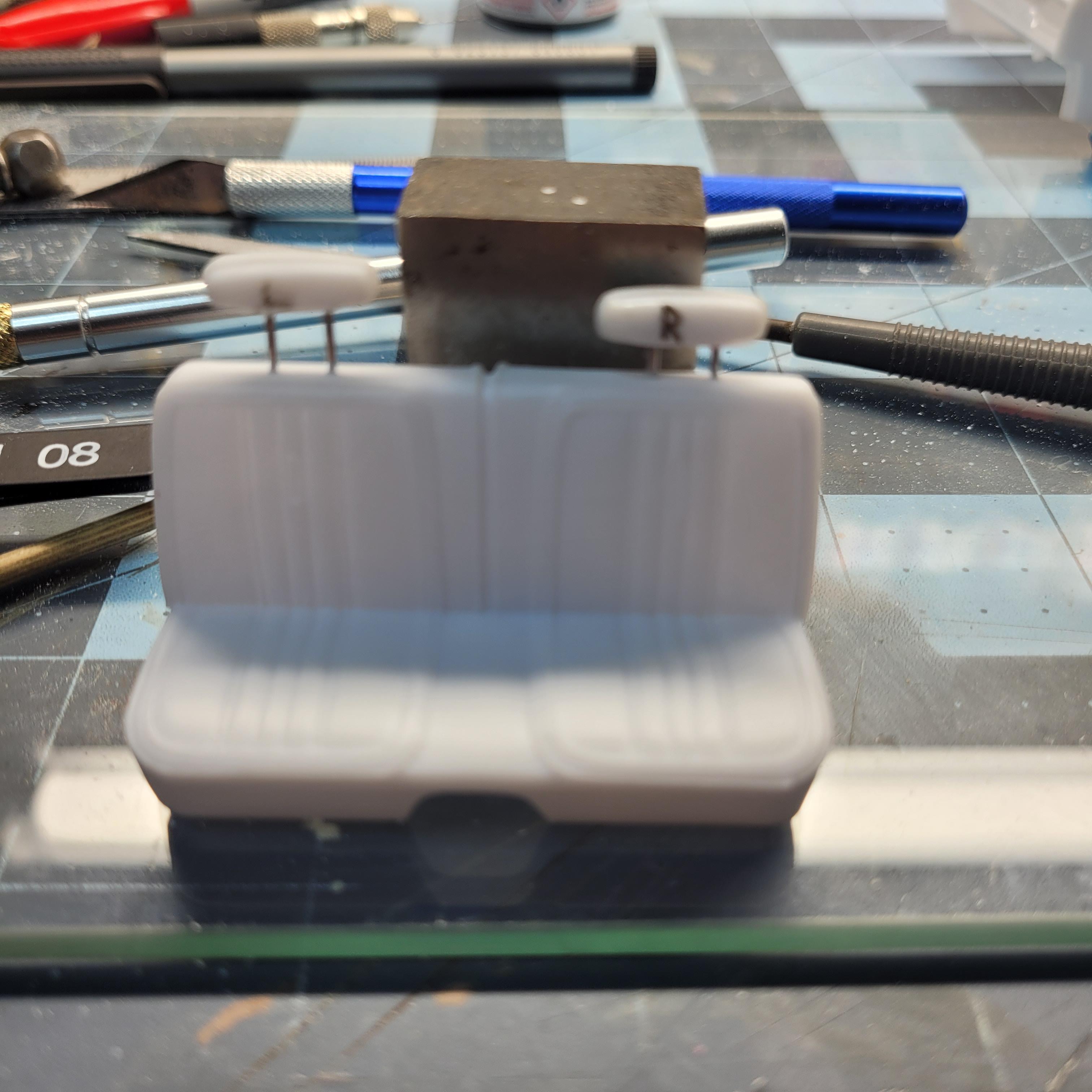

johnyrotten Posted November 3 Posted November 3 Made adjustable headrest as well as got everything ready for primer. I'm on a roll this evening. 5

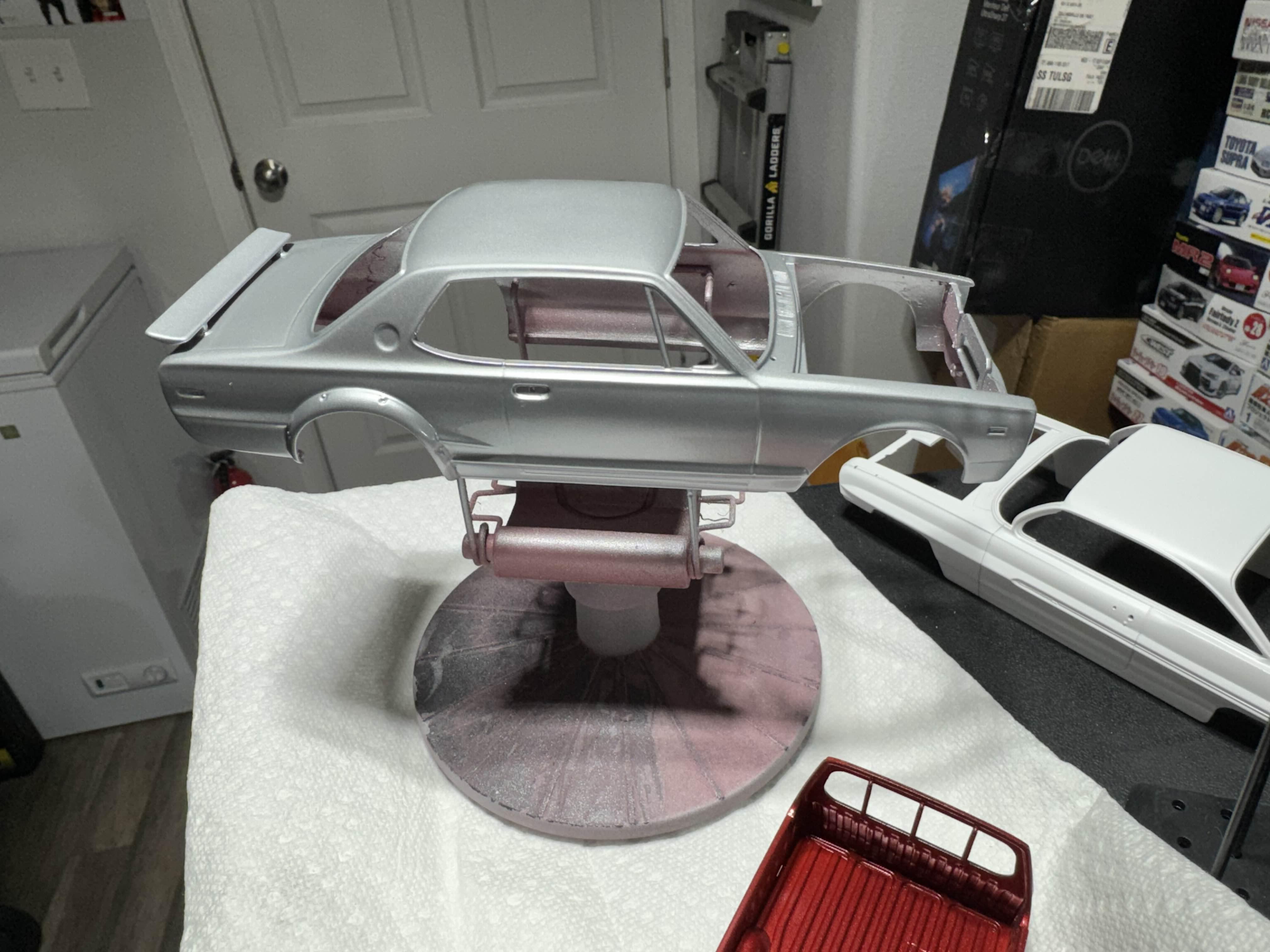

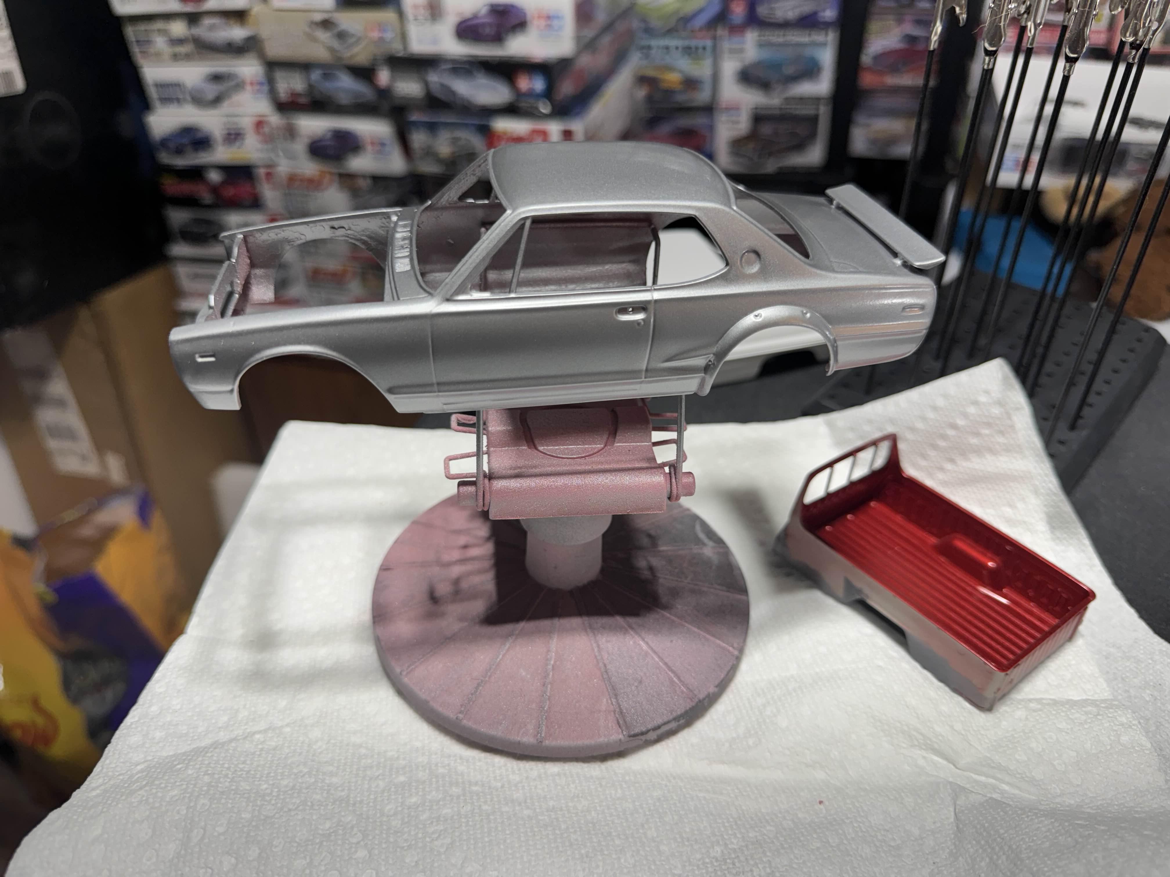

meechum68 Posted November 4 Posted November 4 I got a little bit of work, well spots of stuff here and there done. My little Datsun, wheels assembled, rear suspension in place, have to paint the shock (I realized this after I mounted stuff) will line out the front tomorrow. Will prime 2 pieces for the front suspension tomorrow. Then have to figure out the interior, I think I am gonna go with metallic blue just for some pop. The Skyline primer should be done, I didn't see any defects during the last primer coat. If that's the case, then tomorrow first coat of Mica Silver. The Hudson, I had to hit the left front fender with some putty, so should be able to get it fully primed tomorrow.

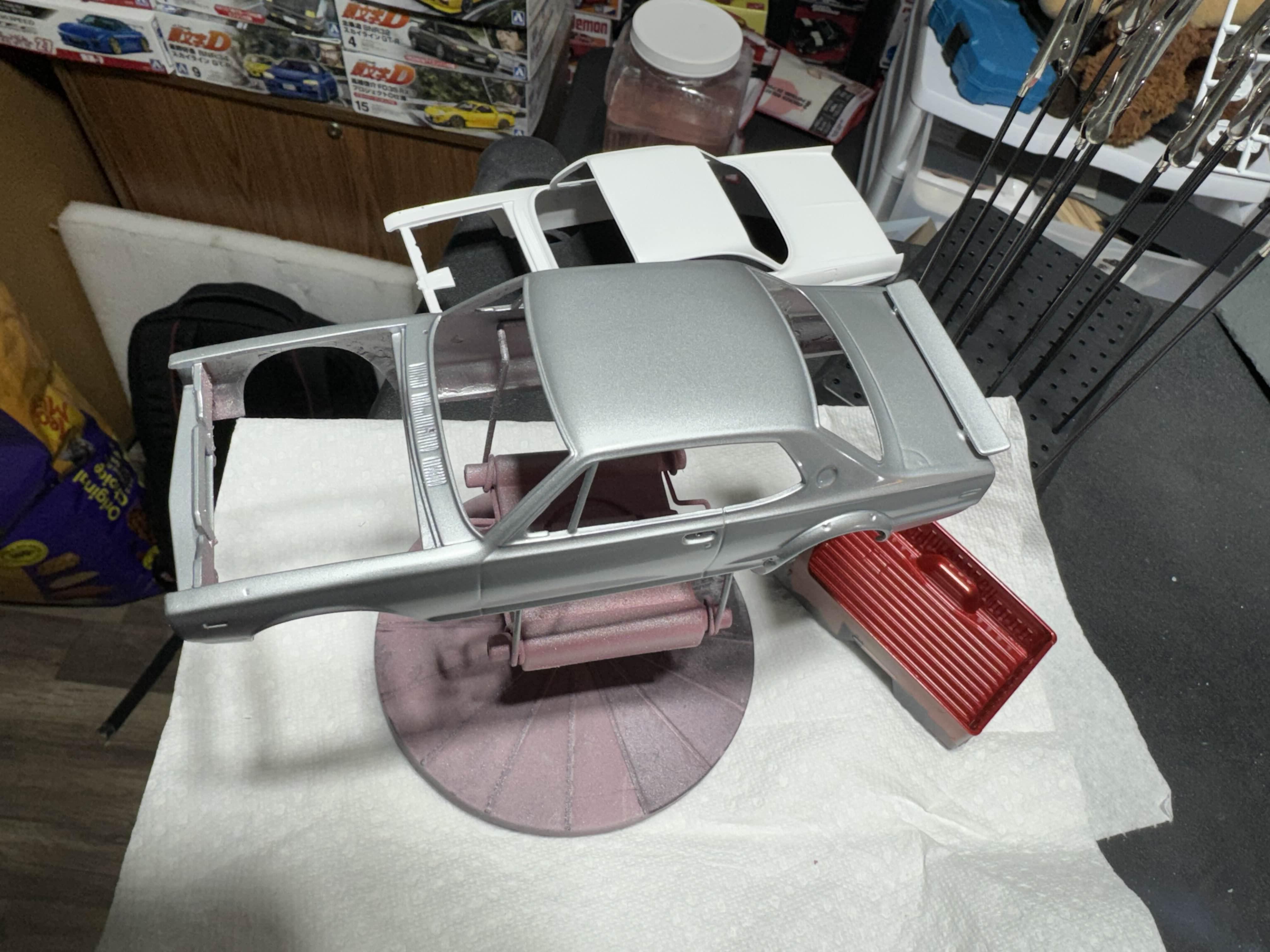

meechum68 Posted November 5 Posted November 5 Did some primer on the Hudson, small parts for the Sunny Datsun painted, wheels for the Catalina painted and the Skyline got some new color! 3

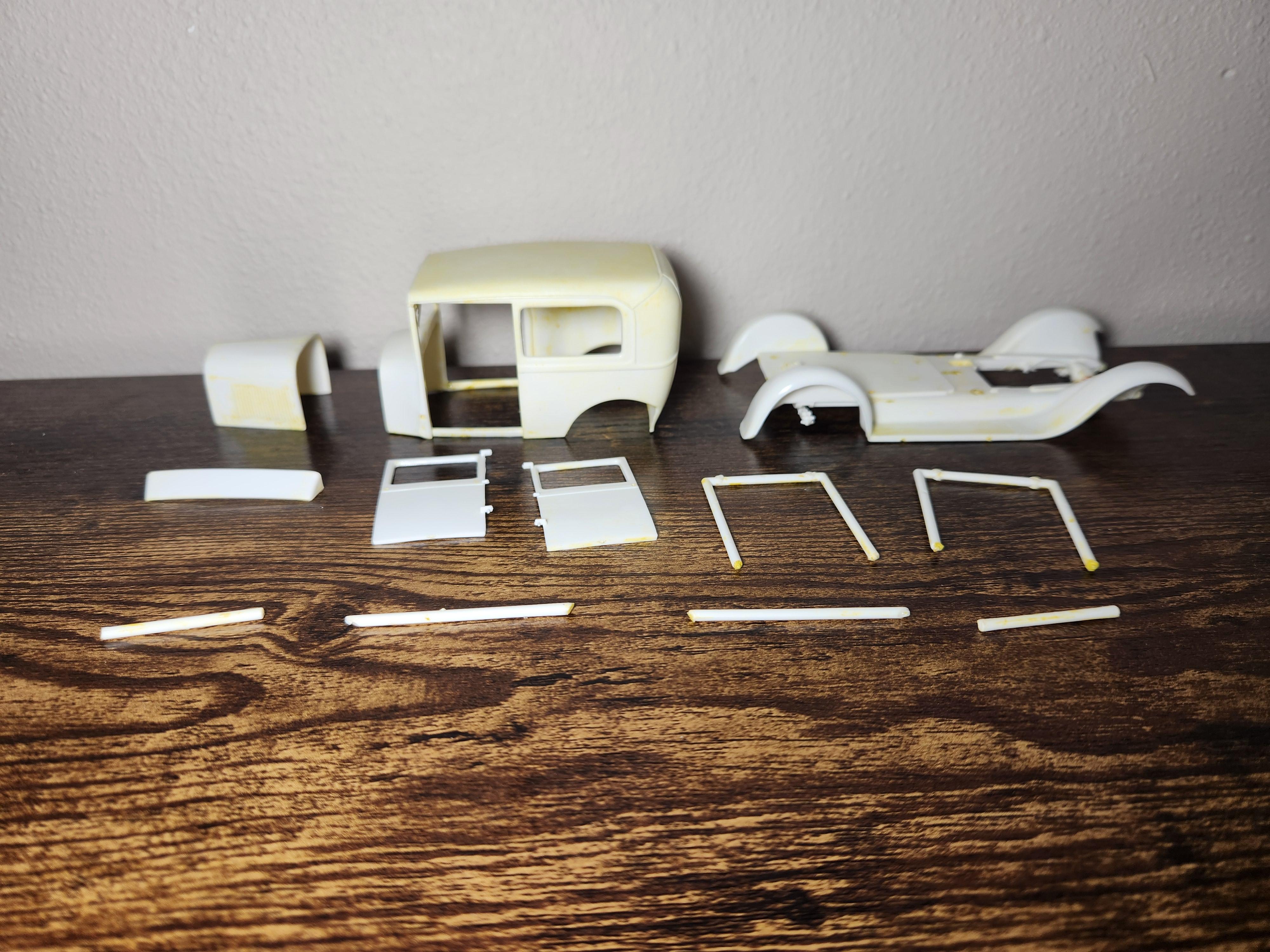

FoMoCo66 Posted November 6 Posted November 6 (edited) Got my 28 sedan out of the stripper, it looks pretty clean. Some lime green is still there but mostly only in the roof and foot texture. It's a pretty good starting point for when I build it. Edited November 6 by FoMoCo66 2
