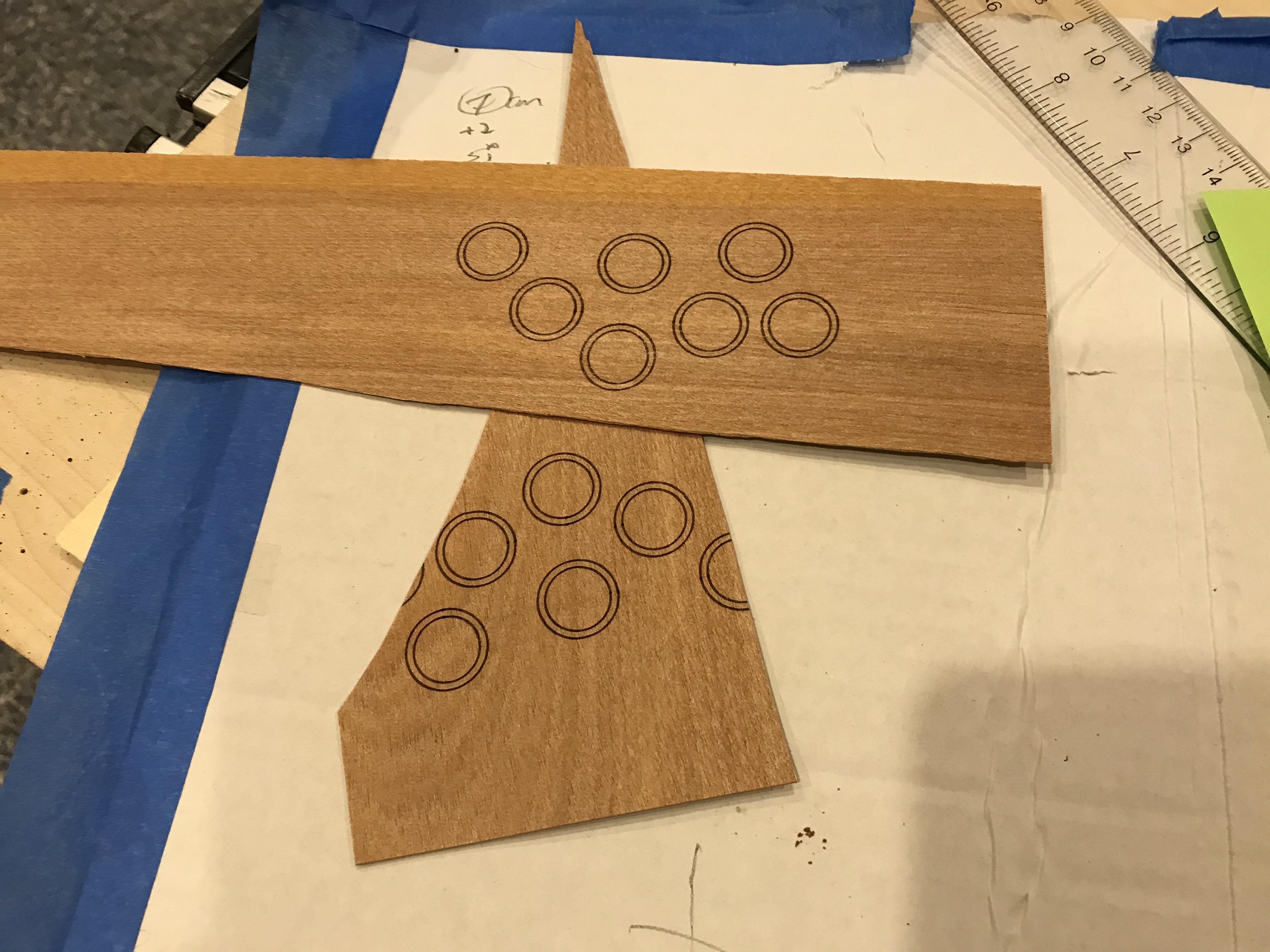

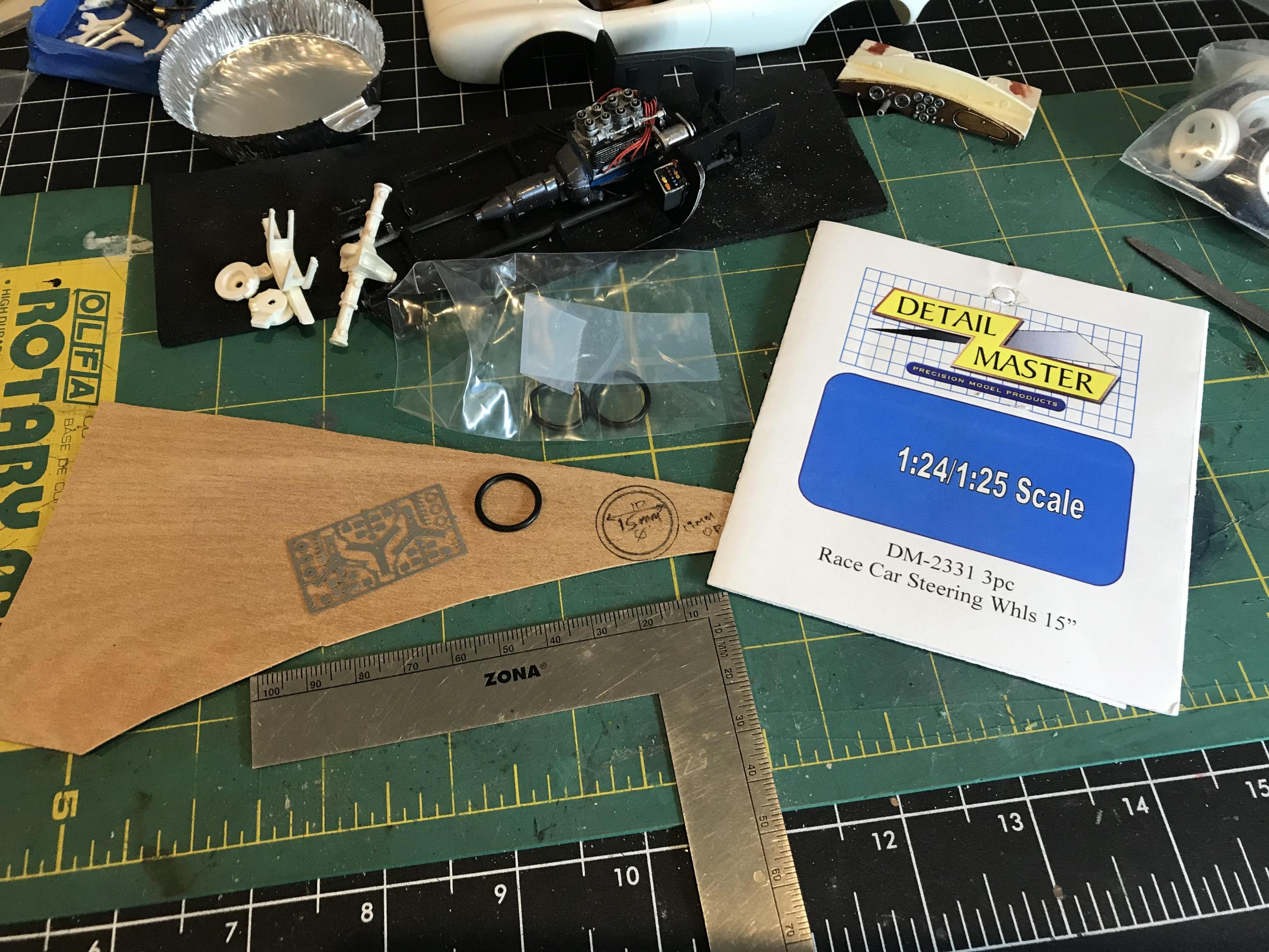

Anybody making wooden steering wheels?? Like with real wood?
I bought a PE set and the steering wheel is rubber....blah
I have been trying to cut out appropriate circles with a laser cutter so I can glue them up and make the wheel rim. SO far not great, the veneer chips out too easily
Like to hear any opinions on how to do real wood steering wheel fab

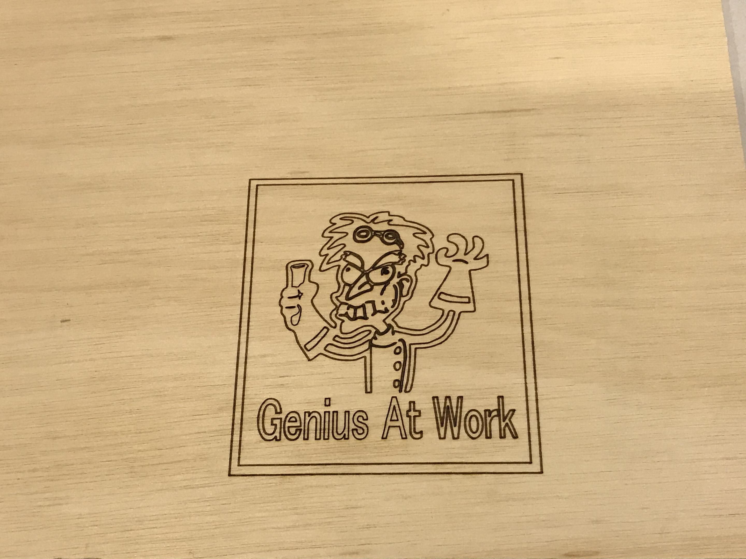

Then I made a mad scientist sign:lol:

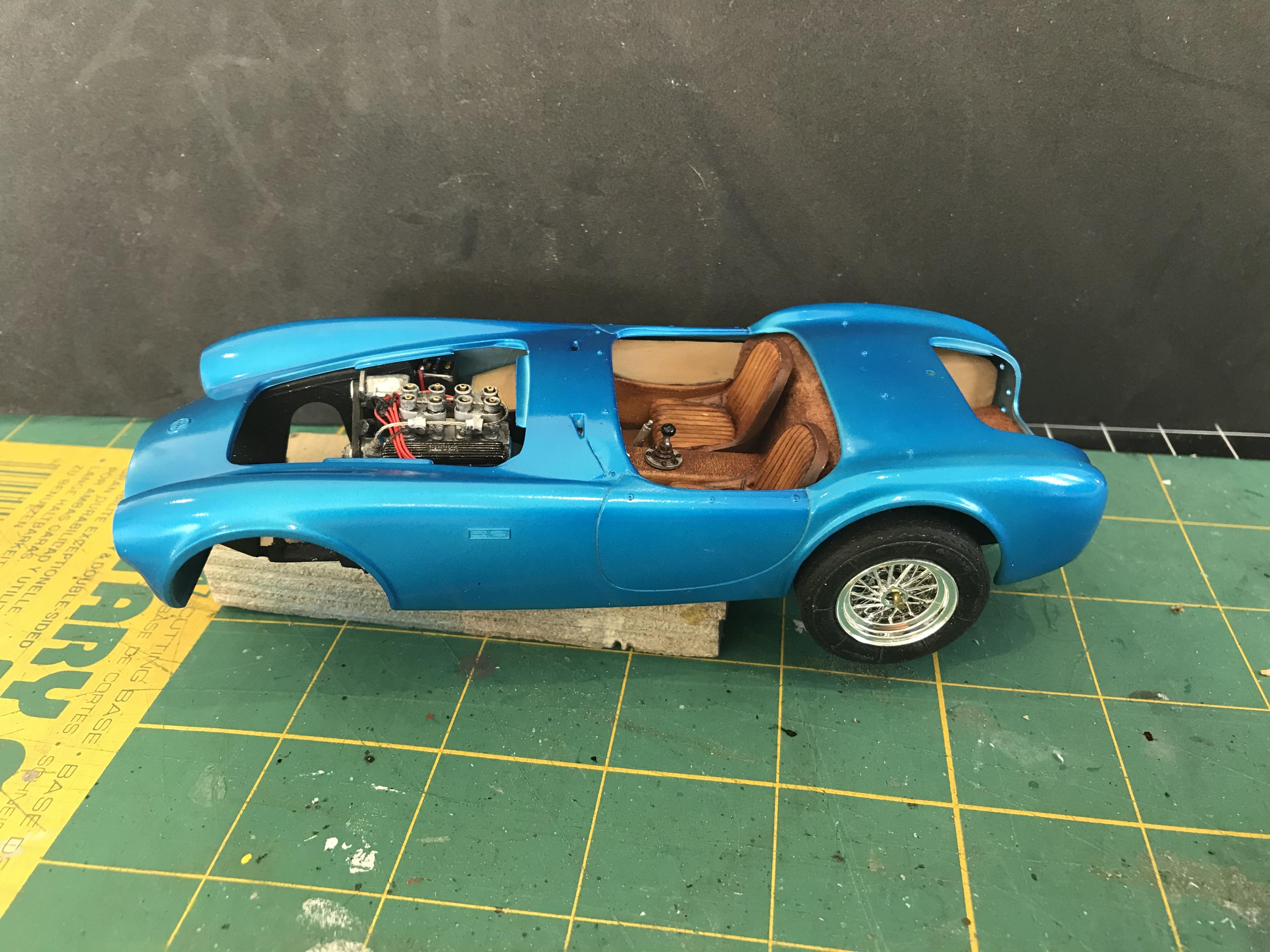

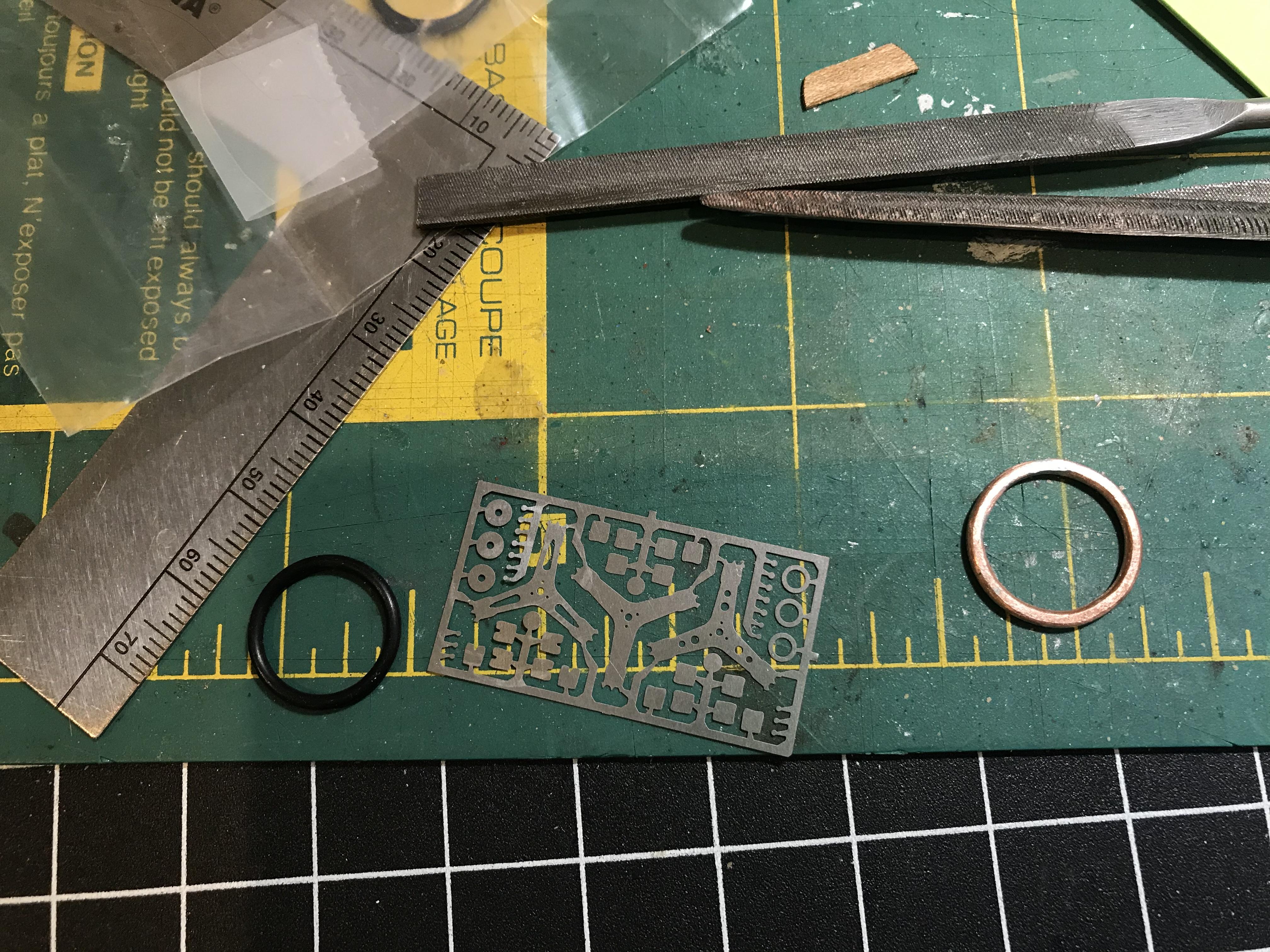

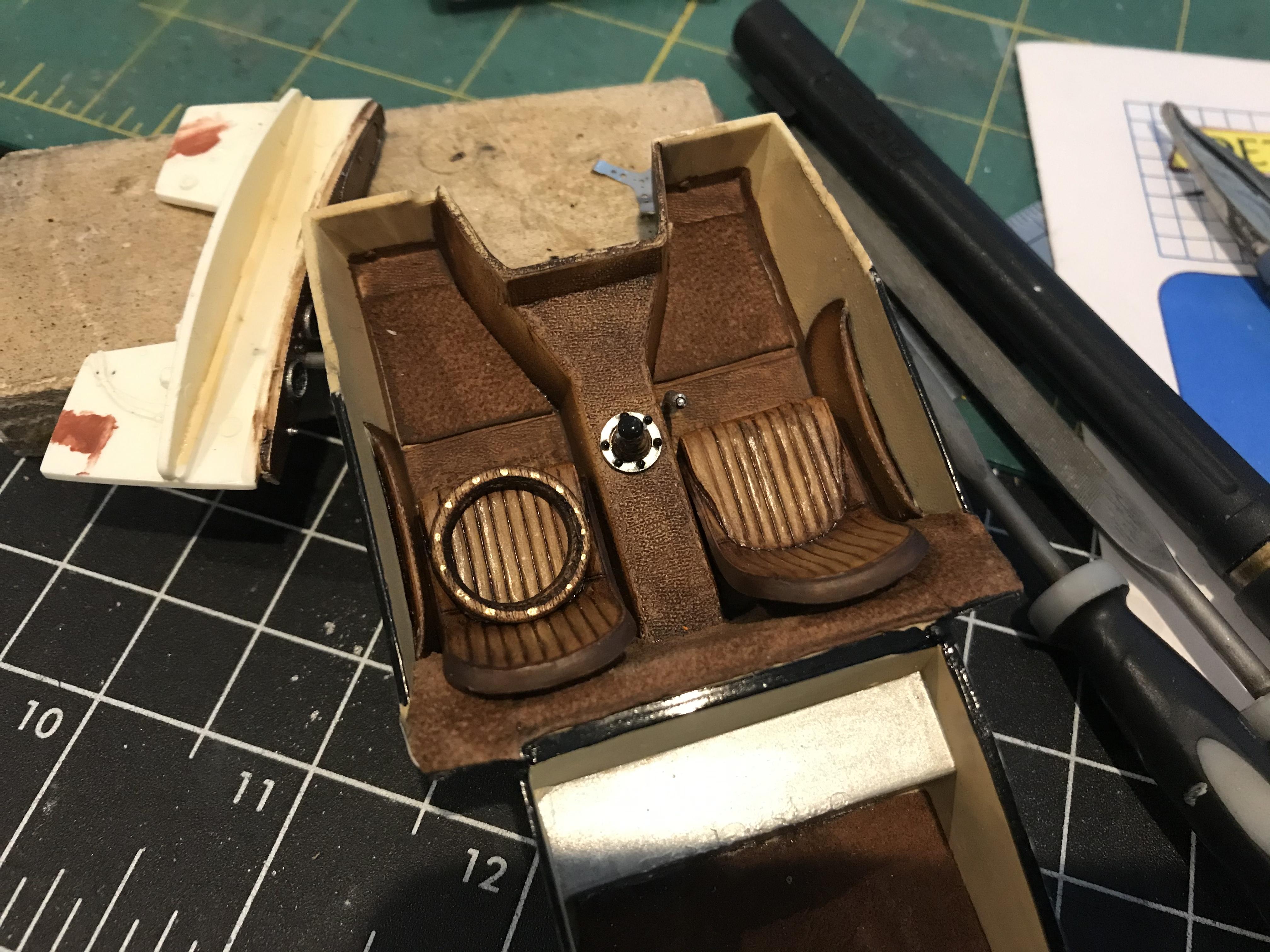

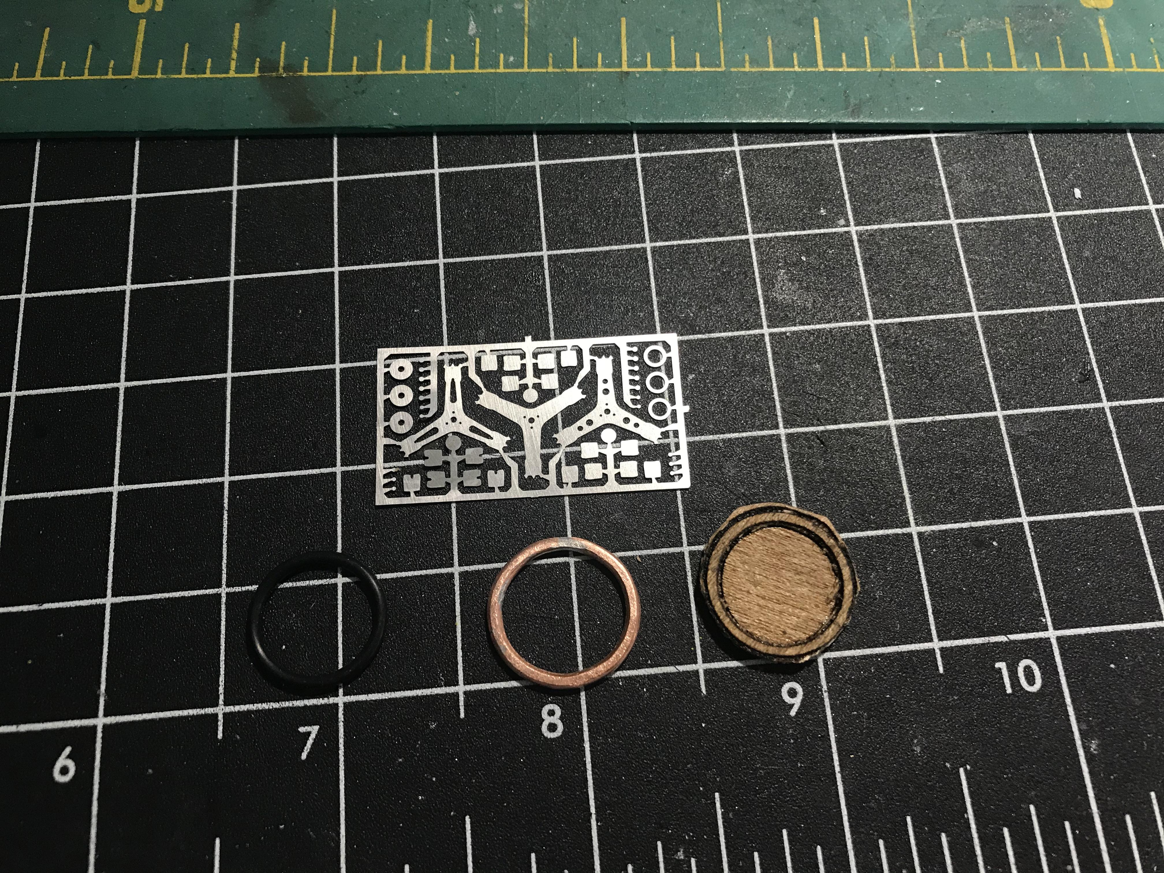

The kit had no steering wheel, well a broken center piece only, so I ordered an aftermarket racing set.
BUT the wheel part is a freaking rubber o ring. This is the drive to make a new wheel....and learn something new as well

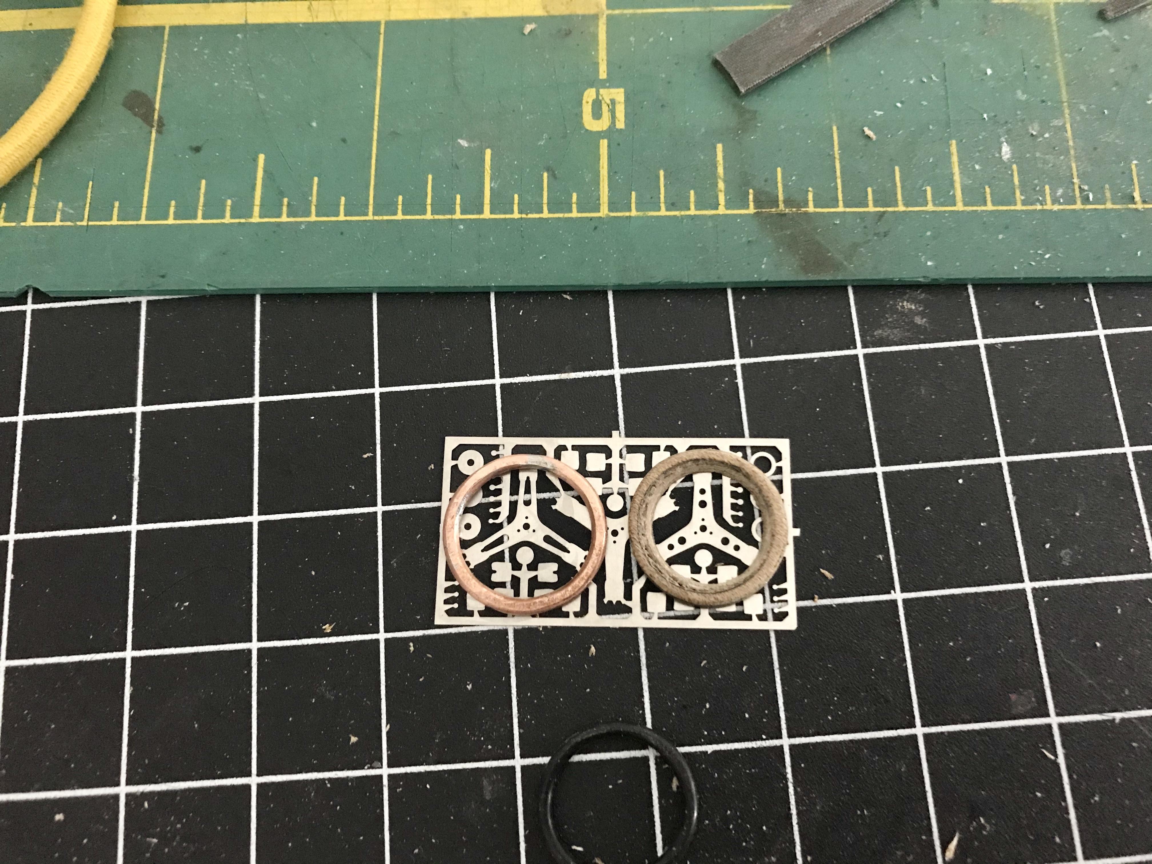

Last night I tried a copper wire bent into a circle and silver soldered the ends. After filing, I hammered the front and back flat.
Next  is to solder in the PE into the center and add some ribbing finger notches to the back

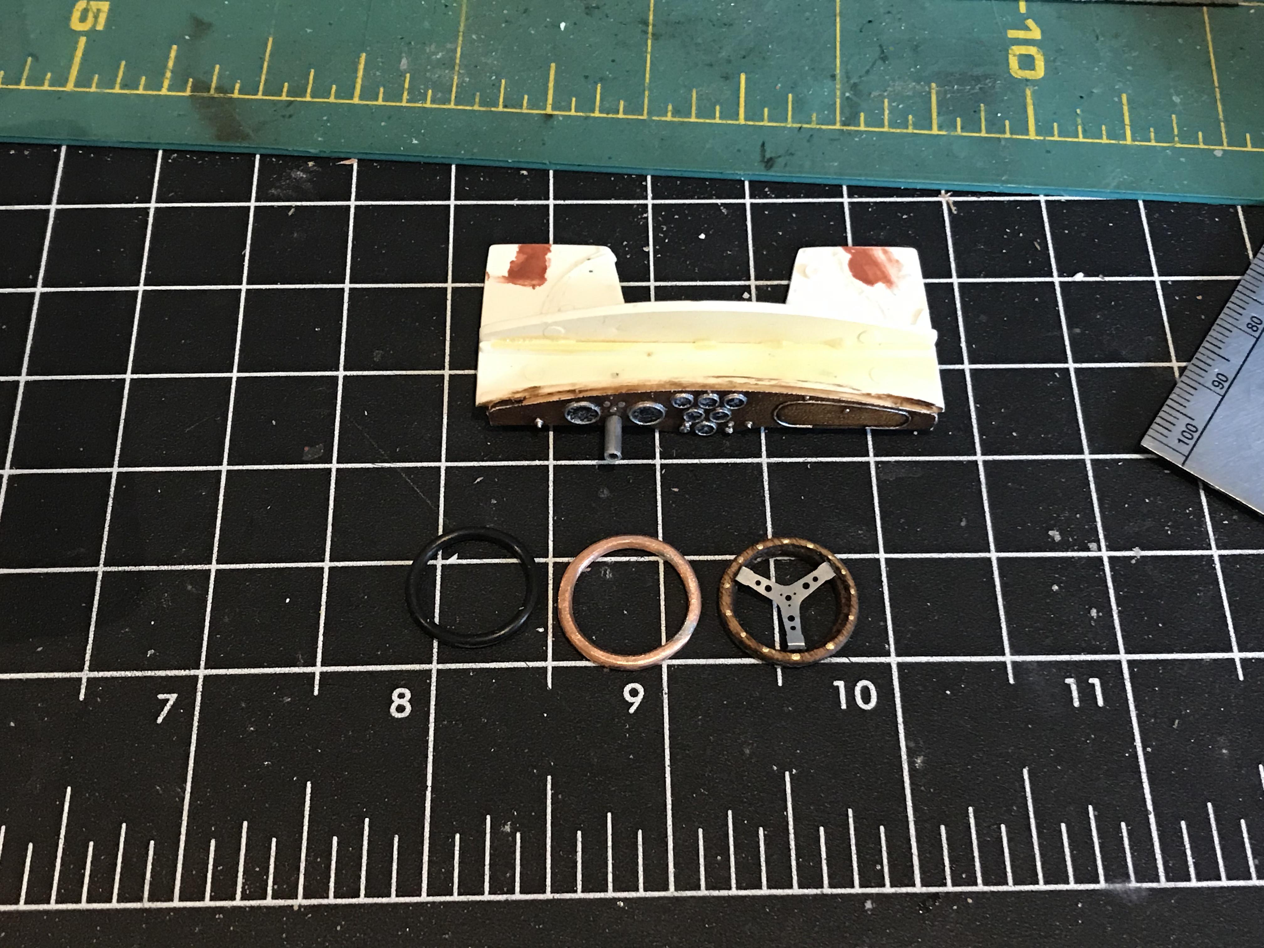

So, this is my mad scientist thing that happens during builds...off on a tangent.
I have made a perfectly good copper wheel that will work fine, and have that rubber ring that would work too.
But I want to make a wooden Wood steering wheel ring?

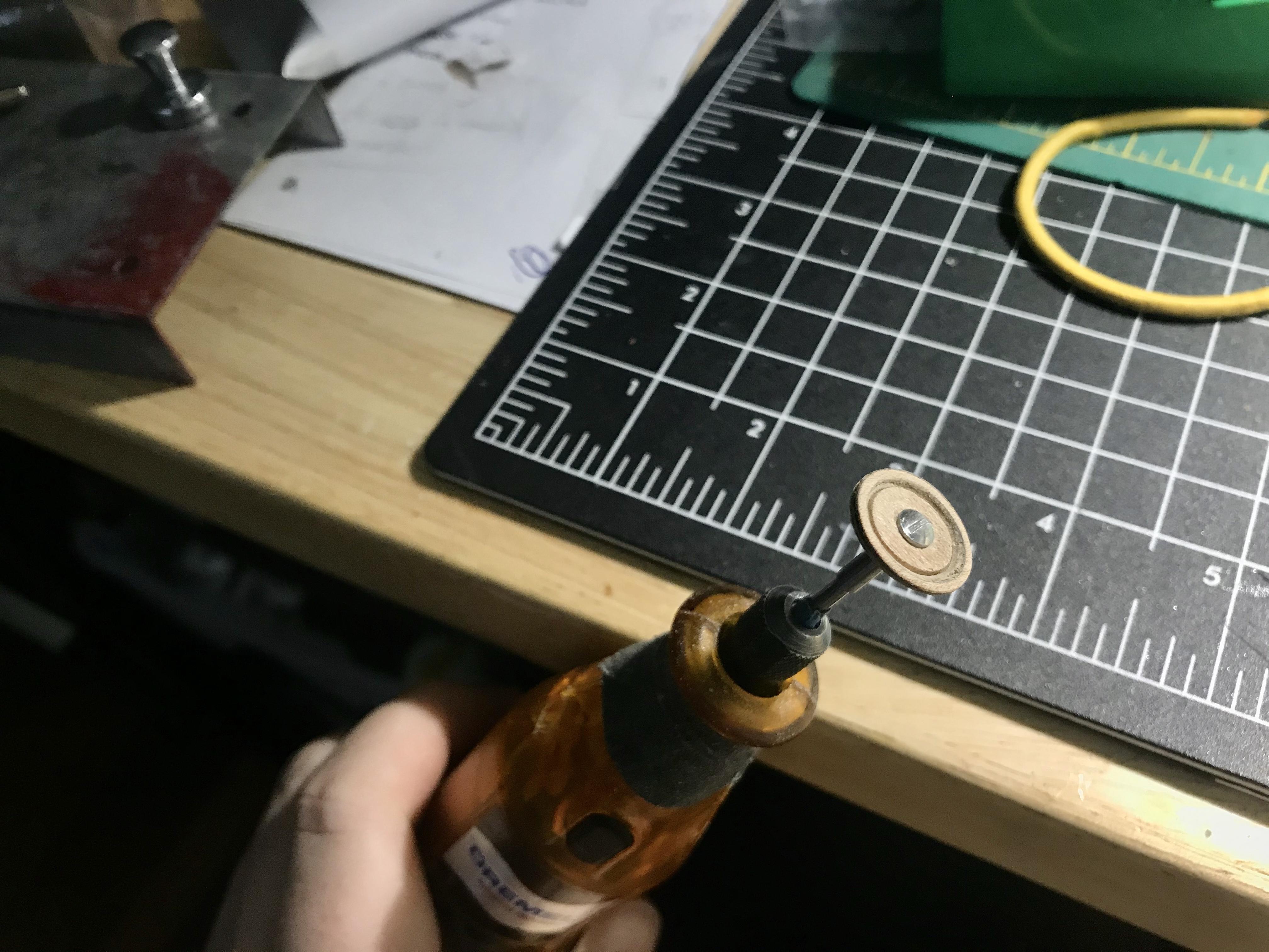

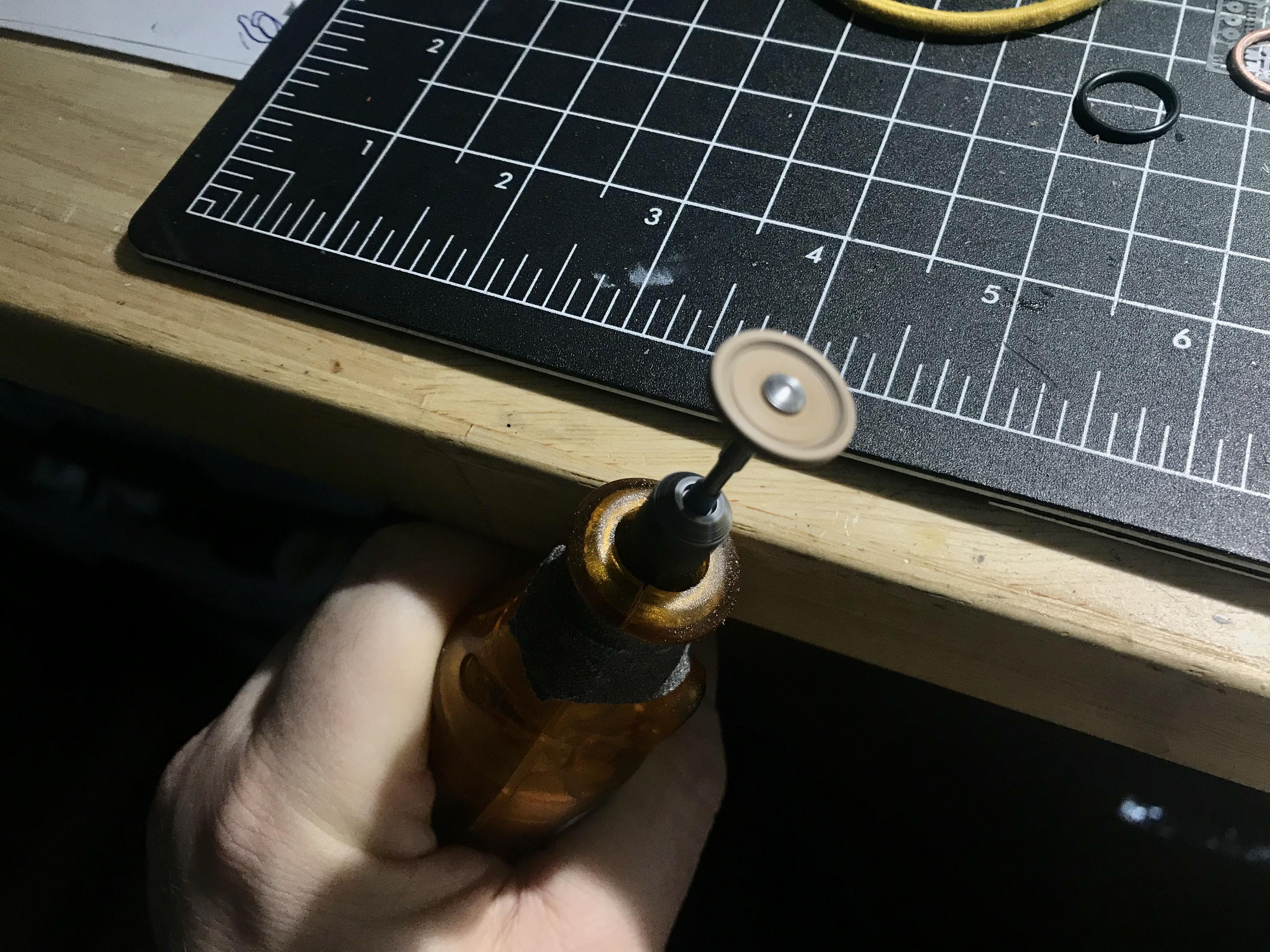

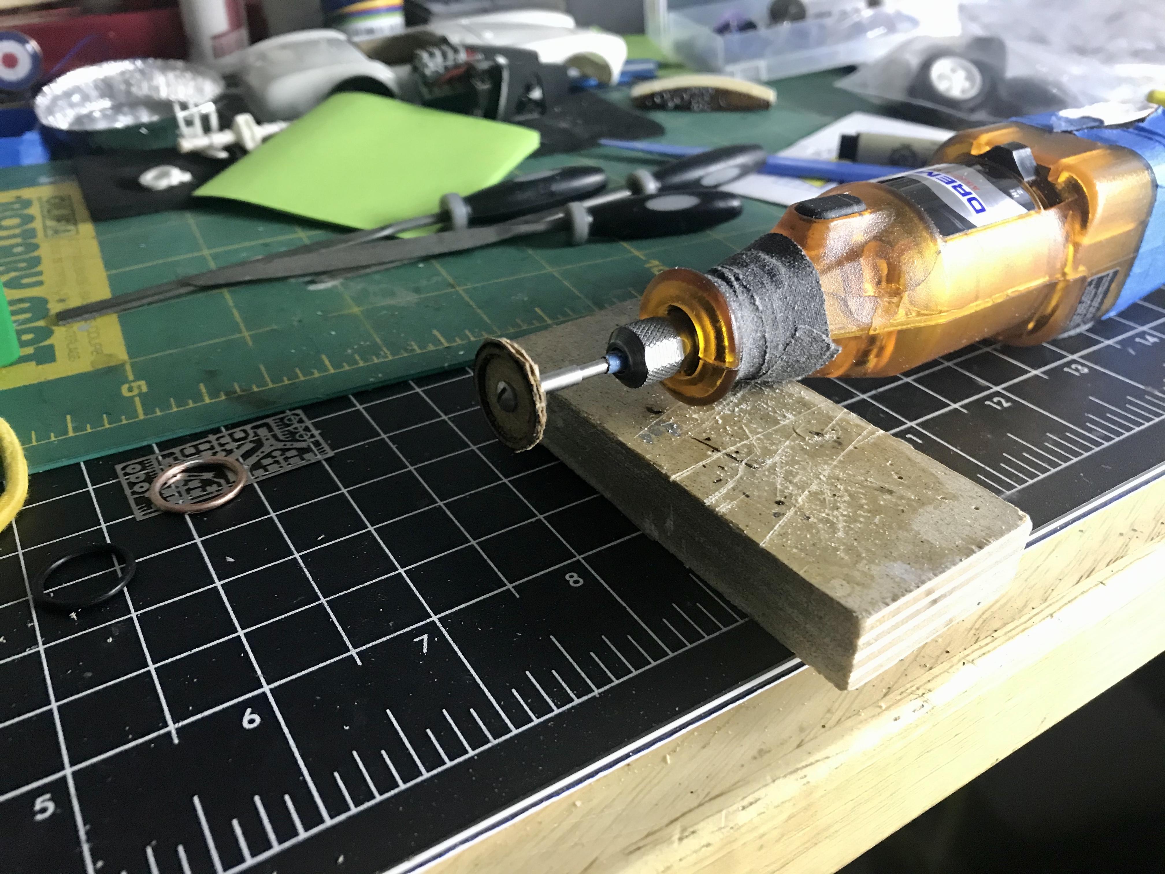

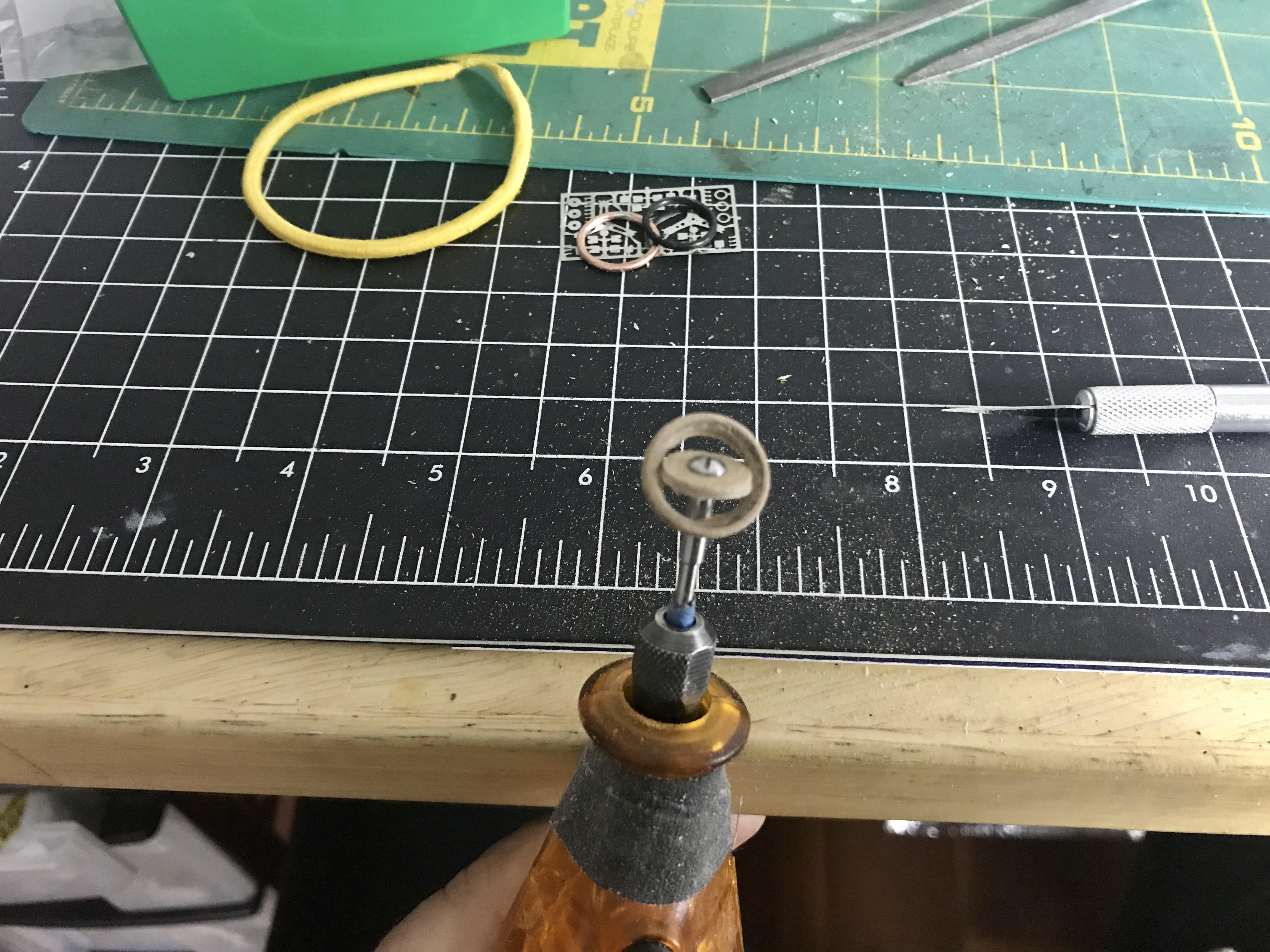

 So I pull put out the cheap man’s lathe, attach the wood to a mandrel and away we go
sandpaper on the edges so not too much pressure..... this veneer wood is very chippy and easily broken.
I didn’t get my two halves perfectly glued so there is a void?
Spinning picture:
now working in the middle cutting a groove to separate the wheel from the middle
pop off it comes
Not horrible for a prototype, but not perfect either. Much room for improvement. I chipped the wood on the opposite side filing the middle flush .

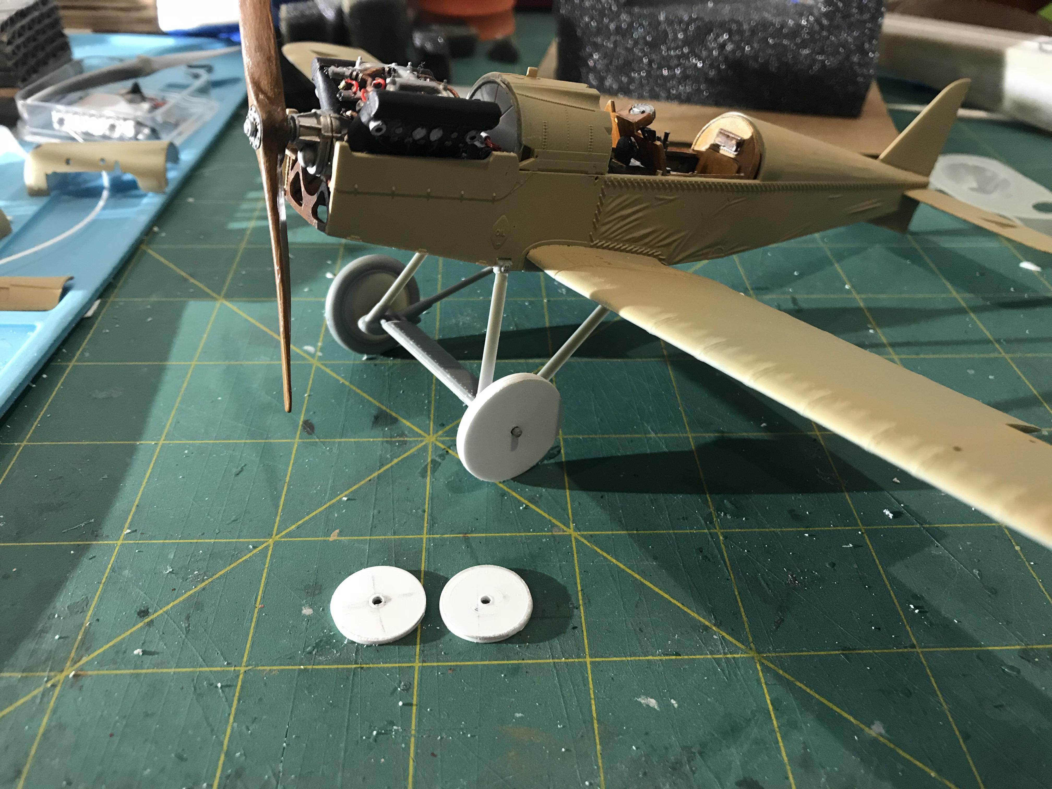

I have made WWI plane wheels this way out of styrene stock....might try that material too. Remember Harry P used to say “nothing looks like wood, like wood”

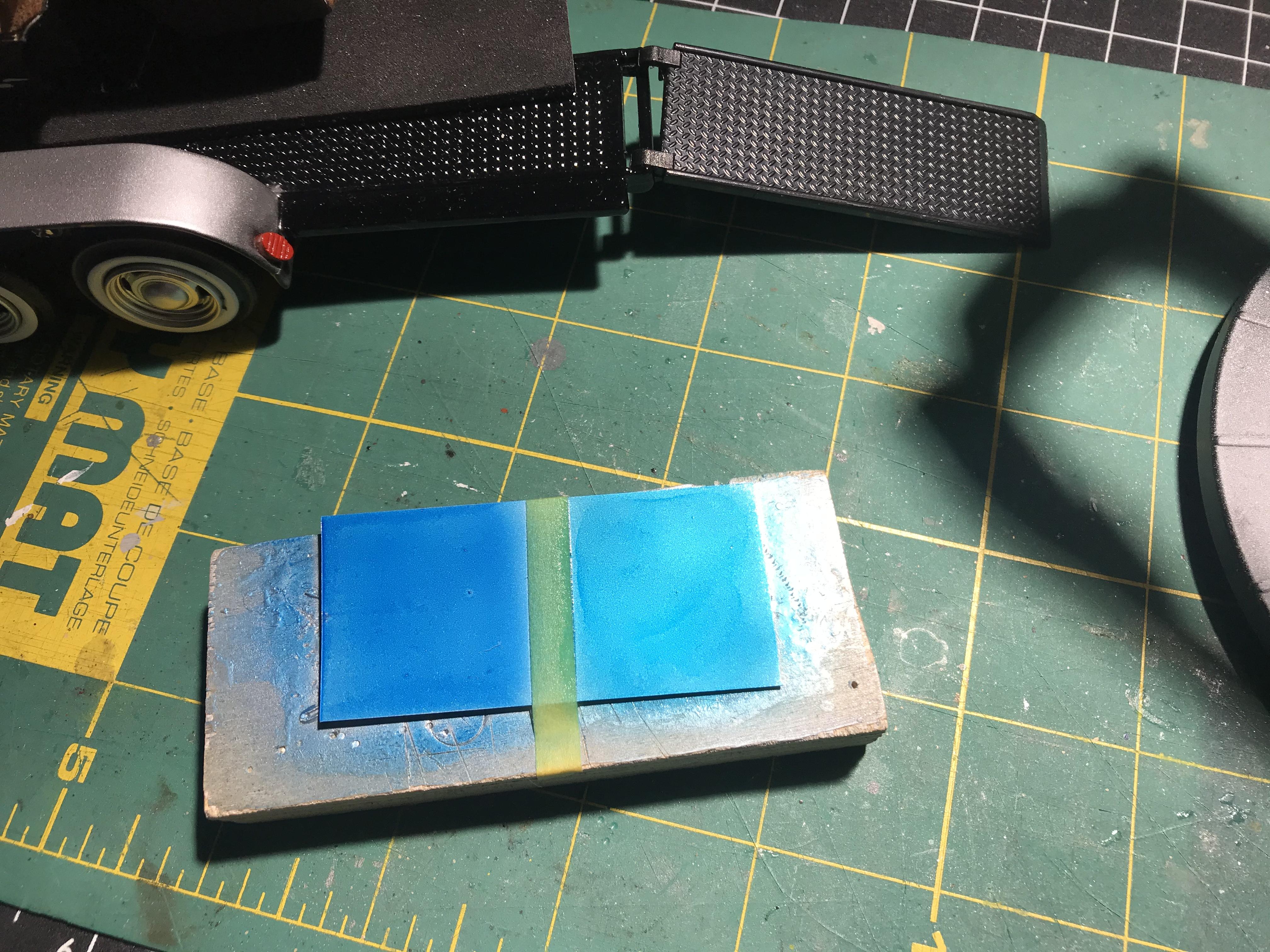

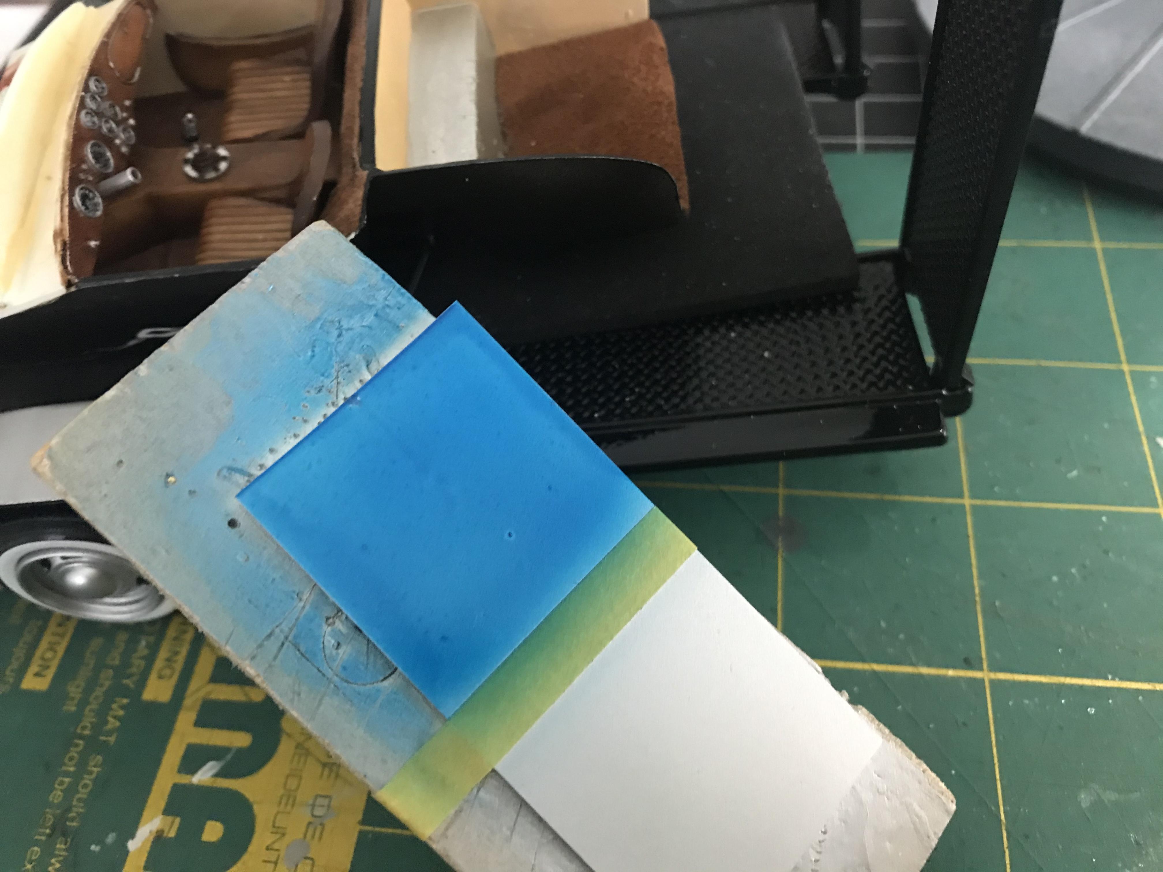

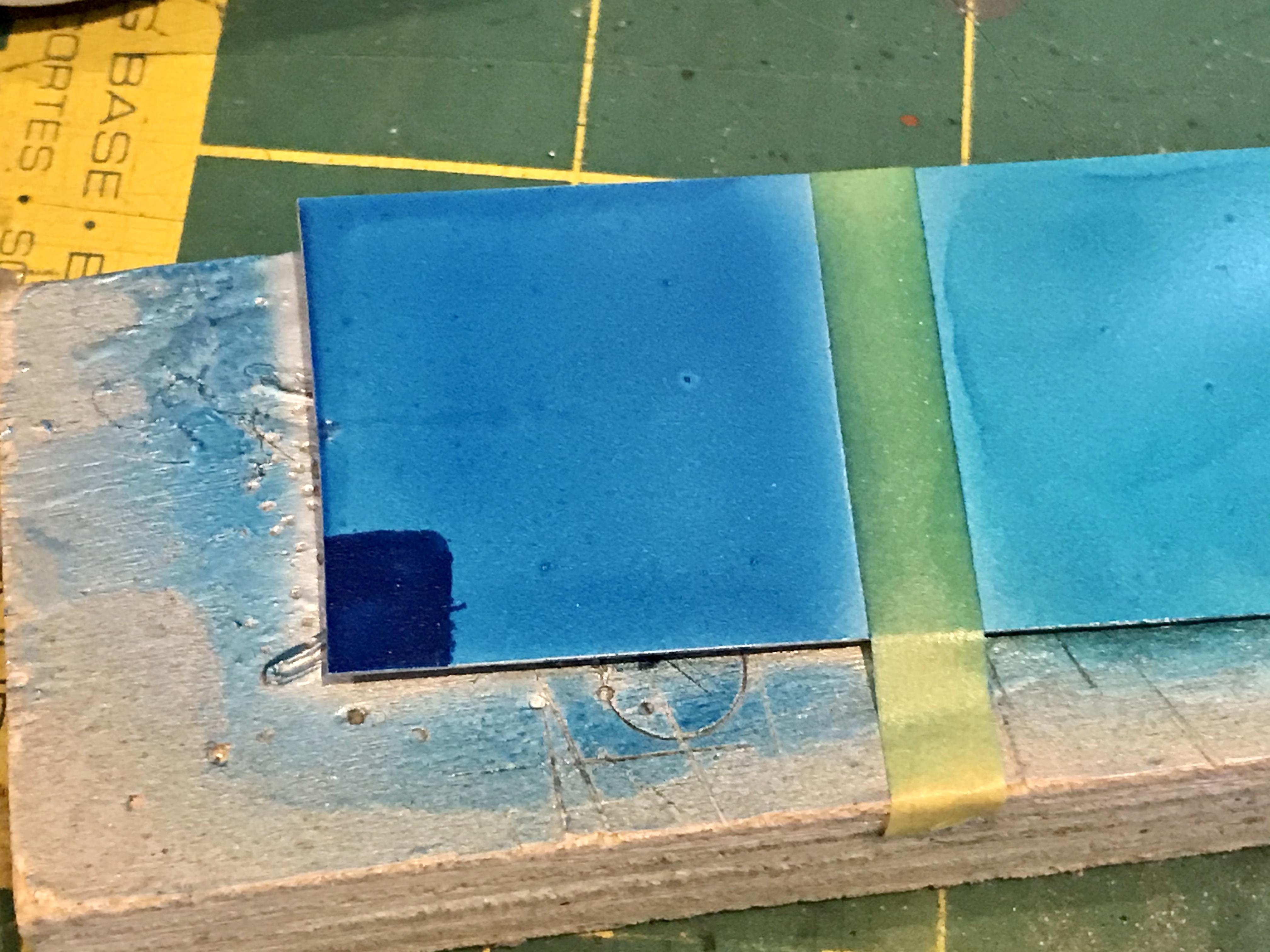

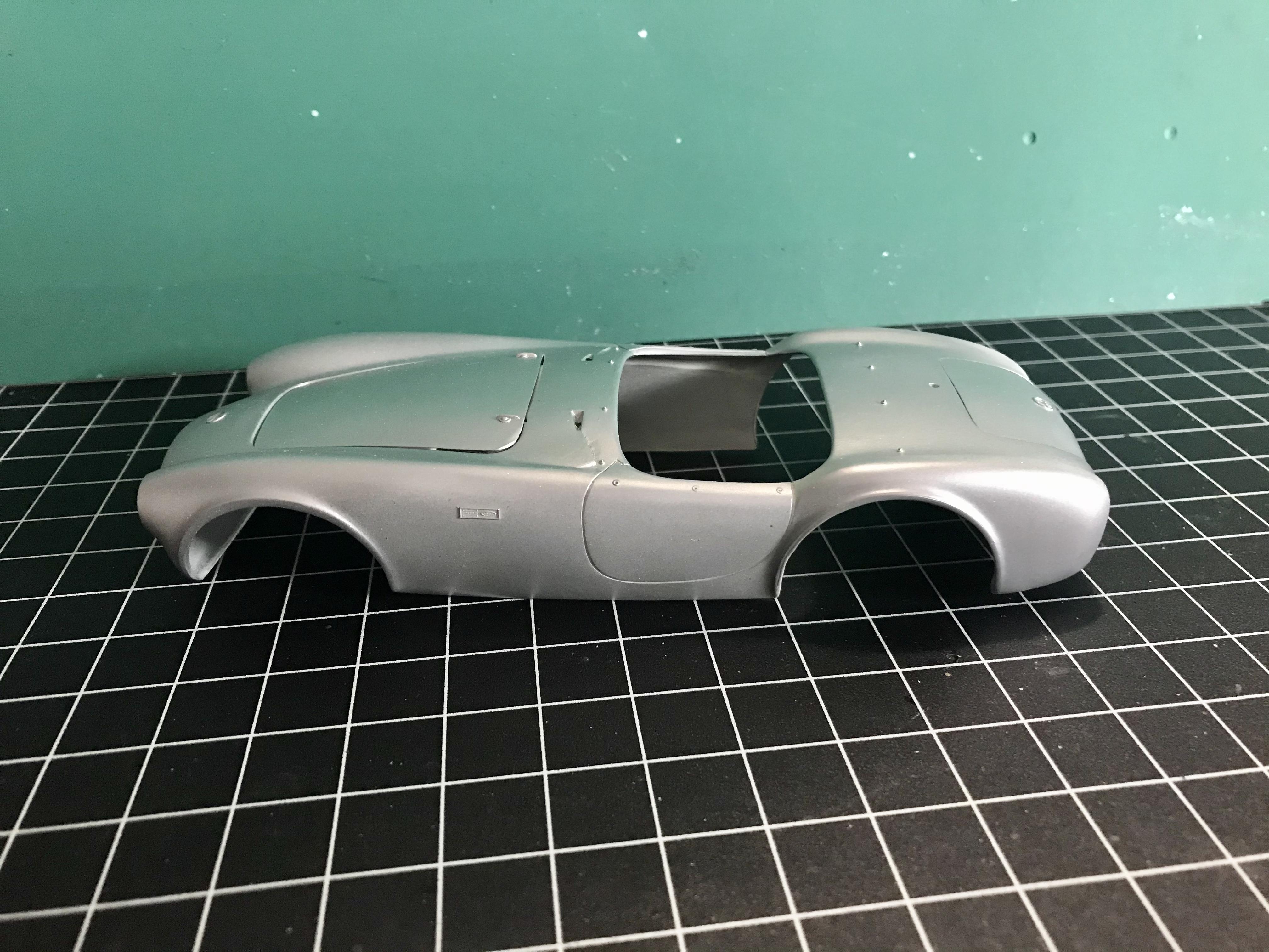

Deciphering paint method and options on styrene sample: white primer, Mr Metal Color aluminum
‘Body silver aluminum inside and out...as many of the early cars were all aluminum
 then Clear Blue Tamiya
Vs Hot  blue metal Alclad
and a little cube of Tamiya LP...for the Fujimi 427 that is coming
