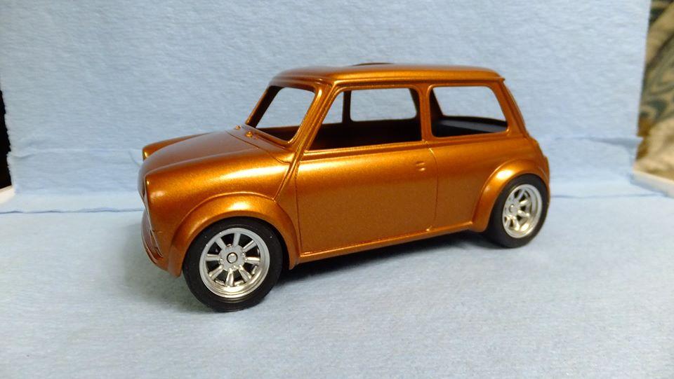

Dann Tier Posted April 24, 2020 Share Posted April 24, 2020 That rootbeer looks great on there!!!, and i LOVE how your shiny parts turned out!!!.....Tamiyas gloss black spray paint is what i use for a great base coat, but i use Spaz Stix Ultimate Mirror Chrome over it, since its waaay tougher than Alclad. These wheels were shot-up with Tamiya matte black...then gloss black(which they just call black), and then two light coats of The Spaz Stix. Quote Link to comment Share on other sites More sharing options...

Dann Tier Posted May 4, 2020 Share Posted May 4, 2020 On 4/24/2020 at 8:31 PM, David G. said: Thanks Dann, I'm glad you like it. Those wheels look great Dann! I've been keeping an eye out for Spax Stix at my LHSs but so far no luck. I like that it comes in a can. It sometimes feels like too much of a pain to fire up my airbrush for two bumpers and a handful of hubcaps. Having the chromie stuff in a can sure would increase the convenience factor. Thanks David G. You can also mask over it WITHOUT affecting the finish!!! Quote Link to comment Share on other sites More sharing options...
