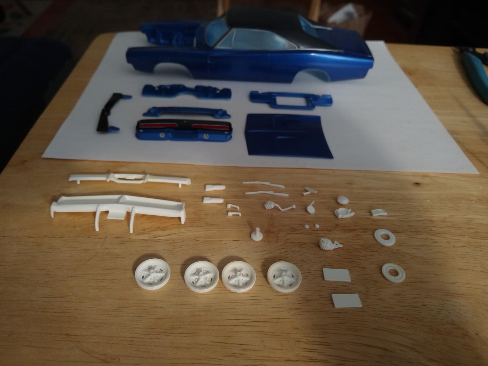

Thank you Jim. Here are a few more pics from this afternoon.
Parts ready to be chromed. Base coat will be scale finishes black followed  by clear Tamiya TS-13 decanted and applied in light mist coats, followed by alclad2 chrome, and sealed in with Tamiya TS-13 applying light mist coats to seal it all in.

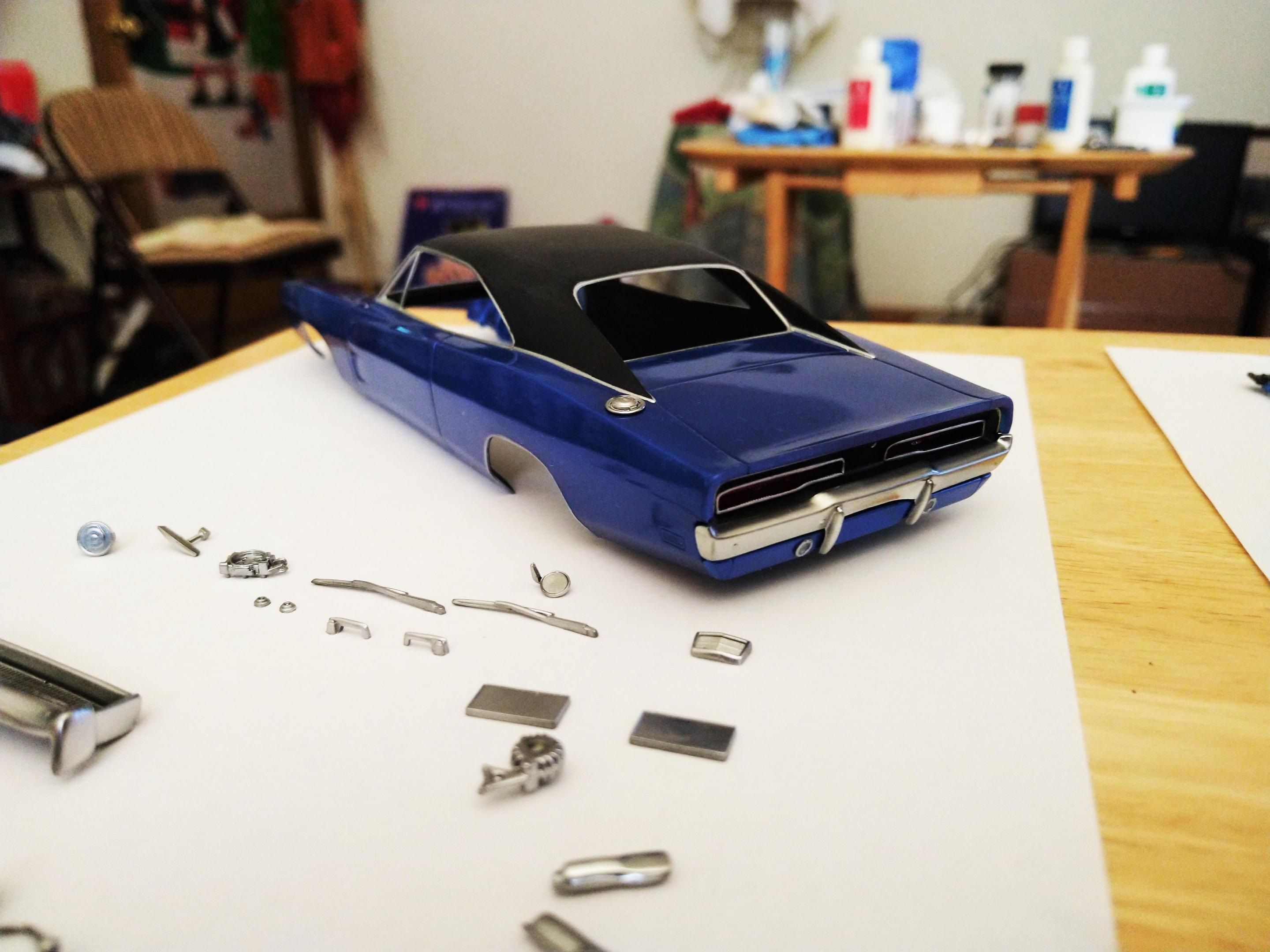

Parts chromed, they turned out beautiful.

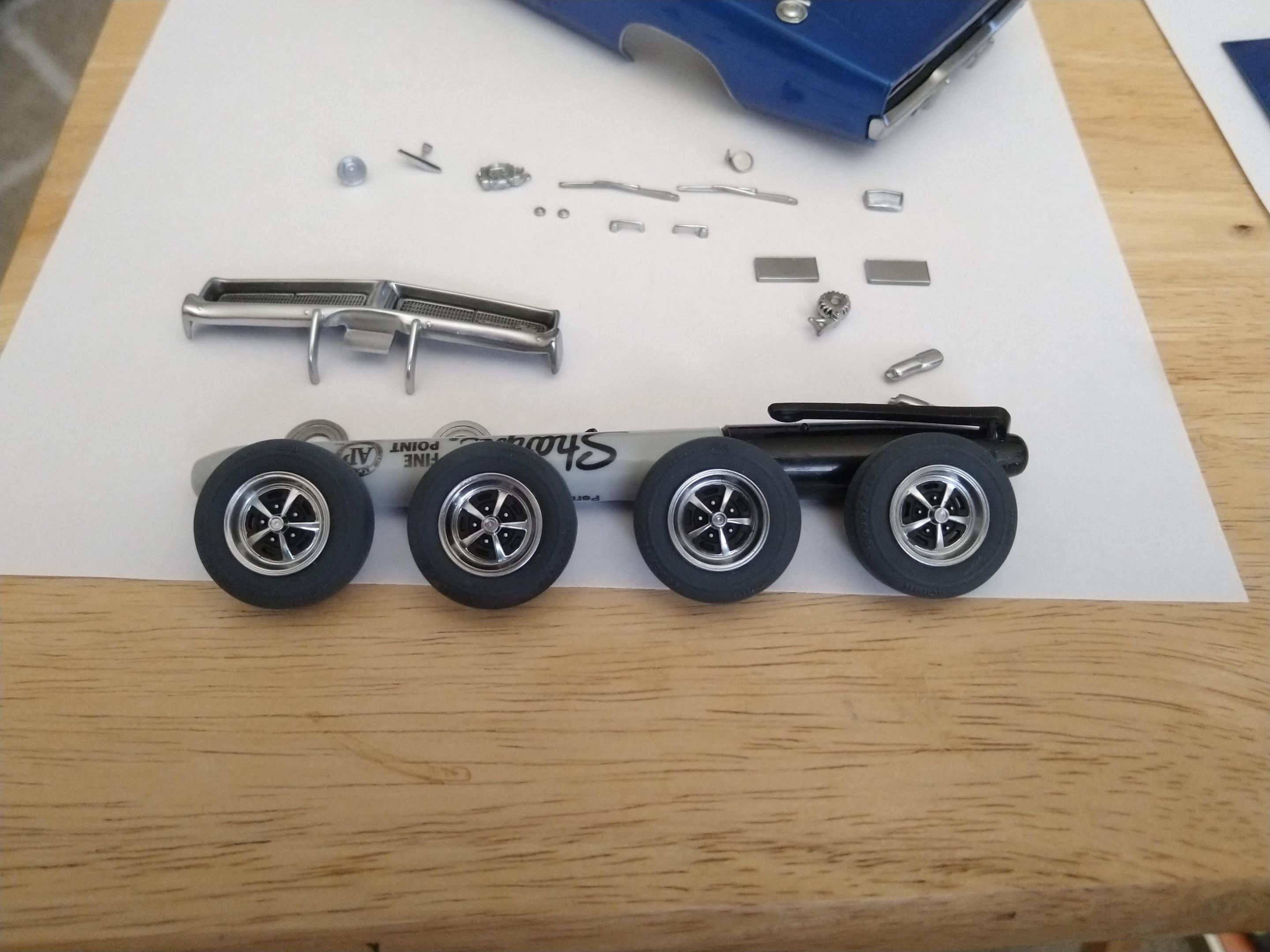

Tires and rear end worked up. I toned down the tires with some flat clear and some thinned out flat white to give them a more realistic look.

Wow this is some great build.It looks like u can dive in and swim in the paint.Excellent job.Like to see this one finished.I was thinking of a set of dog dish hub caps,and a white top,but that’s just me.

Thank you Ron. I do have some nice wheels I will try on this one, I just have to find the box they are in. I do like the idea of the dog dish hub caps, I think they would look cool. This is a learning experience for me. I do mostly aircraft and wanted to take a brake form it for a while. Any suggestions would be of great help. I will need help doing the engine for sure, and I'm worried about all four tires meeting the surface...hopefully I will get it right.

Awesome work on the re-chroming, Steve! Looks ??????
Just a tip, you may have trouble with the stance. IMO, having built several of these Revell Chargers, the front end sits too high. The spindles need a trim, about 1-1.5mm off, to get a better/lower front end stance ?? Can’t wait to this bad boy wrapped up ????

Thank you Cliff, and thank you for the heads up on the front wheel stance, I will do just that.  Right now I'm working on the engine. I cleaned up all the flash and smoothed out all the sprue connections, the hardest one so far was the small parting lines on the coil. Now all I have to do is find the Chrysler engine red. I have well over 3000 paints, it should only take about  20-30 minutes to find it and hopefully it isn't all rock hard.

Nice work! I like the way the black undercoat creates depth in the grille. I have often thought of masking and painting trim but am afraid the tape will pull up the paint.
The spray chrome treatment looks great. I'm at that same point on the model I'm working on now and I'll have to try your mentioned method for the Bumpers and Grill.

Thank you David, make sure you prime with Tamiya fine white primer first the scale finishes will not bite to the bare plastic. Then shoot your  scale-finishes black base followed by  Tamiya TS-13 decanted... thin it with Tamiya lacquer thinner and then spray light coats first ,wet sand 6000- 8000,  polish.... clean off the polish then shoot your Alclad2 chrome.... finish sealing it in with Tamiya TS-13. That is how I did it, you process may differ, please test this process first before you apply it.

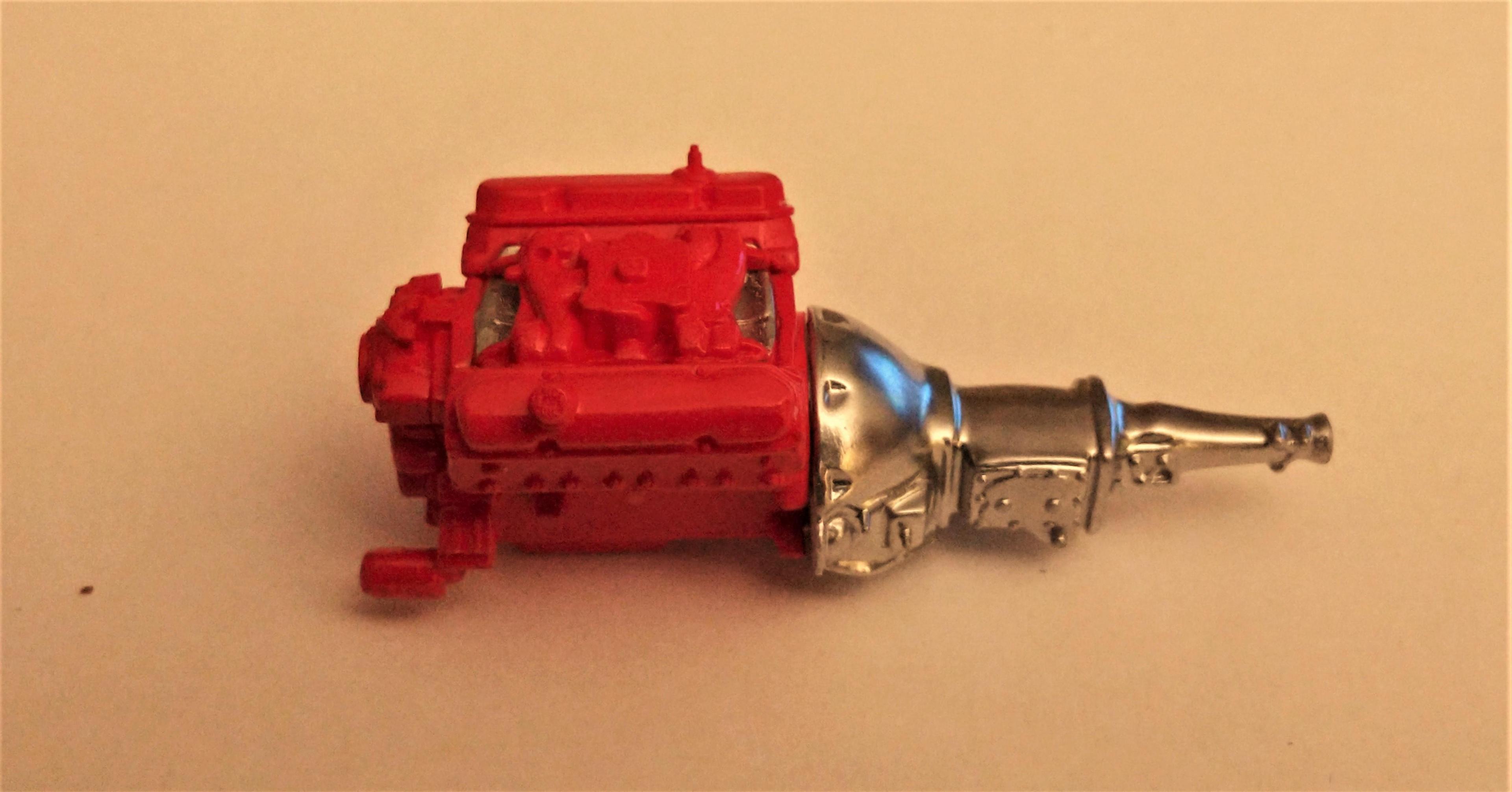

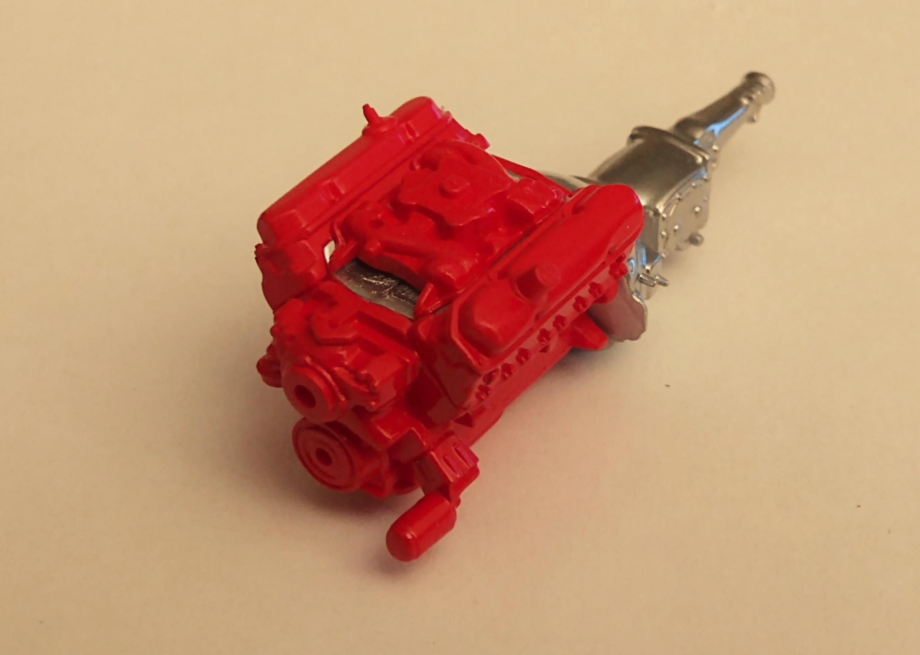

Engine work started. I don't know much about detailing engines but Ill give it a try. I'm going to search the forums to see what I can find. Engine painted Chrysler engine red, transmission is Alclad2 steel over Testors model master gloss white. It will take a few days for this stuff to dry. I wish I still had my dehydrator I gave it away  to make deer jerky, the dehydrator dries enamel quickly but it can ruin a car body easily if you let sit in there to long.

I like how you detailed the Valley Cover, I don't remember seeing that done like that before.
