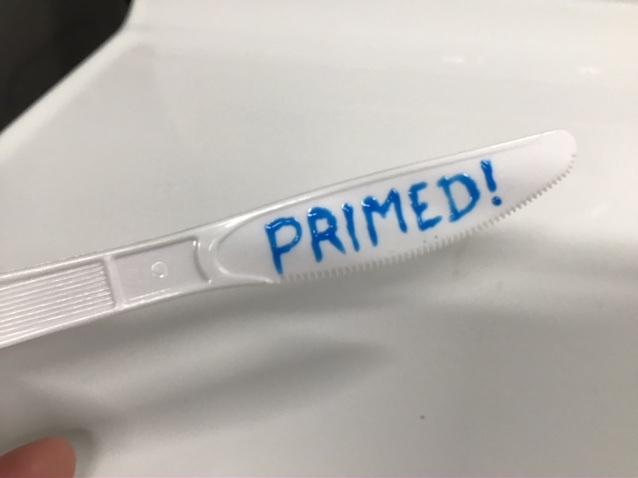

Has anyone used this stuff with acrylic paints, Tamiya in particular? It says not to use it with water-based paint. I want to do parts of a dashboard  in acrylic and leave some parts unpainted. It’s too tiny to mask otherwise.?
TIA, Greg.

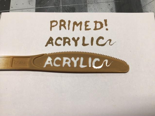

Run your own test and see.
Meanwhile, you can make your own liquid mask with Elmer's glue, hot water, and a drop of dish soap (and food coloring if you wish). This works better than any commercial liquid mask I've ever tried.

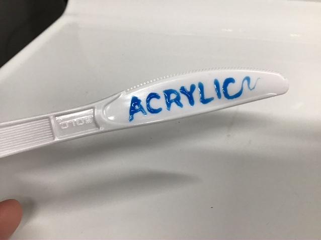

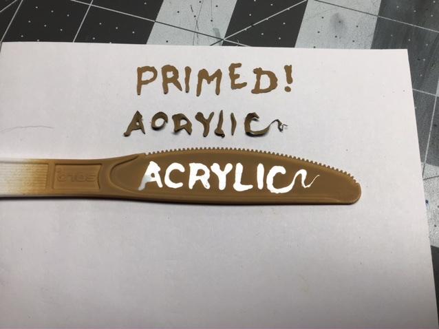

As a suggestion, try masking the "Made in the USA" on the underside of the plastic utensil. That will give you a better feeling how the liquid mask will cooperate on small areas.
