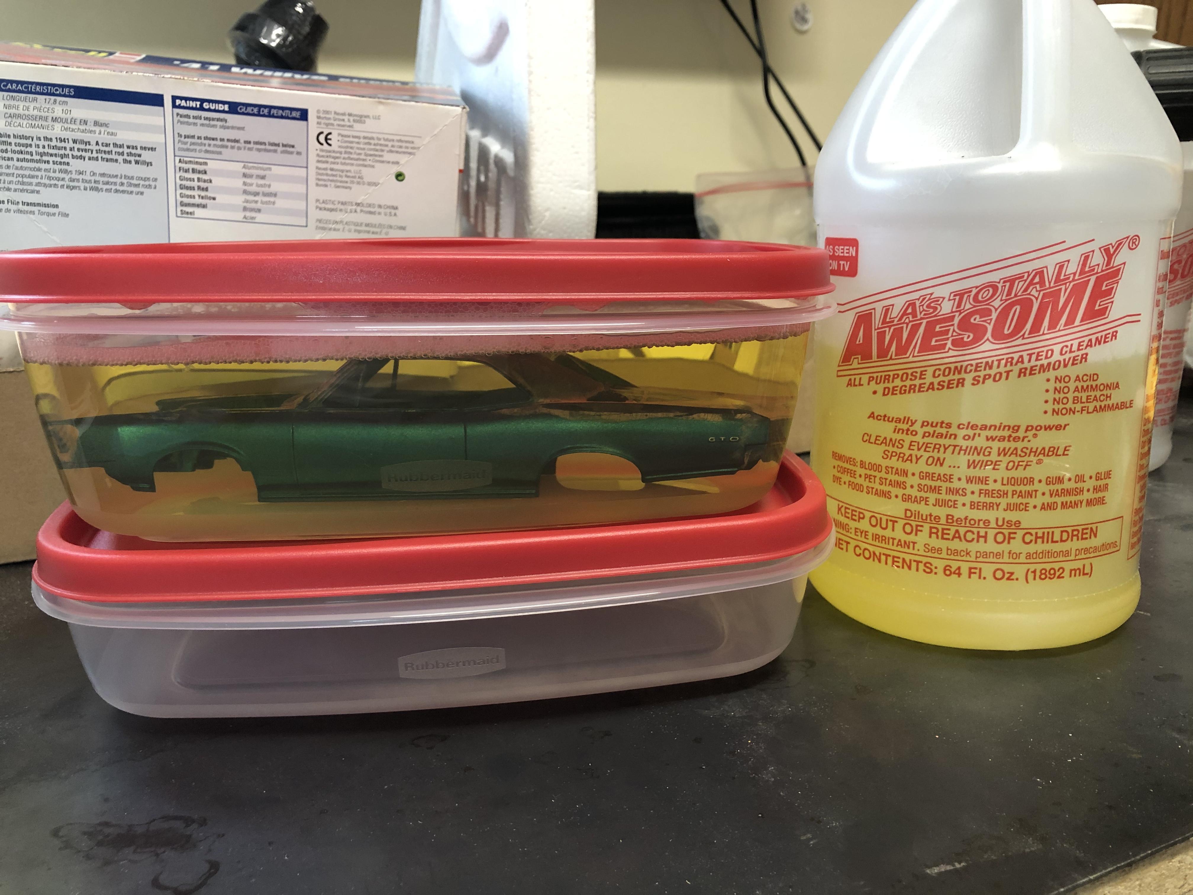

How long do you Guys normally soak your Duplicolor painted models in LA’s Totally AWSOME cleaner to strip the paint off???
That is really hit or miss for removing Duplicolor. It will work for the primer but isn't so good for the paint. Did you use any primer under the paint?
I can't speak for the LA's stuff, but Super Clean will take it off in a couple of days as long as there is prime under it.
I guess there are really no definitive answers to this question as there are a lot of variables depending on how the model was finished, but in general, as long as you use a "powerful" degreaser, like Super Clean, and not one of the cheap knock offs, you should get good results in 2 or 3 days.
Be aware that these solutions will not touch the lacquer at all.
They work by dissolving the primer underneath allowing the paint to loosen and come off in sheets.
If you painted the inside of the body as well as the outside, it would be beneficial to put a few scratches in the paint down to the primer to allow the solution to penetrate into the primer.
If the inside of the body is unpainted, it's unnecessary.
The degreaser will work it's way from the inside to the outside.
I use Super Clean almost exclusively for this job, and it always works for me, even with using as many as 14 coats of primer, lacquer and clear.

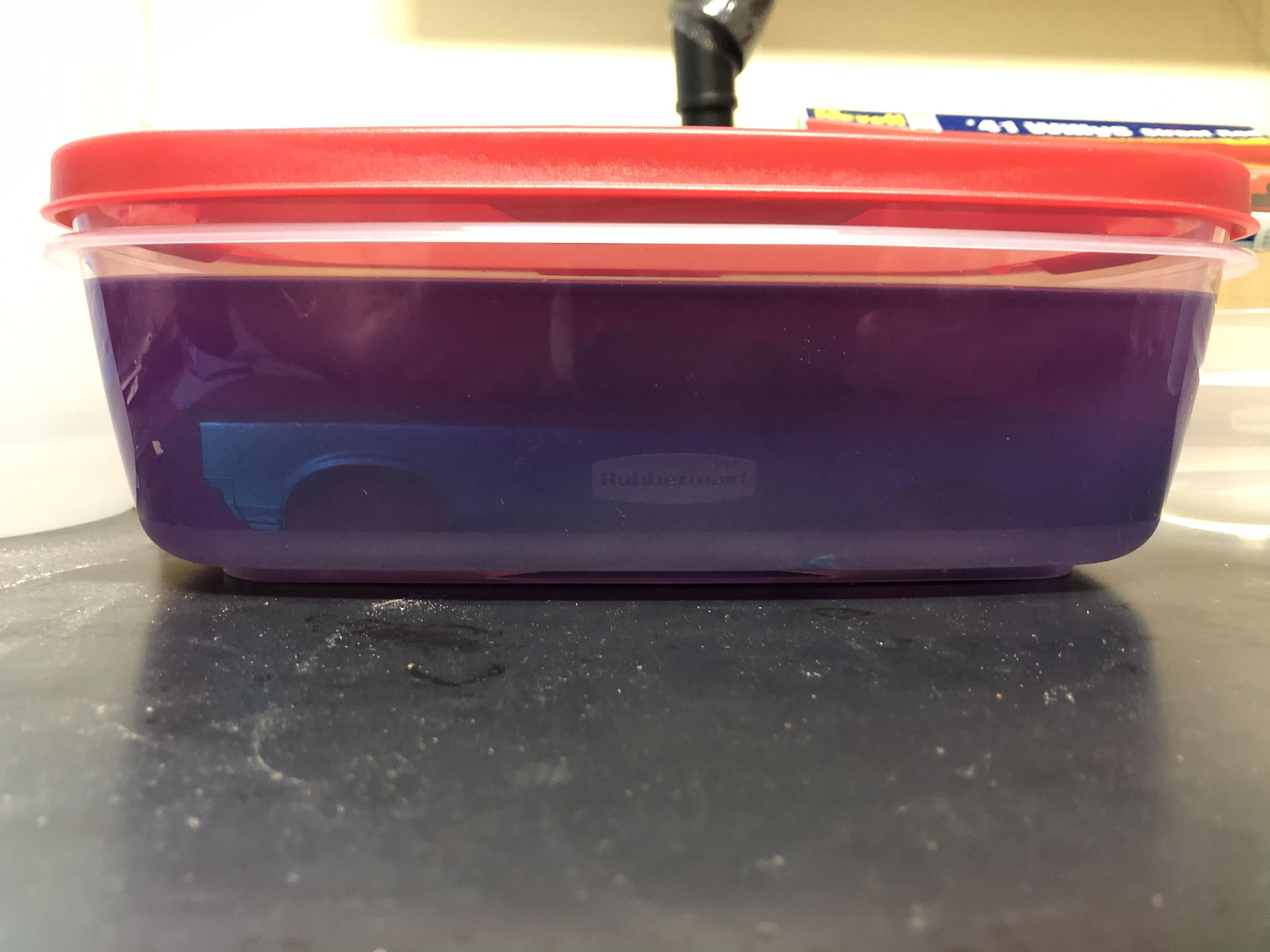

Well I soaked it overnight in the Super Clean and the paint is cracking but not coming off. Does it need to soak longer?
