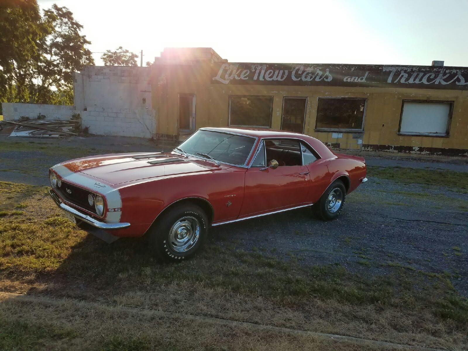

When I ordered my 68,
Wow! You took fun to a whole new level! Beautiful Camaro! Please tell me you still have it tucked away somewhere...
Stolen and wrecked by the thief

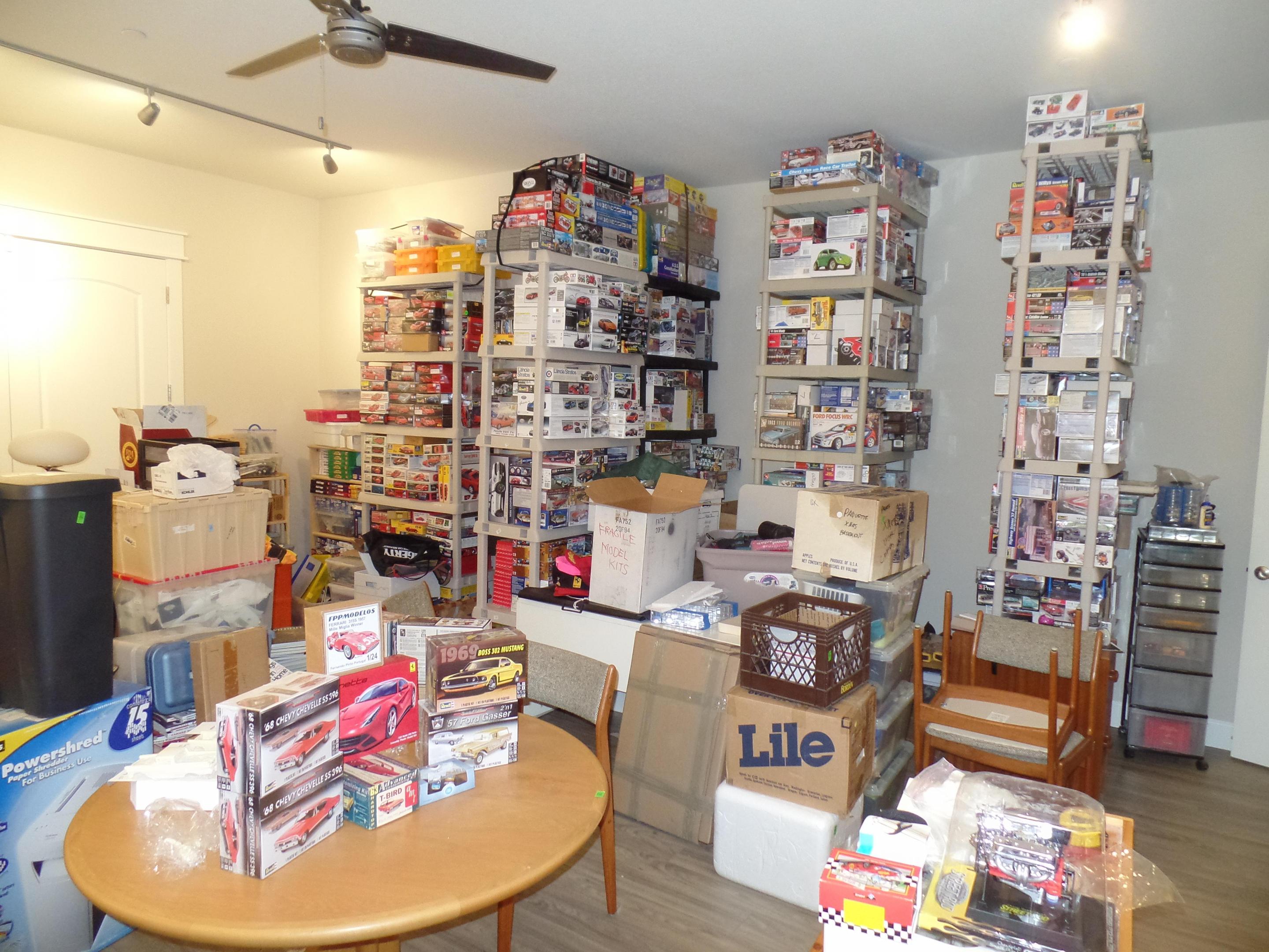

I'm still setting up the hobby room and we're still unpacking.  One key thing here is to lag cabinets and bookshelves to the wall to keep from falling over in an earthquake.  Doing that slower now as my wife is not able to help moving the heavier stuff and I don't want the odd jobs guy over doing anything inside the house for a while (for obvious reasons).  Also, a display cabinet was damaged and needs to have glass replaced before I can load it up.  Again, waiting until things settle down.

Looks as if you have a good sized modelling room. I'm looking at your shelving units and they look like some that I have in the basement. Are these those hallow plastic tube affairs that slip into the shelf ? If so you might consider something a little more substantial. While the kits weight aren't that great, these tings will twist around and could tip over. Home Depot, where I got mine, Lowe's and Menard's would be a god place to check for shelving units. They'll cost a little more but with steel frames they aren't going anywhere, and if they do they'll be the least of your worries. What sort of work bench are you planning ?

They are, but are lagged to each other and the wall.  I also slid some dowel rod (such as for closet rods) down them.  Don't recollect the diameter.  I have an adjustable height desk, because I stand most of the time I'm working on a model.  I also have a couple of work areas for special tasks that regular height desks.  Yet to set those up.

Since I got the room, I decided to use it.  In the old house, a part of the work area was in the basement and the rest in the bonus room over the garage.  Here, we don't have any basement, just crawl space.  The floor of the lower level is 5 1/2 feet above ground level

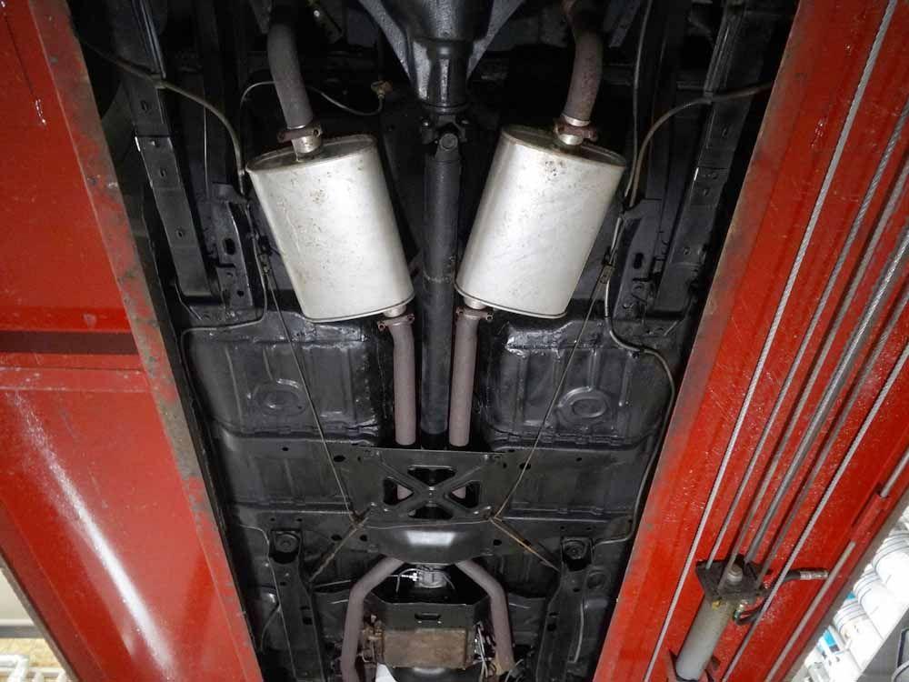

In general, the kit is pretty good, but will need some modifications to be correct as a Z11 option pace car replica.  The biggest issue is that the chassis is incorrect.  It represents the coupe chassis and does not the extra bracing for the convertible.
Below is the kit chassis.  I circled the area where the additional bracing is missing.  A real convertible would have the bracing as indicated in the restoration photo I found:
Also, there would be four vibration dampers at each corner of the car.  Since two would be in the trunk area, that would not be an issue unless you decided to open it up (which I am not for this build).  The front ones may need to be represented, but are essentially cylinders with mounting brackets, so should be easy.
I could not find any detailed spec or straight-on photos to capture specific dimensions of the bracing.  So, I did a little finagling and the kit chassis and came up with (I think) a reasonable approximation and will use to build the plastic piece to add:
I got back to the Revell 69 Camaro Pace Car replica. As mentioned above, the chassis in the kit is for the coupe and does not contain the stiffening cross member for the convertible version. Using images from a 1:1 restoration, I cobbled together the stiffening member. It is not perfect, but close enough, I think. I used too large bolts for it (should have gone down one more size) and I would have to modified the kit chassis some more as well. But, as it won't be on a rotisserie, it will do. I have one more convertible (67 Camaro Pace Car replica) to eventually do. I may design the piece for the AMT chassis and see about 3D printing it. That is a project for next year (an the acquisition of a 3D printer).
Anyway, you can see the modification I just put through primer.

Got back to getting the chassis mods installed and painted.  There is still more to be done, but here is where I am now at:
Finished the initial ribbing and connection plate.
Adapted the Revell 1967 Camaro SS exhaust system to this model.  Although the chambered exhaust is neat, not many Camaros came with it, and I am aiming for a more stock version.
I will eventually join the exhaust pipes from the engine manifolds to the rear component.  I will use the connection plate to hide that joint, rather than bend up full pieces at one time.
As I am not aiming for a GSL level model, I decided not to spend the time to install brake lines on the axle housing.  They would be nearly invisible on the completed model.  I will likely do the same for the front brakes as well.
For reference, I have included a photo of the original kit chassis as well as a photo of a real convertible chassis.  And finally, the current state of the modified chassis.

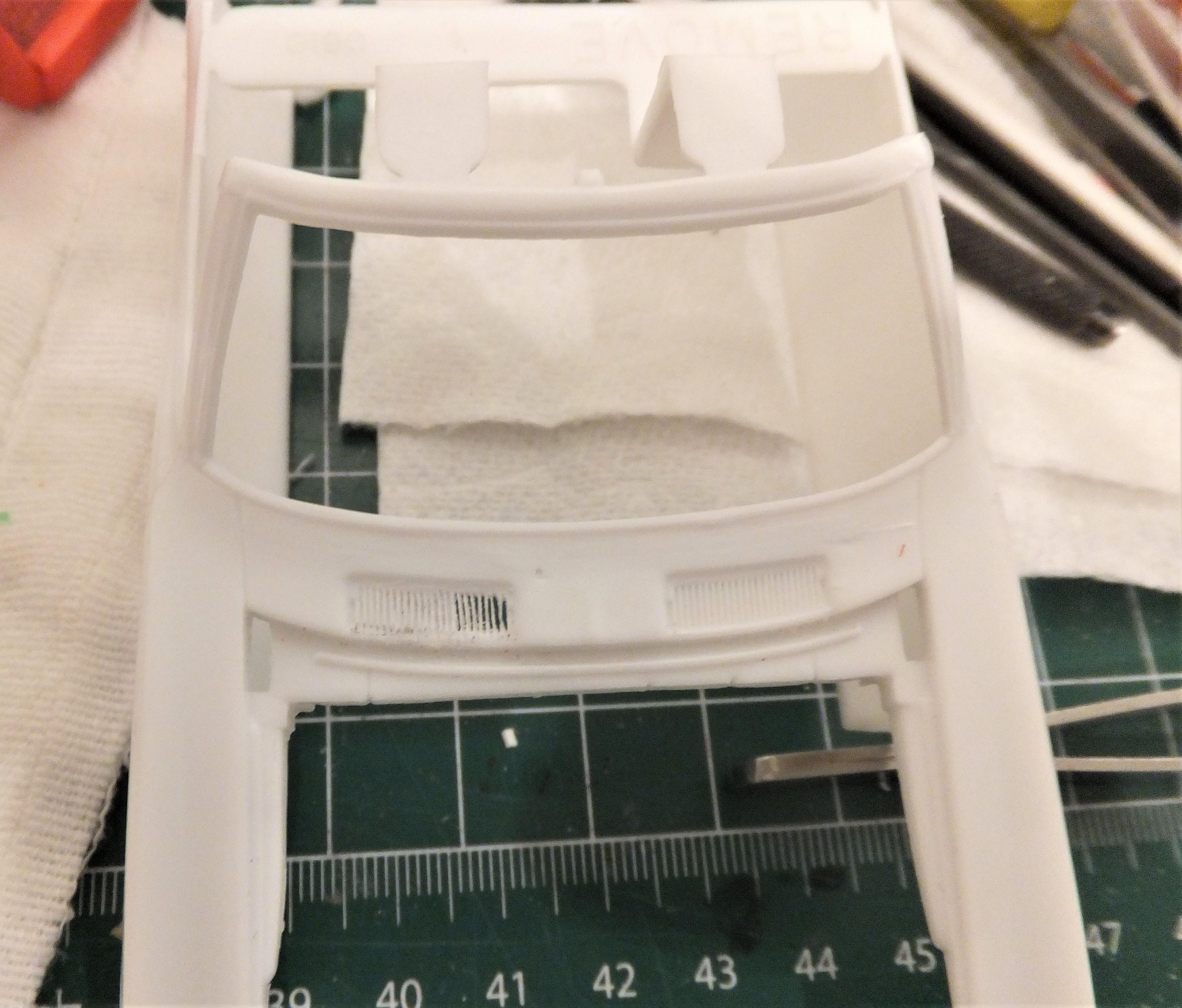

Have not updated in a while.  Working on the interior and body.  Decided to see if I could open the vents and am not sure it was a good idea.  They are so fine and fragile as one sands down (from behind) that they are not looking uniform.  I may need to rethink this idea.  I do have an extra body in a parts box if need be.
