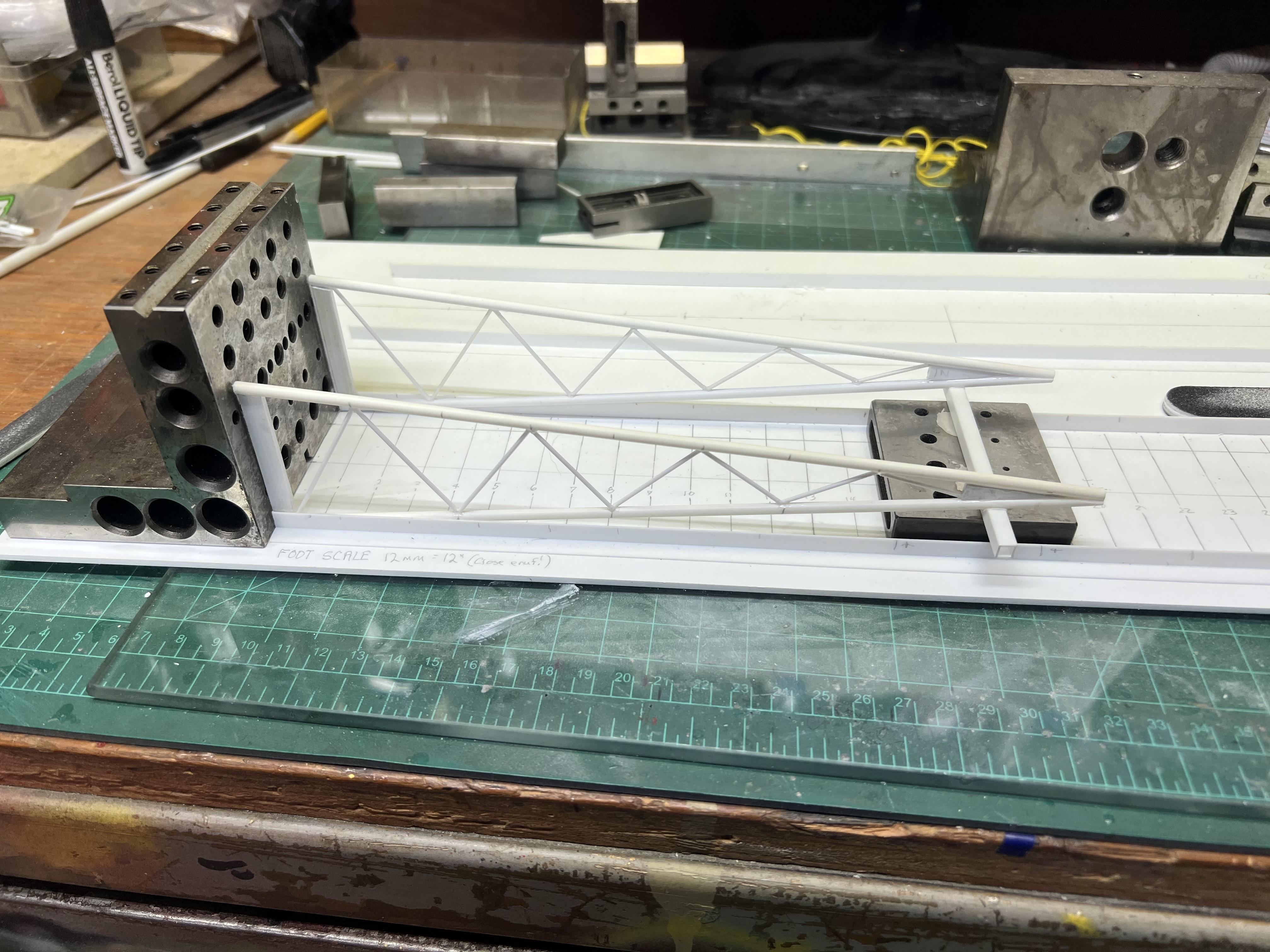

redneckrigger Posted July 10 Author Posted July 10 On 7/3/2025 at 7:33 AM, David G. said: Take your time and get better Tom, we'll be here when you get back to it. Have a speedy recovery all the same. David G. Thank you sir. Actually, just got to the point where I can comfortably sit at my bench again today. Started cutting the first of hundreds of pieces of tubing and rod to make the scale 100 feet of boom. 1/8" tube for the main stringers, 3/64" rod for the side and top diagonals, and 1/16" tube for the end verticals, horizontals and internal diagonals. The whole thing will end up at 4 feet long. Got my work cut out for me!!! Made up a jig to cut them all uniformly as well as another jig to assemble it all together. Getting there!

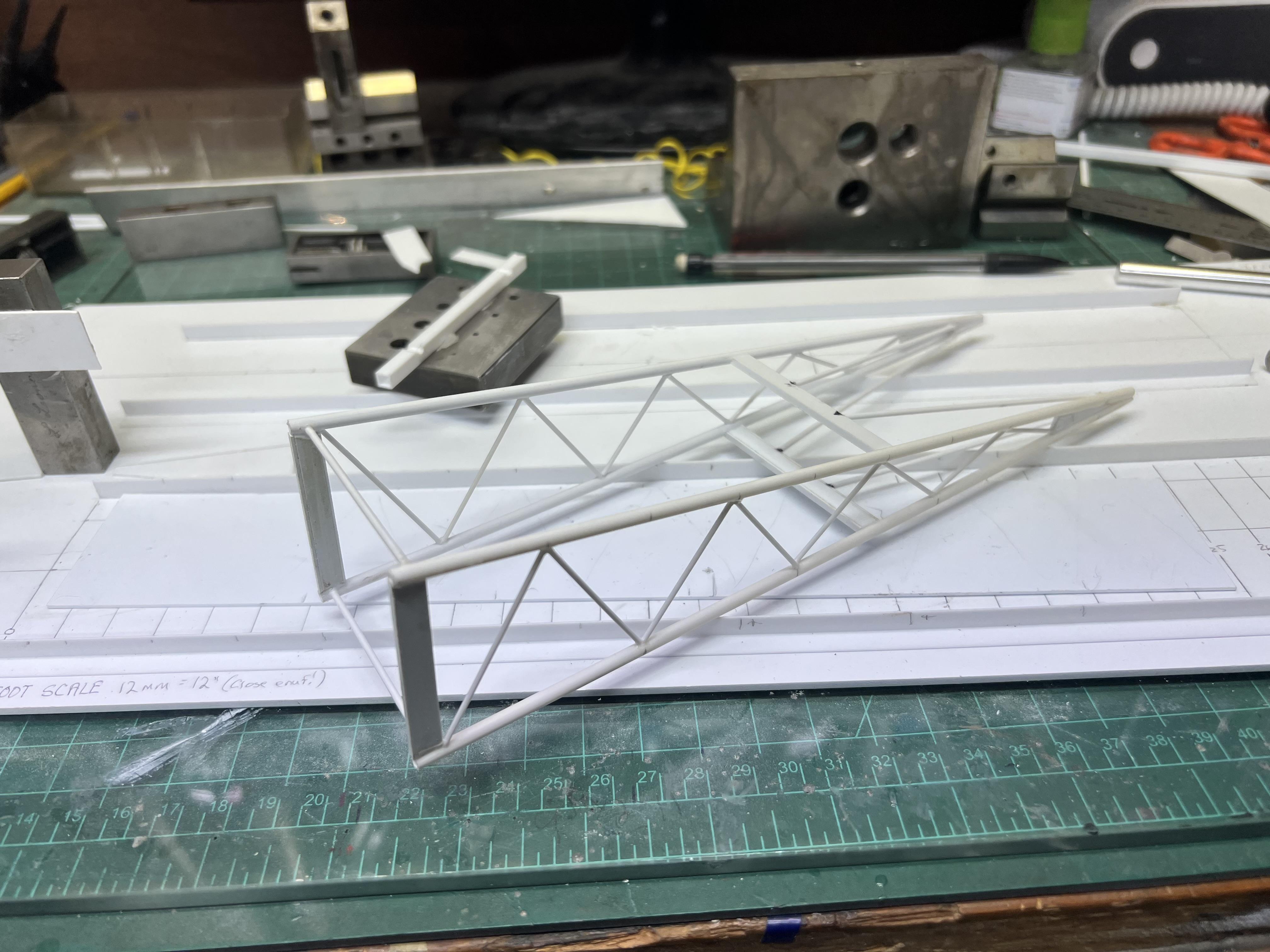

redneckrigger Posted July 12 Author Posted July 12 Sat down tonight and started fabricating the first 20’ section of boom. There will be two straight 20’s, two 10’s for the folding joint, a 20’ base and a 20’ tip. Each basic 20’ straight section will have 64 pieces of tube making it, not counting the mounting pieces and joining plate parts at each end. I also sat and figured out how to make the female joint piece for joining the booms. Males are next. These are the times I wish I was knowledgeable about 3D printing! Sometimes I think I enjoy the planning, problem solving and design of how to build these things more than the building!!! 3
BK9300 Posted July 12 Posted July 12 Lots of work ahead of you! From my very limited experience with resin printed items, I think your styrene booms will be stronger than printed ones would be. Going to be impressive! 3

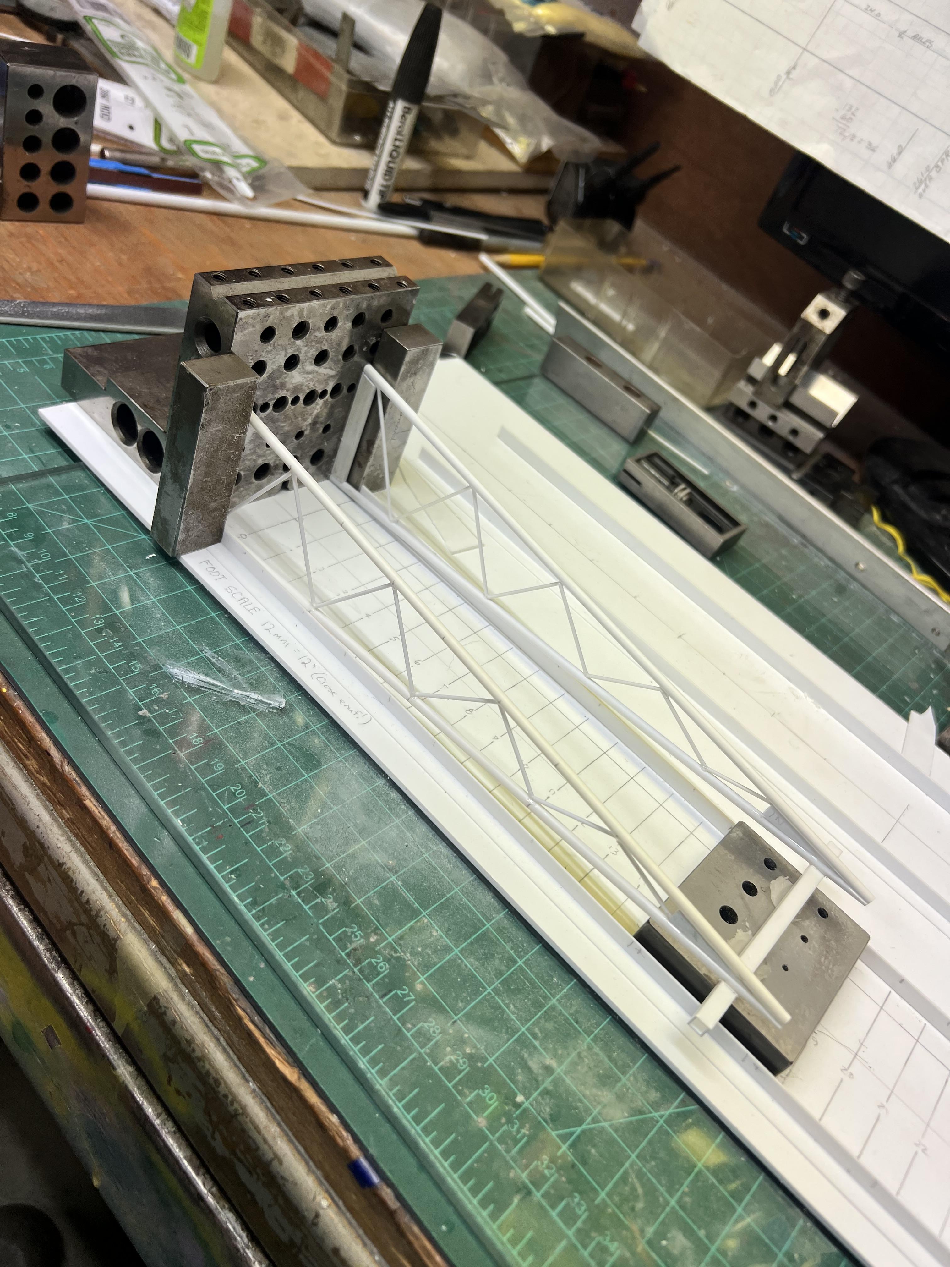

redneckrigger Posted July 12 Author Posted July 12 First piece out of the jig, second one just drying. So far so good! 3
redneckrigger Posted July 13 Author Posted July 13 (edited) First 20’ section of boom is done, except for the pin connections etc. came out pretty well I think, and the second is about 1/2 done. Once the jigs were set up, and a procedure for cutting and such was perfected, it went WAY better and quicker than I expected. The first section is amazingly stiff. The size is 60” on centers of main tubes in width and 48” on centers in the vertical direction. Here is a scale 40’ of boom still needing the connection points, and the boom section on the left is drying before I add the diagonals on the top but it looks rather good! edit: just added last photo to show the second twenty foot section all together as well Edited July 15 by redneckrigger 3
