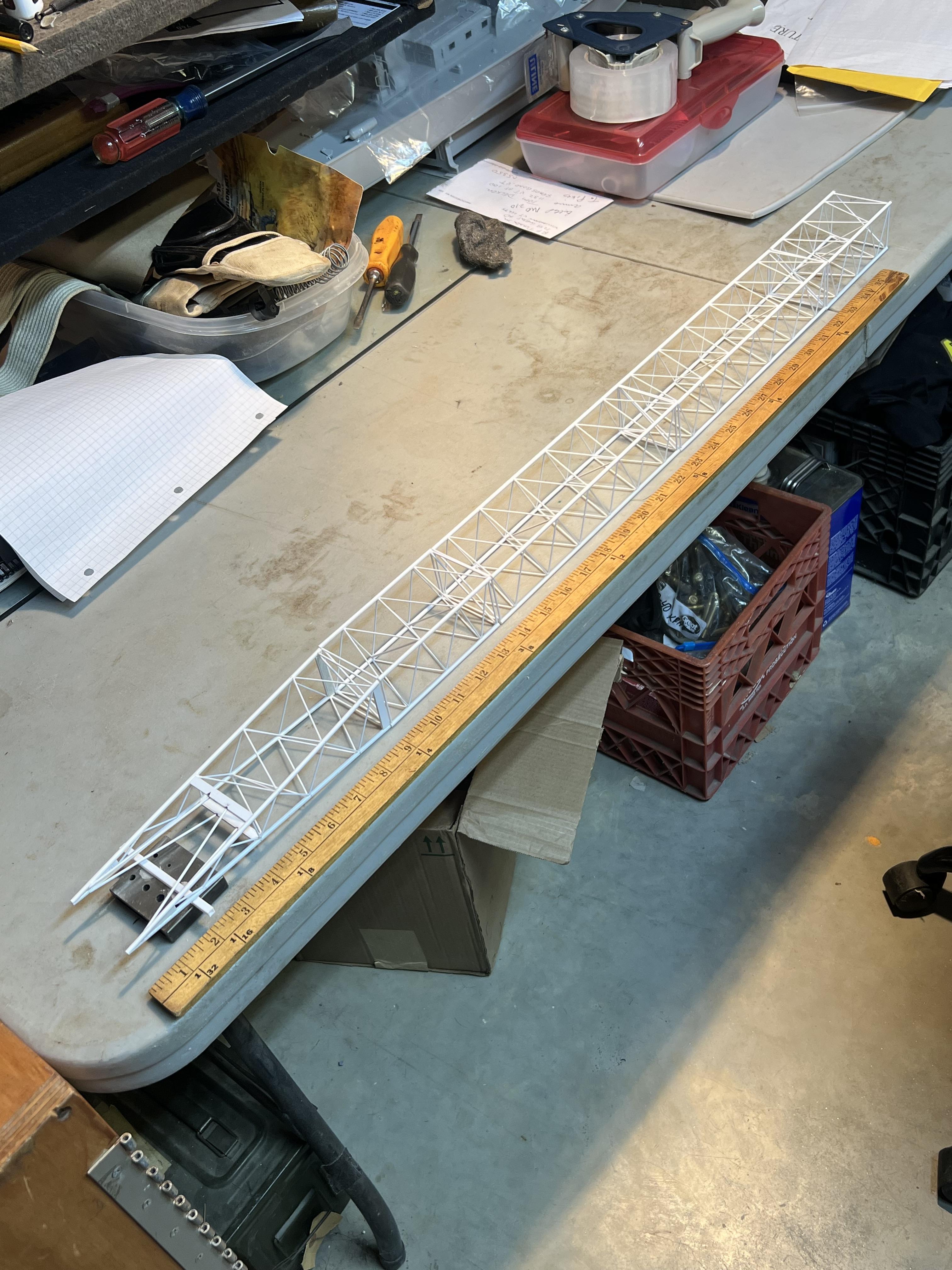

redneckrigger Posted August 24 Author Posted August 24 Still lots of pieces to add to the boom sections such as pendant anchors, boom stops, pivot points, pin connectors, deflection rollers, folding hinge points and more, and still need to make the 20’ boom head section, but this gives an idea what it will look like. Total length will be 48” which equates to 100’. The one I am modeling has 210’ boom and 30’ of jib. I’m going to be happy with 100’ in scale. I can’t even think about making another 67” of boom and jib to match the original! 2
Biggu Posted August 24 Posted August 24 This is a magnificent build. And SO many small details the average bear wouldn’t see or know about, but it is the small accurate details that make the model complete. I hope you give the small detail list as you build to teach us how this huge machine works. They are an amazing feat of engineering and physics. This SO interesting, Tom. I love what you are doing. I am very interested in this. 1
BK9300 Posted August 24 Posted August 24 At 48", the boom sections will be even more impressive, once all assembled! I may have missed you saying earlier, but will you be making the boom foldable? 3

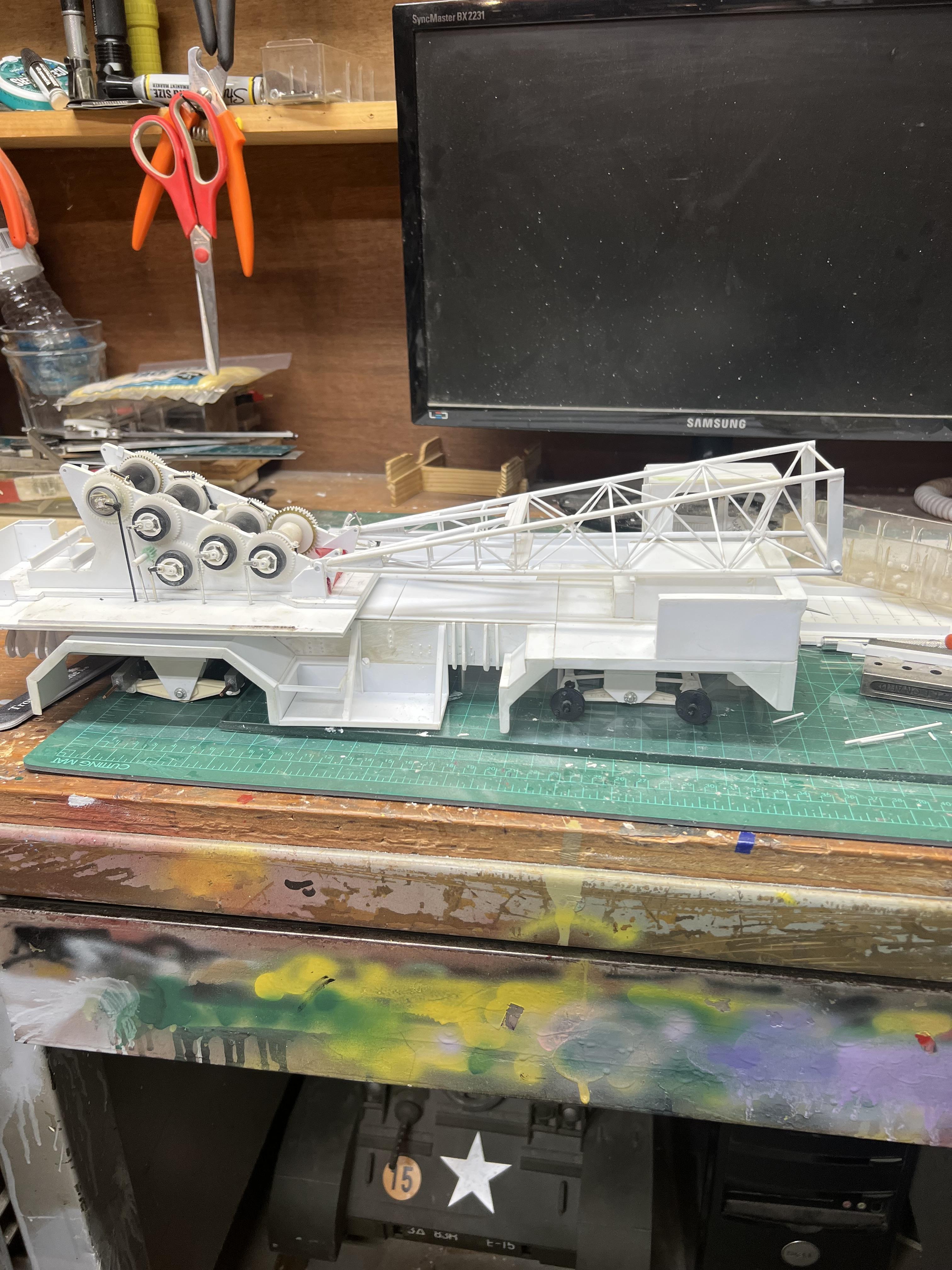

redneckrigger Posted August 25 Author Posted August 25 Quick mockup to ensure the boom fits with the cab and upper enclosure. So far so good! 3
ShakyCraftsman Posted August 25 Posted August 25 1 minute ago, redneckrigger said: Quick mockup to ensure the boom fits with the cab and upper enclosure. So far so good! Absolutely spectacular! Ron G 2

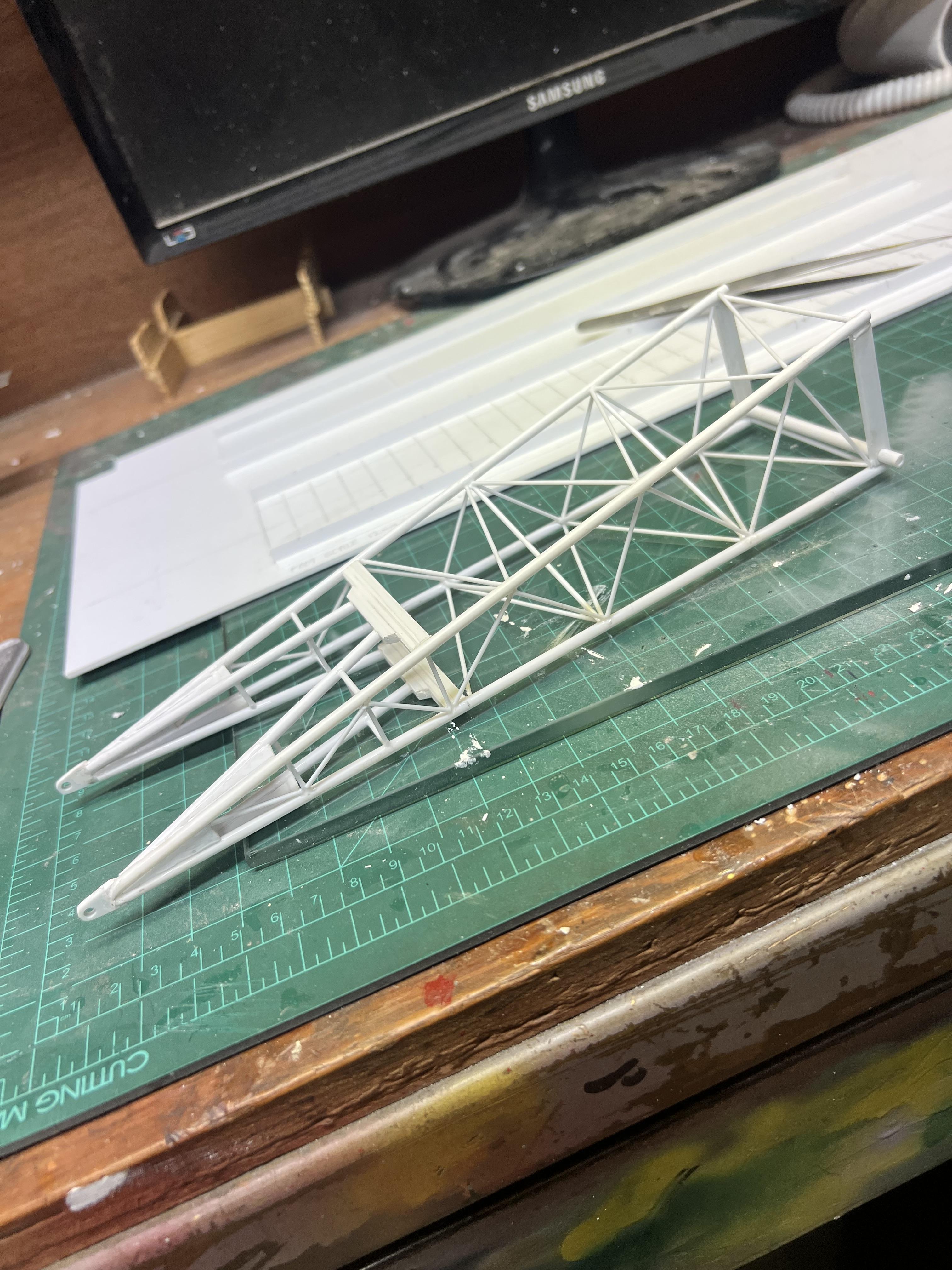

redneckrigger Posted August 27 Author Posted August 27 (edited) Finished the reinforcements for the boom foot and did a quick mockup to see what it looks like. Next step is building the boom head section and then the folding joints and then install the joints. Happy with what it looks like! Good thing is, when and if I ever finish it, if I want to stretch the boom, just gotta put in a work order to the fab shop and pin them on! Edited August 27 by redneckrigger 6
redneckrigger Posted August 29 Author Posted August 29 (edited) Well, I made all kinds of blueprints after taking actual measurements on the actual crane. And it worked out incredibly well, with almost no “two steps forward, three in reverse” scenarios in the five years this project has been underway………..BUT all good things come to an end. When I went to take the measurements, the boom was up in the air about 150 feet. So I could not take actual measurements of it but took plenty of photos. I made some educated guesses, took scaled measurements from the photos and thought my boom construction was going well. Until last night, when I started putting the pivot joint onto the boom foot. Seems that the actual boom foot is just a bit longer than I thought, which turned out with the pivot joint end of my boom foot being about one foot too short and it crashed into the carrier operators cab. So, I ended up having to lengthen the boom foot by about one foot. No biggie……if it was a straight section of boom. But it is a tapered section and by making it longer it was now too tall on the sides to properly mate with the straight sections. So, out comes the torches and welders, (sprue snippers, razor knives and glue), and I lengthened the main tubes, but now the sides had to have all of the latticework that was in place changed to make them all shorter to account for the taper. So tonight’s project will be about another 50 pieces of latticework made up and installed to AGAIN complete the boom foot! Photos to follow…….! Edited August 29 by redneckrigger 1
BK9300 Posted August 29 Posted August 29 7 minutes ago, redneckrigger said: So tonight’s project will be about another 50 pieces of latticework made up and installed to AGAIN complete the boom foot! Photos to follow…….! That's got to be frustrating, but you've clearly got the solution under way! Hope this mini project goes quickly for you. 1
redneckrigger Posted August 30 Author Posted August 30 (edited) Well, it was not too bad, just about 5 hours of re-do. But it came out well and now clears the drivers cab as it is supposed to. And while it was in the shop, I made a few other changes to the diagonal boom supports at the base to make them more prototypical. Edited August 30 by redneckrigger 5
