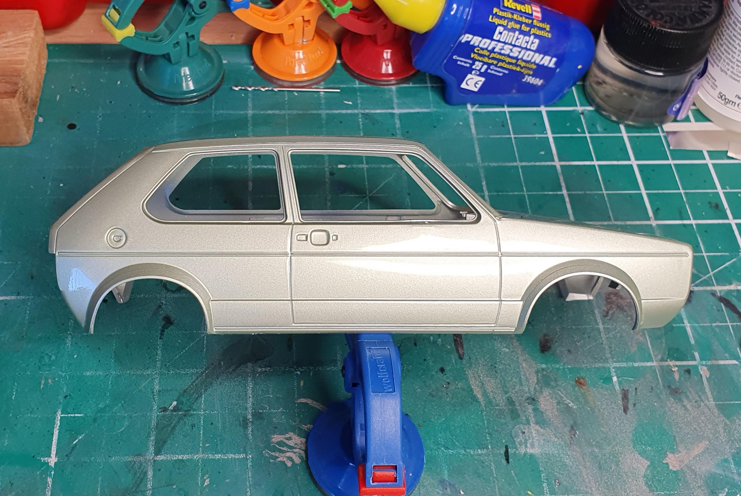

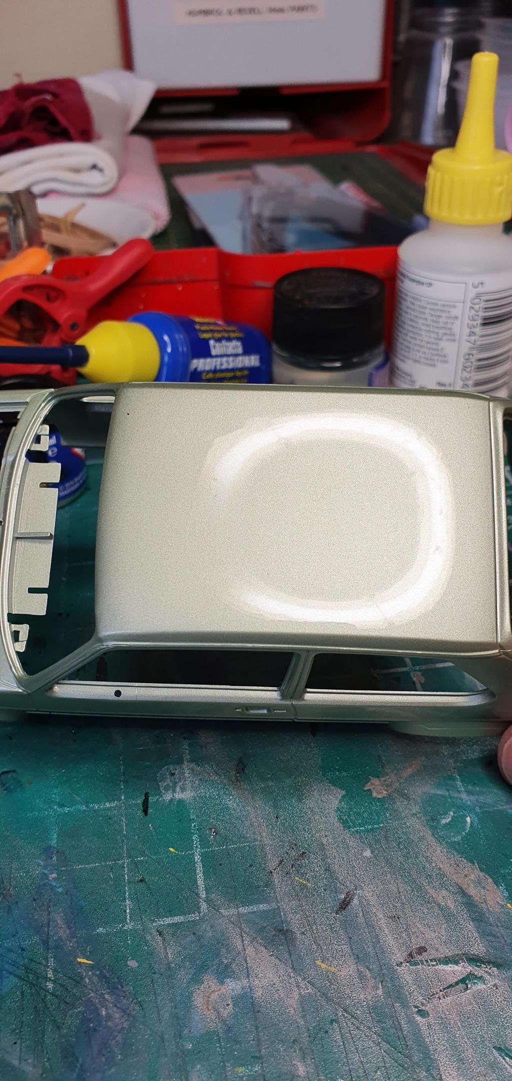

GeeBee Posted June 20, 2020 Author Posted June 20, 2020 Started polishing the bodyshell, starting on the roof panel, polished using 4 different grades of polishing compound

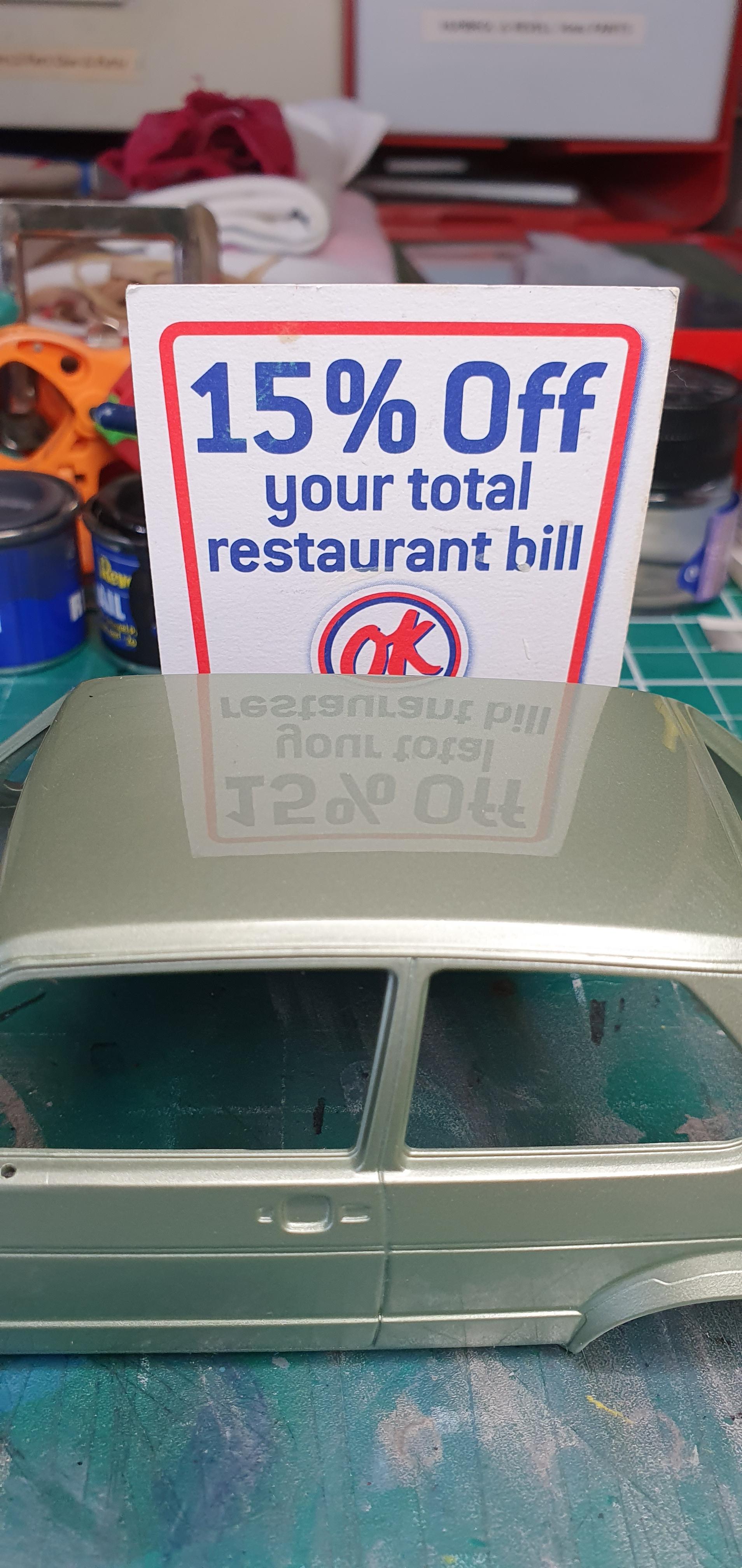

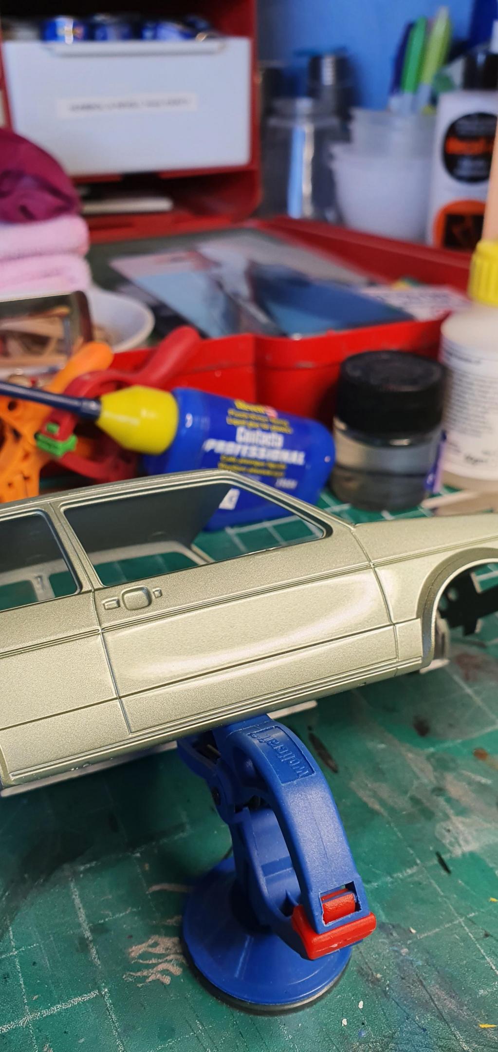

GeeBee Posted June 21, 2020 Author Posted June 21, 2020 (edited) Bonnet polished, I think that's as good as I can get it.... I've had that discount card for years, these days I just use it to see if I've got a good finish on my polishing Edited June 21, 2020 by GeeBee
espo Posted June 22, 2020 Posted June 22, 2020 That's what we used to call "smooth as a babies bottom" finish. That card really does show just how nice the finish on this build is.

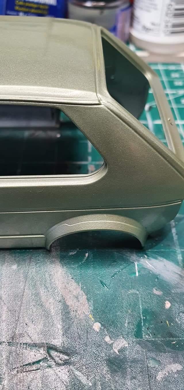

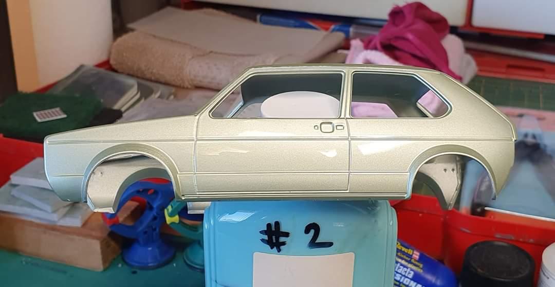

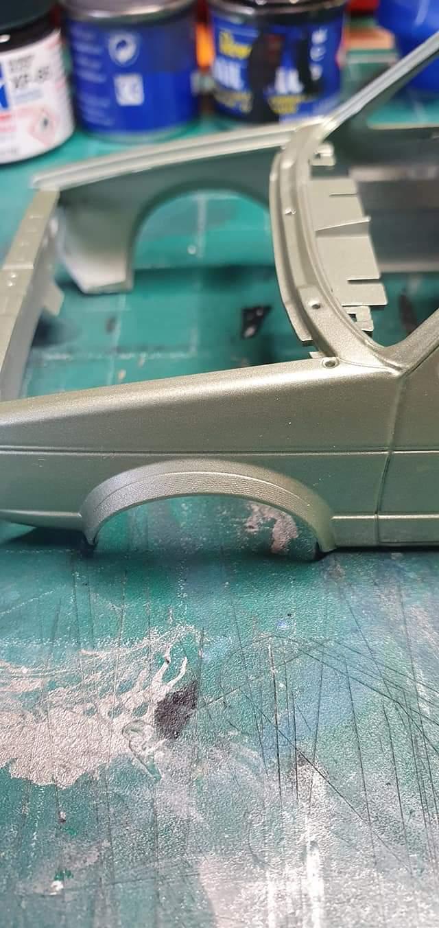

GeeBee Posted June 27, 2020 Author Posted June 27, 2020 (edited) Finished the polishing on this one, now I just need to mask it up to airbrush the black trim around the wheel arches and tailgate Edited June 27, 2020 by GeeBee
beeRS Posted July 2, 2020 Posted July 2, 2020 Beautiful job on the polishing the body. Masking and spraying the black trim is probably my least favourite job.
GeeBee Posted July 2, 2020 Author Posted July 2, 2020 4 hours ago, beeRS said: Beautiful job on the polishing the body. Masking and spraying the black trim is probably my least favourite job. Luckily I didn't put much base coat over the wheel arch trim, hopefully it should be easier to mask them off using Bare Metal foil

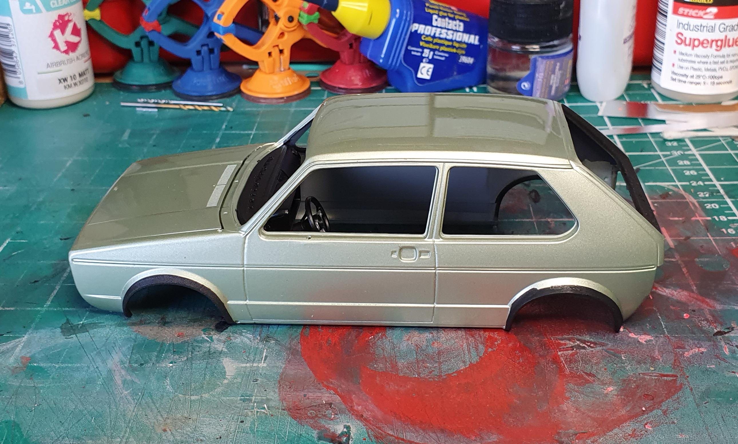

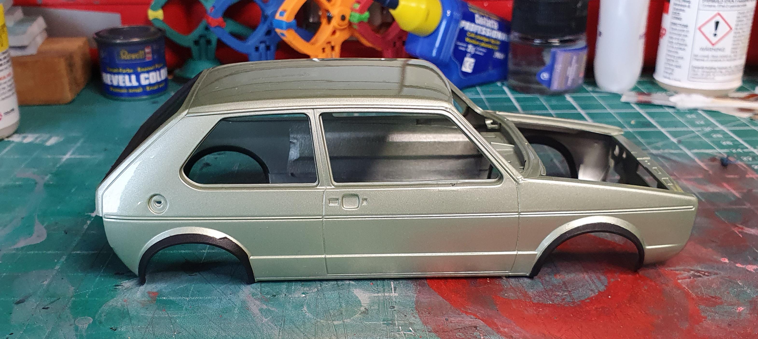

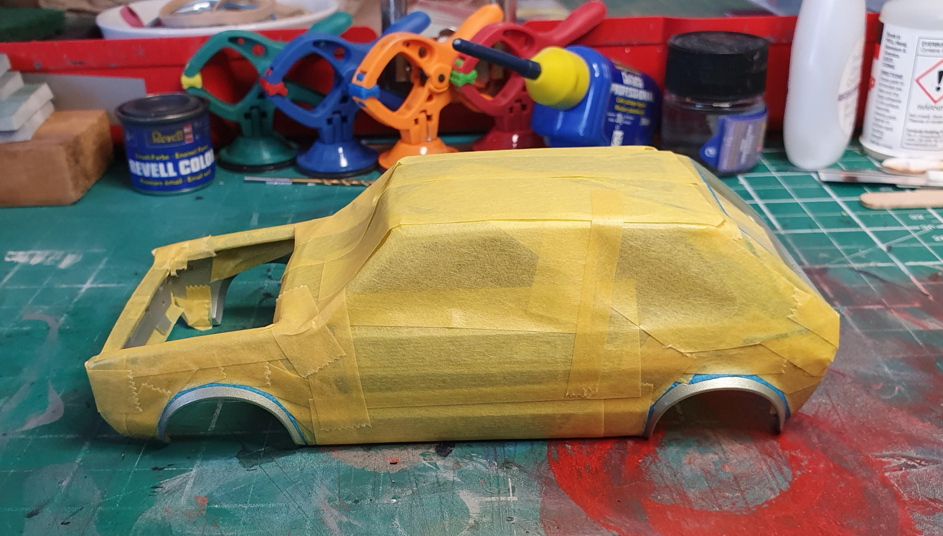

GeeBee Posted September 12, 2020 Author Posted September 12, 2020 So just over 2 months since I've touched this one, so as the weather was warm enough to get myself into the garage to airbrush, i thought i would get cracking with the Golf, masked up the wheel arches, and airbrushed them matt black, using VHT matt black, decanted so i could apply it with the airbrush.

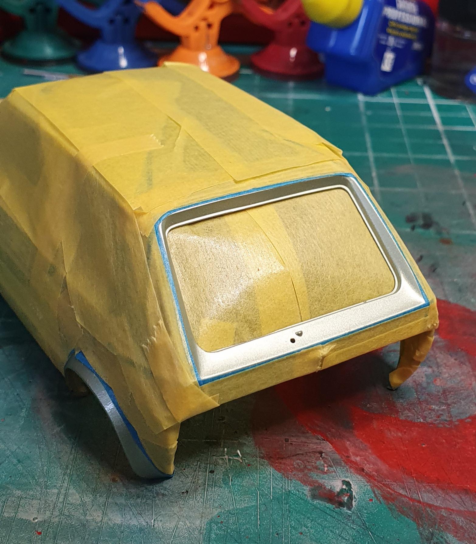

GeeBee Posted September 12, 2020 Author Posted September 12, 2020 While I was using the airbrush, I managed to mask up all the windows and airbrushed the rubber seals using Tamiya rubber black, decanted from the aerosol.
Spottedlaurel Posted September 12, 2020 Posted September 12, 2020 Good to see you back on this one again. The VHT paint gives a great effect.
Modlbldr Posted September 12, 2020 Posted September 12, 2020 Just ran through this posting and the work on this is phenomenal! I especially like the body color and the contrast with the VHT black. Looks like you had a similar warpage problem in the engine bay that I had on the Cabriolet that I did a while back. Glad you were able to clamp it into place. Nice work on this project! Later-

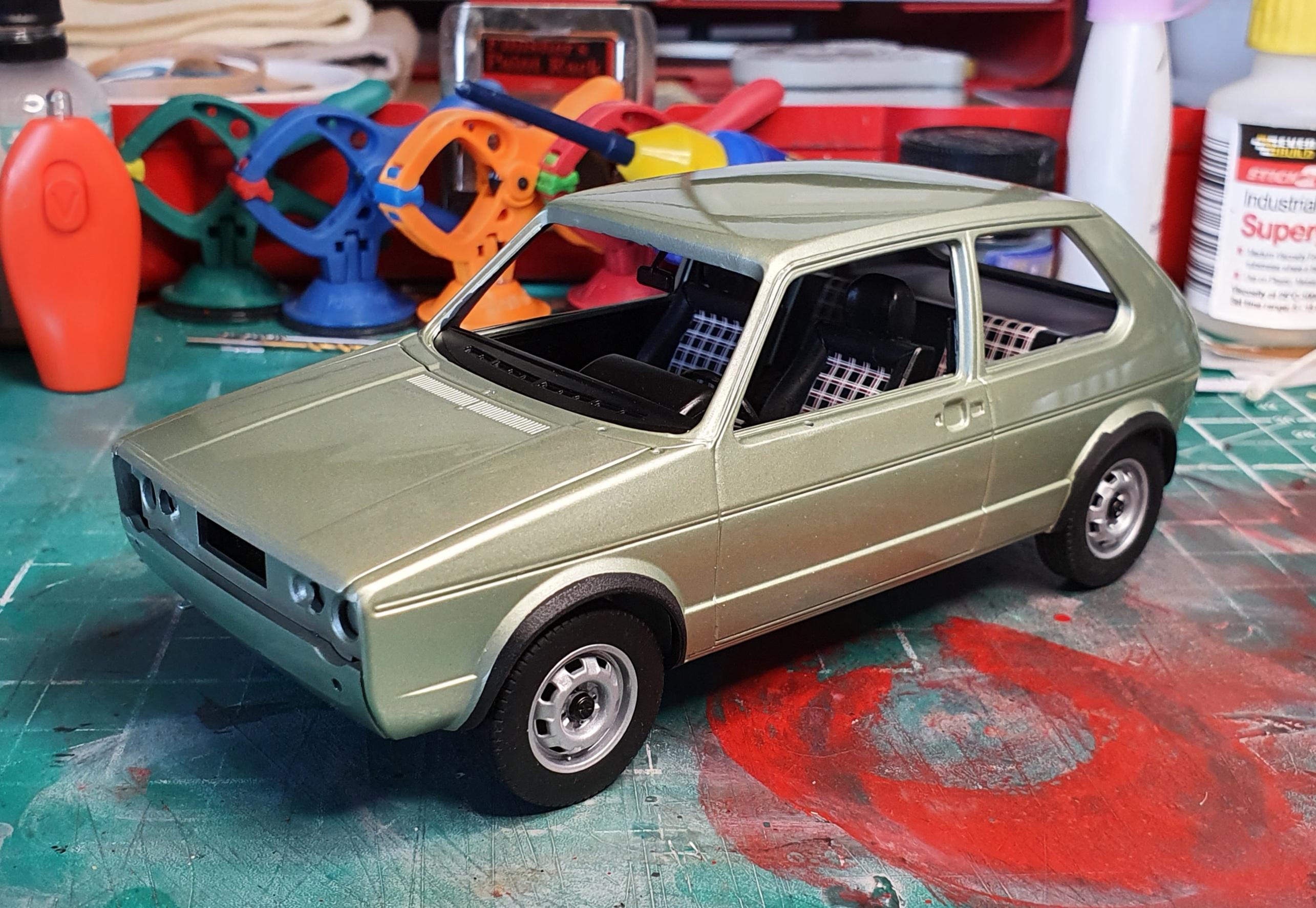

GeeBee Posted September 12, 2020 Author Posted September 12, 2020 (edited) Got the interior fitted into the body, and then the body was fitted to the floorpan, not the easiest job to do, it really needed a lot of persuasion to get everything fitted properly, tight isn't the word I'd use to describe it, but once everything was lined up it only needed a few drops of UV resin to hold everything in place, got the front and rear valances fitted, I can see now why Revell tell you not to fit them earlier before the body is fitted Edited September 12, 2020 by GeeBee

GeeBee Posted September 12, 2020 Author Posted September 12, 2020 1 hour ago, doorsovdoon said: Teach me the ways, master! xD Stunning paint on a classic It's not my best work, it's Zero base coat, followed by a few coats of acrylic clearcoat, it's only the second time I've used basecoat, so I'm still learning.
doorsovdoon Posted September 12, 2020 Posted September 12, 2020 Well it looks great. It looks like a real car half way through the production line! Is Zero a brand?
GeeBee Posted September 12, 2020 Author Posted September 12, 2020 7 minutes ago, doorsovdoon said: Well it looks great. It looks like a real car half way through the production line! Is Zero a brand? Yes,Zero paints are pre thinned paints for airbrush use, available in the UK from Hiroboy https://www.hiroboy.com/Zero_Paints--manufacturer--46.html
doorsovdoon Posted September 12, 2020 Posted September 12, 2020 Prices are not bad for the paints, especially if this is how the finish turns out with them.
GeeBee Posted September 12, 2020 Author Posted September 12, 2020 17 minutes ago, doorsovdoon said: Prices are not bad for the paints, especially if this is how the finish turns out with them. Even better value as in the 60mls of paint supplied is enough to paint around 4 bodies, i painted this one and stripped it as I wasn't happy with the quality, I painted it again along with the bonnet, I've got enough to paint at least 2 more models, the clearcoat applied over the base basecoat that gives you the deep shine, I'm yet to try 2k lacquer as I'm more than happy with single pack acrylic lacquer.
