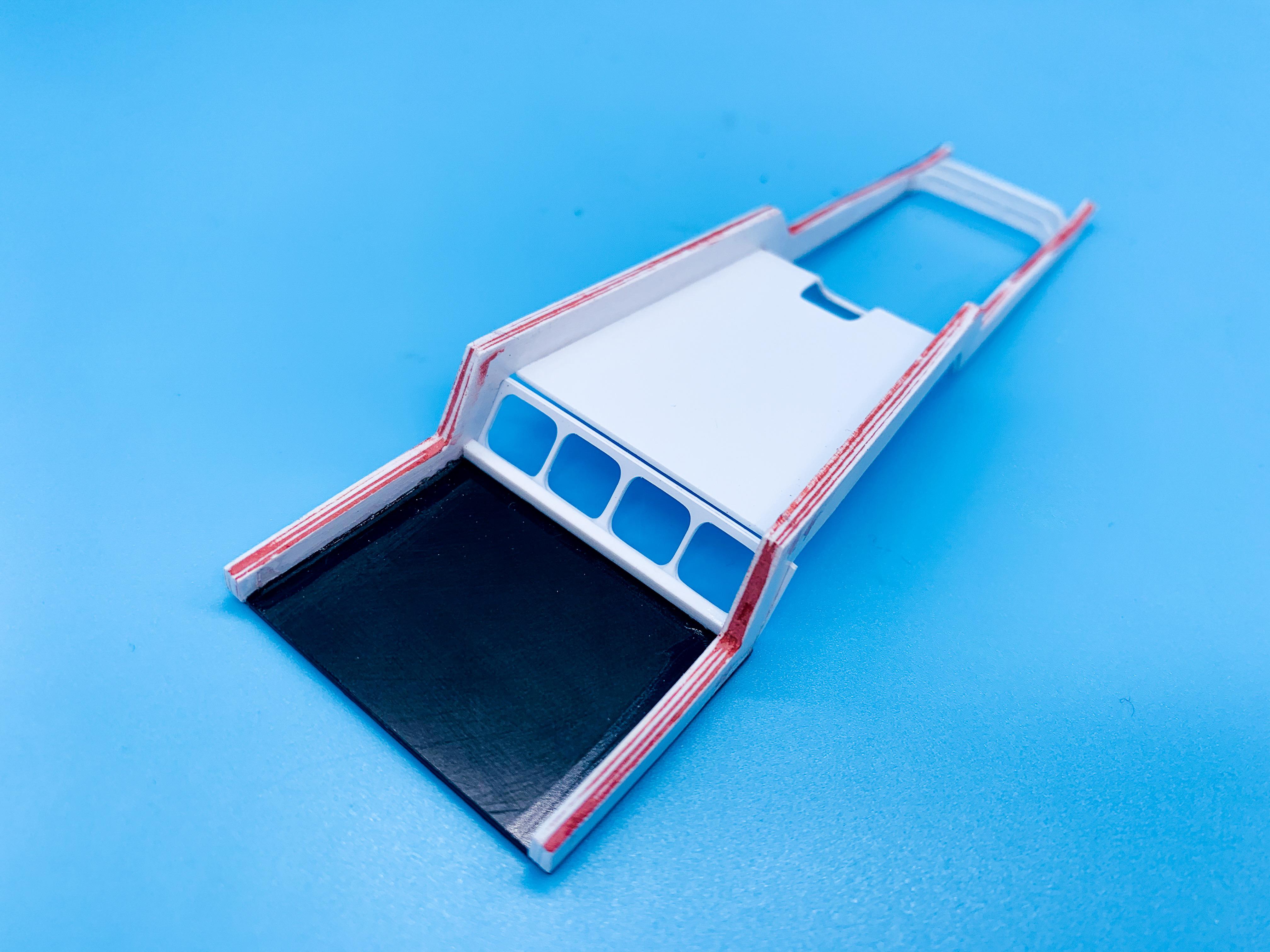

I scanned the new Revell Model A frame and used it as a start to design my own version - nothing revolutionary but a 3-inch Z front and rear compared to stock (new design in the middle, Revell frame top and bottom):
A little work on the cutter later and I’ve got some rails to laminate together:

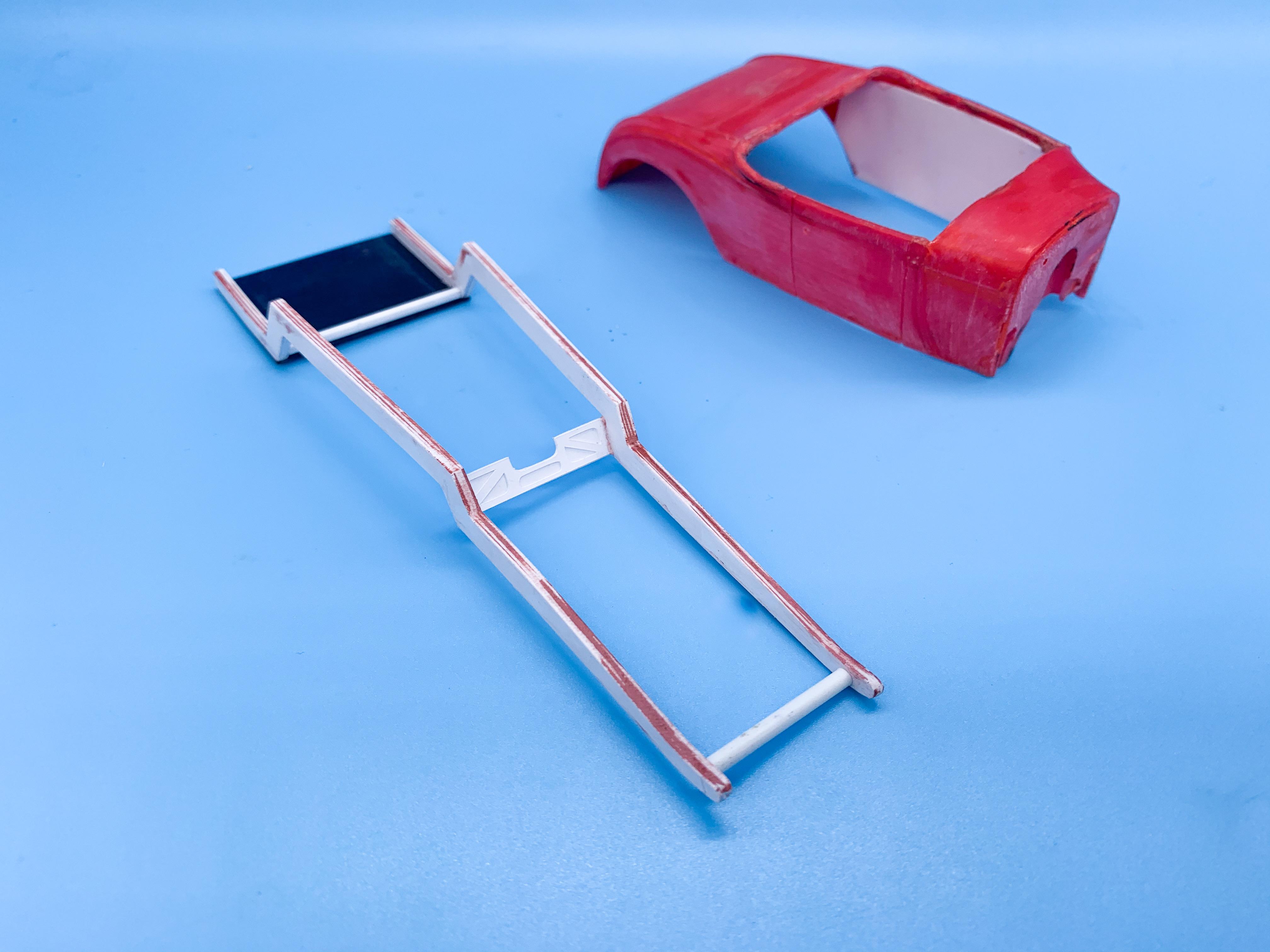

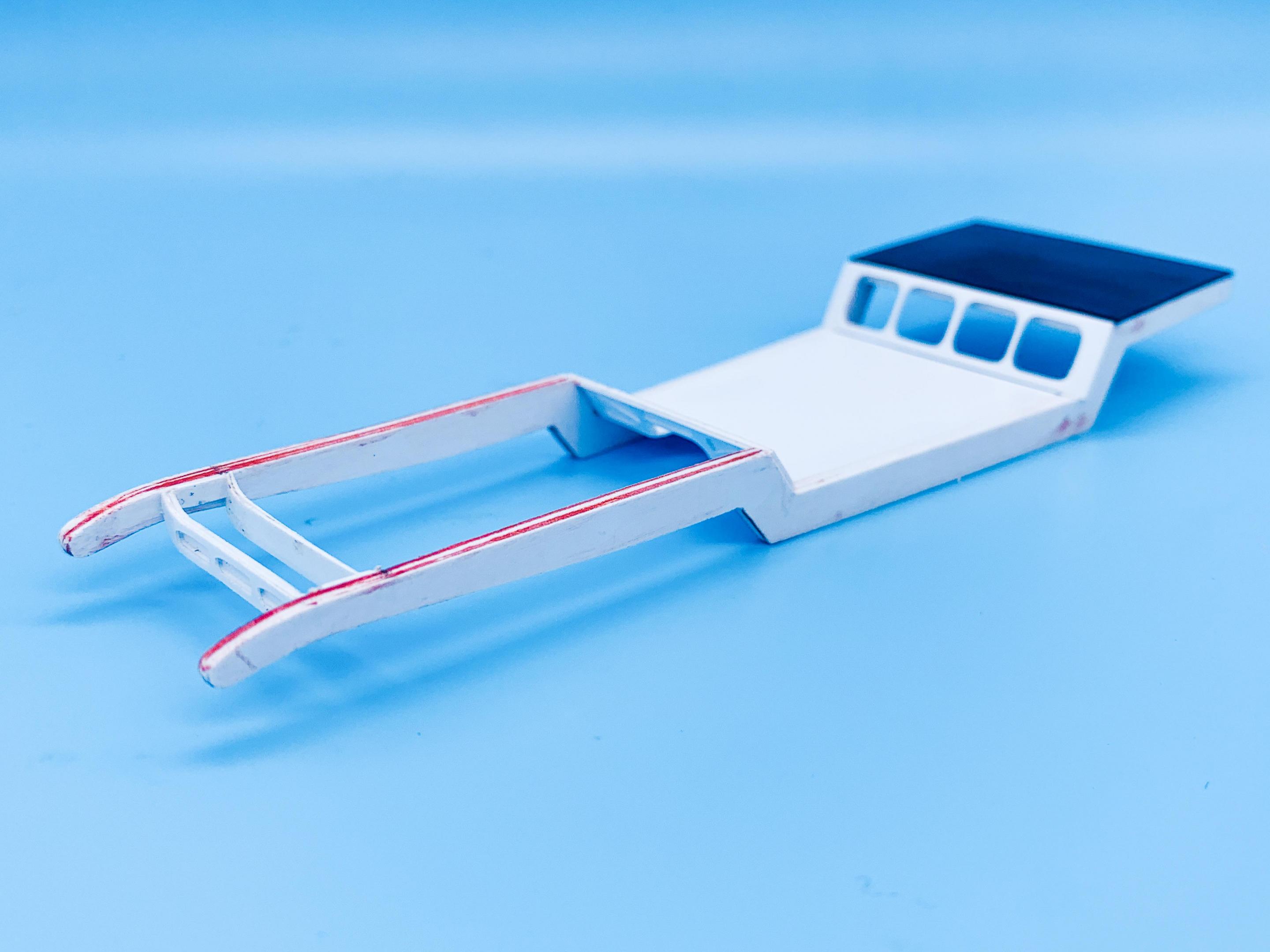

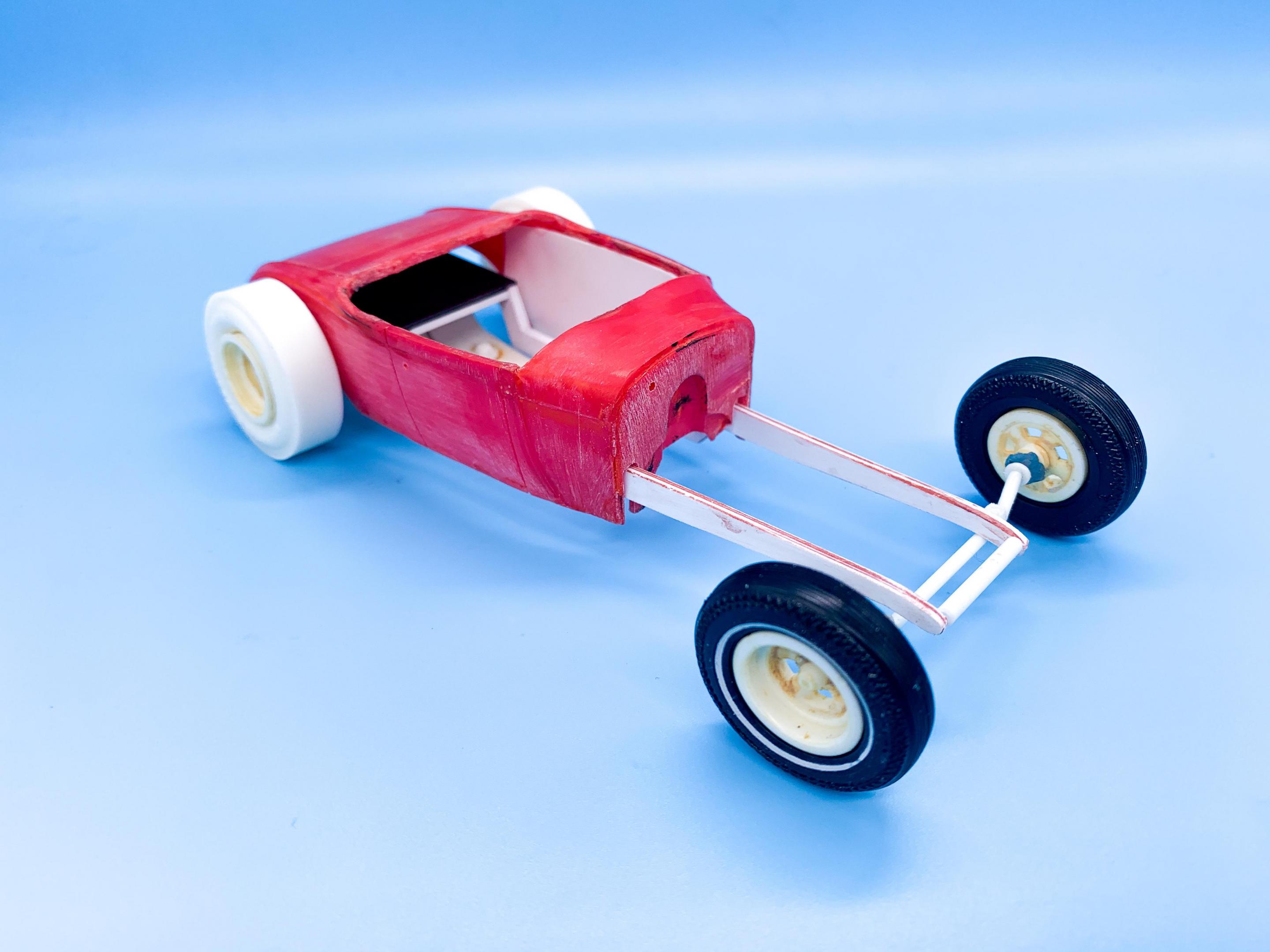

Did a little work on the frame today - just enough so I could get an idea of what parts are going to work right and get an idea of stance etc.

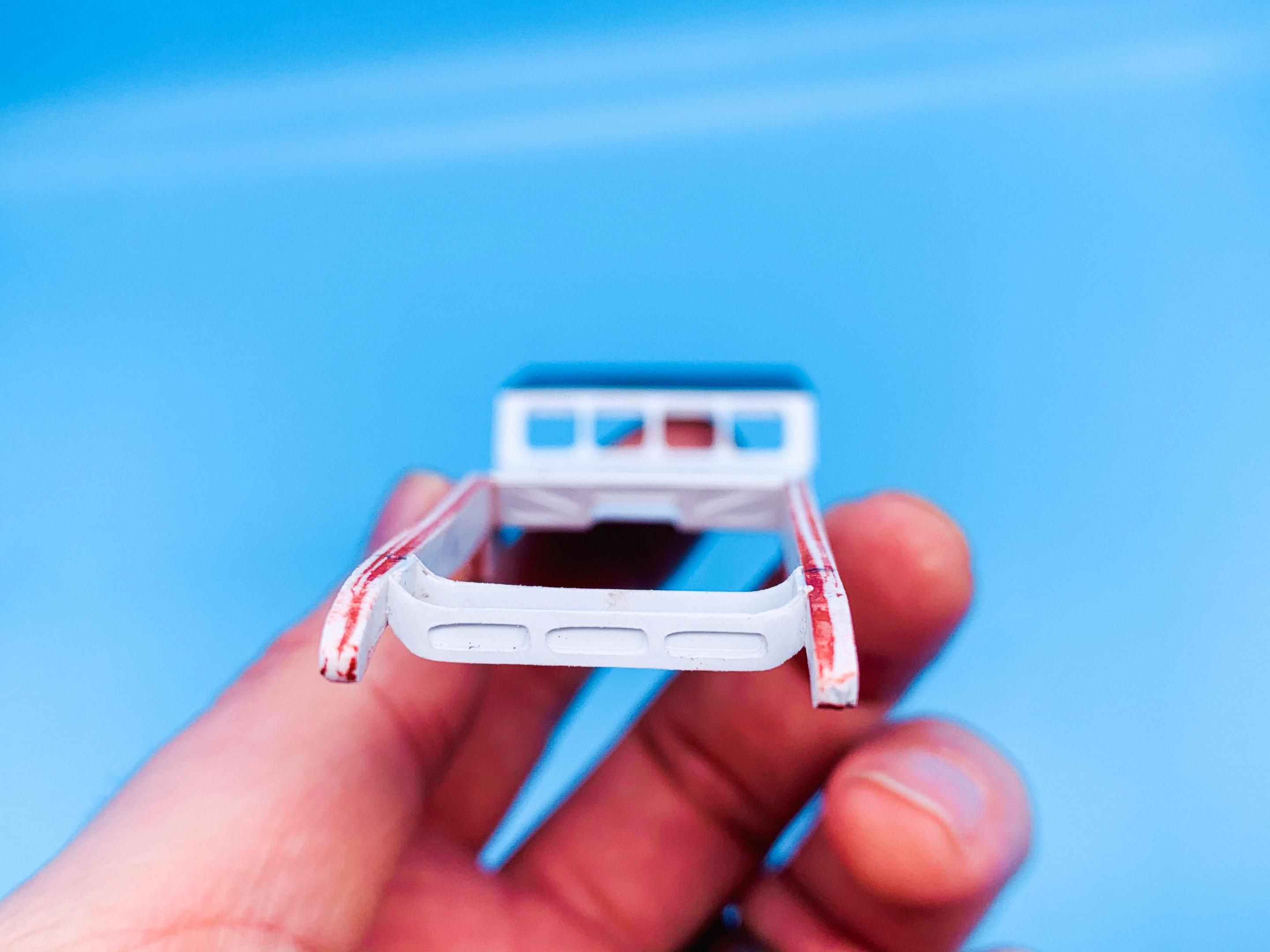

The tricky thing with this frame is that the rails are parallel at the back, then pinch inwards a little under the interior floor then straighten back out  again once they’re past the firewall, so it took some fettling to get them just right without making a jig (which I might do so I can make similar ones a little more easily in future).

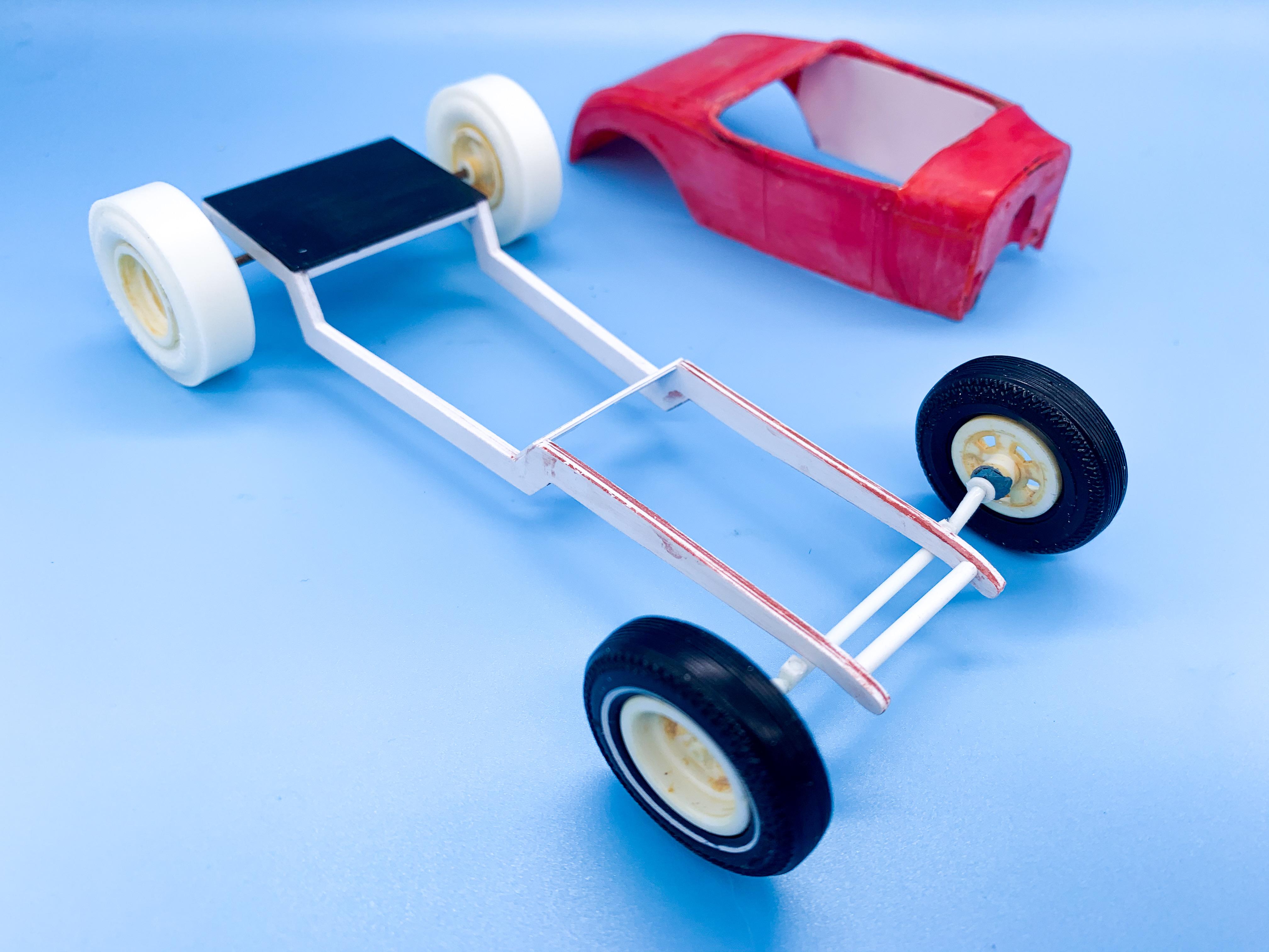

Quick mock-up of it with a front axle I had in my spares box:
To help get the angles right I made the rear trunk-floor section first and got the rails perfectly straight off of that, then made that little center piece to bring the rails inwards under the interior floor section between the zees, and that spreader bar on the front is temporarily keeping them parallel for the front half.  I’ll try and think of something nice to do with that once I’ve made a crossmember for the front end to mount to.
As you can see, I Bondo’d the frame rails a little to smooth them out - my cutter does a really nice job but it has enough tolerance where the identical pieces I laminated together to make the frame were plus or minus a fraction of a mm.  Can’t complain too much about a quarter of a mil tolerance from a machine that costs under $150 though, so...
And a quick mock-up with the body in place to make sure I didn’t screw up catastrophically anywhere here:
It won’t be sitting anywhere near this low when it’s done but everything fit ok after I notched some slots in the firewall for the purposes of trying it all out.  Should sit fairly nicely though hopefully - probably 3-4 scale inches lower than the Revell 29s I would think.
More scratchbuilding fun tomorrow, folks - same bat-time, same bat-channel!

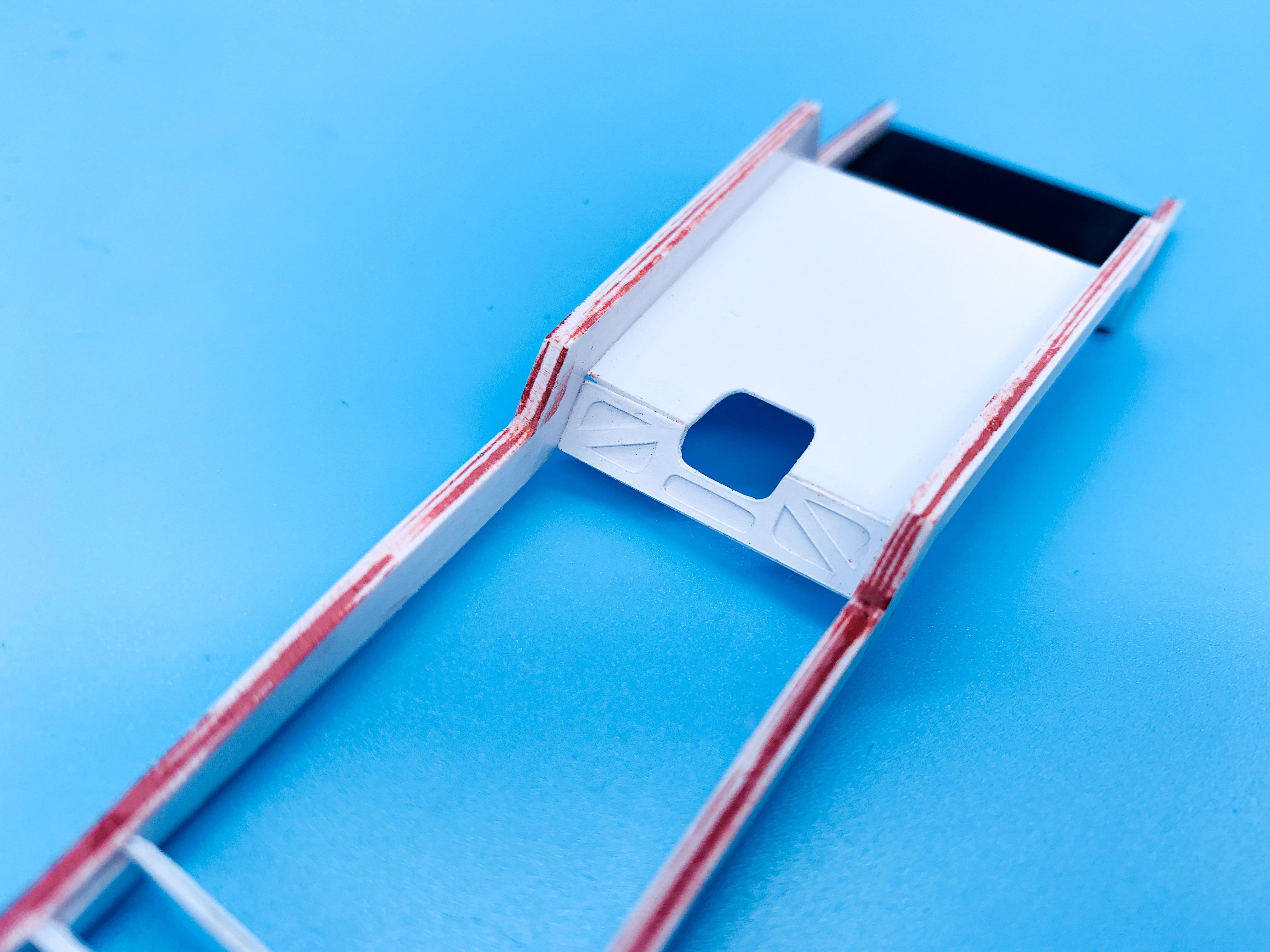

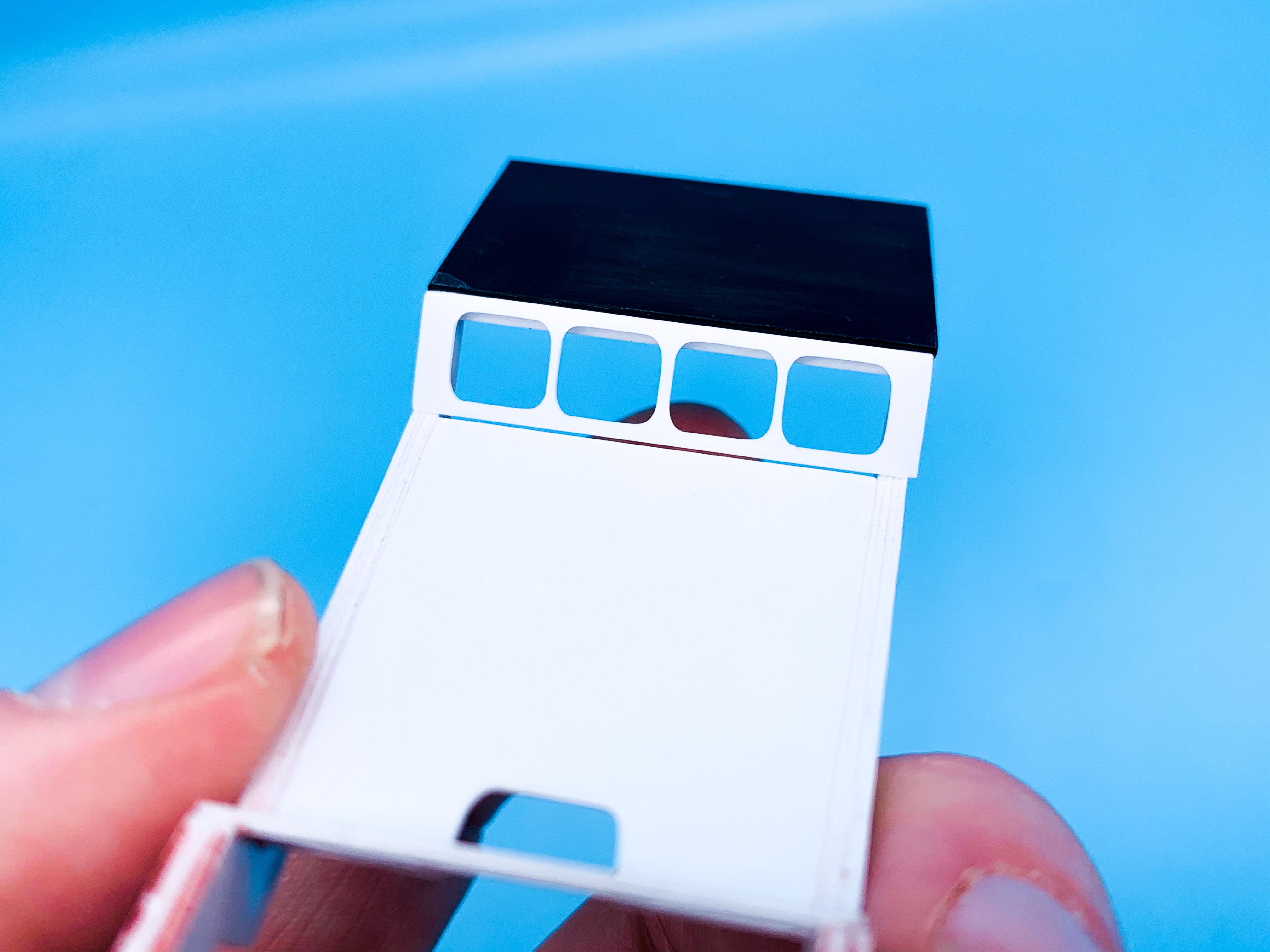

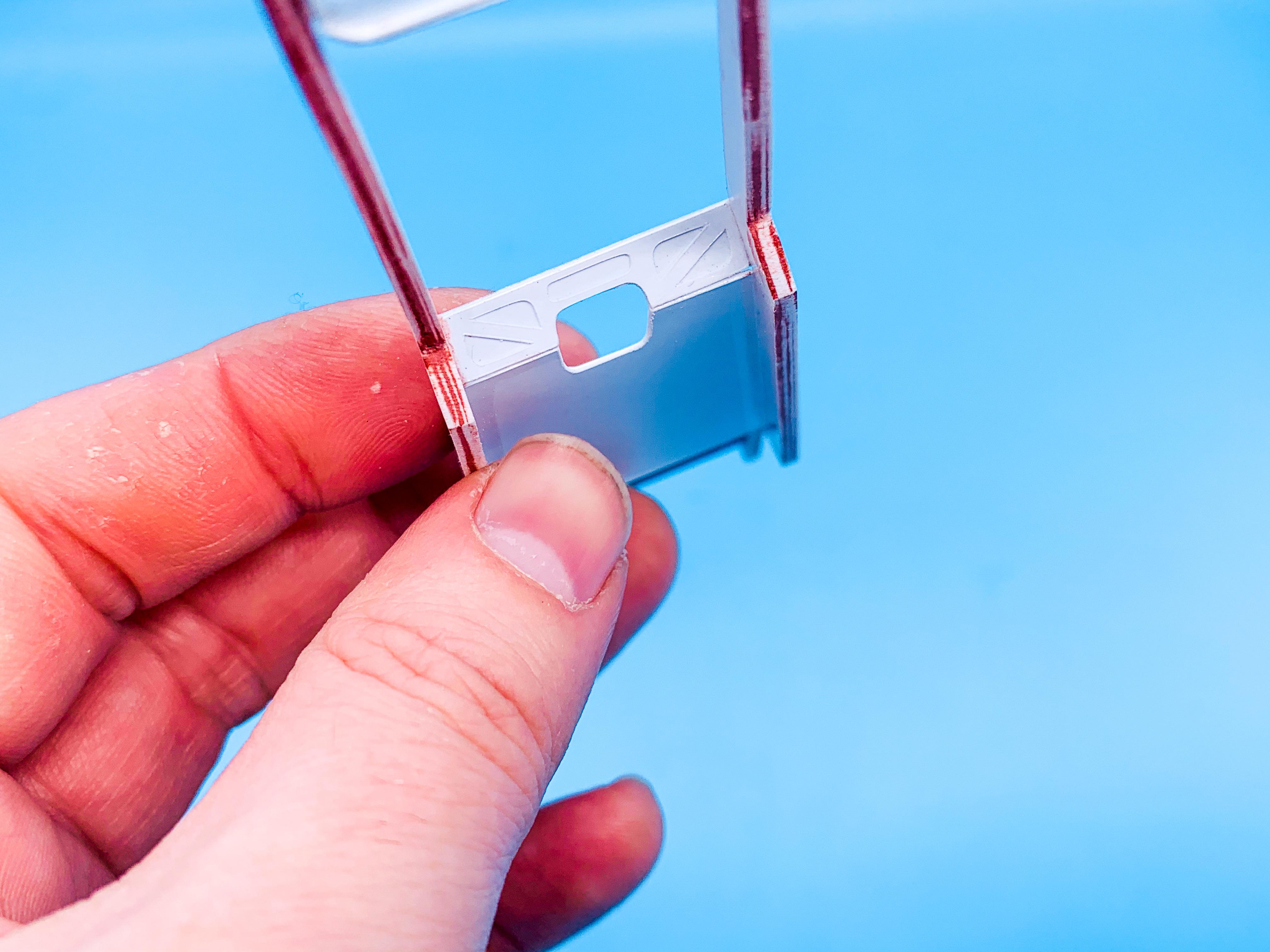

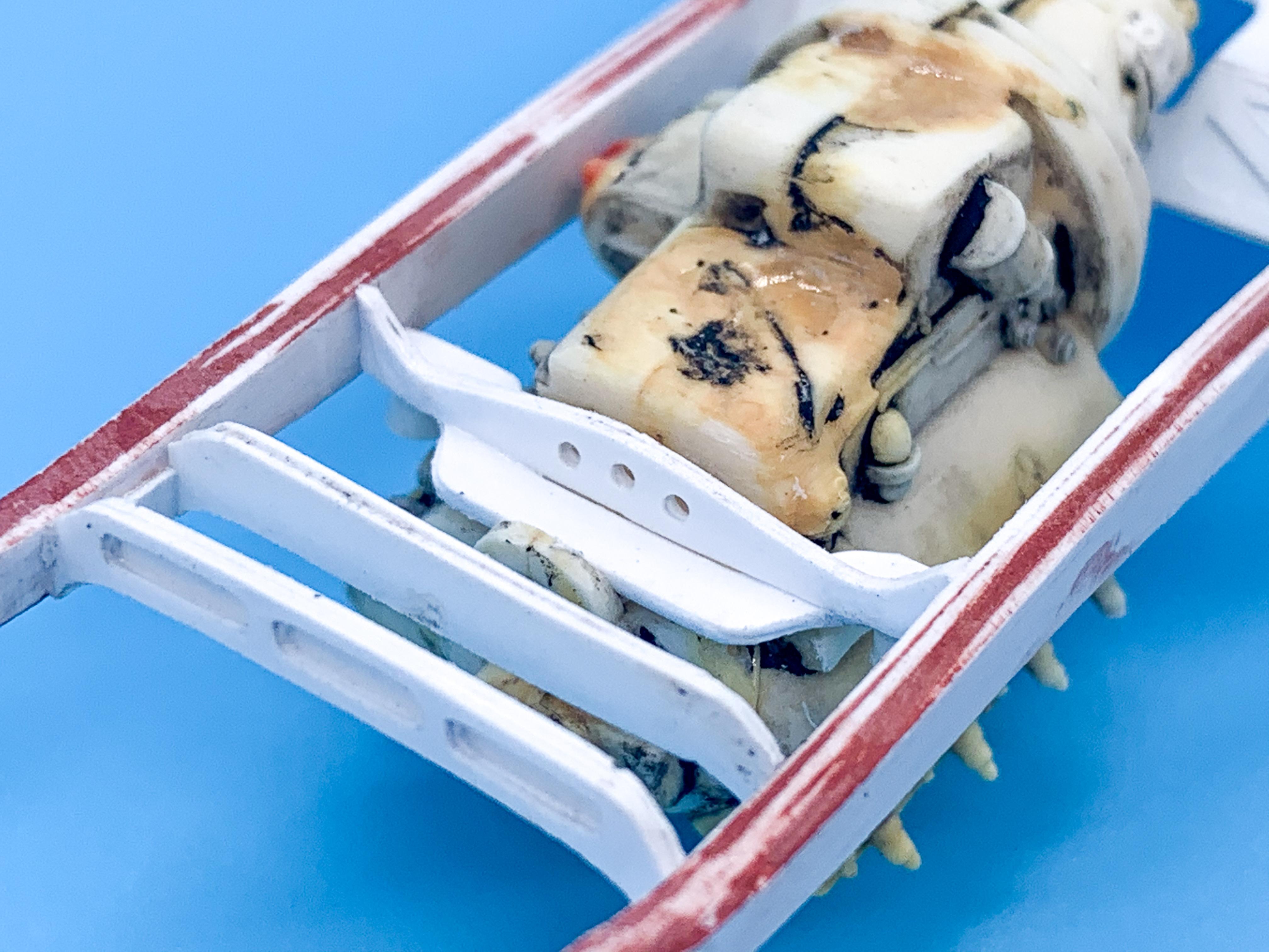

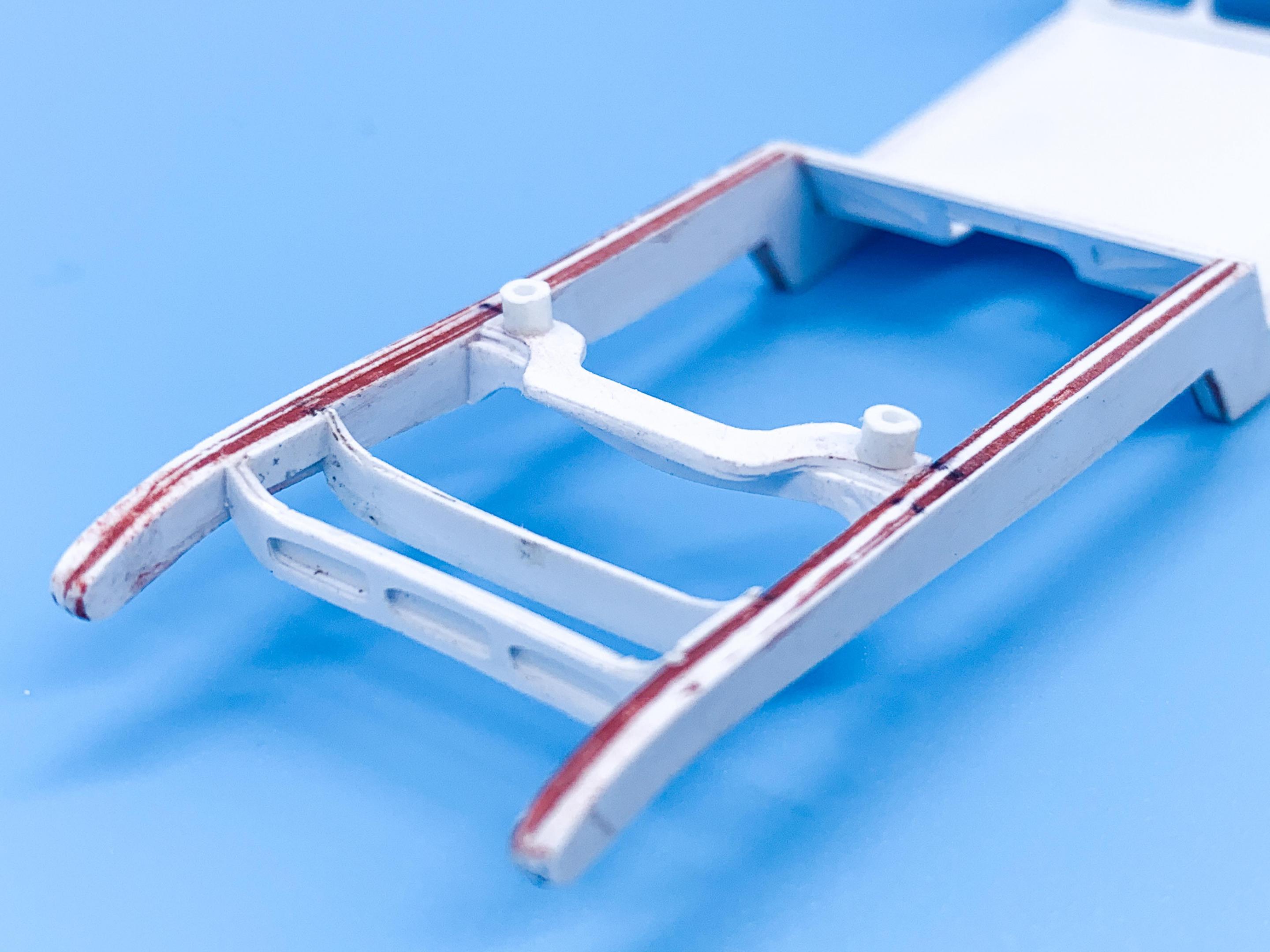

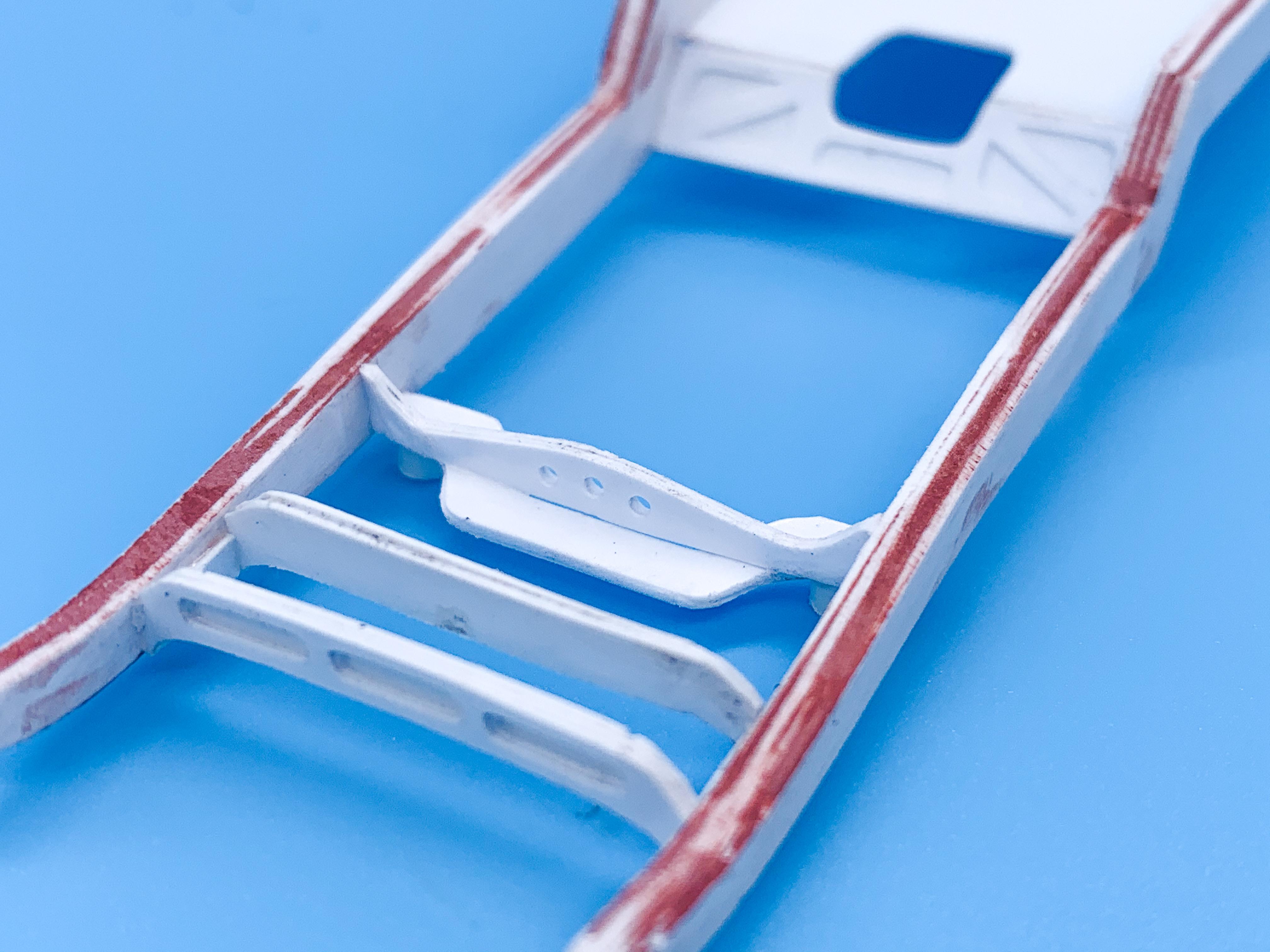

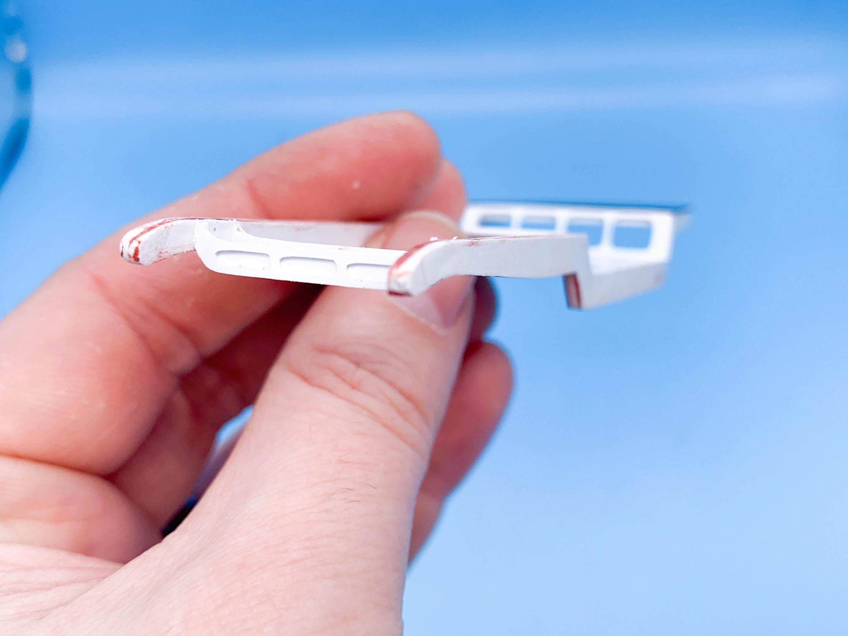

I wasn’t going to post another update just yet, but got a lot done on the frame today so here goes...
First up, front crossbrace, doubling as a mount for the front axle:
Then the center brace where the first zee in the frame happens:
And finally this one for the back of the interior section where it meets the second zee:
Those square holes won’t be open in the finished product, but leaving them open now allows me the option to use a different material behind there to add some visual interest to the frame, or at least paint it more easily if I decide on a different color or finish or something.
Ive got more design and detail work to add to this frame still, but I’m far enough along where I can start adding some major components...soon as I decide exactly what they are ??
More soon!

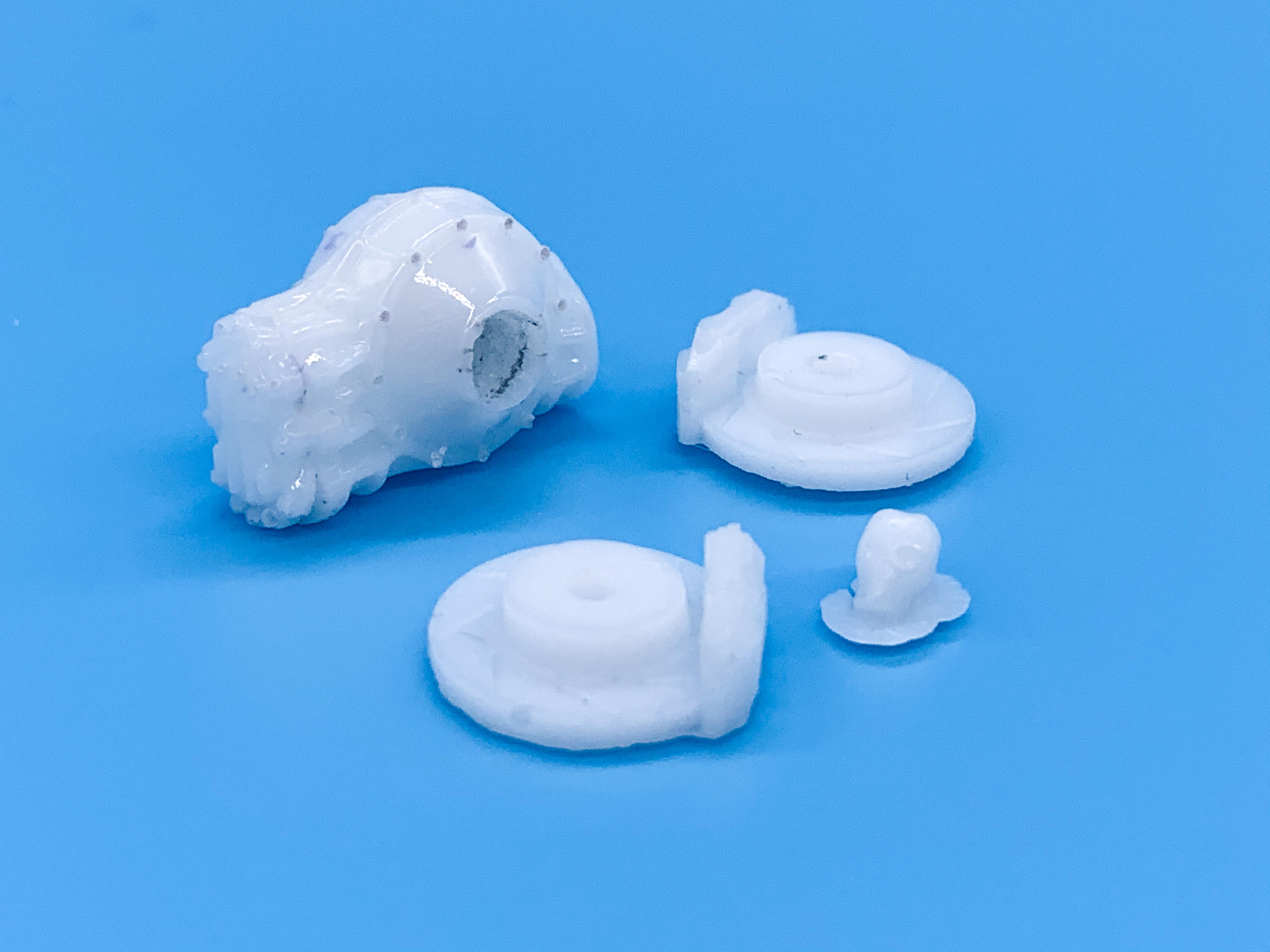

I decided the stock 32 Ford axle probably wouldn’t last too long behind a blown ANYTHING so I cast a resin center section of a Quickchange that I can scratchbuild some other parts around - and whilst I had the RTV and resin out I made some duplicates of some disk brakes that I had a couple of in my spares box - not sure what they’re from, but I figured if I was doing this build for real I’d go with disks over drums, even if it is a more traditional-styled build in terms of some of the parts:
Oh, and that little skull will be my shift knob - there’s a particular Hot Wheels that has skull headlamps so I made a mould so I can make more of those in future.
