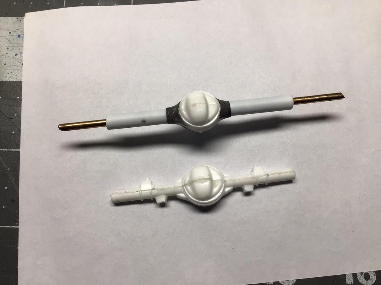

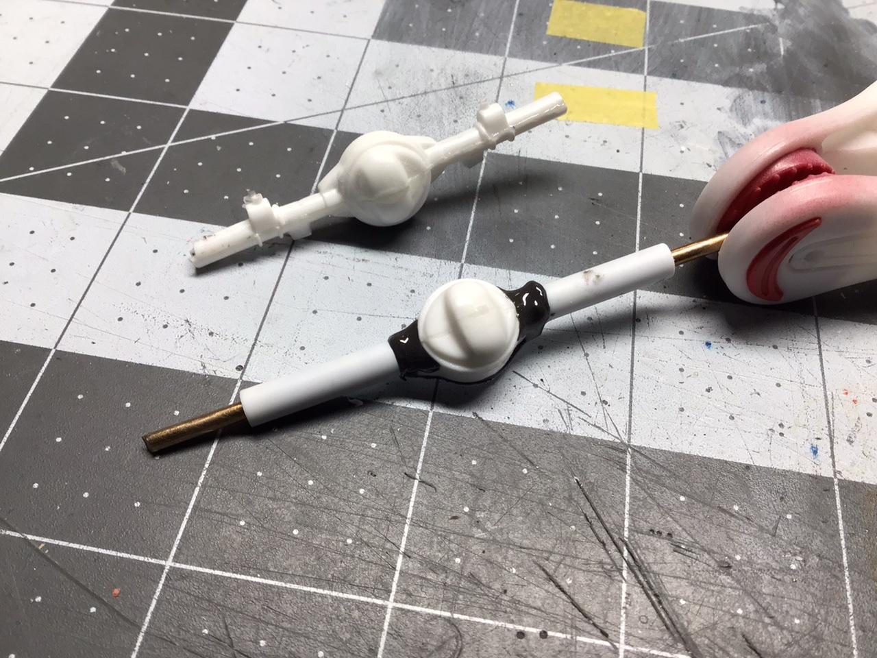

Paul Payne Posted May 21, 2020 Posted May 21, 2020 I'm working on some wheels which combine resin and styrene. I am adding a section which must be centered and then blended in. Superglue would be very secure but also not forgiving if repositioning is required. Any ideas?
Snake45 Posted May 21, 2020 Posted May 21, 2020 I agree with AFX about epoxy but disagree about the 5-minute type. You say it needs to be "blended in," i.e. sanded. All 5-minute epoxies I know of cure to a somewhat rubbery texture and are VERY difficult to sand. I'd recommend a 12- or 24-hour cure type. J-B Weld is my favorite epoxy if sanding is needed, and it doesn't have to be clear. It mixes at a 50-50 ratio and since it's half black and half white, you KNOW it's mized when it's uniformly gray. Doesn't seem to be super-critical on mixing ratio, either.
Paul Payne Posted May 21, 2020 Author Posted May 21, 2020 Guys, thanks for the help- my only negative about epoxy is that it tends to be harder than the surrounding material. Not over sanding the joined parts can be a challenge.
Snake45 Posted May 21, 2020 Posted May 21, 2020 17 minutes ago, Paul Payne said: Guys, thanks for the help- my only negative about epoxy is that it tends to be harder than the surrounding material. Not over sanding the joined parts can be a challenge. J-B Weld isn't MUCH harder than styrene, and I've found it feathers fairly well. Use a sanding block, too, not your fingers or "naked" sandpaper. That helps.
NOBLNG Posted May 21, 2020 Posted May 21, 2020 I second the J.B. recommendation. It sands very nicely!
Paul Payne Posted May 21, 2020 Author Posted May 21, 2020 Guys, thanks for the info. I realized that sitting in my adhesives container is a tube of "general purpose adhesive", probably similar to Duco cement (am I dating myself?) If this doesn't eat styrene or resin, i might try this.
Snake45 Posted May 21, 2020 Posted May 21, 2020 3 minutes ago, Paul Payne said: Guys, thanks for the info. I realized that sitting in my adhesives container is a tube of "general purpose adhesive", probably similar to Duco cement (am I dating myself?) If this doesn't eat styrene or resin, i might try this. I LOVE coming across an old model built with Duco. Comes right apart!

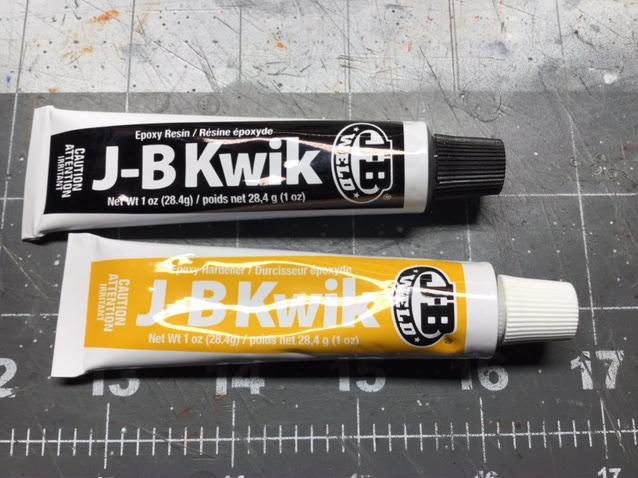

NOBLNG Posted May 21, 2020 Posted May 21, 2020 This is the J-B I used. It sets in 4 minutes according to the tube. I leave it a fair bit longer.
Snake45 Posted May 22, 2020 Posted May 22, 2020 1 hour ago, NOBLNG said: This is the J-B I used. It sets in 4 minutes according to the tube. I leave it a fair bit longer. Have never tried that. Is it still black+white=gray? And how does it sand after it's cured?
peteski Posted May 22, 2020 Posted May 22, 2020 4 hours ago, NOBLNG said: This is the J-B I used. It sets in 4 minutes according to the tube. I leave it a fair bit longer. Ah, a 4-minute epoxy! LOL! Just as I mentioned earlier for 5-minute stuff, it turns rubbery in 4-minutes, then "leave it a fair bit longer" to fully harden.
NOBLNG Posted May 22, 2020 Posted May 22, 2020 2 hours ago, Snake45 said: Have never tried that. Is it still black+white=gray? And how does it sand after it's cured? Yes. And very nicely.
NOBLNG Posted May 28, 2020 Posted May 28, 2020 On 5/21/2020 at 10:05 PM, NOBLNG said: Yes. And very nicely. This J-B doesn’t stick very well to smooth styrene though. I filled a sink mark on a tranny pan and it peeled off while sanding. Maybe it needed to cure longer, but some scuffing to make it “key in” would help.?
