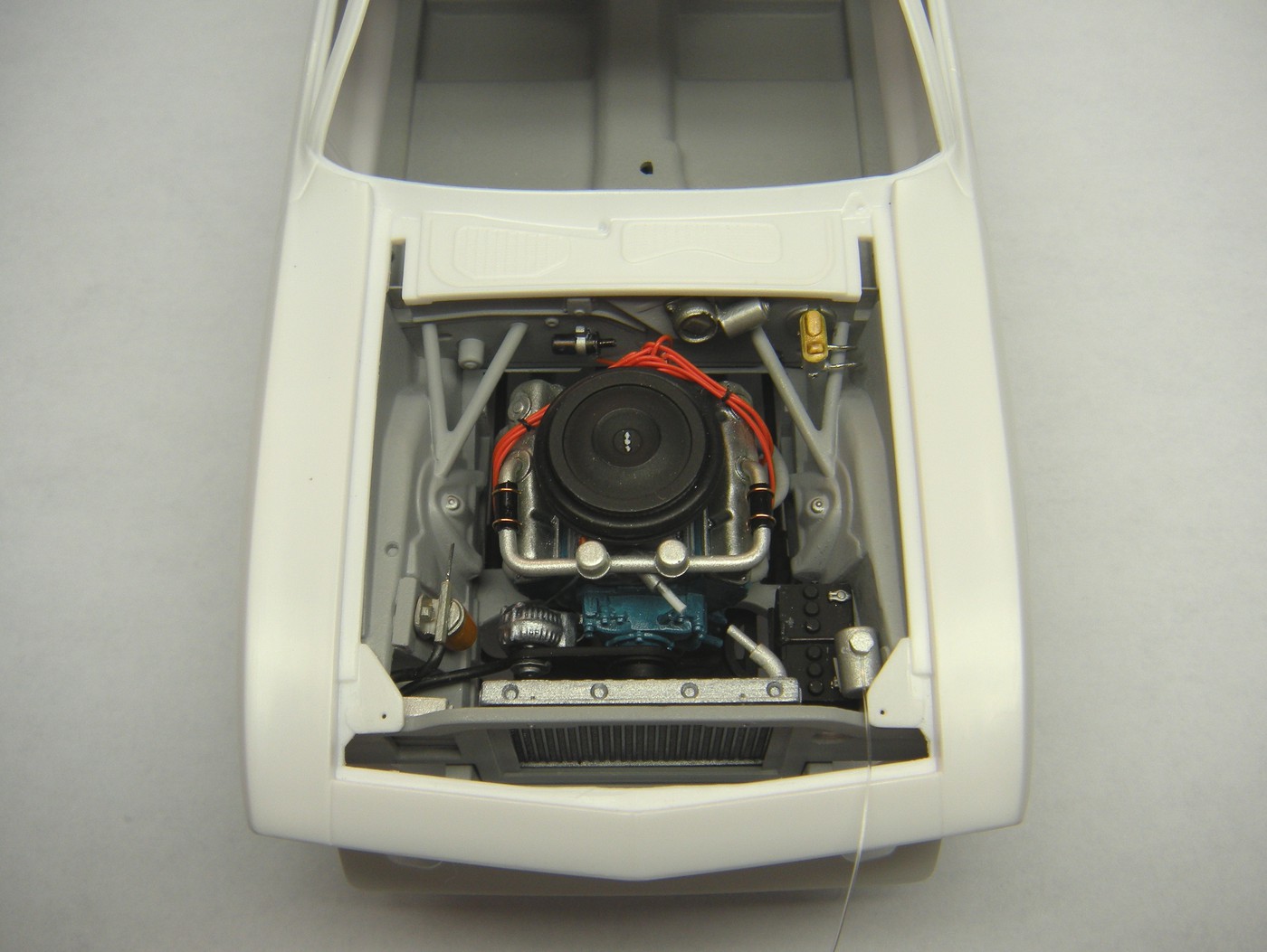

afx Posted May 30, 2020 Posted May 30, 2020 (edited) I did a 340 conversion (1/25 scale) using the Revell 426 for my '70 'Cuda T/A project. That was before Revell released the AAR 'Cuda. Edited May 30, 2020 by afx
Casey Posted May 30, 2020 Posted May 30, 2020 On 5/30/2020 at 12:40 AM, afx said: I did a 340 conversion (1/25 scale) using the Revell 426 for my '70 'Cuda T/A project. That was before Revell released the AAR 'Cuda. Expand Is that the AMT '71 Duster 340's intake manifold? Did the old Revell AAR Cuda's cylinder heads and valve covers need to be resized at all, or were the pretty much used as is?
afx Posted May 30, 2020 Posted May 30, 2020 On 5/30/2020 at 1:24 AM, Casey said: Is that the AMT '71 Duster 340's intake manifold? Did the old Revell AAR Cuda's cylinder heads and valve covers need to be resized at all, or were the pretty much used as is? Expand Yes the AMT Duster intake manifold. I had to shorten the old 1/24 scale AAR 'Cuda heads and valve covers a little to fit the 1/25 scale block. The 1/24 scale six pack intake can be made to fit as well.
gtx6970 Posted May 30, 2020 Posted May 30, 2020 On 5/30/2020 at 2:29 PM, afx said: Yes the AMT Duster intake manifold. I had to shorten the old 1/24 scale AAR 'Cuda heads and valve covers a little to fit the 1/25 scale block. The 1/24 scale six pack intake can be made to fit as well. Expand The problem with this route is the fact its a big block lower end will instantly recognizable to any mopar fan worth there salt . Oil filter location and water pump design are VERY different between the 2 engine designs
afx Posted May 30, 2020 Posted May 30, 2020 On 5/30/2020 at 5:50 PM, gtx6970 said: The problem with this route is the fact its a big block lower end will instantly recognizable to any mopar fan worth there salt . Oil filter location and water pump design are VERY different between the 2 engine designs Expand I made modifications when I actually built the small block for the T/A. Those photos were taken early on just to see if the old AAR parts would fit. It's unnecessary now with the release of the new tool AAR kit.
