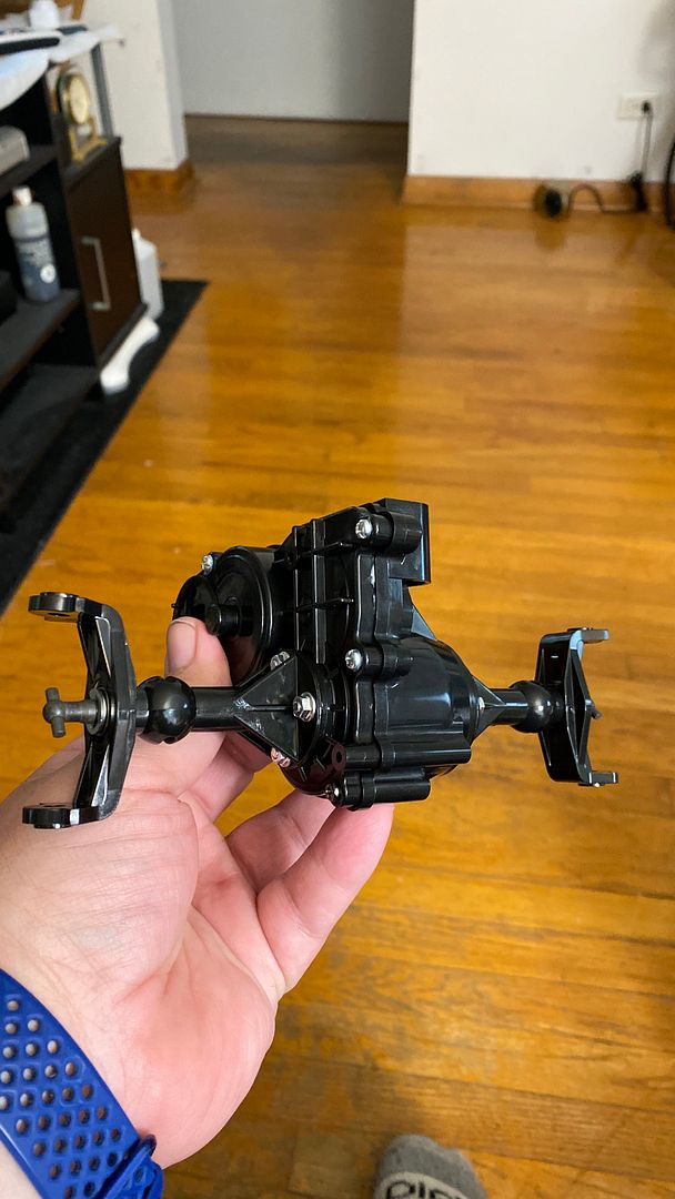

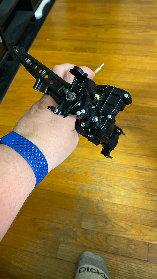

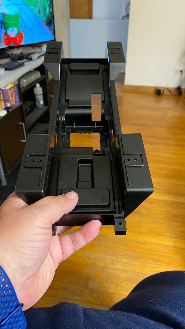

Joe Handley Posted May 29, 2020 Posted May 29, 2020 (edited) To start with, I’ve wanted a Clod Buster for decades now, ever since I saw my first one in ‘87, and had the chance to buy the current Super Clod Buster Black Edition a couple weeks back and started building it on Memorial Day, only mid to start with will be the full ball bearing kit, since bushings suck, plastic ones in particular? My little “workstation”, at the recliner. Aaaand on to the build! Here’s where I started, which is in the middle of the instructions, supposedly there is conversion to swap those nuts and screws out for 6/32 hardware, I’ll just buy the screws and a tap Myself..... And on through the rest of the build...: At this point, I was done for the night, axles completed and ready for install. Next night, I prepped the chassis for then mounted the axles. I then mounted the wheels and tires and fit the ABS plastic shell to see how it looked. also figured a couple other R/Cs to give a sense of scale might not hurt, the Clod and black Javelin bodied 4-Tec 2.0 Are “1/10 scale” while the little green Scout-looking rig is supposed to be 1/24, but scales out to be more Like it’s 1/20 like the Lindburg truck kits were. Started the body prep tonight, should be ready for primer, then hopefully paint, this weekend! Did a bit more beyond this too, just never took the pics tonight. Got everything for the paint but the clear and I’m planning on using spray bed liner In the bed too, so I’m not as worried about those sink marks in the rollbar stand offs. Edited May 29, 2020 by Joe Handley

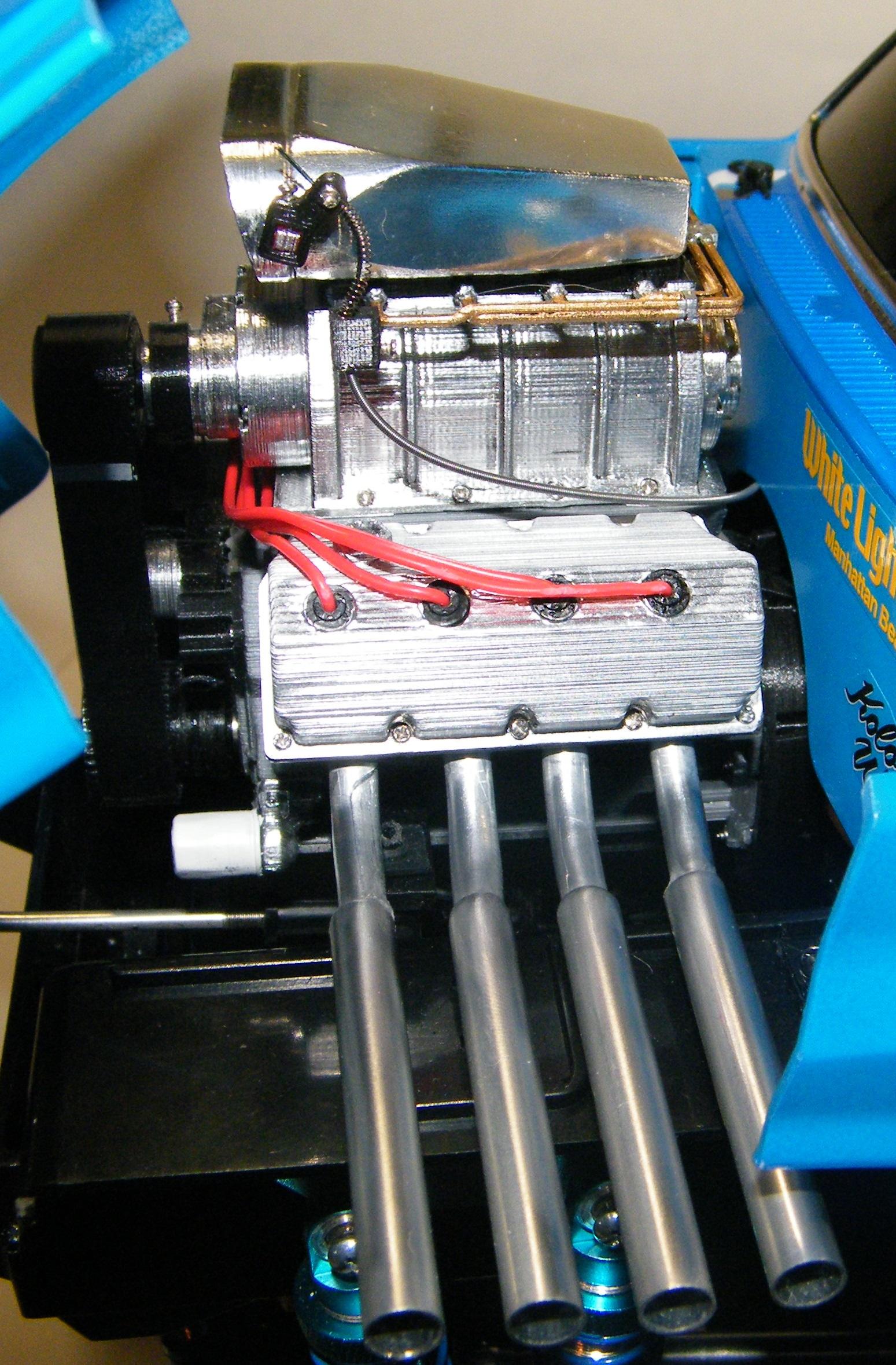

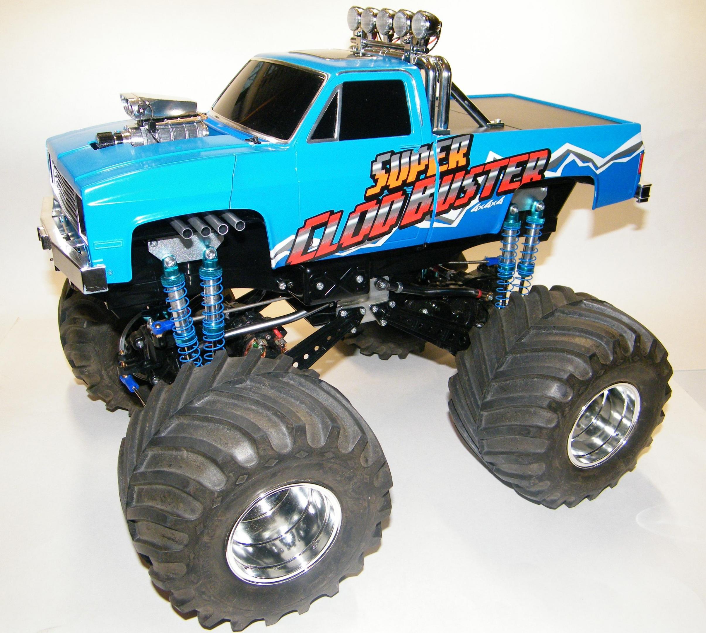

Wolfangel Posted December 5, 2020 Posted December 5, 2020 (edited) I like the classic look of the Clodbuster, so i modified mine to keep the somewhat original look. Here is mine i finished. I hope this will give ya some inspiration. Here is what is done.....bedcover, lift kit, scratch built lower shock mounts, tilt front end (stock body mounts moved to windshield cowl), working V8, scratch built headers, scratch built firewall, aluminum shocks, scratch built upper links (gets rid of the pieces below the original trailing arms). I also modified the graphics and cut out the "wolverine-ish" looking cartoon guy. And here is the link to the V8 motor................... https://www.darkdragonwing.com/products/1-10-rc-ohv-v8-h/ Edited December 5, 2020 by Wolfangel

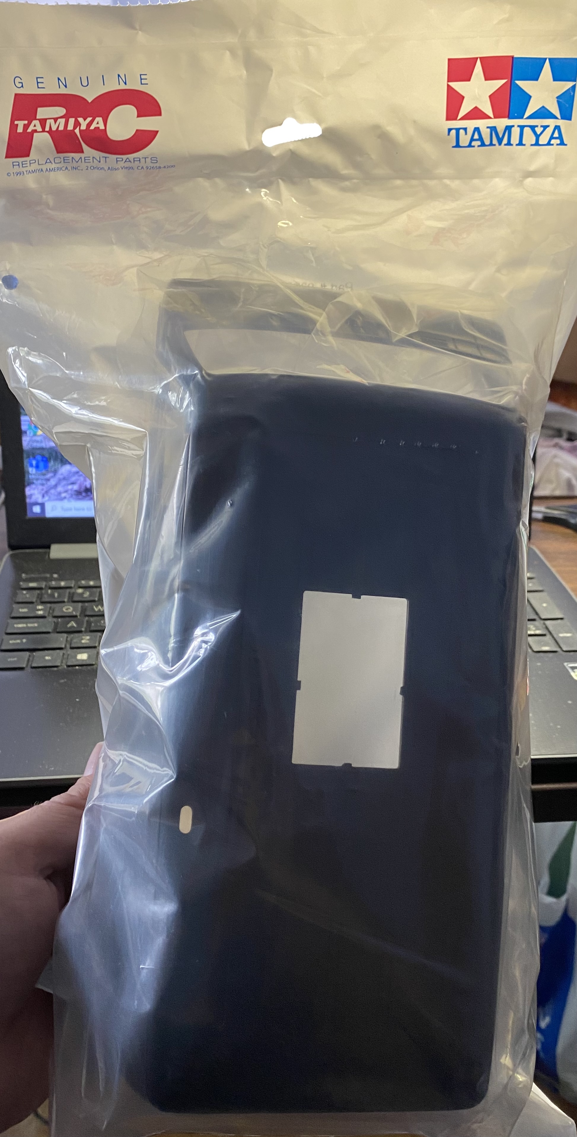

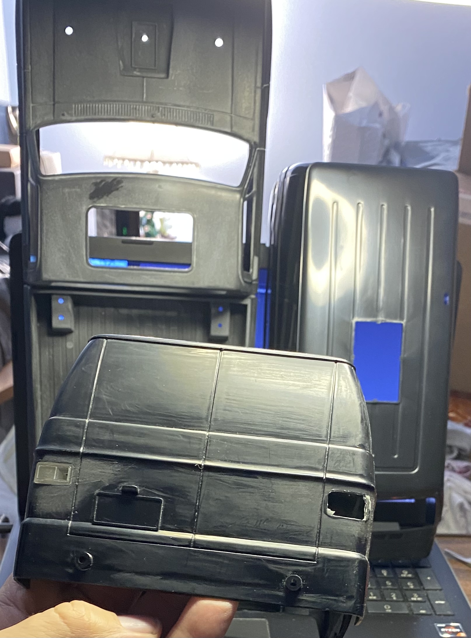

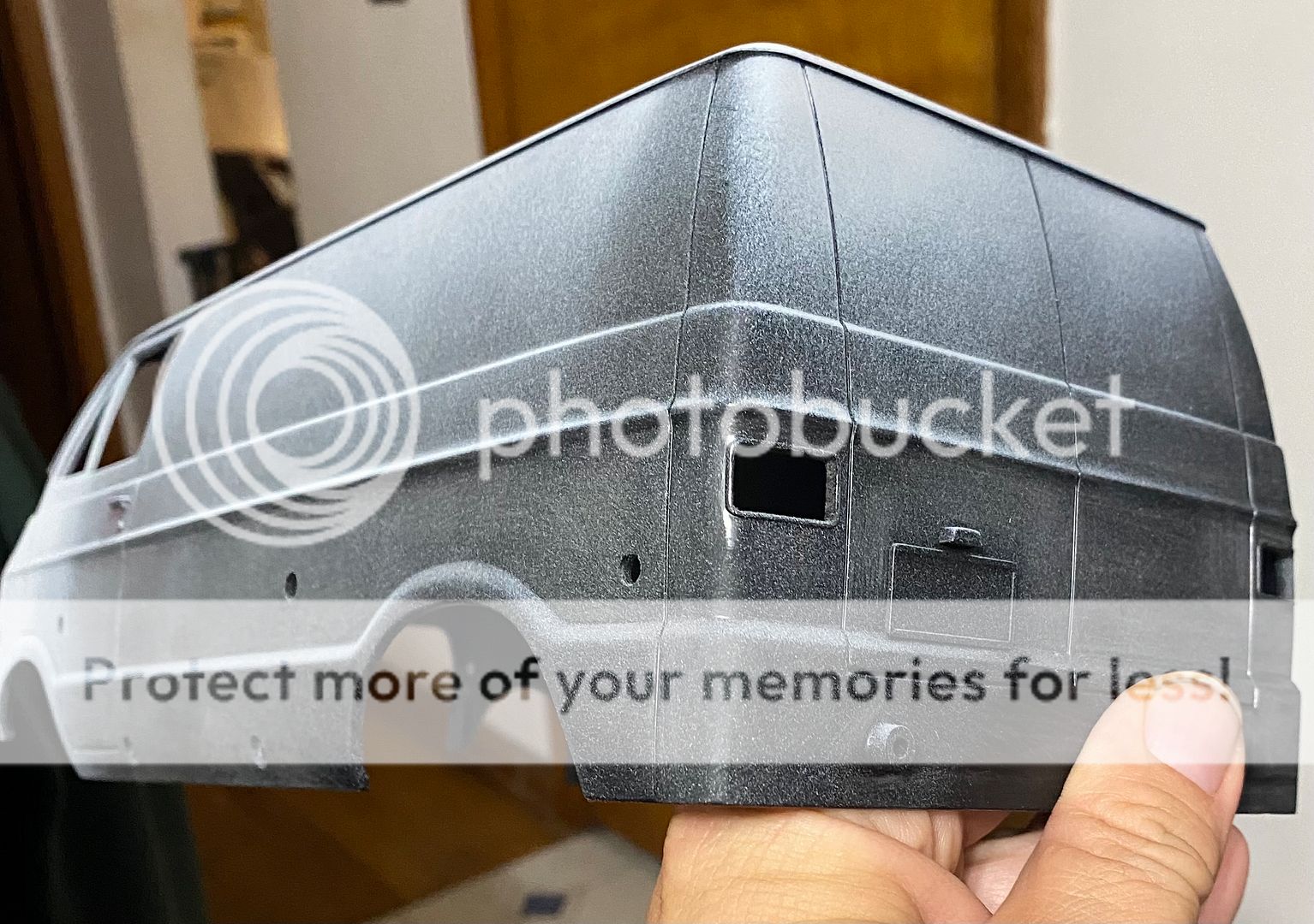

Joe Handley Posted June 29, 2021 Author Posted June 29, 2021 Picking back up in this now too! Both the Clod and Lunchbox need paint and never even got the Lb into primer, just did some minor bodywork to fill in the antenna holes on both and sink marks on the van’s hood. Problem is, I boogered up the right rear corner in opening it for the AMPro 3D printed taillights. What I’m going to do here is redo the mods on the kit body in a replacement Black Edition body, plus cut up the kit body to fill the roof vent hole on the new van body AND the sunroof in the Clod body!

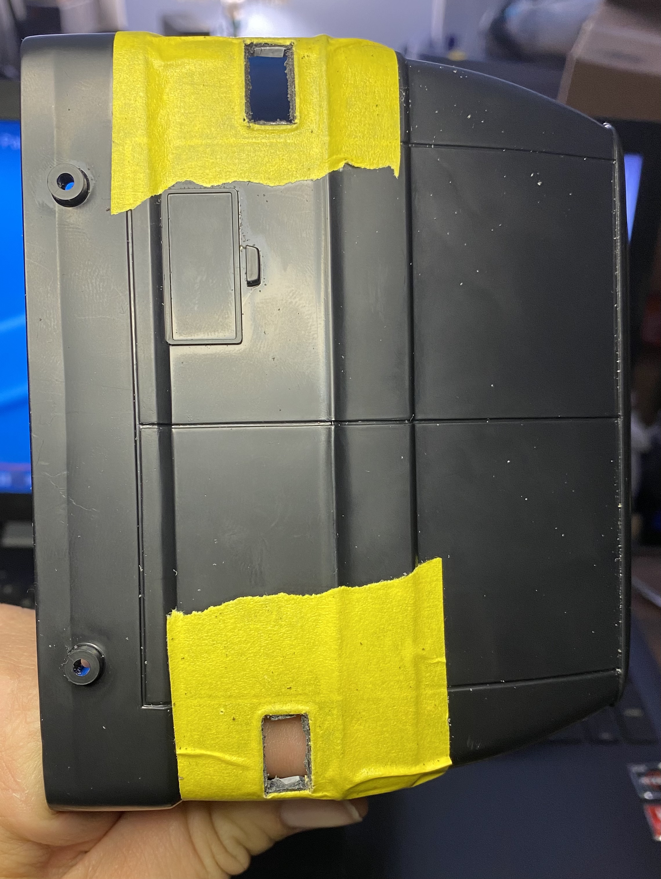

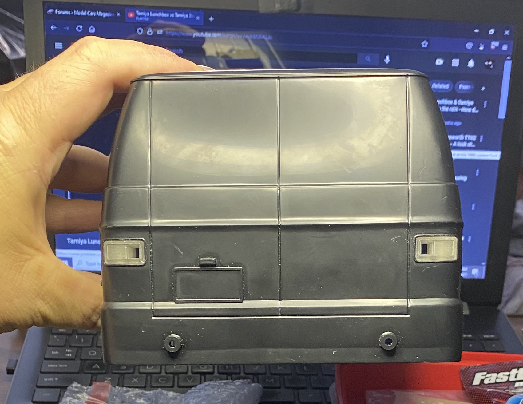

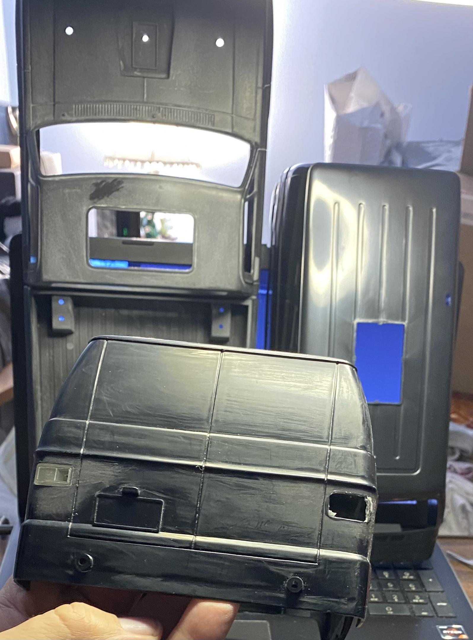

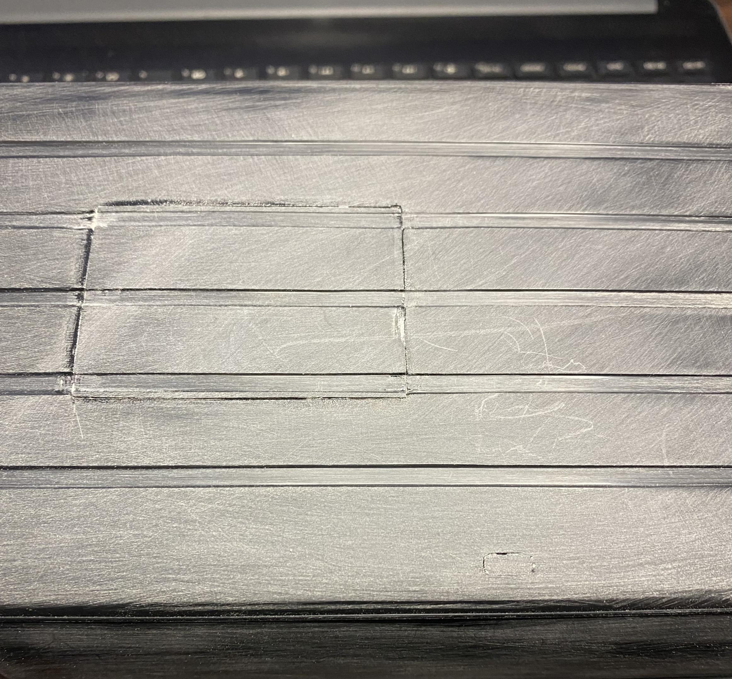

Joe Handley Posted June 29, 2021 Author Posted June 29, 2021 Ok, couple pics from tonight, got the tail lights cut out and the openings filed so that the printed ones will fit, the holes for the side marker lights have been drilled and have the molded on lights cleaned off, I then scuffed the whole body too! Just need to try and install the panel I cut from the kit body to fill in the hole in the roof and the antenna hole. I also fine that there is a slight curve to the upper panels that make using those to fill the Clod’s sunroof hole, not worth while.

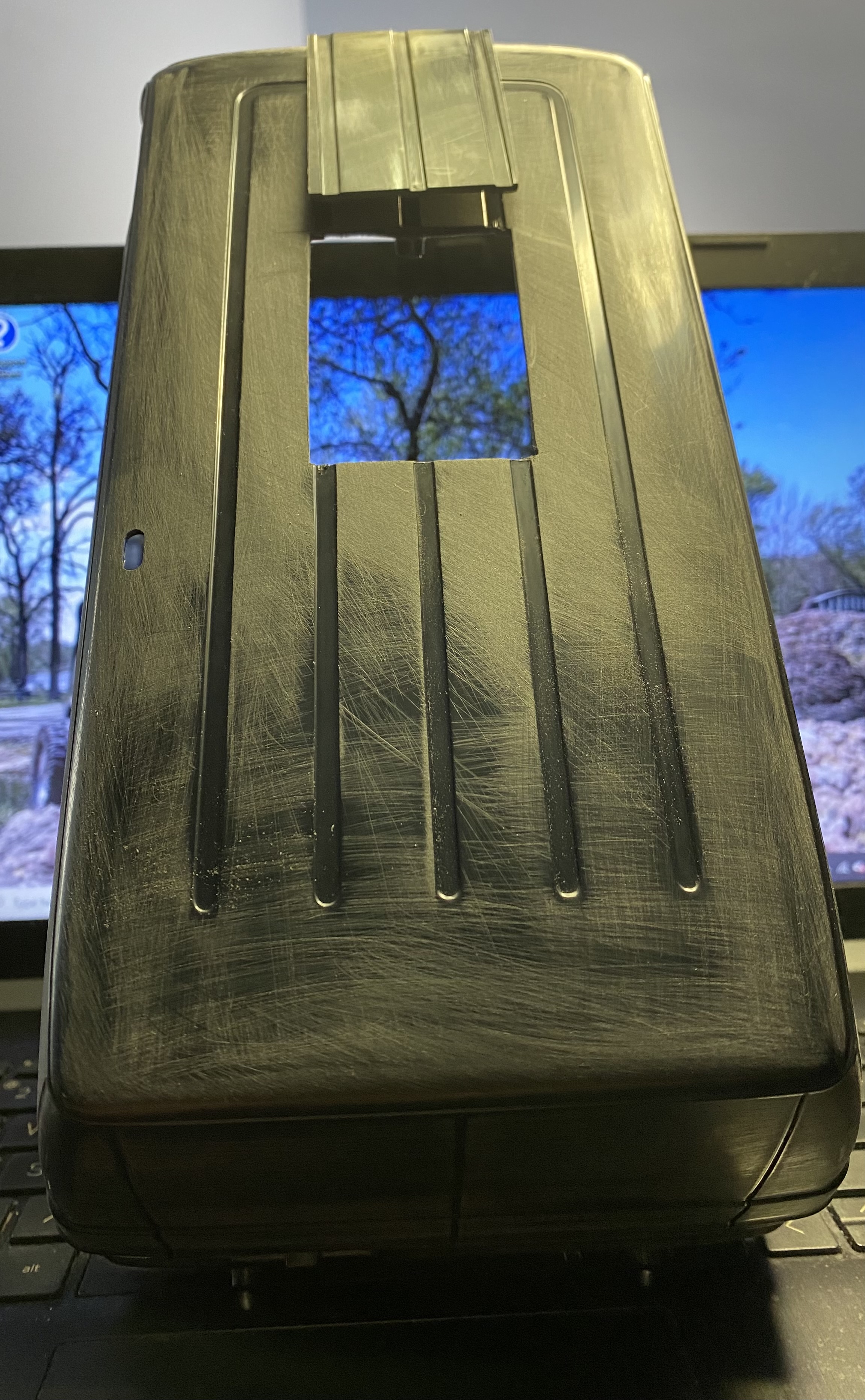

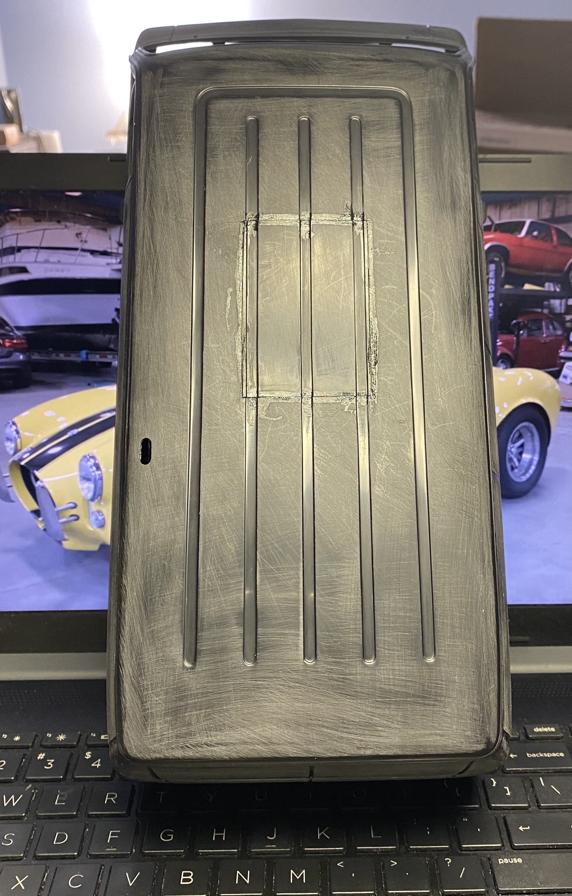

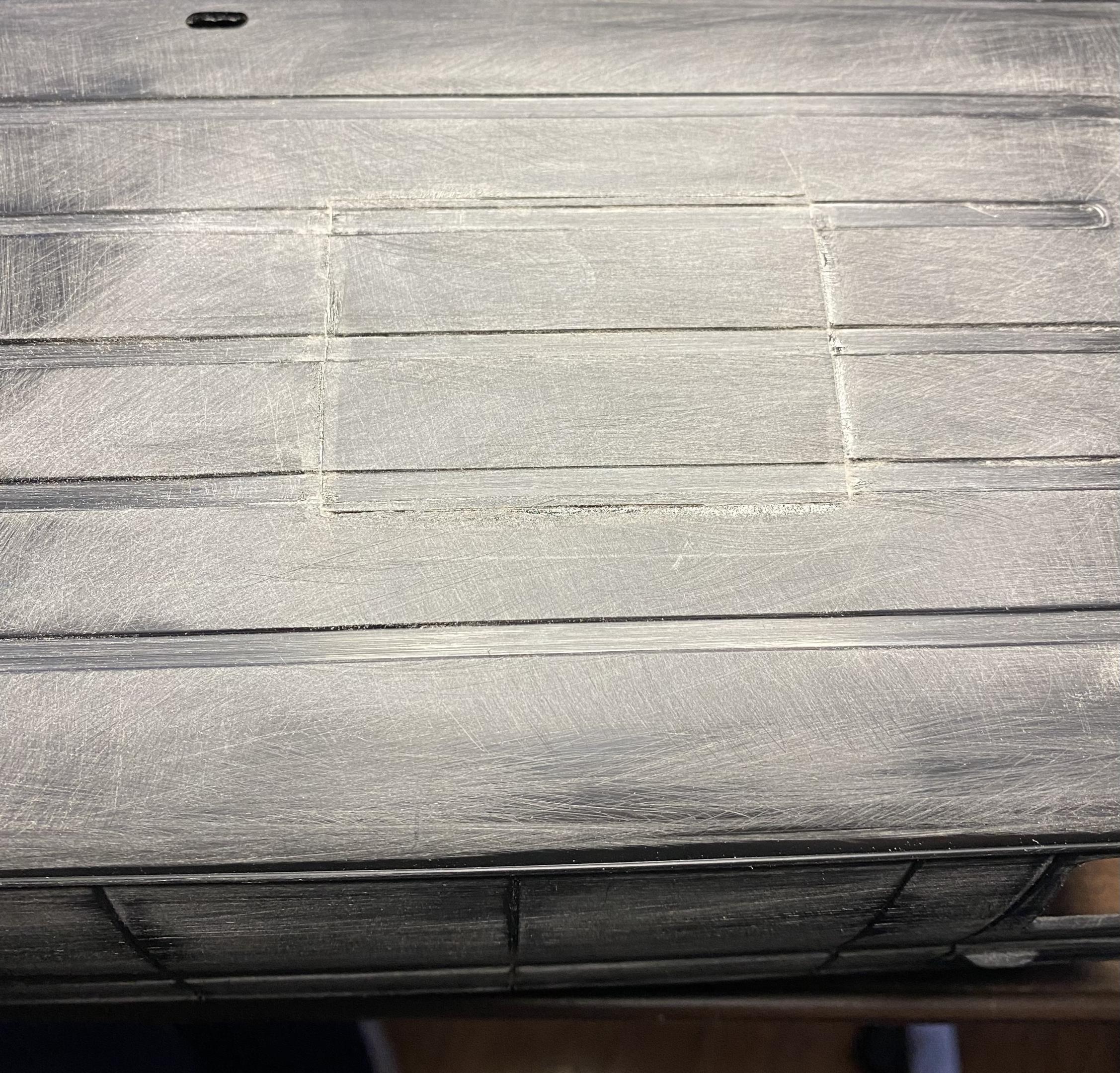

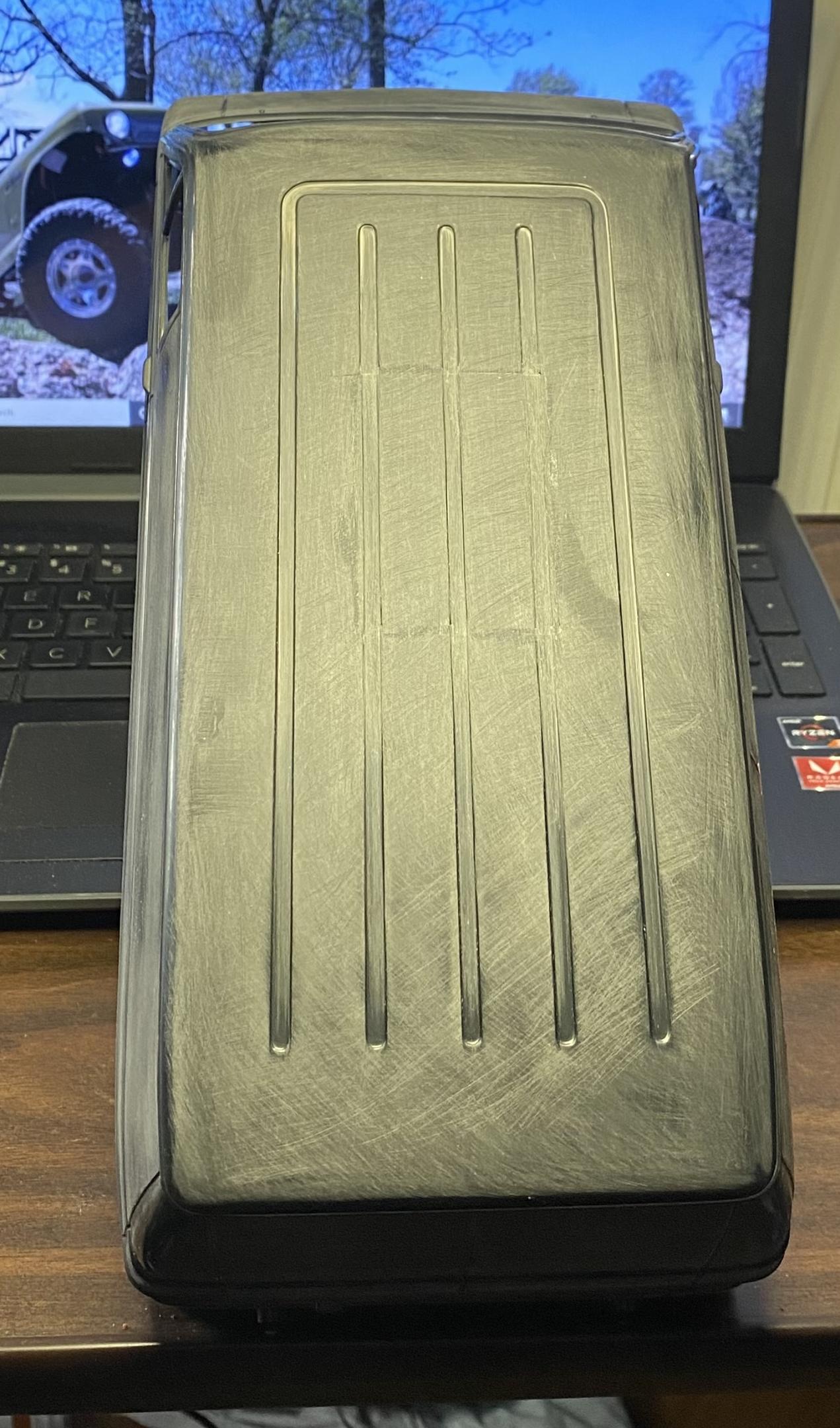

Joe Handley Posted June 29, 2021 Author Posted June 29, 2021 I’ll finish fitting it later, but I have the patch panel cut out the old body and the hole in the new body opened up a bit larger than it was, just need to sand the two to match and cement them together! Found I still have some Plastruct Plastic Weld that will get used for that purpose, same when I go to fill the antenna hole too.

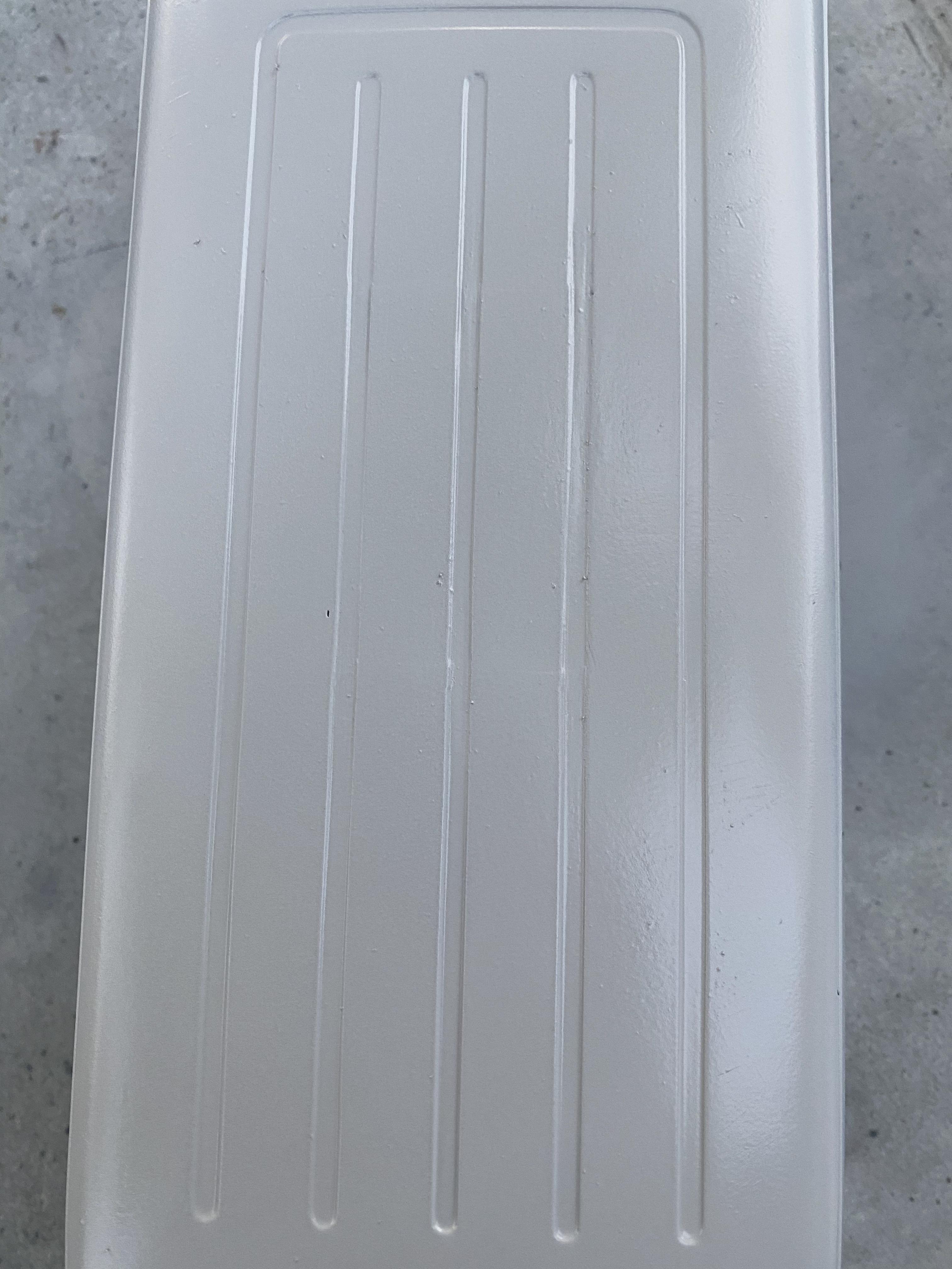

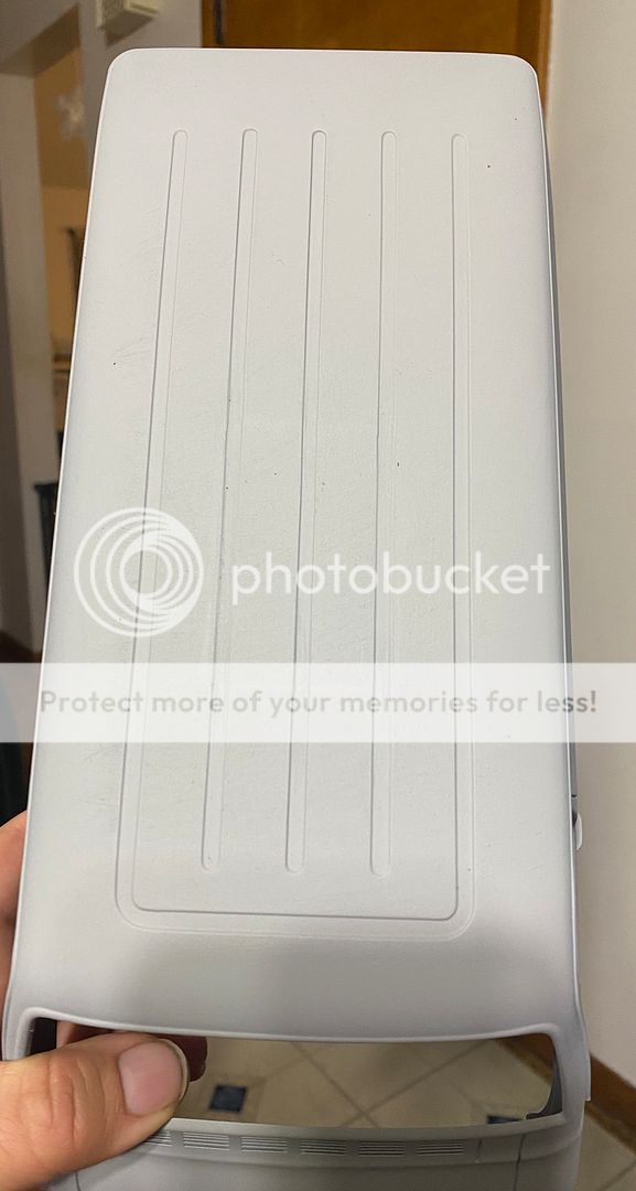

Joe Handley Posted June 30, 2021 Author Posted June 30, 2021 Filled in the roof vent and antenna holes, have them held in place with Plastic Weld for now be will put in some Bob Smith Foam Safe CA in the gaps for added bonding. Once that is good and solid, I’ll probably do some filling with Bondic then do the final filler with some 2 part “icing” type automotive filler.
Joe Handley Posted June 30, 2021 Author Posted June 30, 2021 Ok, the body work is done, not sure if I’m going to do any body filler or just go straight to some Duplicolor Filler Primer then do any corrections and filling from there after sanding it. I did not expect it to come out that good?

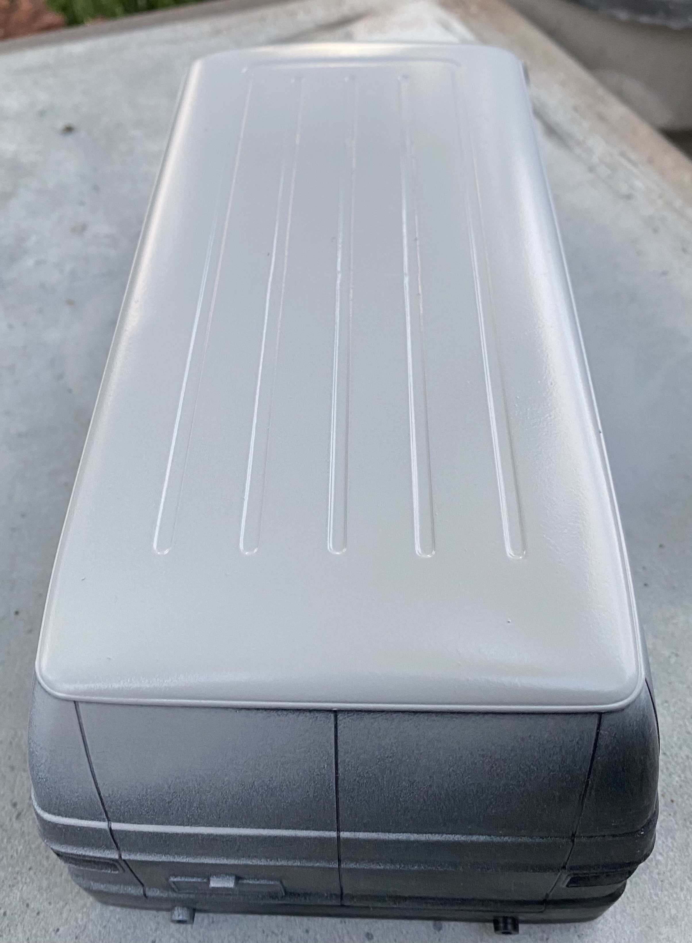

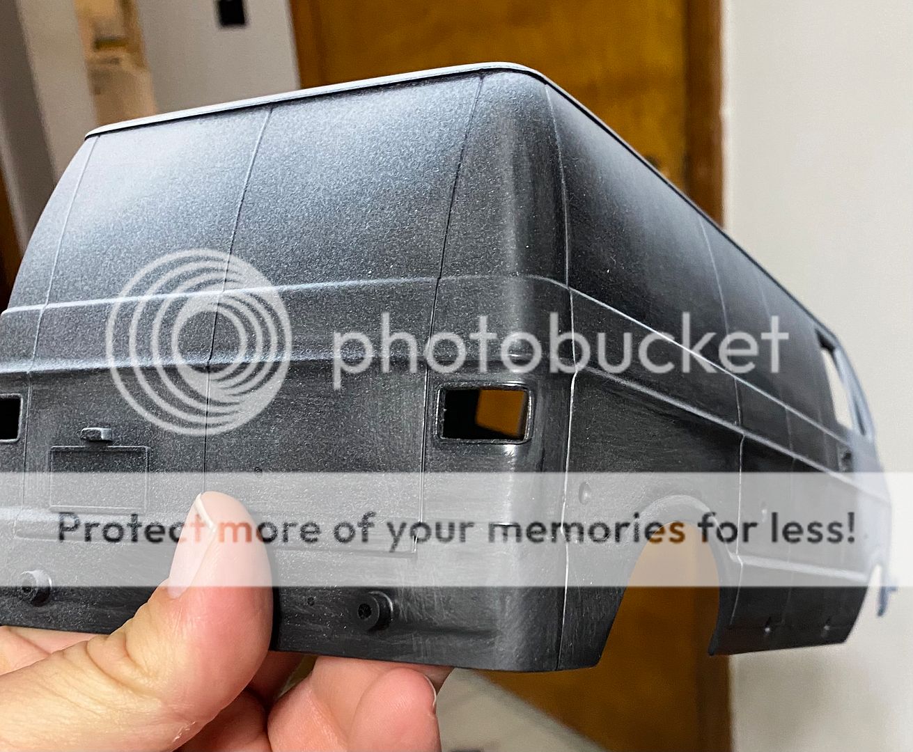

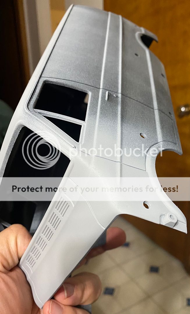

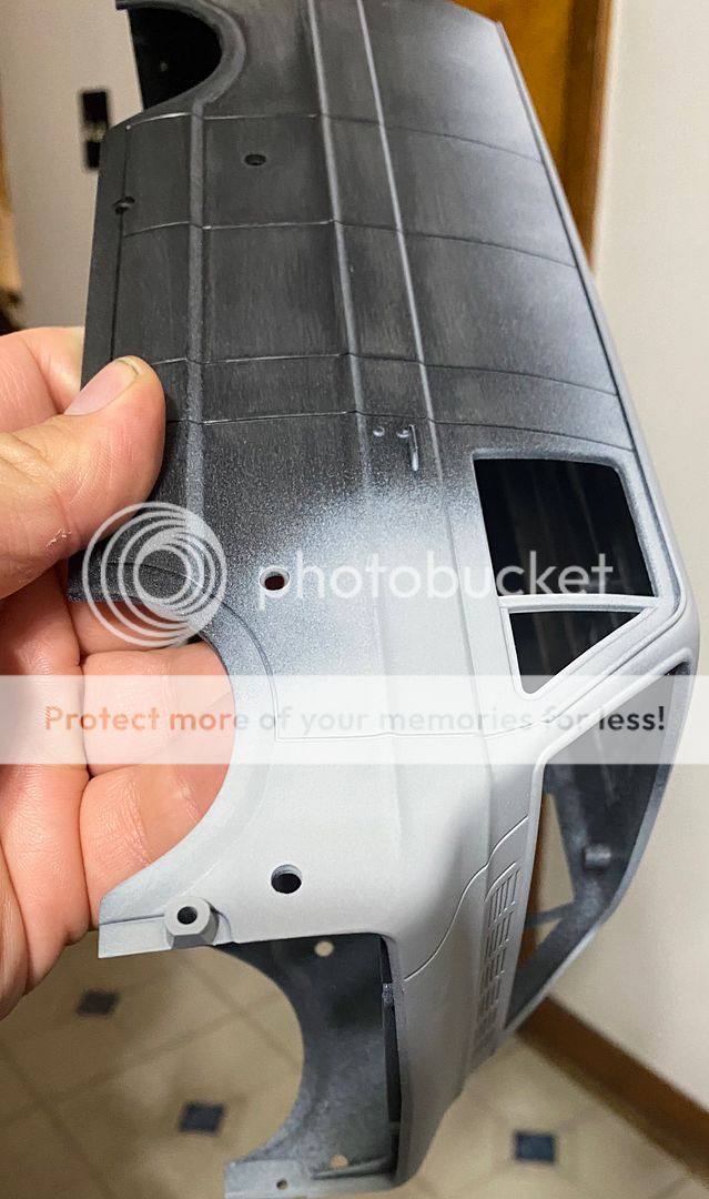

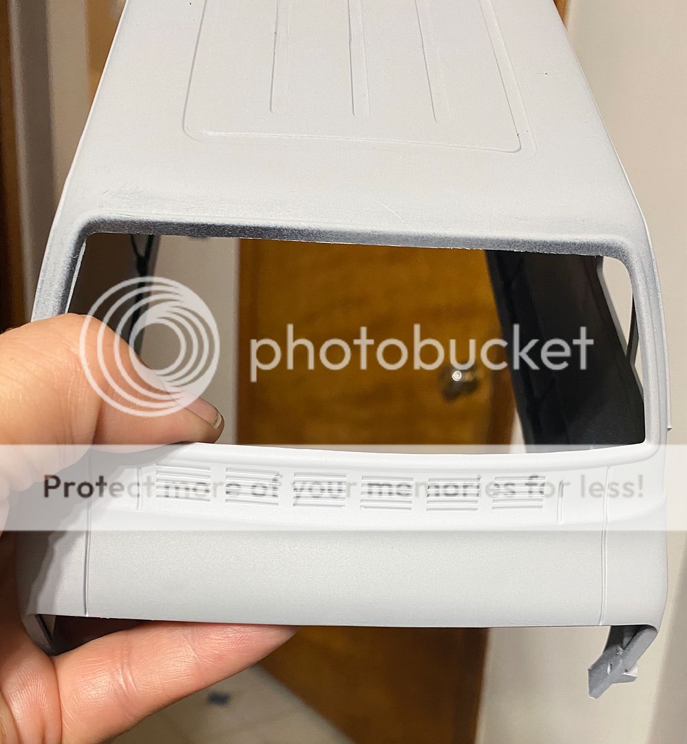

Joe Handley Posted July 1, 2021 Author Posted July 1, 2021 Alright, shot the primer on the roof, hood, and fenders tonight, looks like minimal work will be needed on the roof!

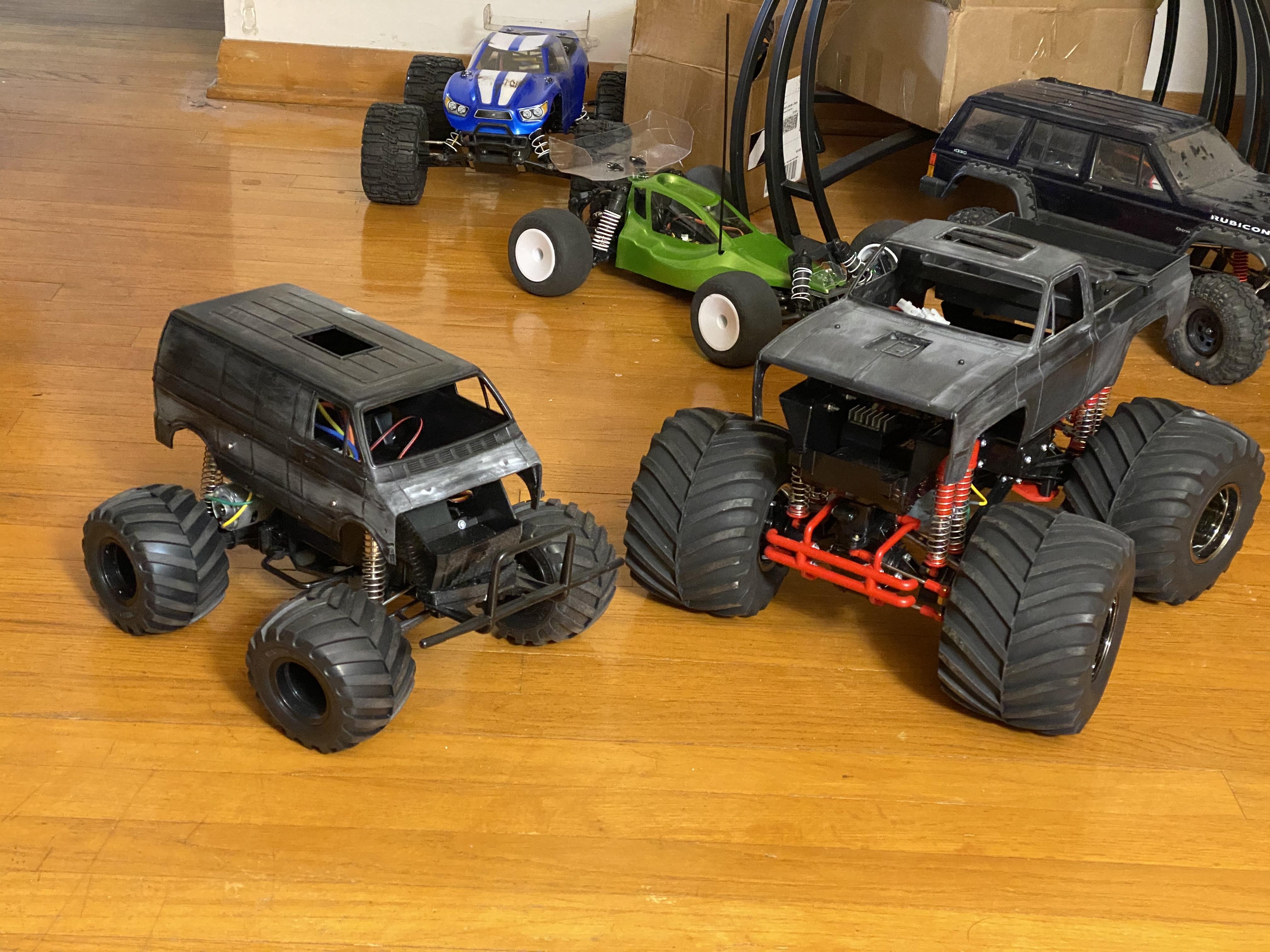

Joe Handley Posted July 1, 2021 Author Posted July 1, 2021 Ok, brought the body inside, looks like there will be some minor tweaking needed with the roof insert and then need to wet sand the areas that still had imperfections from where I cleaned up the mold lines, plus they show where I had to mod this body for the AMPro Lenses too.

Joe Handley Posted July 1, 2021 Author Posted July 1, 2021 1 hour ago, David G. said: Those are a couple of fantastic RC vehicles. Looks like a lot of fun there. What scale is the Clodbuster? I have a couple of old Traxxas Nitro Rustlers that I should rehab and fire up. David G. Thanks David! The Clod is 1/10 while the Lunchbox is 1/12 and both have been around, off and on, since the late 80’s.

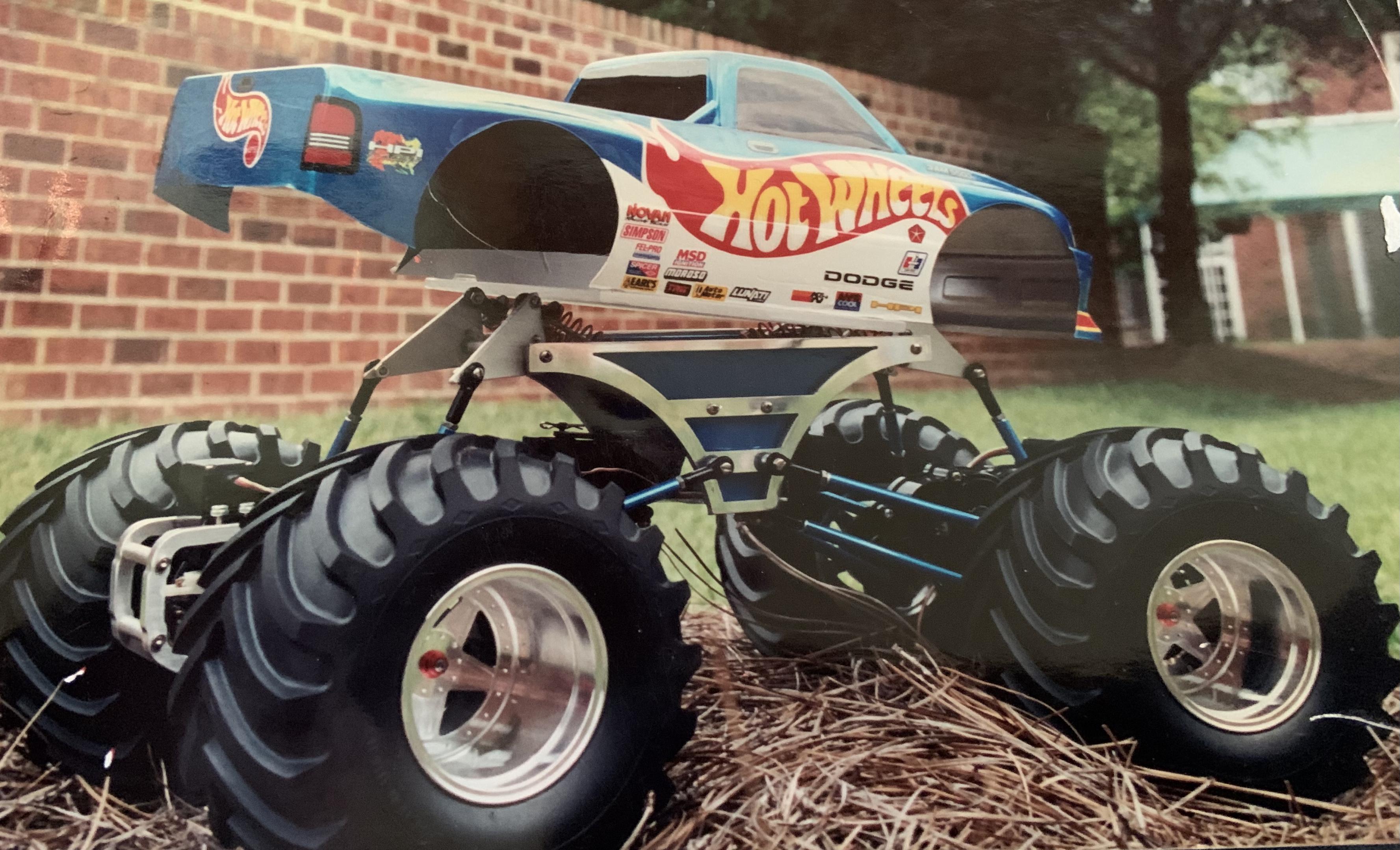

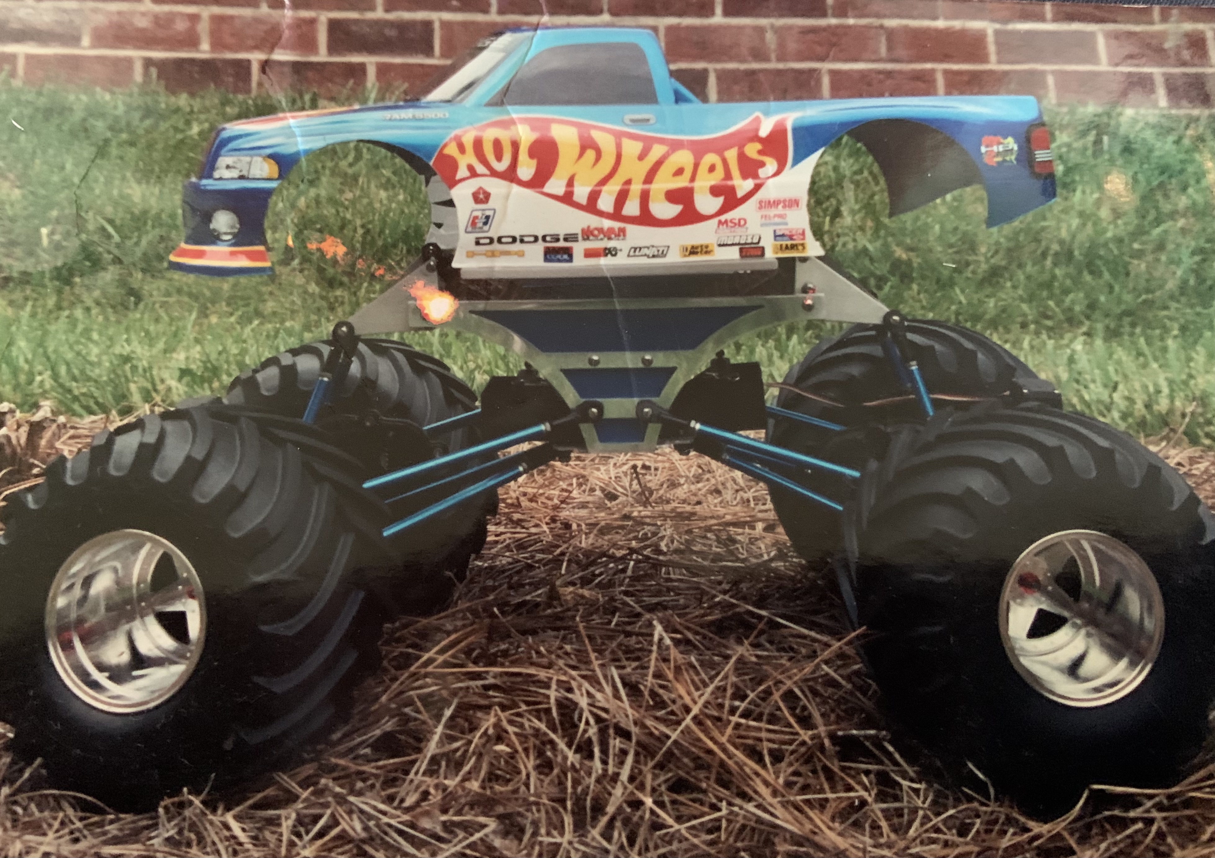

Fantom Posted July 4, 2021 Posted July 4, 2021 Be careful…those can be addictive…I started out with a stock Clod and ended with this 2 years later. 1

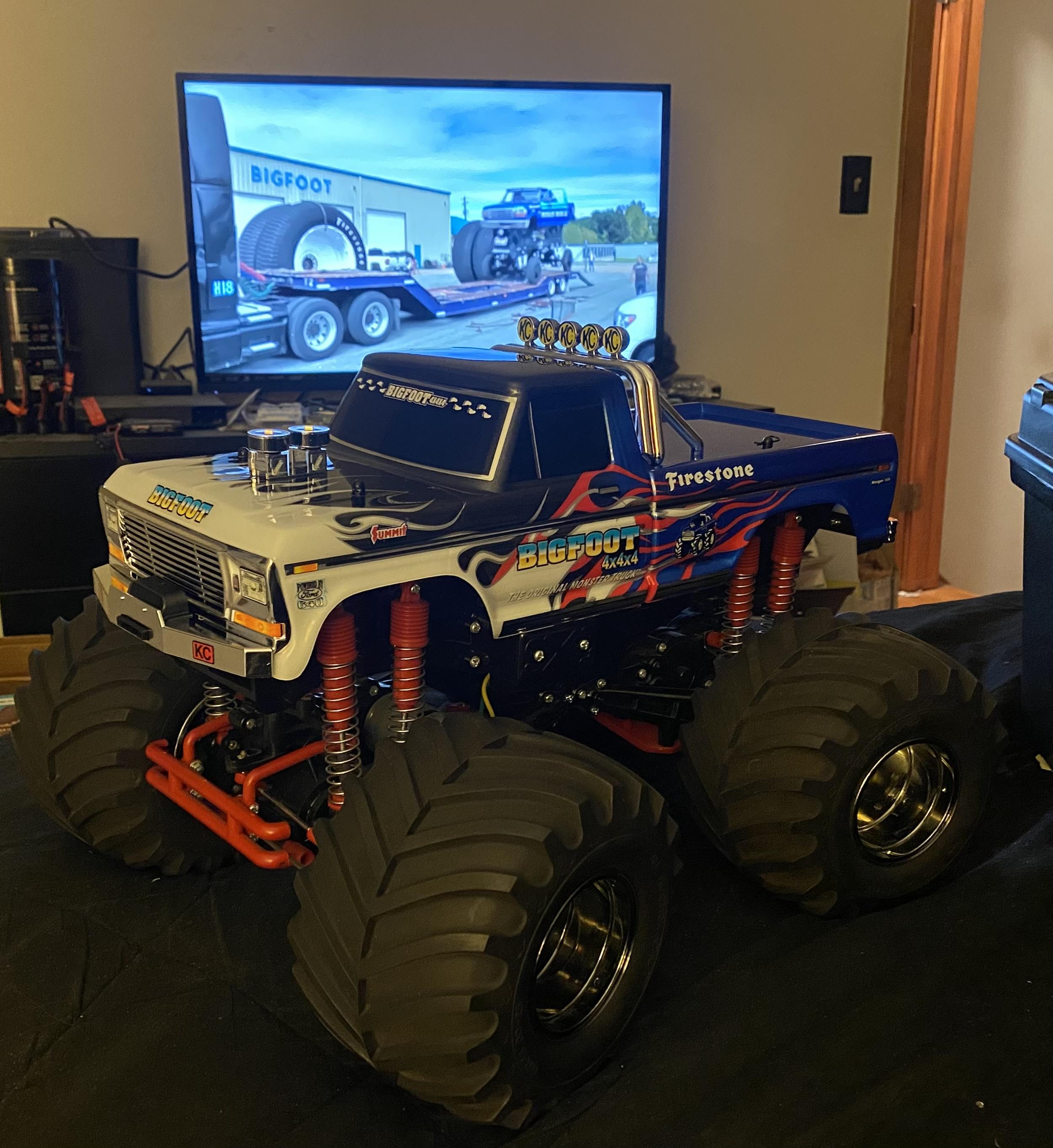

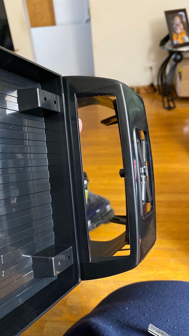

Joe Handley Posted Wednesday at 08:42 PM Author Posted Wednesday at 08:42 PM He issues with the primer on that ClodBuster and the whole build had been shelved until this week. A friend who advised me of that ClodBuster kit being on sale when I bought it sent a message a text of his ClodBuster with a JConcepts Regulator chassis and Clod sized wheels and tires with a prefinished Traxxas Bigfoot 1 body meant for the 2wd Stampede in all blue. Saw that and decided to do the same. Problem is though is that the Black Edition came with red suspension parts and bumpers instead of blue like the normal Super ClodBuster. Discovered that Traxxas also offered a version of that that was also prefinished with white, black, and red flames. Decided to get that since it would go better with my Clod and picked up the body Sunday and some posts yesterday to make it work. Here’s the result as of 12:30am this morning😁 There will be other things done to it like servos on each axle so they steer independently of each other, the same rolling stock my friend’s Clod has, as well as the Traxxas Big Bore hard anodized aluminum shocks meant for their 2wd trucks.
