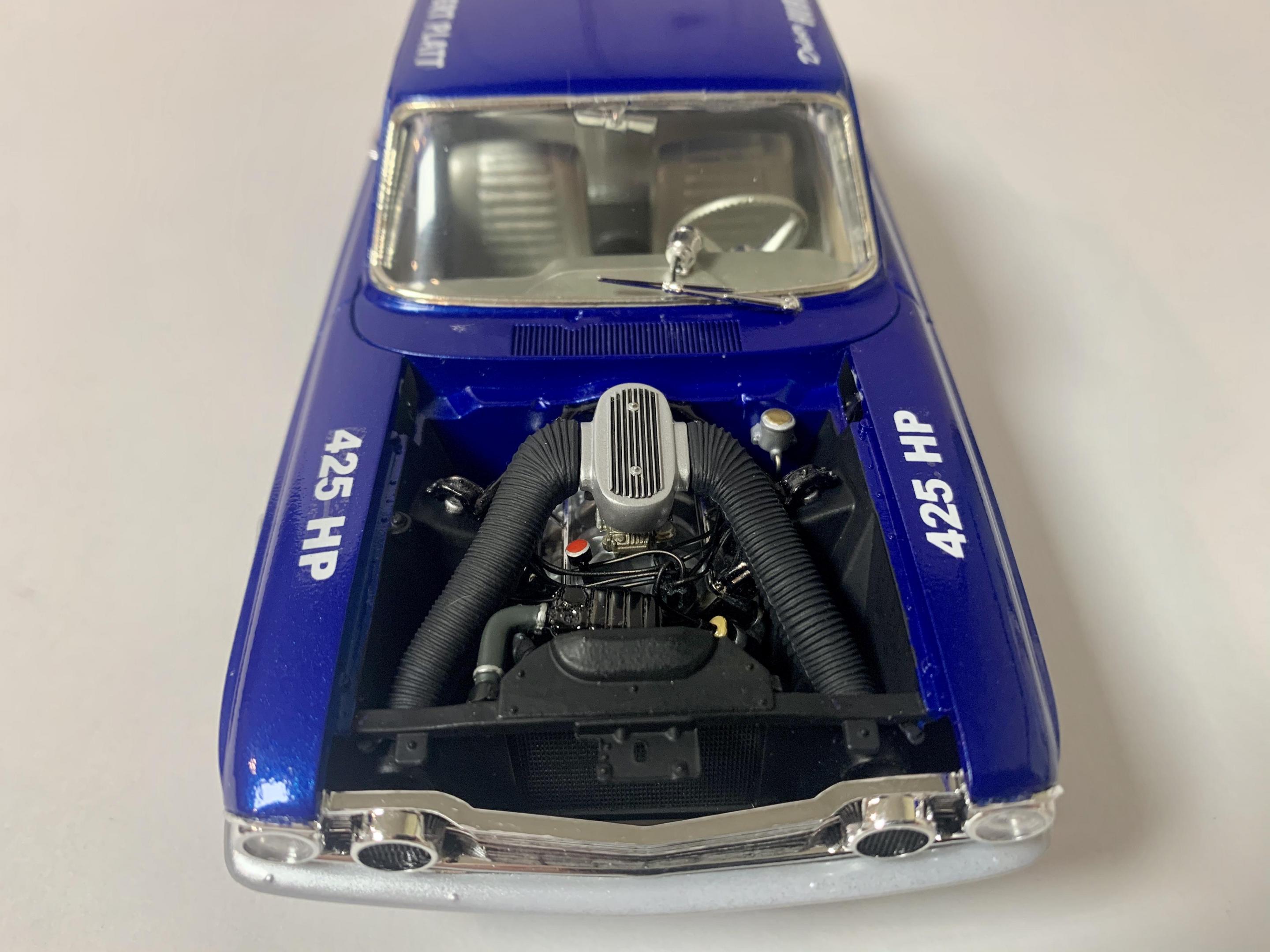

Brutalform Posted June 9, 2020 Posted June 9, 2020 I’ve switched to Vallejo paints and I don’t even look at the Tamiya acrylics anymore, for brushing. I have both the “air” and their regular acrylics. The air is a time saver, as you won’t have to mix it with any water, as you would with their thicker non air bottles. The Vallejo Air Black is a perfect semi gloss, right out of the bottle. The under hood of this Ford is brush painted with it. No brush strokes whatsoever. Might need to do a second coat, but it also cleans up with water if you make a mistake.
Goodwrench3 Posted June 9, 2020 Author Posted June 9, 2020 3 minutes ago, Brutalform said: I’ve switched to Vallejo paints and I don’t even look at the Tamiya acrylics anymore, for brushing. I have both the “air” and their regular acrylics. The air is a time saver, as you won’t have to mix it with any water, as you would with their thicker non air bottles. The Vallejo Air Black is a perfect semi gloss, right out of the bottle. The under hood of this Ford is brush painted with it. No brush strokes whatsoever. Might need to do a second coat, but it also cleans up with water if you make a mistake. Super -- good info ! Are you brushing it on bare plastic ? Or are you using their brush primer first ? I had assumed that the Vallejo Model Color acrylics were ready to brush right out of the bottle -- thanks for that info about needing to thin them ! Typically how much are you thinning them for brushing ? Thanks again !
Brutalform Posted June 9, 2020 Posted June 9, 2020 Thanks. It was brushed on over the blue paint that the car was painted. I never tried it on bare plastic. I’m sure primer or paint would be better than bare plastic. I never mixed water with ANY of the “air” paints. If you use the regular Vallejo paints, a mix of 50/50 makes it too thin IMO. You’d really have to experiment to your liking. That’s why I use the Air paints exclusively.
