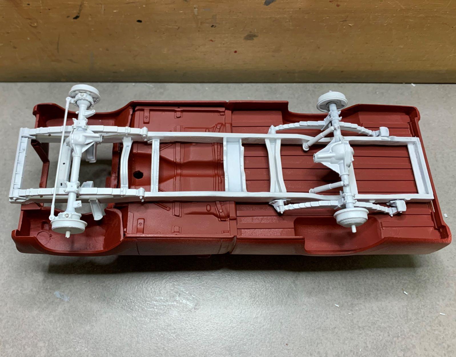

dino246gt Posted June 25, 2020 Author Share Posted June 25, 2020 1: I needed to lengthen the rear of the frame so I glued 2 pieces of styrene together to the thickness of the frame and drilled and pinned extensions. 2: I made the very rear from 2 different sizes but now I have the length I need for this old pickup. 3: I made the cab floor from a '60 Starliner kit, it had to fit the original interior, after I cut that floor out, and the new frame. 4: I added some ribs, opposite of the topside, and positioned them so the frame fits right in. Quote Link to comment Share on other sites More sharing options...
dino246gt Posted June 25, 2020 Author Share Posted June 25, 2020 (edited) So here's how that frame fits the underside now in white primer: Edited June 25, 2020 by dino246gt Quote Link to comment Share on other sites More sharing options...
