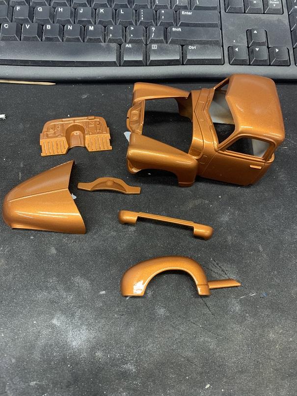

jdhog Posted June 16, 2020 Posted June 16, 2020 (edited) I'm building the AMT 1950 Chevy pickup. I decided that I could get a better paint job by painting all the body pieces (especially the bed and fender) prior to assembly. I've had problems in the past getting good coverage in nooks and crannies around fenders on old truck models. Everything is painted and the clear is curing. Now I am wondering what is the safest way to assemble the pieces. I'm afraid scraping and using Plastruct will be a disaster. I'm thinking about assembling carefully with white glue. What's everyone's opinion on this? Here's a pic of some of the parts. I'm proud of the way the paint came out. ? Edited June 16, 2020 by jdhog Typo
gman Posted June 16, 2020 Posted June 16, 2020 The paint looks great. I am afraid white glue won't hold parts together securely. For adhesive, you have lots of options- where you have joints that won't show, 5 minute epoxy (where you need a little time to get things into position before setting) is a good choice. You can use a drop of super glue in some locations, with the understanding that large amounts will fog paint and windows. Zap A Gap CA + or CA ++ works particularly well, and is thick enough not to run into places you don't want it to go. For some parts, small amounts of liquid cement will work- consider something like a Touch N Flow applicator on the back of your joints (where accessible) to avoid getting more glue than you bargained for onto your parts. I like Tenax 7R for a fast setting glue.
jdhog Posted June 16, 2020 Author Posted June 16, 2020 9 minutes ago, gman said: The paint looks great. I am afraid white glue won't hold parts together securely. For adhesive, you have lots of options- where you have joints that won't show, 5 minute epoxy (where you need a little time to get things into position before setting) is a good choice. You can use a drop of super glue in some locations, with the understanding that large amounts will fog paint and windows. Zap A Gap CA + or CA ++ works particularly well, and is thick enough not to run into places you don't want it to go. For some parts, small amounts of liquid cement will work- consider something like a Touch N Flow applicator on the back of your joints (where accessible) to avoid getting more glue than you bargained for onto your parts. I like Tenax 7R for a fast setting glue. Great info. Thank you very much. I have some epoxy.
