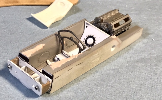

absmiami Posted May 29, 2024 Author Posted May 29, 2024 On 7/14/2021 at 2:00 PM, absmiami said: Back fr vacation and back to work - corrections to the bulkhead and some added detail - I’ve added short pegs so the I can get a reliable bond to the monocoque - which also needs some corrections … Back on pg 7 i posted these pix of the nearly completed chassis for the Lotus Indy 29 …. In case you were wondering what ever happened to this …

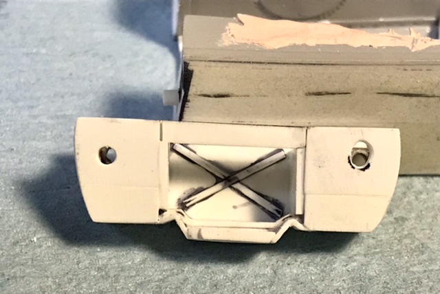

absmiami Posted May 29, 2024 Author Posted May 29, 2024 Norman Veber / Replicas and Miniatures of Maryland agreed to cast the chassis master along with footbox - here’s the pink rubber two part mold …
absmiami Posted May 29, 2024 Author Posted May 29, 2024 And here are the resin castings … before the hobby is over-taken by 3D design and printing - and thats not necessarily a bad thing …. Its nice to be able to resin cast parts here and there - and Norman - another member of the resin caster’s “hall of fame” - cast these up for me - i’ll now shape the bottom of the casting to the rounded profile of the monocoque - and get back to work completing the Gurney Lotus 29 in 24th scale

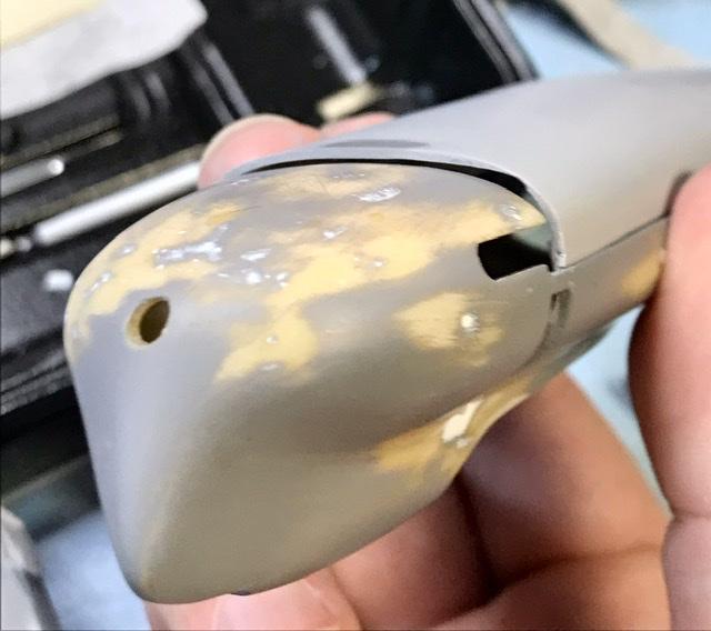

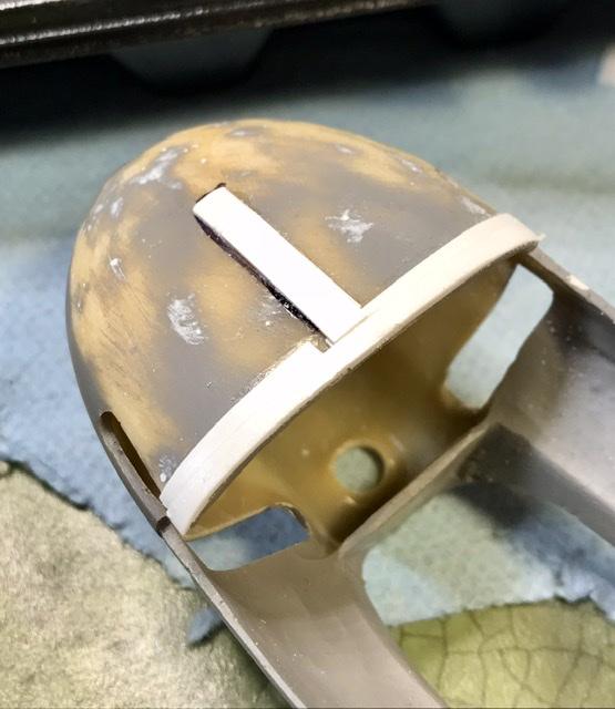

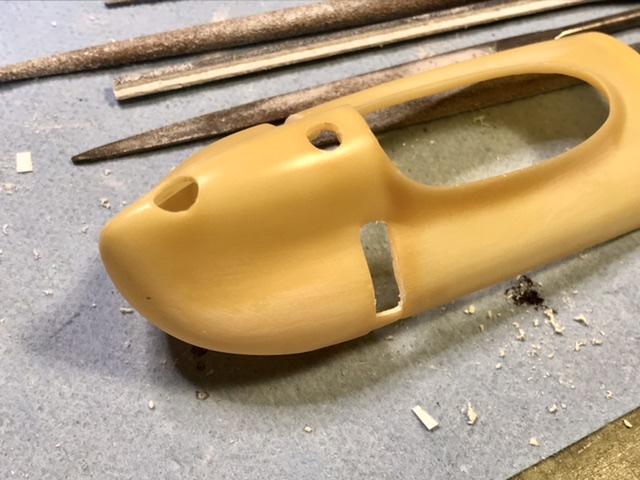

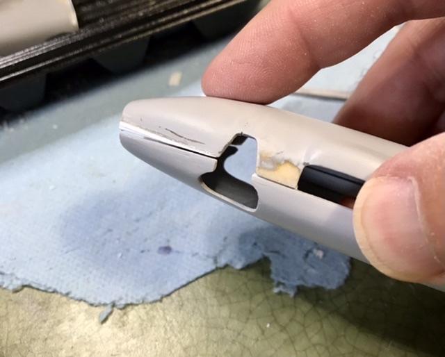

absmiami Posted May 31, 2024 Author Posted May 31, 2024 Having another Lotus 16 moment . As a general rule - you shouldn’t drop stuff onto the shop floor- right? Well the nose casting on the Scalekraft body is eggshell thin , so …

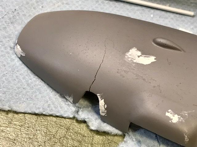

absmiami Posted June 1, 2024 Author Posted June 1, 2024 The repair reqired adding a layer of marterial to the underside - I’m using a nylon clothing patch - with a layer of CA brushed abobe and below - sort of like a layer of finerglass …
absmiami Posted June 1, 2024 Author Posted June 1, 2024 A crack still lurks - some more CA and a quiet prayer to the model Gods -
absmiami Posted June 1, 2024 Author Posted June 1, 2024 Its just gonna be fragile - i could test it by dropping it again - Nah …

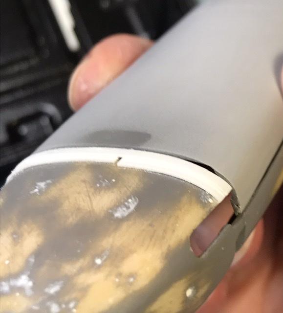

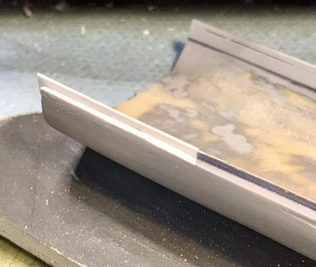

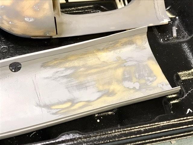

absmiami Posted June 1, 2024 Author Posted June 1, 2024 More changes are needed to align the bottom lip of the tail with undertray …
absmiami Posted June 1, 2024 Author Posted June 1, 2024 That’s done with two .015 Evergreen strips across and a middle guide strip for some putty to acheive the correct profile -

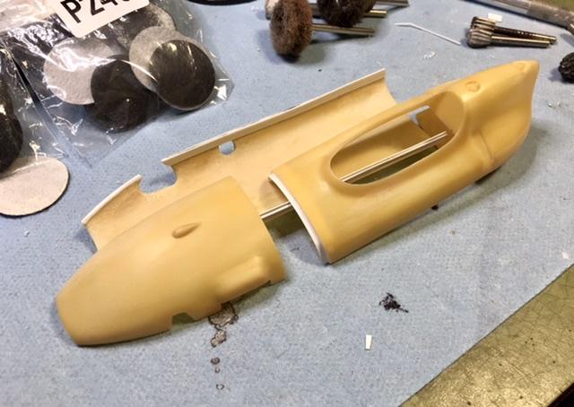

absmiami Posted June 1, 2024 Author Posted June 1, 2024 And i sanded the undertray surface with these disc sanders to get a smoother finish …
iBorg Posted June 1, 2024 Posted June 1, 2024 Great work.....nice to see someone tackle the old resin. I saw the sanding discs. Can you share your source?
Straightliner59 Posted June 1, 2024 Posted June 1, 2024 Nice save, Andy! I'm sure it's just how you'd fix a real one. I would be interested in the source of the sanding equipment, as well.
absmiami Posted June 3, 2024 Author Posted June 3, 2024 The sanding discs come in a range fr course to very fine - got them on - i think - Amazon - Chinese - not expensive- very handy … 1

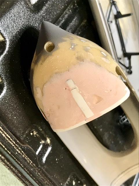

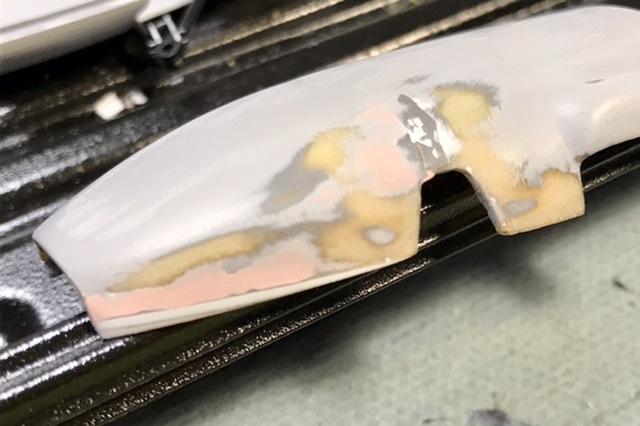

absmiami Posted June 3, 2024 Author Posted June 3, 2024 More changes and corrections - getting closer to what i need - but more to be done …
