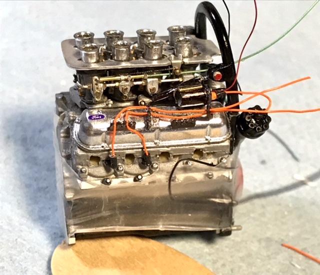

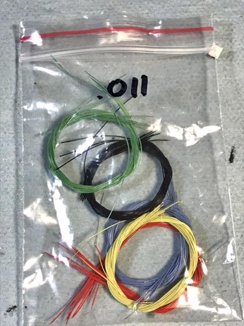

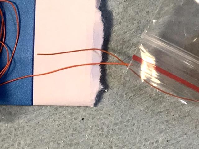

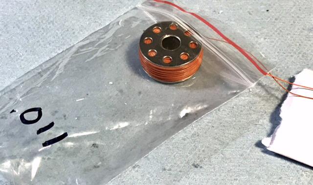

Belly tanker Jim has sourced an ebay store site for wire - very nice - it measured to .011 - the first picture shows that it is slightly smaller dia than the Detail Master plug wire that we all like ….   I’ll use the detail master orange wire for the 29 - but I’m using the lizard green eBay wire for the throttle wire - thanks Jim …

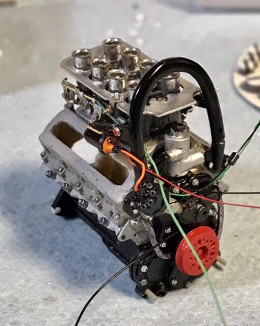

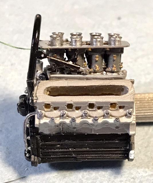

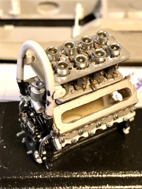

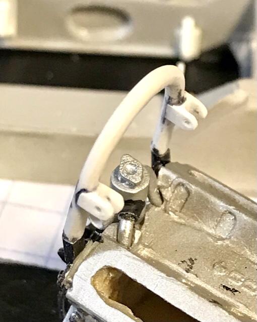

and made some brace clips for the roll bar - to be painted black …

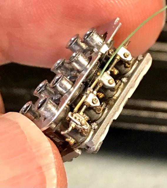

The throttle wire and return spring attach to the last segment of the throttle link - at the back of the carbs ….  Used the .011 green line for the throttle wire - glued to a section of .018 tube - the return spring is stretched from a MFH  accessory spring package with a length of .006 brass wire running thu the spring and used to attach the spring to the tray and the last carb link  - close as I can get to scale parts ….

Has anyone ever seen an off centered ignition coil ?  Here’s one - as used on the Lotus 29 …. Wonder why ?  The nipple on the Pro Tech part was razor sawed off and re- glued  …. The coil is strapped to the roll bar brace that I will make next. …

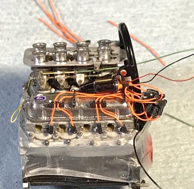

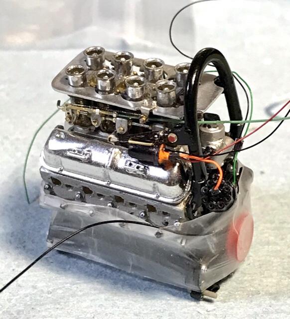

Painting anD adding some of the electrical wiring ….  The valve covers were razor sawed off of the block casting - then added the brackets for the plug looms and then painted Alcad Chrome …

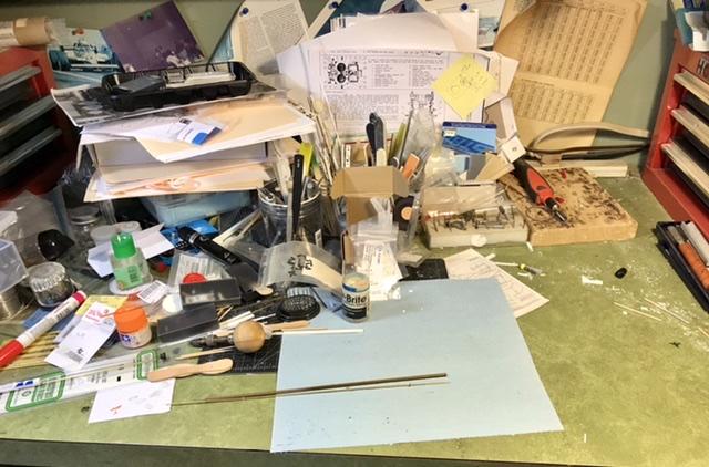

So here’s my question …
I took all the stuff on the right
side Of my workbench and moved it to the LEFT side of my workbench - does this count as “cleaning the workbench???!

No Andrew, that is just a short term fix...................... !
David
To be honest, Andrew..... my workbench is also a mess, with so much stuff piled up that there is very little space to WORK in. Every once in a while I do clear some workspace, and whatever works for each of us as model builders, that's fine !
I agree with Josh, about the plastic wrap around the base of your engine...... makes it look like a real engine waiting to be shipped or fitted to a vehicle.
David
On 9/17/2021 at 11:50 PM, Venom said:
I like the plastic wrap around the bottom of the engine... looks so warehousey.
Awesome stuff though, really!
He uses Parafilm, to protect against wear. Great idea! And, you're right, it looks like shrinkwrap!
14 hours ago, absmiami said:
Detail master .013 plug wires with angled plug boots and RB Bentley plugs …
As always, sir--fine work! Everything looks oh, so right.
Yes. Thanks. It is parafilm.  Which is also handy for sealing that last half bottle of beer that you decide not to finish at O dark 30….

yes the plug wiring for this engine is kicking my a-s. …   The distributor boots are supposed to all point straight back - like good little soldiers …. Mine ….  Do not … I’m just making sure I end up with the correct number of plug wires …
