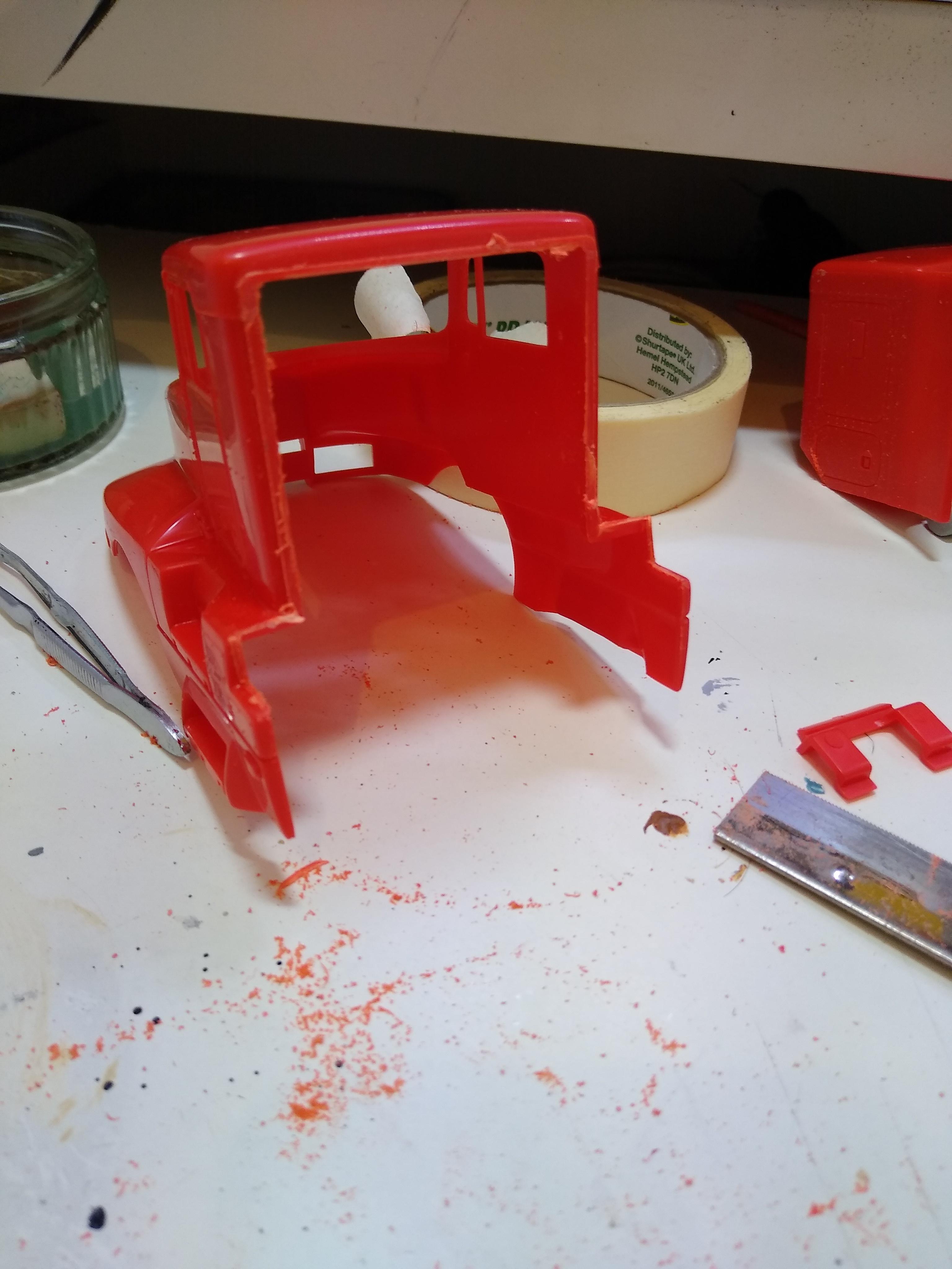

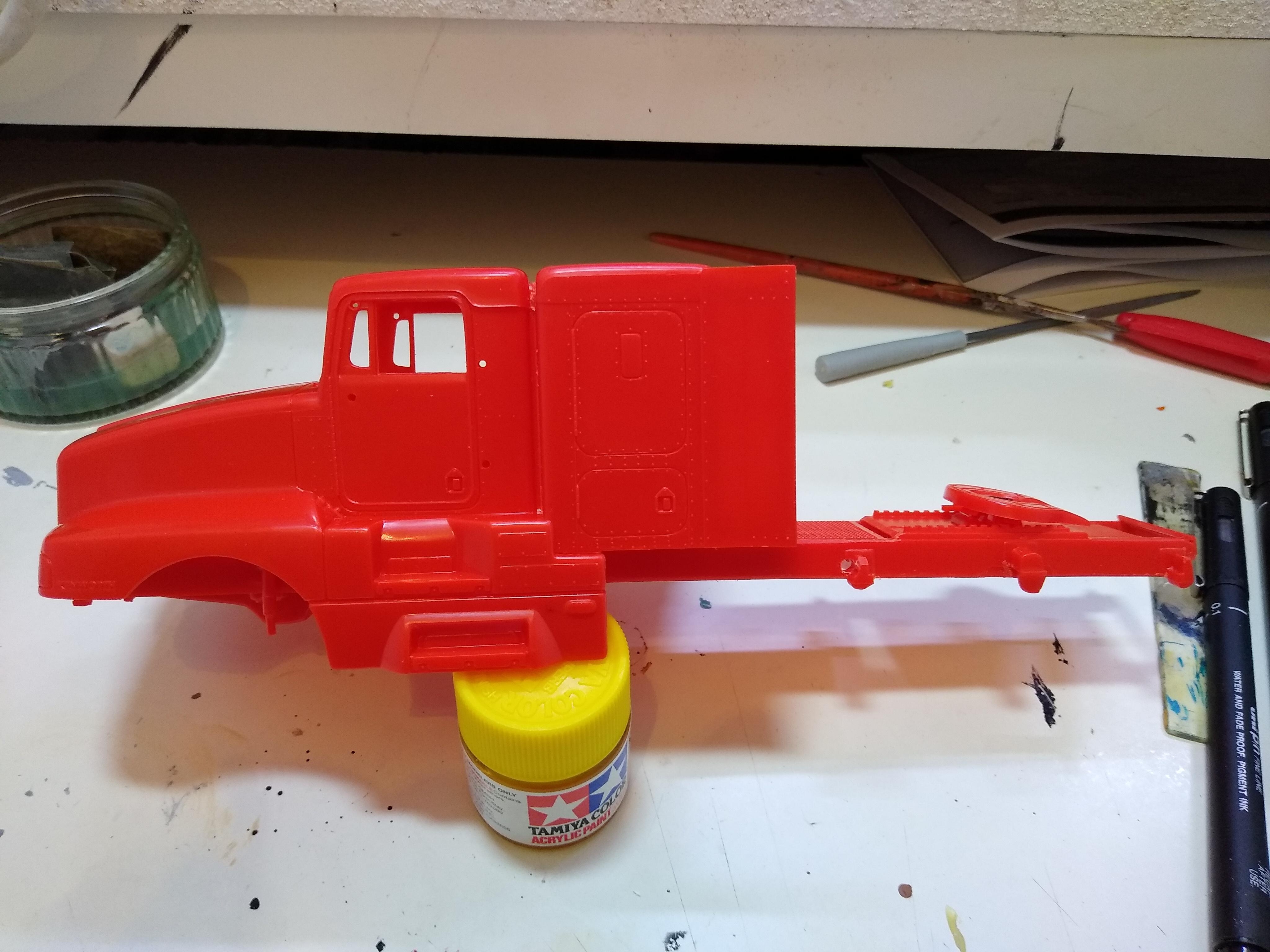

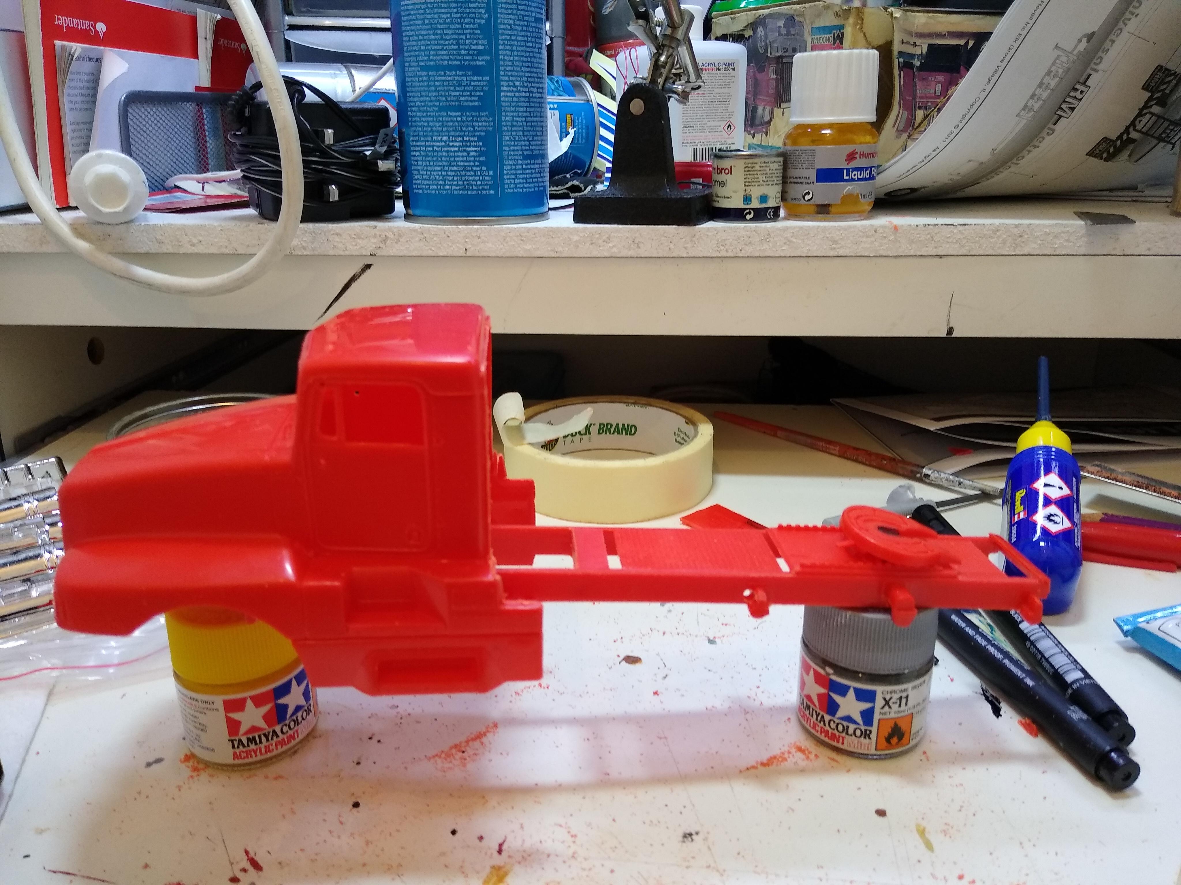

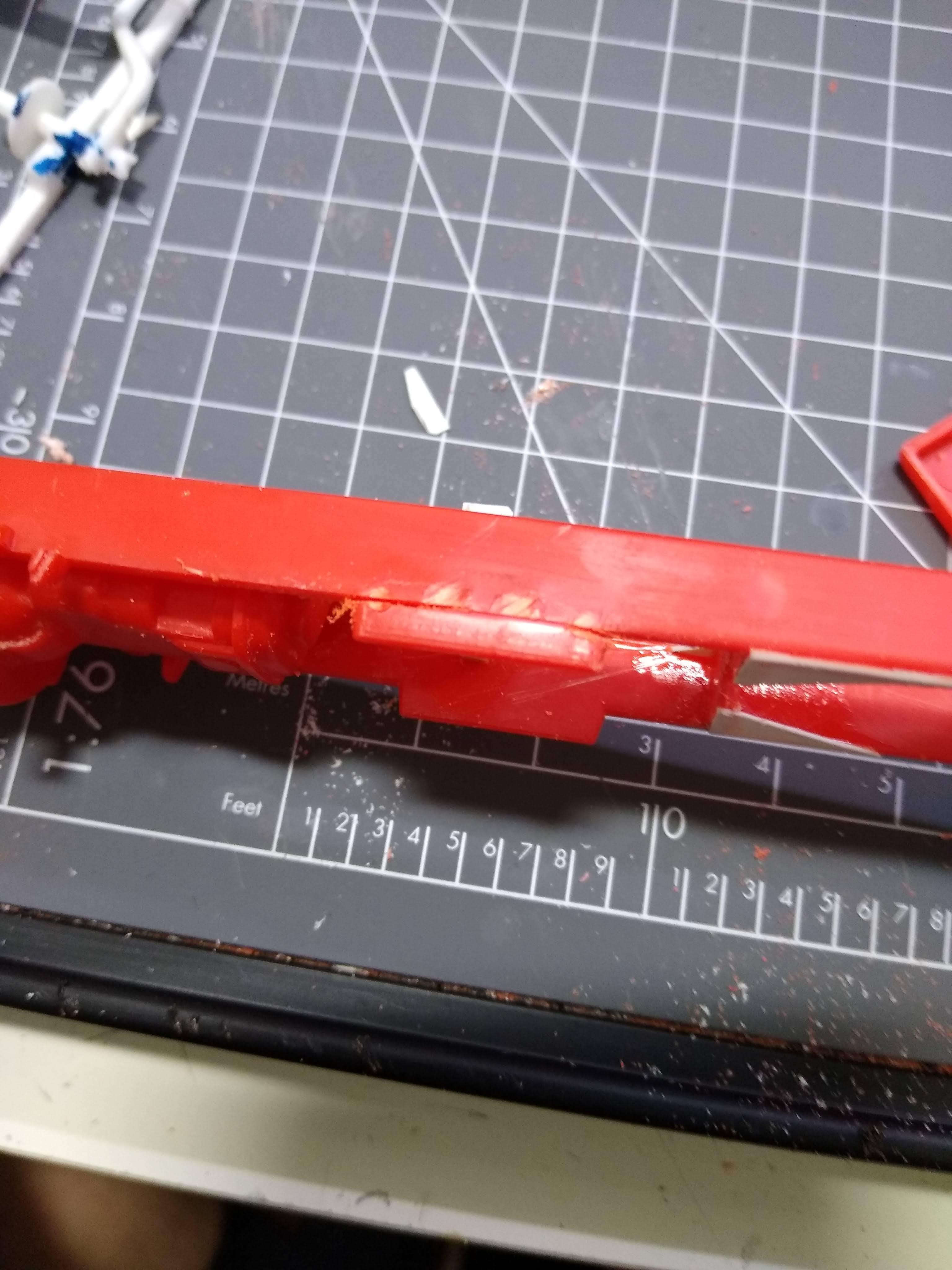

Anyway, I decided to convert this to a day cab, leaving only the skirts in place. I'll use the rear wall of the sleeper to create the rear wall of the cab as it has rivet detail on it.
Out came the saw!
I also intend to remove some of the deck plating they put on the chassis to hide the lack of detail on the duals etc... This will require inserting some detail to make it look better.
Haven't done anything like this for a while. Quite scared.

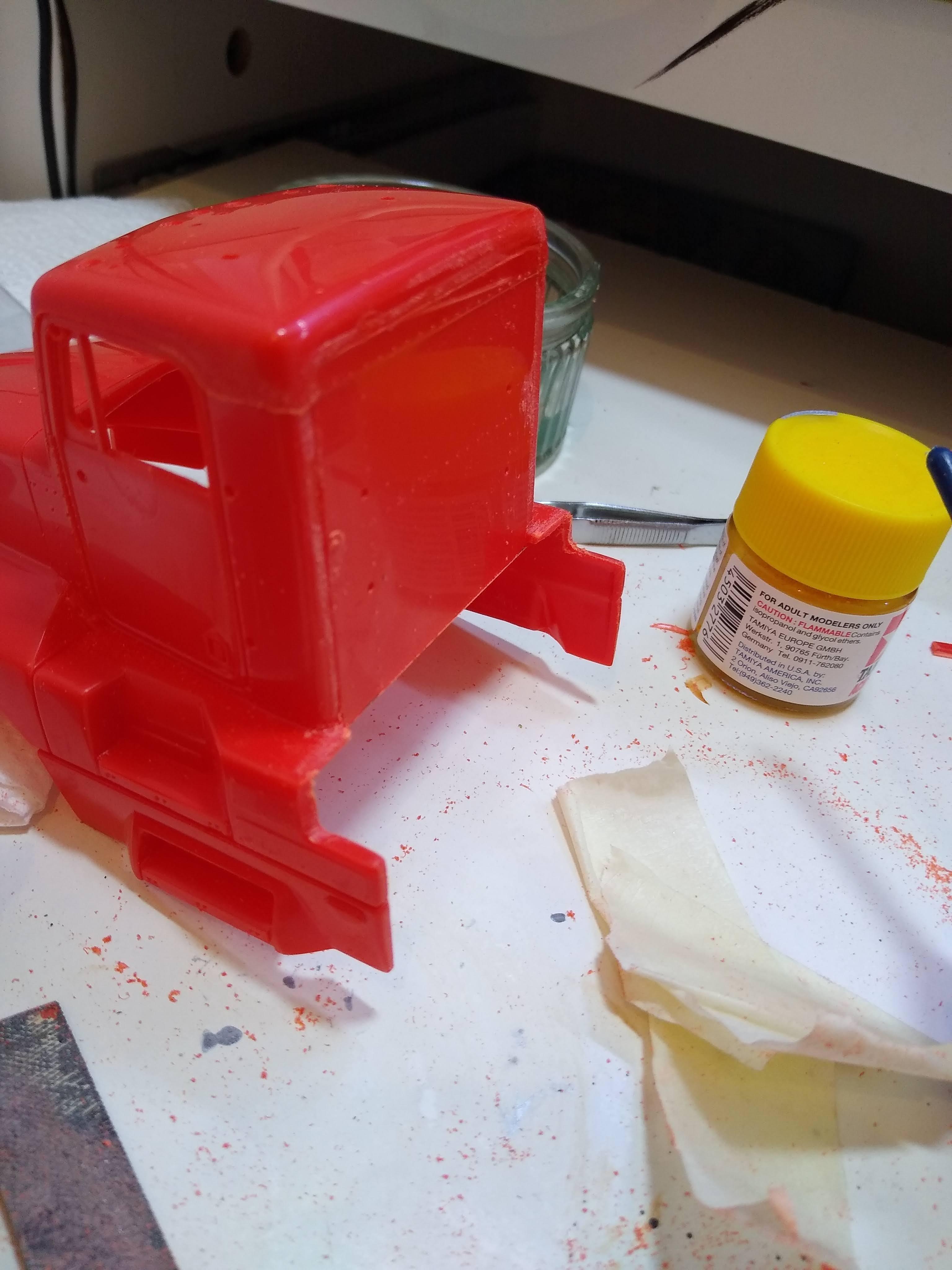

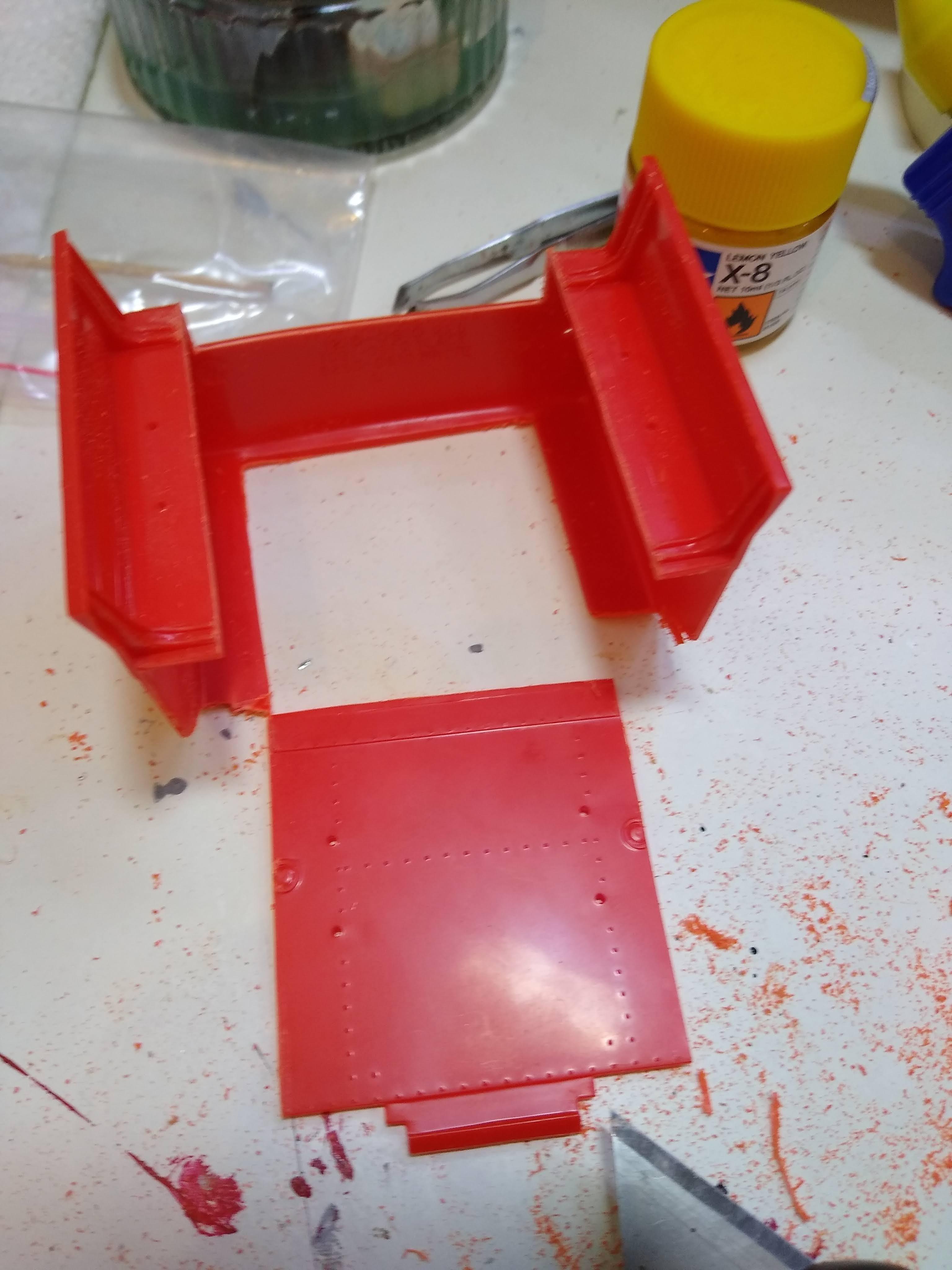

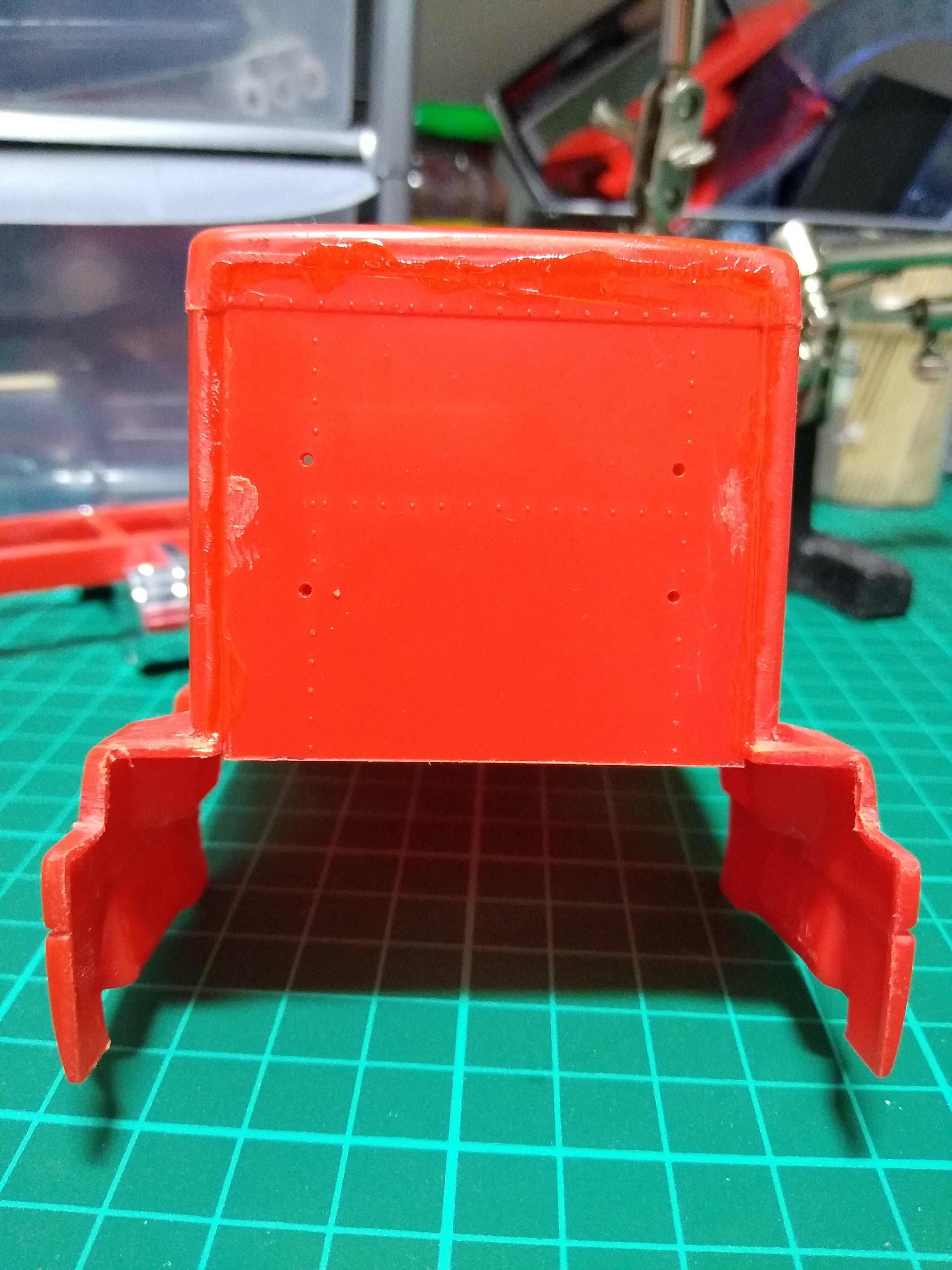

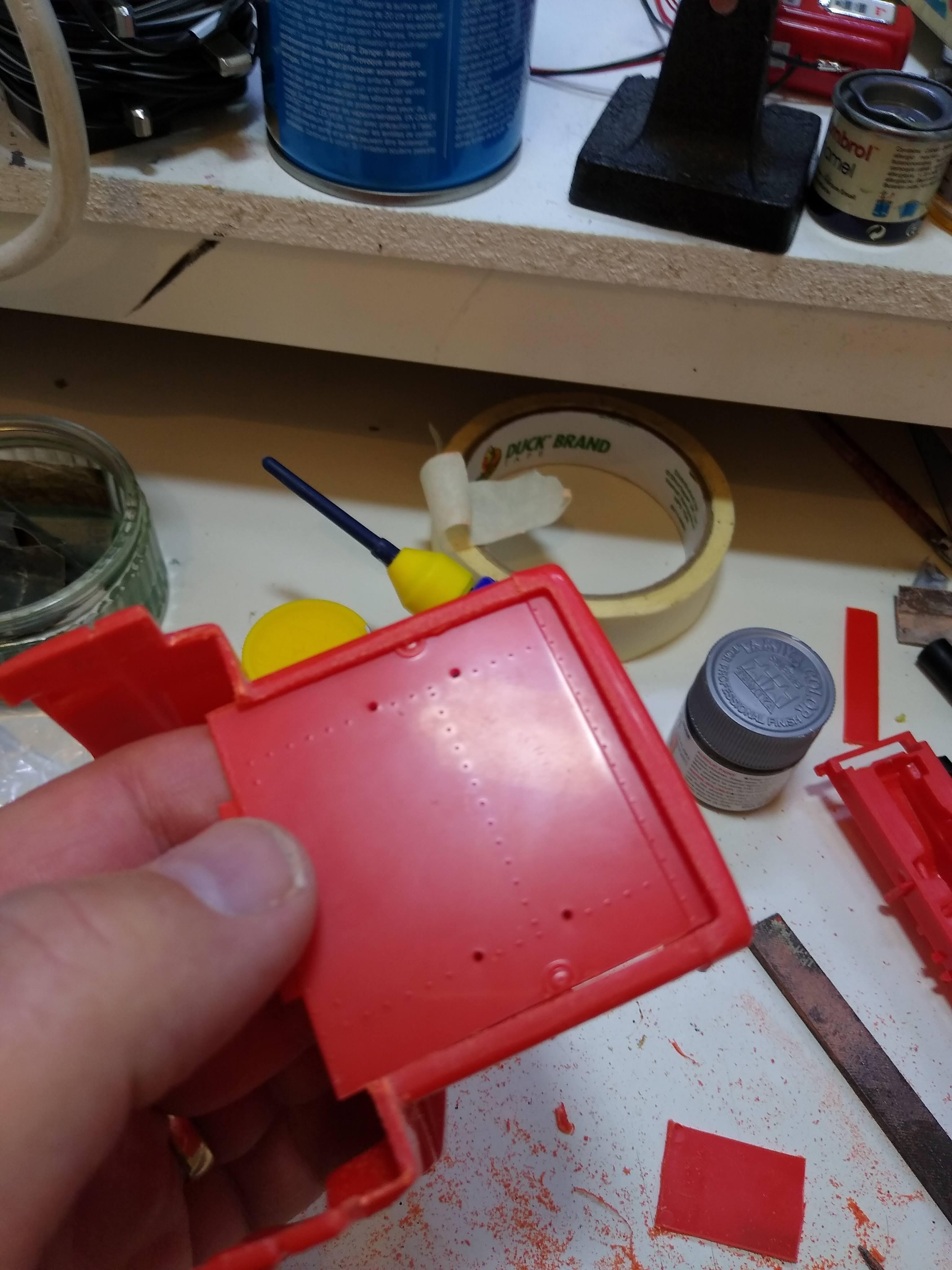

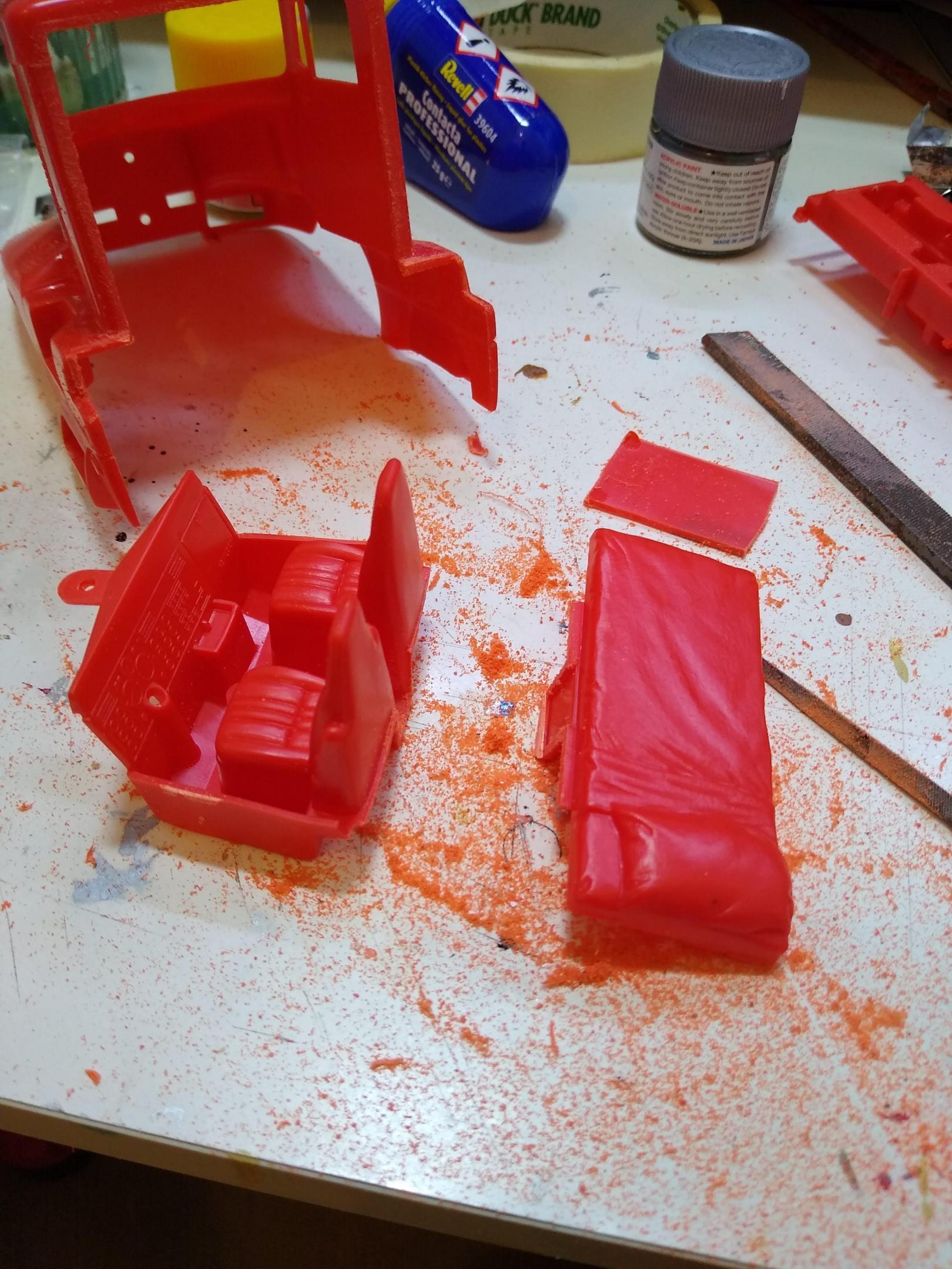

I cut the rear wall out of the sleeper, and extending the cut into the roof cap, this  is because I intend to match the cap's edge with that of the cab's roof cap, plus it will look the same when painted. Red plastic is difficult to hide so I'd probably end up with a shade difference in the paint if I used white card. I filed the cut down flush with the cab rear wall and, with a little filing, the panel dropped in nicely. You can see how the line of the roof cap continues across the rear wall.  I can even use two grab handles on the rear of the cab because the holes transferred across! Before I was overcome with my own cleverness I pondered whether I should have cut out the rear window aperture before I glued the panel in? Probably, one step forward..... never mind.
Hacked the interior in two and it drops in nicely. Does anyone want a bed for the night?

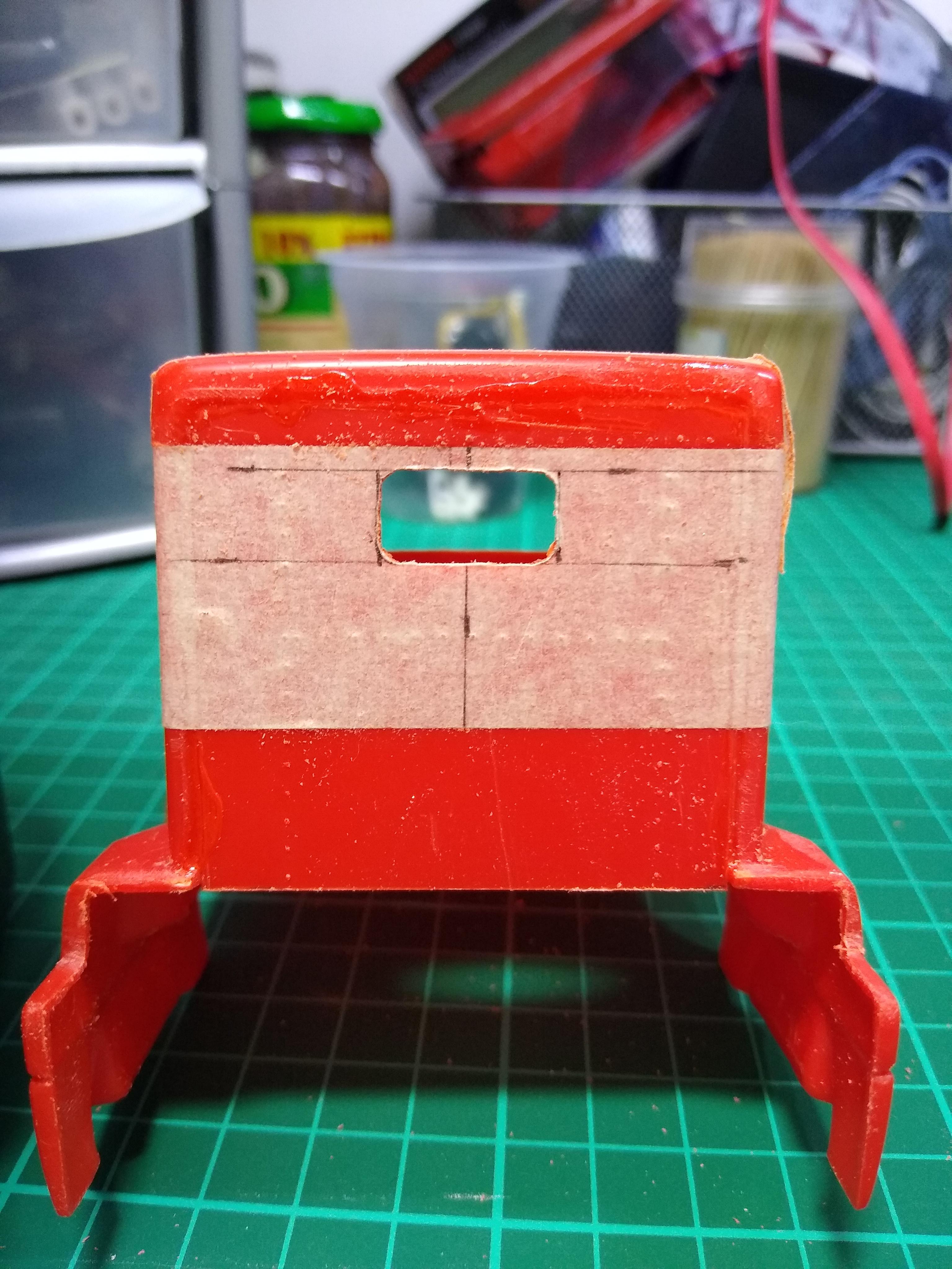

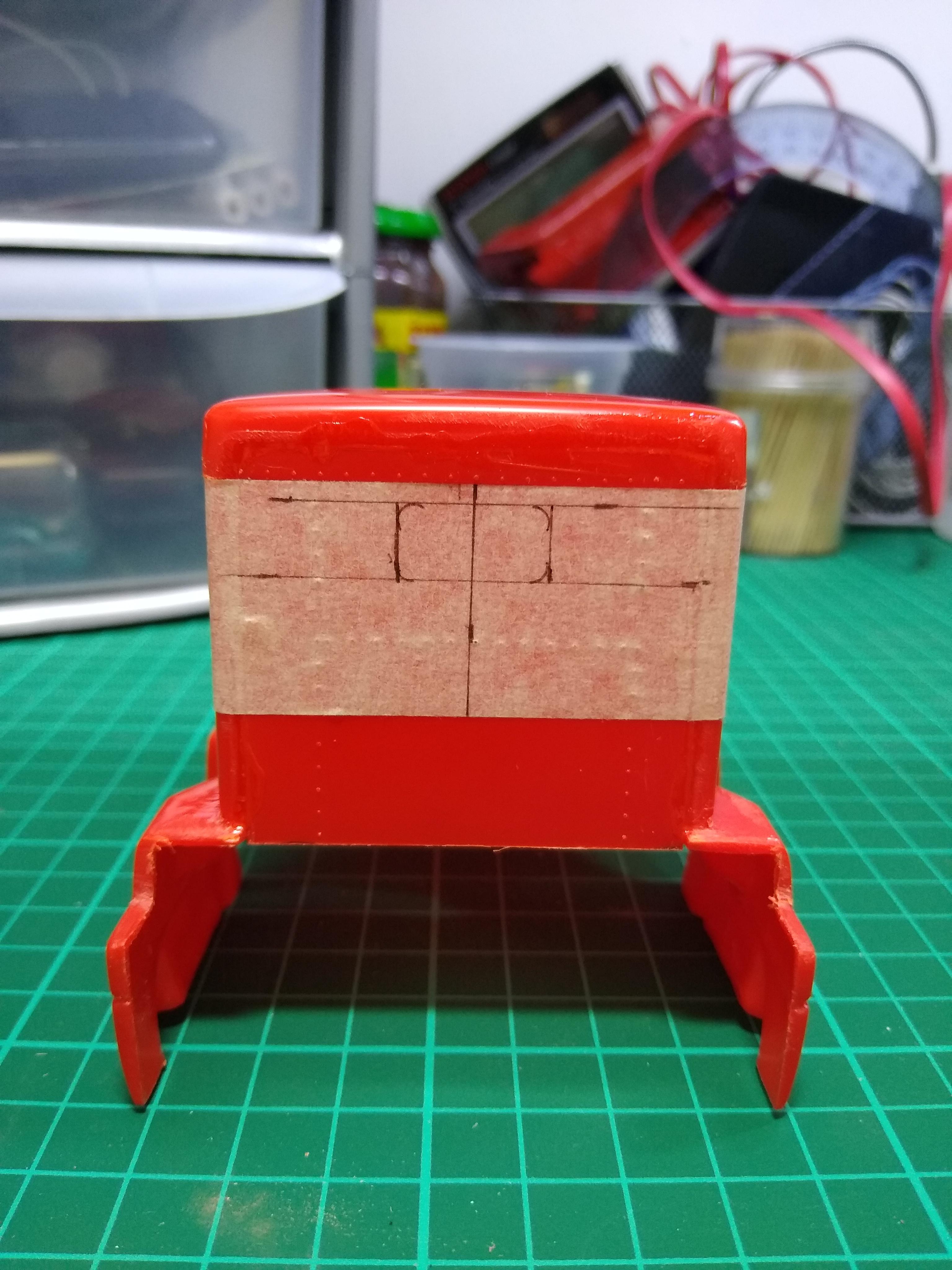

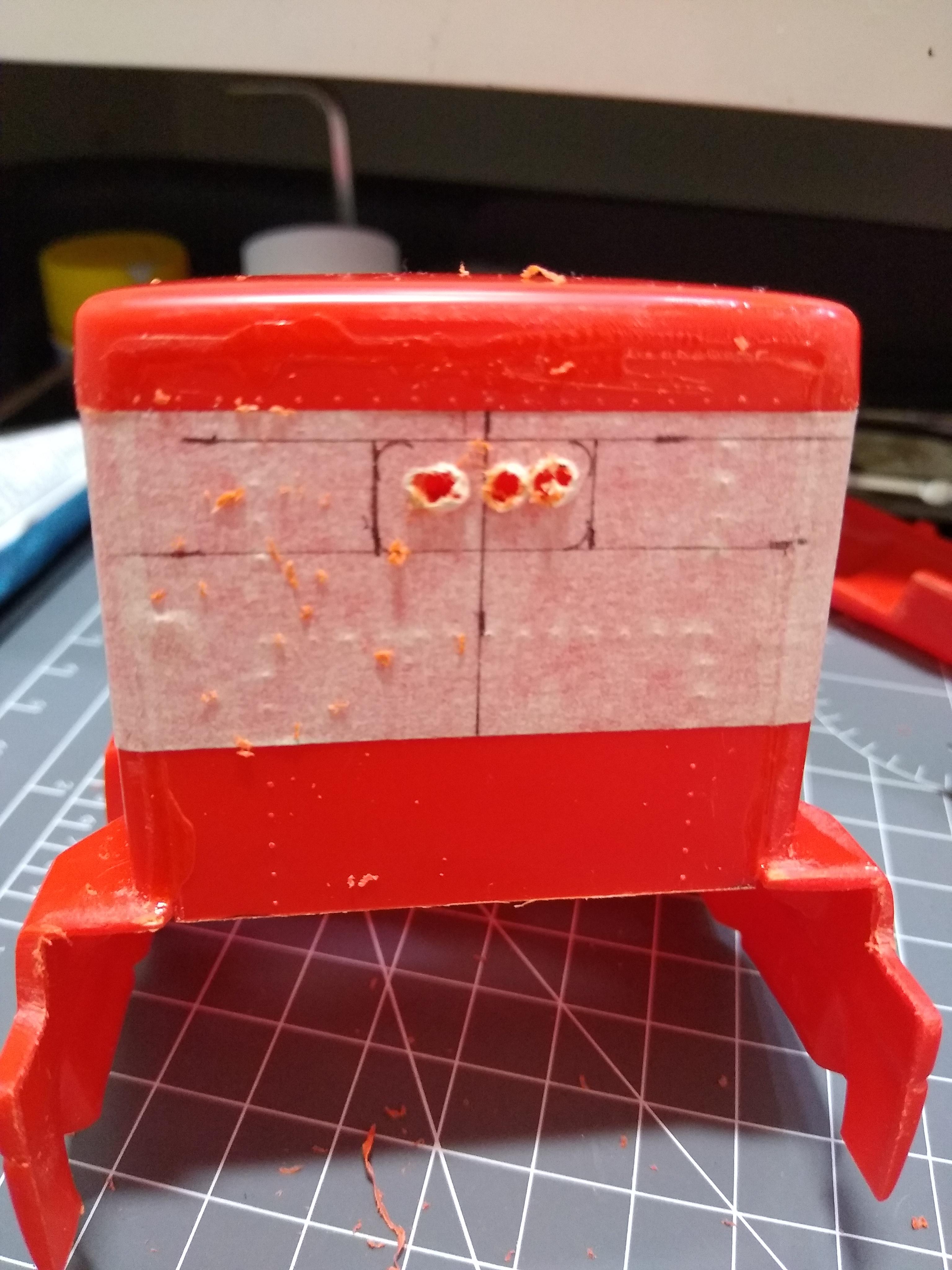

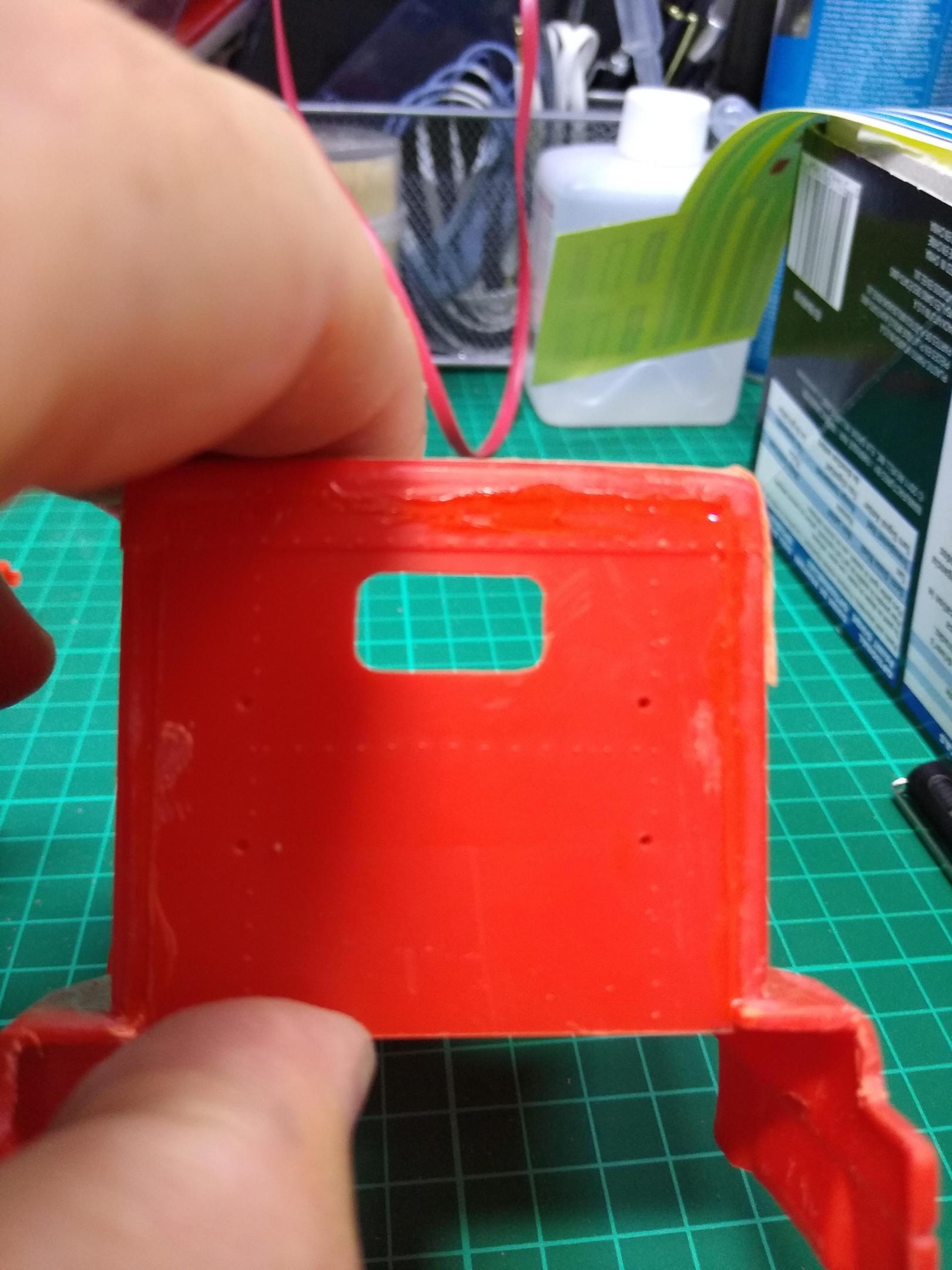

Scary part! Marking up and cutting out the rear window. I laid masking tape across the panel, found my centreline and then drew the box. Using a geometry set circle thingy I drew 3mm radius on each corner. Drilled a row of holes which I then broke together to form a slot and got filing. Used a rat-tail in the corners and finished off with 600 wet and dry. I left the tape on to protect the panel from scratches. Looks ok. Now to rub the joint in the back wall down.

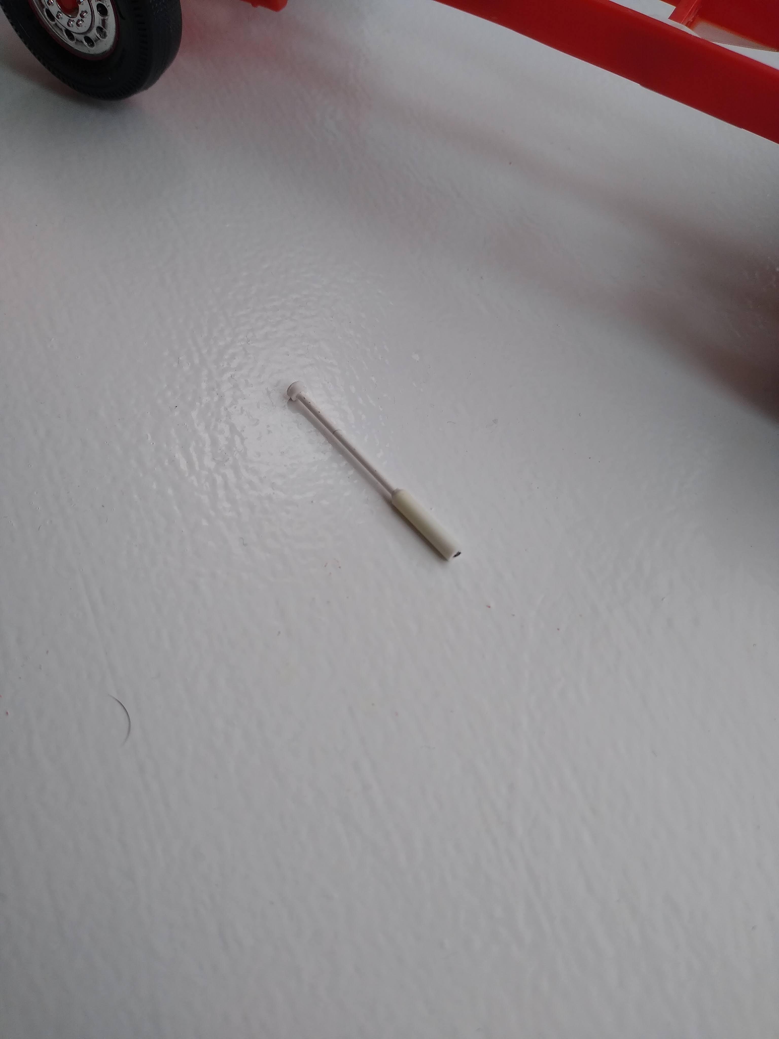

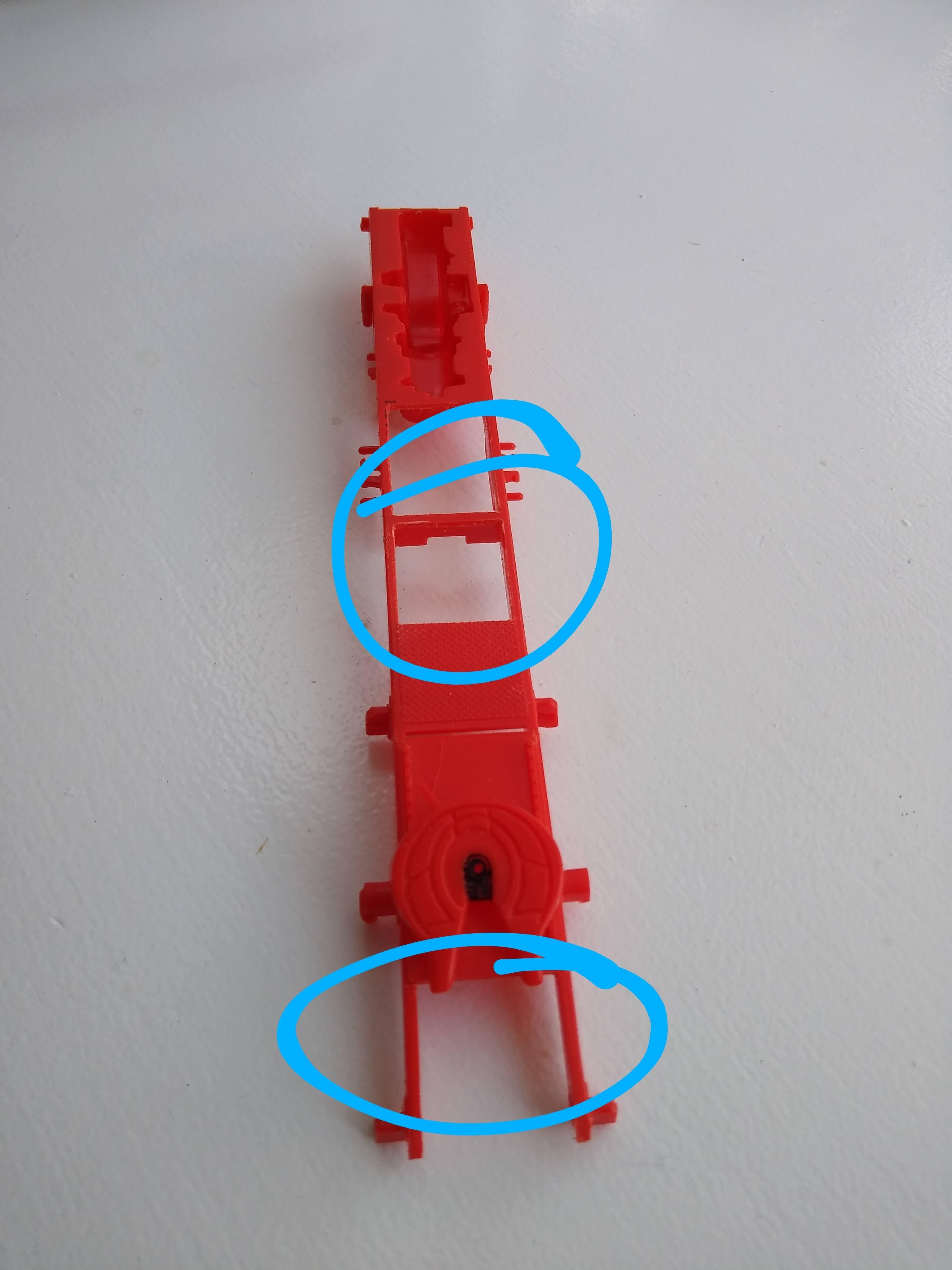

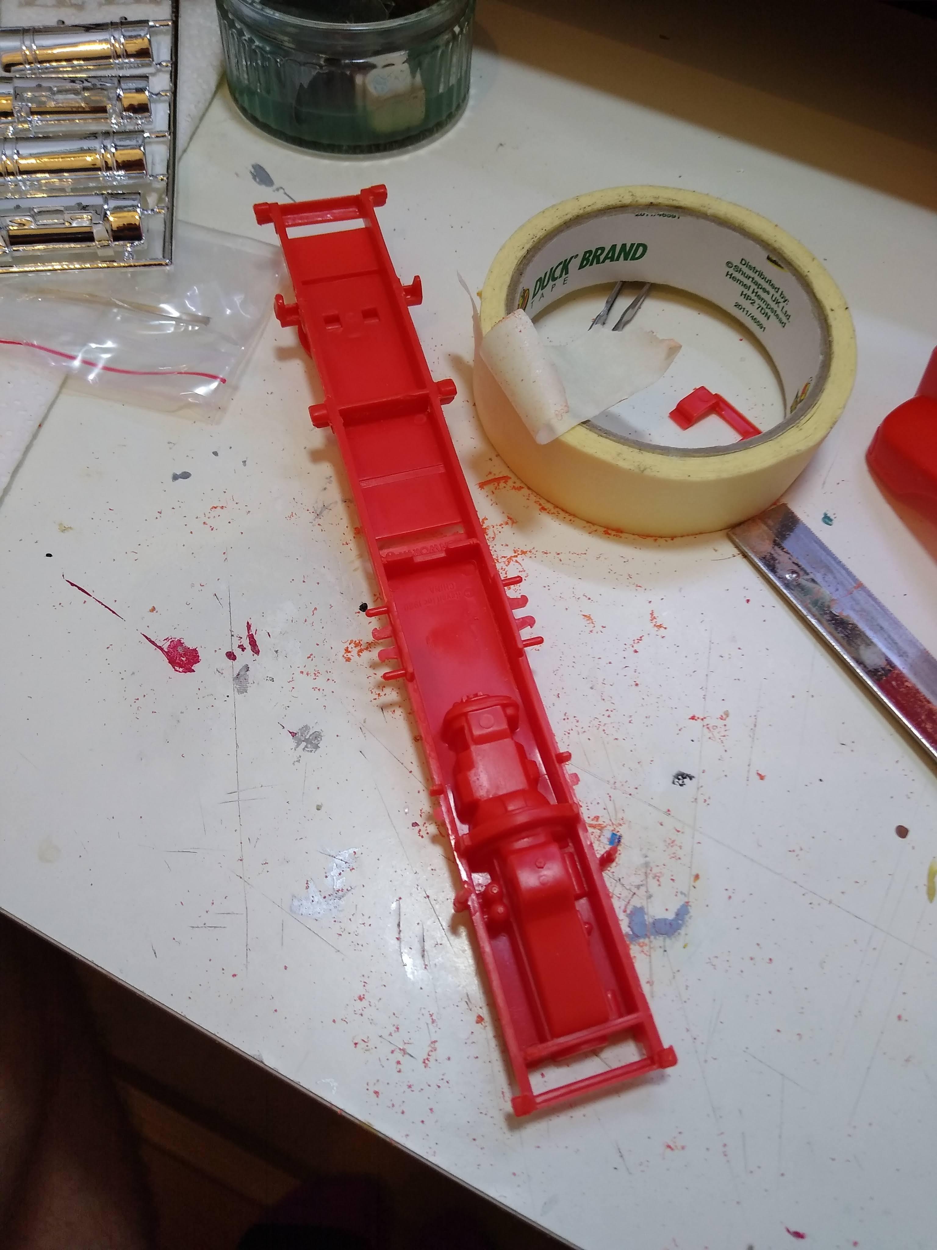

I said I wanted to add some detail to the chassis on this kit, Revell hide the lack of detail with tread plate so that had to come out first. This exposes the top of the rear diff which is hollow so that'll need building up, also you can see there are no brake chambers or shocks or proper crossmember etc...

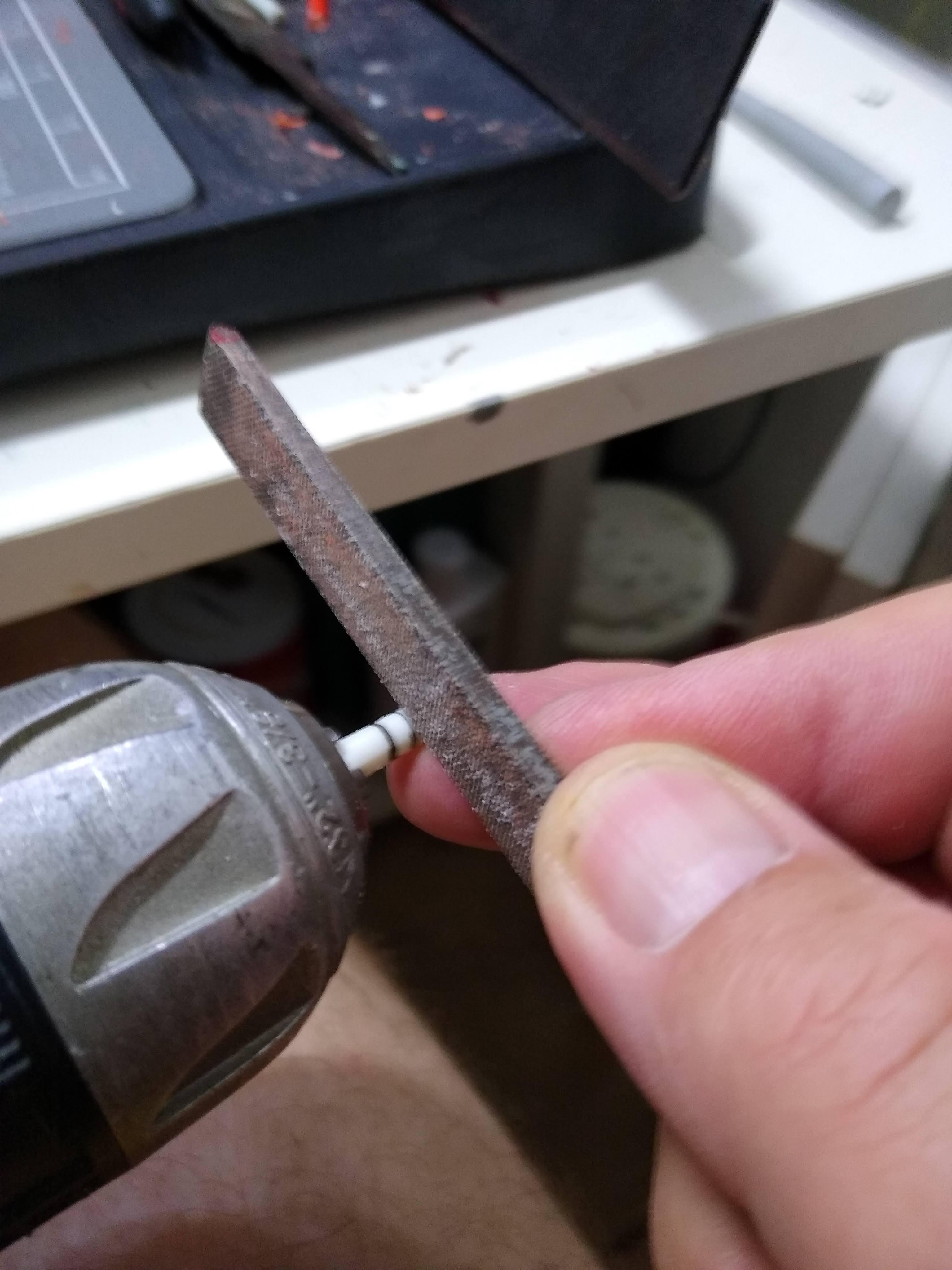

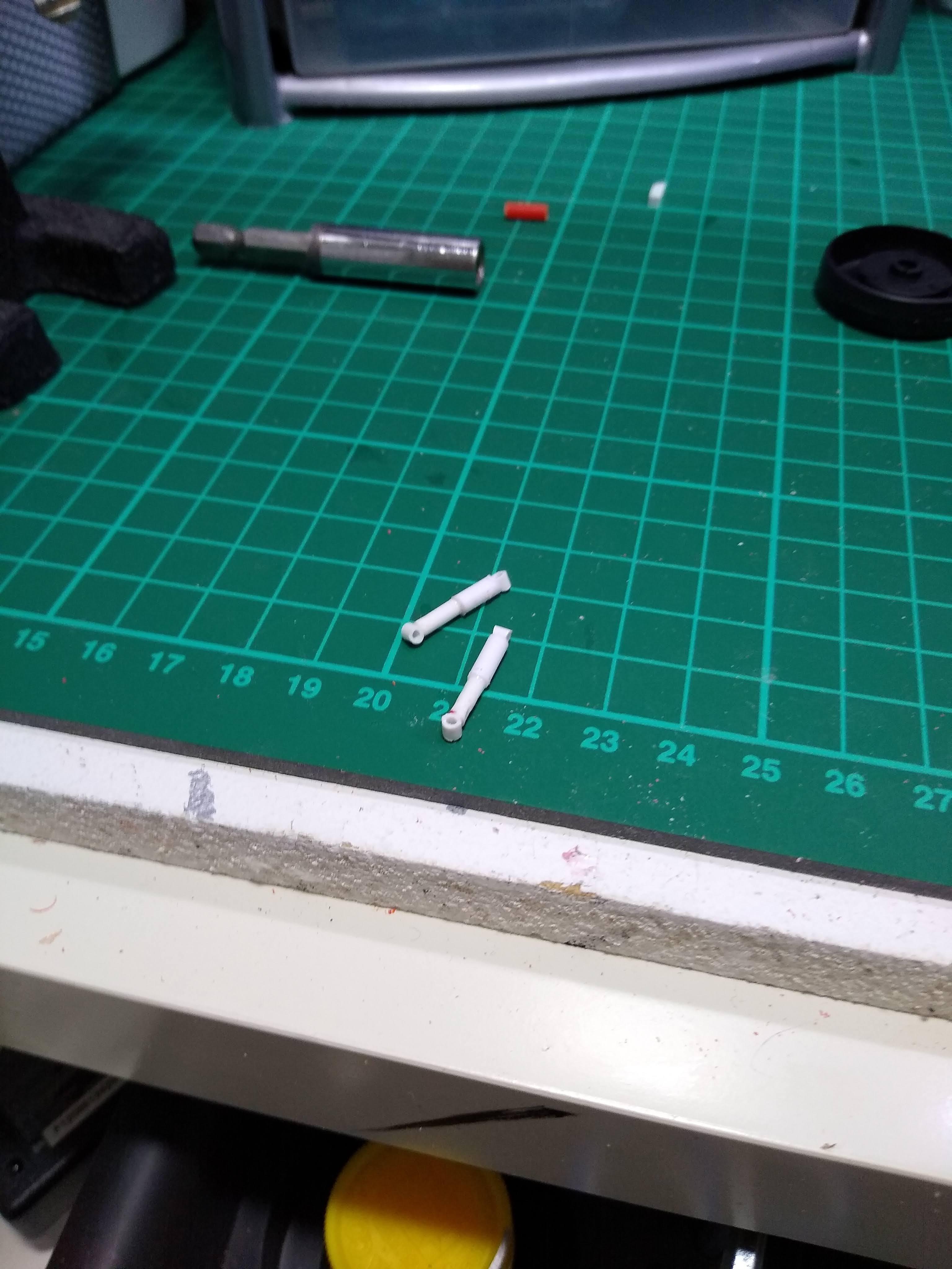

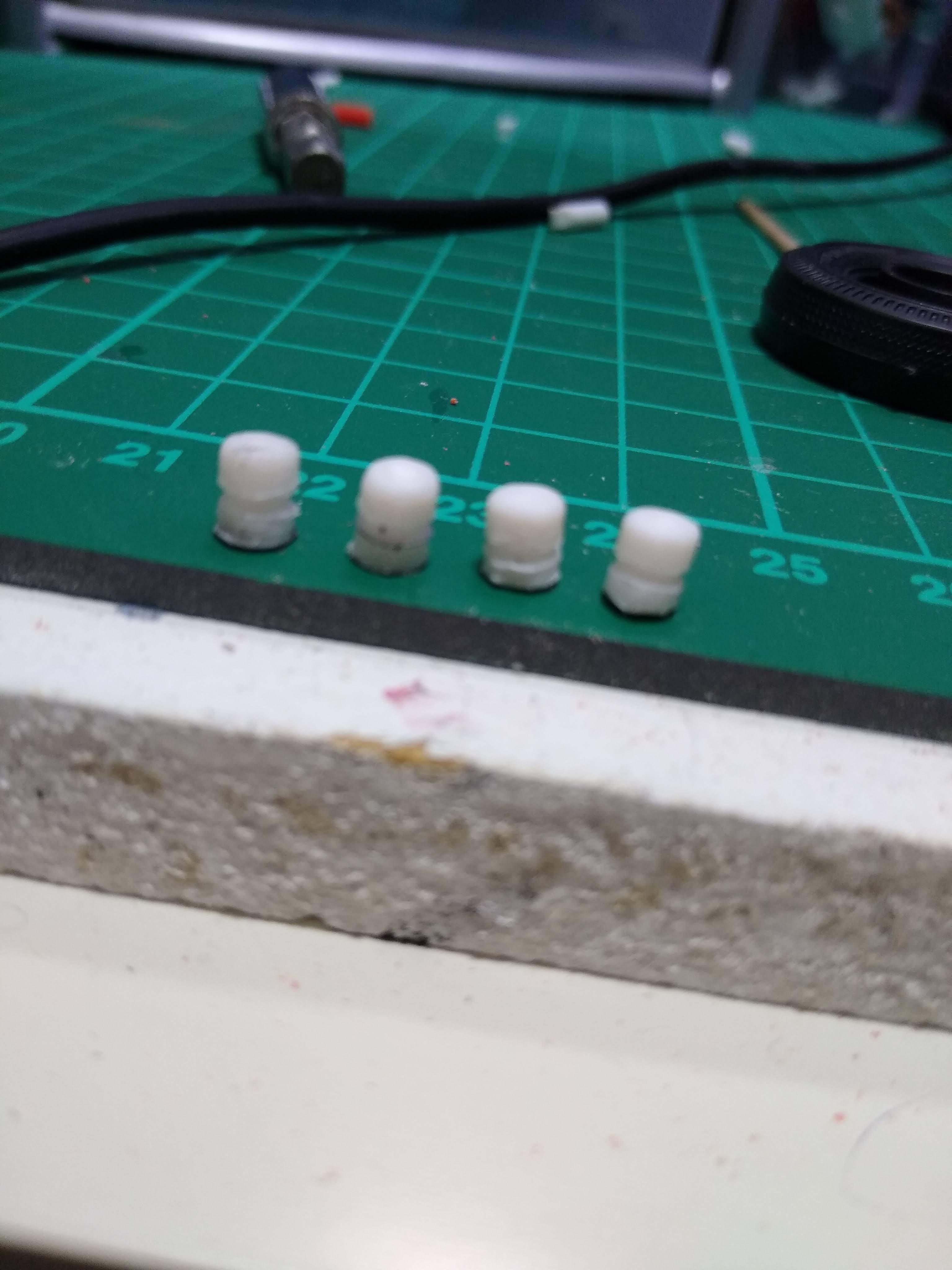

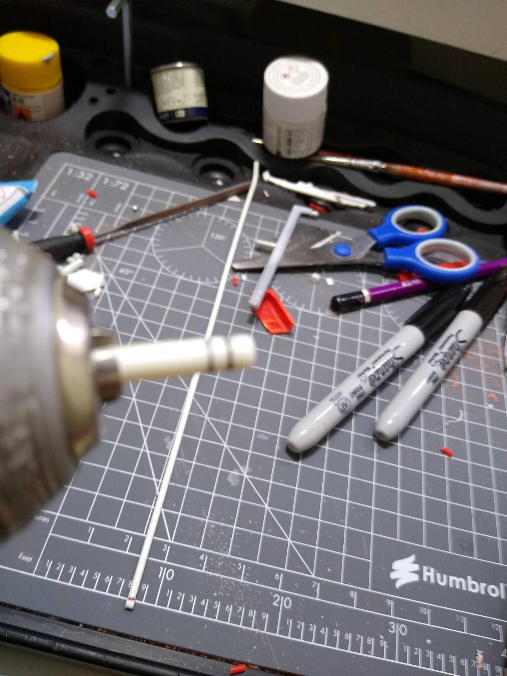

I used my cordless drill as a primitive lathe to turn some brake chambers. [I don't recommend this as a method,  I'm just demonstrating how incredibly stupid I can be]

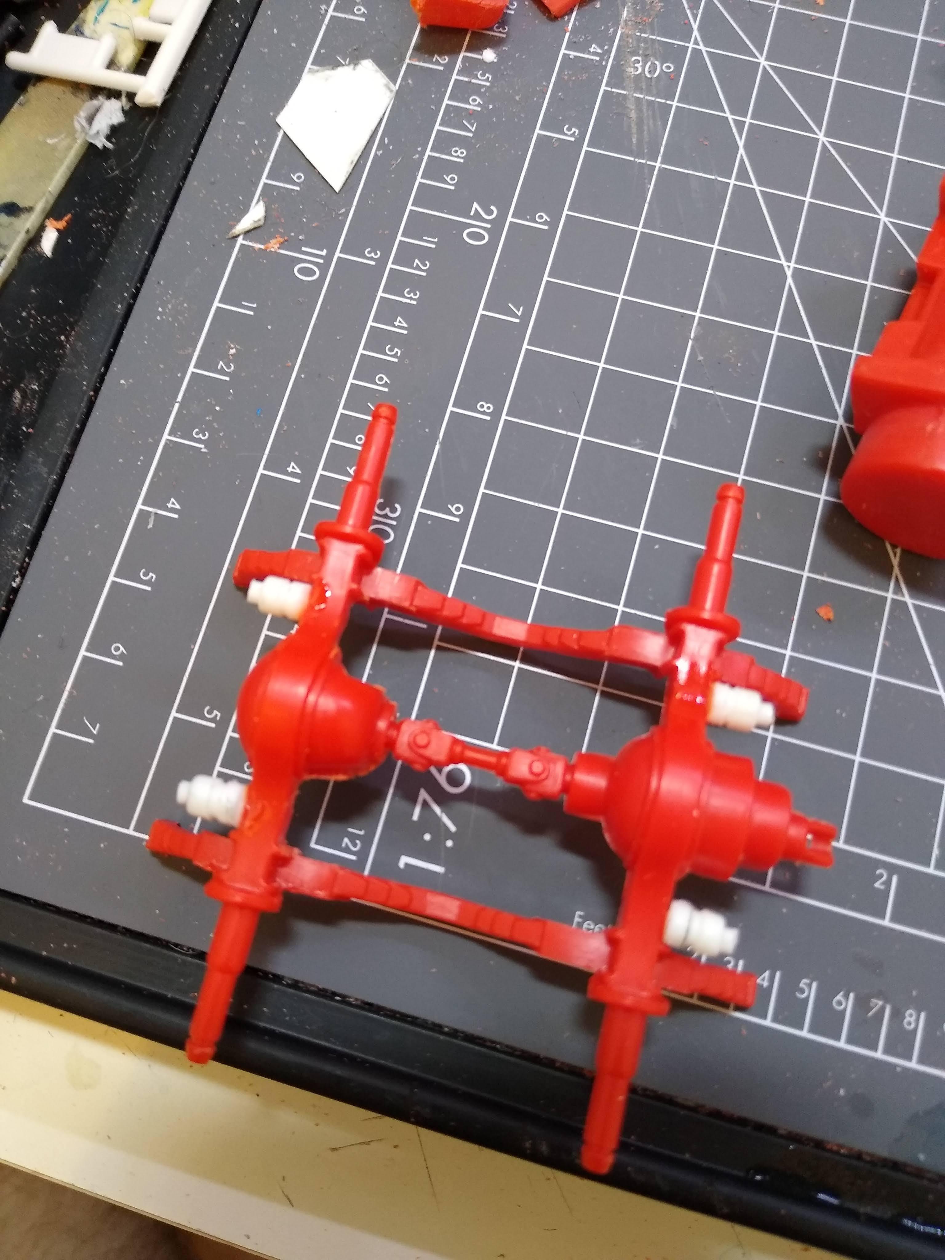

I'm going to make spring-brake chambers [as we'd call them in UK] that apply the brakes when there's no air in the system, rather than plain service brake chambers. I considered adding slack adjusters and cams but I think that would be a little bit excessive.
I first rounded the end, measured 5mm and 2.5mm on the sprue then slowly turned the chuck holding the pen against it to complete the circle. At the 2.5mm line I will turn a groove using a triangular file to create the two halves of the chamber I'll then cut it off at the 5mm mark.  Finally, I used a scrap exhaust pipe from a 1/25 Camaro kit to form the black plastic cap on  the end of the chamber where the winding-off bolt is [in America you'd call it caging the brakes]. Glued them to the axles and the look passable.

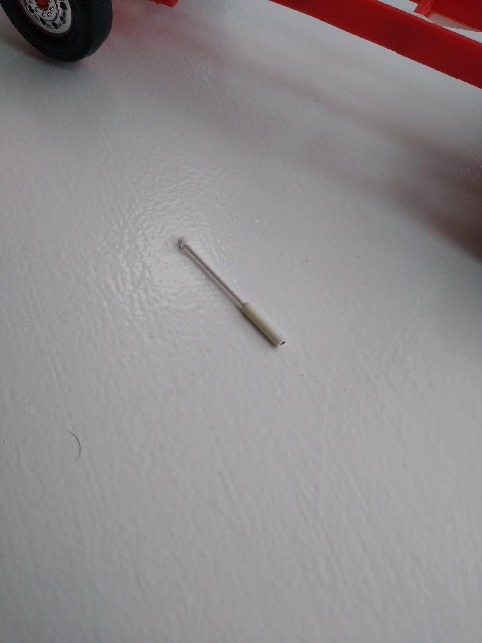

I will install some shock absorbers on the rear axle too. I made them out of plastic tube, using small pieces at each end to form the locating eyes. I can't fit these until the axles are installed.

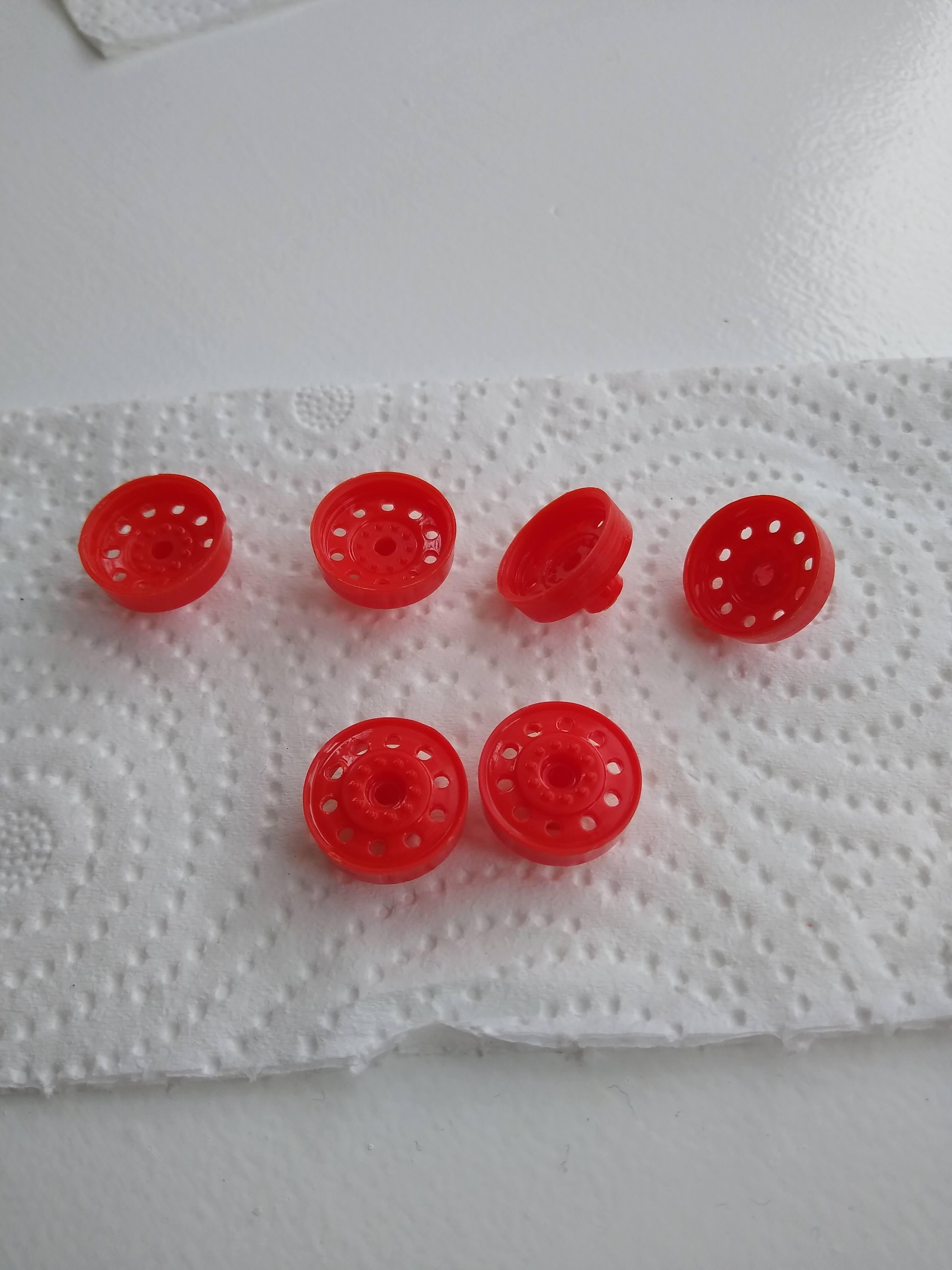

Stripped the chrome off the wheels using bleach because these are going to be unpolished aluminium.
I don't know whether I'm using the wrong product but although the chrome disappears it always leaves behind a clear lacquer on the parts so that they still need sanding to get back to actual plastic.

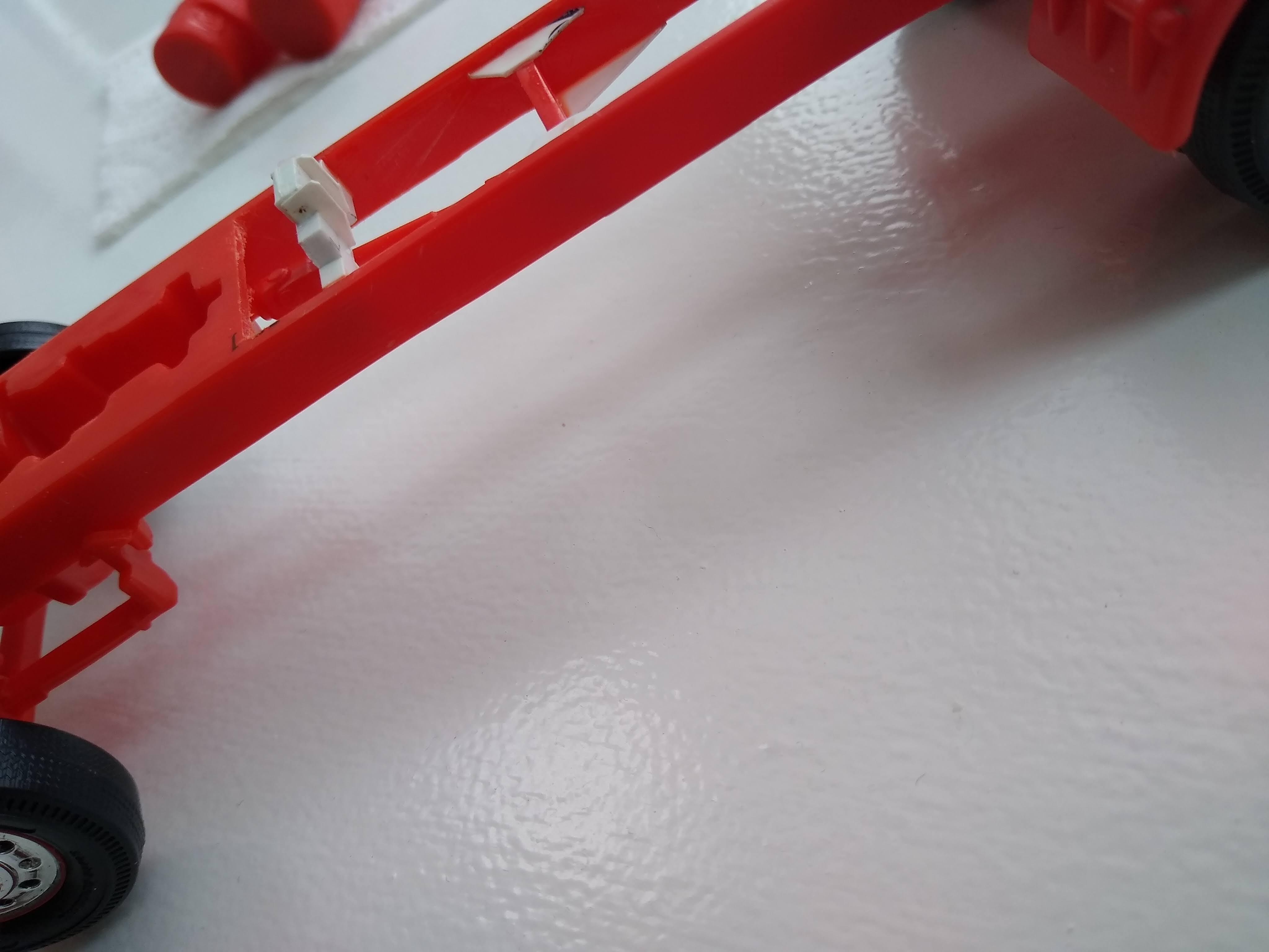

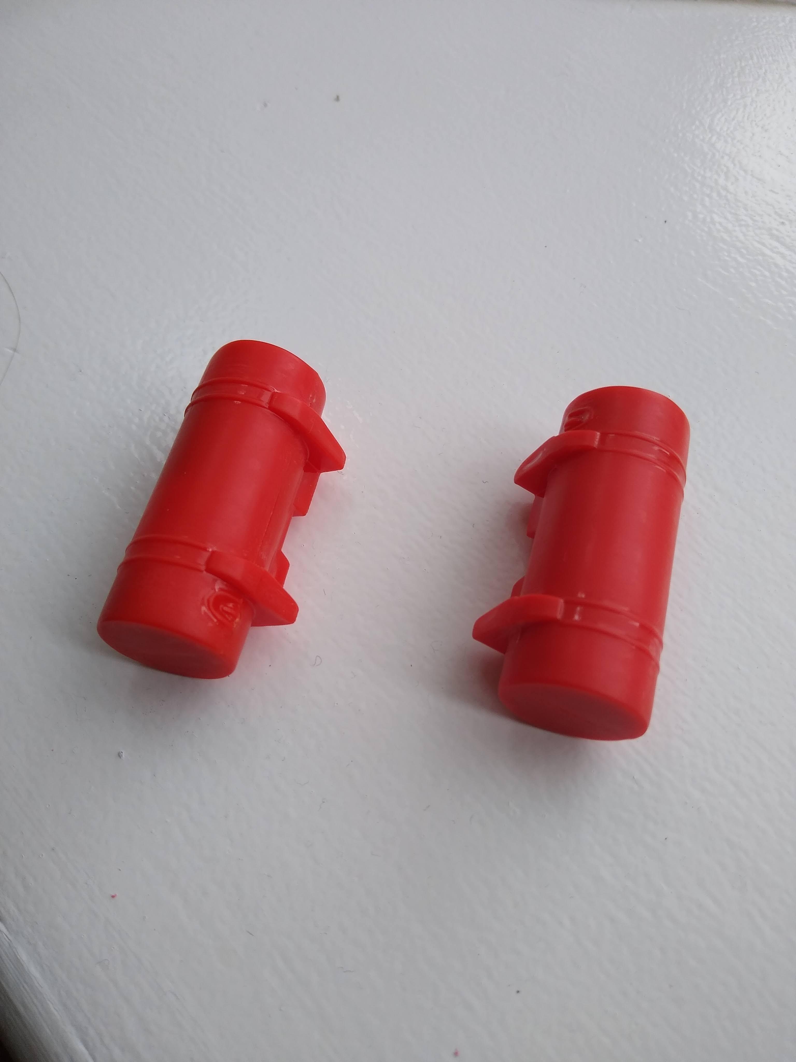

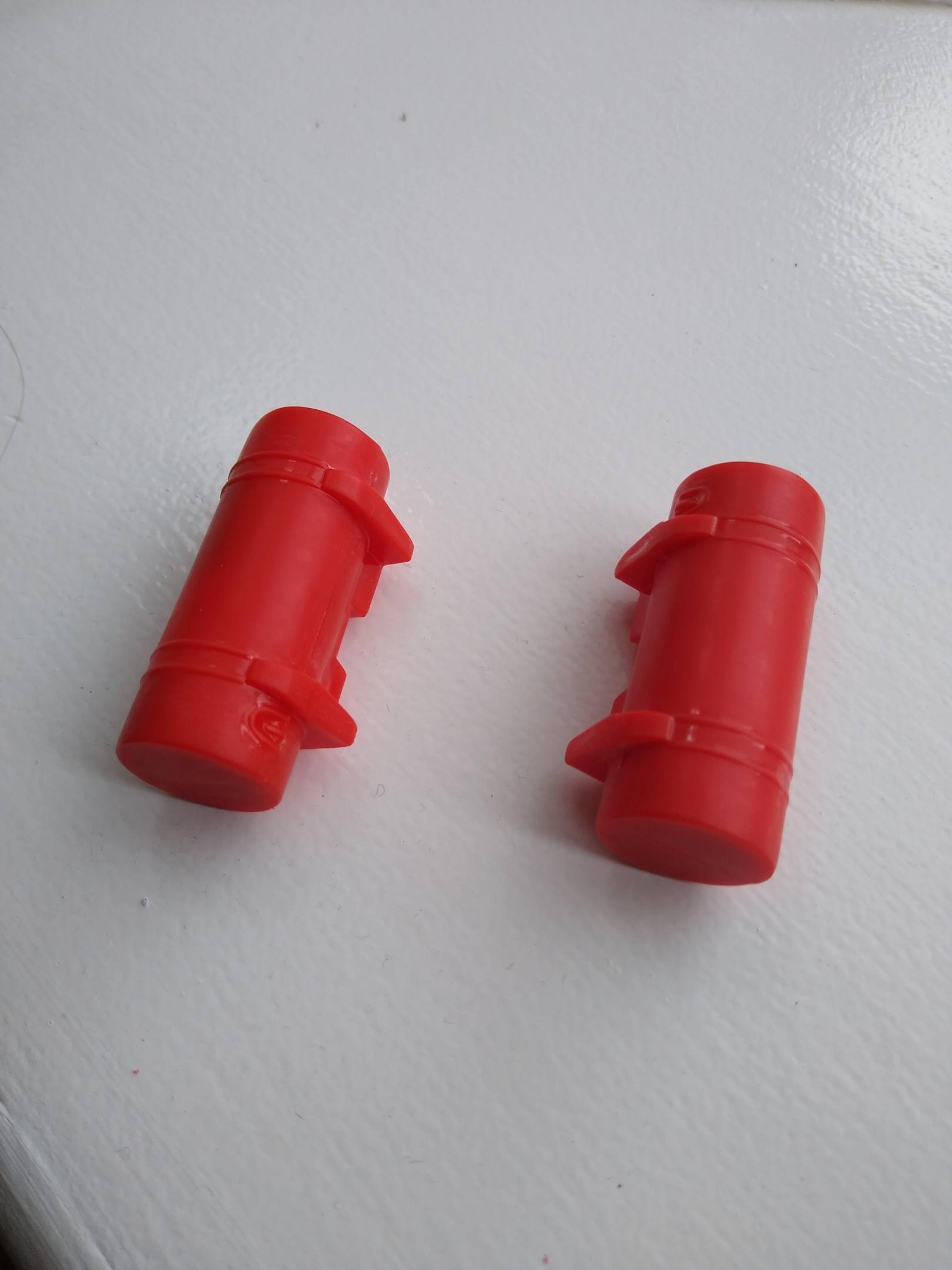

I want to move the fuel tanks forward so that they're pretty much completely under the skirts leaving as much empty chassis rail as possible. It also gave me the opportunity to remove the big locating boss they put on the chassis on these kits so the there is is just one straight rail right through. Also stripped the tanks because they're  going to be aluminium like the wheels. In the chassis  shot you can see the cab mount crossmember I've built out of square rod.
