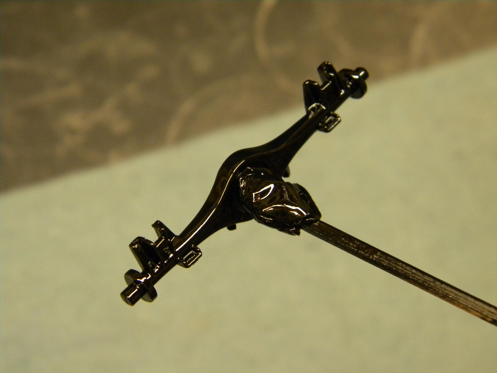

StevenGuthmiller Posted August 20, 2020 Posted August 20, 2020 (edited) Just shot a heavy coat of Duplicolor sandable gray primer on all of my modern kit chassis parts, followed by a coat of Rustoleum gloss black enamel. Looks pretty crappy! Steve Edited August 20, 2020 by StevenGuthmiller

martinfan5 Posted August 20, 2020 Posted August 20, 2020 (edited) On 8/20/2020 at 1:01 AM, StevenGuthmiller said: Just shot a heavy coat of Duplicolor sandable gray primer on all of my modern kit chassis parts, followed by a coat of Rustoleum gloss black enamel. Looks pretty crappy! Steve Expand Yep, its craptastic indeed ? Just because you don't have issues with the paint does not mean its not a low quality paint, its still is low quality crappy paint, the key is the builder, like yourself, you a very talented builder that posses some skills that lot of builders do not( I wish I had your BMF skills), and those skills are required to get decent results from these low quality crappy hardware store paints in can. Its great you are able to get good results from those products , not everyone is as lucky. *just so everyone understands, I mean zero disrespect to Steve, we are just having a debate, its our thing, its what we do. Edited August 20, 2020 by martinfan5

StevenGuthmiller Posted August 20, 2020 Posted August 20, 2020 On 8/20/2020 at 3:02 AM, martinfan5 said: Yep, its craptastic indeed ? Its almost as crappy as your passive aggressive reply, just because you don't have issues with the paint does not mean its not a low quality paint, its still is low quality crappy paint, the key is the builder, like yourself, you a very talented builder that posses some skills that lot of builders do not, and those skills are required to get decent results from these low quality crappy hardware store paints in can. Expand No disrespect intended. I just don't believe in putting all of my eggs in one basket. If Tamiya were to stop producing paints tomorrow, seems to me that there would be a lot of builders that would be SOL, including those that are advised on a regular basis that their only "real" option for primer is Tamiya. A lot like what's happen now with the hysteria over Testors discontinuing many of their paints. There are other very practicable options gentlemen. Regardless of the rhetoric. Steve
StevenGuthmiller Posted August 20, 2020 Posted August 20, 2020 On 8/20/2020 at 3:02 AM, martinfan5 said: and those skills are required to get decent results from these low quality crappy hardware store paints in can. Expand By the way, absolutely no special skills were required whatsoever with painting those chassis parts. just point and shoot, same as you would with any other "crappy hardware store paint in a can". Steve

Plowboy Posted August 20, 2020 Posted August 20, 2020 On 8/20/2020 at 1:01 AM, StevenGuthmiller said: Just shot a heavy coat of Duplicolor sandable gray primer on all of my modern kit chassis parts, followed by a coat of Rustoleum gloss black enamel. Looks pretty crappy! Steve Expand If those parts are from the AMT '62 Catalina and molded in gray, they're not modern. Dupli Color is decent primer. But, as evidenced by Randy, you never know when you're going to get a bad reaction.

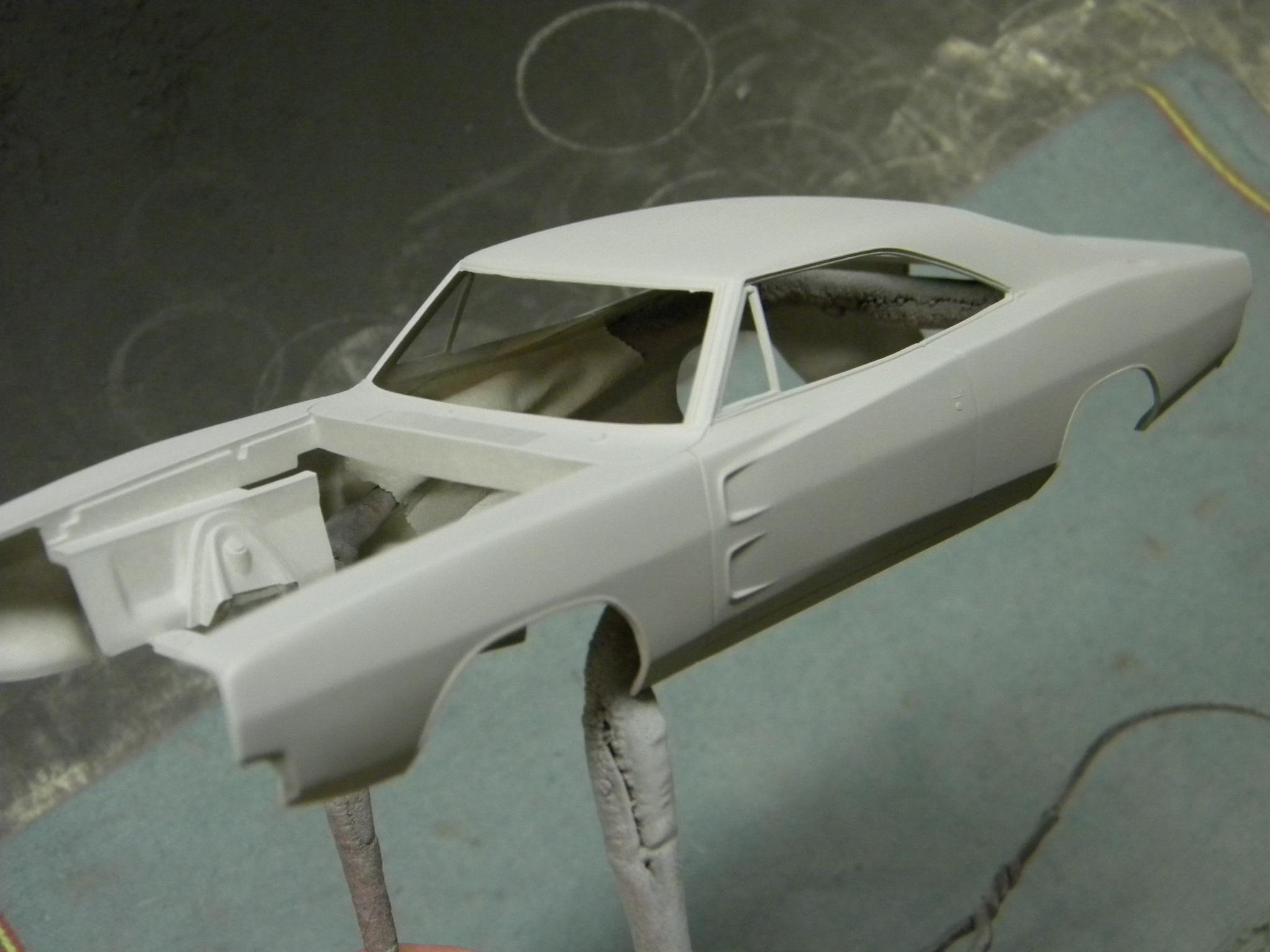

StevenGuthmiller Posted August 20, 2020 Posted August 20, 2020 I don't know if the Revell '68 Charger meets the aforementioned criteria of a "modern kit", but here is my little experiment. Four light coats of Duplicolor "primer sealer" (which is what I normally use) shot over less than a half of an hour's time. Almost no time to gas out, nothing underneath but bare plastic, no sanding between coats and a finish that a baby's butt would envy. No crazing or any other issues of any kind. I didn't even clean it before spraying. Normally, I would shoot a coat of Testors as a base before the Duplicolor, but for illustrative purposes, I sprayed this bare. Works for me. And for half the price per once as a can of Tamiya, I'll take it. Steve
Bucky Posted August 20, 2020 Posted August 20, 2020 I used Pladti Kote primer years ago, then it disappeared from my regular buying places. I switched over to Duplicolor and haven't looked back. I normally shoot a couple light coats and then a couple heavier coverage coats. I spray the parts from all kinds of different directions, to keep down the chances of it streaking. Back in the days of yore, I used mostly TESTORS color paints with no primer at all. Never really had much problem, except for an occasional run when I sprayed it to heavily.
Bills72sj Posted August 20, 2020 Posted August 20, 2020 On 8/20/2020 at 5:12 AM, Bucky said: I used Plasti Kote primer years ago, then it disappeared from my regular buying places. I switched over to Duplicolor and haven't looked back. I normally shoot a couple light coats and then a couple heavier coverage coats. I spray the parts from all kinds of different directions, to keep down the chances of it streaking. Back in the days of yore, I used mostly TESTORS color paints with no primer at all. Never really had much problem, except for an occasional run when I sprayed it to heavily. Expand I too have sprayed Testors enamels directly onto virgin styrene for years. Obviously skipping the whole putty and sanding steps. Most of the time I end up with enamel orange peel but I just lived with it. I now have the patience and budget to attempt better, so I have JUST recently invested in some airbrushes and all the little dodads that go with airbrushing. I used Tamiya white primer and while it seemed thin to me, it does lay down well. When I put Metallic Red automotive Duplicolor over it, it seemed sensitive to chipping off. Fortunately I handled it gently enough to need very few touch ups before covering it with Future. I guess it goes back to the sage advice of the experienced which is, stick with compatible brands/formulas of paints. As a side note. It seems the newer the kit the weirder the plastic is. I saw a Youtube video that mentioned that some kits are made with recycled plastic formulas instead of pure virgin styrene. I had some 70 Monte Carlo parts molded in dark green that were pretty tough to sand and a bit reluctant to glue.
