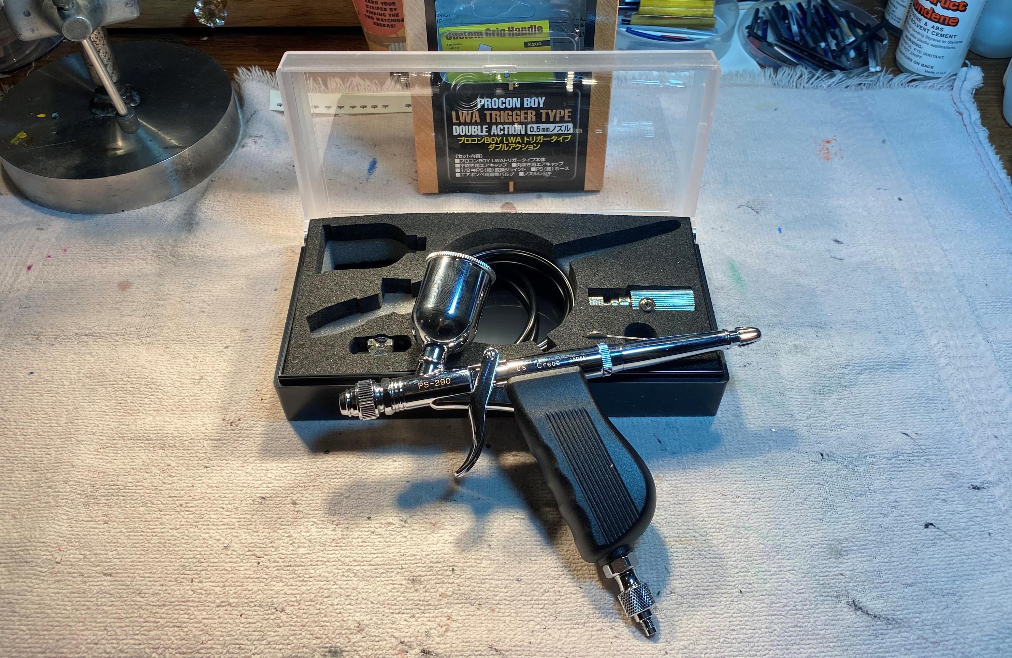

Bills72sj Posted April 3, 2022 Author Posted April 3, 2022 Got to lay some white paint today with my new PS-290. I am liking it. Good atomization, good control, automatic ending with air only. The really big cup is a plus too. Clean up takes a bit more lacquer thinner due to larger cup. So far so good.
TransAmMike Posted April 3, 2022 Posted April 3, 2022 On 4/3/2022 at 10:08 PM, Bills72sj said: Got to lay some white paint today with my new PS-290. I am liking it. Good atomization, good control, automatic ending with air only. The really big cup is a plus too. Clean up takes a bit more lacquer thinner due to larger cup. So far so good. Expand I have the PS-275 (#3) tip and love it tho the 290 with the #5 tip would probably be more what I need. Love the trigger action and ease of cleaning. Did you put the Iwata handle on it?? Makes it more like a regular paint gun and gives better control IMO.
Bills72sj Posted April 4, 2022 Author Posted April 4, 2022 On 4/3/2022 at 10:32 PM, TransAmMike said: I have the PS-275 (#3) tip and love it tho the 290 with the #5 tip would probably be more what I need. Love the trigger action and ease of cleaning. Did you put the Iwata handle on it?? Makes it more like a regular paint gun and gives better control IMO. Expand I did get the Iwata handle. The whole combination has some heft to it. A pleasant surprise that in spite of the trigger and handle, it fits very well in my airbrush holder.
TransAmMike Posted April 4, 2022 Posted April 4, 2022 On 4/4/2022 at 1:40 AM, Bills72sj said: I did get the Iwata handle. The whole combination has some heft to it. A pleasant surprise that in spite of the trigger and handle, it fits very well in my airbrush holder. Expand Good you got the handle, I just think it really compliments it making it easier to hold and control.

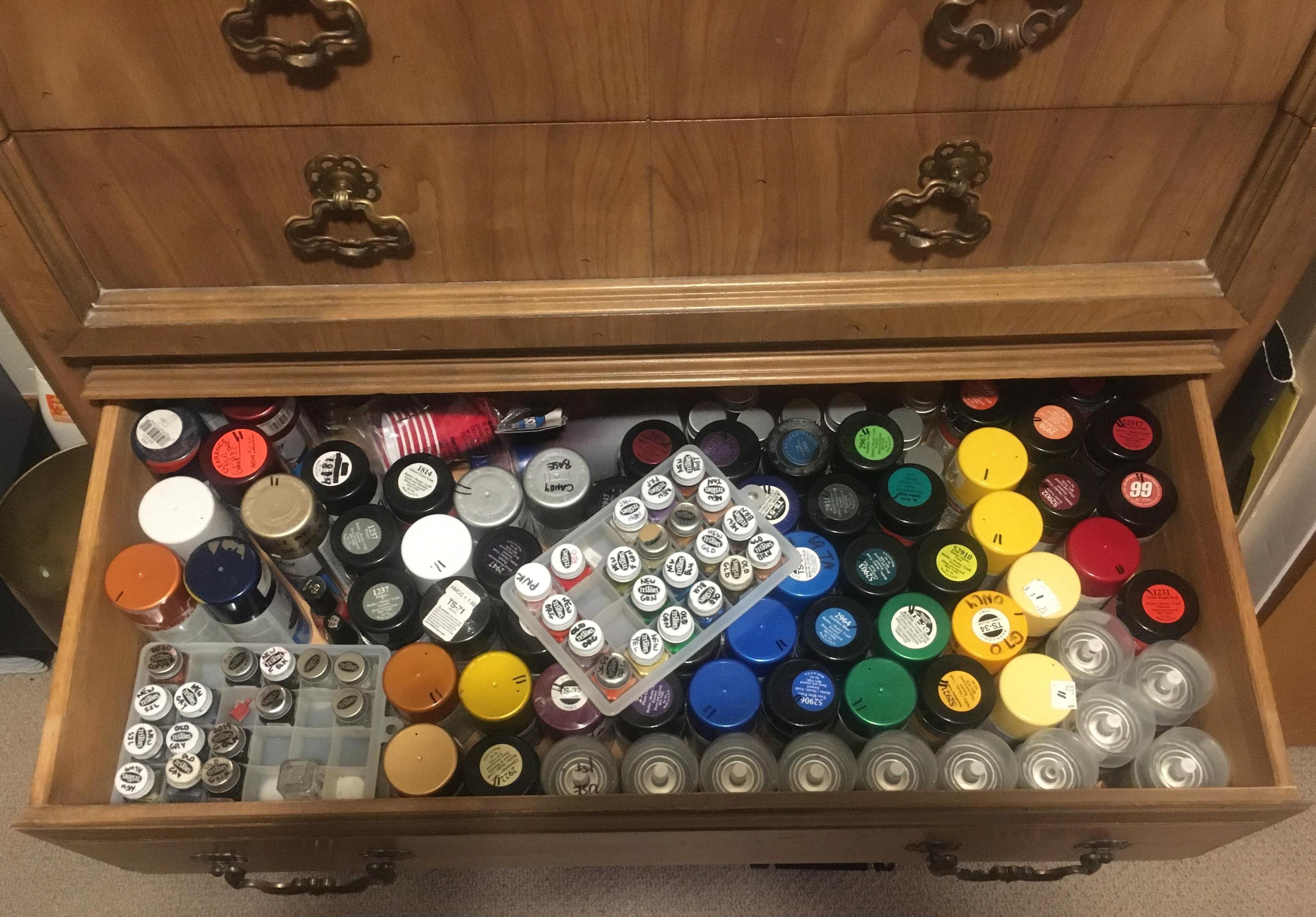

Bills72sj Posted April 16, 2022 Author Posted April 16, 2022 On 4/16/2022 at 1:52 AM, Dpate said: I love this thread so much. Congrats on moving into airbrushing. I started the hobby using a iwata eclipse, and now have a total of 4 brushes including the PS.290 which is a beast. I to have quite a few tamiya rattle cans because i didn't know about scalefinishes or MCW at the time. I also have a ton of tamiya LP bottles, and Mr.hobby ( especially there primers), dspiae paints, alclads etc etc. The tamiya rattle can line up has certain colors you cant get in the LP line up so that's why i will still sometimes get a can and decant it myself. $8 for little over 40ml of paint is cheaper than $2.50 per 10ml bottle. https://www.ebay.com/itm/233180864265?ssPageName=STRK%3AMEBIDX%3AIT&_trksid=p2060353.m2749.l2649 that's who i order my tamiya paint jars from. He's the cheapest on ebay and cheapest you'll find them jars anywhere really unless it's changed in other places. Tamiya jars are amazing fantastic air tight seal. Also if i may add a recommendation and that would be in the future if you haven't already is to upgrade to a tank compressor like one spraygunner.com sales called "No - Name" amazing compressor and big enough tank for airbrushing. Also better quality thinners like Mr hobby leveling thinner to thin ALL tamiya paints and mr hobby. Expand Dusty, I do need to eventually switch up paints. Right now I have two drawers full of rattle can paints. I am giving up on the Duplicolor cans. The paint has adhesion problems over Tamiya primer and is nearly $15 a can. I have recently switched to Mr Hobby primer. I like how smooth it lays down. Regarding a tanked compressor, I have looked into it a little bit. My existing compressor seems to keep up just fine. At this point however, I simply do not have the space for one. (I have also run out of space for kits)
StevenGuthmiller Posted April 17, 2022 Posted April 17, 2022 On 4/16/2022 at 10:34 PM, RJL said: I buy Tamiya paints at Hobby Hut in Fargo, ND Expand Yes, but even there it has been a pretty recent development. I don’t recall if they had a few Tamiya paints before or not, but their paint line has changed considerably in the past year or so since Testors hit the skids. They now carry a lot of Tamiya and Mr Hobby paints as well as some others, including some MCW enamels. Steve
Dpate Posted April 17, 2022 Posted April 17, 2022 On 4/16/2022 at 10:52 PM, Bills72sj said: Dusty, I do need to eventually switch up paints. Right now I have two drawers full of rattle can paints. I am giving up on the Duplicolor cans. The paint has adhesion problems over Tamiya primer and is nearly $15 a can. I have recently switched to Mr Hobby primer. I like how smooth it lays down. Regarding a tanked compressor, I have looked into it a little bit. My existing compressor seems to keep up just fine. At this point however, I simply do not have the space for one. (I have also run out of space for kits) Expand Yes Mr. Hobby primer is amazing. I have lots of the grey and black and pink. Another amazing primer even though it's in a can is ammo by migs titan hobby primer. The black and grey are the best & it's 400ML cans.
