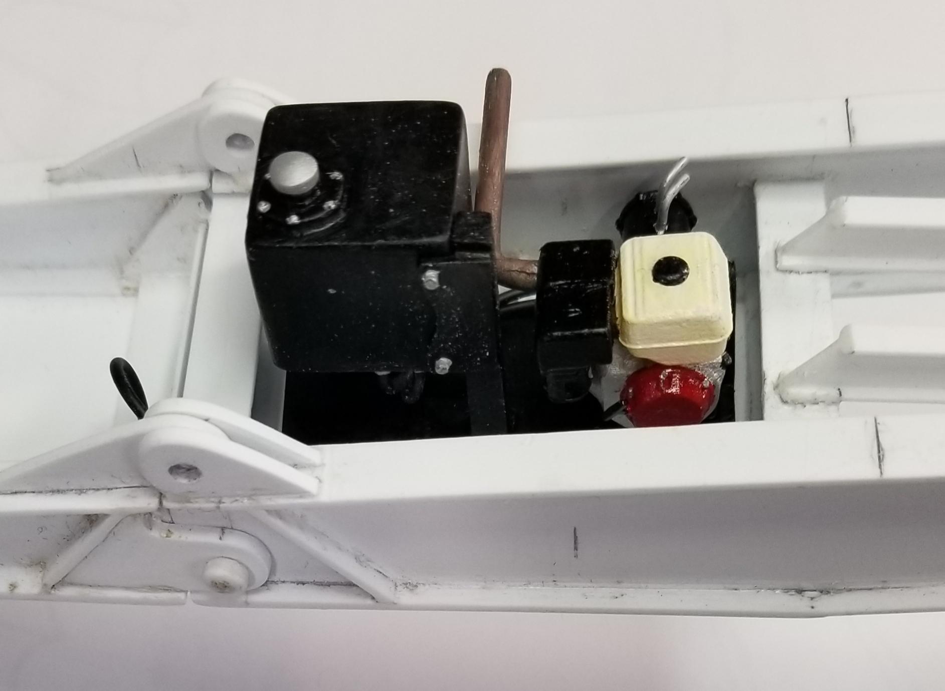

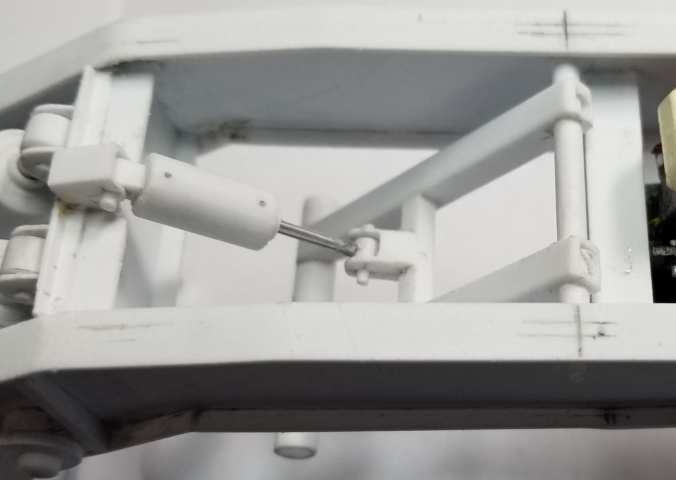

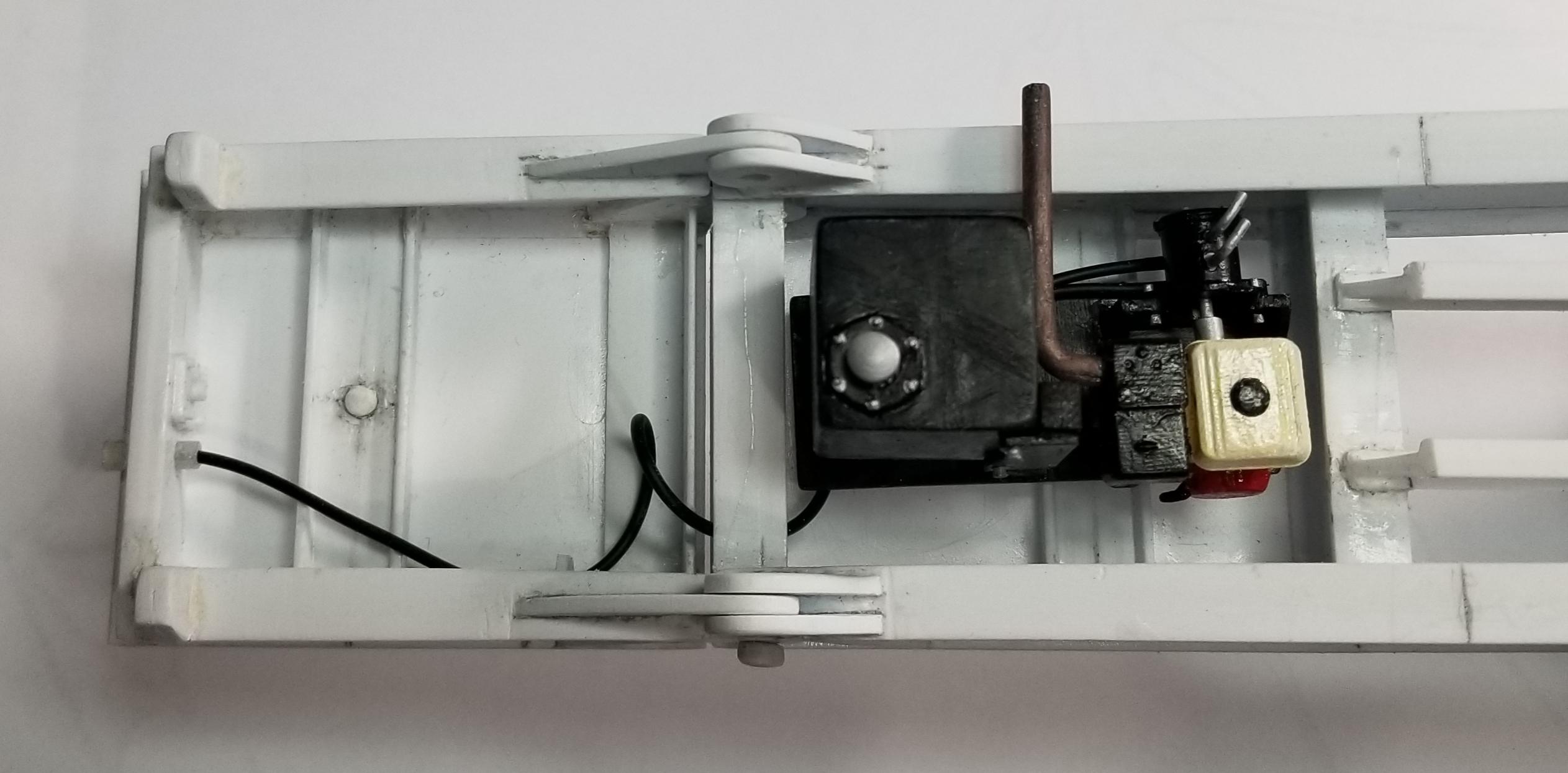

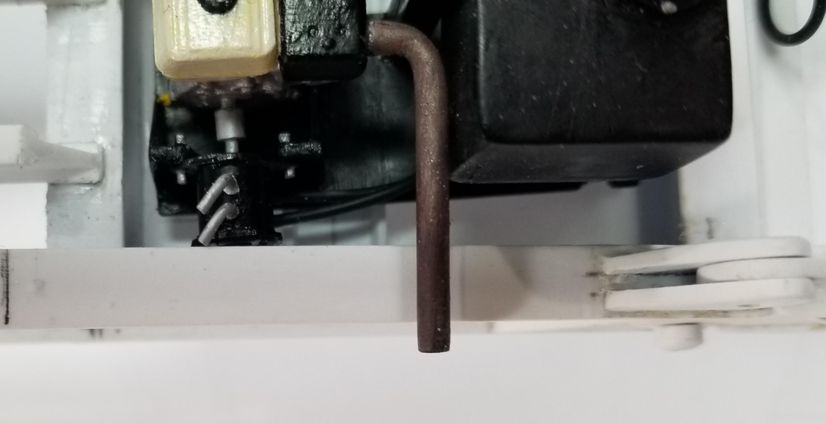

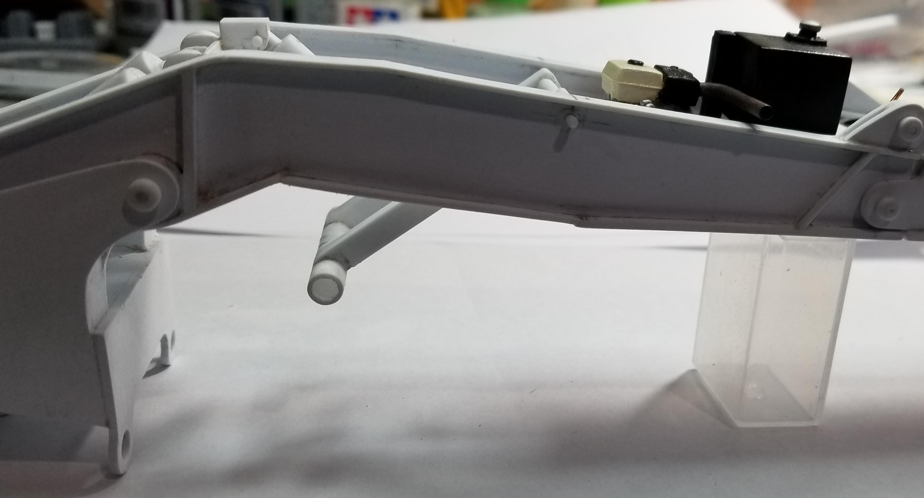

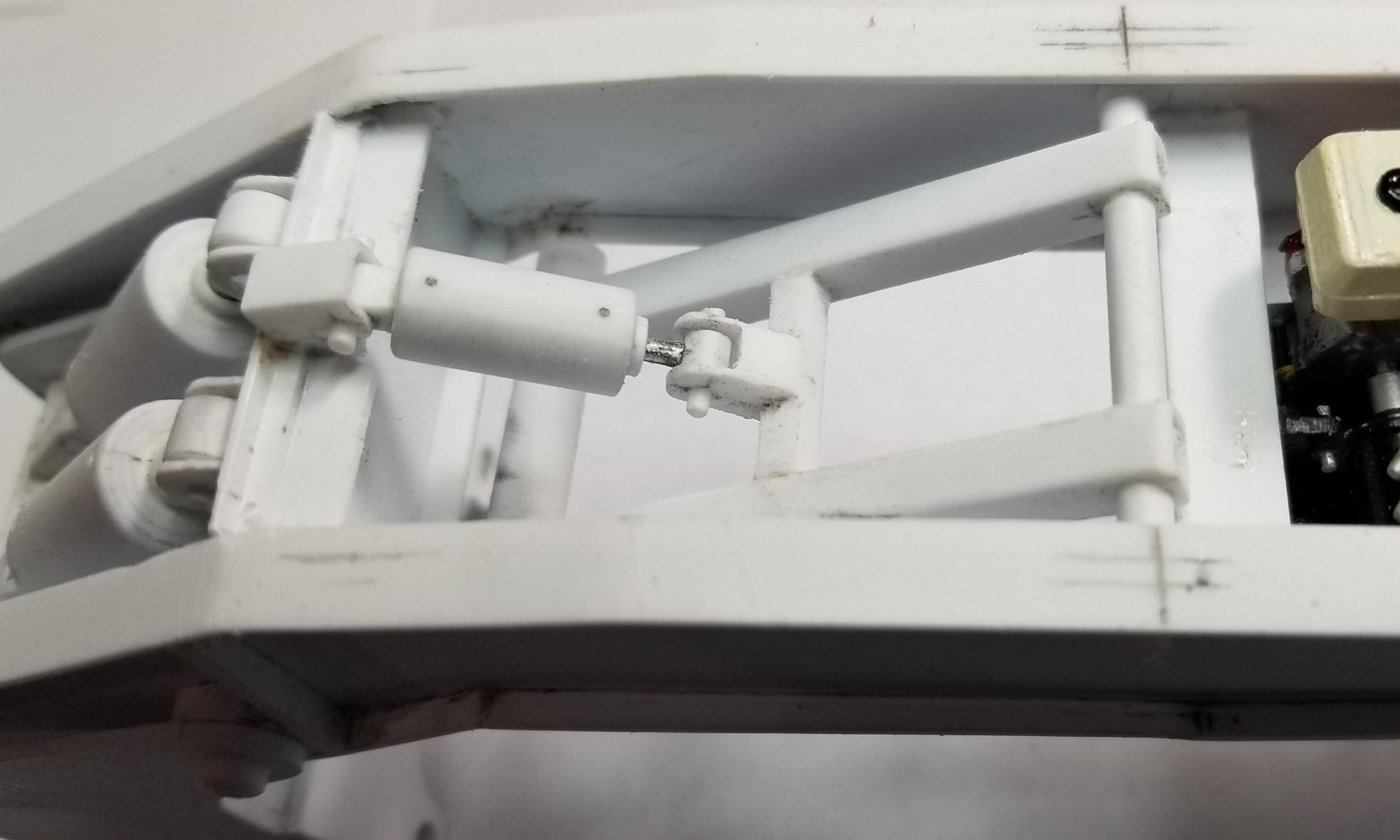

ShakyCraftsman Posted January 16, 2021 Author Share Posted January 16, 2021 (edited) Hey bigred Nope, I'm going to make a 6 to 8 foot long shelf that will simulate a two lane road to display it on. Hey all I've been working on the gooseneck of the trailer. I have the hydraulic power pack done and painted. this view shows the complete hydraulic power pack. It's kind of hard to see the hydraulic lines because they are black and so is the power pack. The line on the right is the feed line that goes to the front of the flip section to a fitting where the tractor hydraulic system would hook up. The hydraulic pump and the motor are on the left. this view shows the Honda 13hp engine and hydraulic pump, also the exhaust pipe that I added. The silver colored lines/fittings are the feed and return lines to the main hydraulic cylinders. this view shows the hydraulic tank and lines/fittings. this view shows the fitting for the feed line from the tractor. this view shows the hydraulic power pack sitting in place on the gooseneck. this view shows the feed line from the fitting in front of the flip section to the hydraulic tank this view shows the exhaust pipe clearing the frame. I also created from plastic and aluminum tubing the gooseneck support system and hydraulic cylinder. this view shows everything added to the gooseneck. this view shows the gooseneck support system in the up/retracted position. this view shows the gooseneck support system in the down/extended position. another view showing the gooseneck support system in the down position. Well that's it for now be back with more soon. Ron G Edited January 16, 2021 by ShakyCraftsman Quote Link to comment Share on other sites More sharing options...

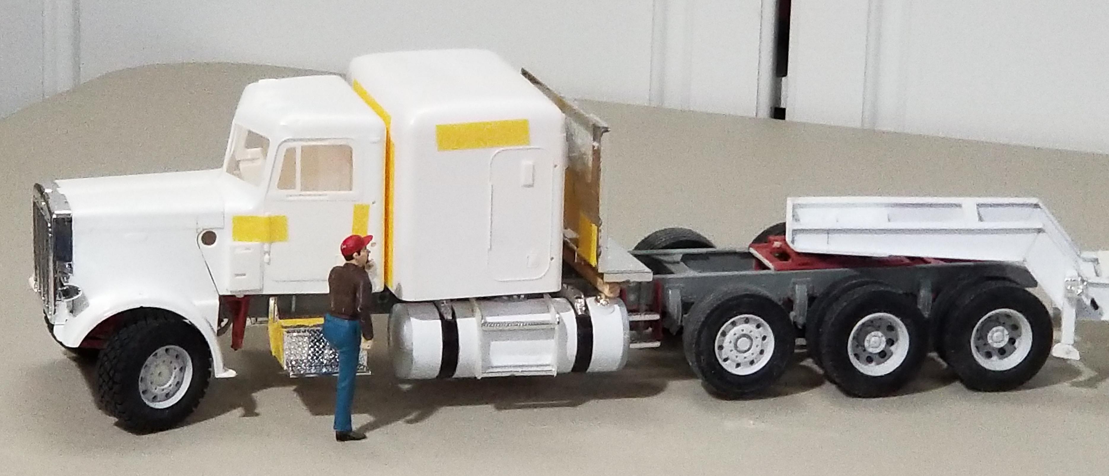

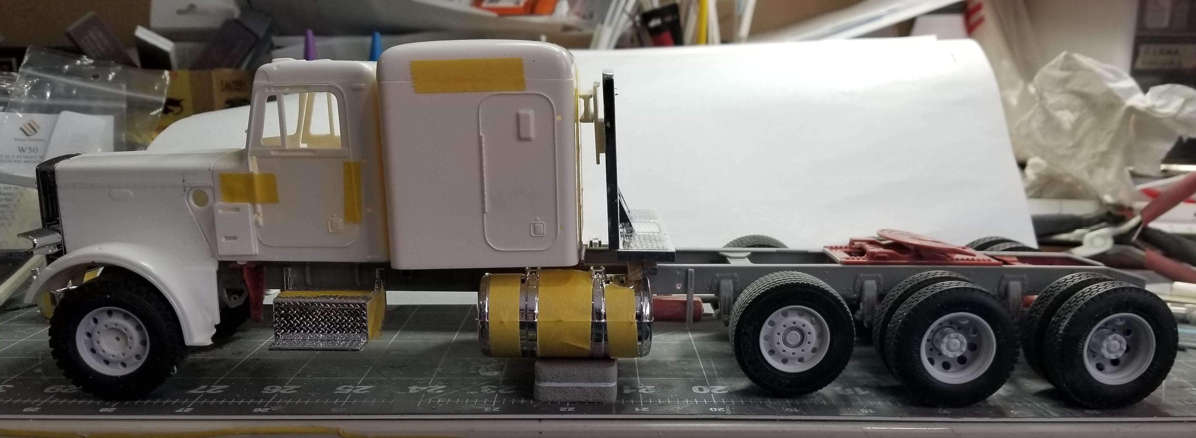

ShakyCraftsman Posted January 18, 2021 Author Share Posted January 18, 2021 (edited) Hey all Ok, I shortened it to a 280" W/B. I think it looks right now. this view shows the headache rack sitting in place, also it shows the rear of the fuel tank were the new 200 gallon fuel tank will be. It will be 28" diameter x 90" long. I'm going to be making it from 1" PVC pipe, which is actually 1.125" diameter, 28" in 1/25th scale. this view is more of a side view of the tractor. I also started on making the XL 80 jeep. I decided to go with a two axle jeep instead of a three axle one. The loads I have for the trailer aren't quite large enough to justify a 3 x 3 x 3 so it's going to be a 2 x 3 x 2 set up. this view shows the tractor, jeep and gooseneck of the trailer.side view of the rear of the tractor and the jeep. this shows the jeep in it's beginning stage. Well that's it for now be back with more soon. Ron G Edited January 18, 2021 by ShakyCraftsman Quote Link to comment Share on other sites More sharing options...

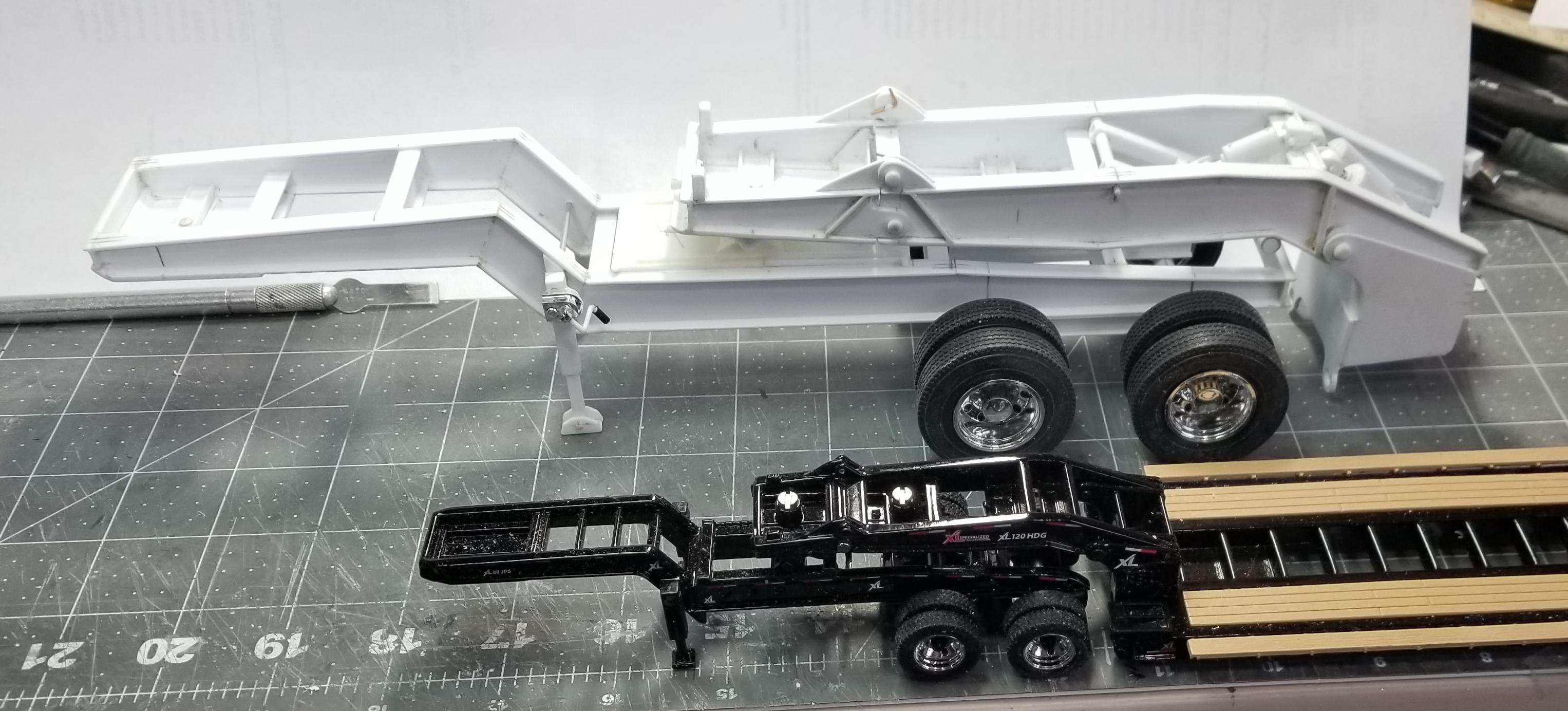

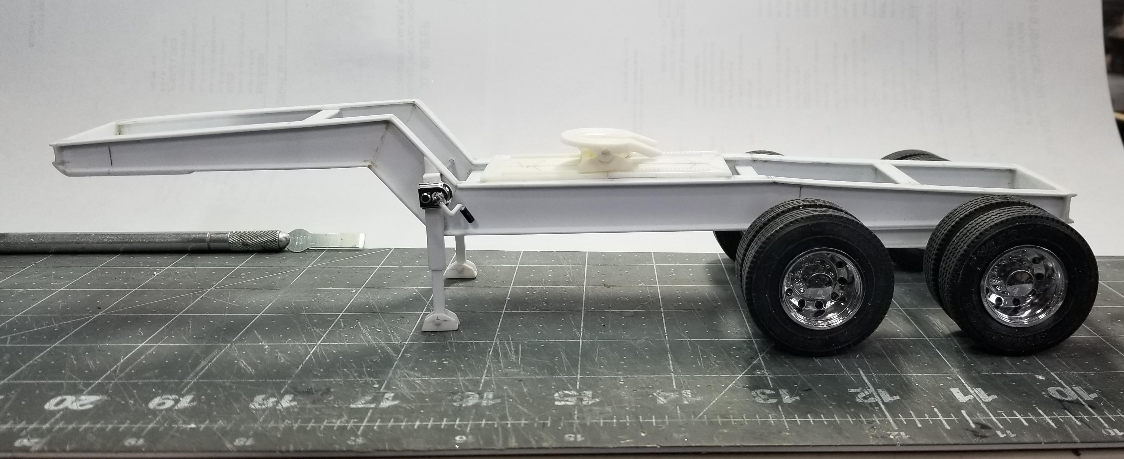

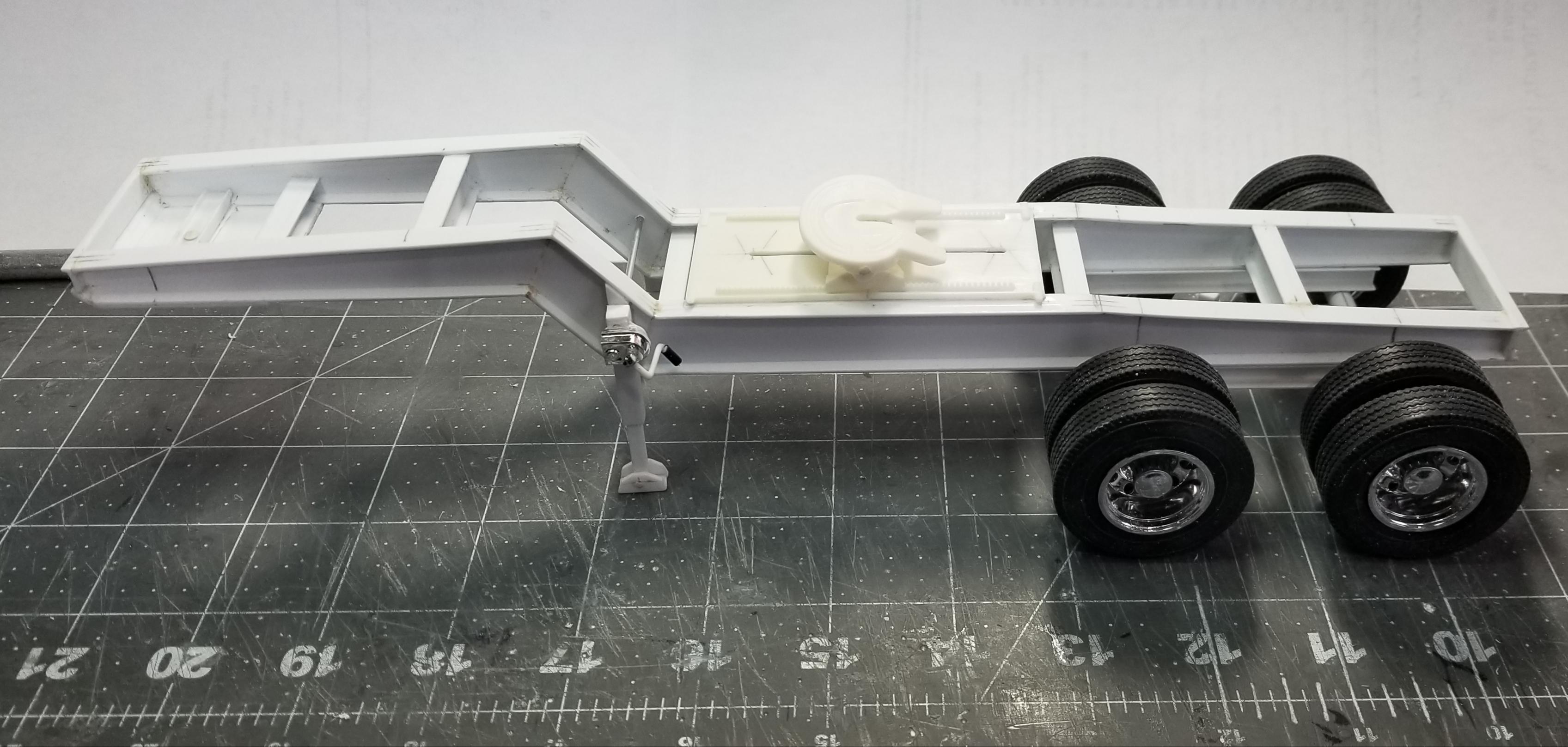

ShakyCraftsman Posted January 19, 2021 Author Share Posted January 19, 2021 (edited) 3 hours ago, Mopar - D said: Ron your scratch building just keeps getting better with this build! I’m looking forward to seeing some paint on this project. Yeah, me too, but that's quite a ways off. Did a little more work on the XL 80 jeep. I have the landing legs made and installed. I used parts from the AMT twin trailer (Consolidated Freight) kit to help make the legs. I added the fifth wheel plate and fifth wheel permanently. I made the fifth wheel movable for/aft, but still fixed to the jeep. this view shows the landing legs, fifth wheel and wheels/tires sitting in place. side view of the XL 80 jeep. this view shows the jeep next to the 1/50th scale one from Diecast Masters. this view shows the jeep with the gooseneck sitting on it, also you can see the 1/50th XL 80 jeep and XL 120 HD lowboy trailer. this view shows my 1/25th scale version of the 1/50th scale one from Diecast Masters. Well that's it for now be back with more updates soon. Ron G Edited January 19, 2021 by ShakyCraftsman Quote Link to comment Share on other sites More sharing options...

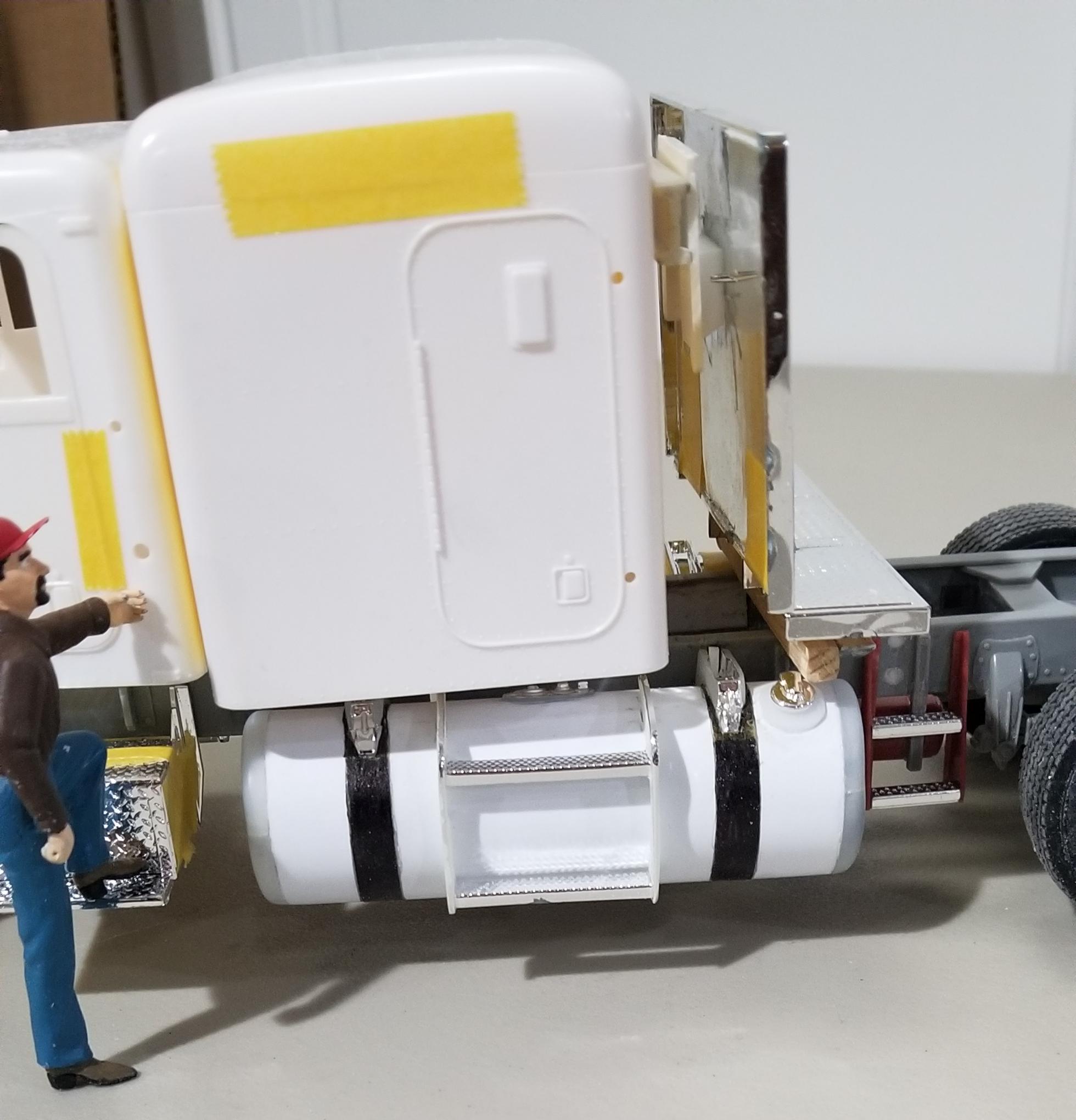

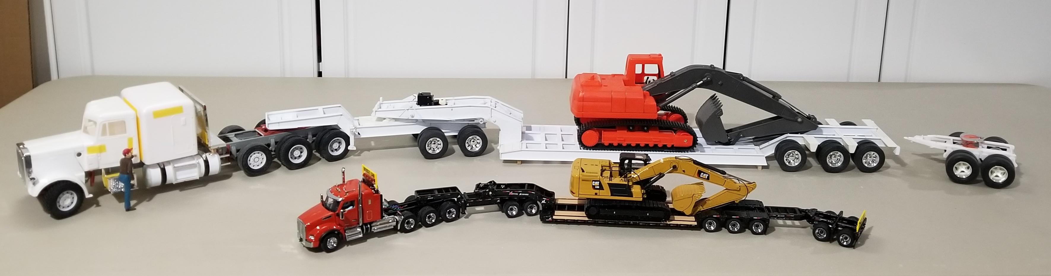

ShakyCraftsman Posted January 23, 2021 Author Share Posted January 23, 2021 (edited) Hey guys I did some work on my Peterbilt 359 heavy haul tractor. I made a new 28" diameter x 90" long 200 gallon fuel tank. this view shows the tractor and the new fuel tank. this view shows a closer look at the fuel tank and steps. I made this from a piece of 3/4" pvc pipe, it's actually 1.07" diameter, so to make it 28" diameter I Wrapped a piece of 0.03" sheet plastic around it to make it 28" diameter. I cut up the kit tank so I could use the peices on my tank. i put the whole thing together so I could see how long it is. YICKS!!! it's big! The excavator is a 1/32 scale Newray one, and the booster/stinger is actually the dolly from my Michigan gravel train project. here it is next to a 1/50th scale similar setup. Well that's it for now be back with more soon. Ron G Edited January 23, 2021 by ShakyCraftsman Quote Link to comment Share on other sites More sharing options...
