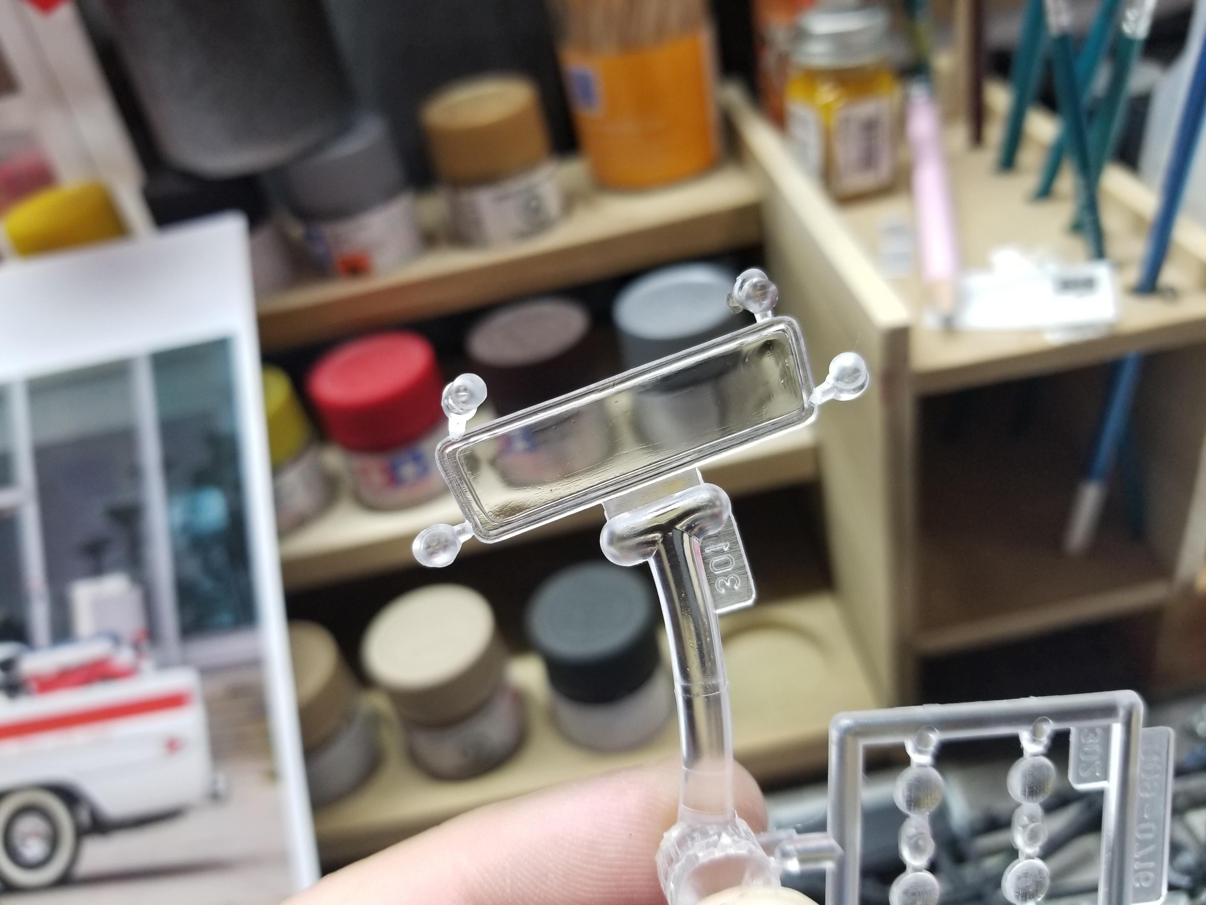

iamsuperdan Posted October 6, 2020 Posted October 6, 2020 What is the point of these little plastic tab things on plastic parts? Placement on kits seems pretty random to me. And why would this window piece require four of them?
Tom Geiger Posted October 6, 2020 Posted October 6, 2020 Those are the ejector pins. Much better than having them visible on the part itself
Danno Posted October 6, 2020 Posted October 6, 2020 The more a part has, the more assured complete flow of the molten plastic is to all areas of the part.
Jantrix Posted October 6, 2020 Posted October 6, 2020 On 10/6/2020 at 2:05 PM, Tom Geiger said: Those are the ejector pins. Much better than having them visible on the part itself Expand Or more exactly, they are extra material added for the ejector pins within the mold housing to push against, to push the part out of the mold. Like Tom said, much prefered than having pin marks in the plastic part itself.
peteski Posted October 6, 2020 Posted October 6, 2020 I don't know the official name for those, but like others have said, these are areas where the ejector pins will push the part out of the mold. If you look at every nub, you will see ejector mark on it. Those are used where it is not convenient to have ejector pins under the part itself. This either done on very small or thin cross-section parts that are too small to have ejector pin under them, or on clear parts where they would be marred by ejector marks. They have nothing to do with flow of the molten plastic.
