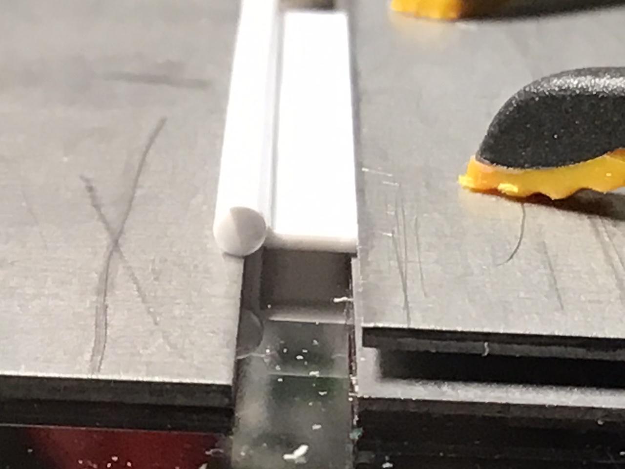

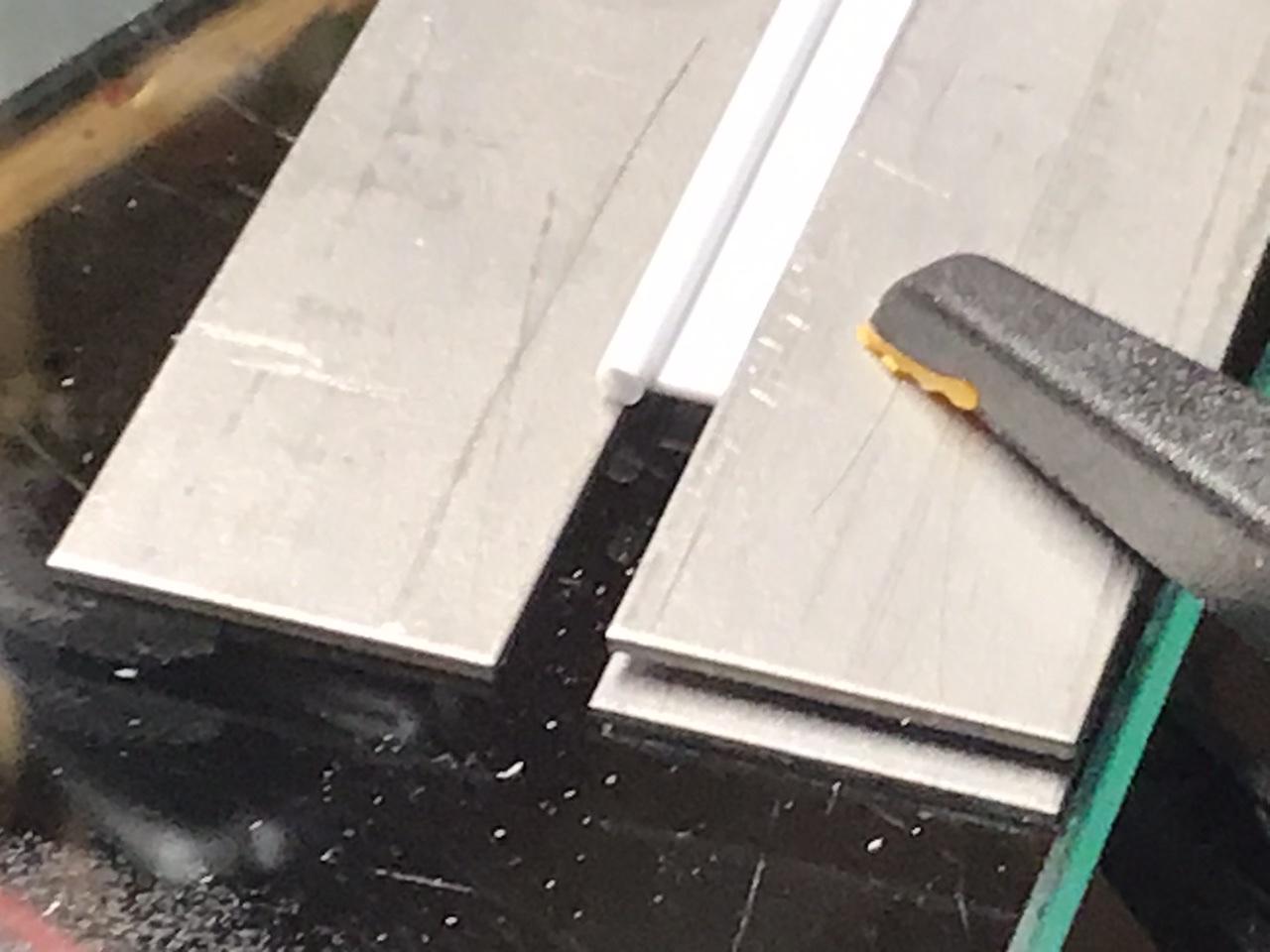

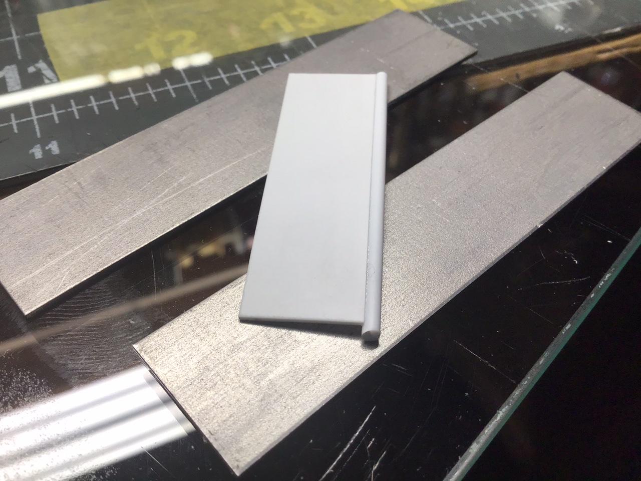

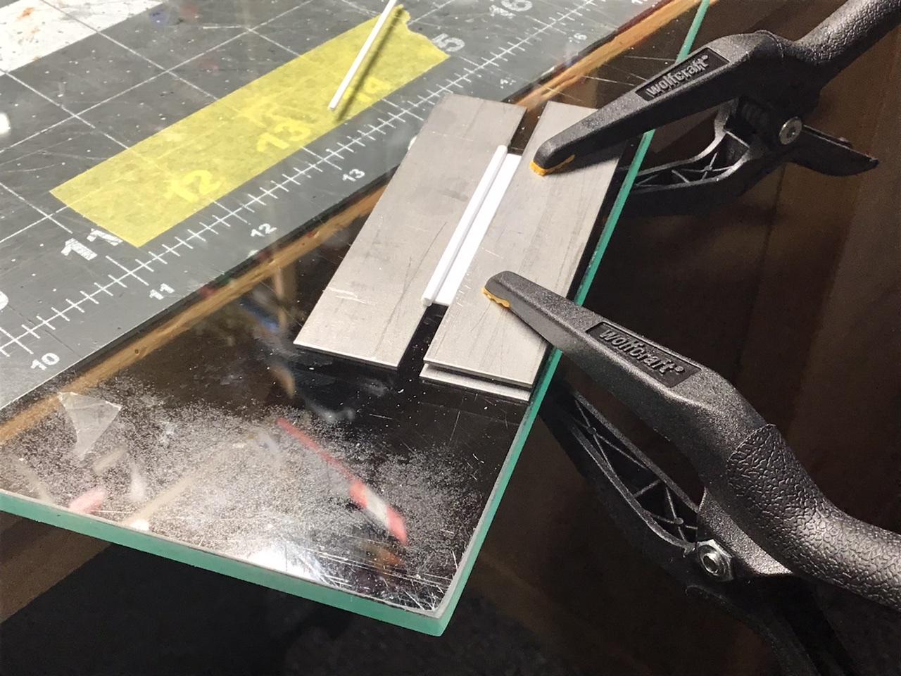

NOBLNG Posted November 3, 2020 Posted November 3, 2020 (edited) I want to glue round styrene rod to the edge of a styrene sheet so that it is flush on one side. I have done it before by filing a bevel on the edge of the sheet and laying both on a flat surface. I like to use Tamiya extra thin cement for this. The problem is the cement wicks under the parts and they are damaged by getting stuck to the surface. I came up with this idea to leave a void right where the glue joint will be. Now the cement will only seep along the joint itself. Edited November 3, 2020 by NOBLNG
PHPaul Posted November 3, 2020 Posted November 3, 2020 Nice! Creative jigs are a big part of scratch building, always glad to see new ideas.
peteski Posted November 3, 2020 Posted November 3, 2020 Place a piece of polyethylene (a cheap thin sandwich bag) under the glued parts. Neither the liquefied styrene, or glue will stick to it. I also do this when using CA.It also doesn't stick well to polyethylene. Wait for the glue to evaporate before peeling the sandwich bag off.
Chariots of Fire Posted November 18, 2020 Posted November 18, 2020 I recommend beveling the edge of the sheet stock first. This will give more of a surface for the rod to bond to. Same procedure as what you are using to keep it flush with one side.
GLMFAA1 Posted November 18, 2020 Posted November 18, 2020 Good ideas, I would also put a flat edge on the round piece to mate with the sheet stock greg
