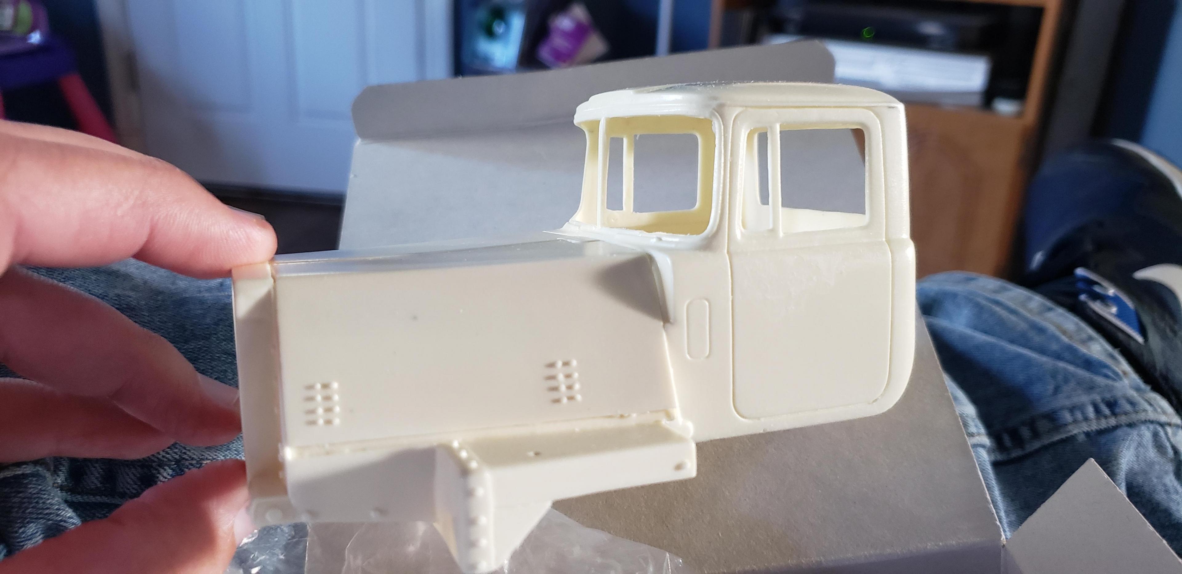

First up was finding a suitable cab . I chose the RM since their very popular around here for highway dept use and i knew where to find one! A quick call to aitm and the ball was rolling after a buddy arranged the specific parts id need to build the Mack.

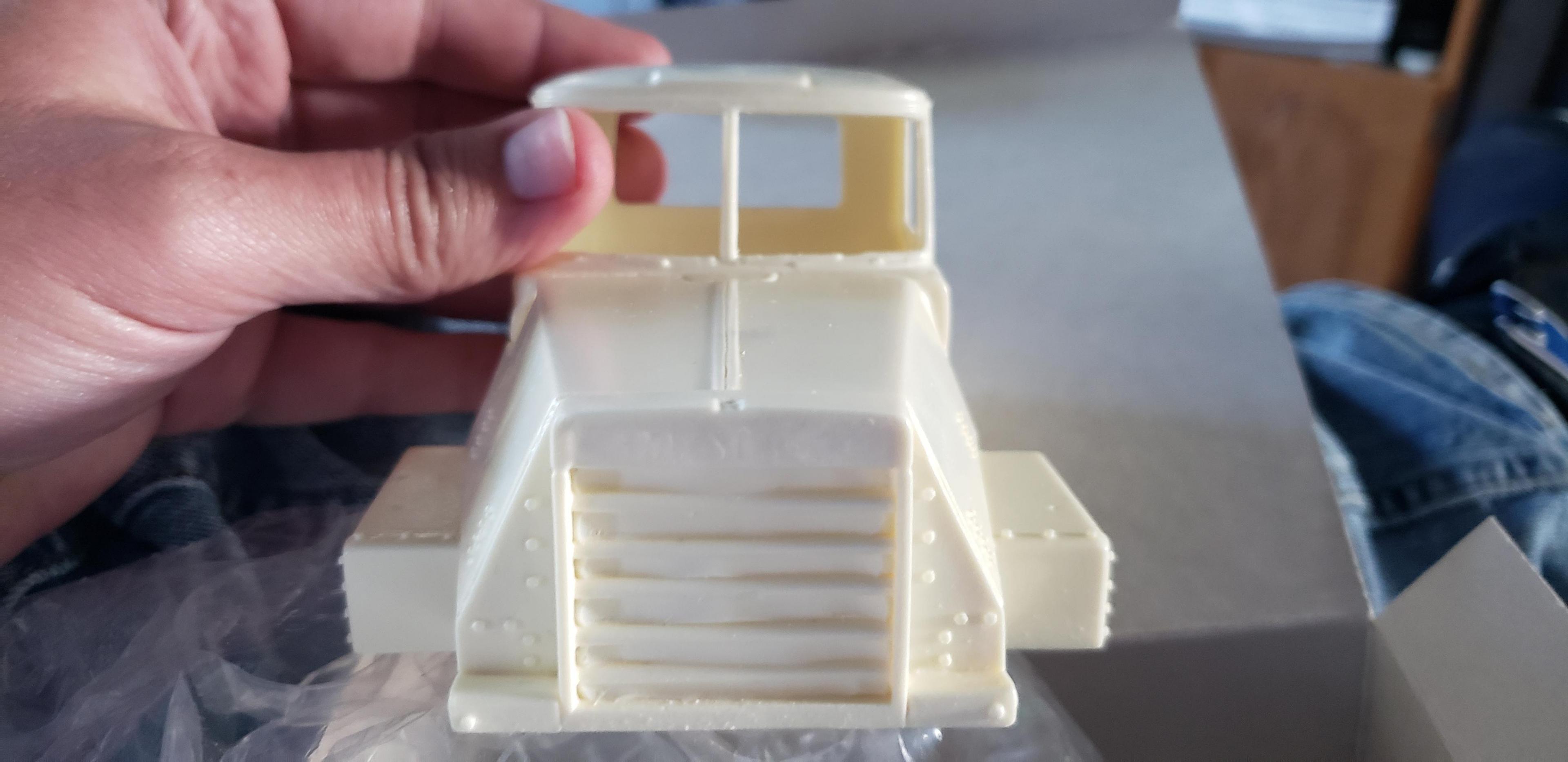

The frame was robbed from the reissued DM kit....and another box from Dave arrived w correct fuel tank, suspension and axles ..oh and those enormous 14x24 tires lolIMG_0486.jpg.c9fa6b00c1f34f5b1b12d403bbd75527.jpg

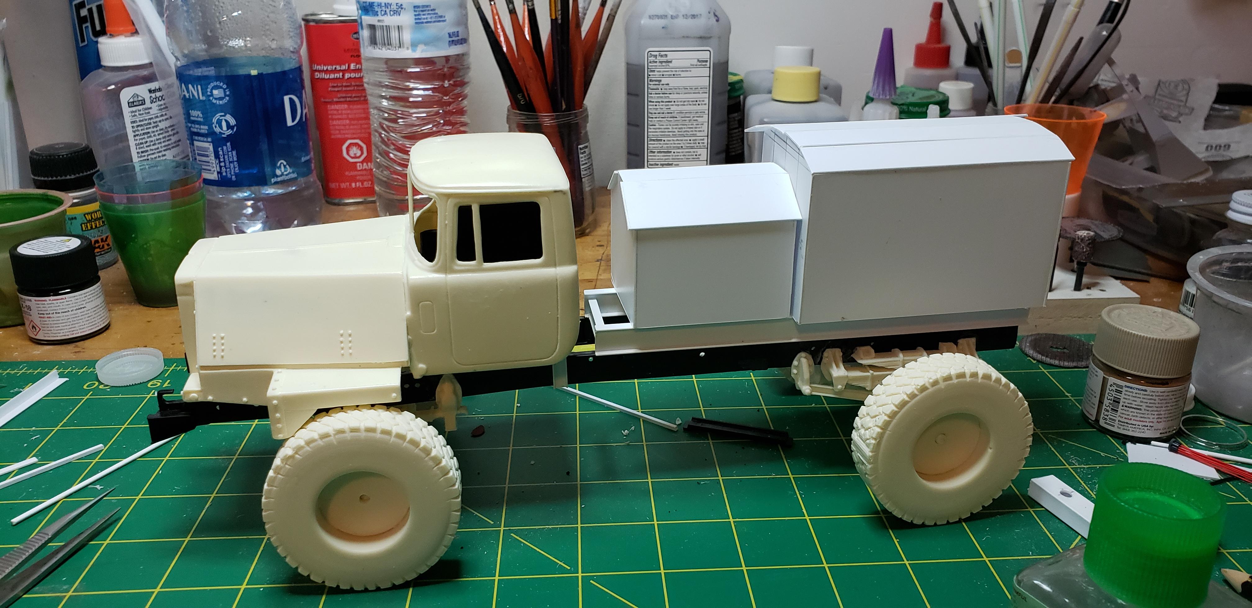

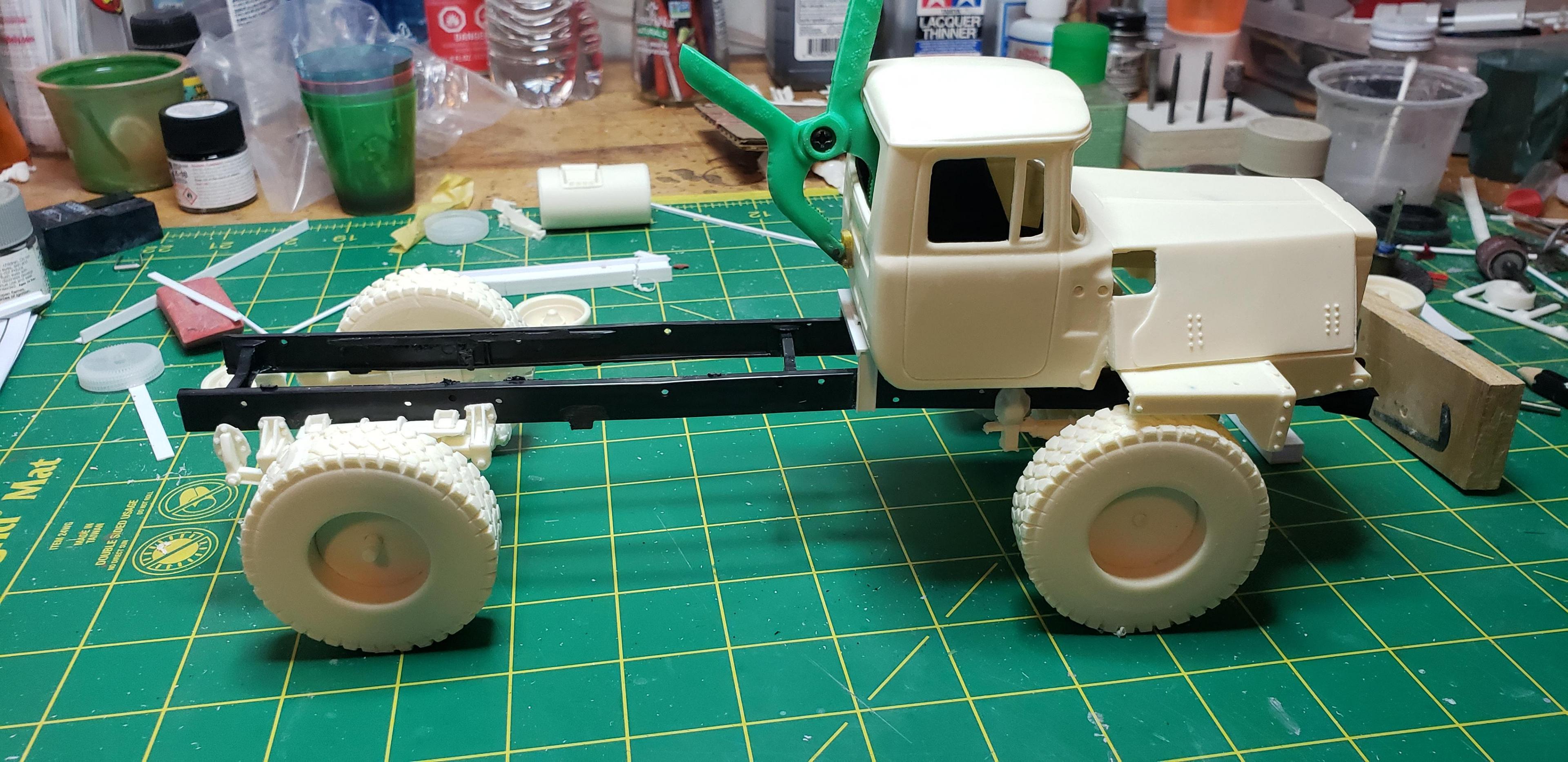

I literally stuck the cab on the mocked up frame,  eyeballed the suspension position and I had a rolling chassis.  Ill add a little frame extension out front later . These mock ups really keep me motivated to keep going !

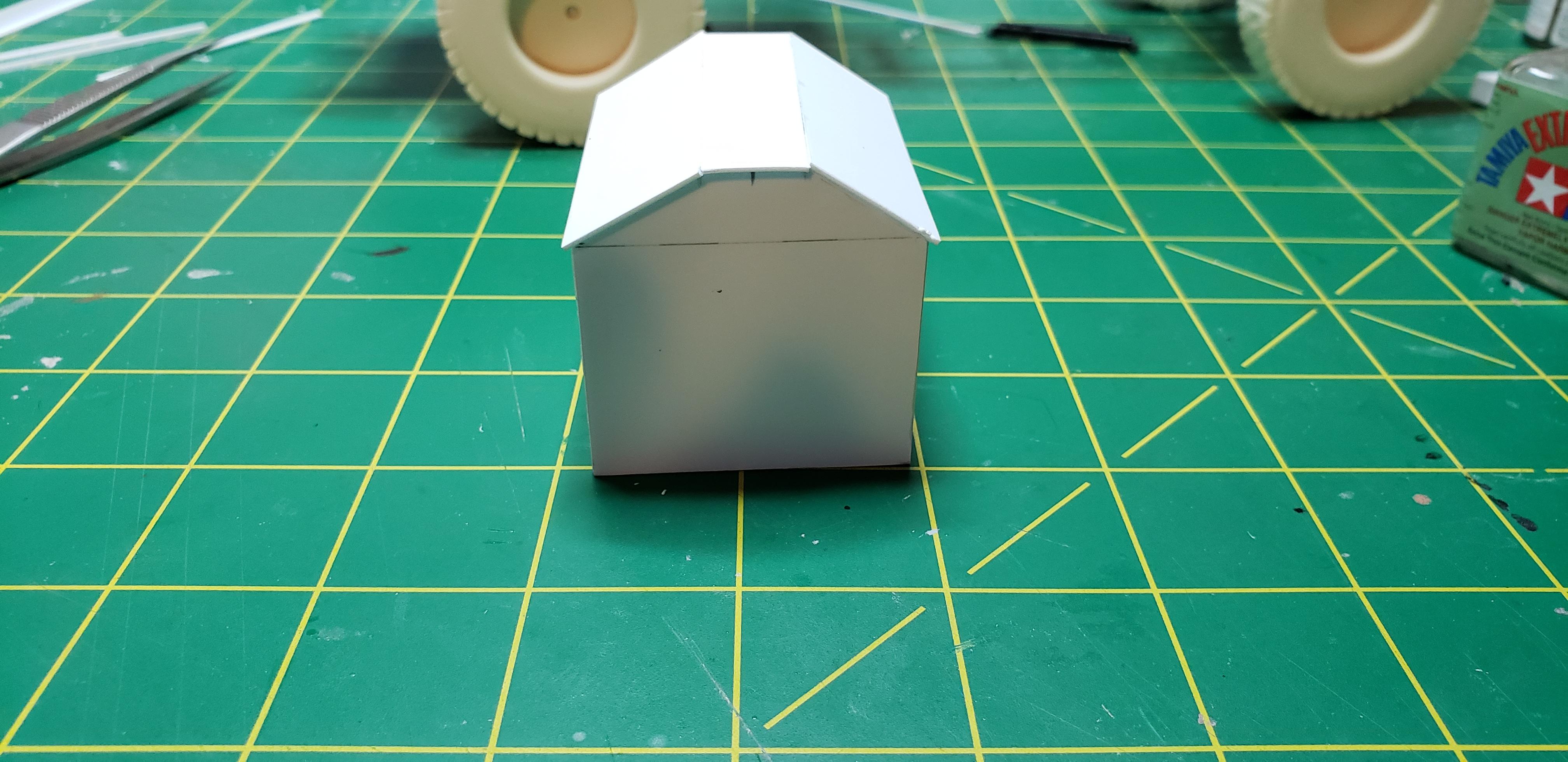

There's a couple compartments on the back for the blower engine , mine will be completely curbside...sorry...so I just bashed a couple together from sheet and will detail them out later when I get bogged down waiting for shear pins lol20201024_215602.thumb.jpg.8a115359ac0a1d7345bad637de459b48.jpg
Checking fit

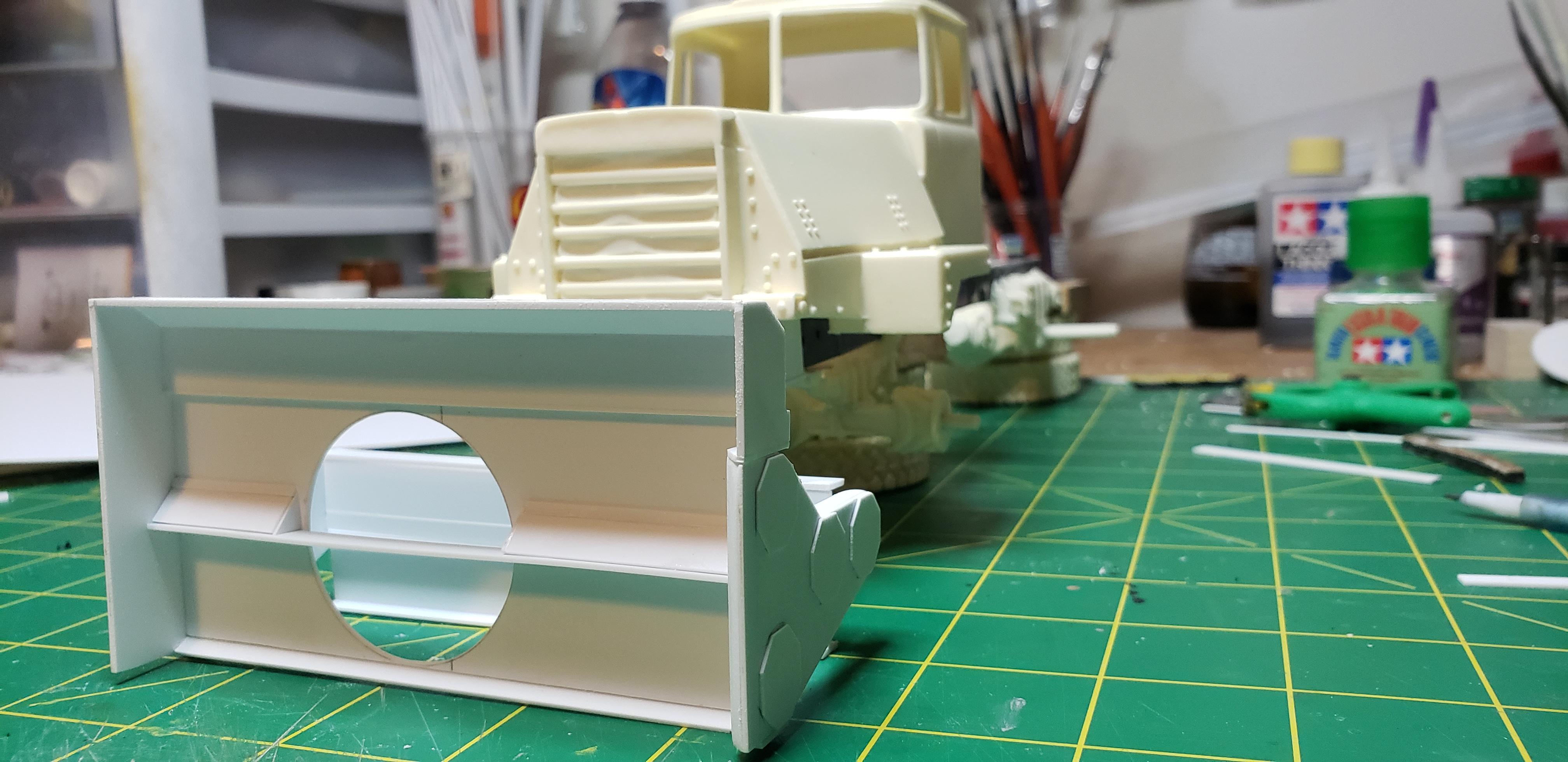

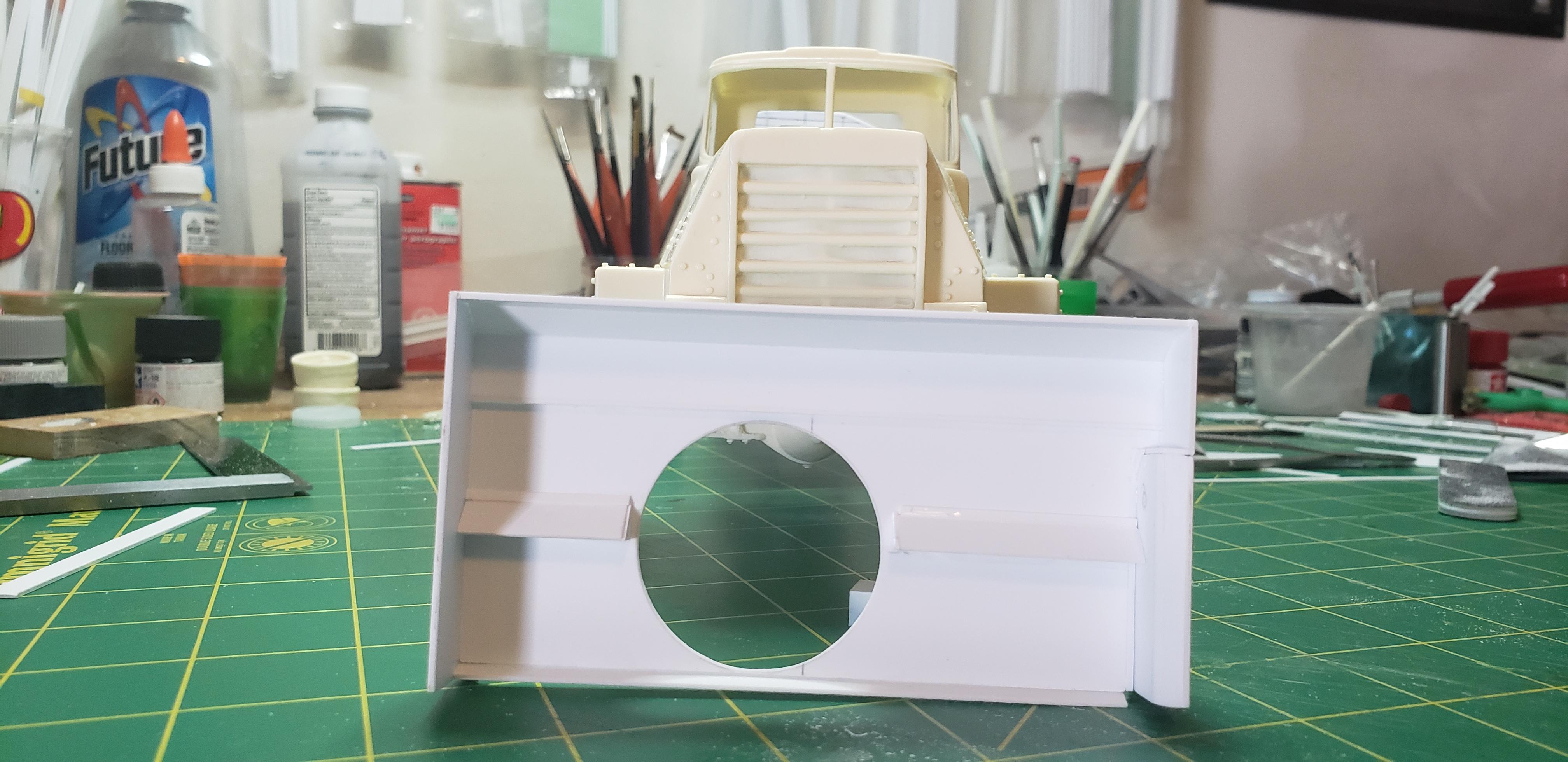

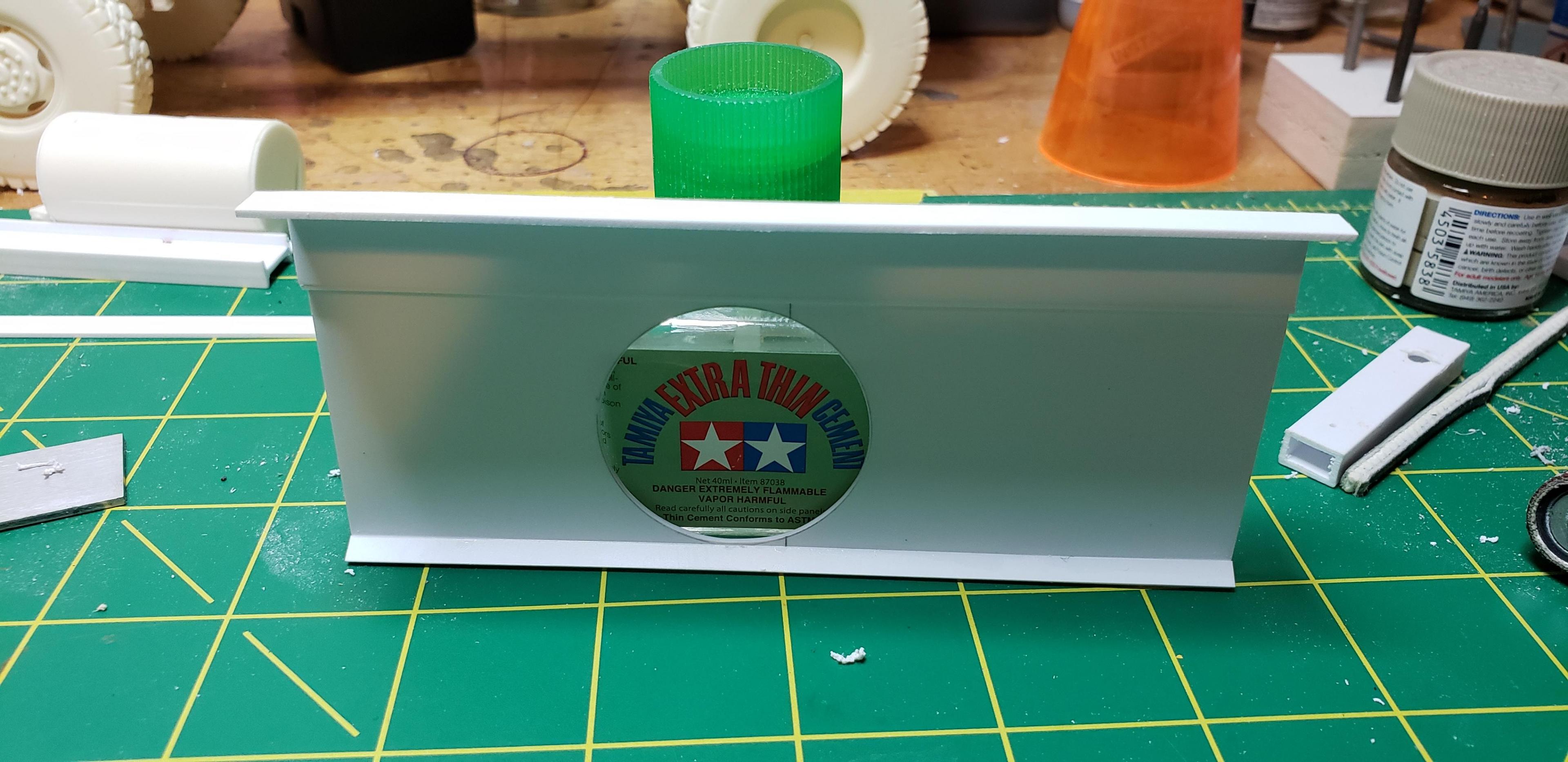

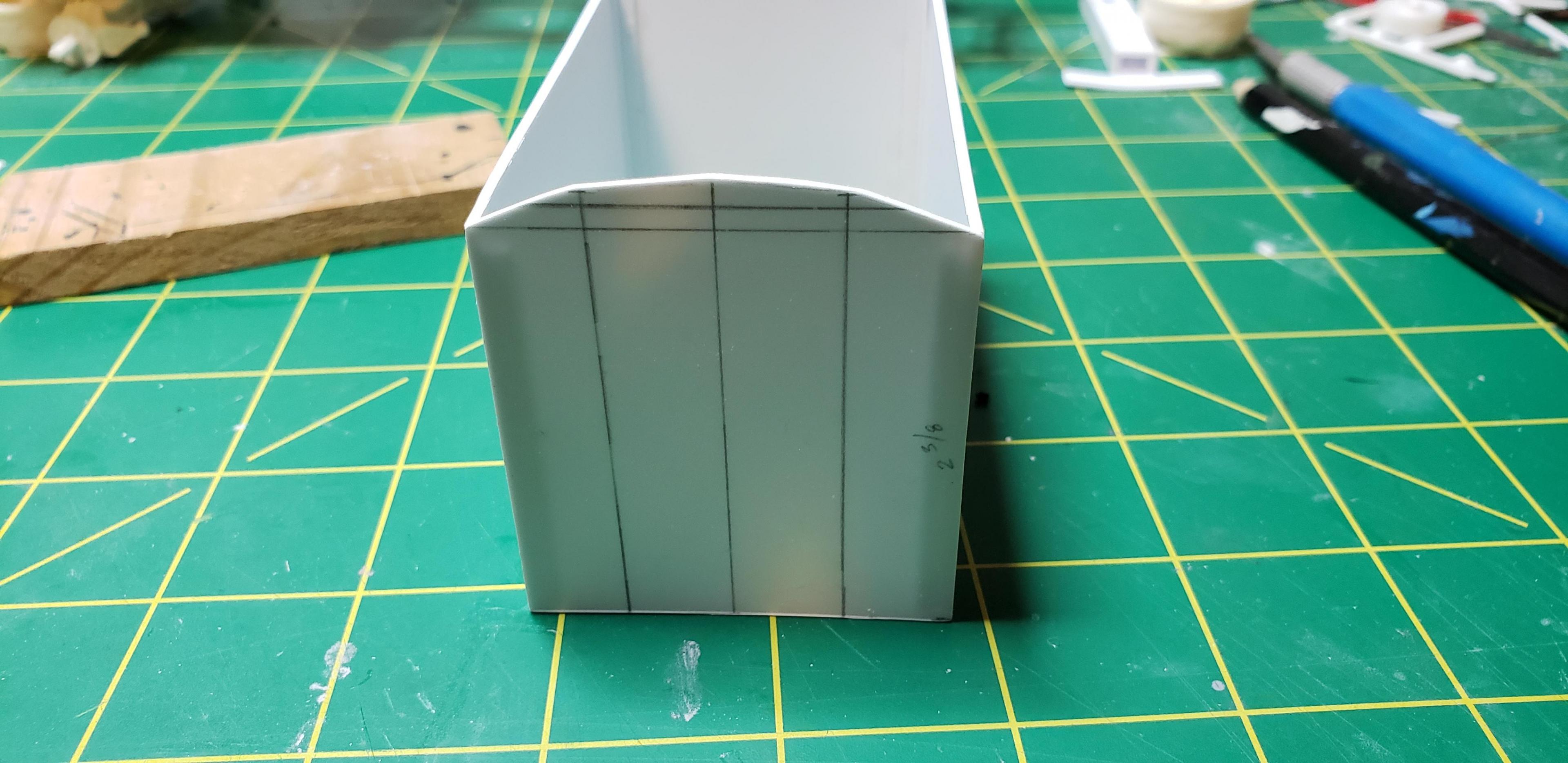

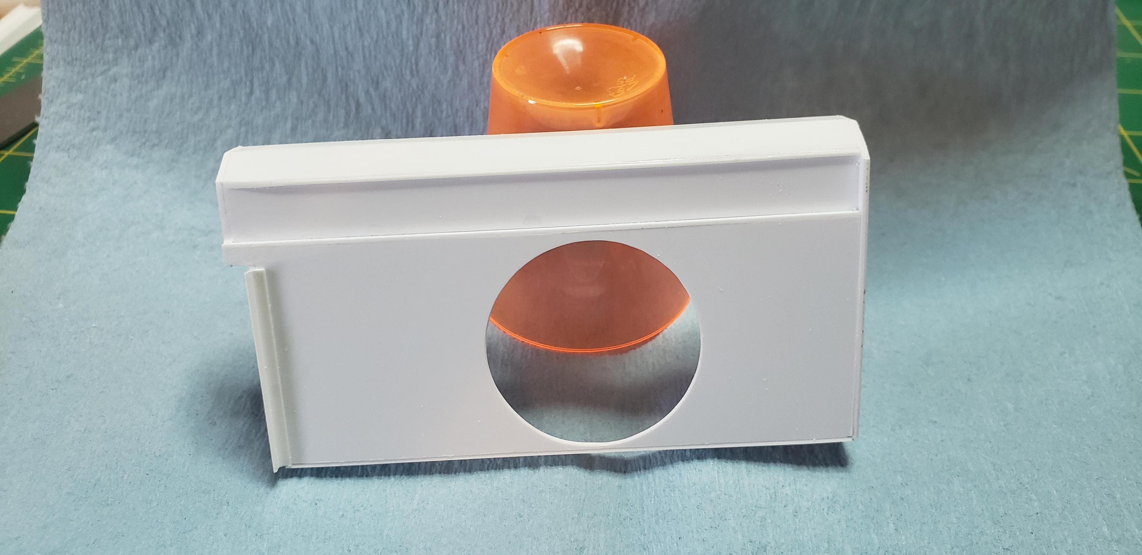

Anyway,  I started building up the head assembly,  mostly 040 sheet , starting with the back wall. It took me several photos to be convinced that the hole for the impeller was offset . A photo in his book showed an exploded view showing the offset opening...the backwall is 4 inches wide .

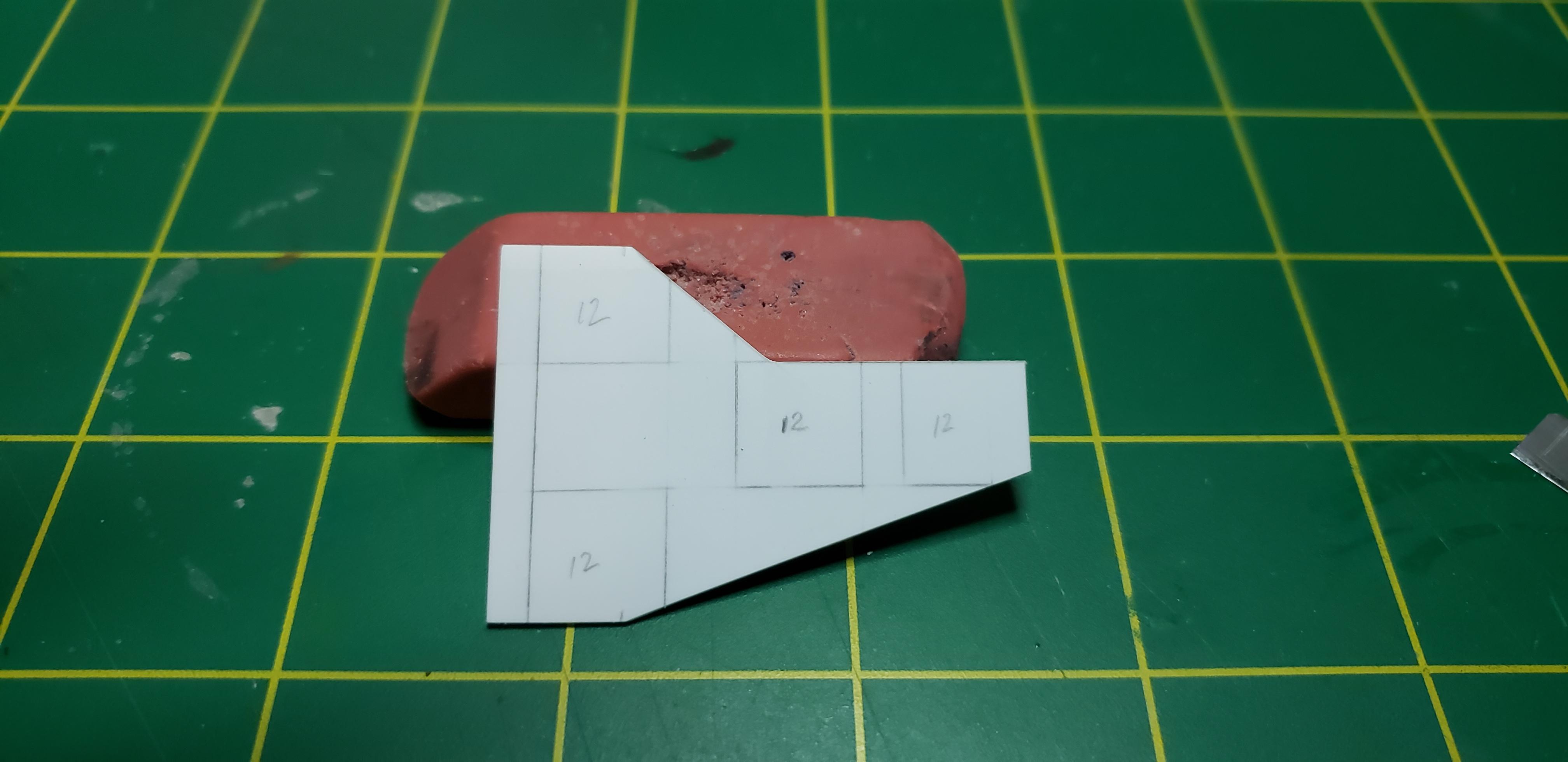

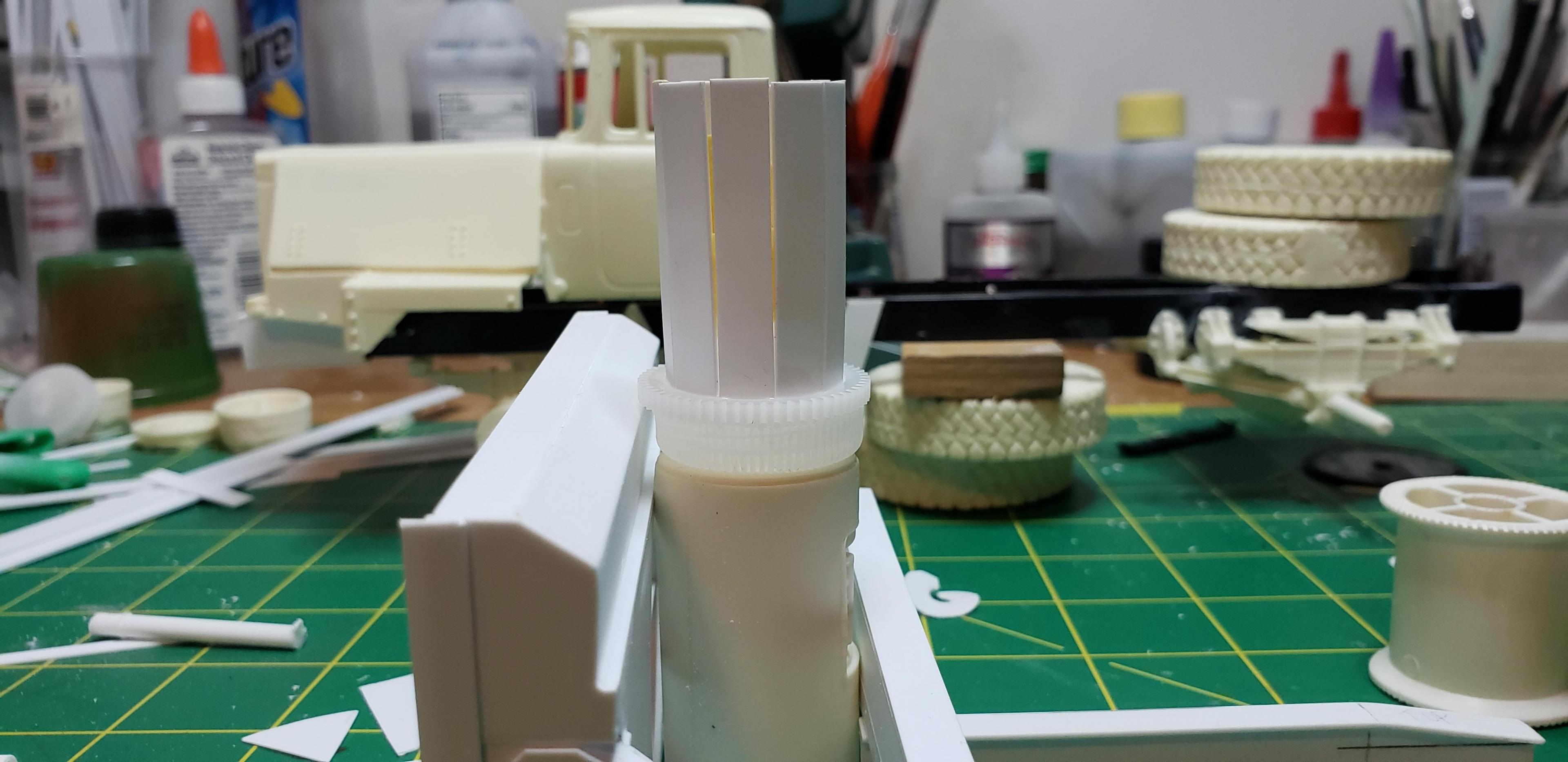

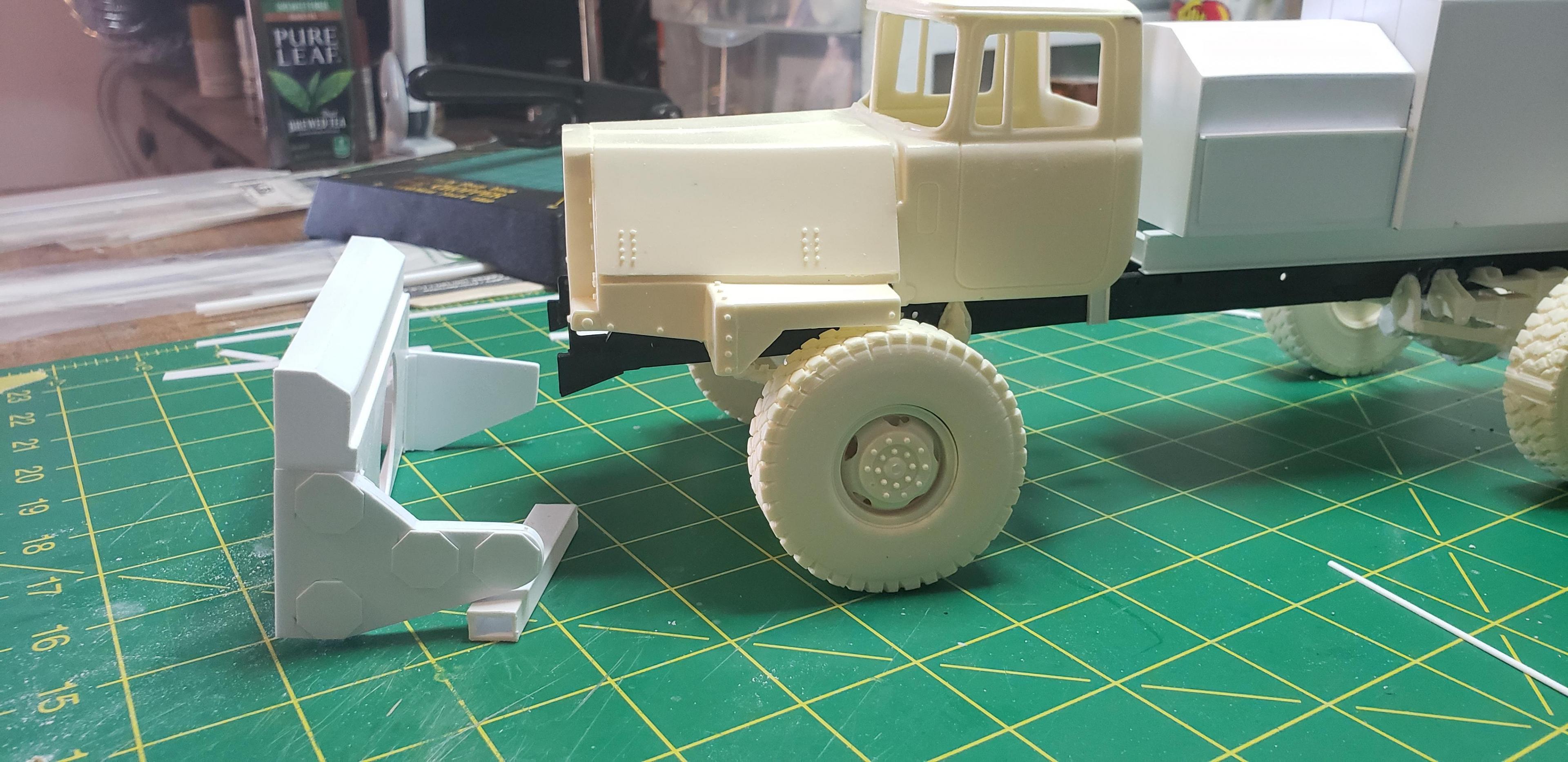

The street side is mainly the assembly that contains the drive train that runs the twin augers...massive 20 inch snow bank chewing teeth ! I based measurements off the 1:1 and gleaning sizes off the access panels.  Each were 12 inches . Laying out a pattern of lines then cutting away the waste left me a suitable side panel. I laminated several pieces to this making the gear box then added those access panels. 20201031_215515.thumb.jpg.0648a352e5d030054d40b646d2867371.jpg
20201107_103347.thumb.jpg.dca6b9c0c3b3c33e5a0f01eab654e92d.jpg20201107_103358.thumb.jpg.2728d8c41381f46c0d975f61849bfd34.jpg
More parts went on until I had a rough draft of the "bank head ".20201107_125604.thumb.jpg.3c945f152c146689d0c0bc976149822a.jpg

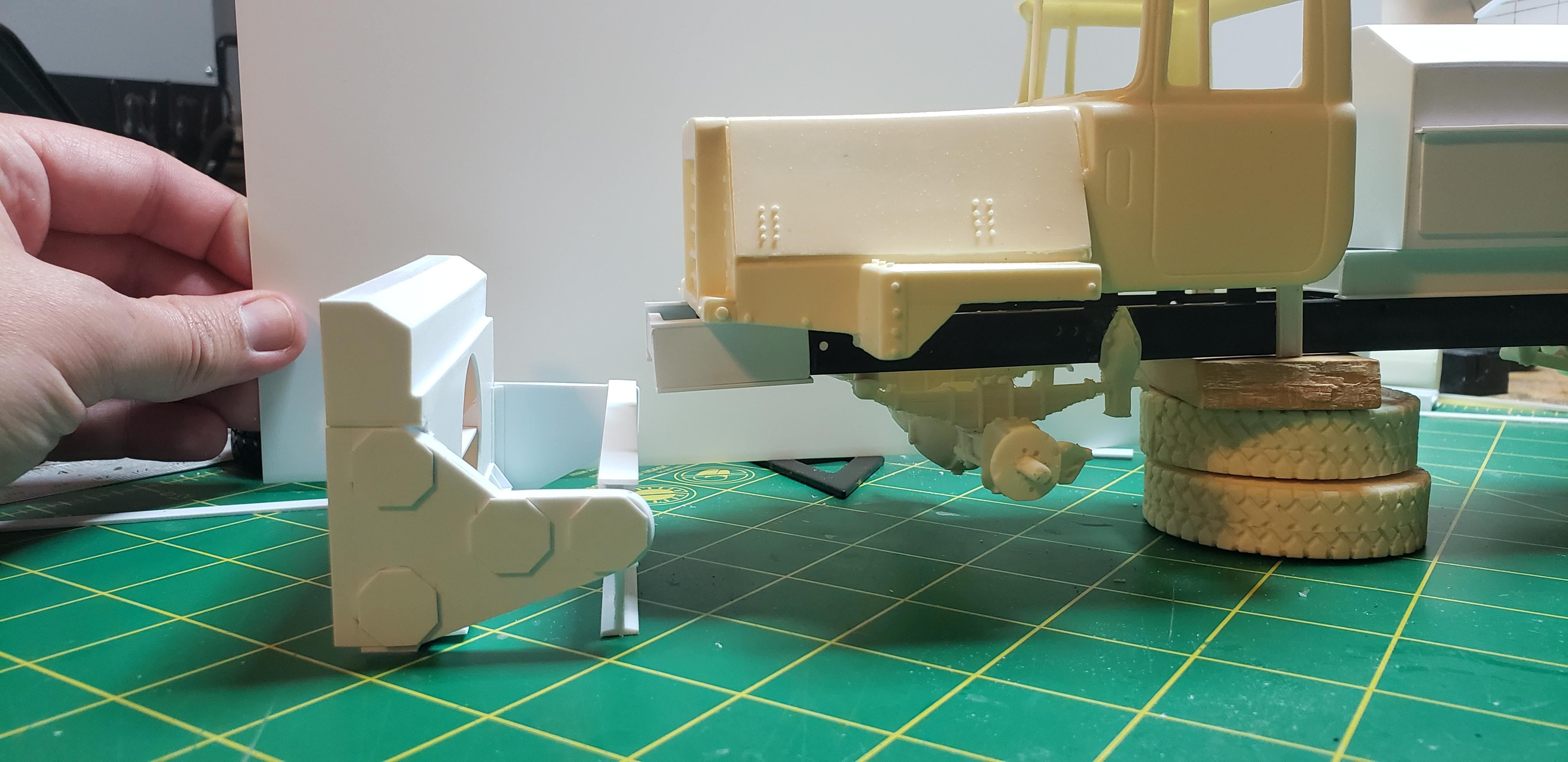

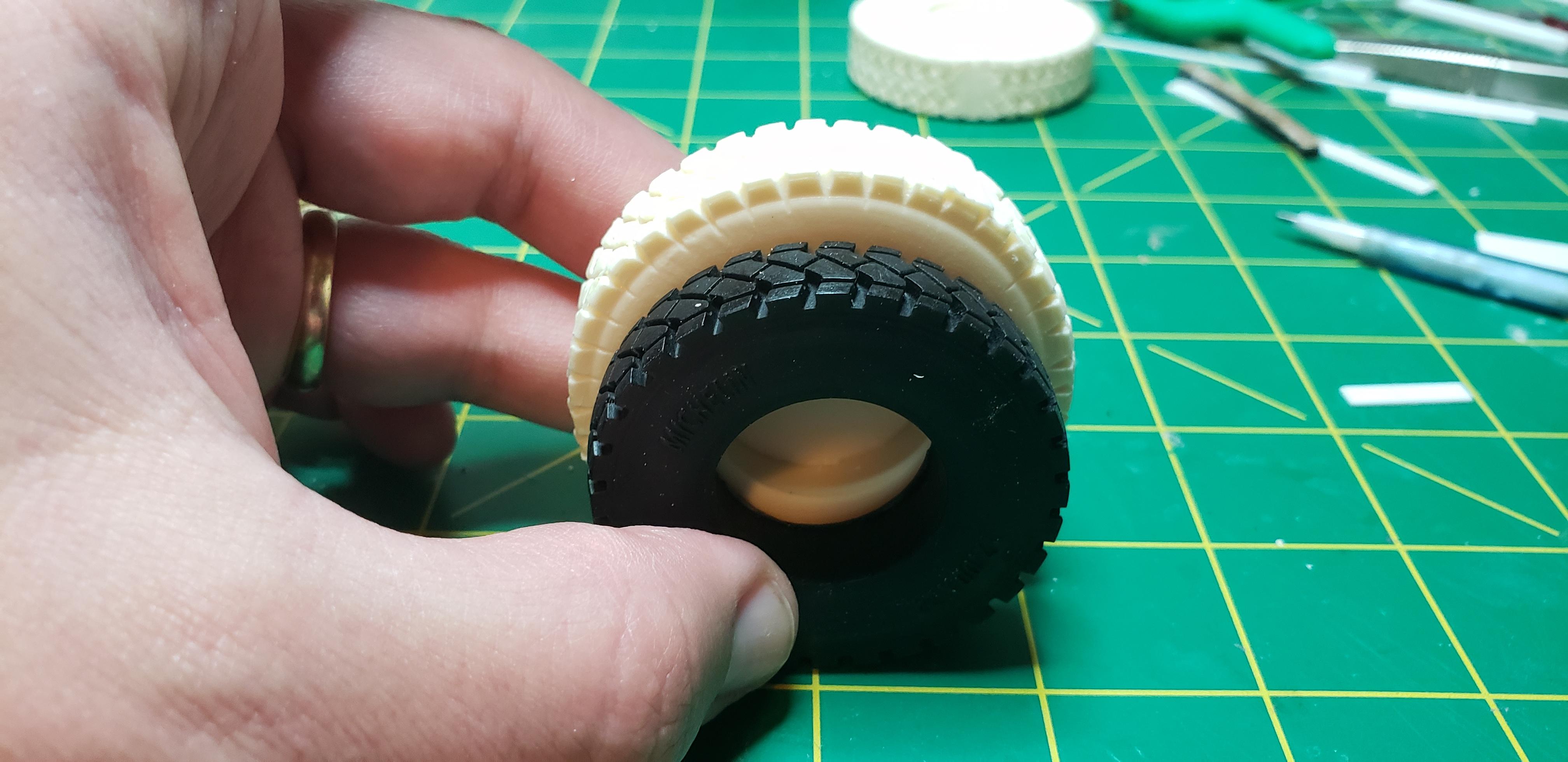

Side view reveals an issue ...those giant tires are causing everything to look out of scale. I wanted the top of the bank head about level w truck fenders.  I had ordered a set of 12x24 tires from moluminum and decided to test fit them..everything looked in proportion now .
okay.moving along now !
Here a comparison of the tire size for reference
So the Moluminum tires are a better fit?  Are the AITM rims ok?  I got a set of AITM tires a while back but the rims need to be shimmed to get a good fit.  Love the work.  It's a real treat to be able to work off detailed information and photos.  If I can find that Oshkosh again I will take some photos of it.
The moluminum wheels are smaller in height, being only 12 x24s , I needed a shorter tire . The aitm rims fit pretty decent w just a small amount of play inside the tire..not flopping around like some .

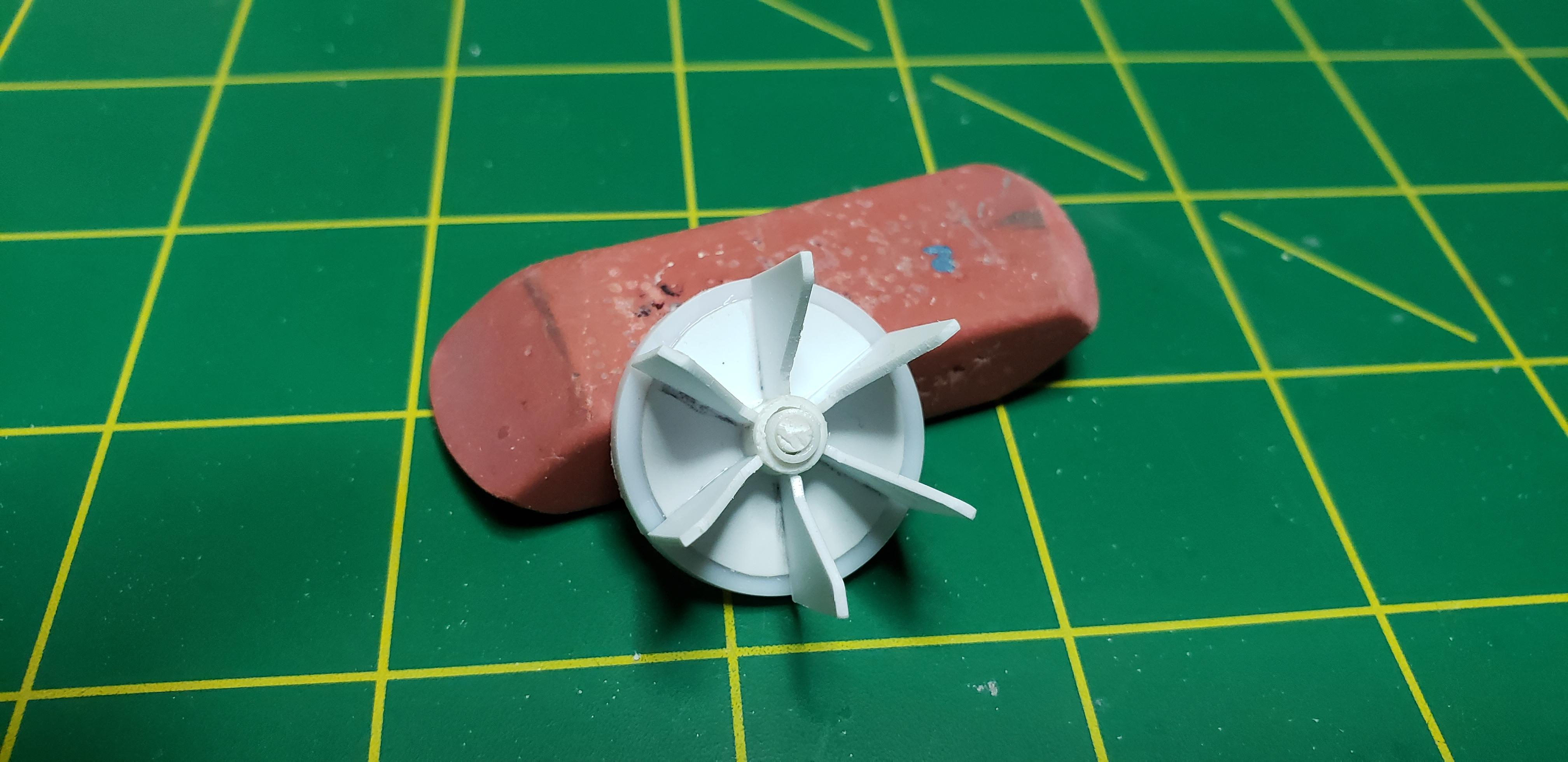

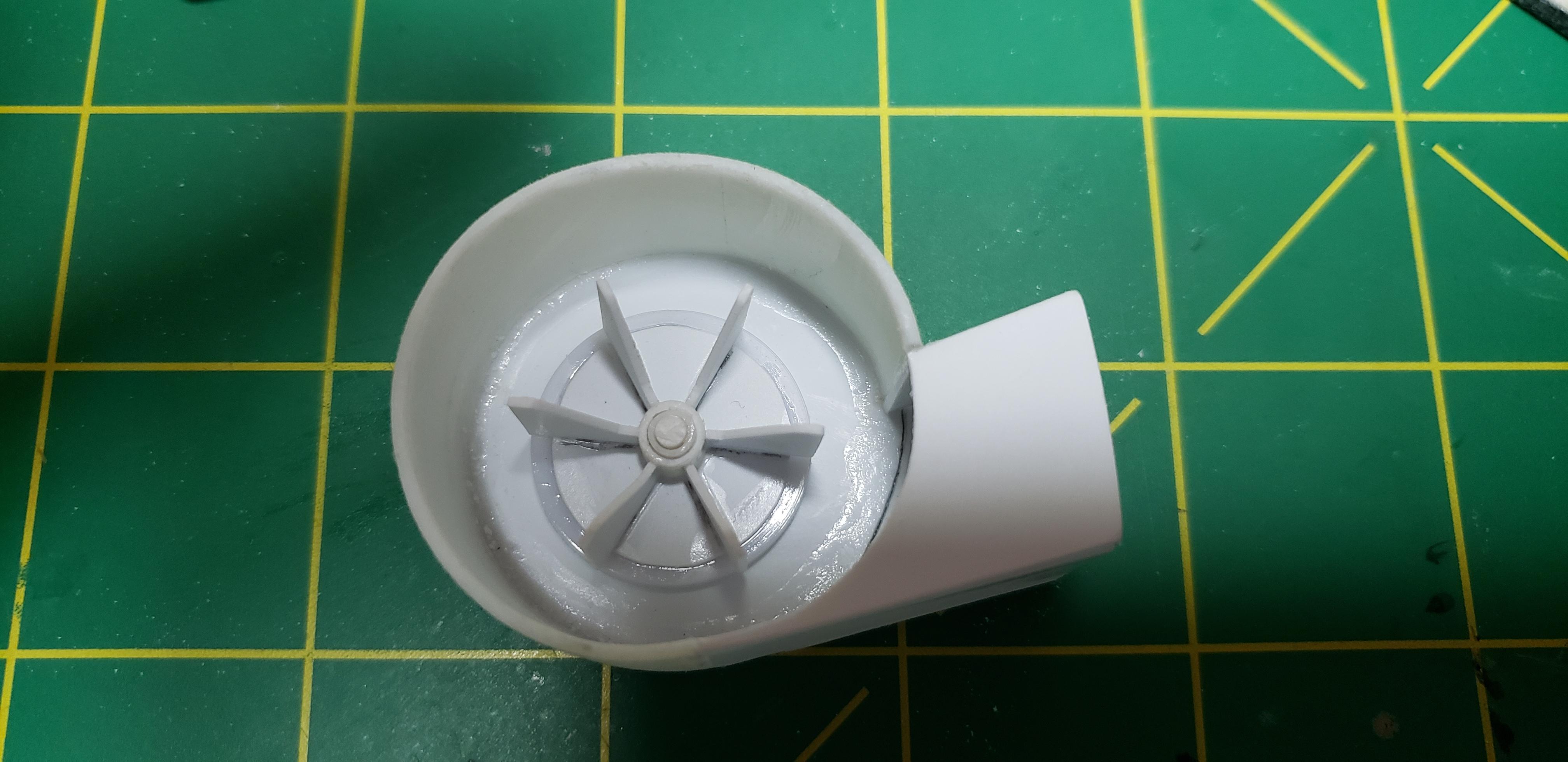

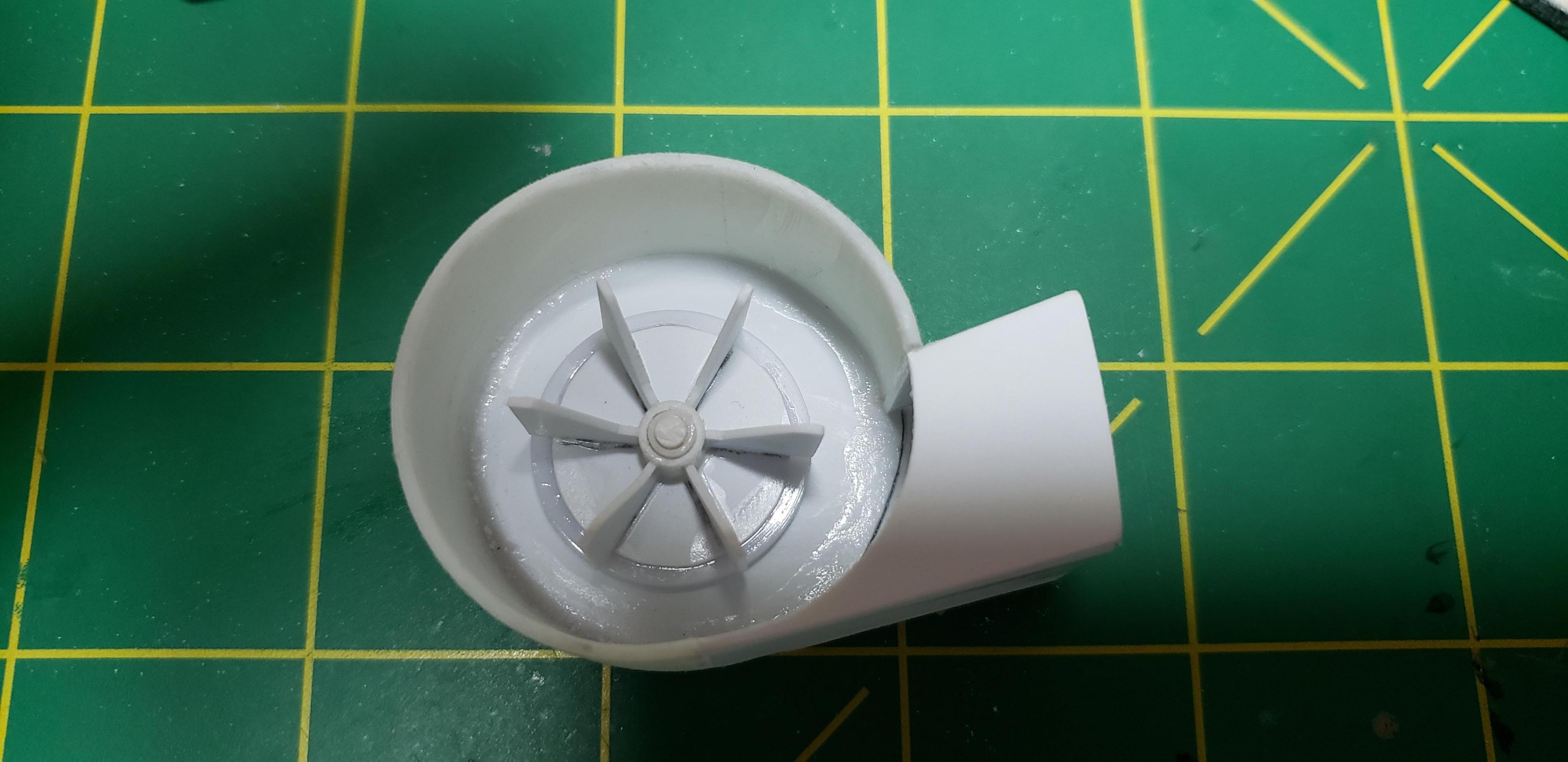

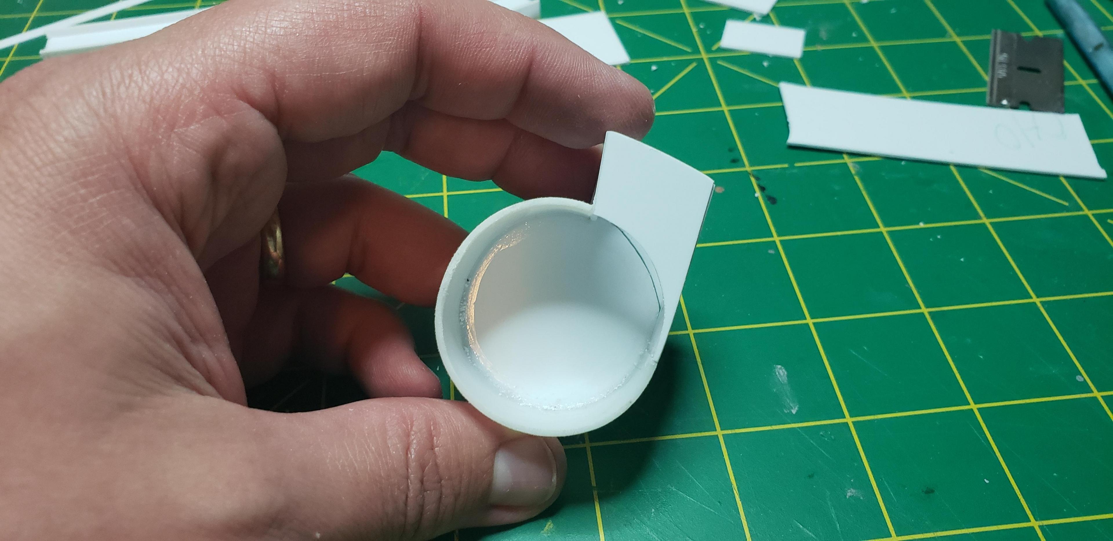

I'm plugging away on the blower, fabbed up the impeller body from pvc tube and some scraps . I originally thought about using medicine bottles , but didn't have correct size in the bag I was given. Photos I took helped judge the width and based diameter from those . 20201111_185611.thumb.jpg.b86e8b93fd46348dc13ca0c891aedb5e.jpg
The actual impeller is a cut down kw snapper wheel back, covered w sheet, then the shaft is scrap tube . The blade mounts were cut from 030 " sheet. Using photos I roughed in the shape then laminated the rest . They need a slight curve still then the blades will be added
Checking appearance before blades and bracing  gets added . Alot of work for a part buried behind the augers,but I'll know its there  !

So funny how the compartments you added, in the raw, resemble a couple of dog houses... ?

Yeah those dog houses are where the Bulldog sleeps at night !! I sketched both out on graph paper before finalizing to plastic to check angles looked symmetrical...close enough hahaha

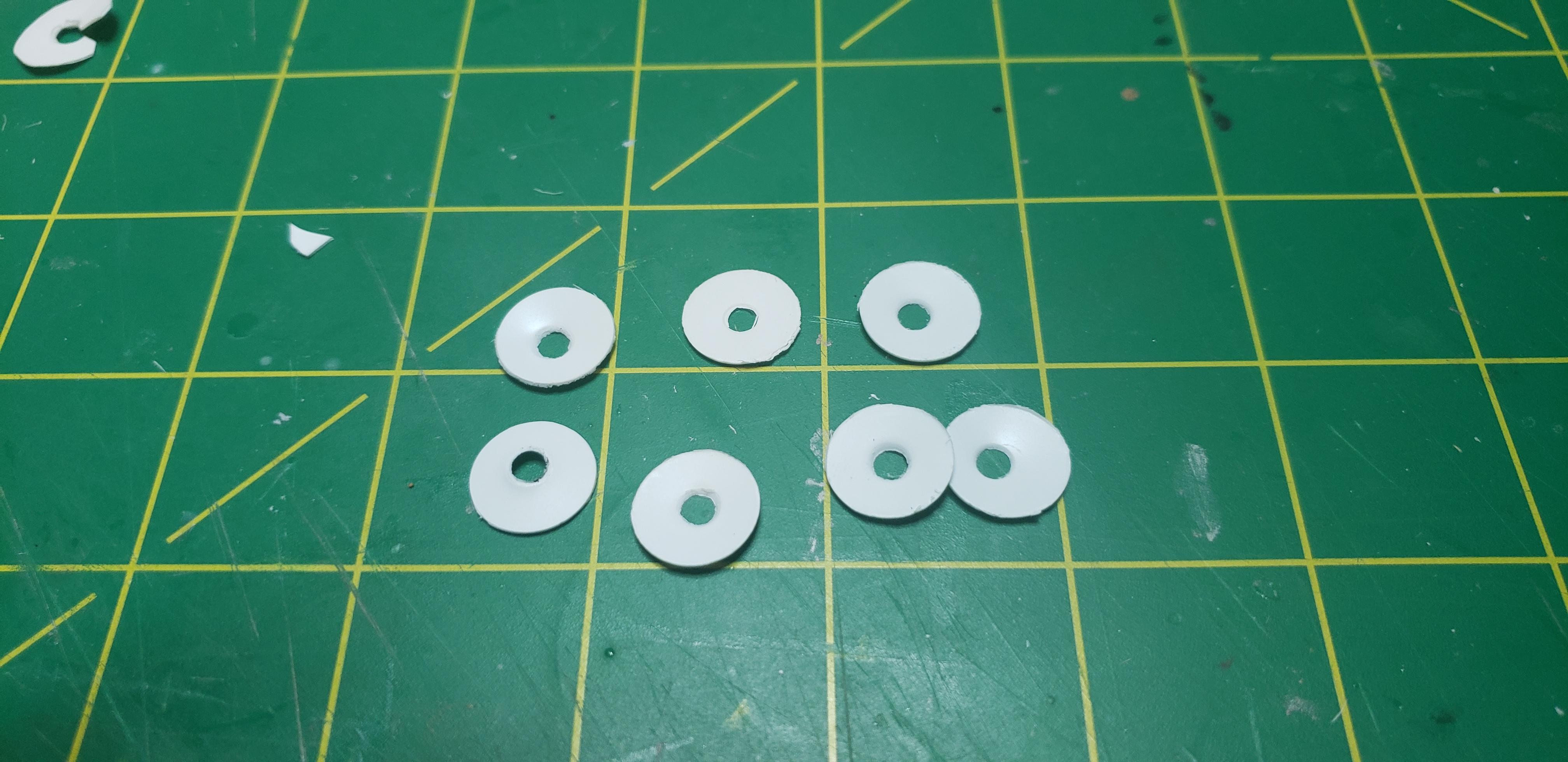

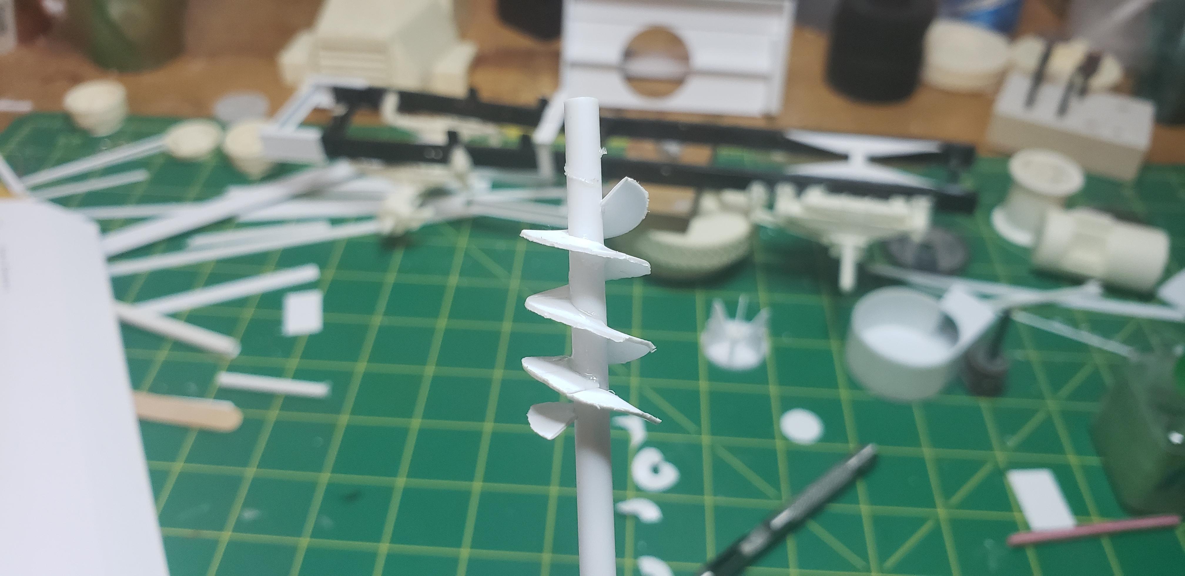

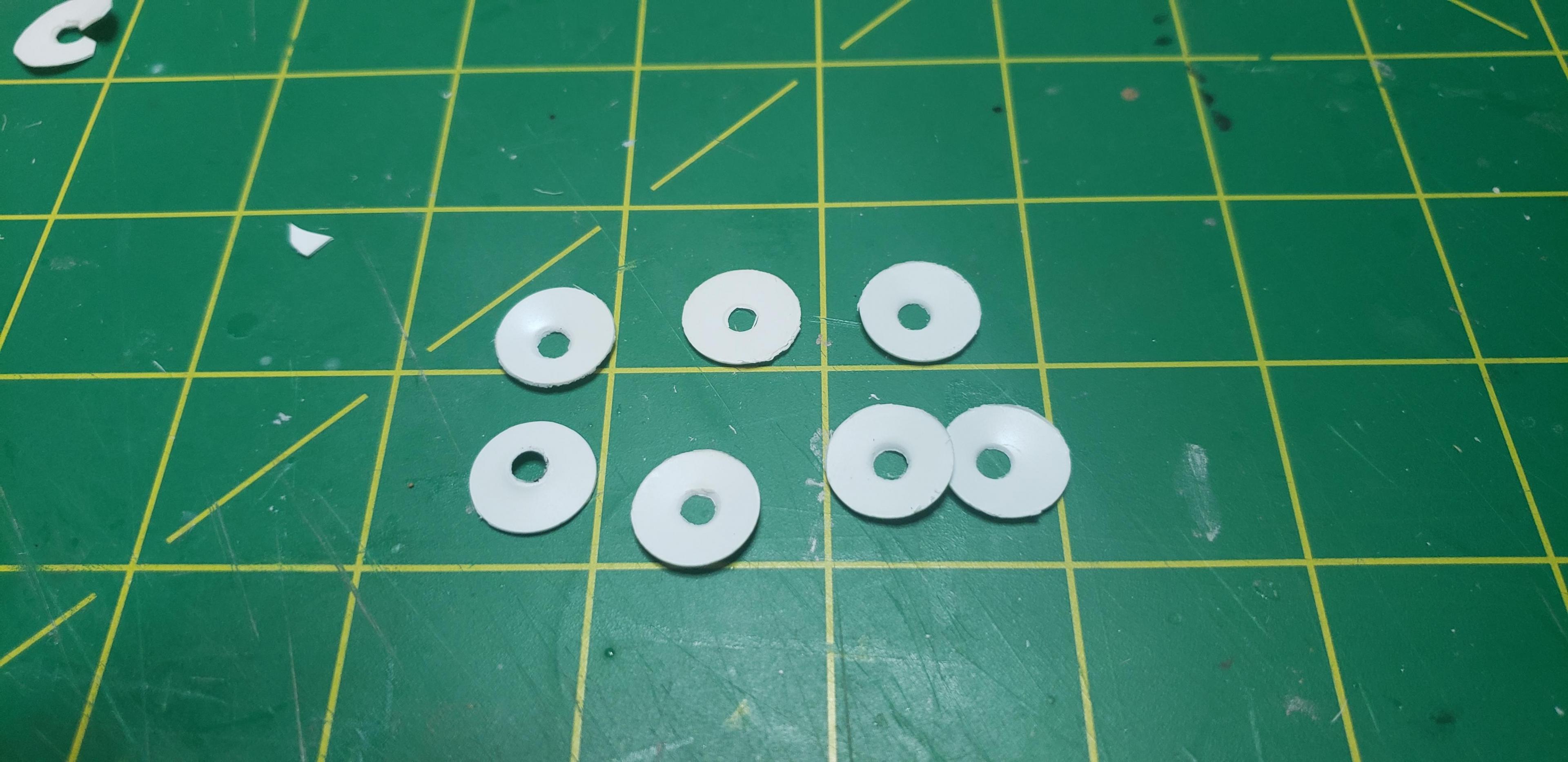

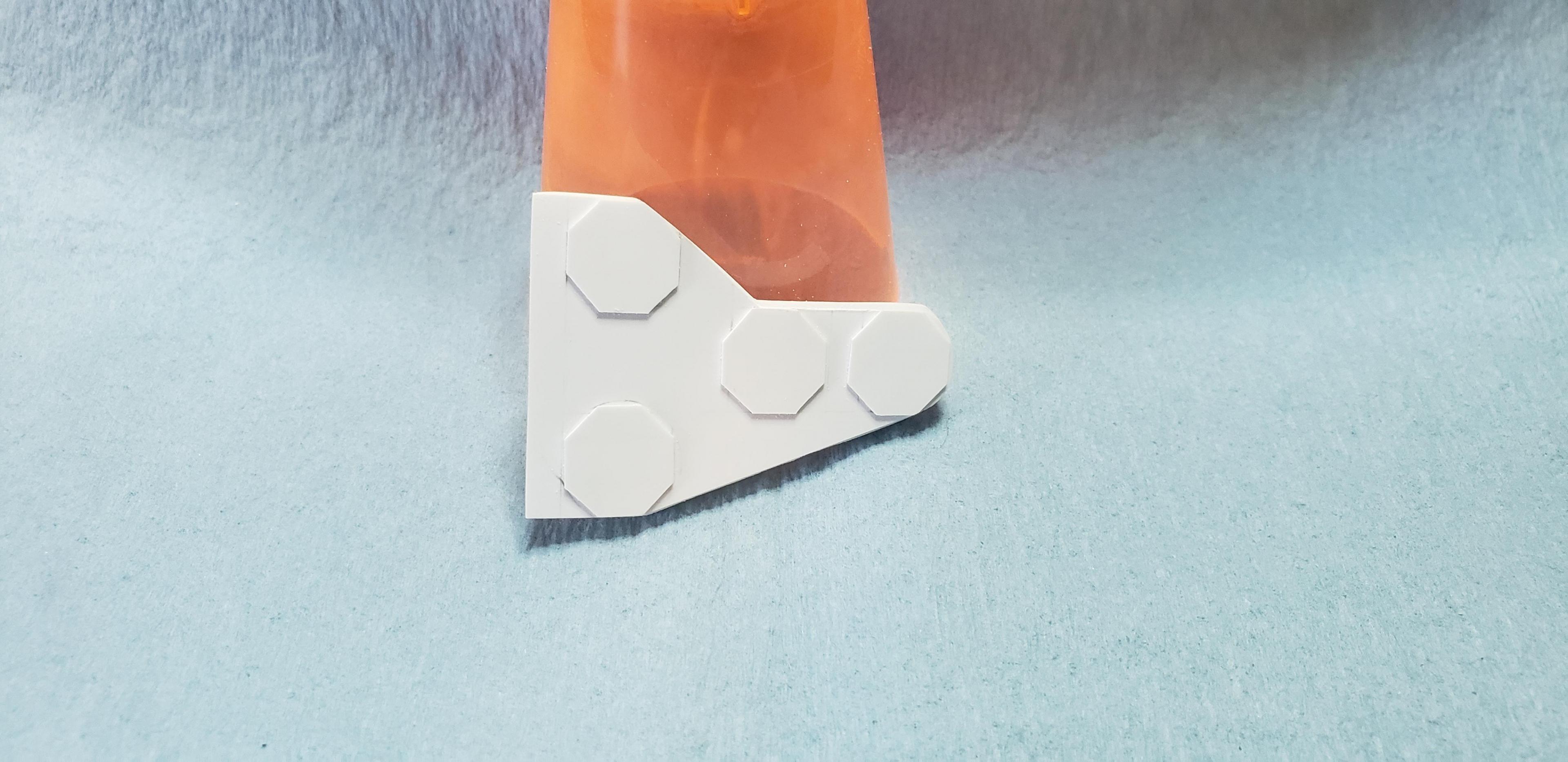

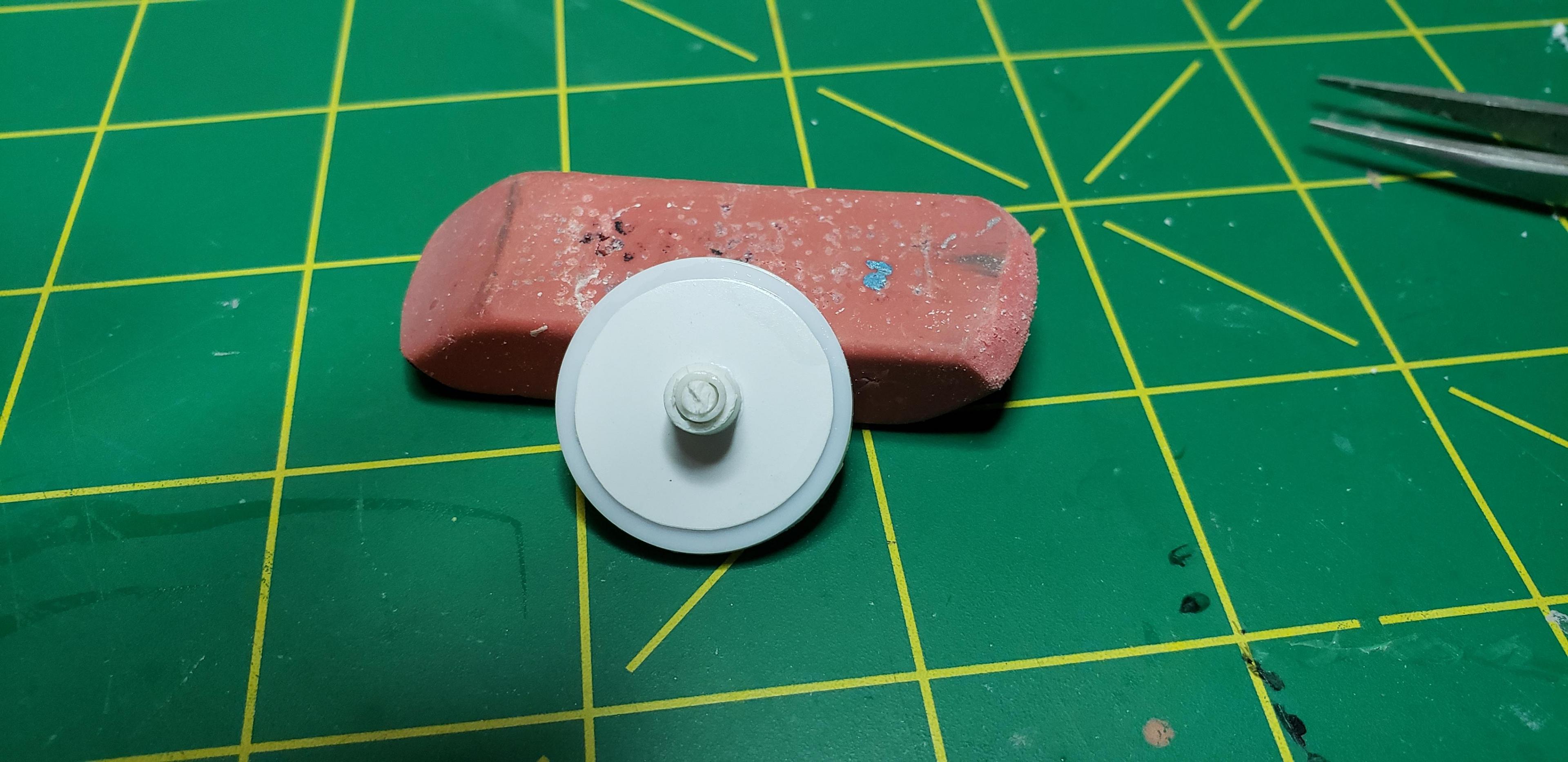

Screwing around w some plastic , picked up a gasket maker set to punch out the auger discs. Ended up using 9/16 punch or around 15mm.
Curling them slowly around a rod and tacking w insta set I had a starting shape..after several screw ups ! 20201117_193655.thumb.jpg.84c5bfa0c8926fb19fd7fbffb8b7ff90.jpg
Sorry for the cluttered background,  only another 20 to go
Thanks everyone!  I haven't been messing with the augers much, my build time has been mostly after work while daughter taking her nap. I didn't expect to use up my pre punched discs so fast..

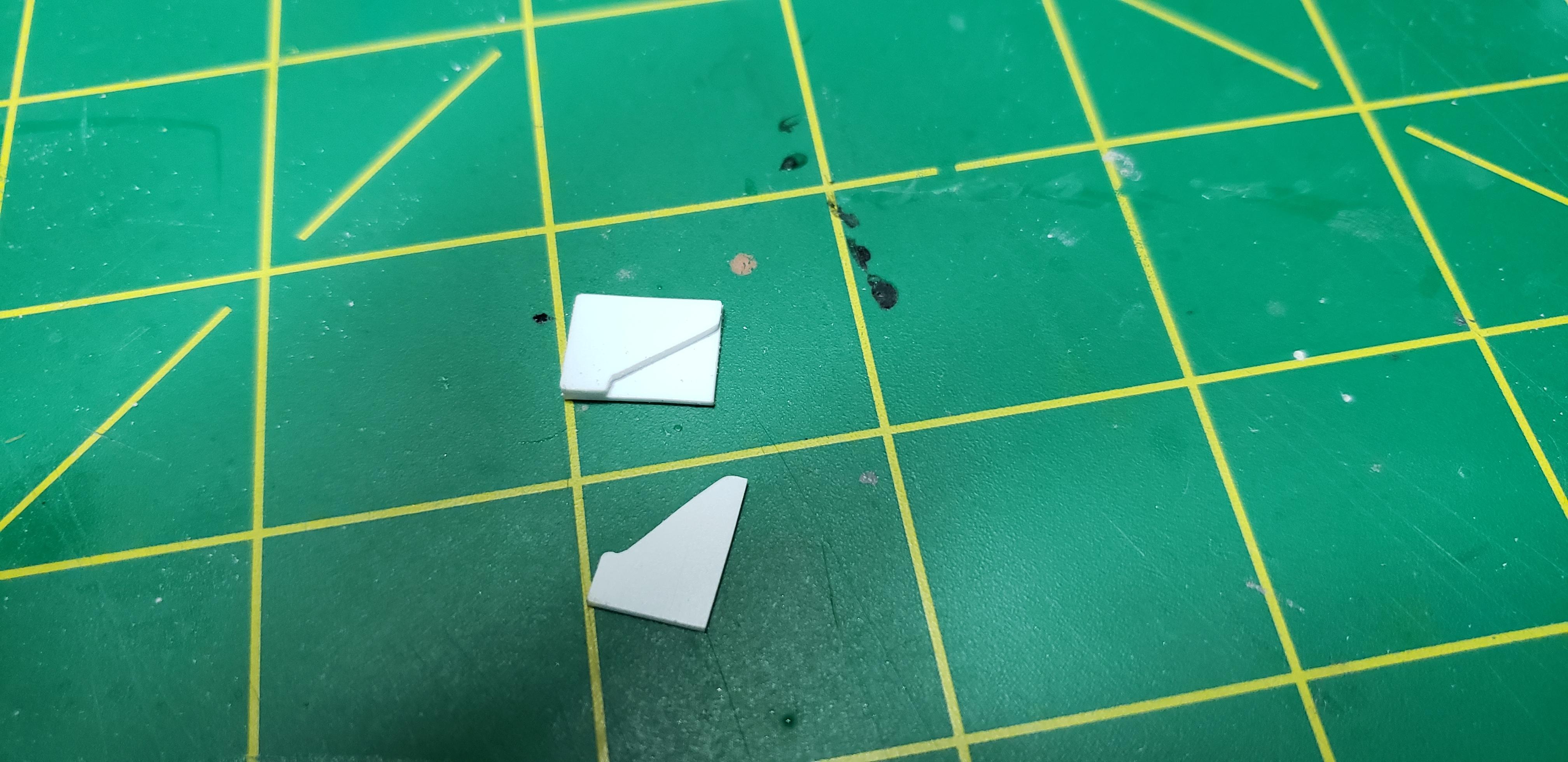

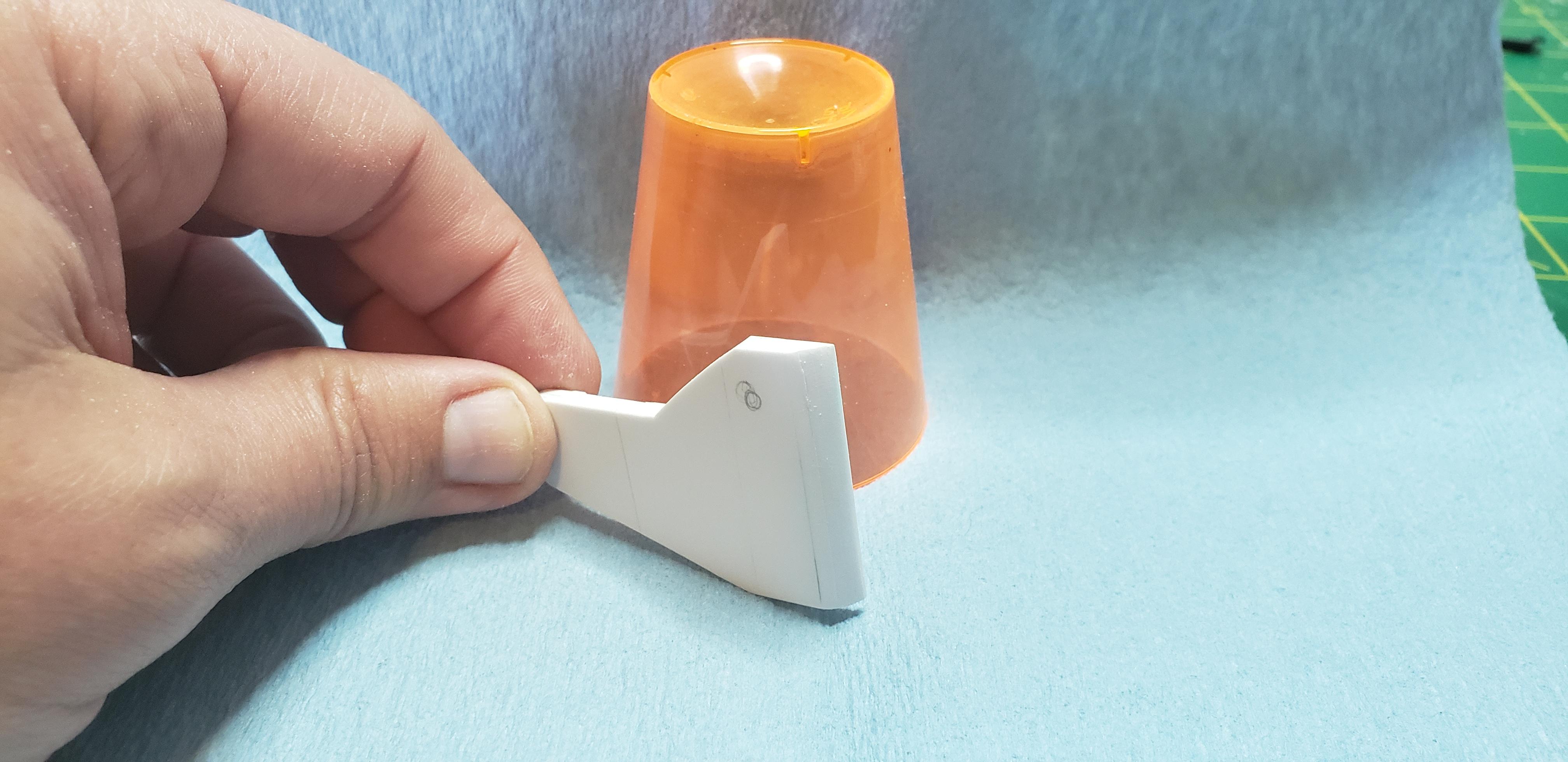

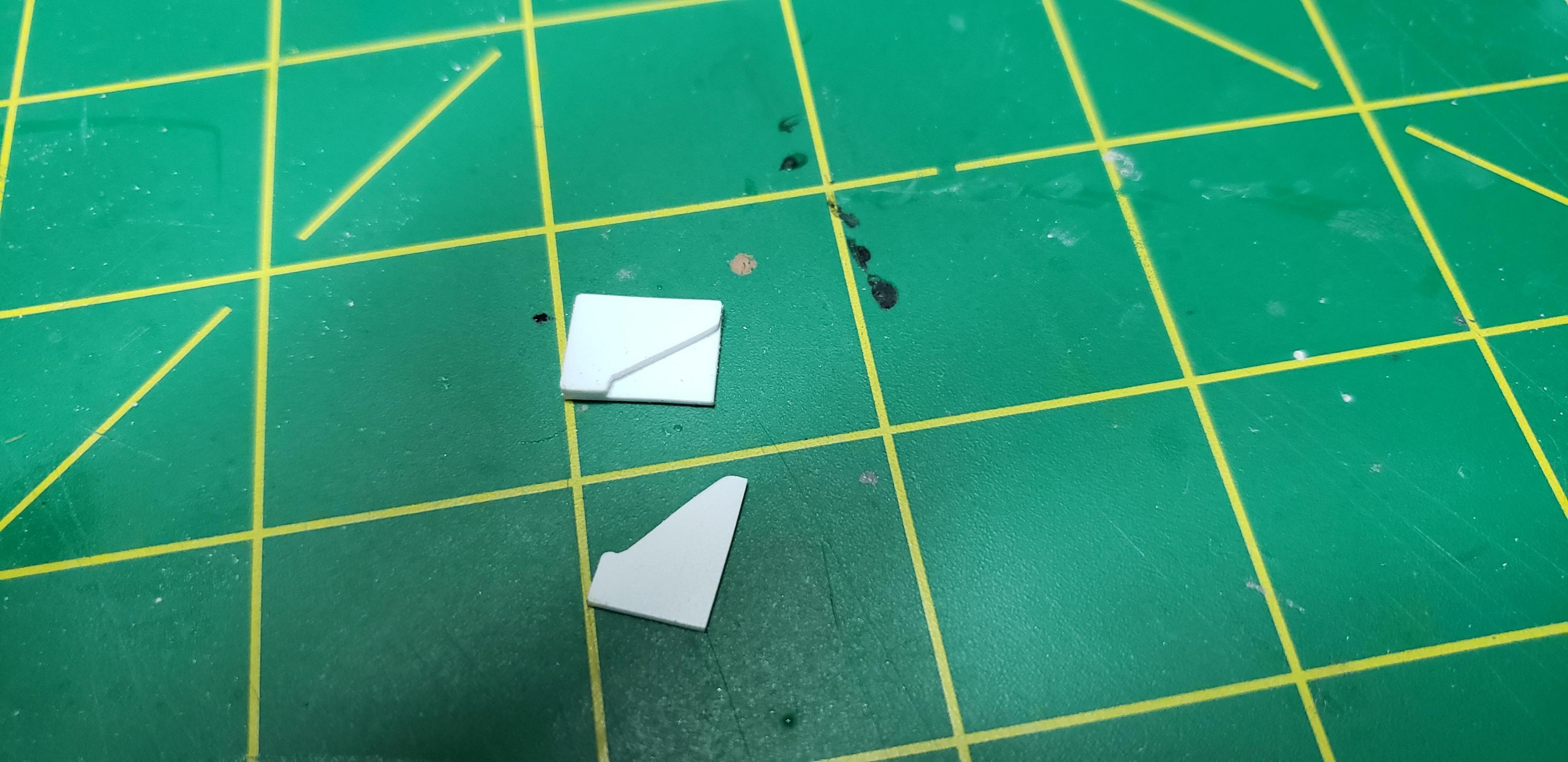

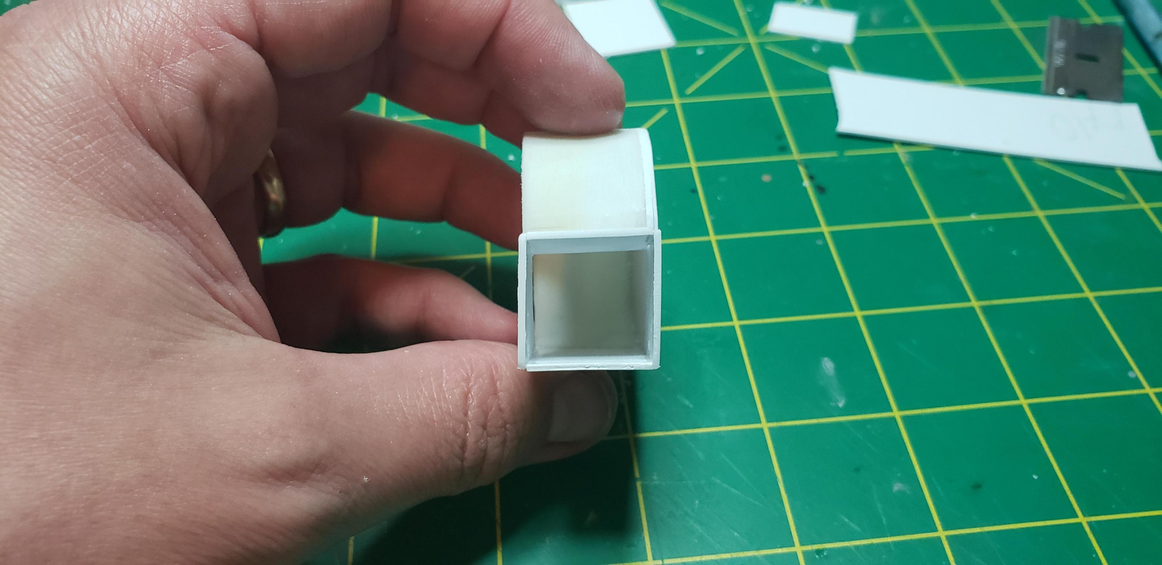

Did experiment last night w shape of discharge chute after a bag of gears arrived from amazon..I sketched out rough shape of chute , but have yet to try cutting shapes for it . Theres a side panel that curves and leans out thats testing me right now
Here's the lower chute though..030 strip glued into the gear made it sorta like whiskey barrel!
I'll putter with it over the wknd and also make a huge pile of auger teeth !
